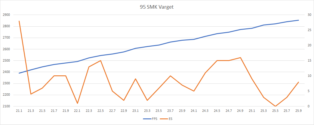

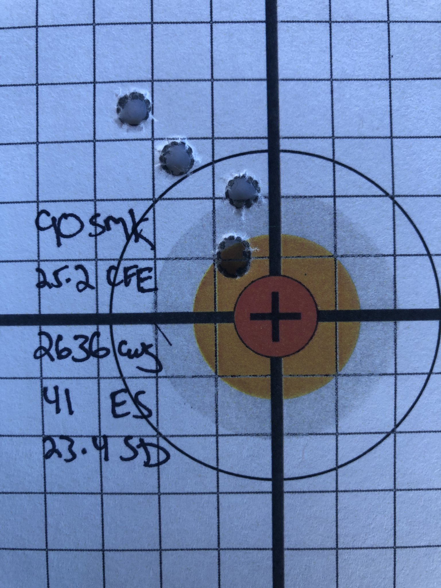

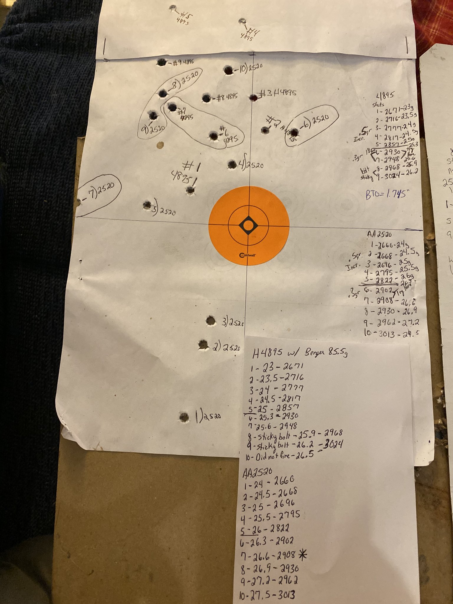

My first attempt at a ladder test. I did two shots per load. I was impressed with how linear the speeds were. I'm looking at 23.9 -24.1 for a possible node to test further.
95 grain SMK
Varget 21.1 - 25.9 grains
Starline virgin brass, run though FL die.
Federal small rifle primers
24" Spencer/MPA barrel 6.5 twist
Using that node with a velocity of 2674, that puts the heavy 95 grain pill out to 1200 yards in 2 seconds flat, remaining supersonic for the entire flight. Very excited to see this.
95 grain SMK

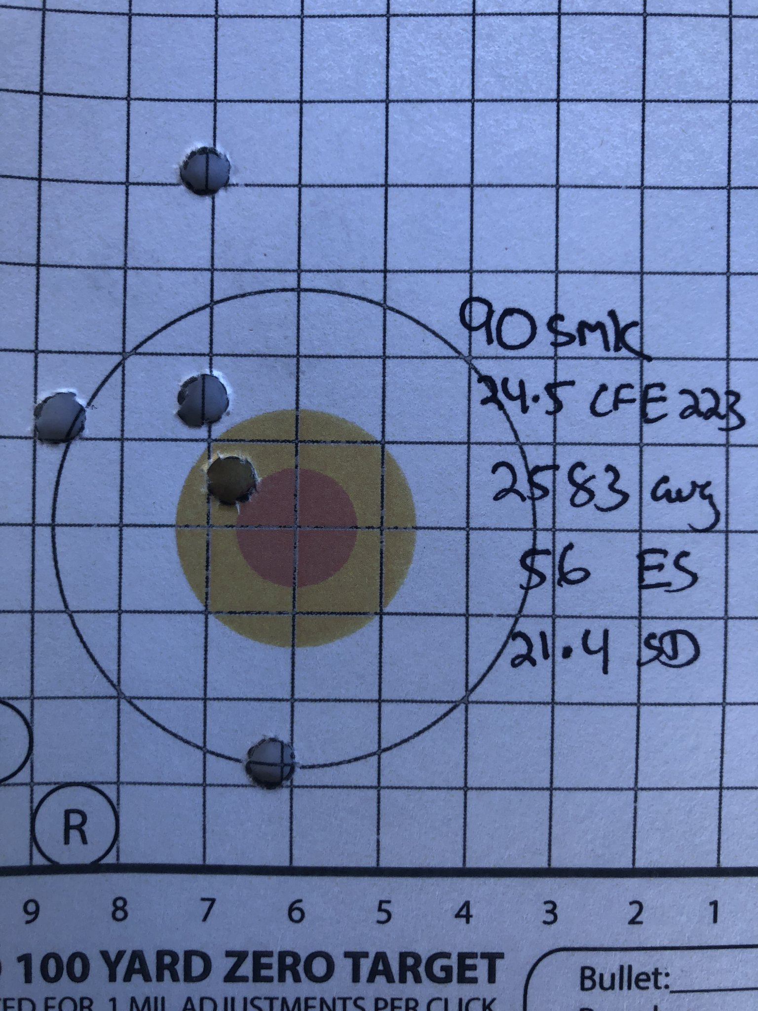

95 grain SMK
Impressive velocities at the upper end... This is in a bolt-gun correct? Did you see any bad pressure signs at that velocity?

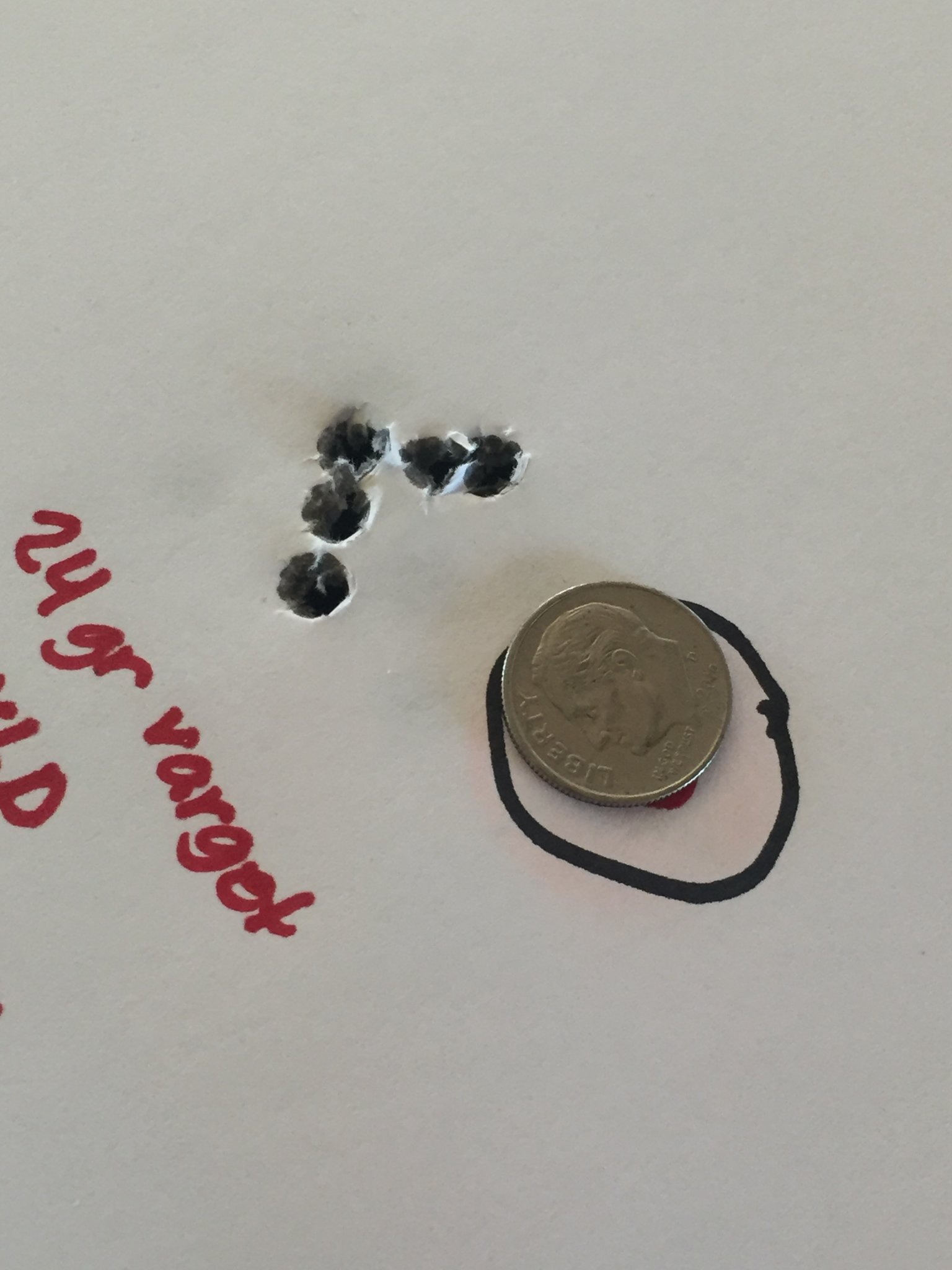

So after messing around with bullet seating I found that the 23.9 gr of varget works best with the 95gr smk’s at .010 jump from lands. I couldn’t test it any closer due to max mag length for the AR platform, but really didn’t need to since I’ll be happy with the .296” group.? The OAL is 2.295”. Unfortunately I forgot the chrono so will have to take a guess at speeds from last visit which was around 2650-2665fps at 300’ ASL. This will keep the bullet supersonic out to around 1200y at this level and supersonic out to 1260y at 2500’ASL, where some matches are held. Damn close to that 1300y marketing hype, and in an AR.

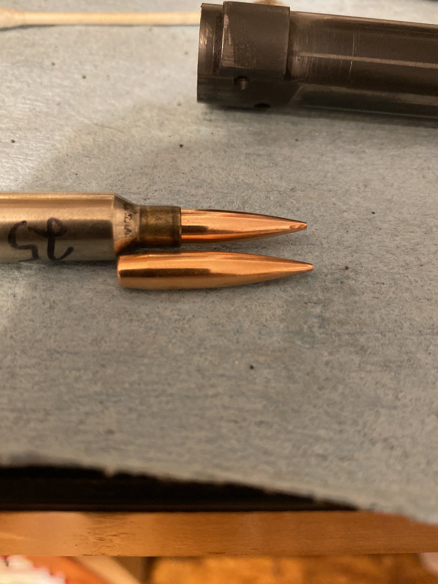

Edit....made a rookie mistake on how much throat erosion I had. I was measuring COAL with a sized shell with a bullet pushed in by hand in it, well that is not good because when you pull the shell out with the bolt and if the bullet gets into the lands at all it is very likely that the bullet will get pulled out of the case all the way or just enough to screw up your measurements, and that is exactly what happened. Sorry for the confusion
Started to work on the Berger 85.5’s, the measurements with the Sinclair tool might be longer due to me possibly pushing the bullet a little too hard into the lands/rifling but the other measurement was a fired case that I squeezed the neck a little to cause more tension on the bullet and inserted into the chamber and closed the bolt on, did the same thing multiple times and came up with the same measurement every time but once so I will be going by the fired case measurement I believe. Don’t know how much I’m going to mess with these this close to rifle white tail season but we’ll see. Was working on my 30-06 in case my 6.5prc wasn’t going to show for deer season but I got confirmation of its arrival due date to be Tuesday!!!

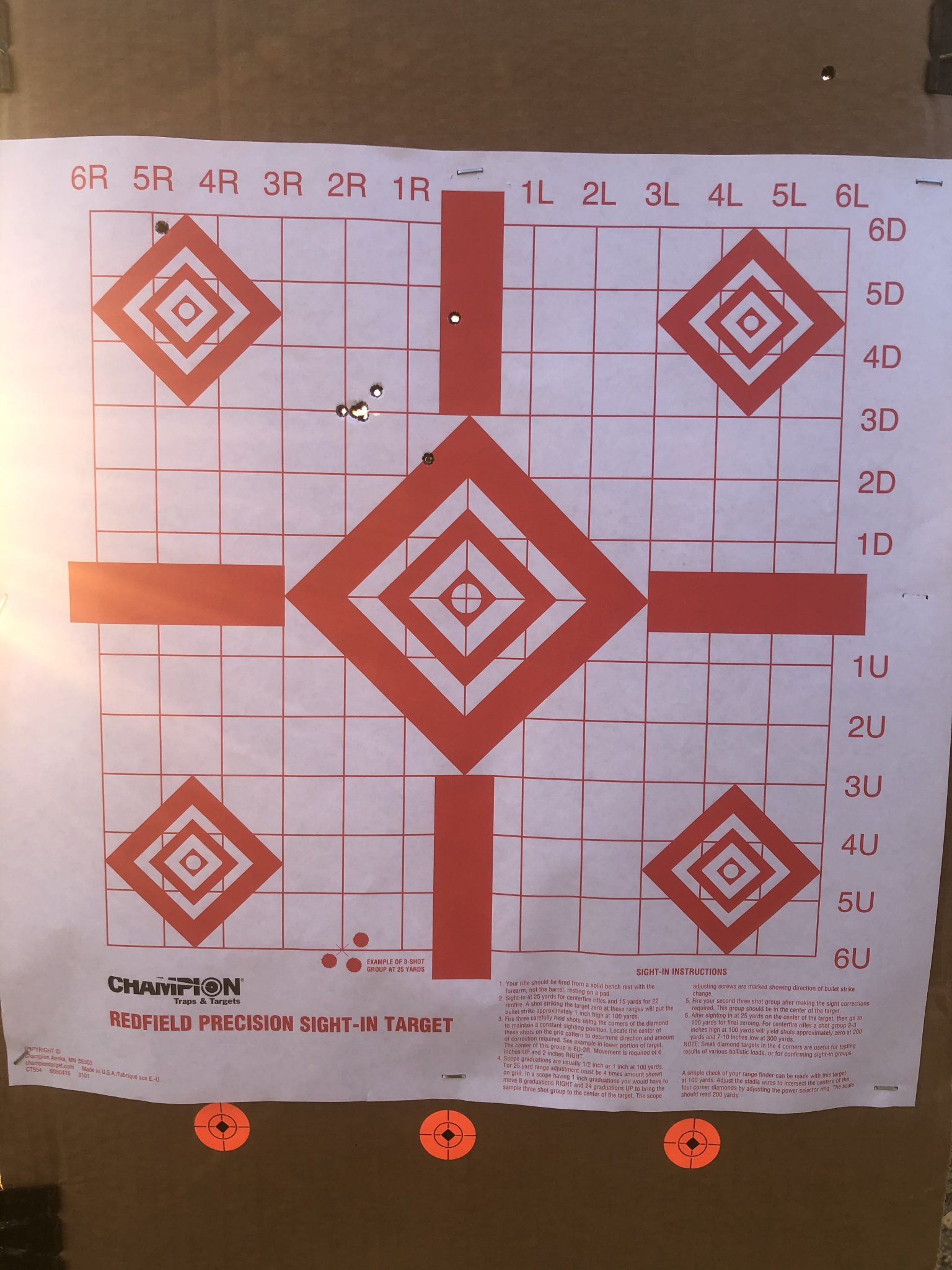

I only got one picture of a group at 100 yrds before the rain got the paper wet and made it fall off the target backer. I may tun the load a little more but at this point I’m just enjoying shooting it right now.

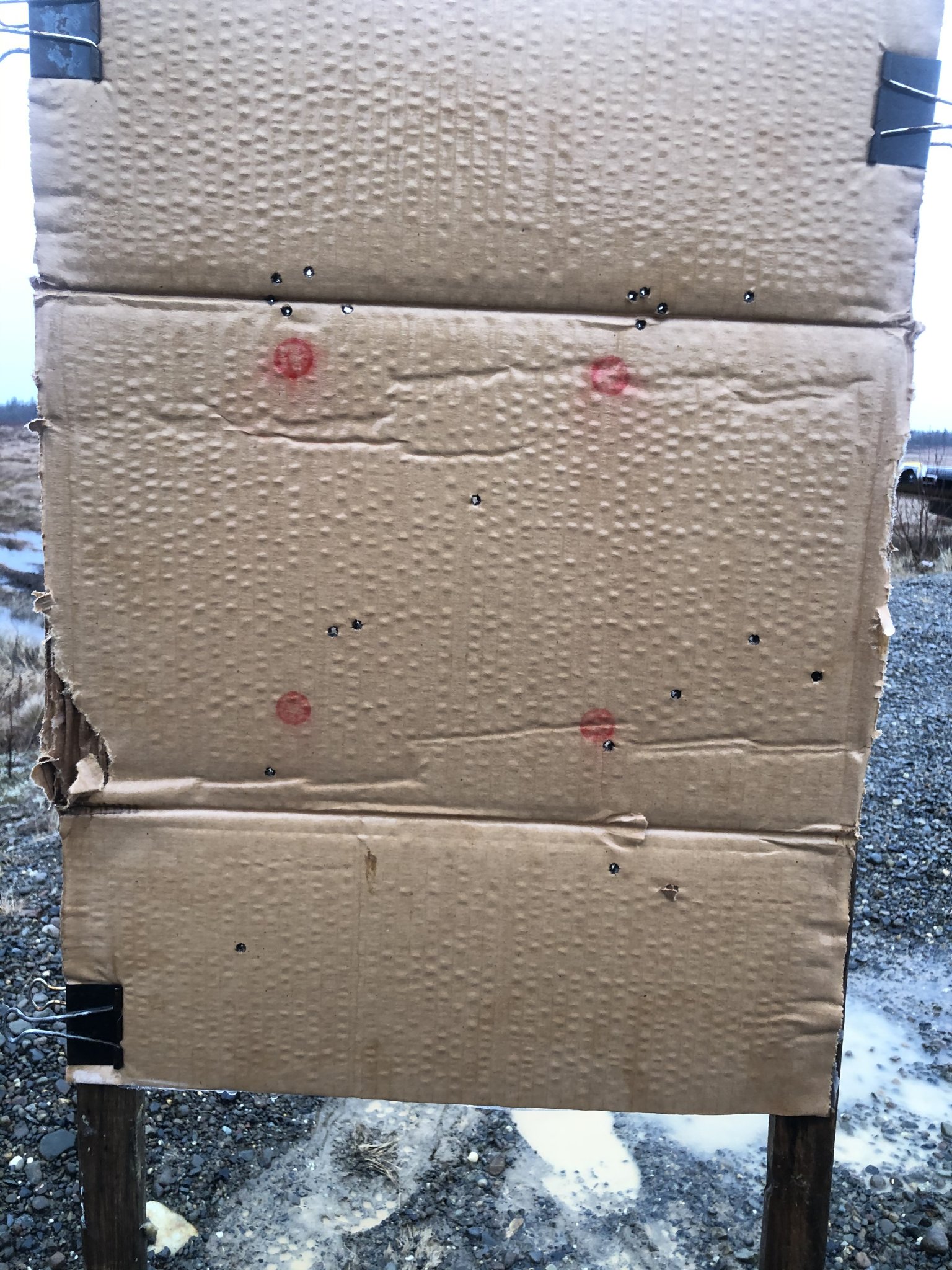

Weather was crap but I made it out to jump test these 85.5 Bergers. I have a bunch of CFE223 so I used this for this test and wasn’t too meticulous in my charge weight as I was in a rush and would safely assume they are plus or minus a 0.1 grain. At a tenth off and also 0.050” off they shot well and it makes me wonder if they will be similar to the 80 eld-m’s and like 0.035”-0.045” as the preferred jump. I pulled my 5th shot on each of these groups as I was watching the group come together. I haven’t shot since early spring so I have some rust to knock off. At 0.090” and 0.130” off it looked like the 90 fusion groups I got out of my setup, horrible.
Findings on Facebook using H4895 show 24.4 as max and 2840fps out of a 24” bbl. I believe I will continue tinkering with CFE223 and see how far I can take it velocity wise and also if the groups hold together. I shall save the H4895 for my red rockets.
6.5T 24” Bison Armory heavy barrel
44.8F, 94%H, 29.94inhg
Virgin starline, 26.8 grs. CFE223, GM205MAR, 85.5 Berger@ 0.010”, 0.050”, 0.090”, 0.130” jump; lands at 1.803” CBTO, 2.355”oal
1.793”-0.9” not including called flyer
1.753”-0.655” not including called flyer
1.713”-not worth measuring
1.673”-not worth measuring
Average velocity 2781fps, sd13, high2804-low2756 out of 20 shots fired. All brass looks good and this charge looks to be fairly light as the primers are still rounded on the edges and no ejector marks at all. Very light recoil and I was able to watch holes appear at 100 yards.
Top left 0.010”, top right 0.050”, bottom left 0.090”, bottom right 0.130”

16DEC2019 30F, 95%H, 29.66inhg
Once fired starline, [email protected], GM205AR, 85.5 Berger@ 0.025”, 0.030” 0.035”, and 0.040” jump
CBTO
1.779”-best group but open
1.774”-horizontal group
1.769”-horizontal group
1.764”-open group
2789avg, sd18
This avg is for 20 rounds fired. I tried GM205MAR primers to see if it would lower the sd but it stayed about the same as Rem 7 1/2’s (2804avg, 20SD 20 rds fired), and just lowered the avg speed by 15fps. I’m going to try a few rounds using imr4320 to see if this will work or not.
Reuben
I’m about to give the 85.5’s a try with Winchester StaBall. The only reason I am switching is because I can’t find the 90 gr vlds anywhere. My Origin with a 1:7 5R Bartlien was lights out with the 90 vlds over 24.1 grains of varget which pushed it at 2710 fps. The OAL was 2.320.

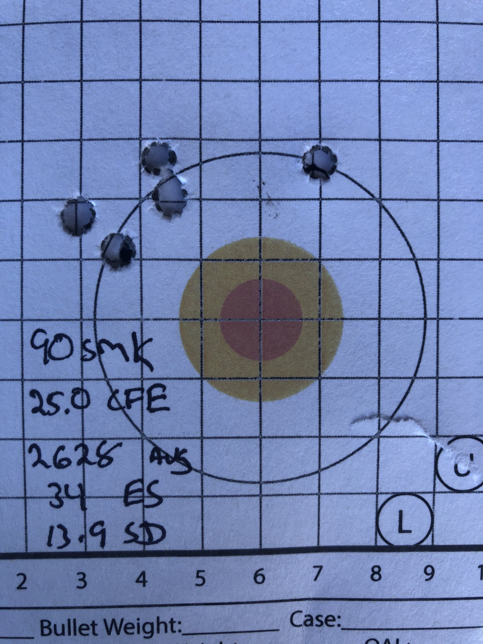

Here is my satterlee test to find pressure which I didn’t and they all look good to go. I will load five at 26.3, 26.5, and 26.7 to see if they are accurate. Here’s a photo of the eight shots at 100 yards. I am hoping the last four went into the tiny cluster we shall see with further testing. As long as I can keep these under an MOA and near 2700 I am happy as they are hunting bullets. These are the same bullets used in the factory 90 grain fusion option.
17DEC2019 23.7F, 86%H, 29.49inhg
Once fired starline, Rem 7 1/2, 90 RMR SBT@ 1.764” CBTO 0.040” jump, CFE223
25.1-2534
25.3-2530
25.5-2544
25.7-2631
25.9-2608
26.1-2637
26.3-2678
26.5-2678
Got a chance to shoot some quick ladder tests to establish max charges in my Valkyrie. Due to time constraints I was only able to shoot at 100 yards with limited rounds down range. I picked the 80 grain Berger VLD over Superformance and H414. I haven't seen much data in this thread for this bullet or these powders and I have a ton of them, so that's what I went with.
20" Larue with 1-7 twist
80 grain Berger VLD
COAL: 2.271"
CBTO: 1.777" (Jammed 5 thou)
CCI .41 Primer
New Federal Brass (H20 - 31.4 grs)
Fired Federal Brass (H20 - 32.0 grs)
Superformance: (grs / fps)
27.0 2310
27.4 2372
27.8 2440
28.2 2465
28.6 2520
29.0 2567
29.4 2621
H414: (grs / fps)
25.0 2385
25.4 2421
25.8 2470
26.2 2520
26.6 2560
27.0 2604
27.4 2656
Results:
I was surprised to see this much vertical spread on target at only 100 yards. Several of my bolt guns shoot ragged holes over a 2.0 grain spread at 100 yards and it's not until 300 yards that you see meaningful dispersion. Not sure why that is, but not really concerned with it.
It appears that with each powder there is a low and high node with a "scatter" in between. The "scatter" shot was exactly 2520 fps with both powders (coincidence, who knows!?) and the low node is between 2372-2470 fps, and the high node between 2560-2656 fps. I was also surprised by the linear increases in velocity, approximately 49 fps per 0.4grs of powder. I did not reach any pressure signs during these ladder tests, so I will explore slightly higher charges in the next round of testing.
So what does all this tell me... Avoid anything in the 2520 fps range, and H414 produces more velocity per grain of powder than Superformance (it's more efficient?). Neither of these powders are said to be temperature stable, so in the future I'll do some testing with other powders such as Varget, N540, 8208 XBR, BLc2 and AR-Comp. I know, some of those aren't temp stable either, but I'm curious... It's also nice having two nodes in two different powders that span about 100 fps each. That tells me this round should be very forgiving and stable if loaded to the middle of a node.
The next round of testing will consist of an OCW style test to better identify the high nodes. Most likely focusing on Superformance between 29.0-29.8grs (5 groups of 4 shots, 0.2gr increments). Then H414 between 26.6-27.8grs (7 groups of 3 shots, 0.2gr increments). As I mentioned I did not reach pressure max with either powder, so loading on the higher end will let me verify the outside edge of the node. If I reach pressure before then, I'll stop.
I did load some extra rounds for sighting in and fowling the barrel. The last picture is a decent group that makes me think this rifle has potential. Oh, by the way, I HATE FLIERS! (rifle will out shoot me every day!).
