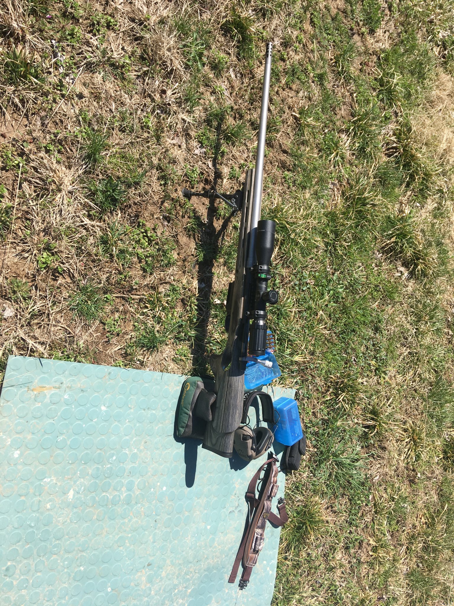

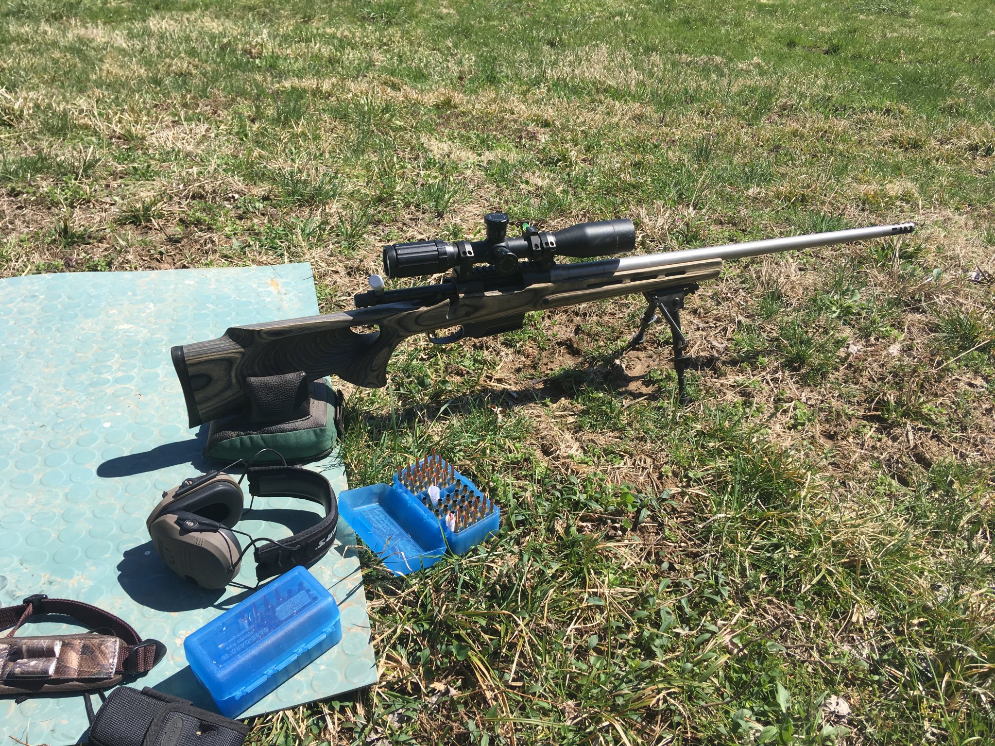

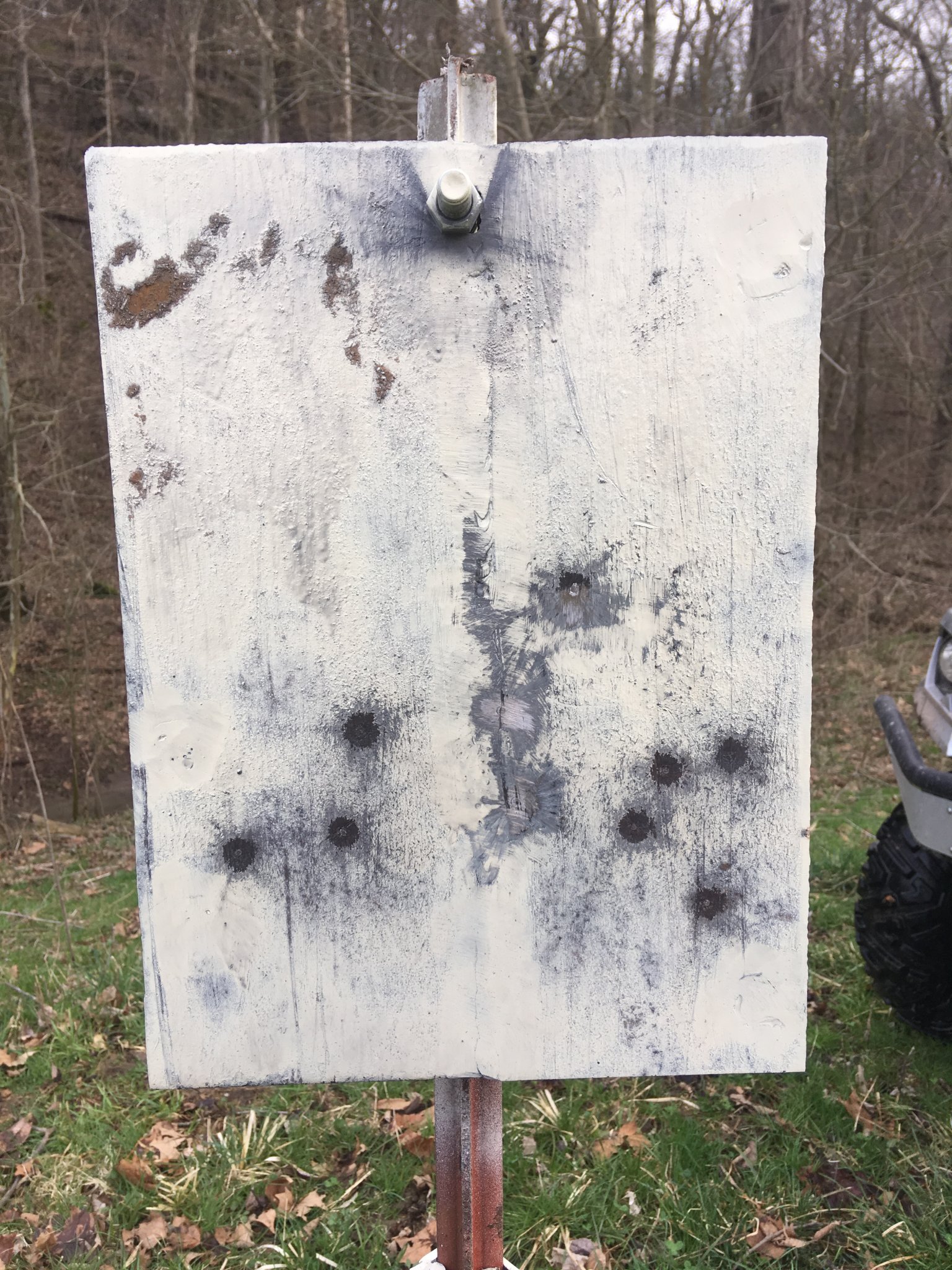

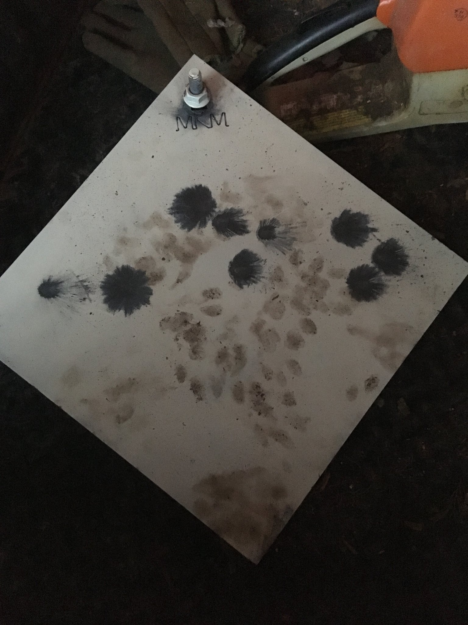

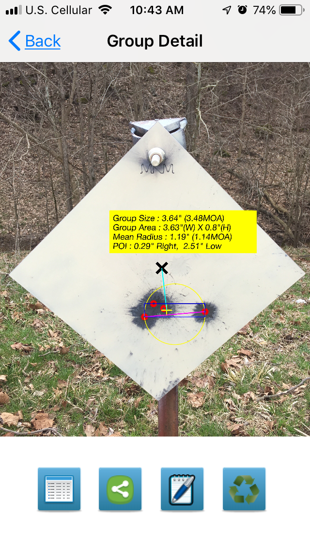

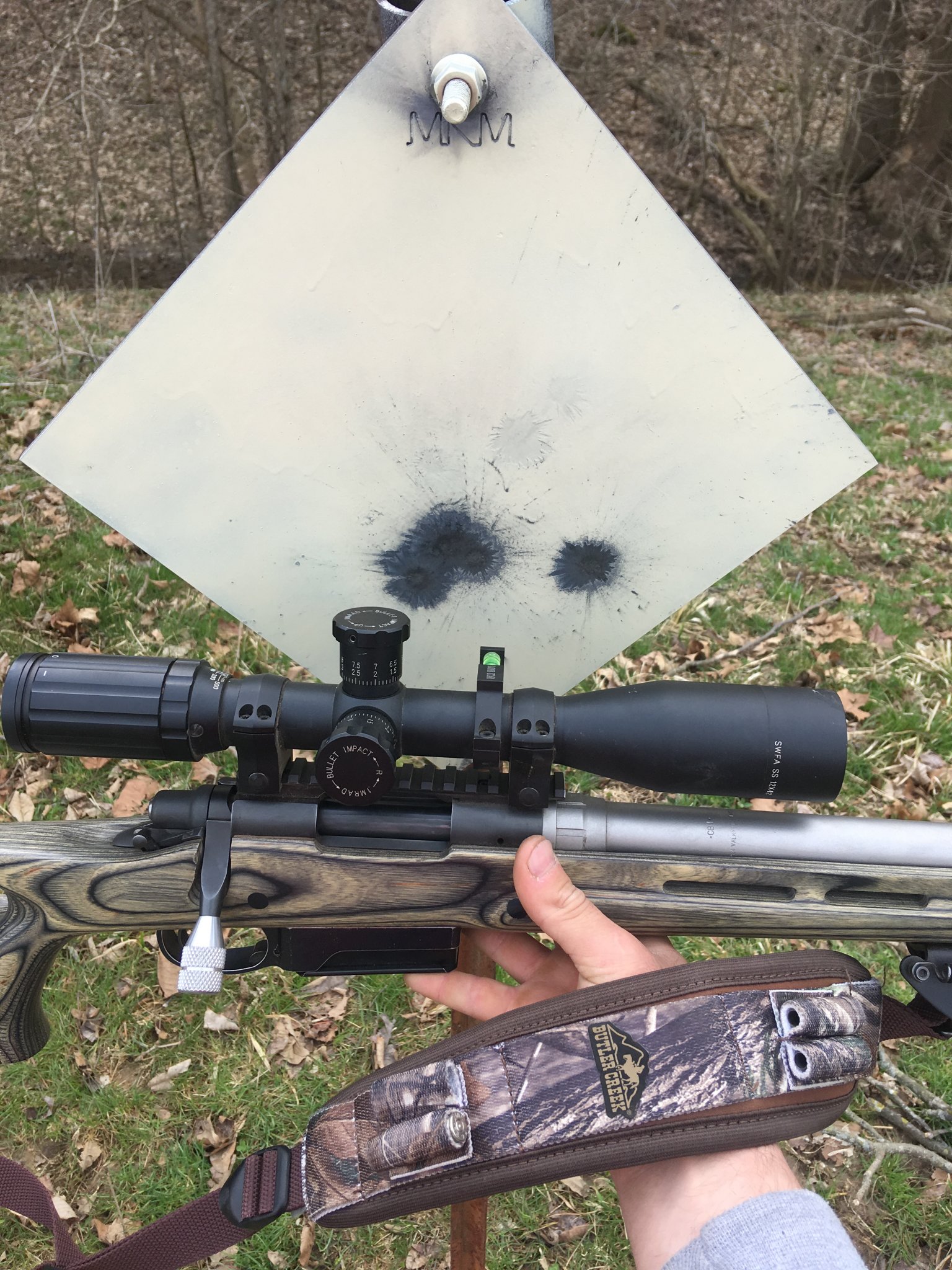

Now for the pay off!!! Got time to set up a 12”x12” plate at 600yrds. Very nice day, had a 3-4mph 3:00wind, wind really didn’t affect it too much really. View attachment 7048824
I missed the first shot, adjusted and bingo!!! Top and the below was the 25g H4895 .001NT 1.775bto cci450
This is the 25g H4895 .001NT 1.765bto cci450!!! I was pretty pumped and I’m not sure what happened to the 5th shot, maybe me maybe mirage....not sure but still fucking awesome!!
25g H4895 .002NT 1.740. First shot miss and connected with the next 9....buy now I’m surprised I hit the plate!! Not sure if it was me or if that’s how it actually grouped.
This was almost too easy!!
Remage bolt gun, 1-6.5” twist 24” lt varmint contour, pillar bedded and detachable magazine done by me, ss12x42, 20moa seekins rail.

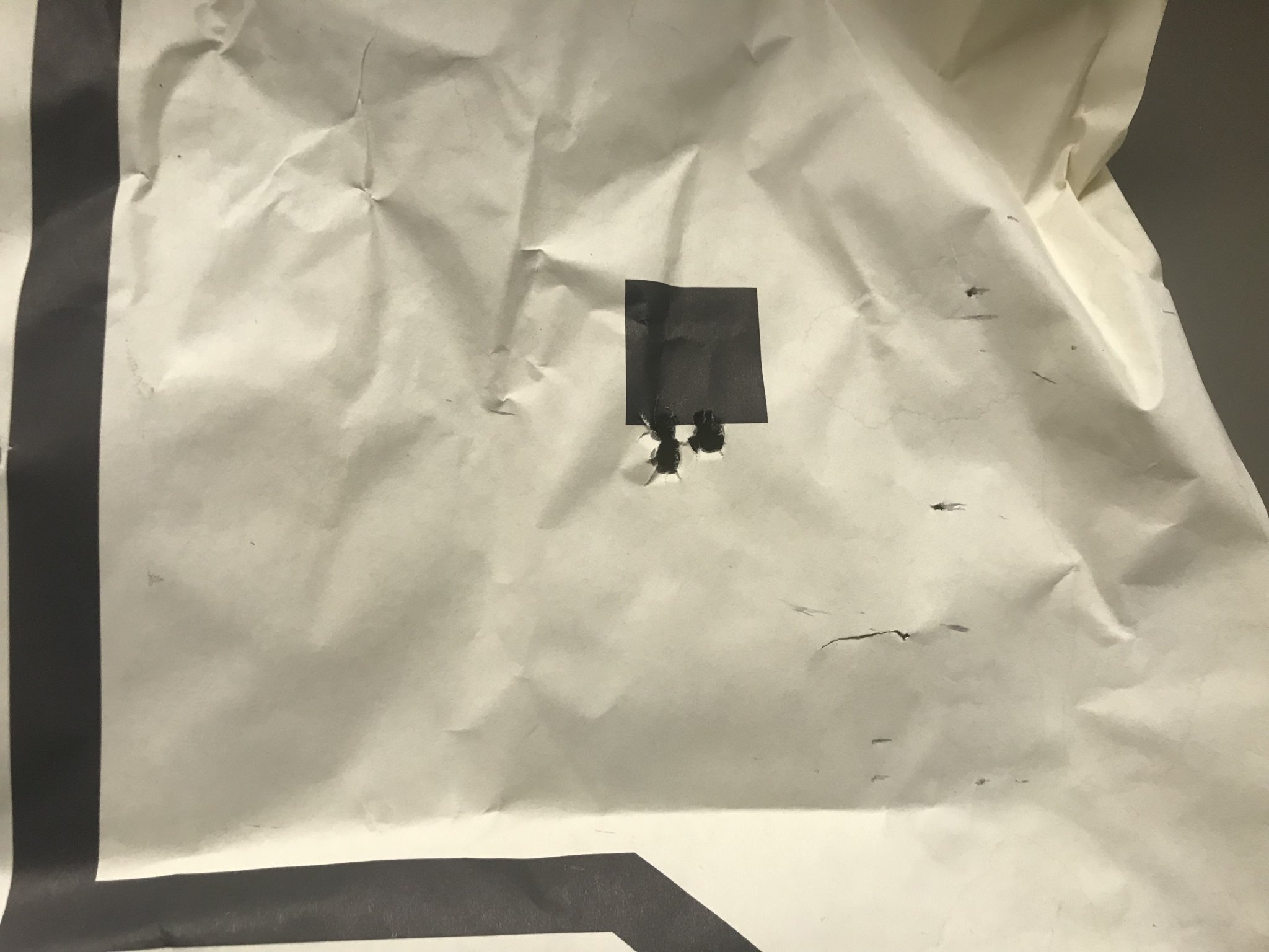

Wanted to post something after a disappointing weekend. This is at 200 yards with a scope that didn't stay in place due to crappy $40 rings. The elevation at 200 is understandably very consistent, and I suppose so was my scope drift!

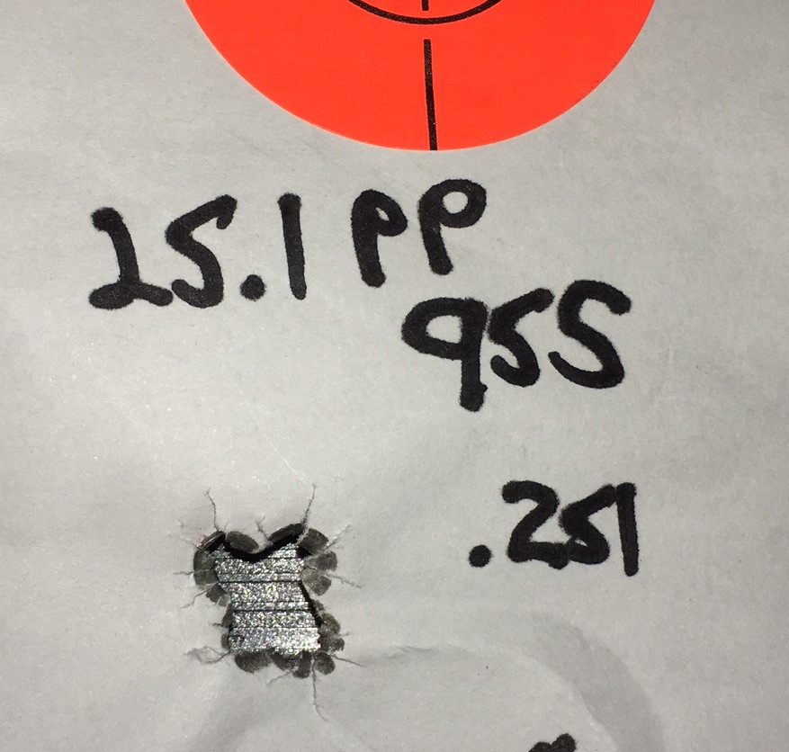

Finally got around to doing some OCW testing. 18" criterion from craddock. Using cfe 223 with 75, 80, and 88 eld-m in virgin starline brass and cci small rifle primers. I picked a pretty narrow charge weight range based on a "satterlee ladder" i did yesterday and what others have been seeing as good nodes.
75 eld-m:
I'm thinking doing my seating depth test at 27.7 with these.
80 eld-m:
Not clear to me which charge weight to go with here. Based solely on poi, i would say 26.6, but that group at 27.3 is hard to ignore. The vertical is really tight between 27.1 and 27.5, but that 27.3 jumps to the left, so I'm not sure what to do.
88 eld-m:
I'm thinking seating depth test at 25.6 or 25.7 with these. The vertical stayed pretty consistent all the way to 25.8, but 25.6 and 25.8 jumped to the left and those two charge weights have almost exactly the same average poi.
Anyway, just wanted to contribute some data and see what ya'll thought about which charge weights to go with. Looks like this barrel has some good accuracy potential. A few sub moa groups and one really good one. Anything sub moa shooting round robin with a gas gun makes me happy.

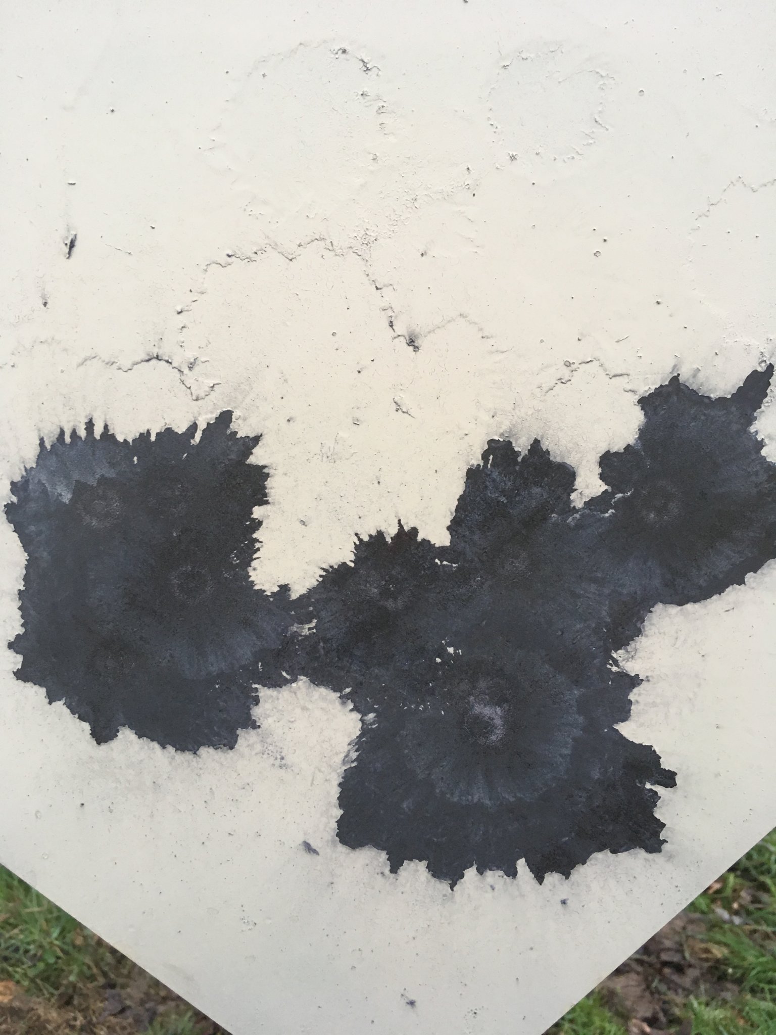

Remage bolt gun, criterion 1-6.5” twist 24” lt varmint contour, pillar bedded and detachable magazine done by me, ss12x42, 20moa seekins rail.
BIG shout out to who all helped me accomplish this!!!! Subwrx300 you were the most helpful.....thank you kindly!!!

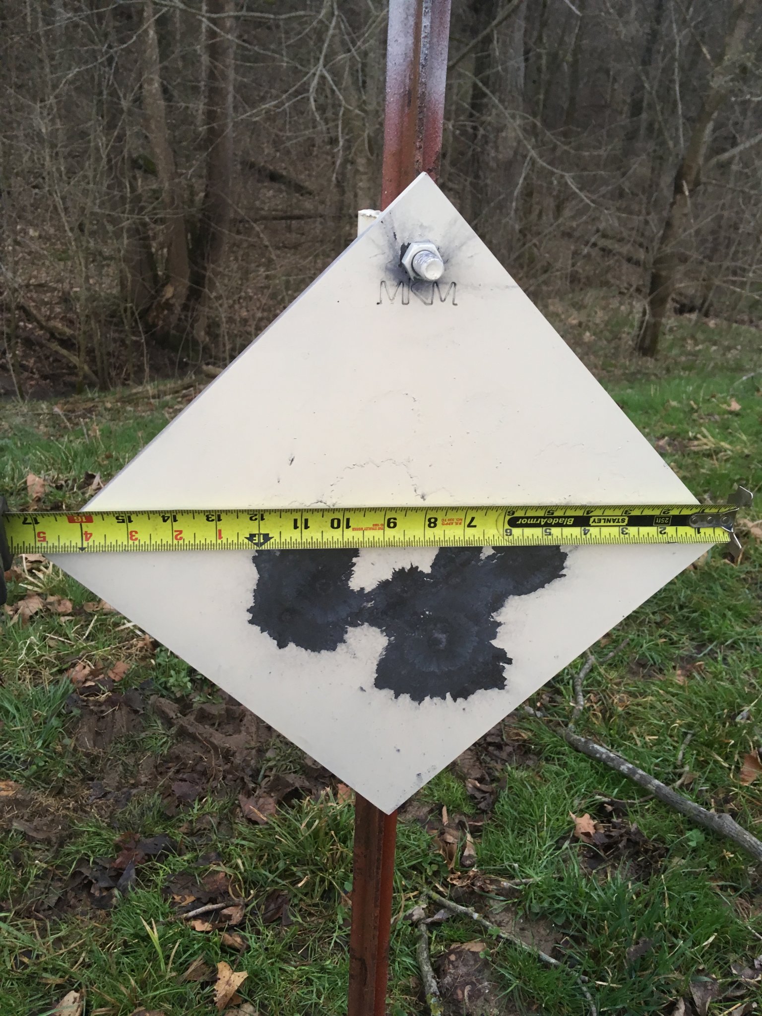

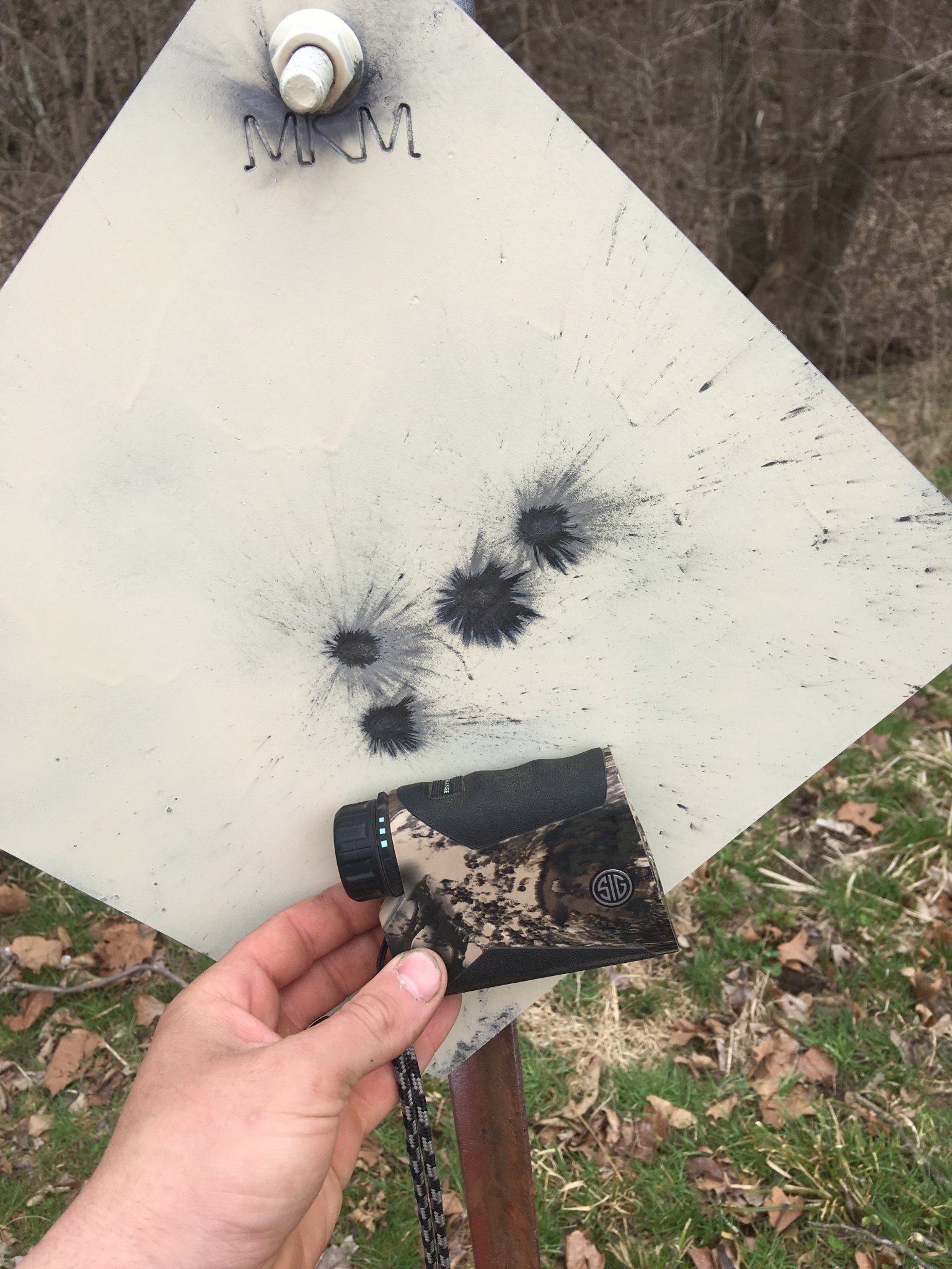

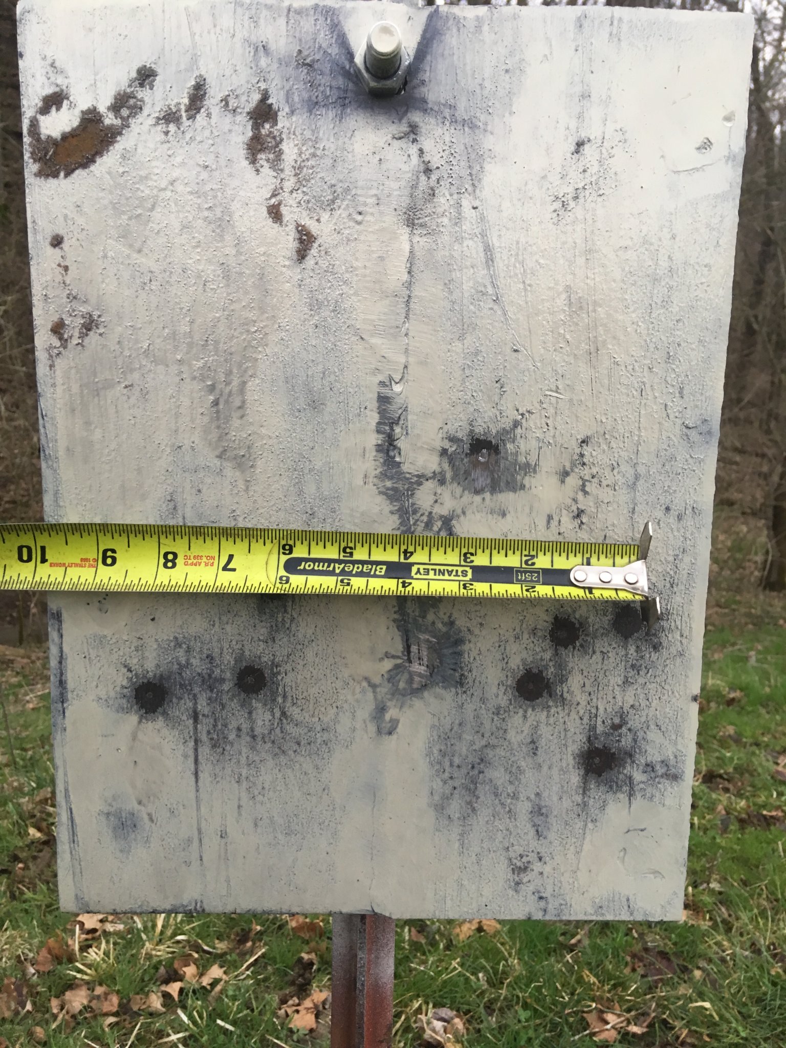

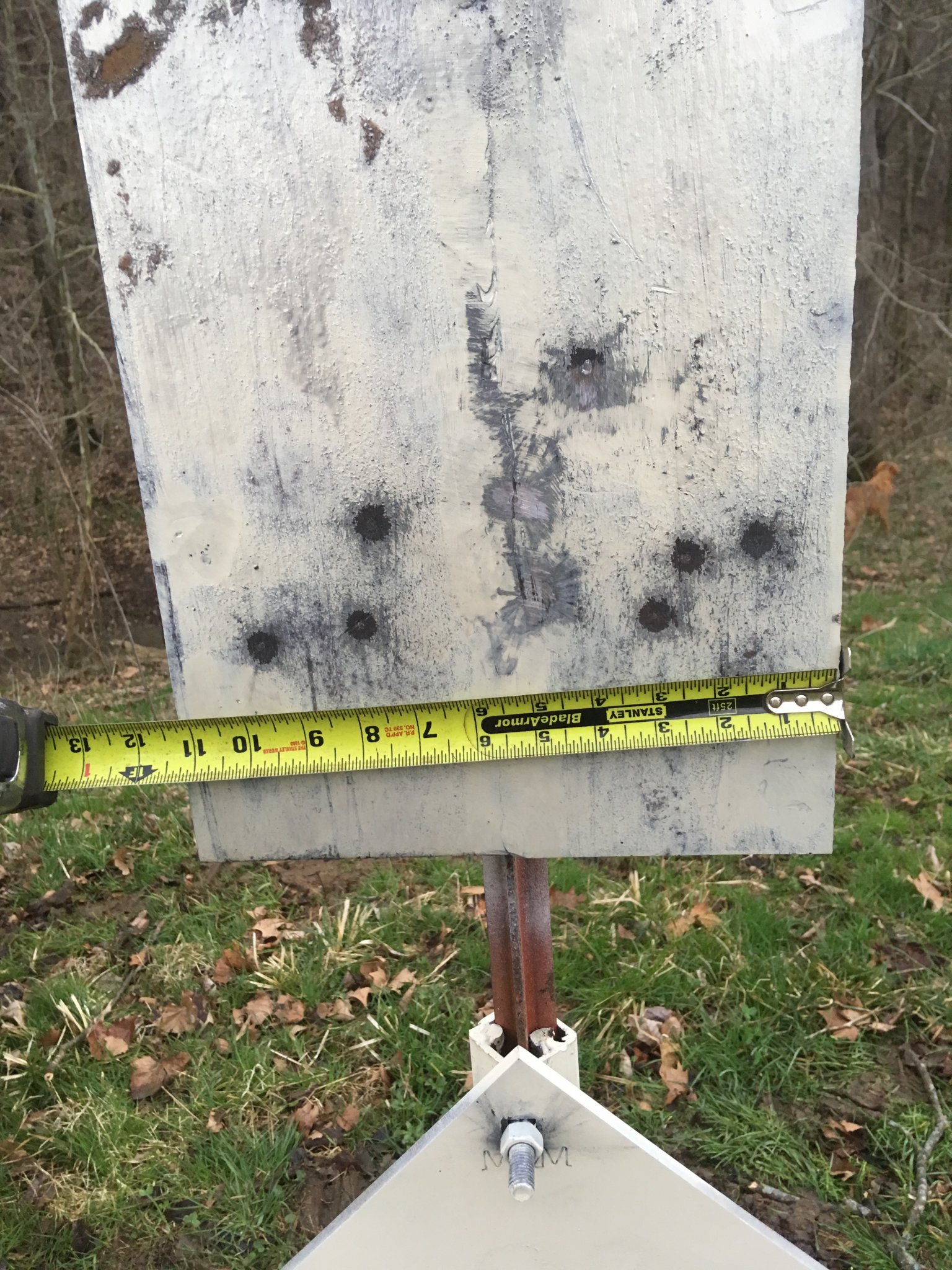

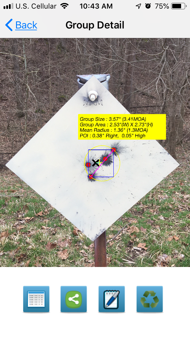

Shot 600yrds again today and I was more than happy with the results!! The diamond 12”x12” plate was 10 shots of the 1.775”bto loads and the rectangle plate was 10 shots of the 1.765”bto loads, now I will be truthful that I did have a round that something was off on this load on one round and missed by like a foot to the right(I don’t know what happen), but I did shoot 11 rounds at the rect. target and the 11th hit with the rest of the group, idk
Only thing different between the loadings was seating depth and velocities. Also 5 rounds was produced a week or so ago and the other 5 was produced last night on both seating depths/loadings. I have a 2’x2’ target now for the 1k shooting and I think with the results at 600yrds I will try the BIG 1k soon!!EB9316ED-BBA4-4601-8CB4-CCB19E7519D9.jpeg3DD64ABD-6590-4E4B-A4EB-C94F5576D901.jpegBB128A3F-E779-4E86-8EF0-46E00A236292.jpegC89EDC7F-ED94-4C3B-B813-5DE8683CD414.jpegE2DB527A-70FE-4051-A6D9-30C2B3DB540D.jpeg31362140-CC37-404A-882F-9EF249D5CD9A.jpegCB27A4AF-D43F-49B1-A08C-D5F74FDDB32F.jpeg5EC90B42-14A4-4942-B9BF-CC5E2B0B20C5.jpeg

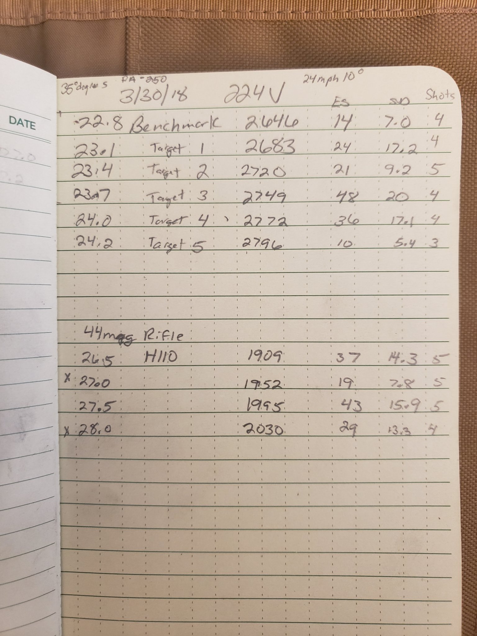

Ran benchmark with CCI450. Here is the data for those wanting to try it
22” craddock Bartlin barrel. AR15. 88g Hornady.
Hope this helps

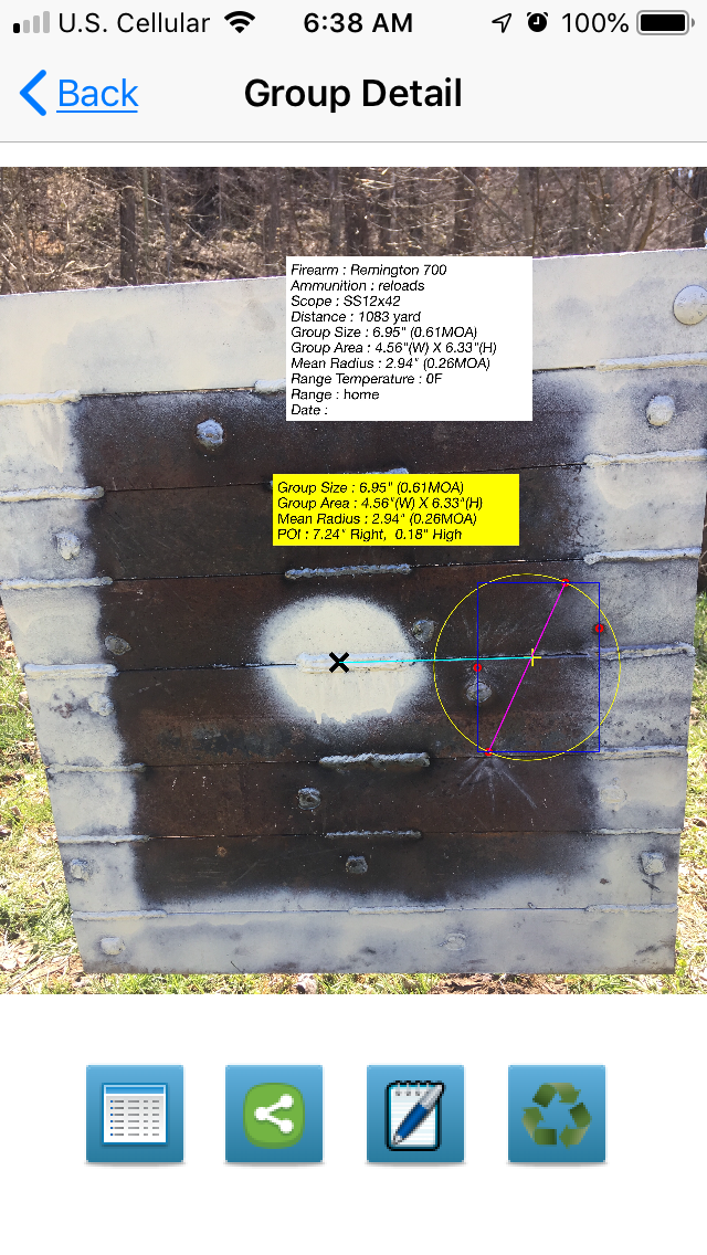

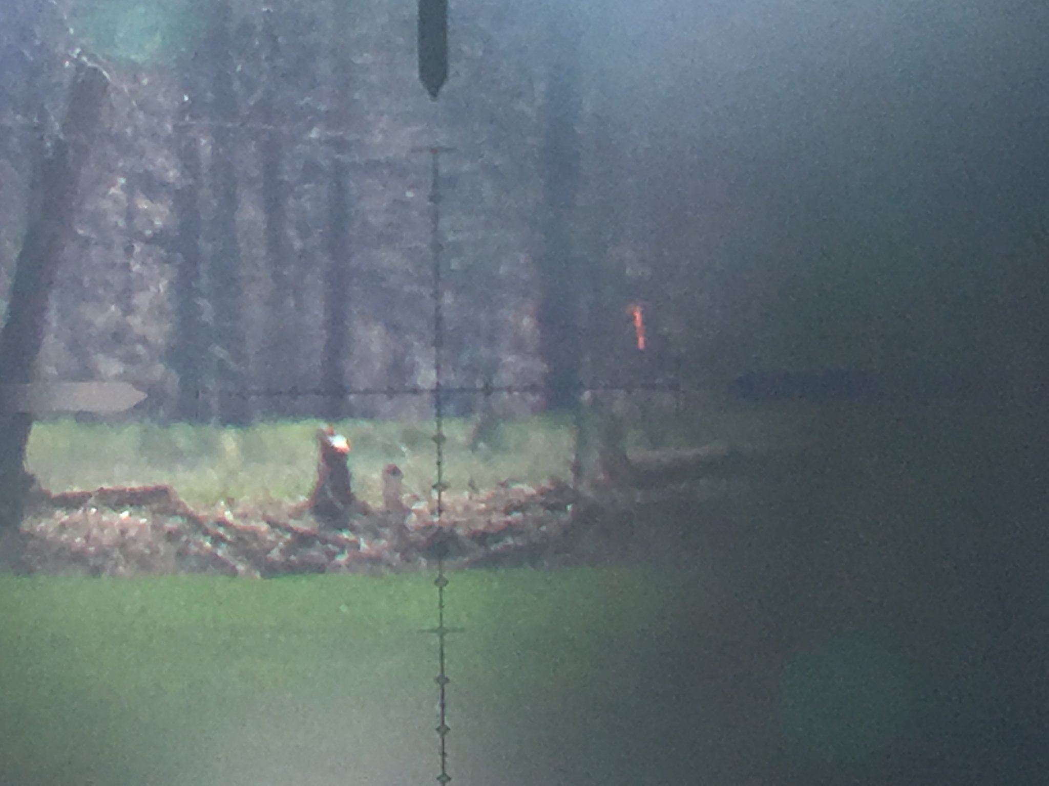

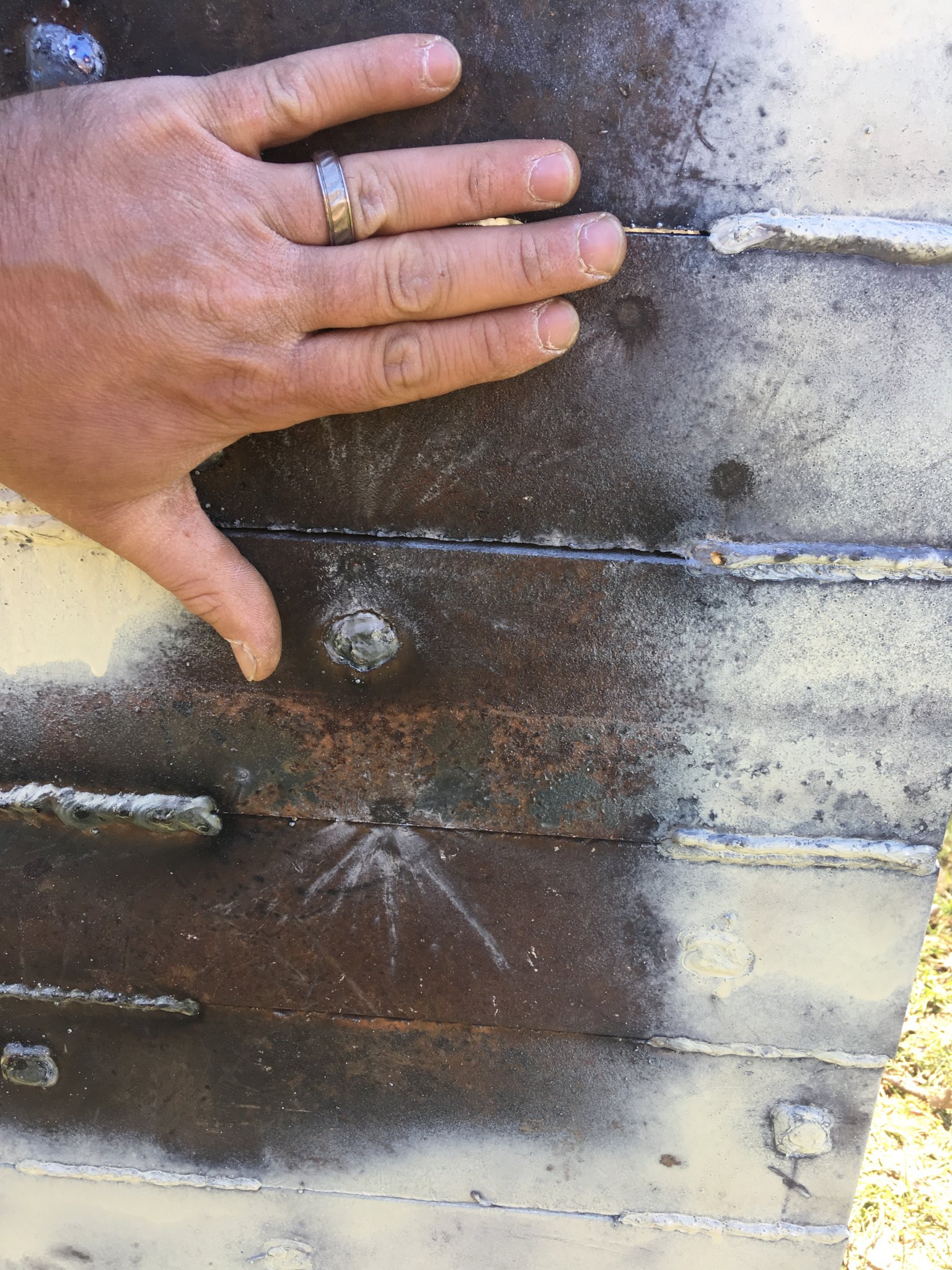

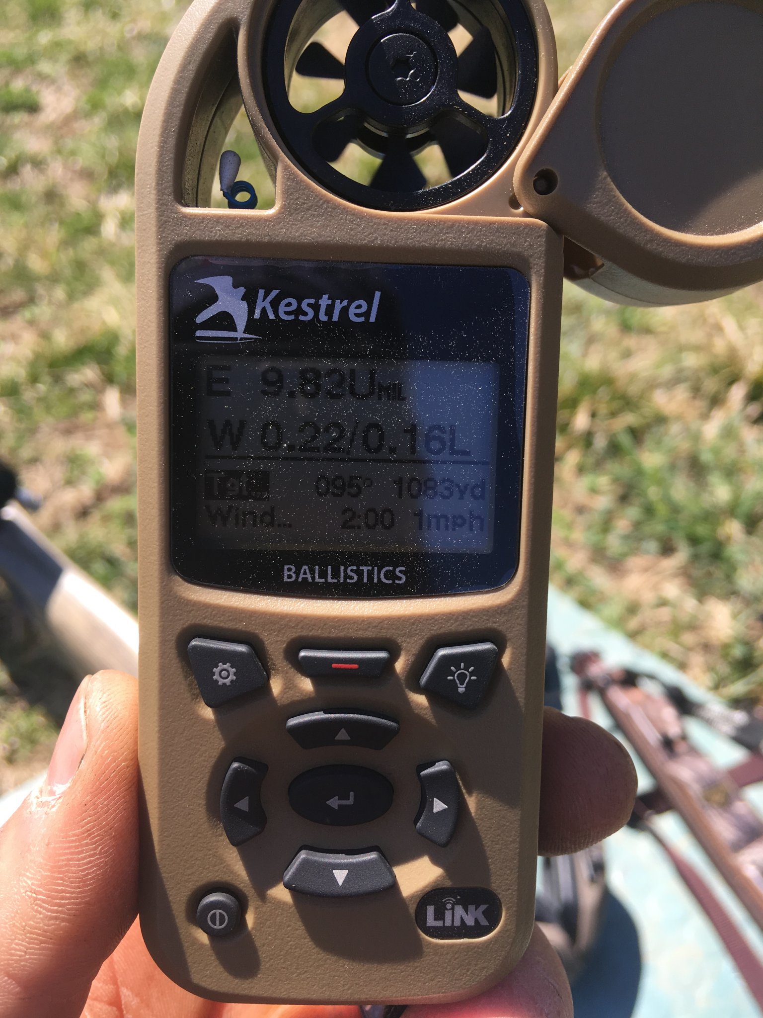

Okie dokie, took the Valkyrie out to 1083yrds TODAY!!! Freaking awesome experience, fun, and easier than I thought with this cartridge!! It’s been a live long dream to make hits on what I’m aiming at at that kind of range and I did it today!!!!
I had my three loadings that I’ve been testing for my gun and it simply likes the 80eldms either at the lands(1.775) or .010” off(1.765), and I had some that is set for .035” off(1.740).
I first tested the 1.775bto and got 4 out of 5 on a 24”x24” plate! Then I tried the other loadings which I should’ve went to look after the second volley but I didn’t. I went to look after 10 shots in a row, 5 being .010” off and 5 being .035” off......ended up getting 10 hits out of 15 at 1083yrds FOR THE FIRST TIME!!!!C2A4EF80-0D19-4E5B-852E-67FE92FB9A90.jpegF0BDFC58-7CAC-4CDF-8551-78A7295274F4.jpeg2CB62B8B-9785-45A6-8746-34D635EDB9E3.jpeg2CB62B8B-9785-45A6-8746-34D635EDB9E3.jpegA3304801-ED58-449C-929D-F0E69ABCB0C0.jpegCB75F852-060A-41E9-8801-159F43CAC893.jpegE0E0C20D-22AF-4B1A-85B2-AC79F840EB7D.jpegDE9B97B8-9C10-448C-8F85-057E9CAA3D5E.png5198A733-15BE-4AE2-A3E9-6BB9B8894050.jpeg
GREAT JOB IHFarmer07!!!! Super excited for you. I hope/dream of those ranges too ;). Some day for me as well.... You're an inspiration ;). And RE: the 80 ELD-M's being the best. They are great bullets!!! And each barrel will have it's favorite. We might hope the heavies are the best, the 80 ELD-M's are no slouch and can go quite a distance from what I hear.
Reactions: IHFarmer07
Thanks!!!! You will get there, it takes time, work, a lot of trial and error with loads, and shooting! That means a lot!!!
I probably have 900-1000rds down the barrel now, including factory ammo. What was eye opening/greatest feeling that I could go farther out was when I shot at 600.....that shocked me! I’ve shot my deer rifles with factory ammo at 400-450 on a 16”x24” steel and never could get close to the accuracy of this thing, maybe 1-2 hits in 4-5shots. Having a weather meter I think really really helps though in the equation and don’t clean that barrel until accuracy goes to crap!!
If I can do it so can you!!!! Thank you and again thank you to all that helped me accomplish my goal! There’s some great ppl here and on FB willing to help with this cartridge!

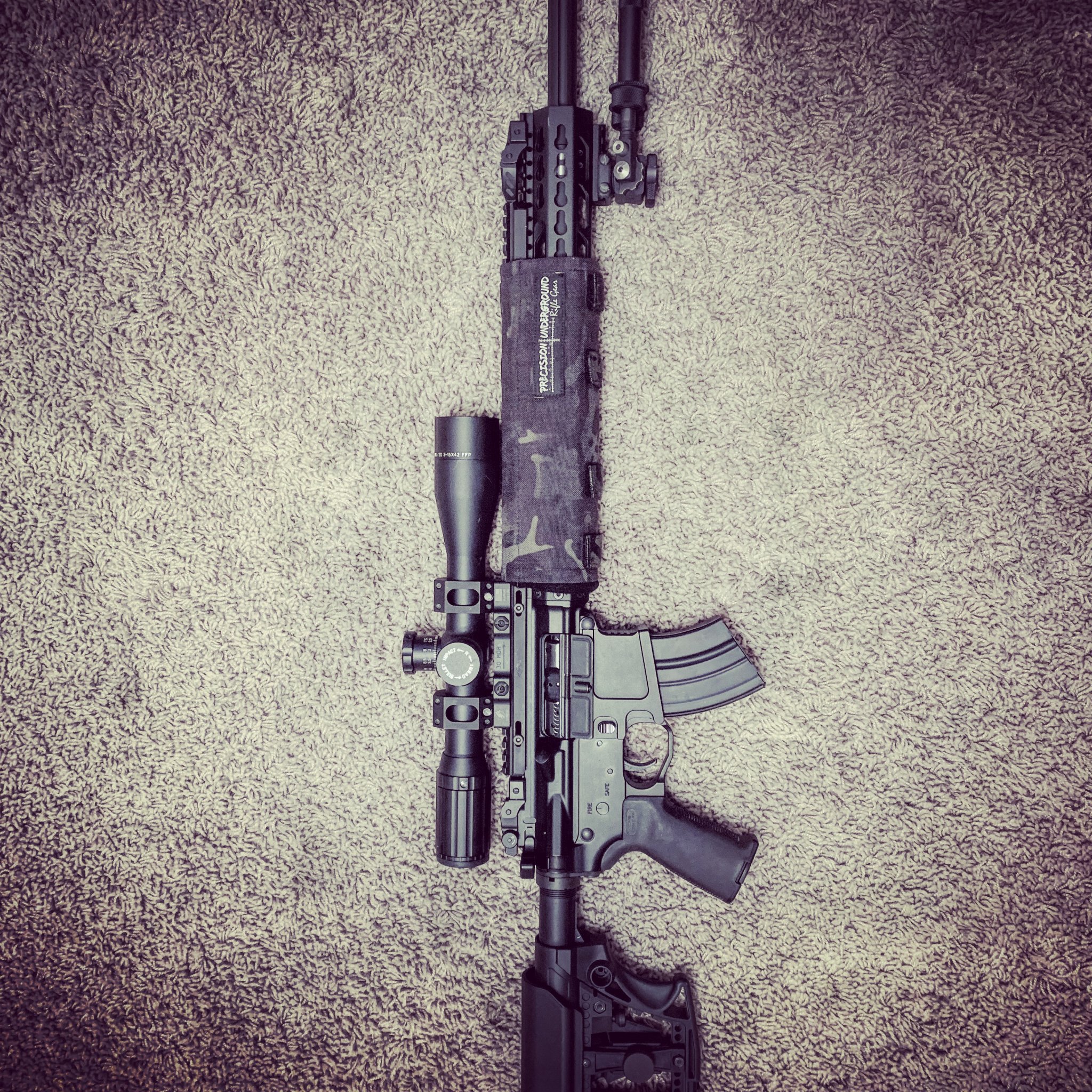

Finally getting some time on the Valkyrie and it looks good so far. It has been a bit picky with loads but I am close now. Super impressed with the speed. The 88s are going faster than I had hoped for.
Mega MKM
X-Caliber 20”
Starline
28.4gr H414(hot and compressed be careful and work up)
ELD 88@ 2740 into .45”-.75” from initial testing.
Need to go back and tweak the load now that all of the brass is once fired but I’m glad I will have a couple more thousandths of space to seat the bullets lol. That’s how compressed it is.

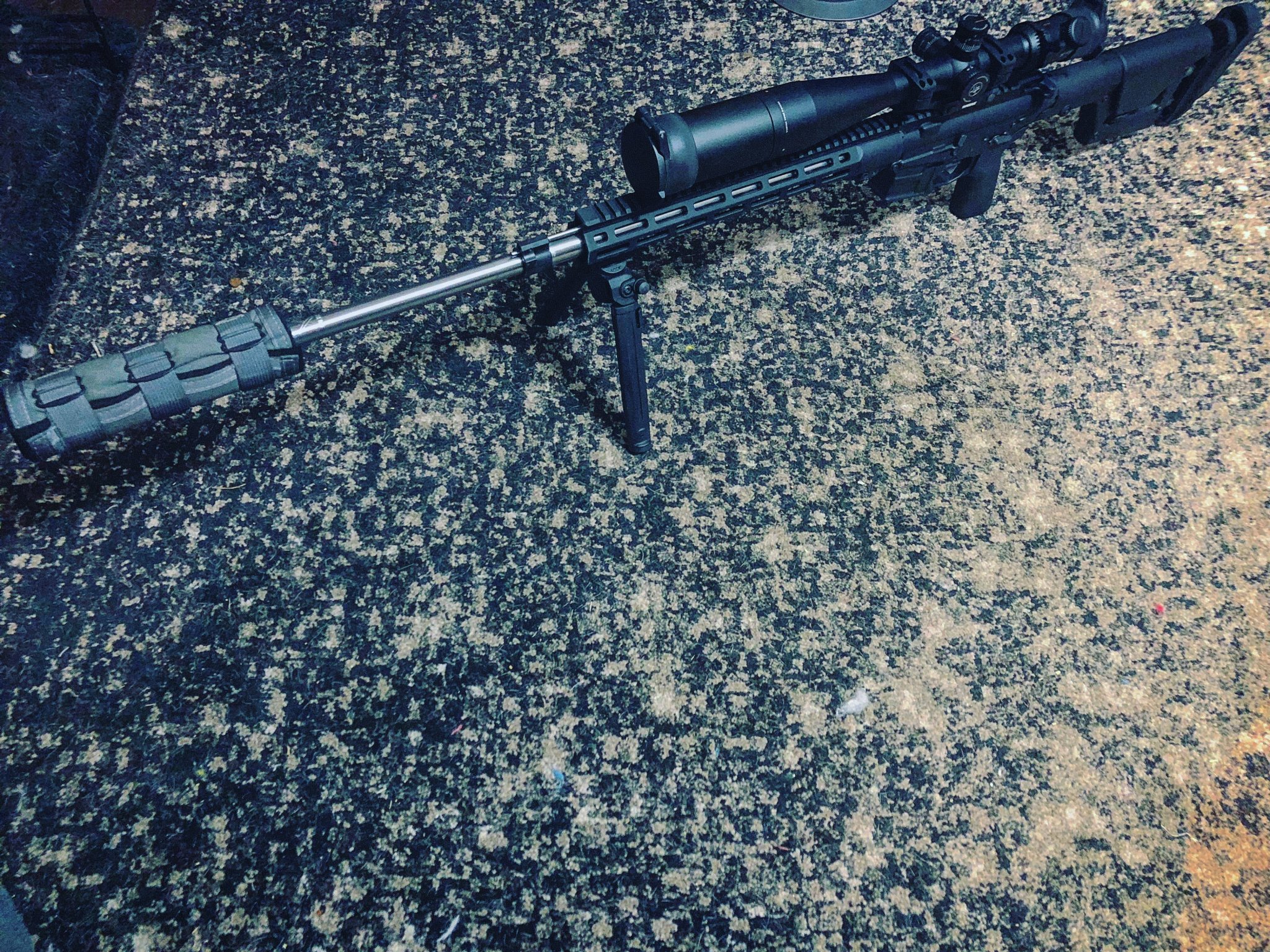

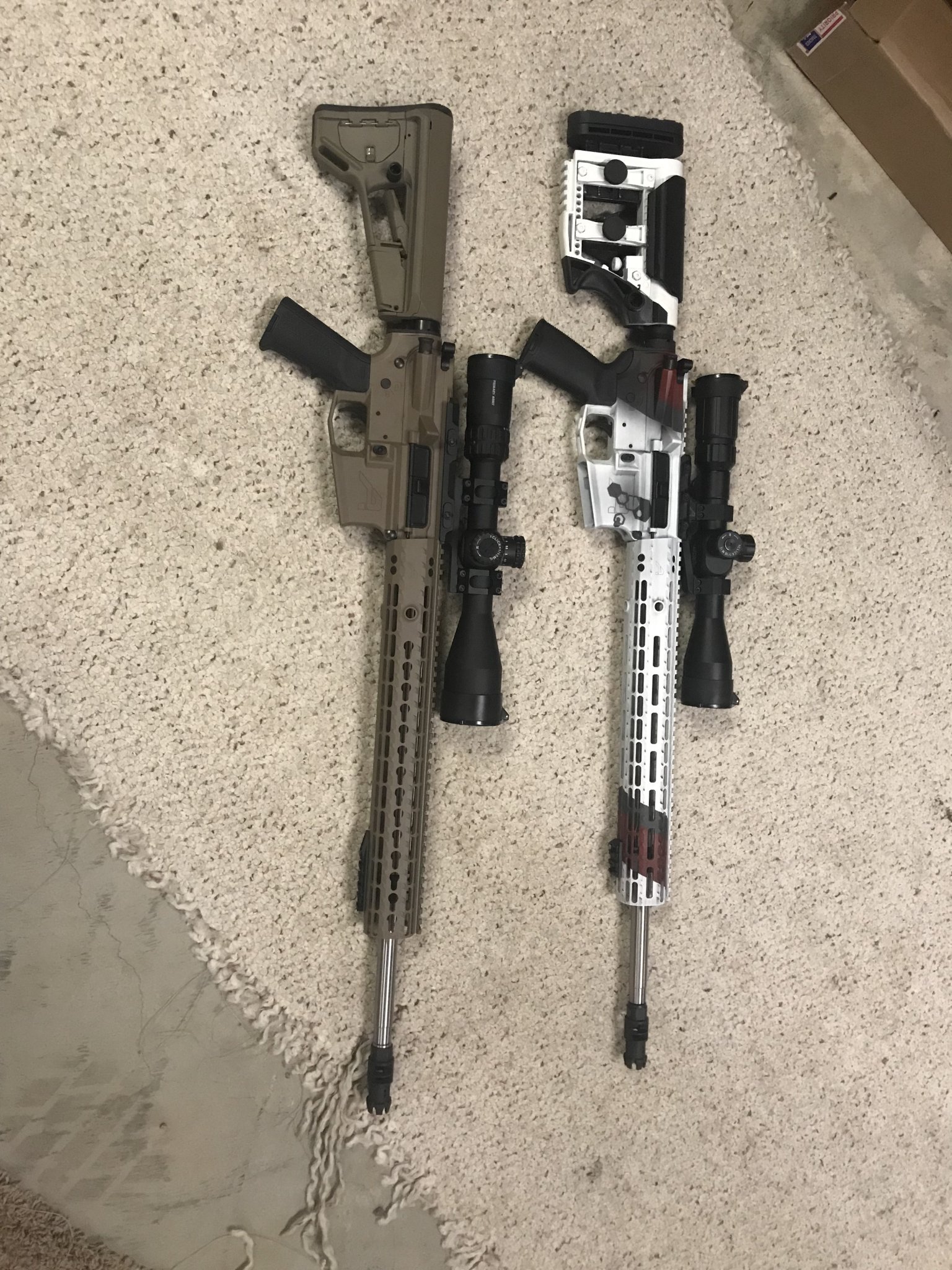

So.... I bought a new PSA 6.5 twist 20" barrel/bcg combo. I've been happy with my 1/7 PSA barrels, but have been chasing accuracy with 88gr eld-m's and tbh I just wanted to play with new stuff. I'm a sucker for a sale too, it was $149.99 shipped with barrel/nitride bcg.
Built new upper with Aero enhance upper/15" keymod handguard FDE
Glass=Primary Arms 3-18 ACSSS Apollo 6.5CR/.224V reticle

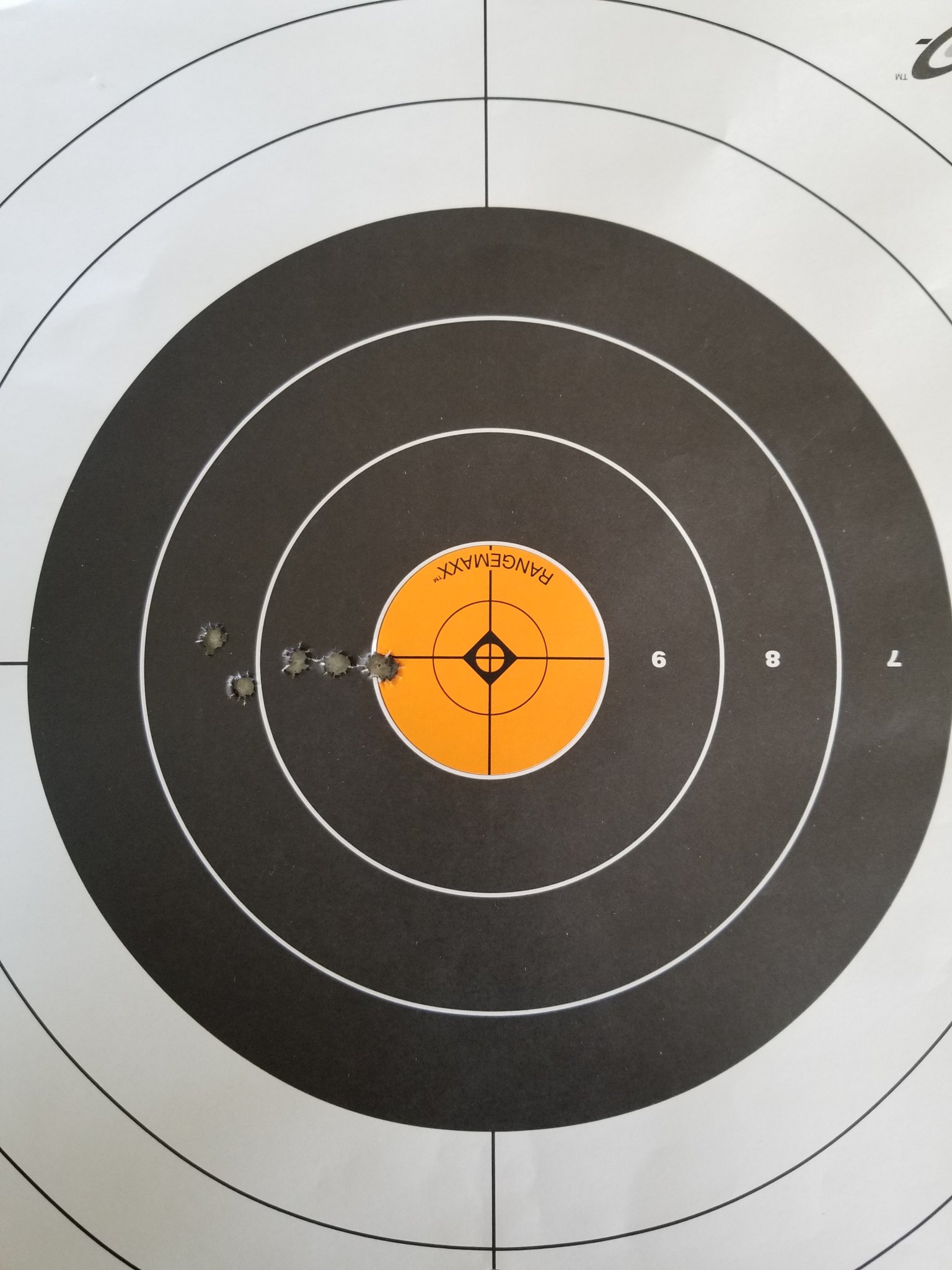

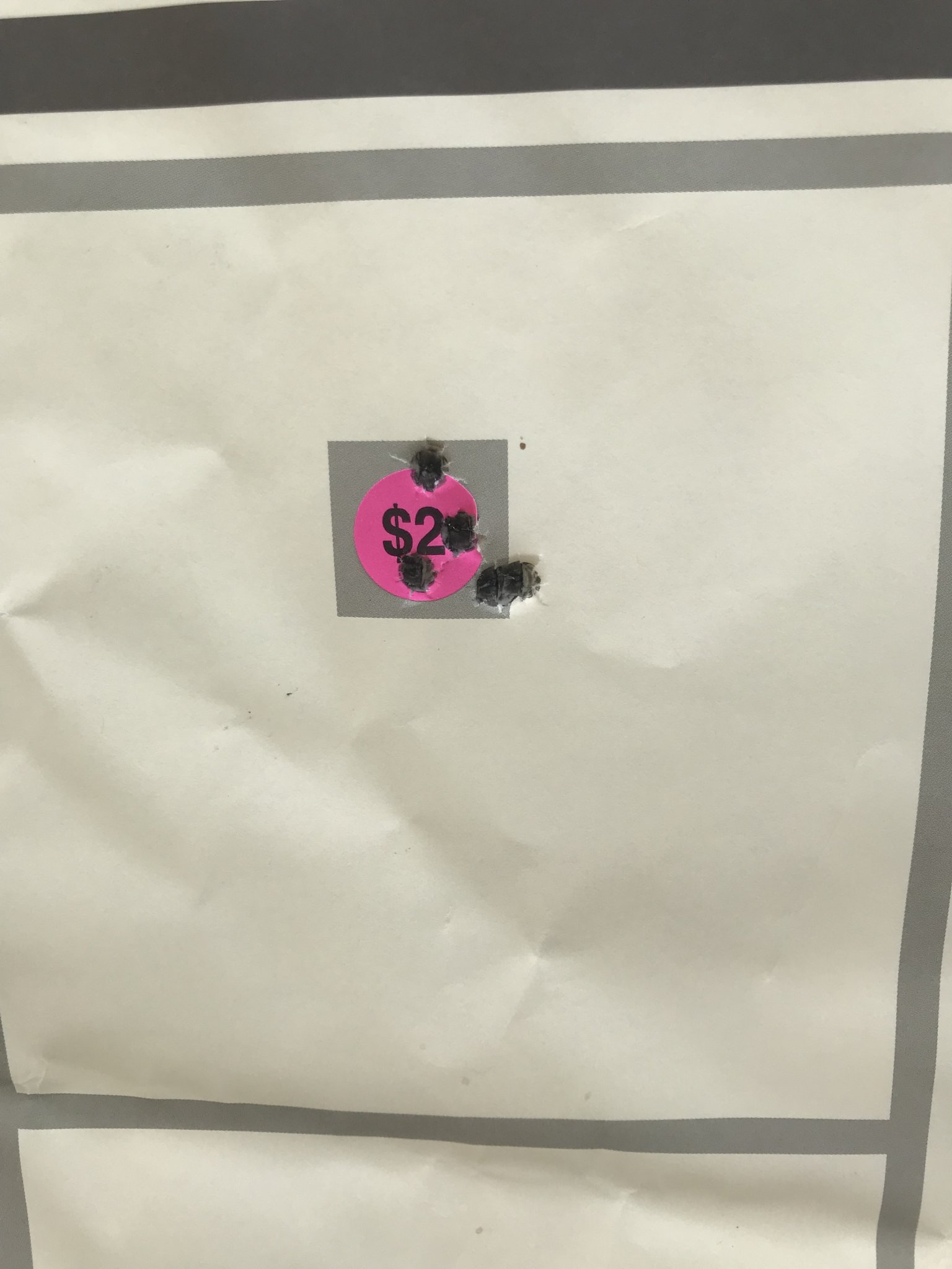

Finally got my Valkyrie put together. I'm a Lefty and I ordered a PTG stainless trued action, Calvin Elite trigger and a Criterion 24 inch light varmint barrel. Took about 15 minutes to do the barrel install.
First time to the range with it and had two pretty descent groups on the first pass. Range was 100 yards.
First group is 95 grn Sierra HPBTM
Second group is 88 ELD-M
Third group is 90 Berger VLD
Fourth is 80 grn Sierra HPBTM
Haven't played with seating depth at all-yet. Very happy with the first time out results!
