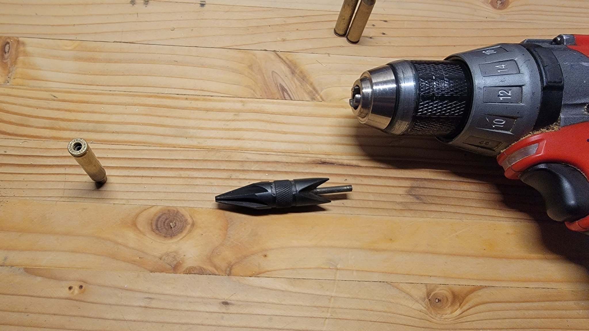

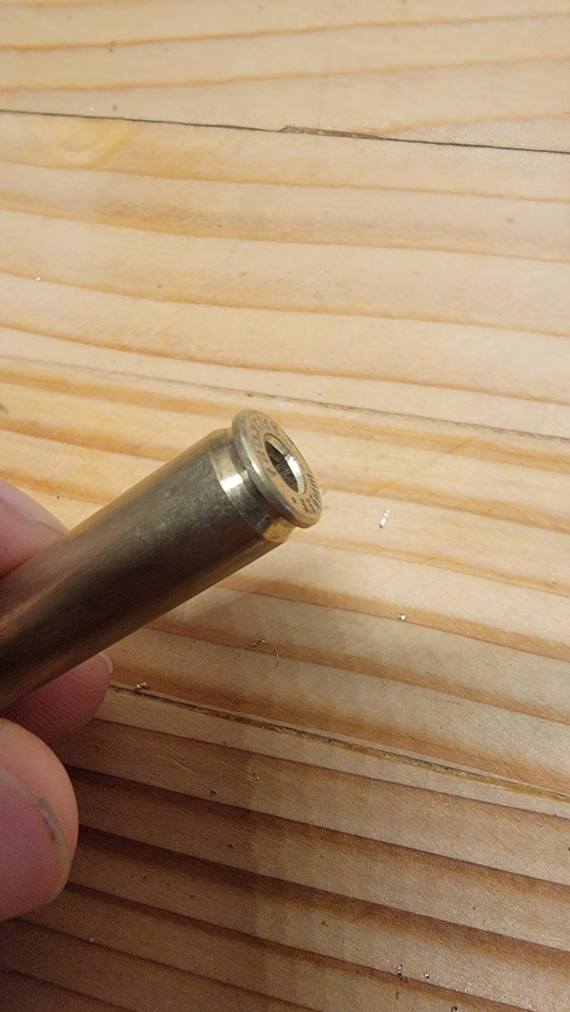

Also I have a huge box of once fired Hornady brass that has crimped primer pockets. Any of you guys have a good solution for dealing with this. I’ve tried the RCBS tool for my Rock Chucker and found that it takes a lot of force and then the nipple gets stuck into the pocket and I have to slam the handle to back it out. I’d like to utilize this pile of brass if there was a solution that was more cost effective than just buying new brass.
Reactions: Jackomason
I've got a cabelas chamfera/deburring tool that I use on my 5.56 brass. Works fine chucked up in a drill.
Reactions: binazone
You use this to take the crimp out of primer pockets?
Yup. I don't hit it hard. And its for plinking so I'm not too worried. I can't see how it'd hurt "match" ammo.
This one was hit on the heavy side.
The poors will always find a way!
Worked like a charm bud! 🍻 I’ll have to drop back a bit on my charge and work back up. Not sure the difference in case capacity for Hornady vs. Federal….but you just got me another several hundred pieces of once fired brass!
Reactions: lash
Just use an actual crimp remover in a drill. Using a chamfering tool…yikes lol

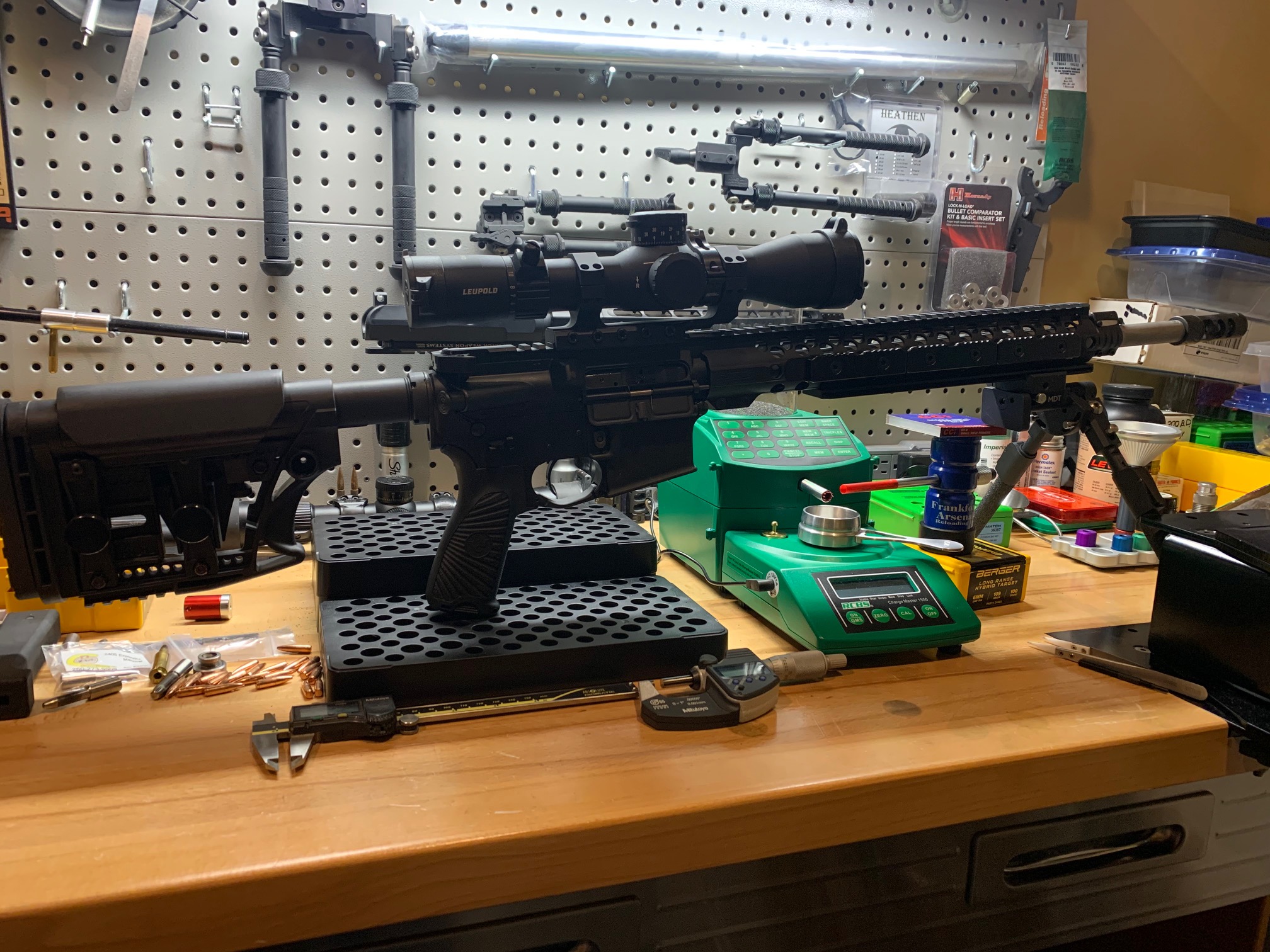

Had a great day at the range today. 55 degrees & Sunny. There were only 3 other guys there & all shooting 308 bolt guns. None of them reload (y) . So I came home with a pile of once fired Black Hills match brass & My 6 ARC bushings delivered while at the range.
The Valkyrie also put a smile on my face today.
I posted some results in another thread from my first outing with Valkyrie & 6.5 Staball loads. Reubenski shit on my parade by showing equal results from his 223. He was getting 2800 with 75HPBT from a 20" 223. My 224 V speed was about 2770 with 77SMK & results with 85.5 Berger's sucked.
For round 2 I stepped on the gas with the Staball & got 77 SMK to 2850 & grouping well. 85.5's to 2800 hanging out the front of the windowed mag. The Berger's still did no better than 1.2" & pressure was showing at those speeds. Threw it in the safe & built a 6 ARC. Back ordered bushings had ARC on hold, so I loaded round 3 for the Valkyrie shot today.
After today I'm no longer doubting the value of this round.
Gun specs.
BCM thermal fit upper (lapped + Accushim), Anderson lower
Craddock 18" RL + 1" gas, medium profile .750 GB, 7T
Centurion M-lock 13.5 rail + Nelson 10" Arca rail.
SLR adj GB, Heathen 3p brake
Sharps XPB low mass carrier, LWRC hp bolt.
Trigger Tech adaptable set to 2.5 + Trigger tech ambi 45 degree safety

Gun specs.
Geissele Super charging handle
Wilson/BCM mod 3 grip
VLTOR A5 spring, std A5 buffer, & tube
LuthAR stock
MK 5 HD 3.6-18 TMR scope with Leupold mount and MK machine level

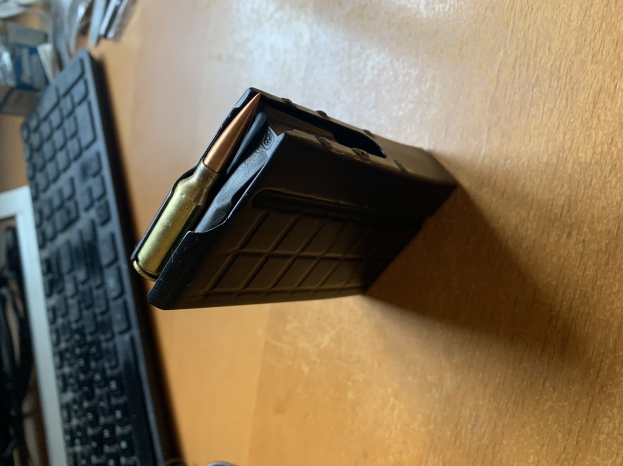

I tweaked a windowed mag that gets me 2.340 without grooving lower & extension.

Yep I did the same thing with all my Valkyrie mags and even my 6 ARC mags as well. I only run 10 rounders in these calibers anyway. Yes the 85.5lr Berger’s liked a 0.035” jump as well in my rifle which had them around 2.325-2.33”. I have one of the longer freebore barrels though and a sammi spec throat would have most of the bullets being able to run mag length and be close enough to the lands to be accurate.
