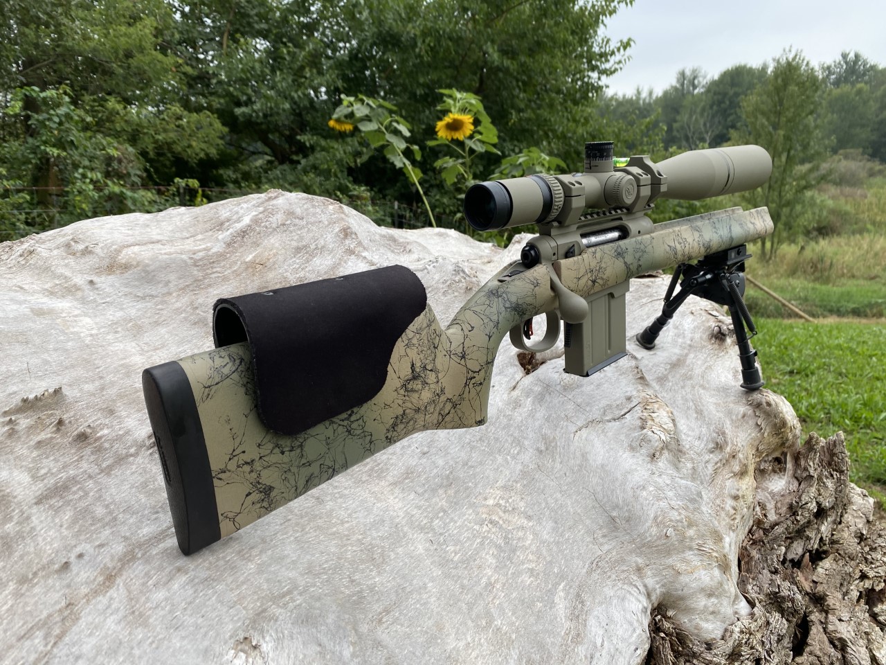

Got a 22BR barrel due to arrive at the end of the month and due to powder shortages I'm looking to run LEVERevolution in this rig. I expect good velocity with 80gr ELD's provided I watch my pressure in the heat (not too hot here in Michigan) however I'm unsure of where to start with this combination. I'm thinking 27-28gr seems like a reasonable starting load but what do you guys think? Anyone got quickload?
Here's a pic of the rig as she currently sits in the safe...
