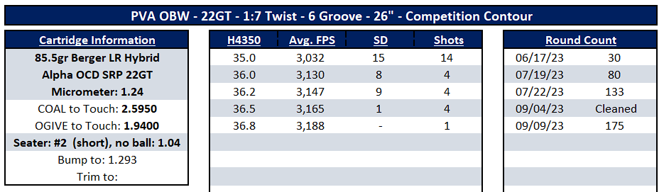

After having had my 22GT replaced due to the ARC CDG clearance issue, I finally found time to do some load development. Up to this point, I have been shooting 35.0gr H4350 w/ 85.5s with a total of 133 rounds on the barrel. The load was pretty inconsistent but fairly precise and accurate. Decided to move to a higher charge, ultimately higher fill %, albeit higher than I ever intended to go with this cartridge.
All I have to say is that I found money at and above 36.0. Low sample size but the barrel has been consistent at 35.0, I am confident these 36s will be consistent too. I shot two four-shot groups for each charge and the results repeated.

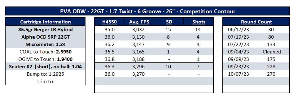

Follow up to my previous 22GT post. My barrel continues to speed up after having settled on 36.4. Now at 270 round count, I am back at the drawing board because I am running at 3,300 lol...
How often are you cleaning? I notice mine speeds up about 45-50 FPS by time I get around 80-90 down the tube. I'm at 280 rounds on my PVA OBW. However I'm using RL23, not H4350. Clean is about 3000 and dirty is about 3050.

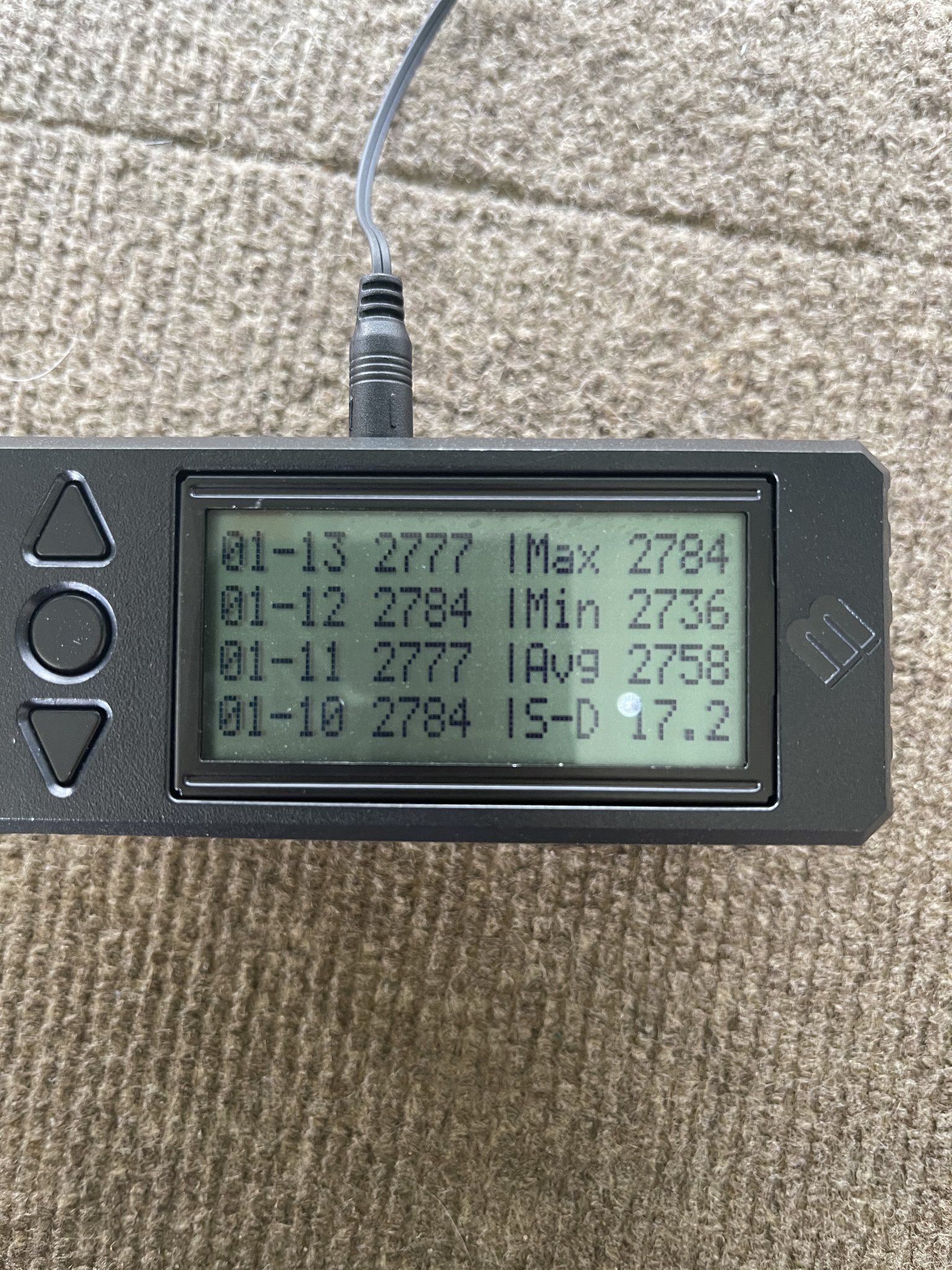

Just cleaned my brand new barrel 24" 1:8 with .169 freebore.
Going to fireform and break this in with 25rds in the morning starting with new Alpha brass, 32gr of H4350, and Berger 85.5 LRHT.
Just back from the range, all cleaned up.
Ran 25 rds of 32gr H4350 with an average fps so far with new Alpha brass of 2758.
Next batch will be at 33gr to continue break in.
Shoots pretty good so far, but can't wait to start load development soon.
Was able to average 2960 with 34gr of H4350 with Berger 85.5's.
Next step now that the barrel sped up and was holding speed, I'm going to try the 90gr A-Tips, and 95gr SMK's at all 35gr to start.
