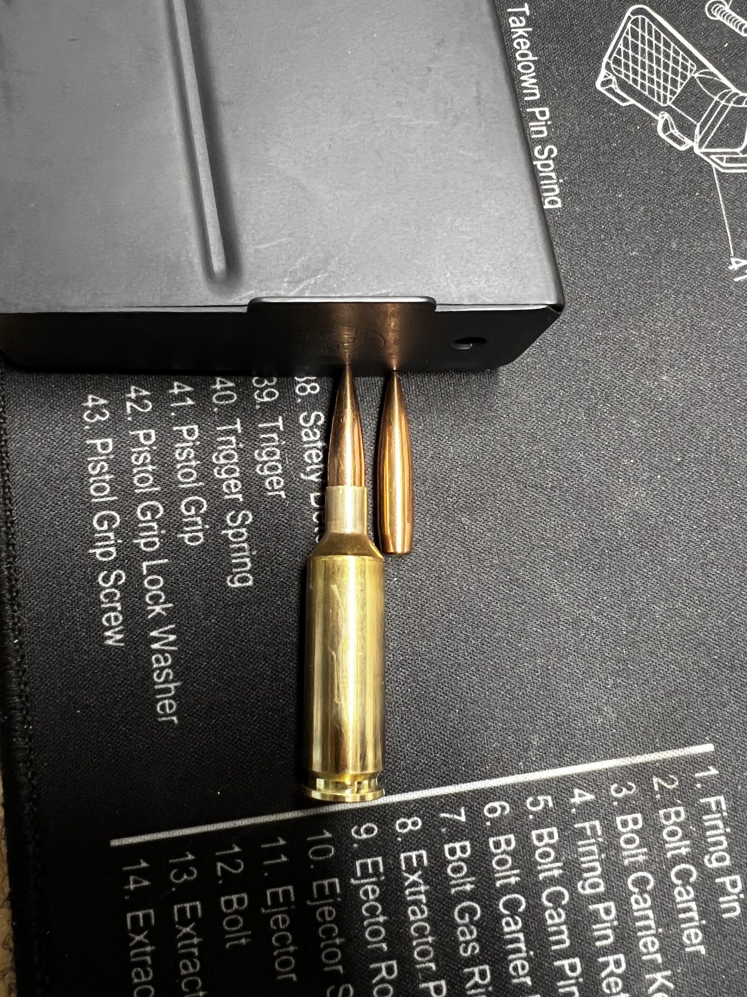

.247 bushing in a wilson full length sizing die with alpha brass. SAC universal seating die. I’ve also seen 85.5 hybrids like a big jump .040-.080
FWIW, .060 - .080” jump with the 85.5s is really deep in the case with a .169fb.
I found .020-.025” gave the best spreads and least horizontal dispersion. Right in the 1.99x” range base to ogive which is consistent with what others have seen.

I'm not sure what your definition of really deep in the case is. But here's the math.
From the base of the 22GT to the neck shoulder juncture is 1.43". To the end of the chamber is 1.73". So the neck of the chamber is .3" long. The transition is usually about .015, and using a standard .120" GT freebore that gives you .435" to seat the bullet and jump it.
The bearing surface is .361 on the 85.5gr Hybrid. So if you were to perfectly line up the bearing surface boat tail juncture of the bullet to the neck shoulder juncture of the case (which still isn't perfectly accurate as the case juncture has a bit of radius) you would be jumping approximately .075". I say approximately because the ogive will actually contact the lands a little sooner than that.
But even with a .120" freebore, you can still jump .060" with nothing but the .166" boattail section of the bullet in the case. And if you have to go a little deeper that doesn't mean anything. I've shot that bullet and the 88gr ELDM in a .050" freebore 22BR and 22 Dasher. They were lasers. There are reasons to seat the bullet out in to the neck and get it out of the case, but every load doesnt have to be that way. Seating the bullet out is optional. Most often not even necessary.
