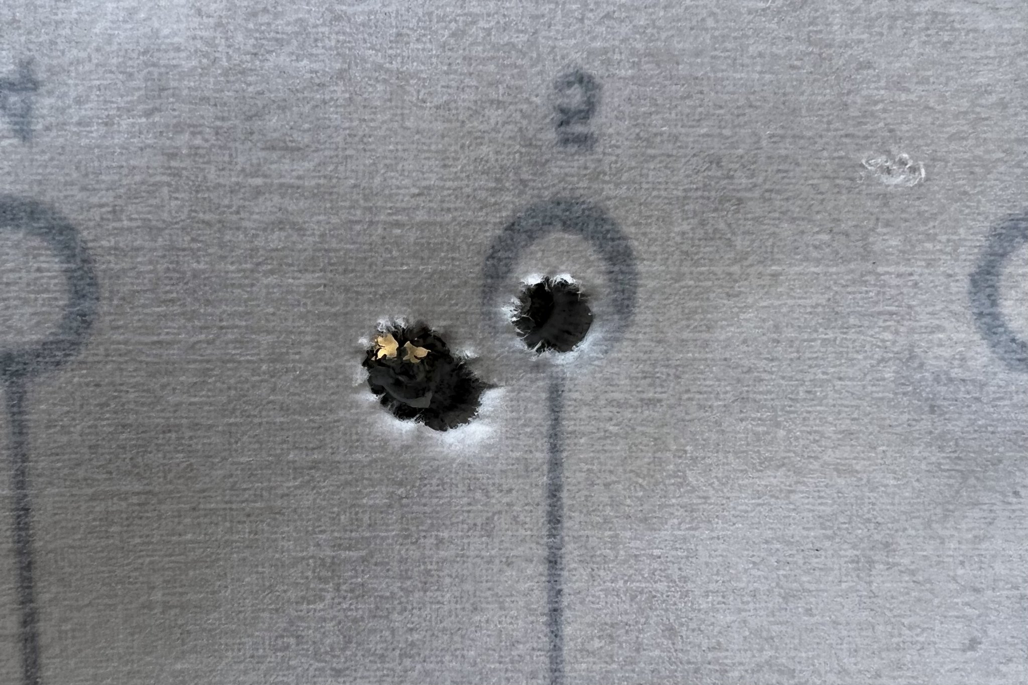

Got out today to shoot 2 OCW's both at 200yd.. Not the accuracy results I was hoping for but Ill try a seating depth test next with the 95 SMK....
95 SMK / H4831sc OCW
No pressure through any of the charges. Really good, consistent single digit SD's and a nice wide consistent POI from 37.4 - 38.00... Consistently right at 0.5moa so nothing horrible.. At least it was consistent other than that 1 group at 38.3..... Ill play with seating depth to see if I can tighten up 37.7...
85.5 LRHT / H4350 OCW
No pressure with any of these charges either. Anything closer to the lands and you werent getting much of the bearing surface in the neck. I generally like to keep bullet diameter worth of bearing surface in the neck (.224).... But when I loaded up .01 off there was probably only half the neck engaging the bullet bearing surface so I seated deeper to 0.03... Either way, didnt like this combo as SD's werent great other than 1 charge weight.... Probably done with H4350, ill play with some other powders.

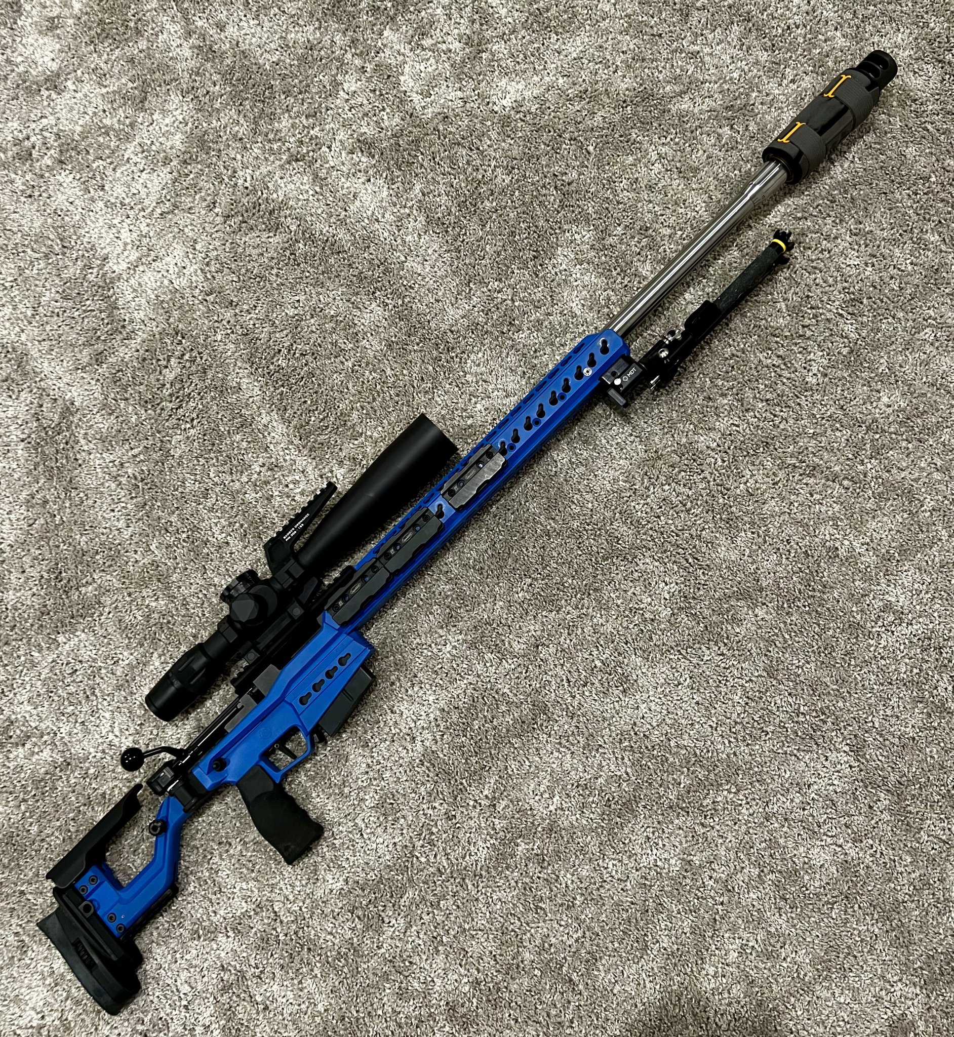

I'm building a 22GT prs match rifle.
Proof 26 inch competition contour.
Cci 450 primer.
88g eldm
H4350 powder.
What powder charge should I start and end at?
Cci 450 primer.
88g eldm
H4350 powder.
I'd start around 35gr, you'll likely end around 36-36.4 at 3120fps. The 88s shot very well there in my rifle.

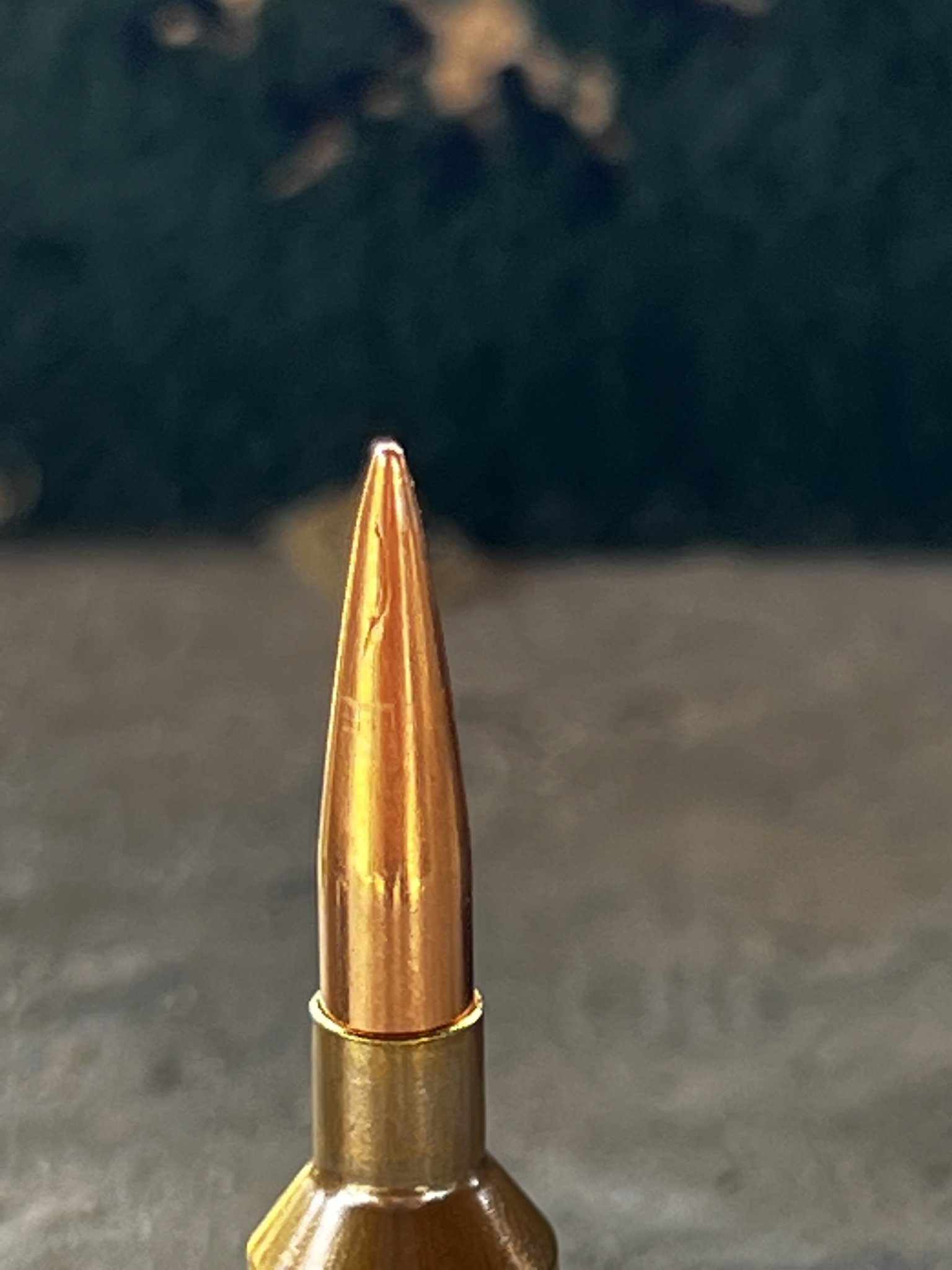

Went shooting Saturday, when loading my magazine, I noticed this bullet had a fucked up jacket. Could very easily feel it with a fingernail. Figured I'd shoot it anyways to see what happened. Ended up landing about a full inch away from the other 4 shots. Check them Sierra's. Never know what may show up.
Now I'm gonna have to check my 95's more closely. Haha
