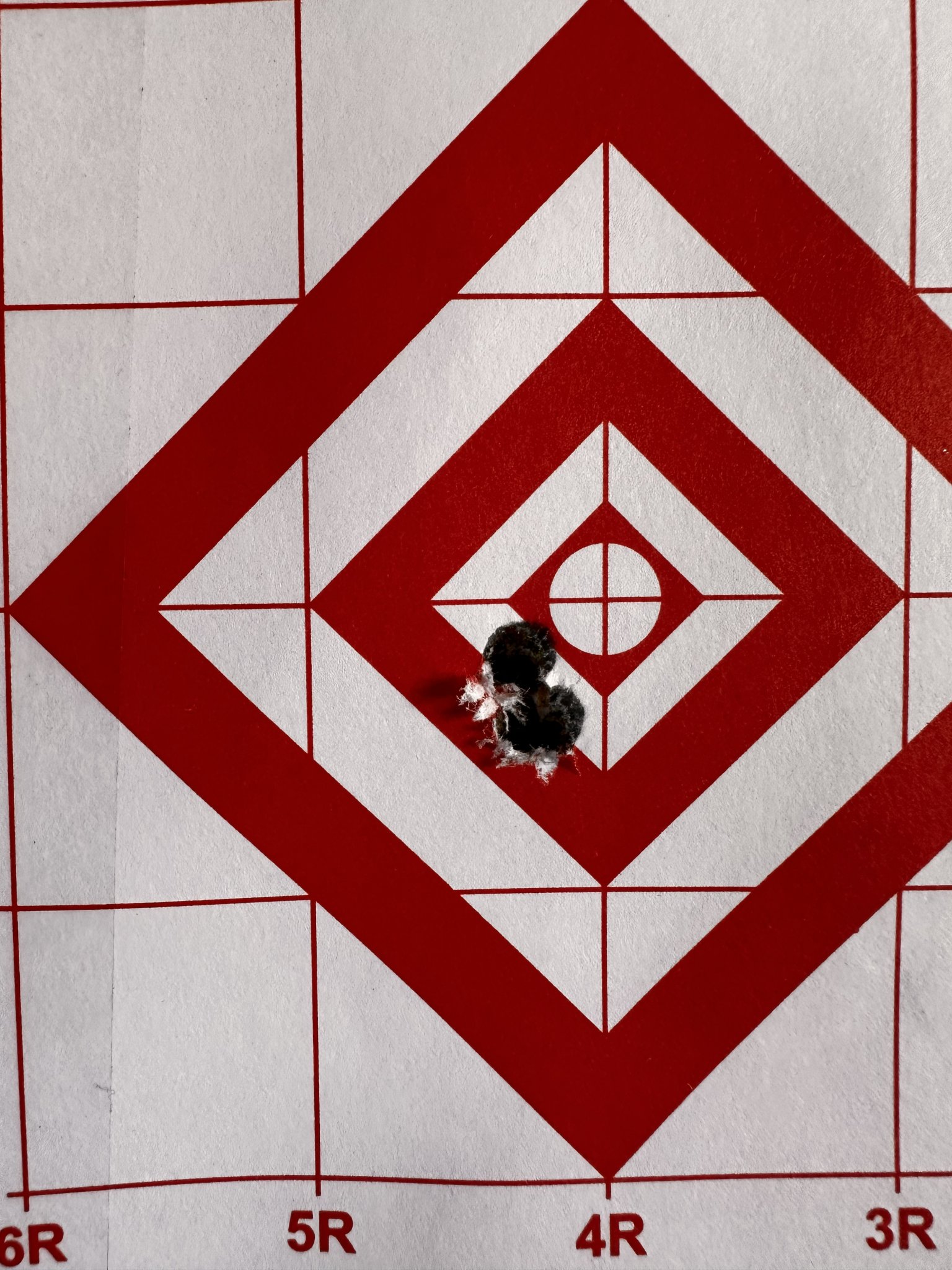

I appreciate the heads up. I ordered a few boxes. Although, I have to say that I've had fantastic results with the hornady brass.
37.5 grains staball 6.5 (trickled)
Rem 7 1/2 primer
Hornady brass
88 eldm
es of 5 across 10 shots

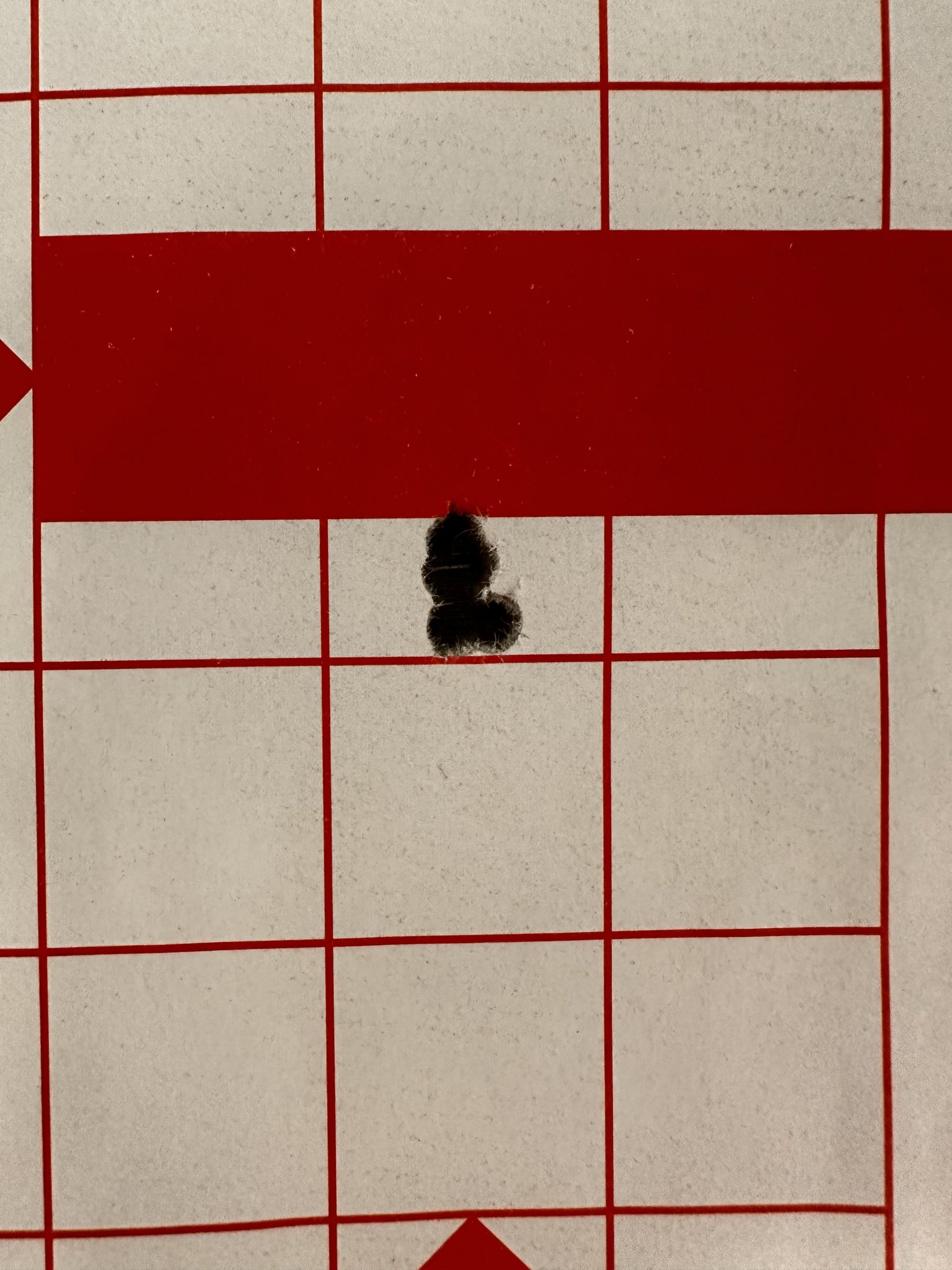

I had zero issues with my pva obw 22GT 1-7 and blowing up bullets. Shot 88 ELD's lights out...

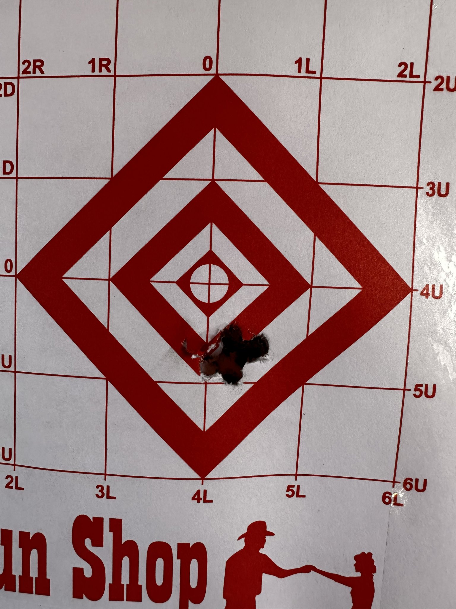

I didn't have great luck with 95's in 2 barrels...90smk, 88 ELD and 85.5's all shot great.
I just tested the PVA OBW for a few hundred rounds for accuracy while I was waiting on my Bartlein...it's still in the safe..
