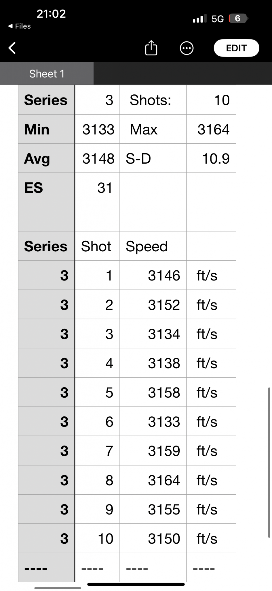

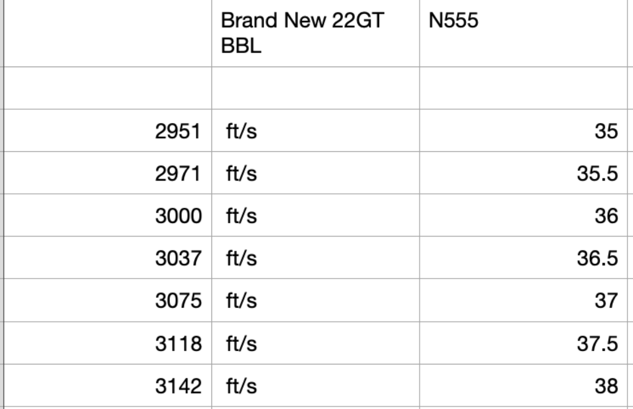

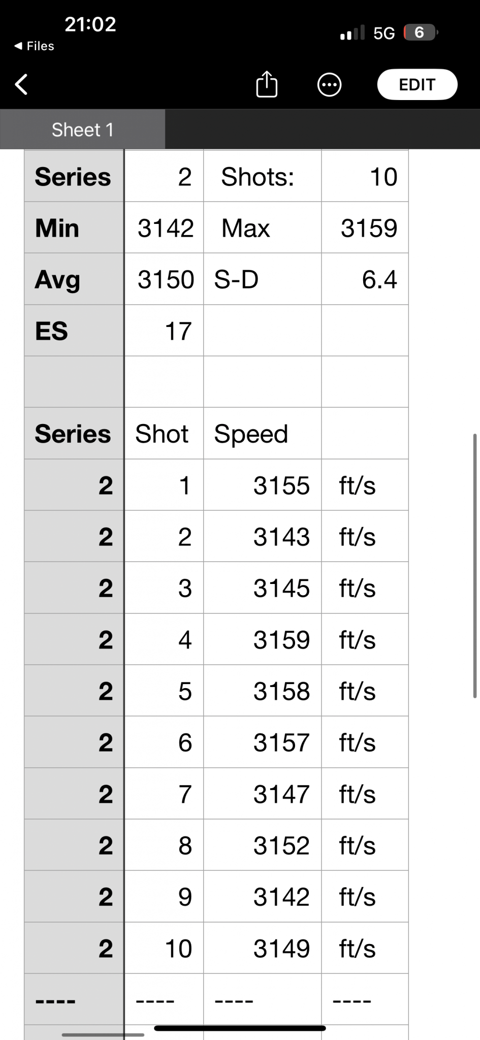

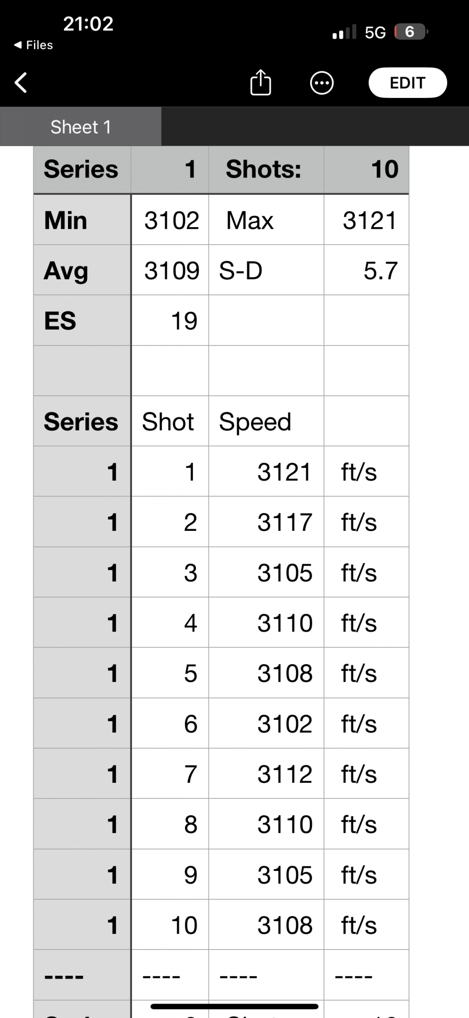

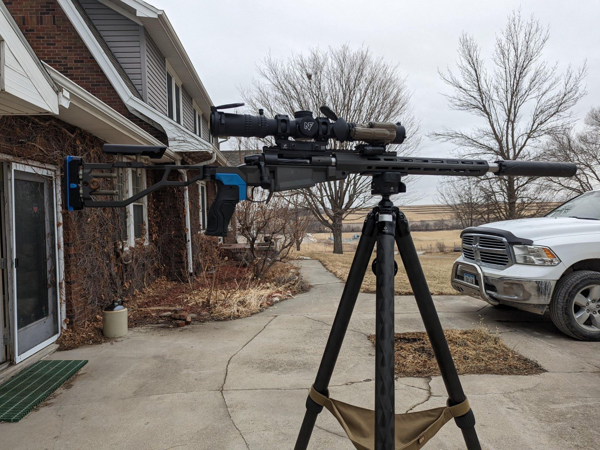

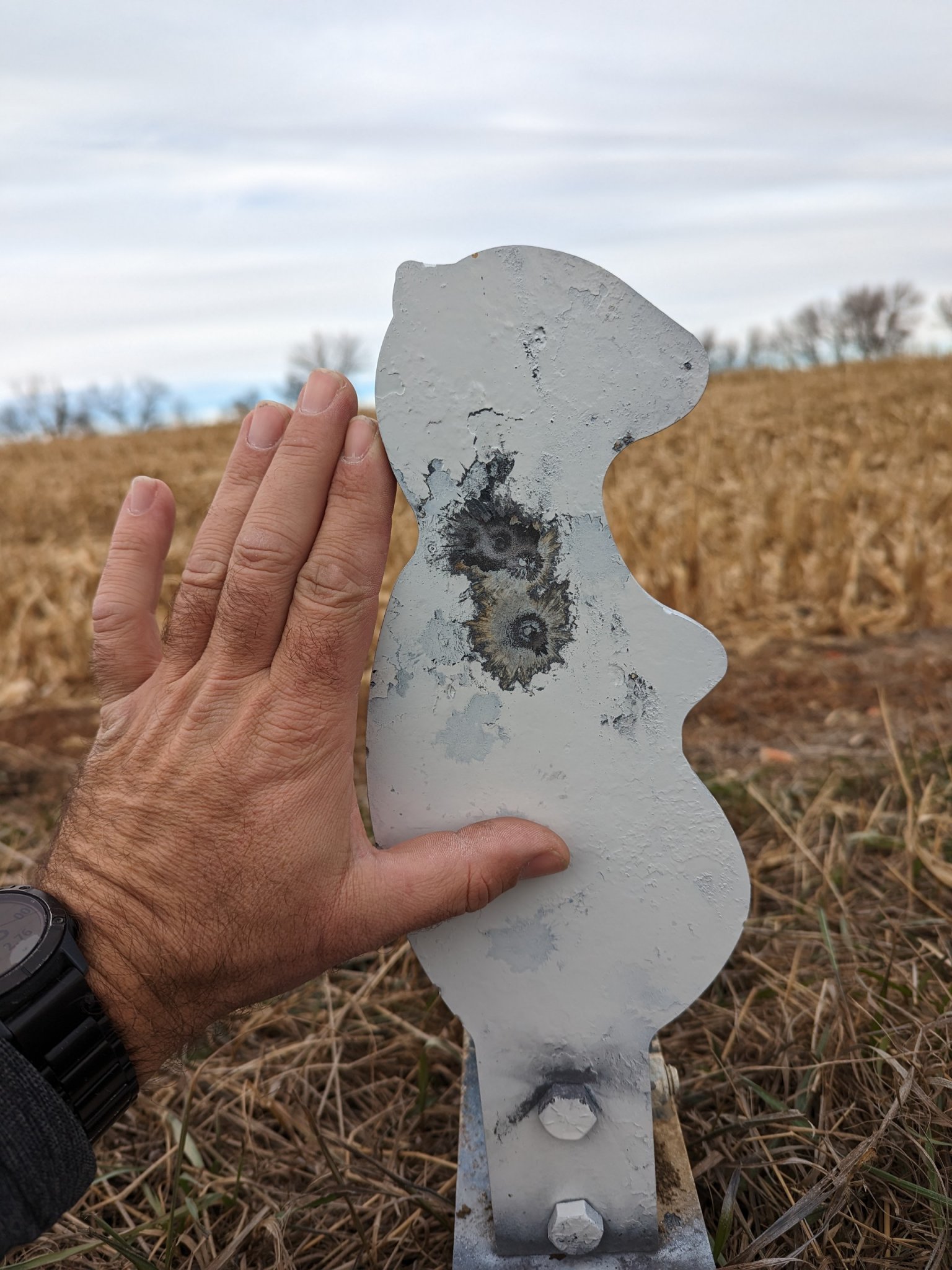

Got some rounds down the new GT barrel. Shot 8 and then these 7 for speed. The first 8 were 35gr for sight in and then these. Ran 88gr ELDM 20k off for this procedure. All N555.
For anyone who wants to try this as a coyote round, I have built 3 different barrels for hunting. My bullet is 60vmax using H4895. Same identical load is 3450fps in 16" barrel, 3500fps in 18" and 3600fps in 20" barrel. They all shoot great, but the fav currently is the 20" Bartlein 400bb steel carbon wrapped. I'm hoping for long life even with the highest velocity.
3 shots at 250yds is the last picture

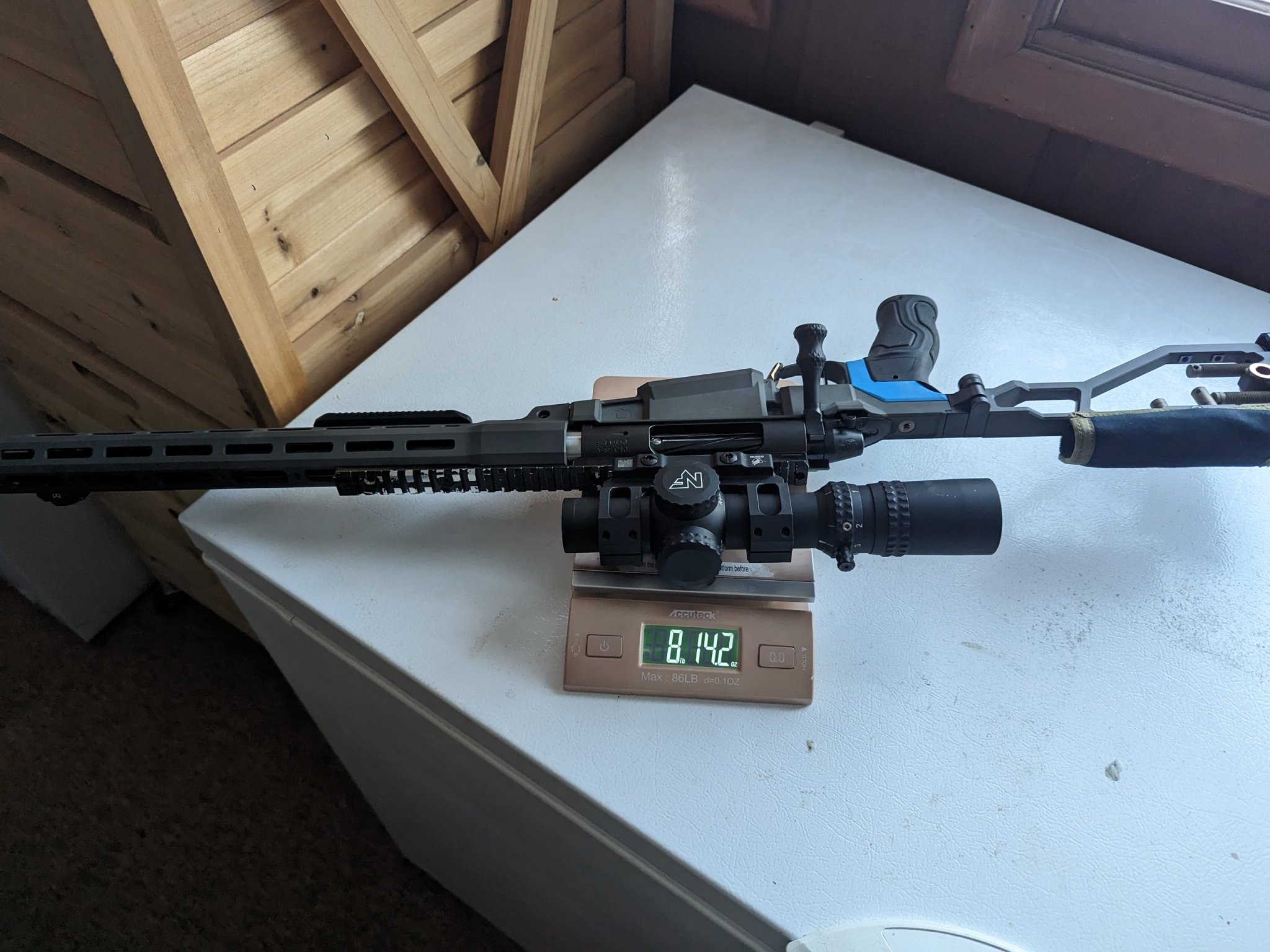

For those of y'all that wish to run 22GT with a HRD br kit in an AW/AW mag. The spacer needs to be filed/ sanded down to at least 0.325" towards the top. I measured the gap that I normally leave with a standard 308 follower and it was 0.329". More may be needed depending on the bullet you are using and OAL. This is for 88's at a coal of 2.546".

I just looked up my earlier targets. At the 30 round point, that same load chrono-ed at 2942fps. Sped up to 3088 by 190 rounds, quite a change.
