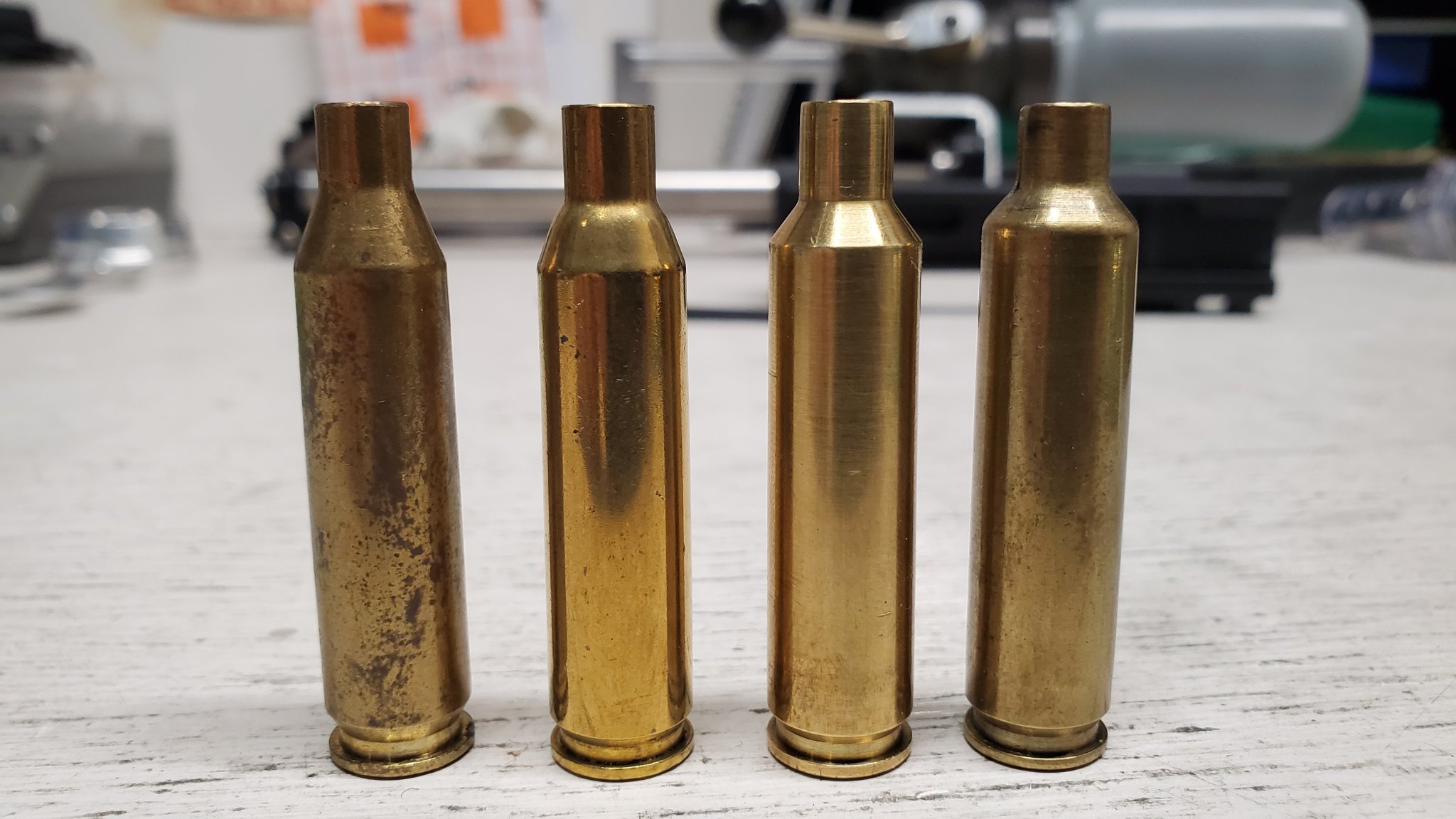

That's hot.View attachment 7254881View attachment 7254882
243cutright ftw, lol. Has more work to it, but it's a nicely balanced case. Left to right: 243win, 243win ran into cutright sizer, fireformed cutright, and a 243ai.
