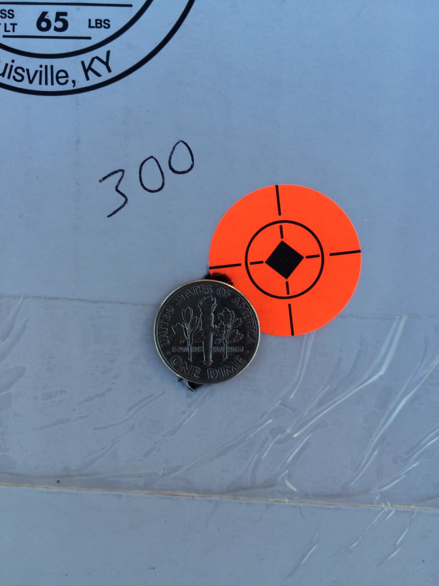

Fgmm is very mediocre in mine. It’s 1 moa ammo in my gun. Best factory ammo I tried was the Berger 136 Scenar ammo at 1/2-3/4 moa. Hence what led me to buy a bunch of them. My hand loads are in the .2s at 100 and .5s at distance
Lapua Brass
CCI BR2/200 primer
42.5 gr H4350
142 SMK .010” off lands
2835 FPS Unsuppressed
Criterion 26” 1/8
300 yard and 600 yard targets below. Longest hits with this setup is 1,792 yds
I’ve shot a handful of 1” 5 shot groups at 300 yards with it.
Far and above what any other load
Including my own do.
My loads do beat it at vertical at distance at least.

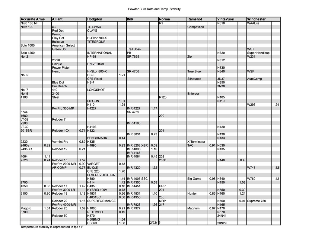

how important is temperature sensitivity to you? Are you shooting suppressed?
Tex,
Stability is not huge to me, I’d certainly like a small ES in all conditions but barrel life and accessibility are more important to me. It will be shot suppressed the majority of the time and the reported carbon fouling is of some concern. Albeit, I have no first hand experience with RL16 and it’s supposed carbon fouling. I’d like to have one profile in my kestrel and something I don’t have to go back to notes to make.
I haven’t noticed any more carbon issues than any other powder I’ve used in my 260.
Accuracy, low ES, good temp stsband easy speed I have found with R16.
I’ve burned through 5+ pounds of it so far and can’t say a bad thing about R16 yet.

That is precisely why I take most things I read on forums with a grain of salt. Are you shooting suppressed?

Interesting. I’ve always read that the reloader series were temp sensitive and carbon fouled worse than H4350. Gonna do some research on temp sensitivity. I found this chart on here the other day.
i saw RL16 sitting on the shelf at a local place. Might need to try and work a load up for it.
That was certainly kinda the case but R16 and R23 were conjured up to get more in line with current demands.
