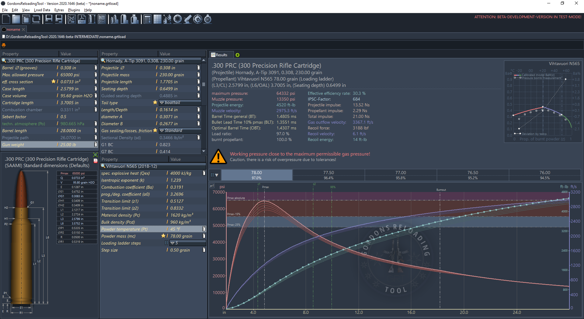

Playing around with the Gordons Reloading Tool....and had to input all the case measurements since they don't have the 300PRC in the cartridge selection.....I'm stuck on Case Volume in H2O....and I don't have any empty brass to check myself....any one got an answer? I just put in 96 as a guess. And I have no idea what a 'Sebert Factor' is....so I copied the 300Norma for that
So...with guessing on those variables...I see a projected MV of 2935fps using 78.5gr of N565 on a 225gr ELD-M...and the last time I was out...I think it was 2931.....I don't think this thing asks for environmental variables....
Anyway...anyone got a closer guestimate on H2O capacity?

Hornady brass 95.6 gr.

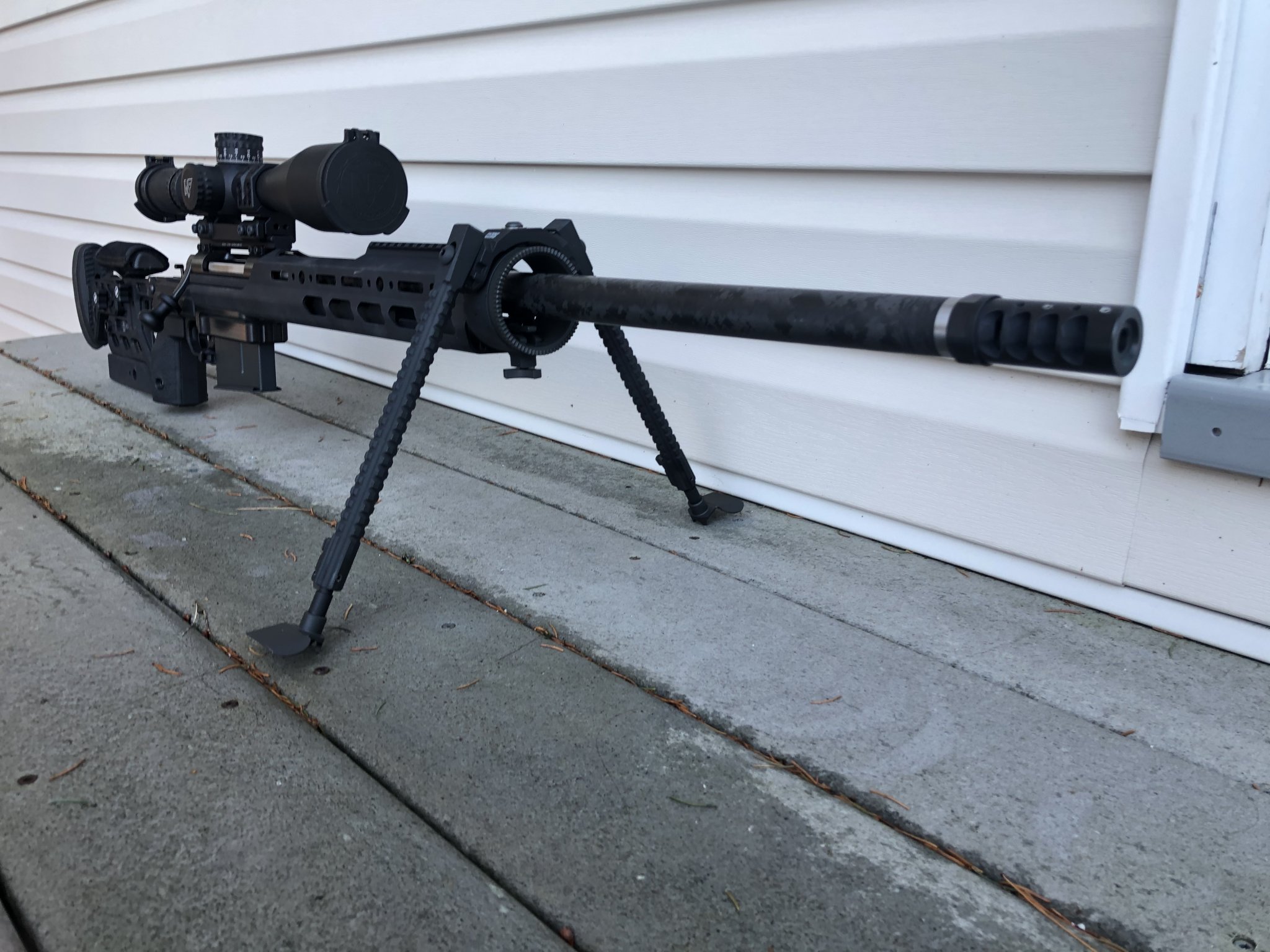

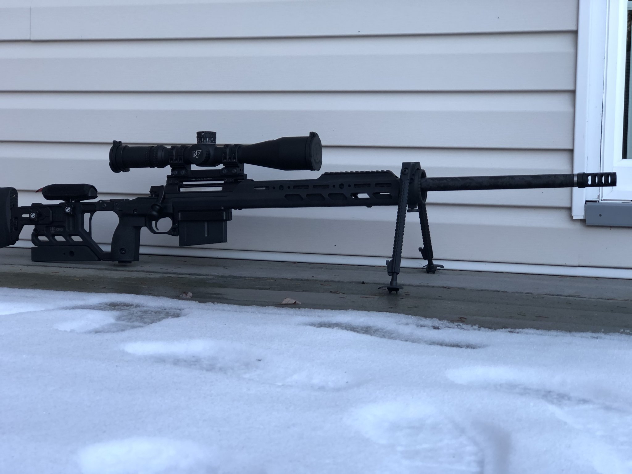

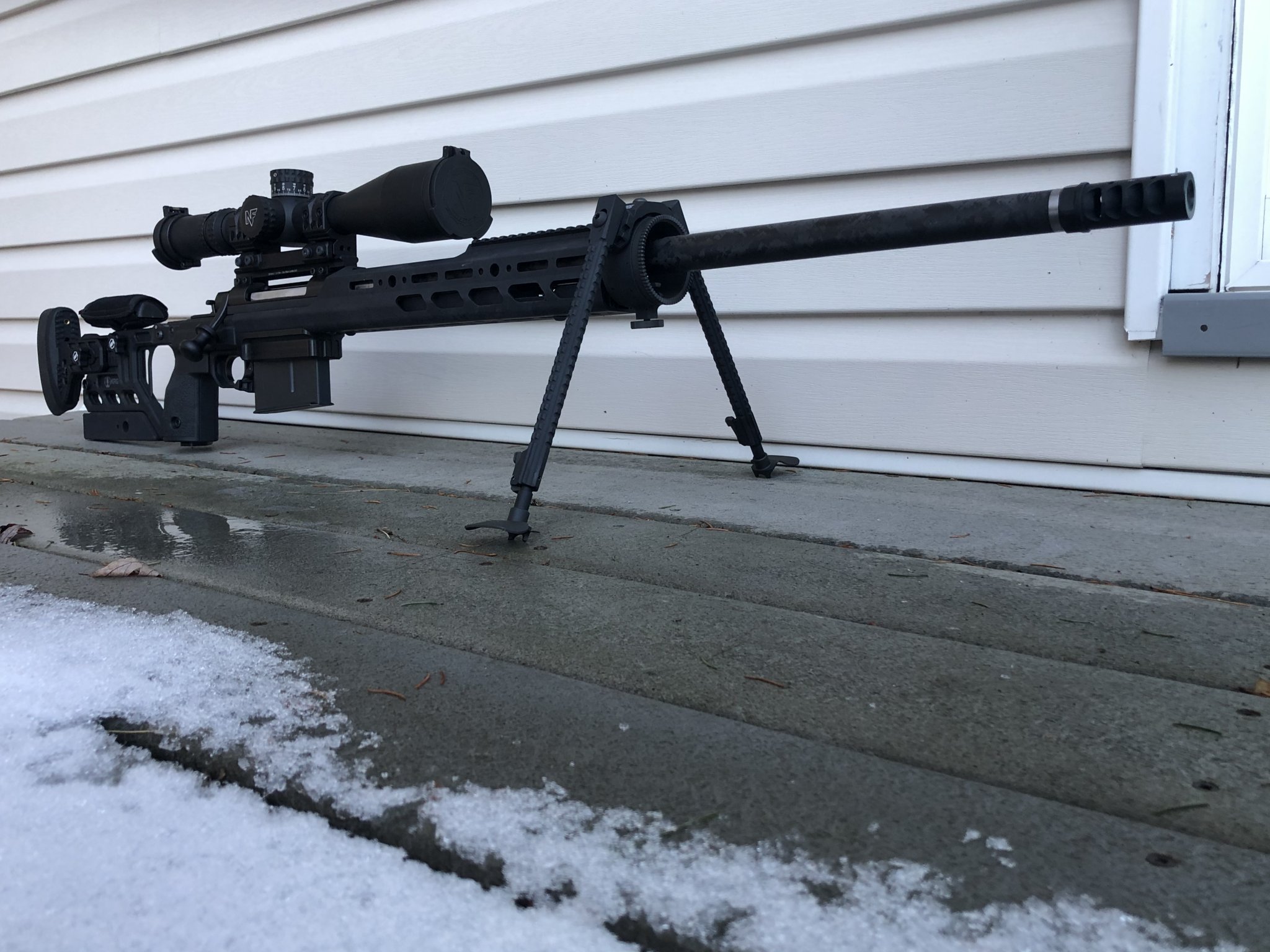

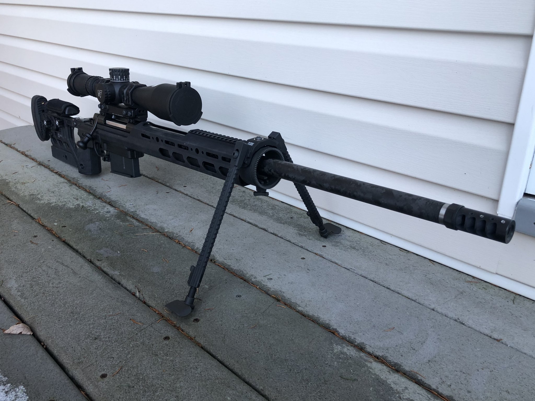

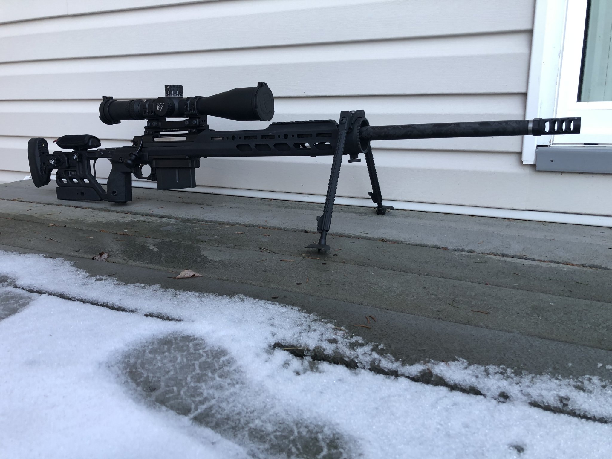

Out to 2000 yards 300 PRC running strong!
Mausingfield Action
Carbon Fiber Proof barrel
KRG with enclosed Forend
ELITE IRON Revolution Bipod panning model
TriggerTech Dimond Trigger
APA GEN 3 Self timing Brake
SPUHR Mount 50 MOA with rail (34 Mill dial elevation )
NightForce 7-35x56 F1 Mil-XT

Is that the lil or fat bastard gen3?

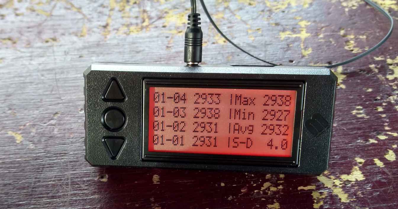

It must be pretty strong brass. I am smoking Hornady brass at 3-4 firings at 2890 fps with 230 Hybrids.
Walked out the door and forgot the 250gr A-Tips loaded with Retumbo/N565/RL-33.. DOH!!!
However, I did manage to take the big box of ammo that I wanted to do temp stability of the N565 loaded with 225gr ELD-M's. I was pleasantly surprised to see not much reduction in velocity in much colder conditions. I dropped about 1fps per degree F. Today was slightly cold....35F when I shot....some would call that 'mild'...but I couldn't shoot less than a 1/2" 100yd group to save my life because this southern boy was shivering a little....micro shivers. Vertically was great....side to side was bleh.... so 78.5gr of Vihtavuori N565 pushing a 225 ELD-M equals:
6th firing on Hornady brass....SD 4.0...ES of 11...time to anneal ;)
