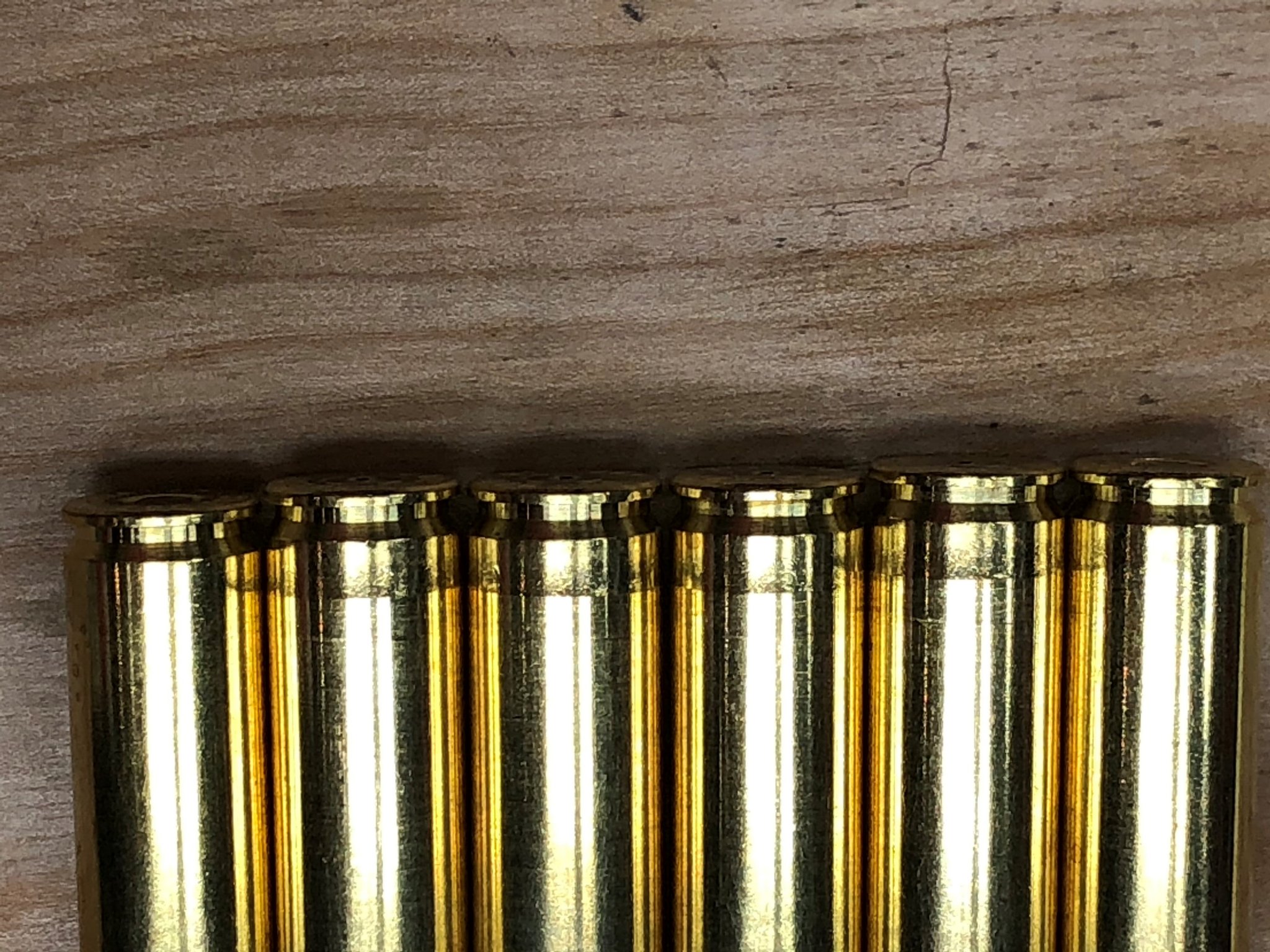

I am admittedly out of my element, but will try to add to the discussion.
The first picture is four once fired (factory) Hornady 225s flanked on each side by an unfired case. You can see, on the four middle cases, the issue Alex discusses. The two other pictures show the measurement of a new and once fired case at the web.
Supposedly, the fired case, is not being resized at the web during the full-sized process, which creates the issue. I believe Alex had a new reamer made that is like 2 ten thousandths over spec at the web to alleviate the issue. Supposedly, others have polished the rear of their chambers a tad to do the same, and others have taken a sizing die and used a lathe to cut it off so the web is also resized.
I've read the threads and decided to contact Larry Willis at Innovative Technologies thinking his collet resizer might work. It won't as it relies on the belted area to hold the collect while the die works. However, Larry did say he was aware of the issue and suggested only bumping the shoulder 0.0015, not the 0.002 - 0.003 some bump. Apologies in advance if I got this wrong.
Supposedly, the fired case, is not being resized at the web during he full-sized process, which creates the issue. I believe Alex had a new reamer made that is like 2 ten thousandths over spec at the web to alleviate the issue. Supposedly, others have polished the rear of their chambers a tad to do the same, and others have taken a sizing die and used a lathe to cut it off so the web is also resized.

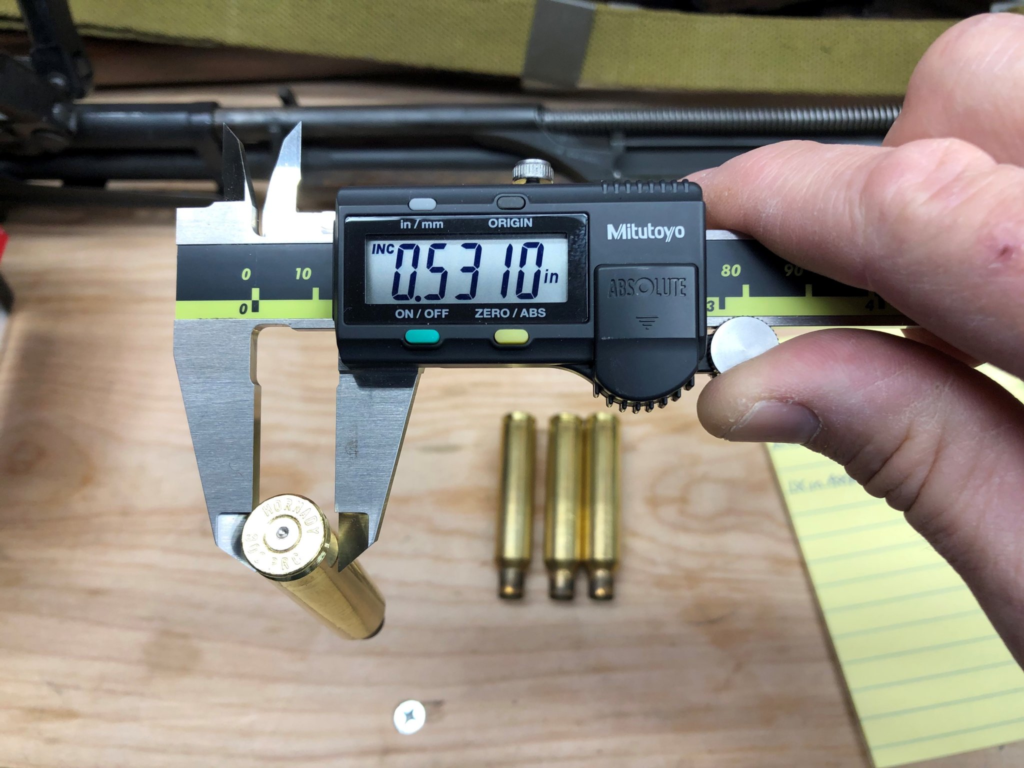

I just got .5310 at the web with once fired Hornady in a Redding FL die. (Looks just like your brass). .5320 is the SAAMI spec. Not sure I understand the issue this presents.

New Hornady is .5290
My fattest fired cases measure .5320
3rd party Seekins cases that wont resize are measuring .5340+
Spring back on trying to size the body .005" that far down is too great. Remember this is the non annealed portion.
My bet is a batch of out of spec reamers made it into the wild. The only way I see to trace it back is make a list of barrel manufacturers.
As someone who suffers from SCS (Small Chamber Syndrome), this is my bet. Brass coming out of my current chamber measure .529 - .530.

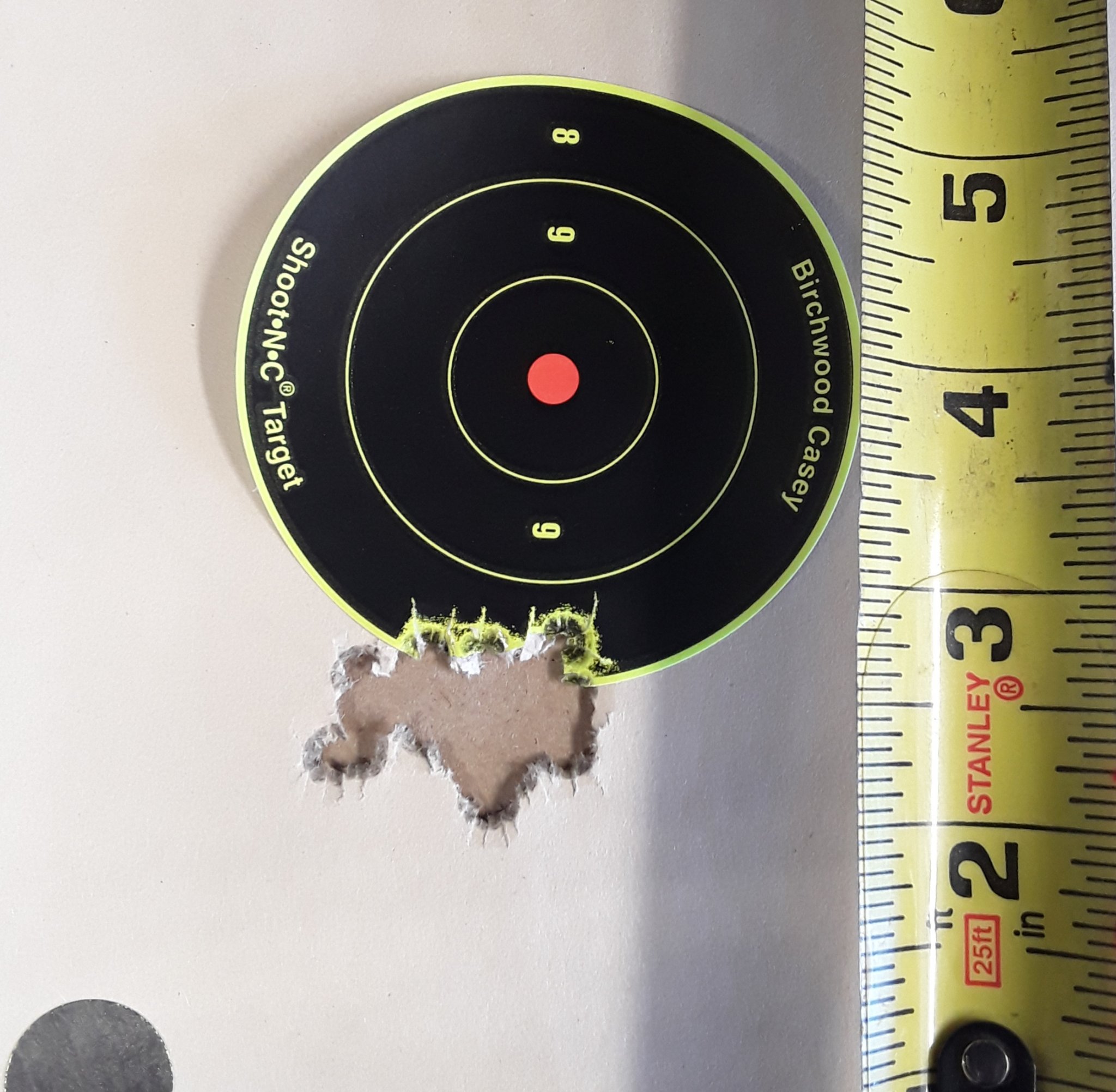

Lets get this thread back on track. I went out and tried some Ramshot LRT over the weekend.
24" barrel
Virgin Hornady brass
215M
225ELD @ 2.900 bto
792543ft/s
79.52606ft/s
802513ft/s
80.52595ft/s
812586ft/s
81.52541ft/s
822614ft/s
82.52617ft/s
832662ft/s
83.52637ft/s
842736ft/s
84.52712ft/s
852768ft/s
85.52728ft/s
862760ft/s
86.52826ft/s
872820ft/s
87.52811ft/s
882813ft/s
20 rds and one ragged hole.

There seems to be some inconsistency with the progression. What were your thoughts?
I noticed that also, It definitely makes some big jumps. It's totally possible i fucked something up somewhere. But then again its half grain increments. I just did it to see what speeds im looking at and the last 4 look promising. 15fps over 1.5 grain spread, I'll take that any day.

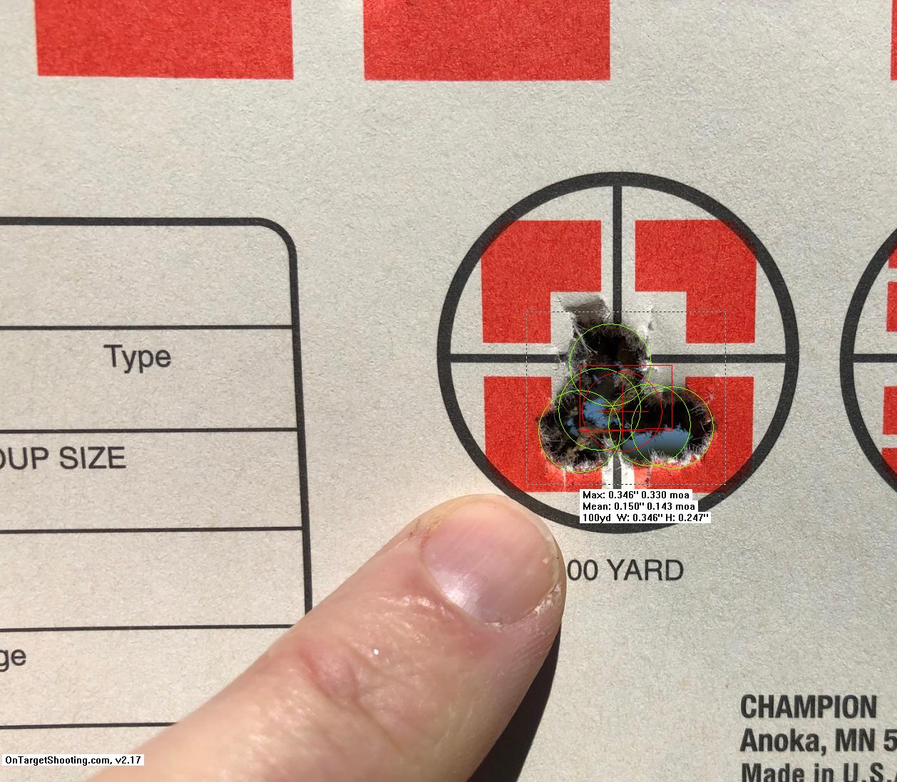

Wow! Maybe I need to switch to Ramshot LRT. Im using Ramshot Magnum.
225ELDM
78.1grn
Hornady Brass
CCI #250
26" Barrel
AVE. 2873fps
Pretty decent 1/2 moa groups.
