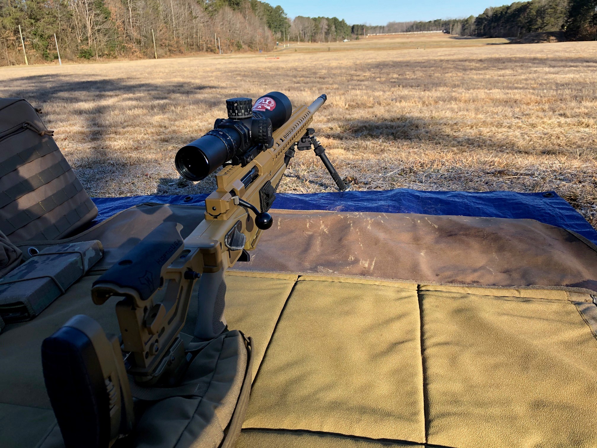

I went out to test a load today at Quantico R4. A nice 18 degrees to start the day but it warmed up to almost 40 degrees when I shot the string.

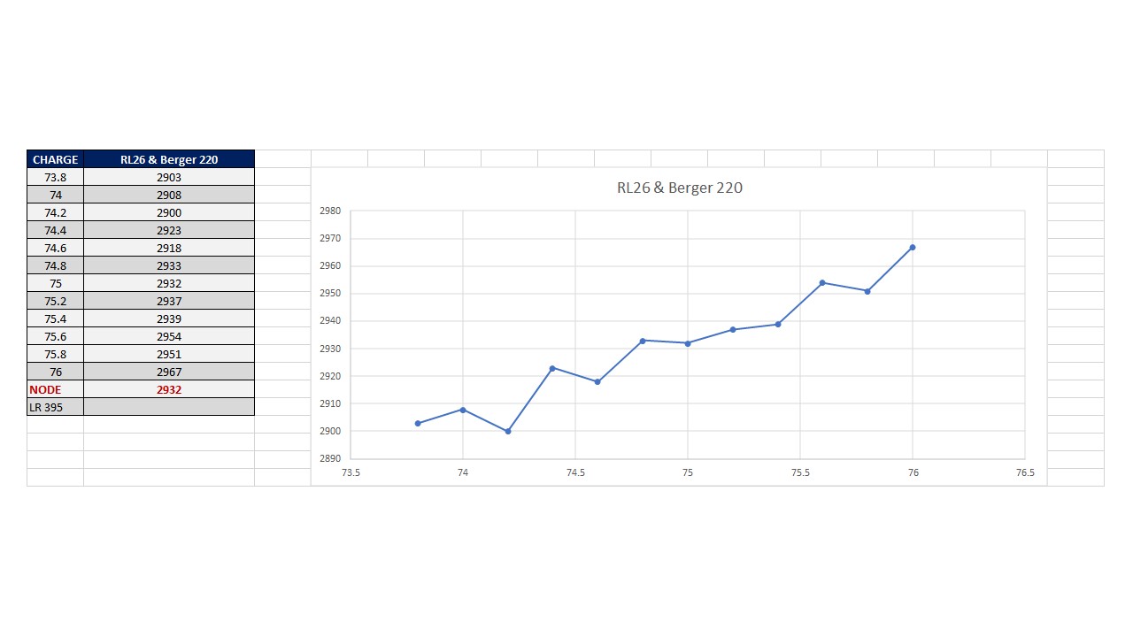

I previously found a node at 2870 with a differing combination so, I was interested to see where RL26 and the Berger 220 would land. The chart shows a velocity node at 75grs / 2932fps and I will pursue that a bit, but I'm also going to see if there is a slower node in the 2870fps range.

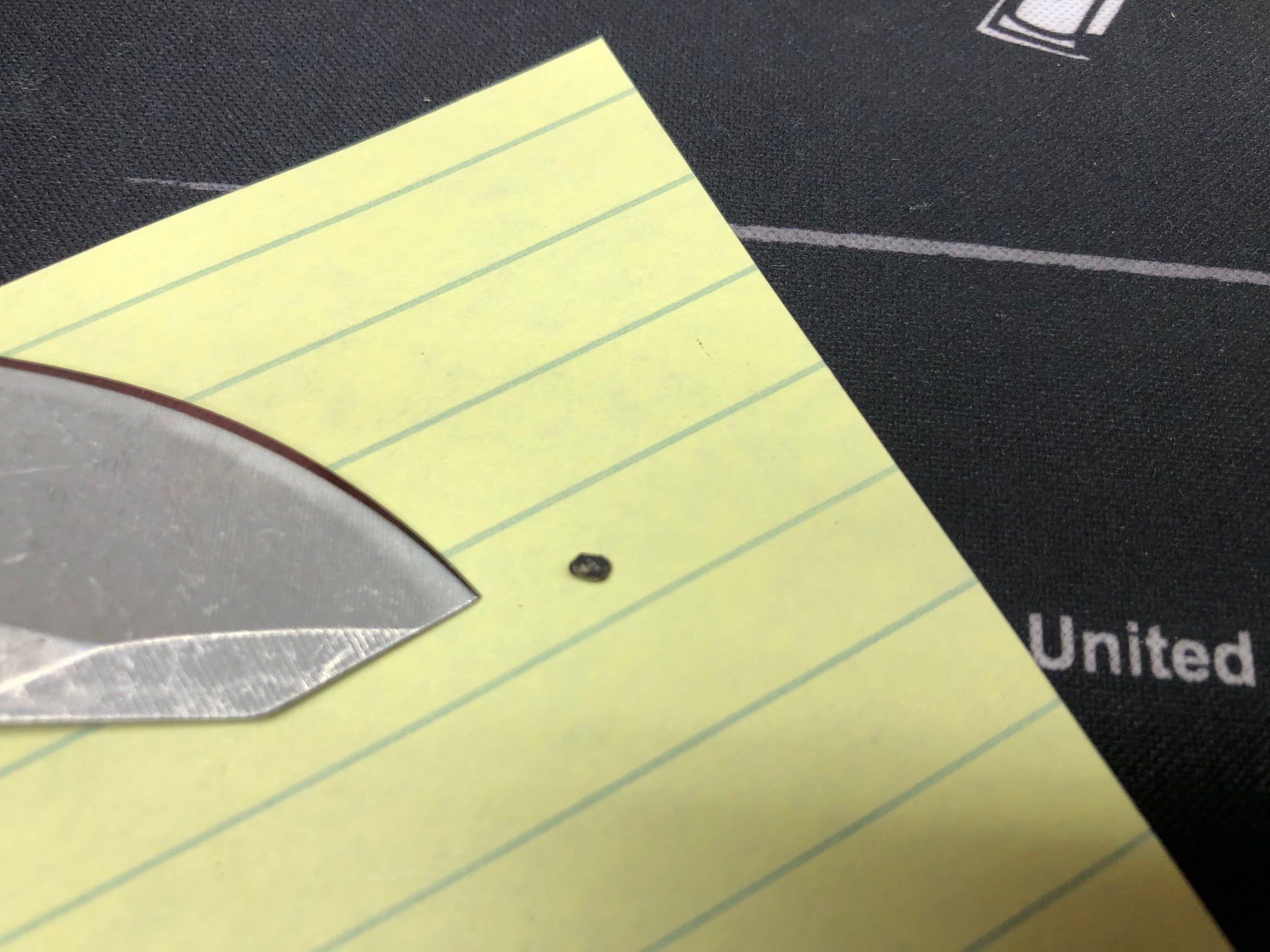

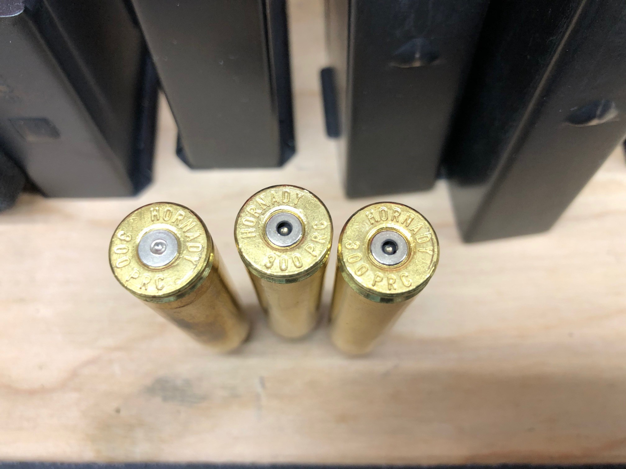

I also shot N565 and the B220s, but the initial two increments were too hot (pierced primers, 2982fps), even though QuickLoad was telling me this load was much slower.

My initial increment with the N565 / B220 was 78.2grs and you can see the results in the 2nd and 3rd case contrasted against a factory load.
I shot 78.5gr of N565 fairly regularly with 230 A-Tips....and had some minor swiping and some plunger marks....but I've never had a primer do that.....I had one pop all the way out with a loose pocket using a load I won't discuss here....it was....well...HOT.
