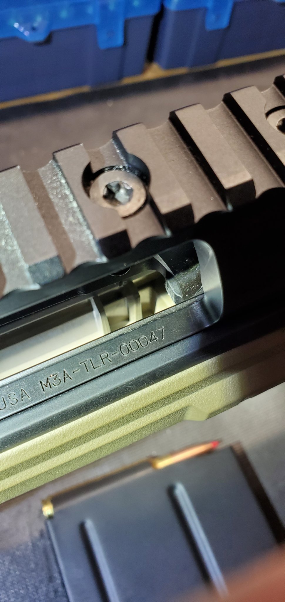

Finally got my barreled action back. Can't wait to get this out and see what it will do.

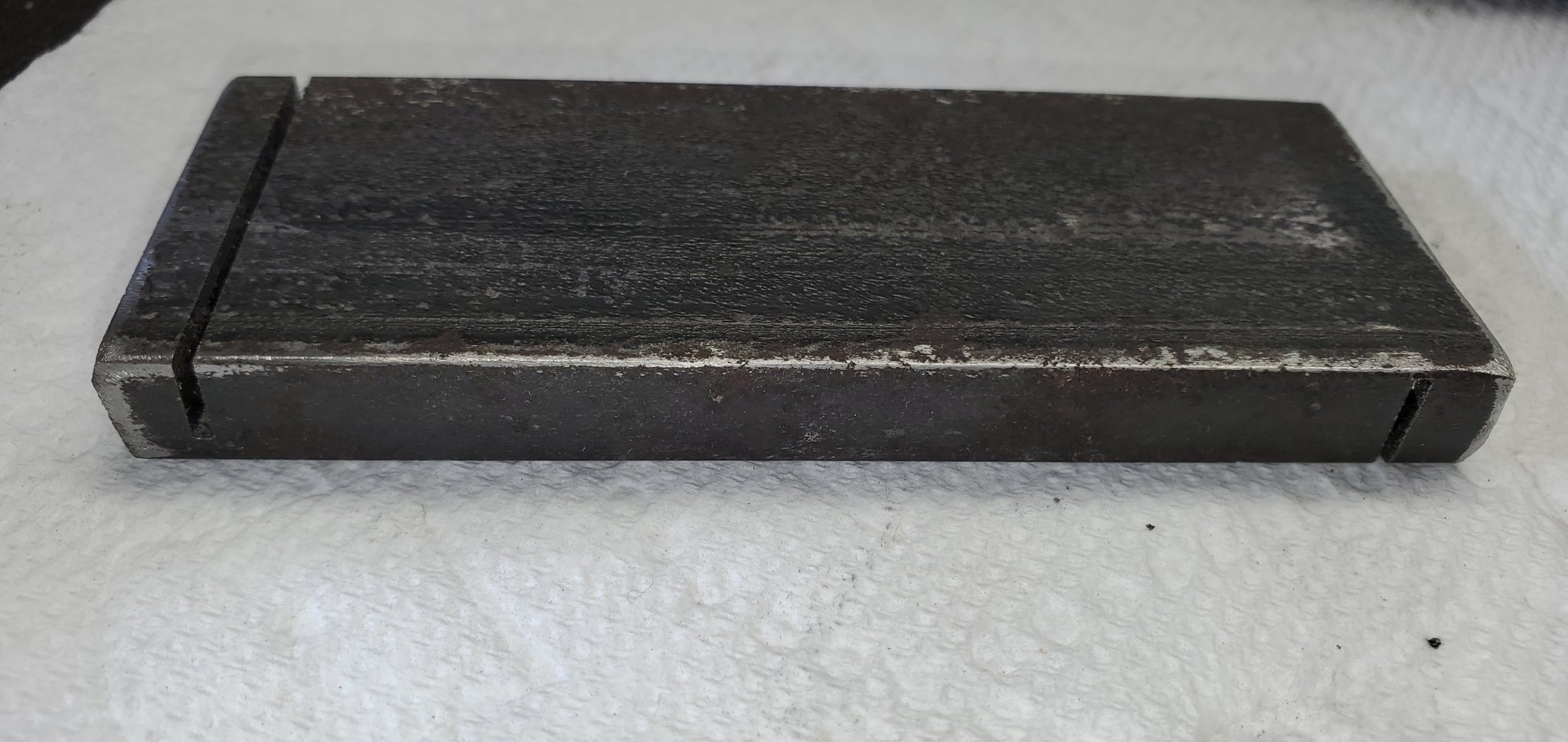

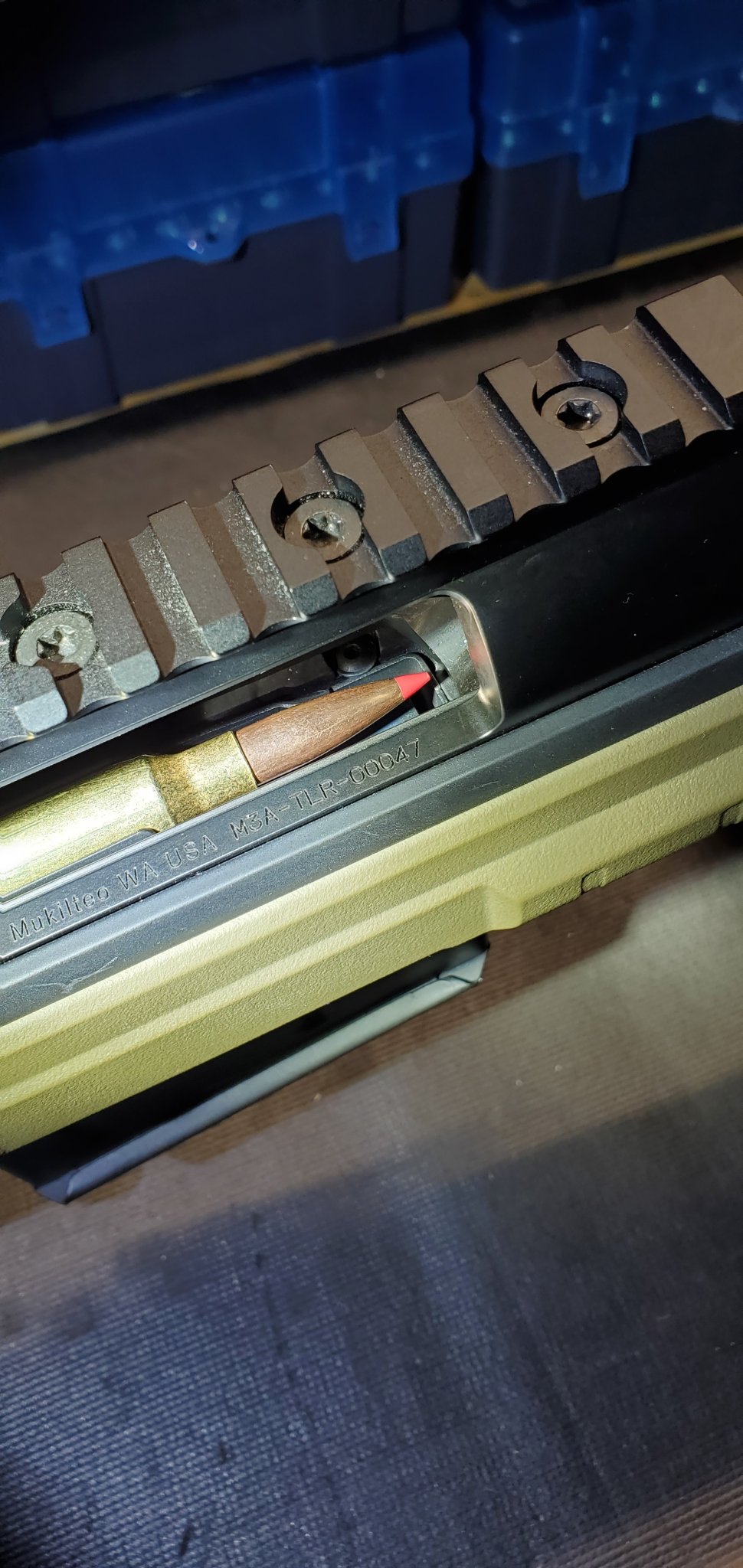

I'm having some issues getting the brass to cycle in the mag. I'm running 300wm 3.850" accurate mags. I'm probably going to have to tweak it, just was hoping for some insight on what needs to be done. Looks like I will have to do some adjustments on the chassis. I'll have to tinker with it.

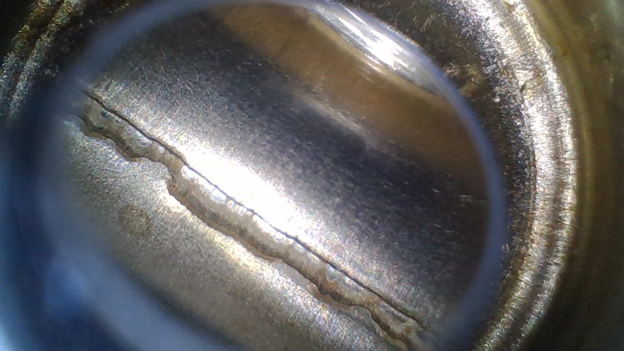

Anyone seen this?
Borescope in a new unfired Hornady 300 PRC case. Crevice/crack or whatever it is, is about 1/4 inch above case head. All of them in the bag are like this.

Well I think I just need to tweak the magazine a little.
You might need a slightly extended mag latch, or you can try opening the front of the feed lips a smidge. Can you post a short video of the feeding issue?
Anyone seen this?

Just to clarify, this is the inside of the brass, and it goes all the way around? It can be super hard to tell whether it’s a burr or a crack. Cut one of the cases in half lengthwise with a hacksaw or something and see which it is and if there’s any thinning (if not, it’s probably safe to shoot, but bring pliers in case). Probably worth sending a note to Hornady with the brass lot number either way.

Wow, is that the only one or is there more? Ive had some case head separations but from my own doing. Either way it looks like a weak point that would stress and fail sooner than normal. If theres more I would contact Hornady customer service and get it swapped out.

I had to adjust the mag catch on my MPA initially. It was strange. The first round would cycle fine, but after firing (not just dry cycling) the second round wouldn’t cycle. Loosened the mag catch and then the second round cycled but the third wouldn’t feed. It would start to feed but as the tip of the bullet hit the feed ramp the head of the case angled too low and the bolt couldn’t push it any more. I widened the mag feed lips ever so slightly and now everything works fine. I measured the height of the bullet in the magazine as I went to make sure I didn’t go crazy with it.

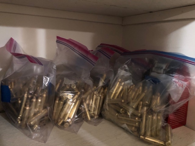

I wish it was only one-
650 pieces. The ones in the zip locks are the 100 packs that I purchased from MidSouth. One box of 50 Hornady branded. They all have it.

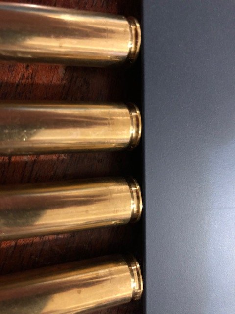

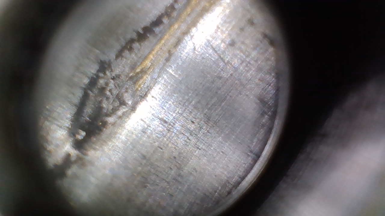

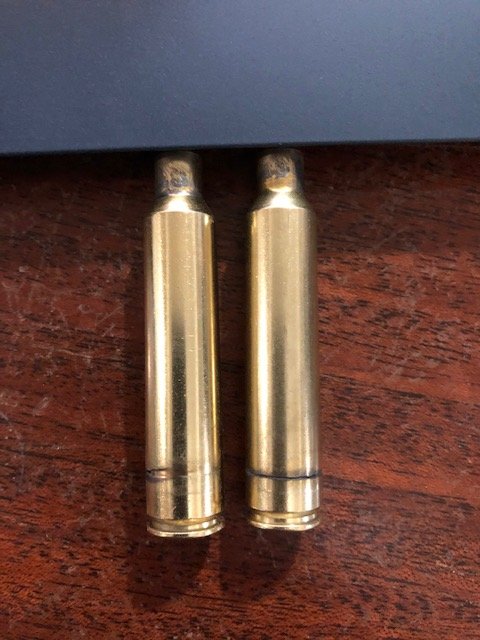

First firing - you can catch a nail in the marks.

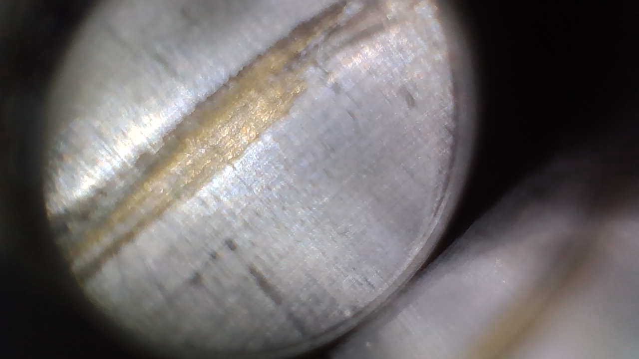

Second firing -
I sent pictures to gfrear at Hornady 3-18-21. He said he had seen if before and thought it was a problem when he first saw it, but he checked with the engineers and they told him the crevices/cracks were normal?
Second firing -
Hornady brass is already low grade to begin with, add in a defect right at the place where case head separation occurs. Its like the perforation on a paper towel. Destined to fail.
Check your chamber, it puts nice fire cuts in it where it blew through.

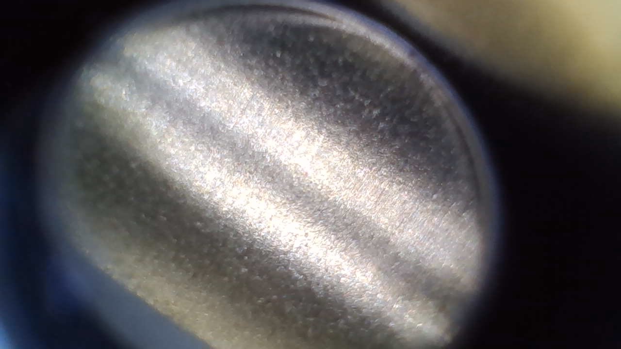

I have the same but not as pronounced. I'll pull some more virgin and 1x cases to see what they may show.
@gnochi I made a feed lip tool out of some flat bar at work and adjusted my magazine when I got home. It seems to have fixed my problem. I've cycled multiple loads through the magazine and action to test it out and it's doing well. If I run into any other issues I will get a video of it. Thank you for the help.
Jeremy
Looks a lot like the one I made for mine. Must be the magazine. Mine is an accurate mag also.
