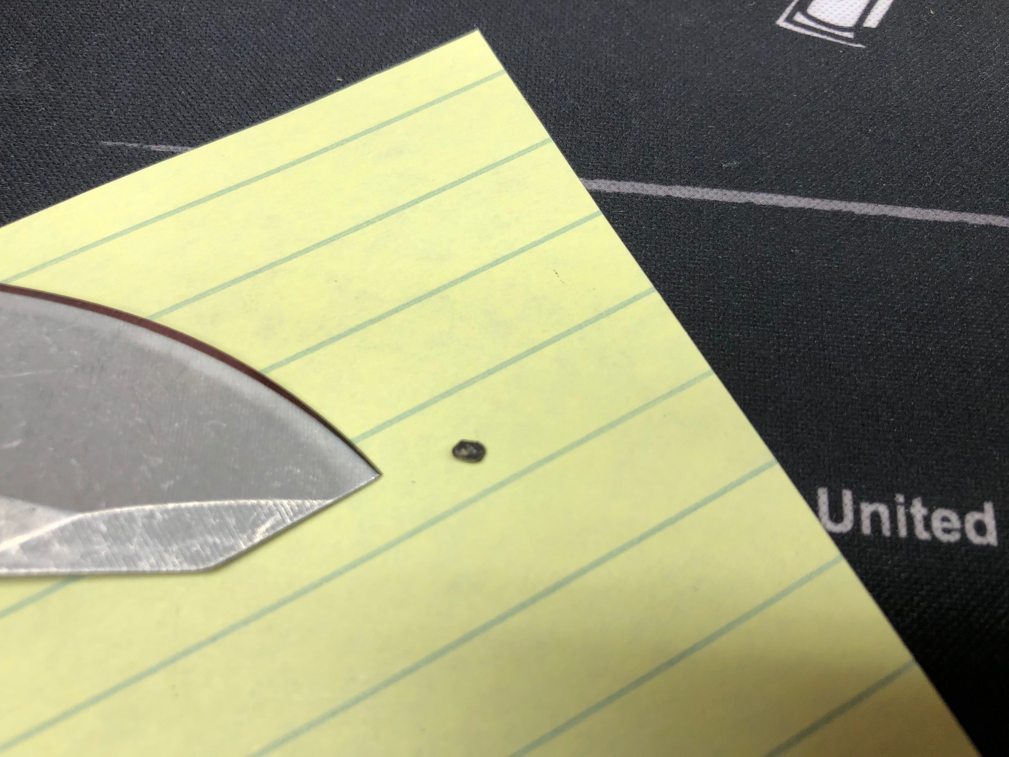

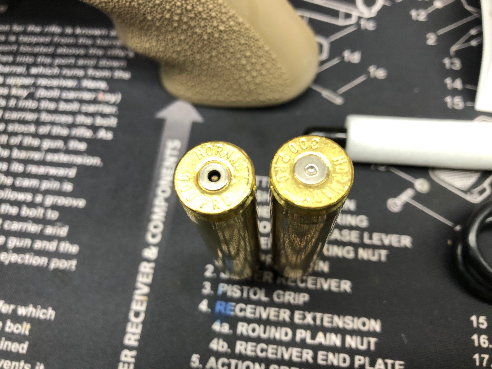

I was shooting factory and noted higher velocities than normal on the labradar. The 4th shot I pierced a primer so I took the rifle off the line. I got home and took the barrel off the AI and found a factory round would not drop freely into the chamber. My bore scope confirmed I have a significant carbon build up in a barrel with 354rds. I have been using bore eliminator and an occasional nylon brush, but clearly I need to up up my cleaning regiment.
I try and use my bore scope sparingly but I broke it out to find not only is their carbon in the first 6 or so inches of the barrel, I have a nice carbon ring. Anyways, I ordered some bore eliminator C4 and JB paste and until it arrived, used a gentle cleaning cycle and soaked the barrel overnight in kroil.
The C4, and a kroil soaked patch with some JB took care of the ring and carbon, so a factory round will now drop into the chamber un-impeded.
Pics show the pierced primer and the small piece of the cup that gets blown back into the AIs bolt assembly.

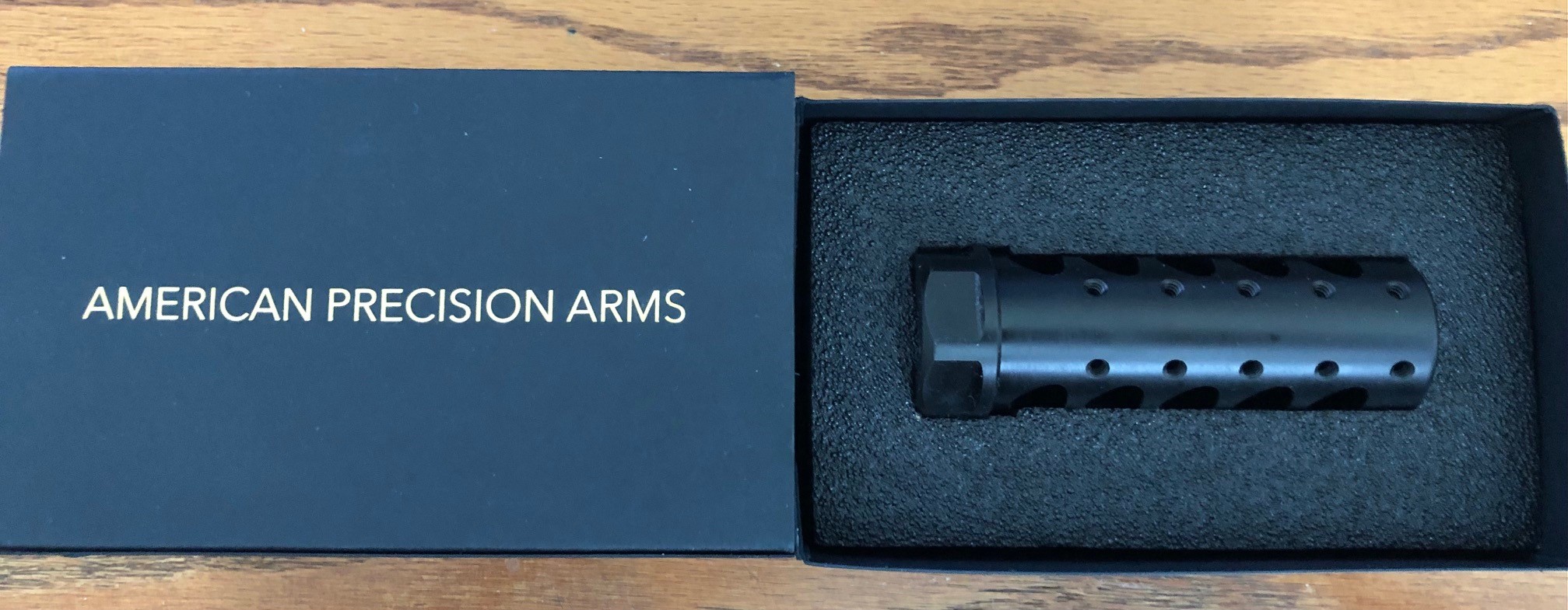

ETA - I also bought a Gen III FB. Anyone running one on an AI? Looks like APA also really upped their packaging game.
ETA II - Mailman also delivered another goodie I'm going to give a try. Anyone using an E-Dope card?
I run a gen 3 Fat Bastard on my 300 PRC it works very well, loud as hell but works well.

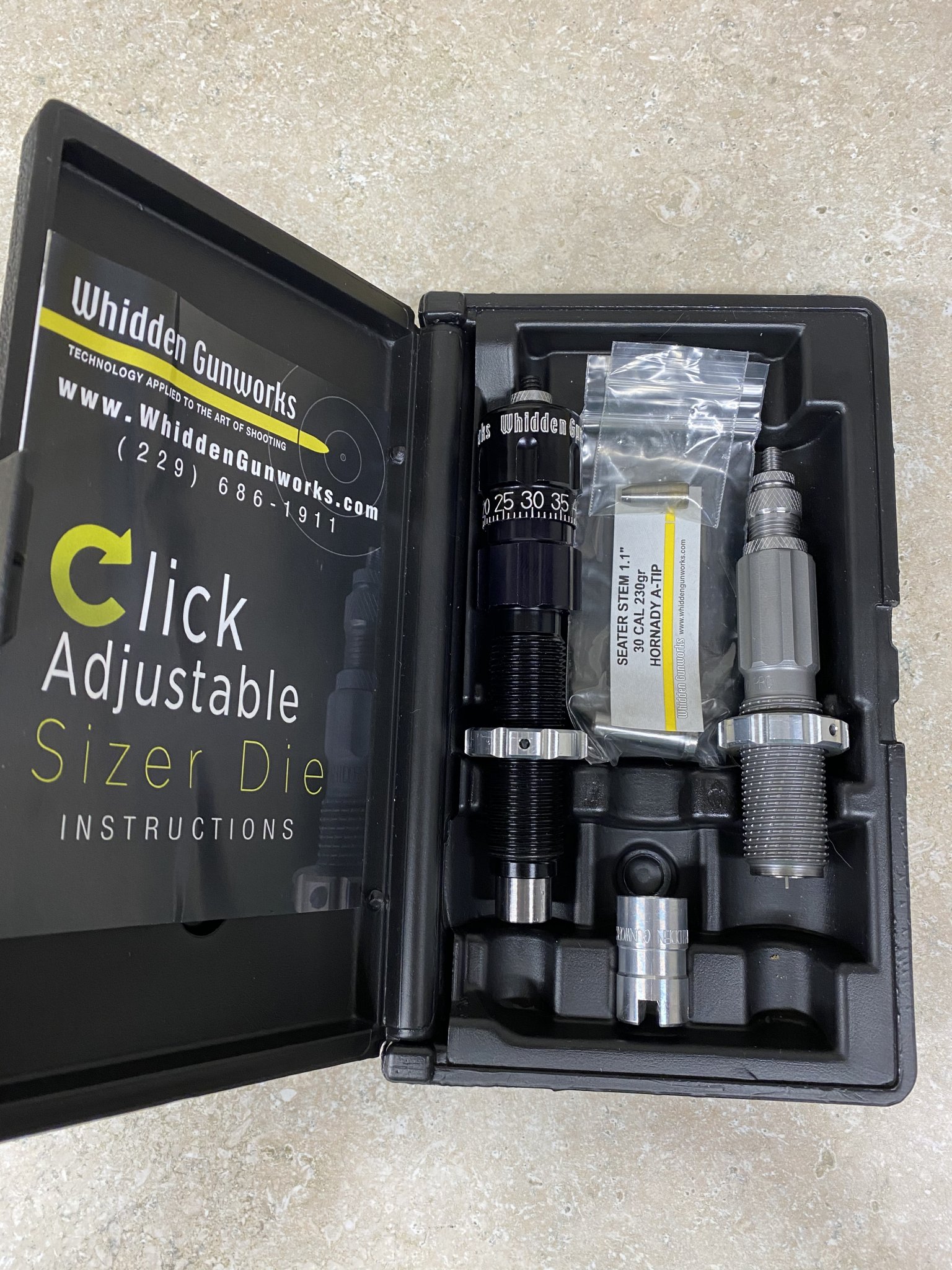

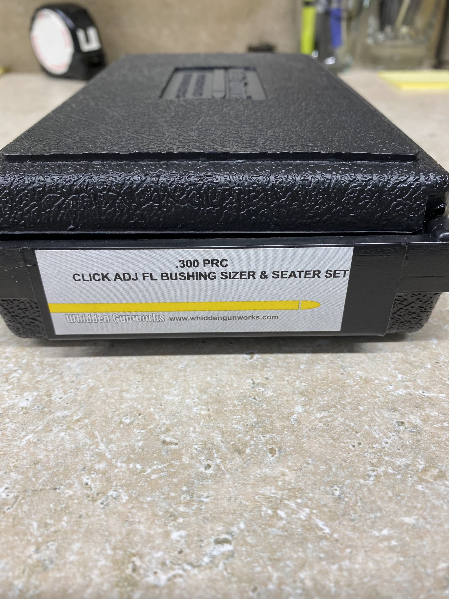

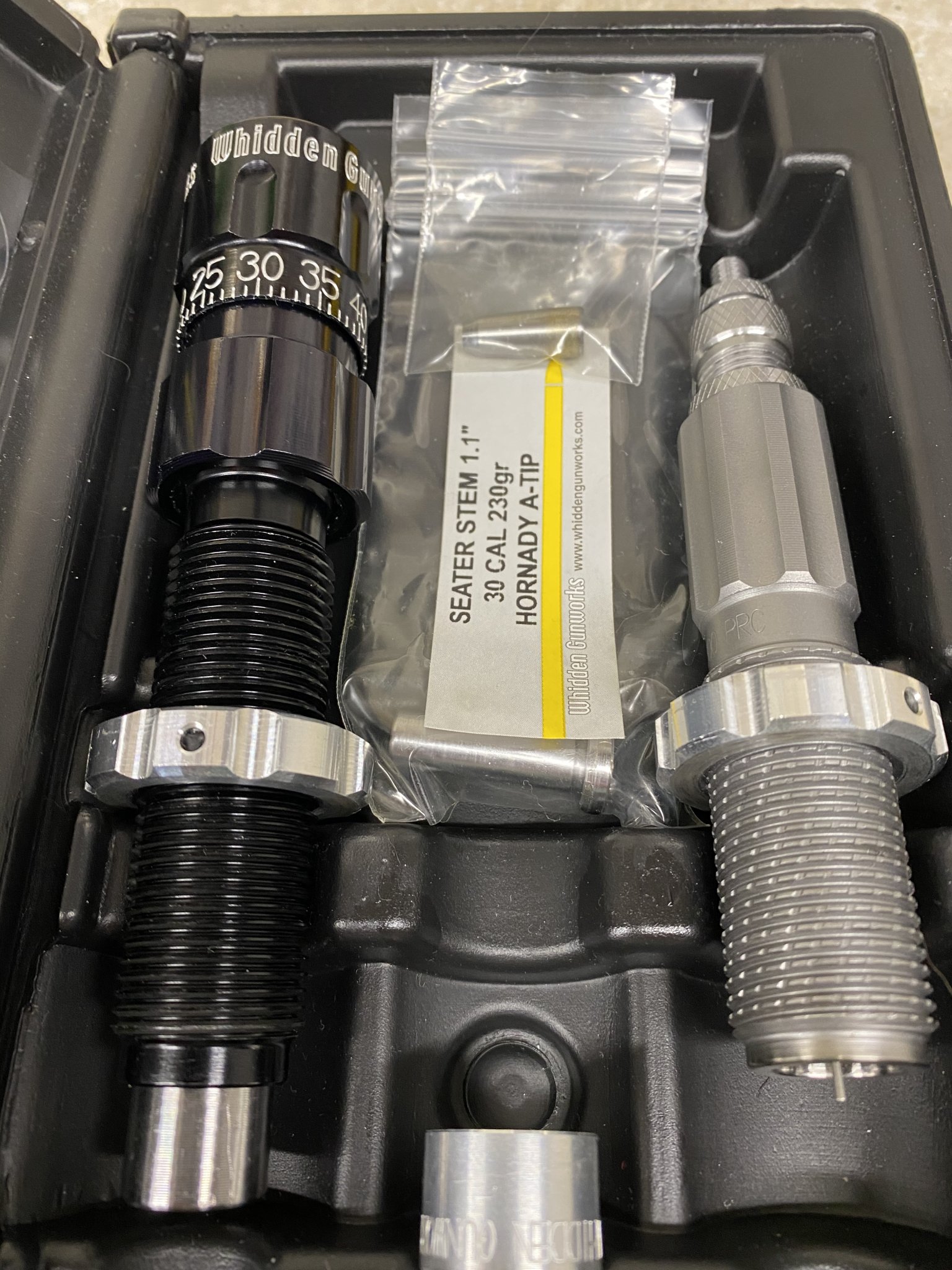

Another set of dies going up for sale. PM if interested. Shoulder bump gauge, standard stem, 215 hybrid stem, and 230 Atip stem. $250 shipped.

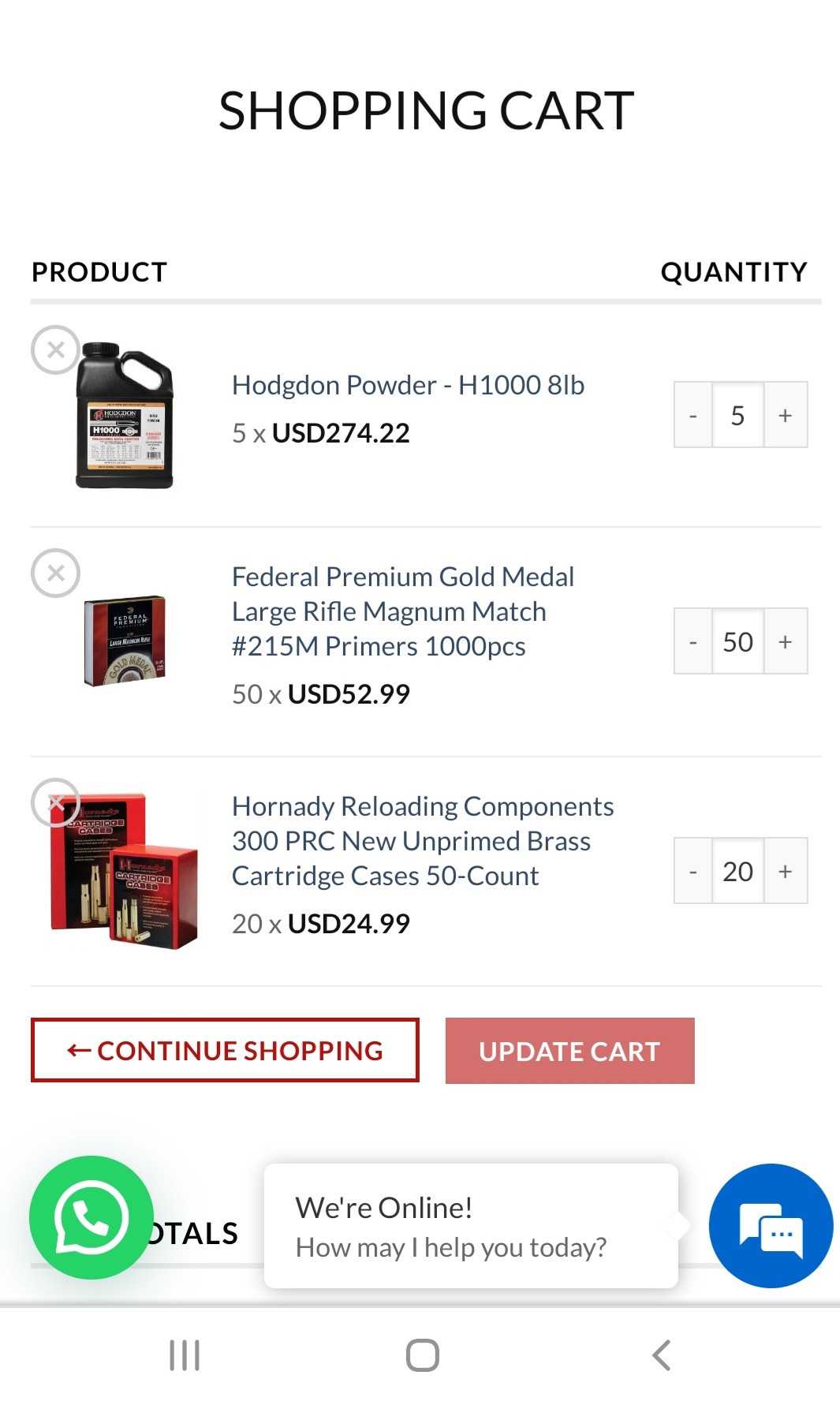

FWIW, I emailed them to confirm that they actually have it in stock and received a response confirming that it was.
I’ve never used Zelle but I understand that it pretty much just a PayPal equivalent. Maybe there is some buyer protection? Bitcoin is always shady but there seem to be more places accepting it as a legitimate currency, especially after the past wacky year.
If I hadn’t managed to get my order in with Midsouth, I might have tried it and ended up saving $50 with the 8-pound jug.
Zelle explicitly does NOT have any payment protection. I can’t guarantee that the shop is a scam, of course, but only taking payment options that make it super easy to scam people is sketch AF.
Reactions: 6.5SH and dwent
Last time I’ll bring this up, before we all get back to talking about our illustrious PRC cartridge, but wanted to update to save anyone else the heartache that was considering this.
A friend tried to put an order in with the aforementioned place and got some email in the middle of the night about his payment not going through and wanting him to submit the order again. He turned the other way and ran. I don’t think he’s out any money but this place is shady as all get out.
The website has only been up three months and on the front end it says they take Visa, Apple Pay, PayPal, etc... but when you go to pay it’s just Zelle and bitcoin. I think probably what is most suspect is the fact that they’ve had an 8 pound jug of H1000 listed as in stock for as long as they have. Going to call this one a 100% scam....

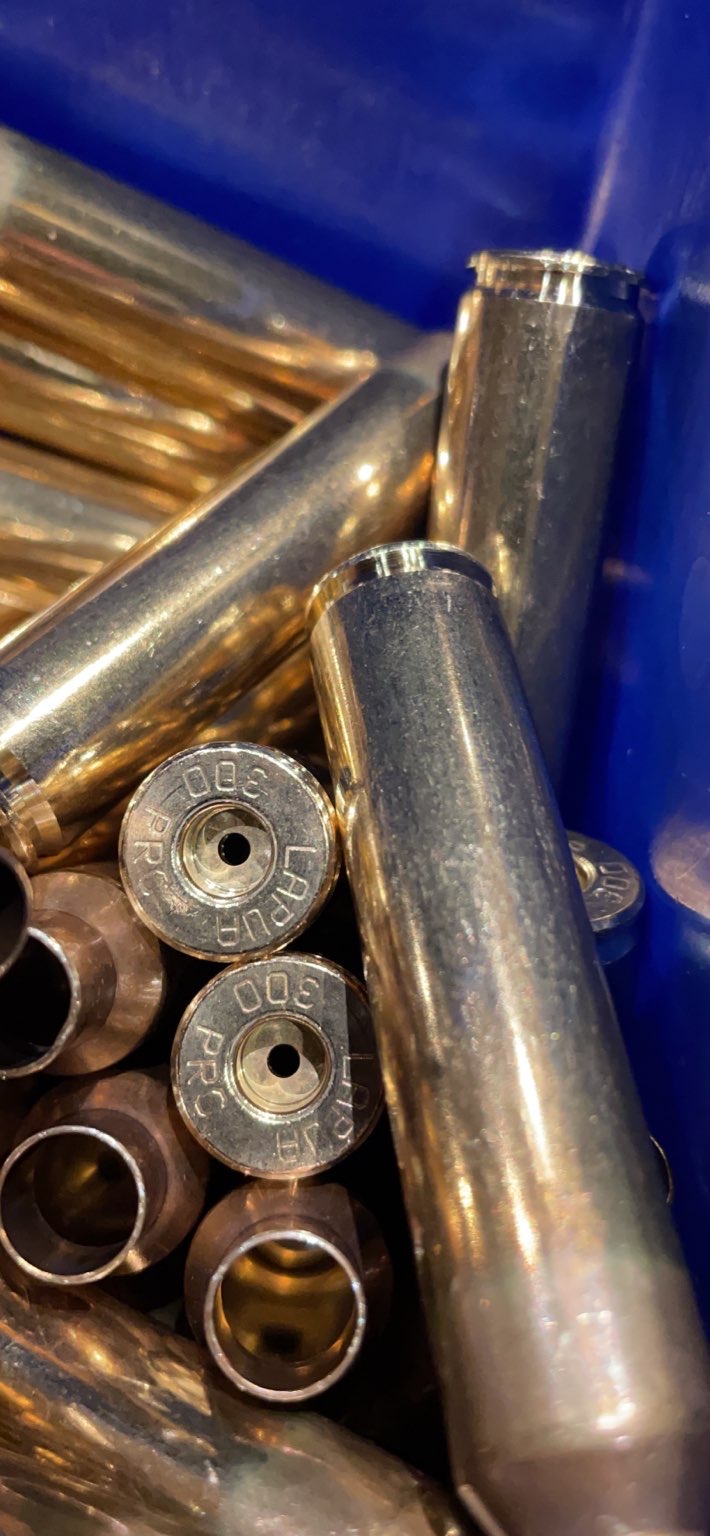

Does anyone have a couple Hornady 300PRC cases that have bad primer pockets they could donate? My brother cannot find a modified case for his 300PRC rifle and I was going to make one for him. I would loan him mine but he lives about 7 hours away so I figured I would drill and tap a case if I can find one and give it to him. I do not have any with bad primer pockets yet and really don't want to use what limited amount I do have that are good.
Thanks
Jeremy
Thanks
Jeremy
Ideally, you would want to make a modified case out of brass fired from the same chamber and bumped to whatever you normally bump it to.
At a glance it doesn’t seem like it would matter because when it’s in the chamber you’re referencing the distance between the shoulder and the ogive when you’re pushing the bullet up in the tool, but when you take it out to measure it and find your seating depth you’re measuring from the cartridge base to ogive, which is going to vary in most cases between chambers.
This is why the modified Hornady cases aren’t ideal and it’s better to make your own (from brass sized for your chamber).
The other idea, which I do because I’ve never bother to buy the obscure tap size needed, is to just note any difference between the modified case and your own cases and account for that difference in your seating depth measurements.
The Hornady tool has some weird threads. When I had one made for 264 Norma the guy had me resize fired brass then he said the tap and die cost a couple hundred dollars to make the threads but he already had one . Then he built a neck expander that would allow the bullet to slide but good fit.Wanted to charge me $5.00 lol. Was way more that I thought was needed. Love watching that old guy mill stuff and make it look easy.
