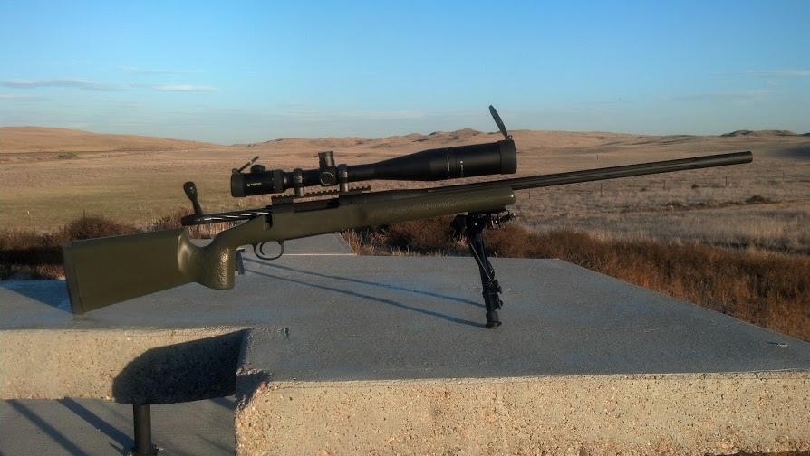

I had a custom winmag built a couple years ago. Remmy action, 1-11" twist 28" rock creek, Manners T2....shoots amazing. Young's guns did the work for me out of sand coulee MT, and i'd highly recommend them. Couple things to bring up. Right now there is a custom action maker out of Gillette WY having a group buy for his custom actions for $750. The Rock Creek I have(Medium Palma) is a work of art. Manners or McMillan either one would be just fine, Manners was cheaper for me. Stocky's has quite a few ready to ship anymore. Overall I love my 300. It shoots 1" groups at 400 yards with 190 Gr Bergers when I do my part, and due to the 11 twist, it's shooting them at 3150 with absolutely no pressure signs. Anyways, here it is...It was exactly what I wanted and once you go custom, it's tough to go back....Good luck on the build!
