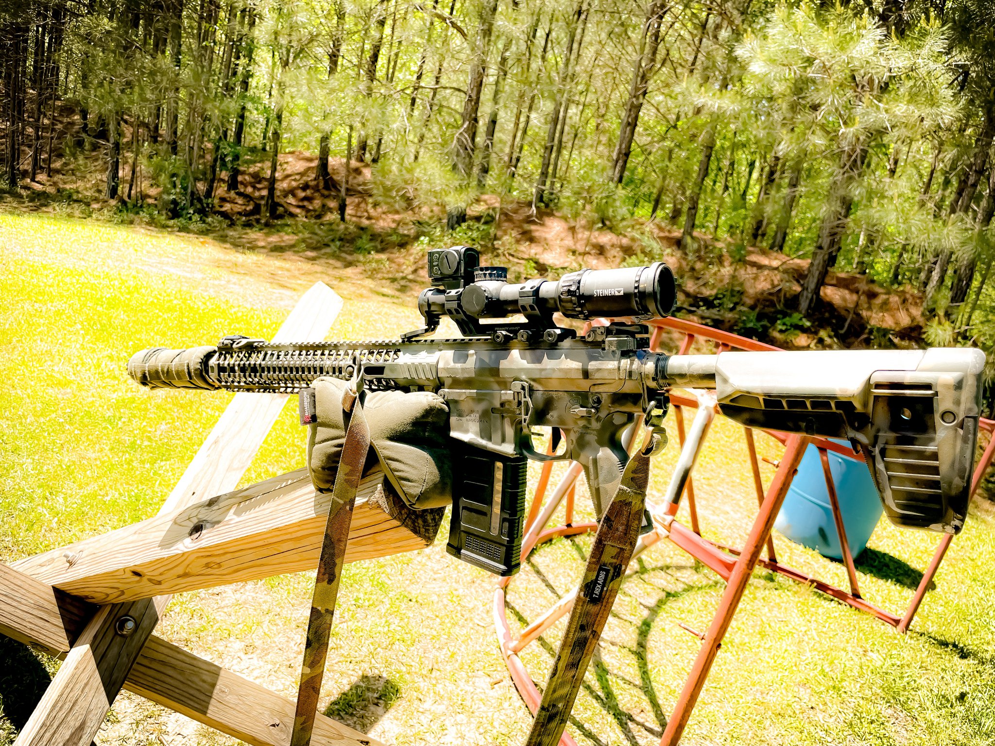

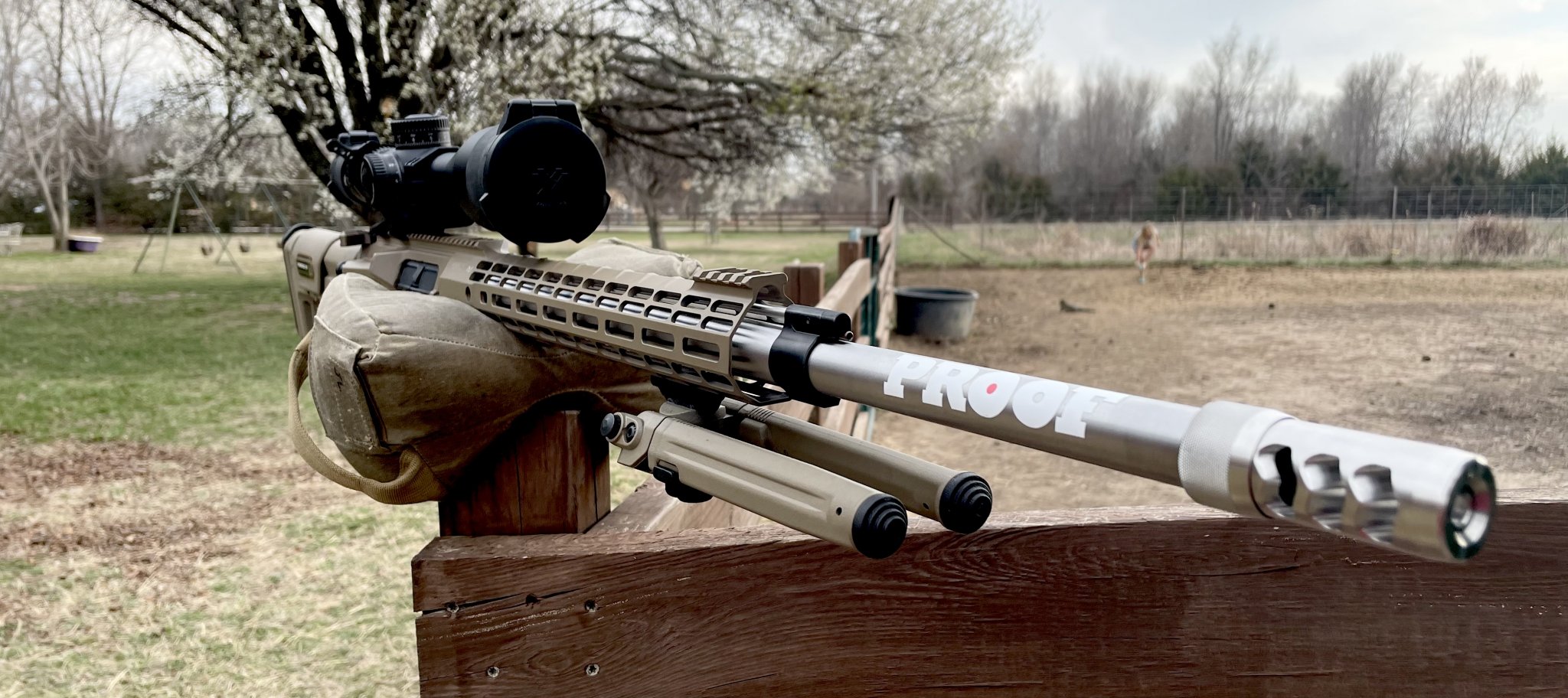

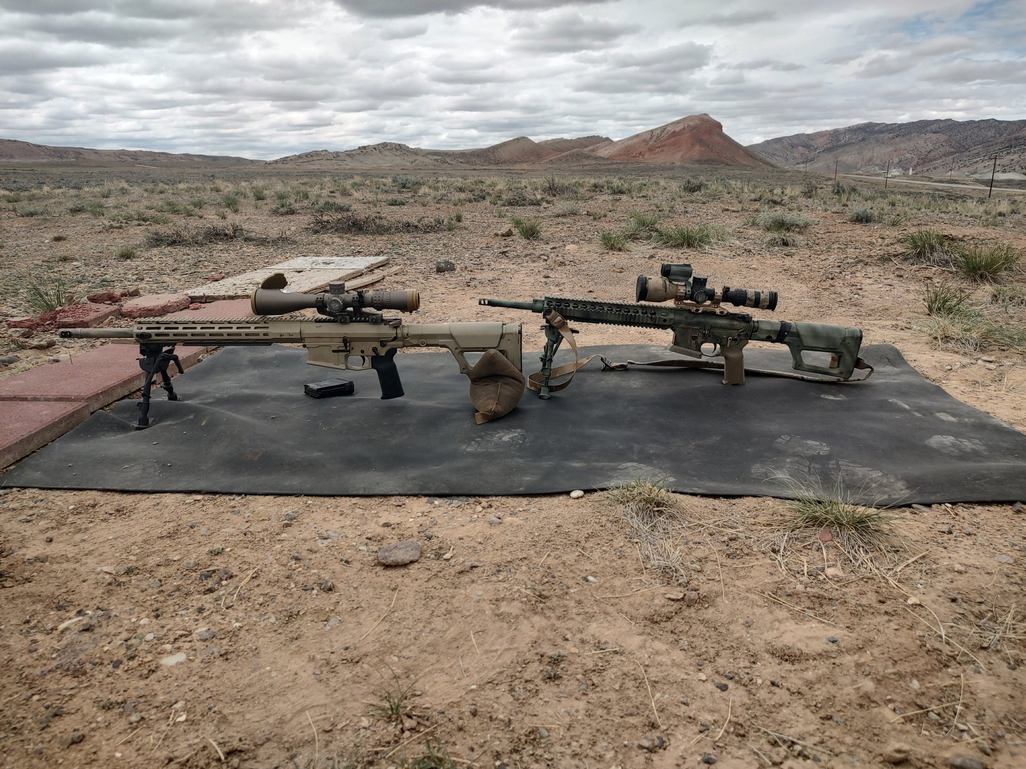

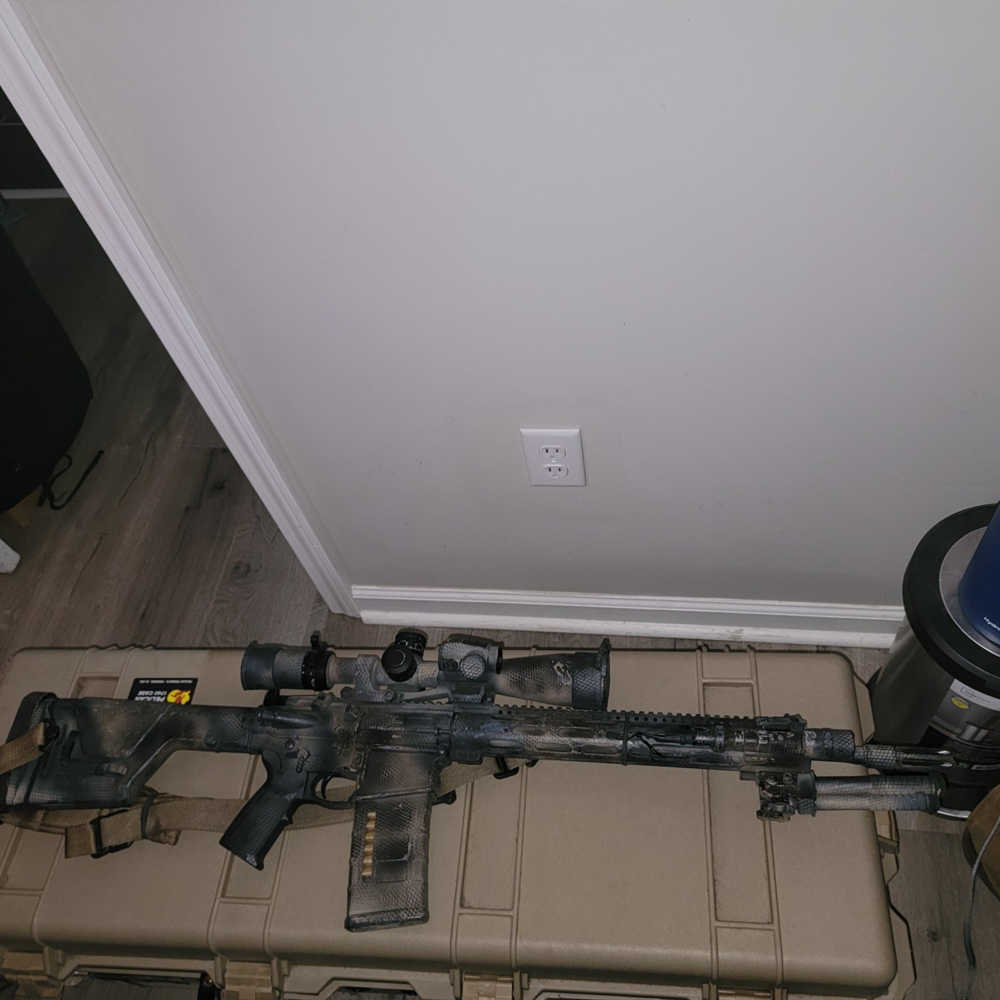

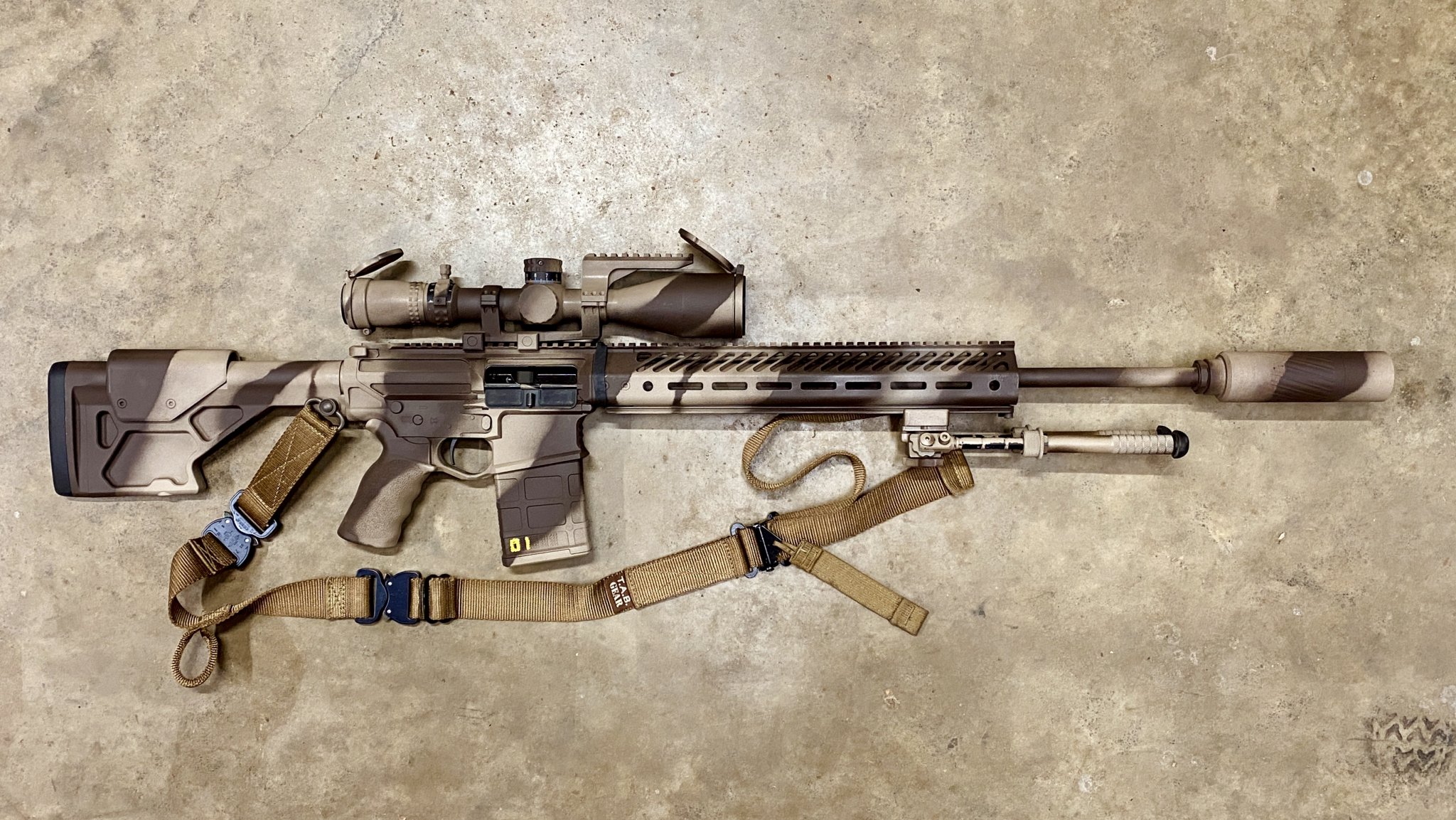

Here's my M&P10. Names Beatrice after my grandmother who raised and protected me all my life. She was a gift from my lovely wife.
Magpul PRS stock
Magpul MIAD grip
Radian Raptor CH
Geissele SSA-E trigger
Midwest Industries rail and gas block
Vortex Viper gen2 5-25x50 MRAD on a Vortex mount
Vortex Sparc Solar red dot on a Vortex offset mount.
Magpul MS1 sling
Surefire 640 light and pressure switch
Atlas BT10 bipod
Complete with an absolute shit rattle can job View attachment 8095315
Absolutely nothing wrong with that camo job.
Looks fine.

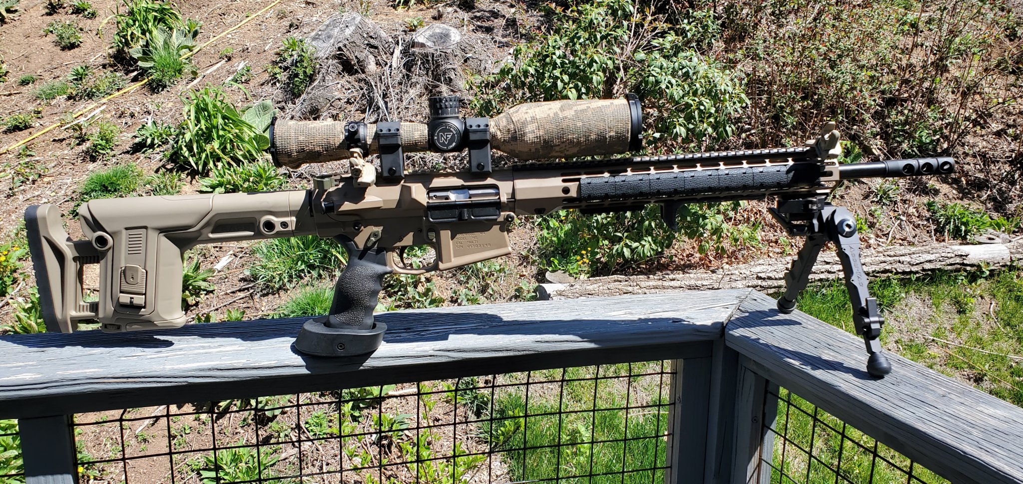

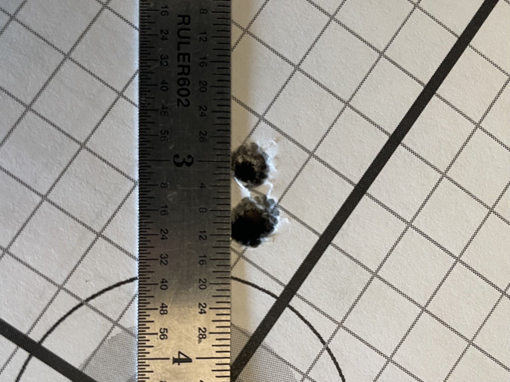

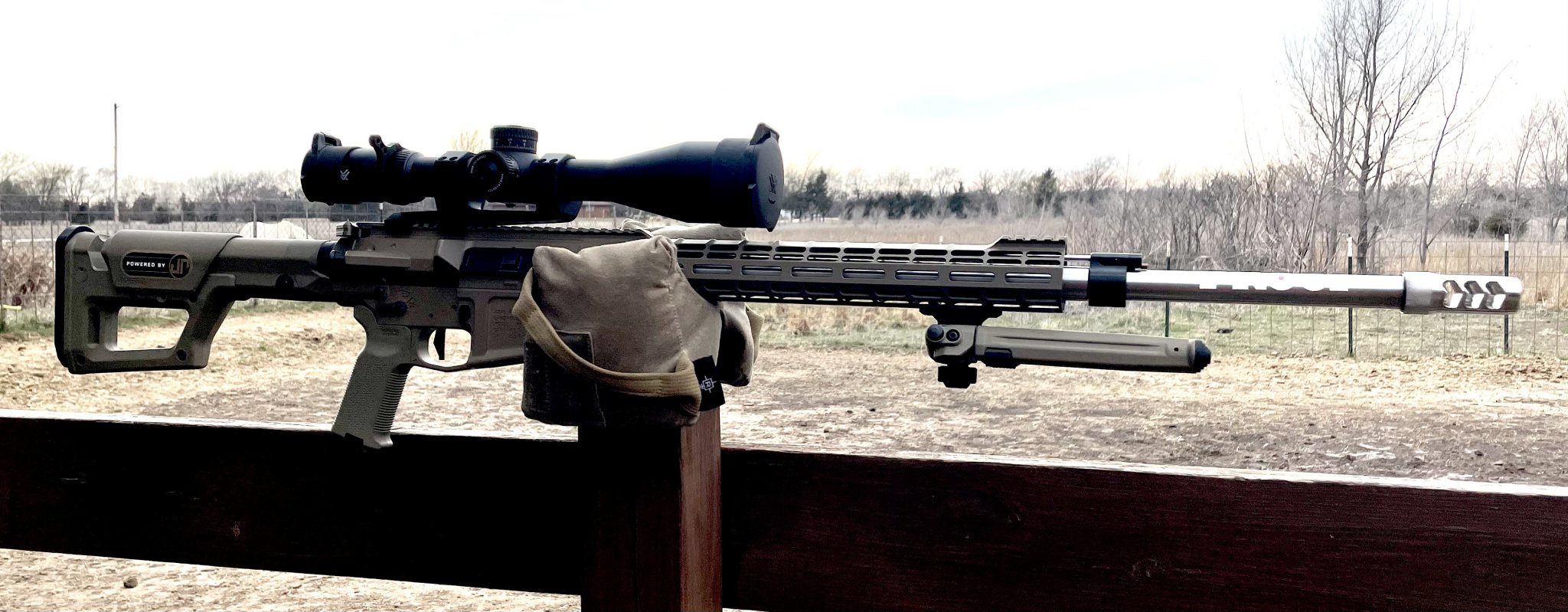

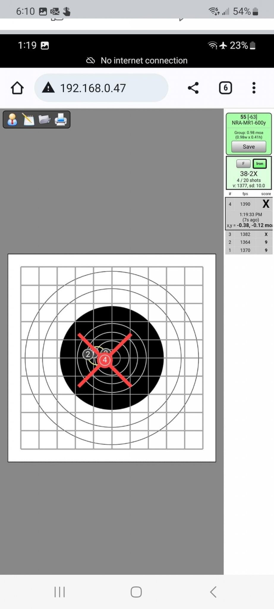

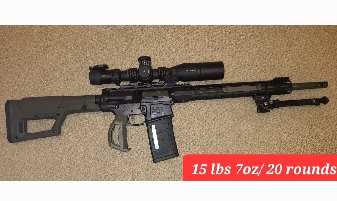

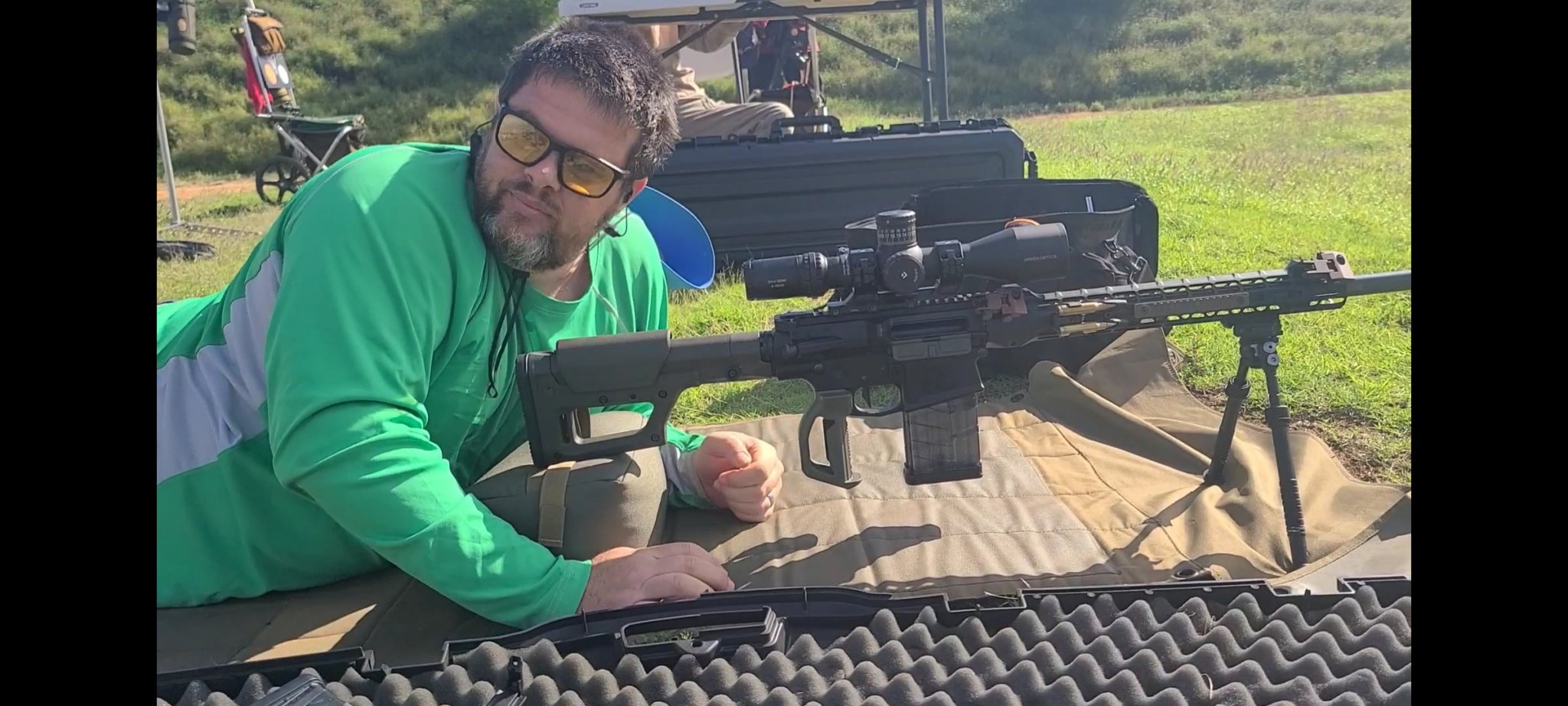

AR-10 DMR

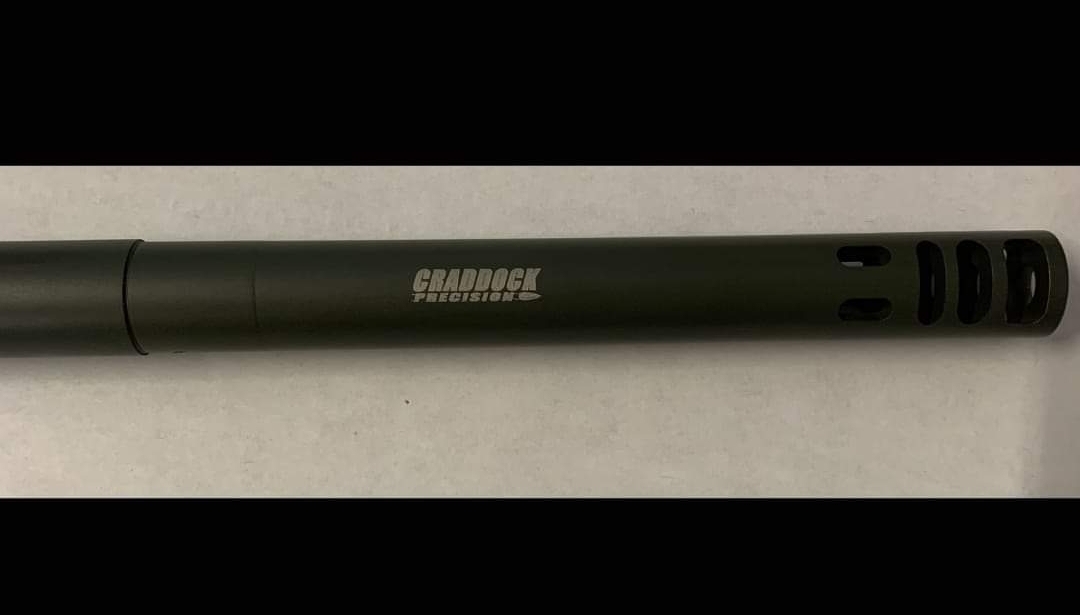

• 18" custom Bartlein barrel/ OD green cerakote and blended muzzle brake (turned by Craddock Precision)
• Superlative arms Titanium adjustable gas block 10 clicks on restrictive mode
• JP Enterprises Fmos bcg (having issues)
• Aero Precision M5 upper, Receiver face trued and lapped then set with loctite 620
• Aero M5 lower
• aero S-one Handguard
• Magpul PRS Lite stock:
• 3.4 OZ Buffer weight
• Springco Orange spring
- Carbine length buffer tube
• Geissele Super charging handle
• Large grip, Anarchy Outdoors precision
• LaRue MBT2 trigger

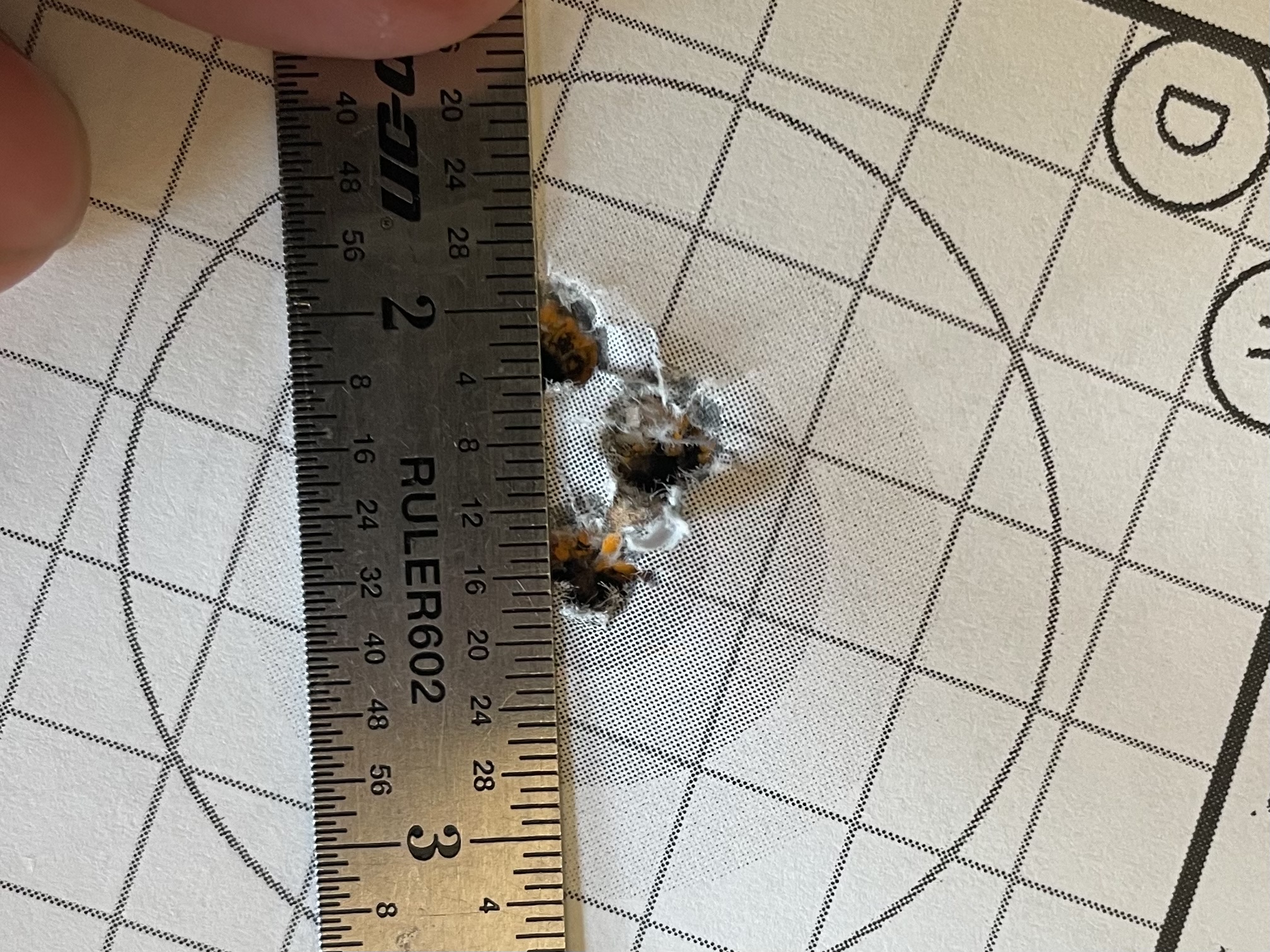

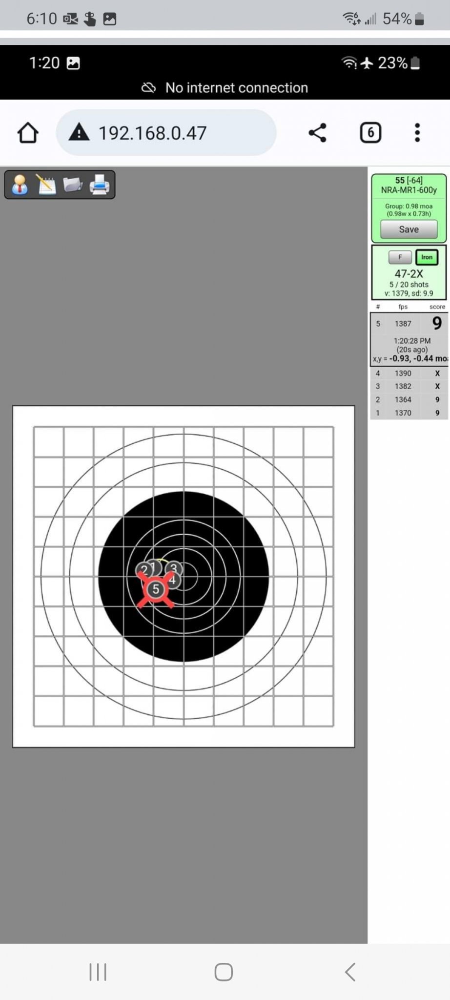

I'm a newer shooter, and was still able to consistently hit Sub MOA at 600 yards with this rig.
Working with Craddock Precision to get my 18" Bartlein barrel was a phenomenal experience.... great team over there.

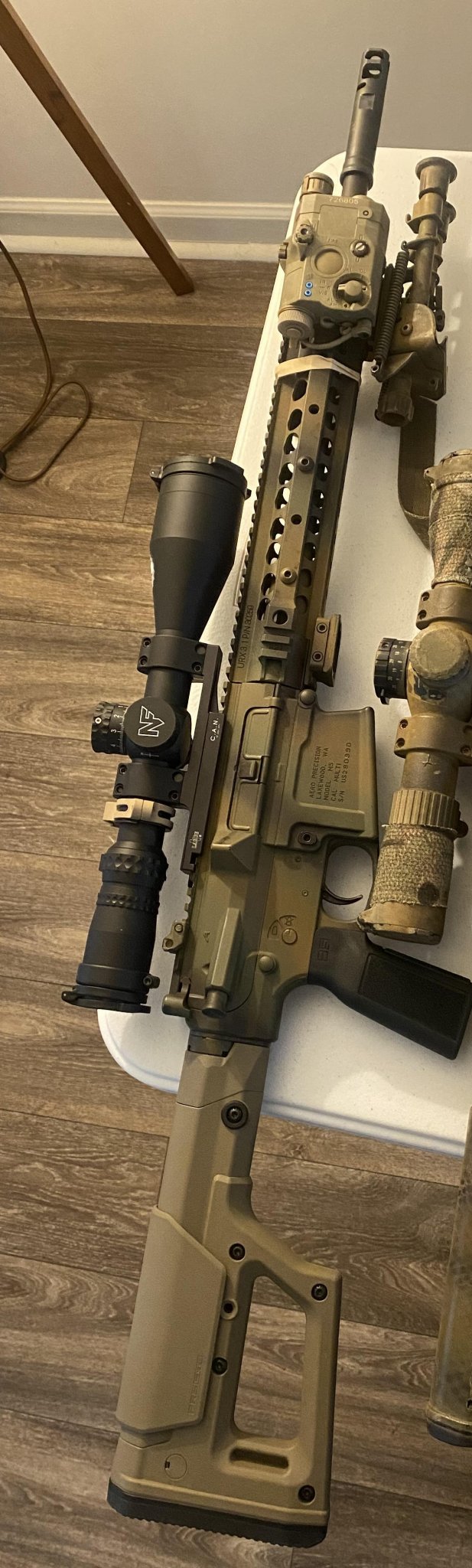

Bought my first Armalite 308 in '08.
Didn't like it, so it sat in the case, neglected for many years.
Didn't like the carry handle, didn't like the Kenner SSP style charge handle, and didn't group worth a damn.
Then china bug happened, and the plant I worked at shut down for nearly 2 months, and I figured what the hell, I'll make it into something I did like.
Had been trying for years to buy a flat top upper from Armalite, and they never had any in stock.
So disassembled it, and went after the carry handle first. After machining it off, made a custom rail that saddled down over the upper so it was at the same height as the front tube.
Next was to rid it of the SSP charge handle, and picked up an FAL handle, and some steel stock, and made it into a non-reciprocating set-up.
When it was all the way down to pieces, found one of the accuracy issues, the pinned & welded brake was hiding one of the worst damn muzzle crowns I had ever seen in 50 years playing with firearms!
It looked like it was done with a hand drill, using a dull countersink bit, scored, and off center.
Pretty sure this thing was slapped together at Armalite, and they figured that once the brake was on, no one would ever see that horrible workmanship.
Same went for the front of the upper, wasn't square with the bore by at least .005". No wonder I had to have thee rear sight cranked almost all the way off to one side.
Anyway, re-crowned the barrel, trued the front of the receiver, and bedded the barrel.
Now it shoots pretty damn well :).
And as you can see, I like my front sights at the front of the barrel. All my ARs are built this way.
Glad that I didn't trade the old girl in 20 years ago.

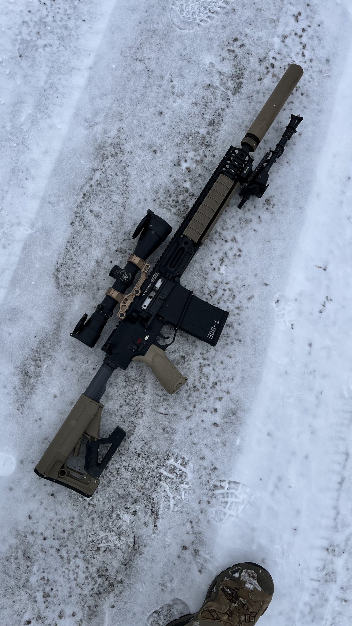

I'll play. Just got my upper back from d.wilson. They did a great job on my KAC URX install. This is a 1moa shooter all day long, maybe better for someone more seasoned at shooting gas guns than me.
Edit: don't hate on my 10x SWFA. After 1.5 years I have not decided what optic I want for this rig and the 10x I've had lying around as a "test scope"
Reactions: BigBabyMoses06
There's relatively little standardization in big block gun components compared to that we enjoy in small block guns. Sometimes you end up with a combination that works. Sometimes you do not.
I've used KAC big block rails with SR-25/DPMS pattern receivers.
Some KAC stuff doesn't even work with other KAC stuff. I've had to hone out KAC URX barrel nuts - just to get them to fit over first generation KAC SR-25 barrels.
I love the look of the URX 3.1's, best looking rail IMO.

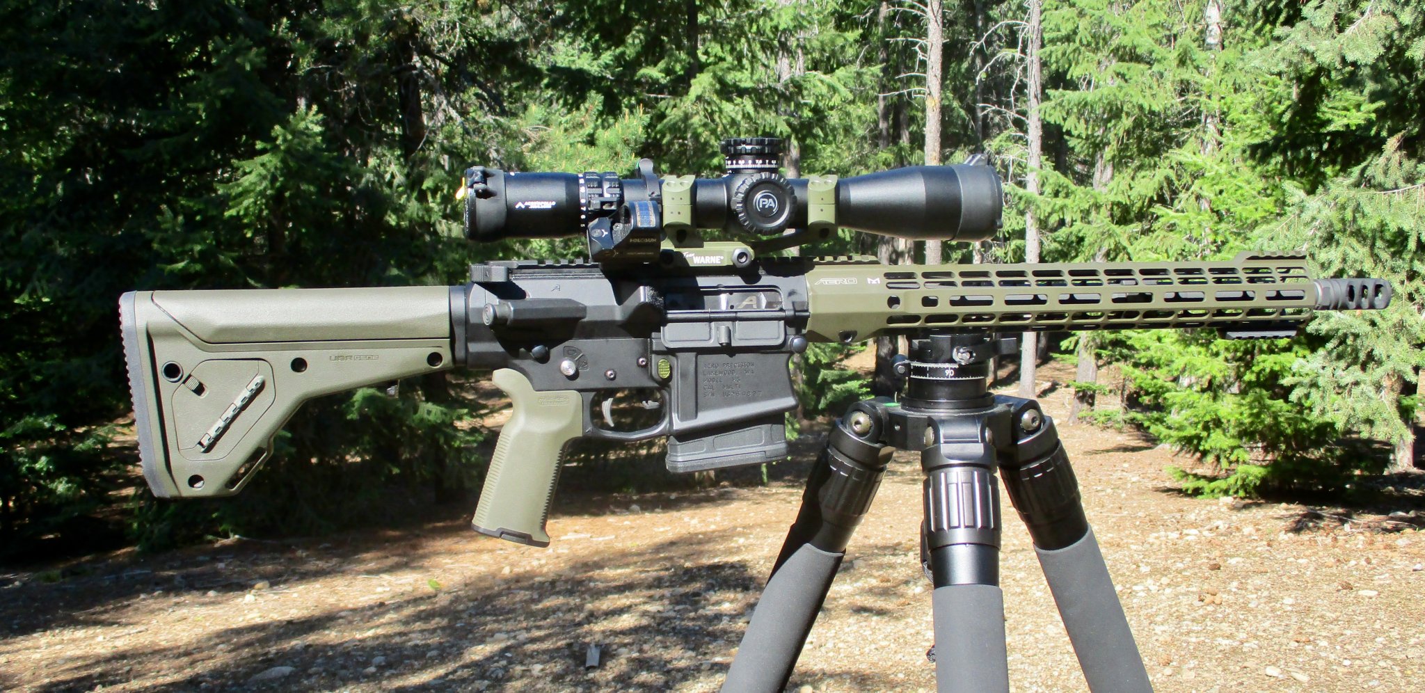

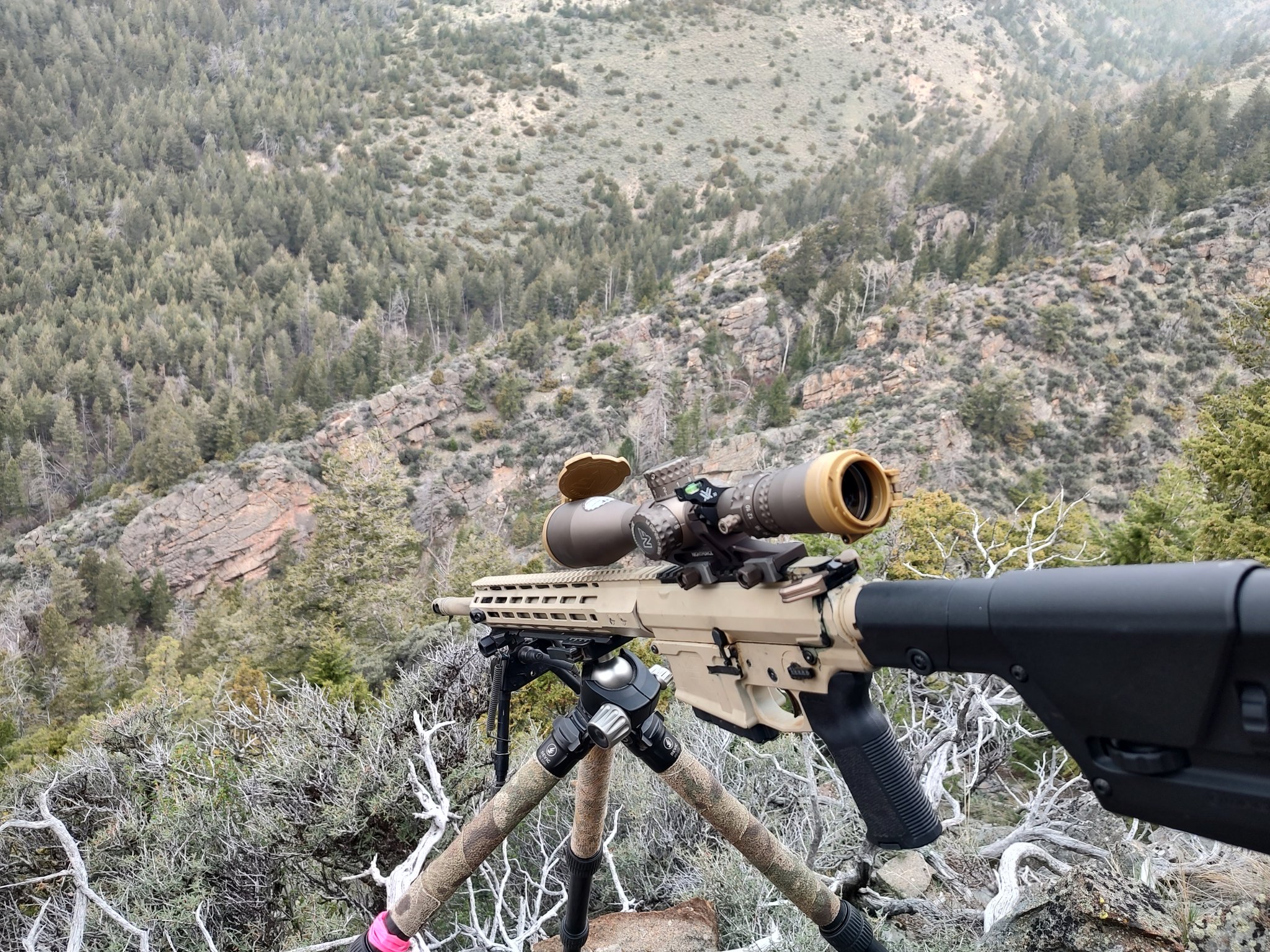

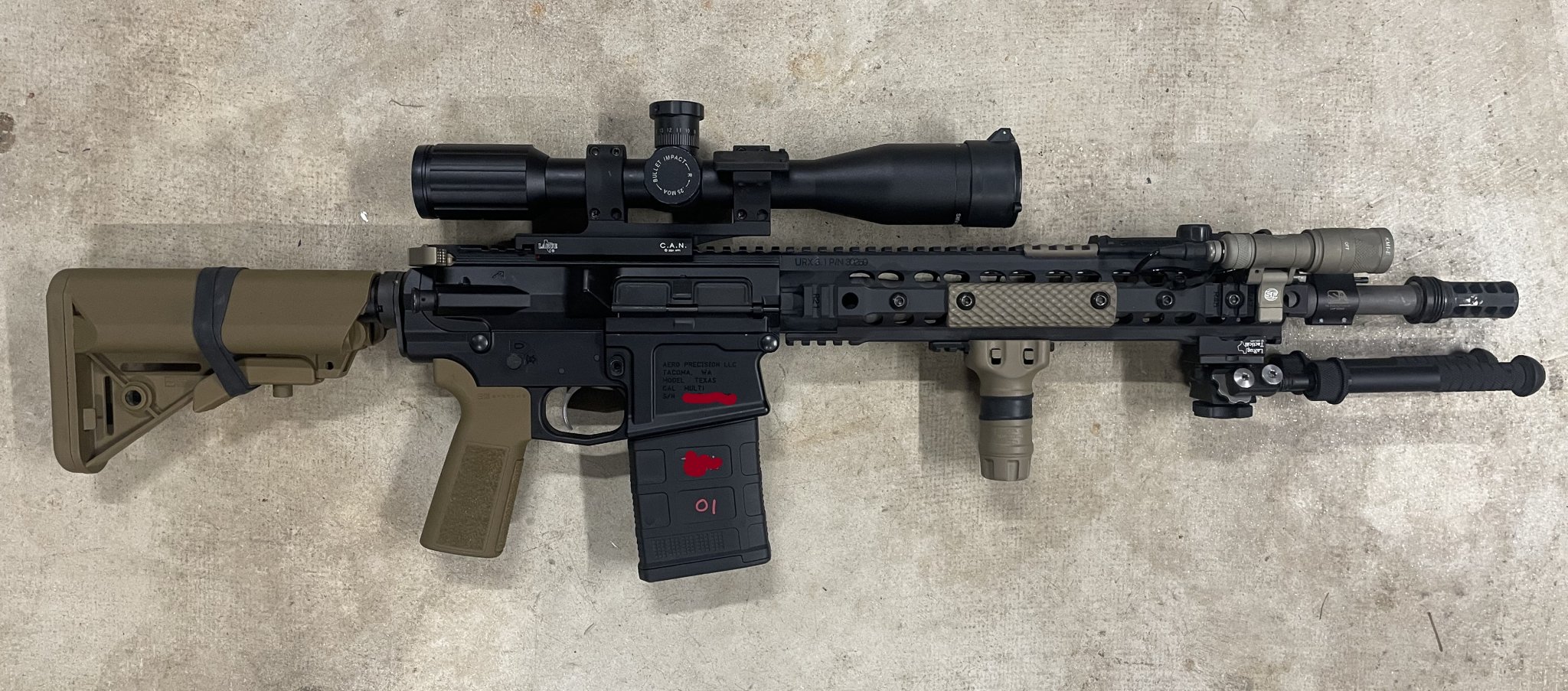

Aero Lower and Upper
Criterion 6.5 CM 18" Rifle Length gas barrel with SF Brake
Gas Buster CH & Rubber City Armory BCG
KAC URX 3.1
superlative arms adjustable gas block
NF NX8 4-32 MIL XT in a larue CAN with accuracy 1st bubble level
Geissele SSA-E
JP SCS
PRS Lite

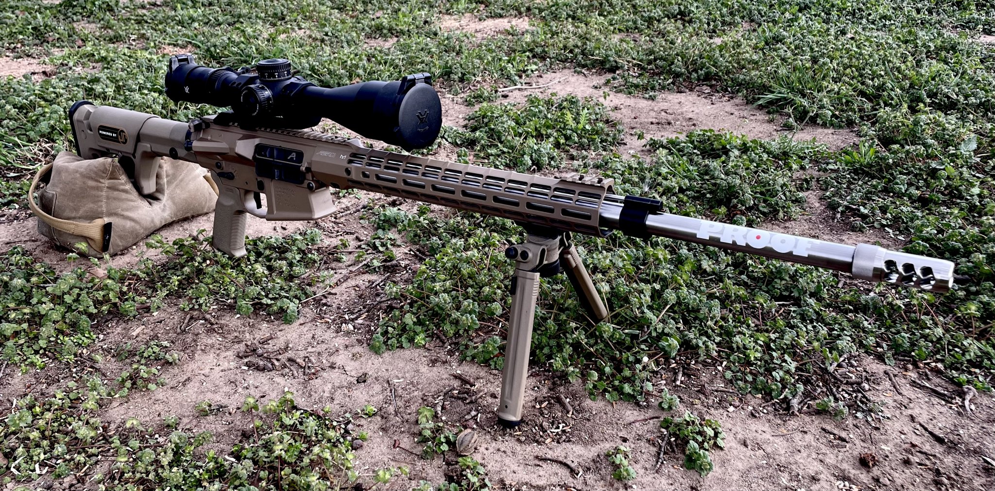

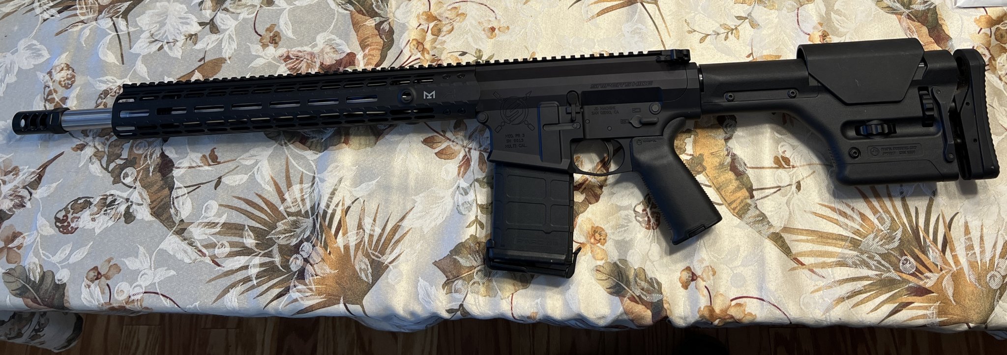

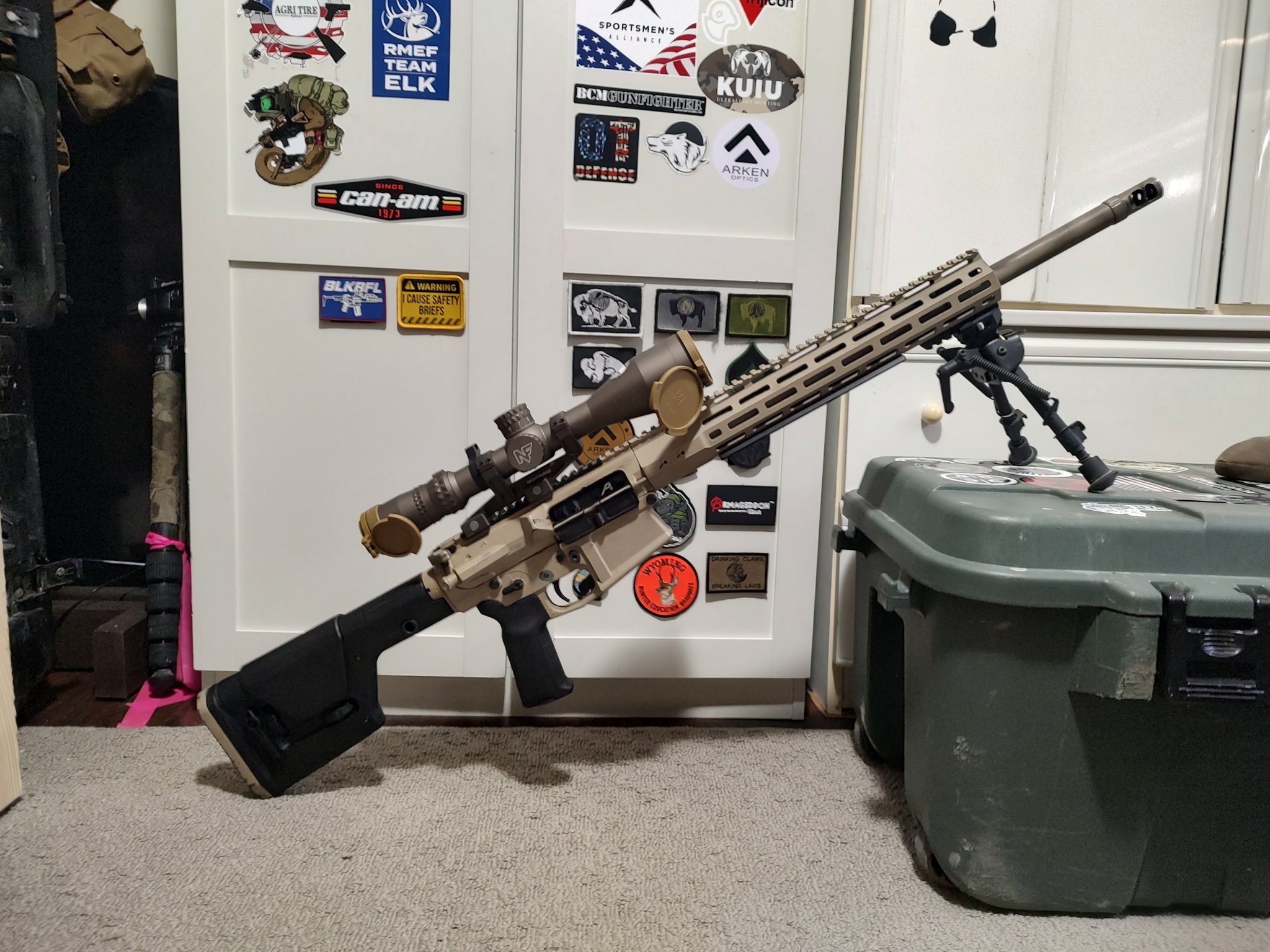

Aero upper/lower/BCG, small charging handle
Ballistic 20in stainless 6.5, didn't realize this was a 308 thread....
Wilson combat 15in handguard
PRS stock
K2 xl grip
Gunwerks brake
Aero adjustable gas block
Ssa-e
NF ultra mount and 4-32 nx8 mil xt
Magpul arca and pic rail
Harris with arisaka rail slider

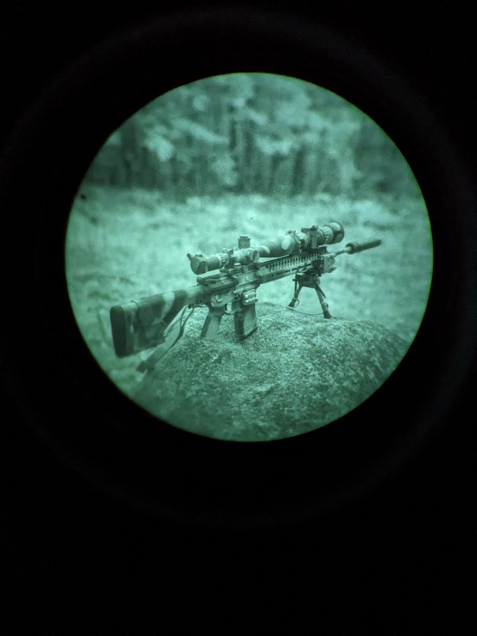

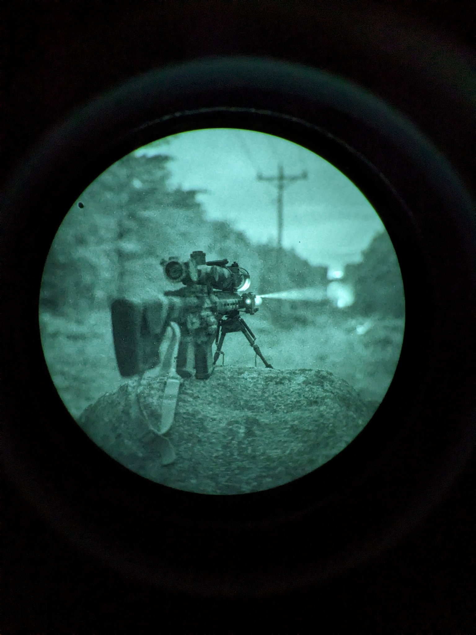

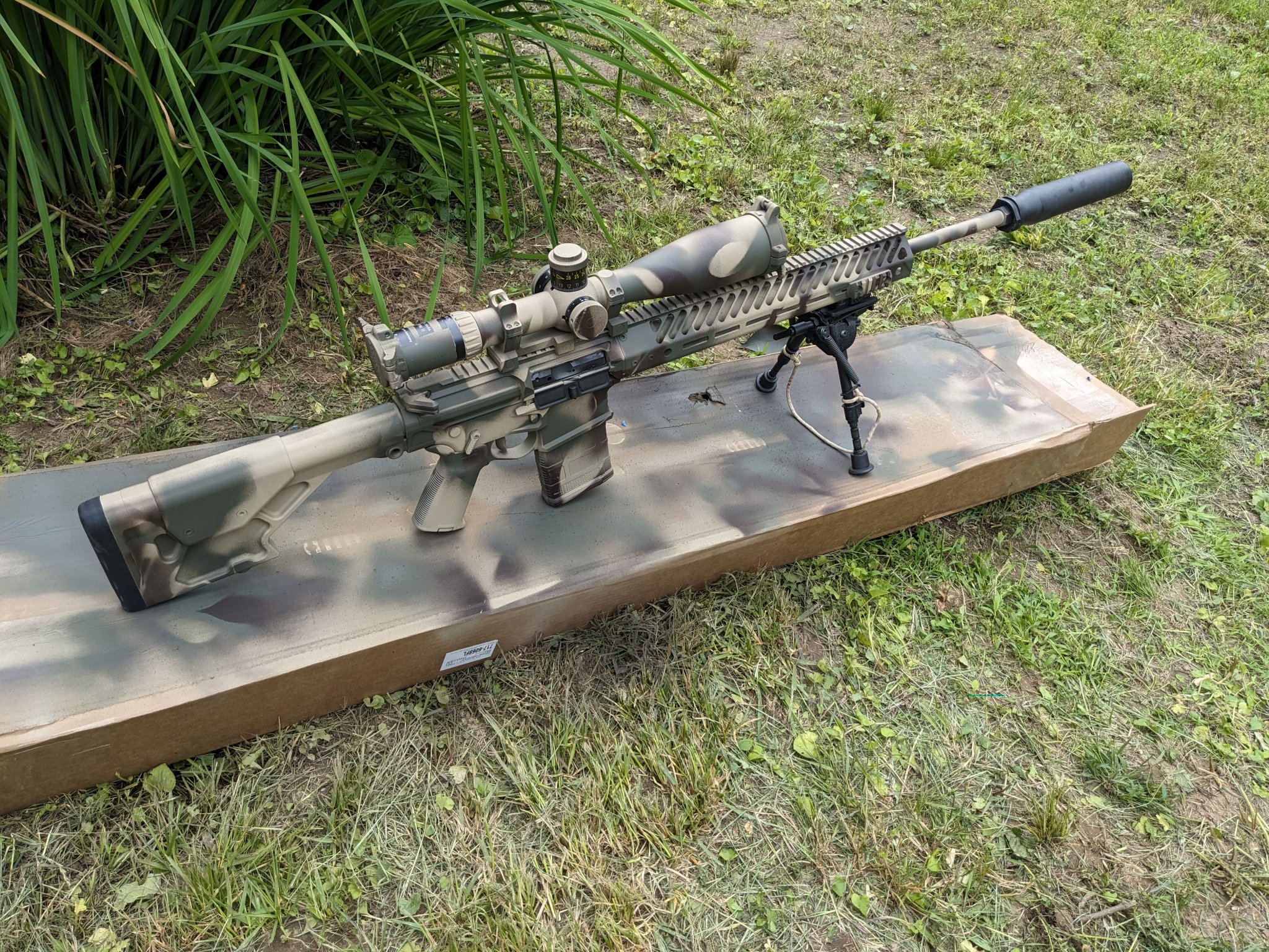

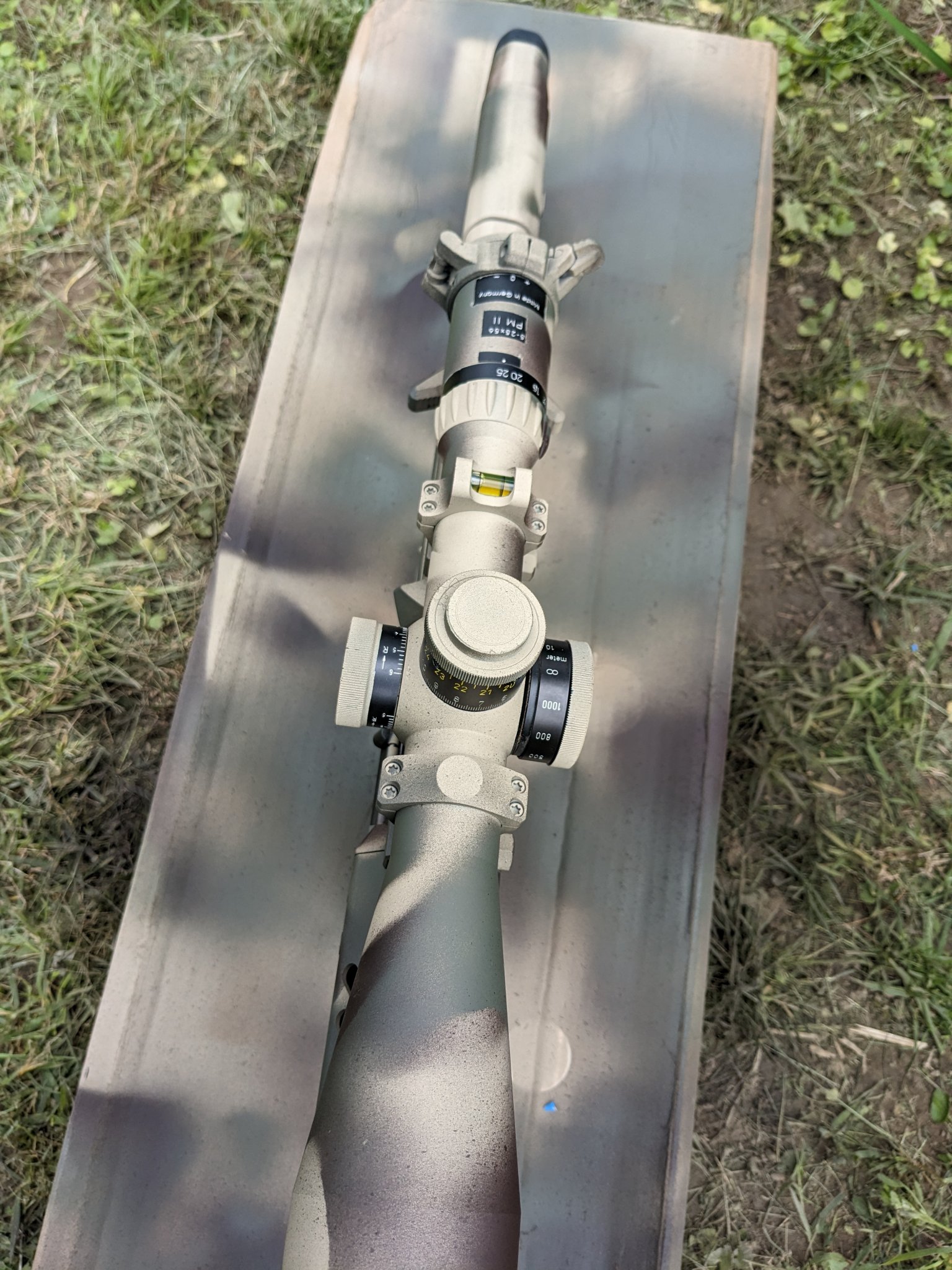

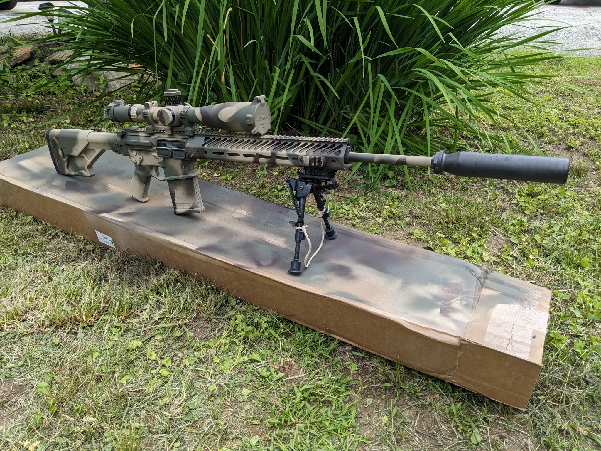

Seekins SP10 (Gen 2) 6.5 CM
Factory 22" Rock Creek Barrel
Geissele SSA-E
Aero Ambi Charging Handle
S&B PMII 5-25 T3
Freshly kryloned in a 3 color Rust-Oleum.
Loves 42gr of H4350, Hornady Brass, Federal Large Rifle Primers (non match), and 140ELDM bullets. Velocity in NH is about 2720fps with the load. Shoots 3/4MOA groups from prone. I don't think I have seen it over 1MOA in the 500 rounds through it.
Geissele SSA-E
S&B PMII 5-25 T3

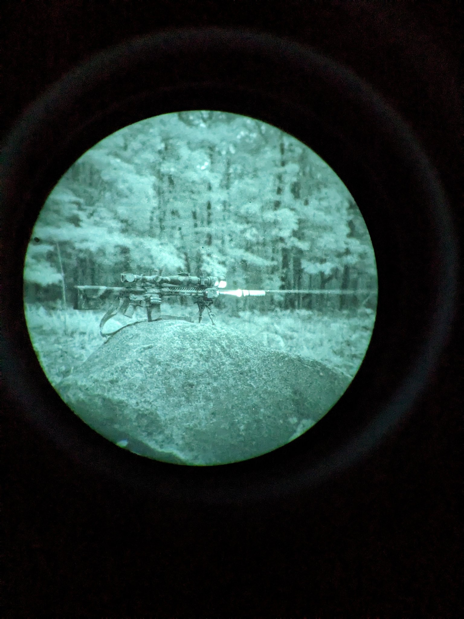

Follow up photos under NV through an L3 white PVS14 and my shaky phone.

Its a SIG can, no?
Yup! The 762Ti QD I think.
Is the PVS14 a helmet mounted or rifle mounted setup? Pretty sure you can actually do both with those right? Plans to mount it on the rifle and smoke some hogs at night?? Always wanted to do a nighttime hog hunt man, that shits legit. Some guys we lease out land to have NV kit they run while setting up over bait.
You can mount a 14 to a 5.56 (nothing more for recoil), but would highly recommend against it.
1.) To scan you are going to be aiming your rifle at everything.
2.) You can’t put them behind magnified optics.
3.) A red dot or similar may “burn” a permanent black spot into the tube even on a NV setting after extended use.
I would helmet mount it and find a laser to mount. Even better, helmet mount a 14 of goggles (much easier to move around with), then put a thermal on the rifle. Even with super high quality tubes, sh*t blends together really quickly outside of 100 hundred yards (animals have great natural camo). They can’t hide from thermal.
I had no idea you would burn in a black spot on mounted pvs14. Makes sense though.
To be safe you would only want to turn on the dot (again even on NV settings) when you are about to engage targets. Or do the same with the 14. If you out there scanning with it on a rifle (not ideal) for extended periods of time, you will likely regret the blem in the tube.

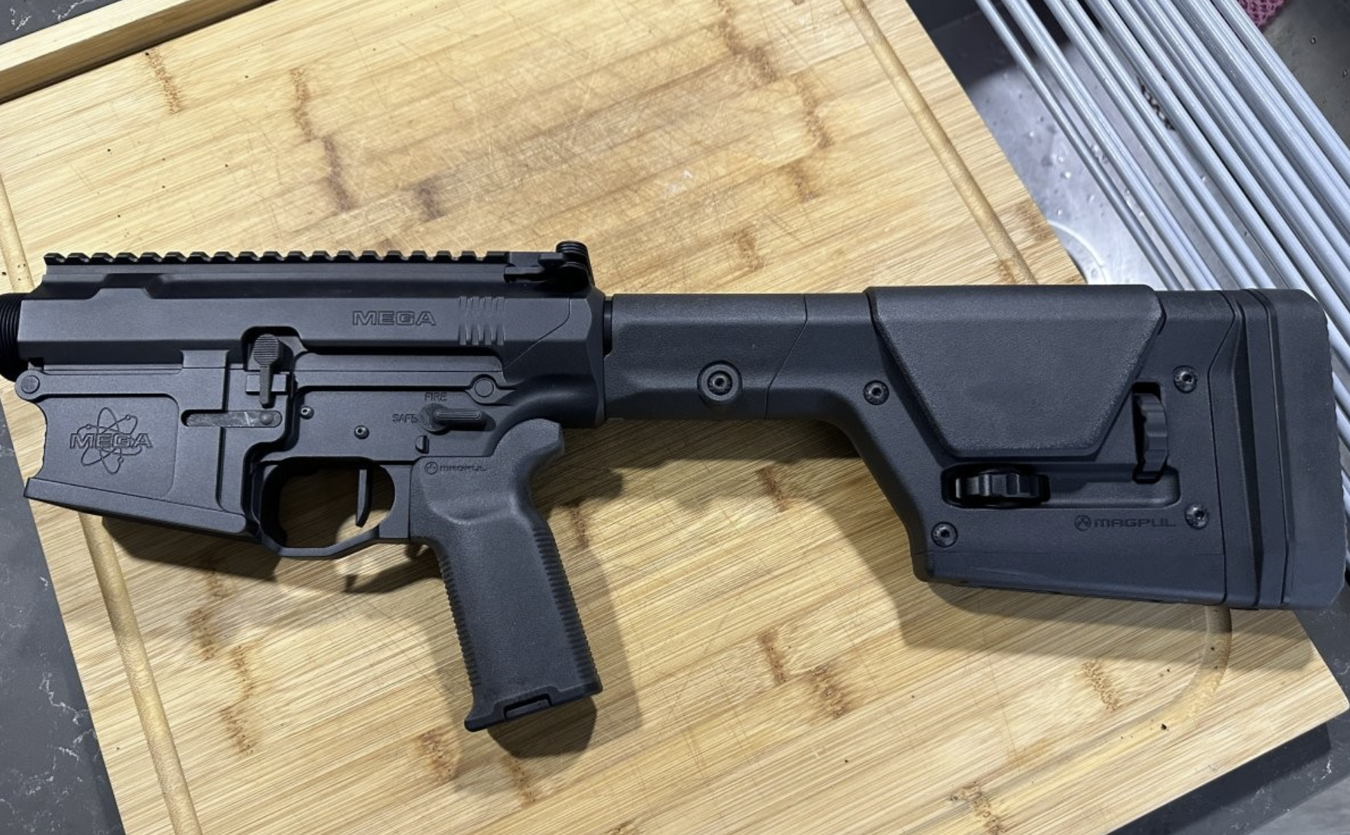

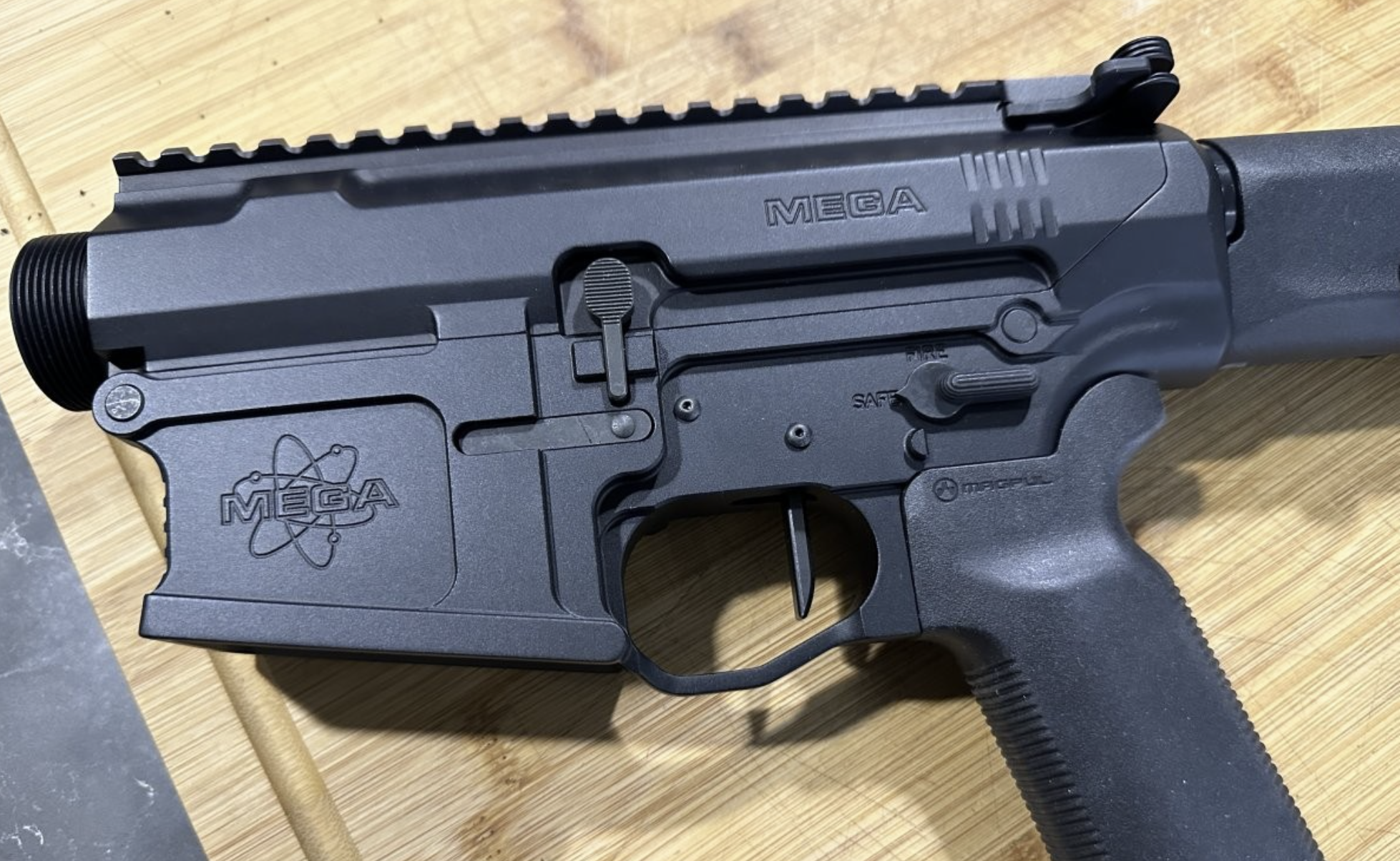

Picked up my first AR10 today - a pre-merger MEGA Maten receiver kit. Came with an RPS trigger as well - prior 308 experience was with a PTR91 and then a SCAR17.
Honestly torn if I want to go mroe long range ( not many around me to make use of ) or more battle rifle type. A P&W 13.7 sounds like a bundle of concussive fun :)
Now to find a DPMS High handguard
