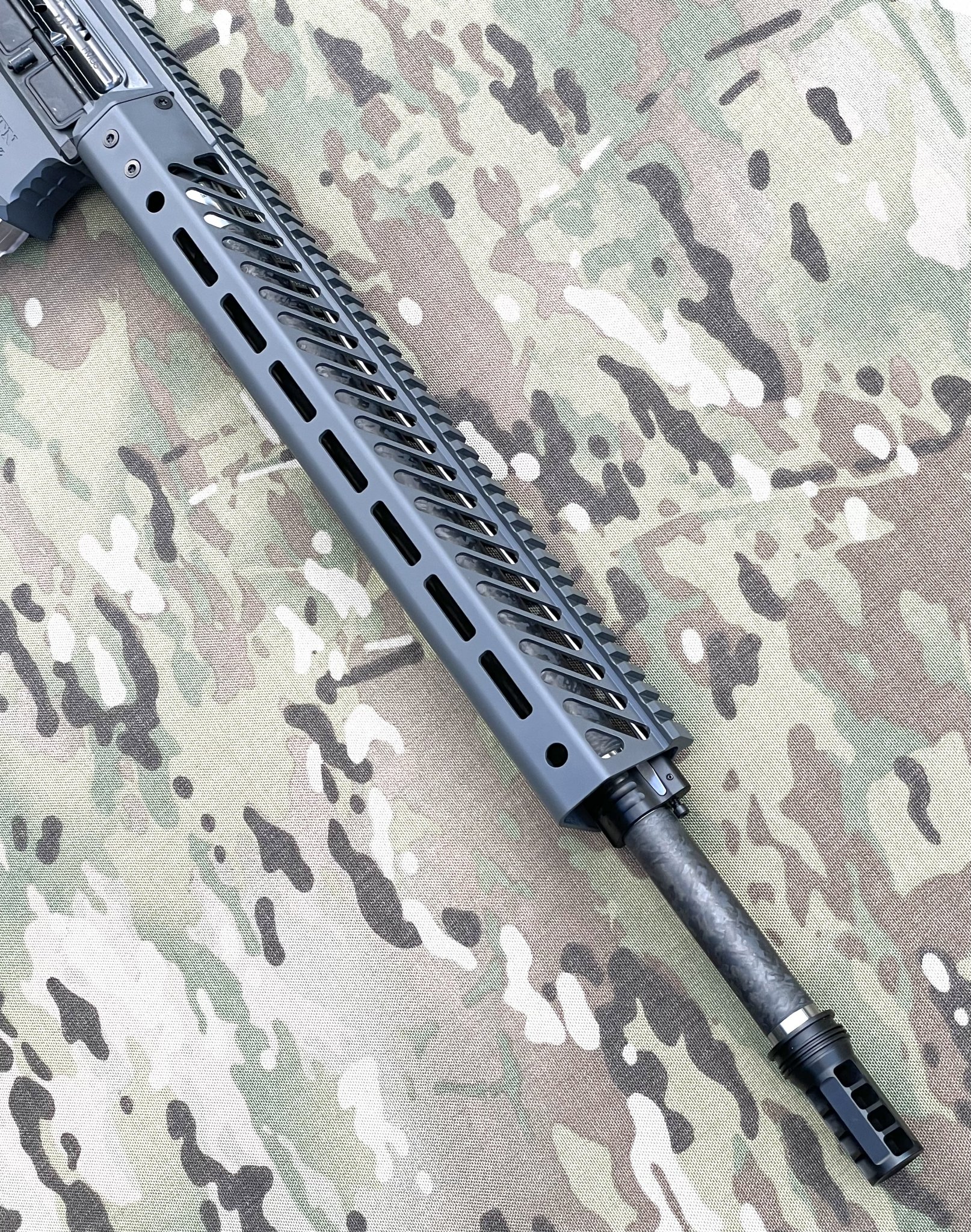

This is my poodle shooting mainstay, a .223 Wylde Turnbull TAR15, 18" JP Supermatch button rifled high polish 416R stainless steel barrel with 1:8 twist and rifle-length JPGS-9D adjustable gas system, JP Mk III modular 15.5" hand guard, JP EnhancedBolt individually head-spaced to the barrel and FMOS Bolt Carrier, JP original trigger and adjustable reversible ambi selector with standard profile levers, JP Gen 2 AR-15 silent captured spring builder in a locked Fortis LA stock; Radian Raptor ambidextrous charging handle; Featureless Arms Liberal rifle grip; Ultradyne C4 Dynamount Folding Front Sight, Athena Linear Comp, and C4 Folding Rear Sight; Aimpoint Micro T-2 2MOA Red Dot Sight and 3X Magnifier in a Twist Mount.

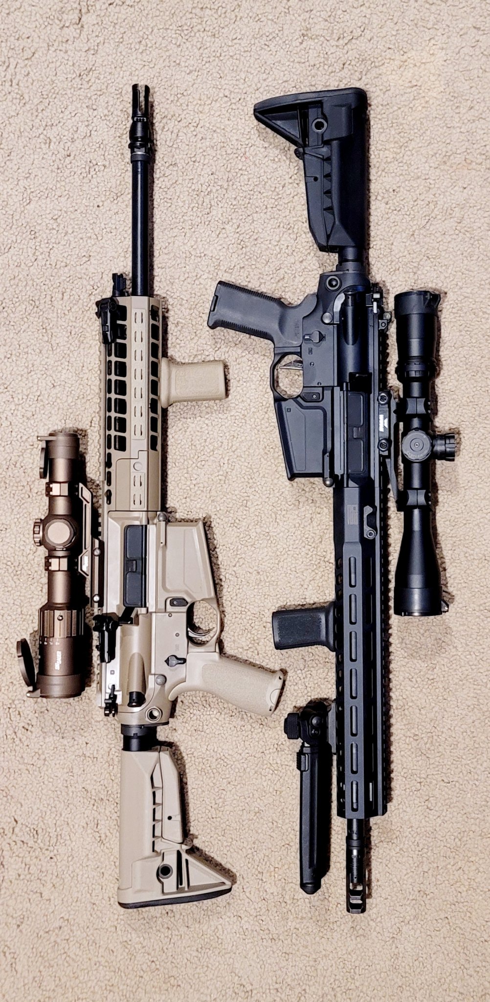

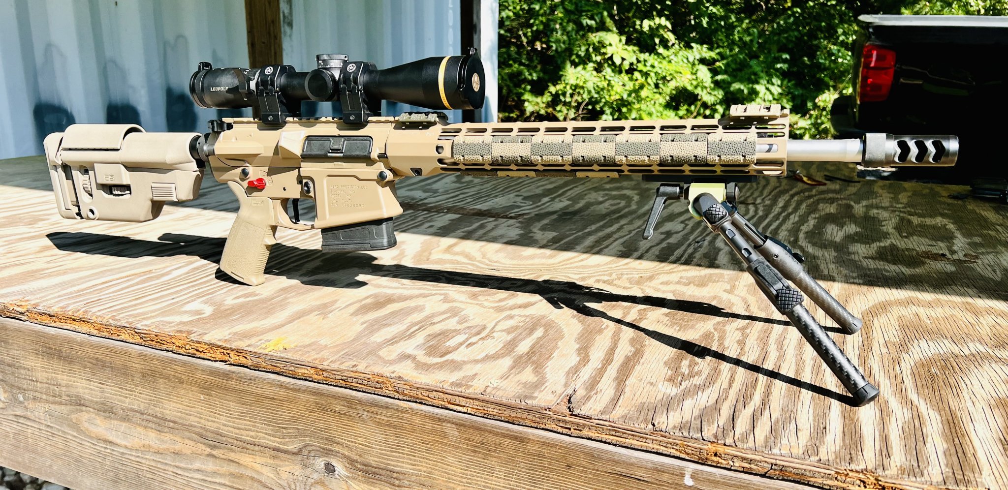

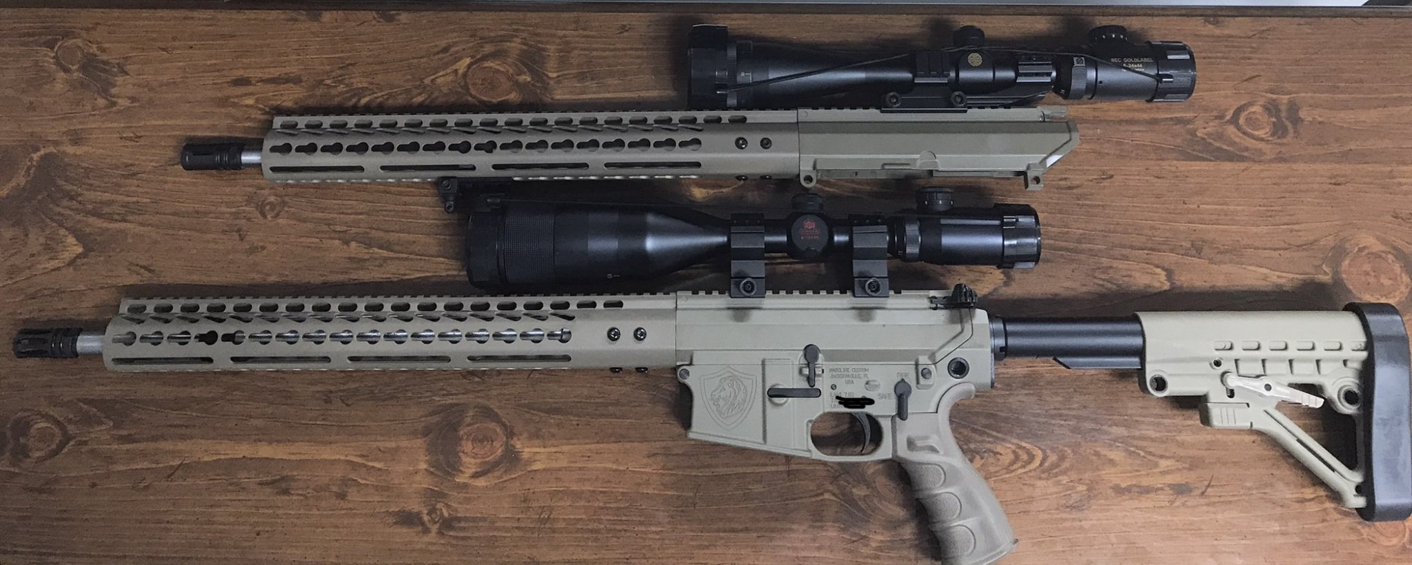

Placeholder for better pictures to come after parts arrive. I recently installed an EFAB on the AR10 pictured on the right and added an FCD PMA and RMR as my offset for the TA01B. The other 50 shades of FDE is being rebarreled from a Nemo 20 inch in 308 to a BA 18 inch in 308. The Aero M5 barrel nut needs new shims to properly torque to the correct timed position so right now the upper has been stripped waiting for the shim pack from Aero to arrive.

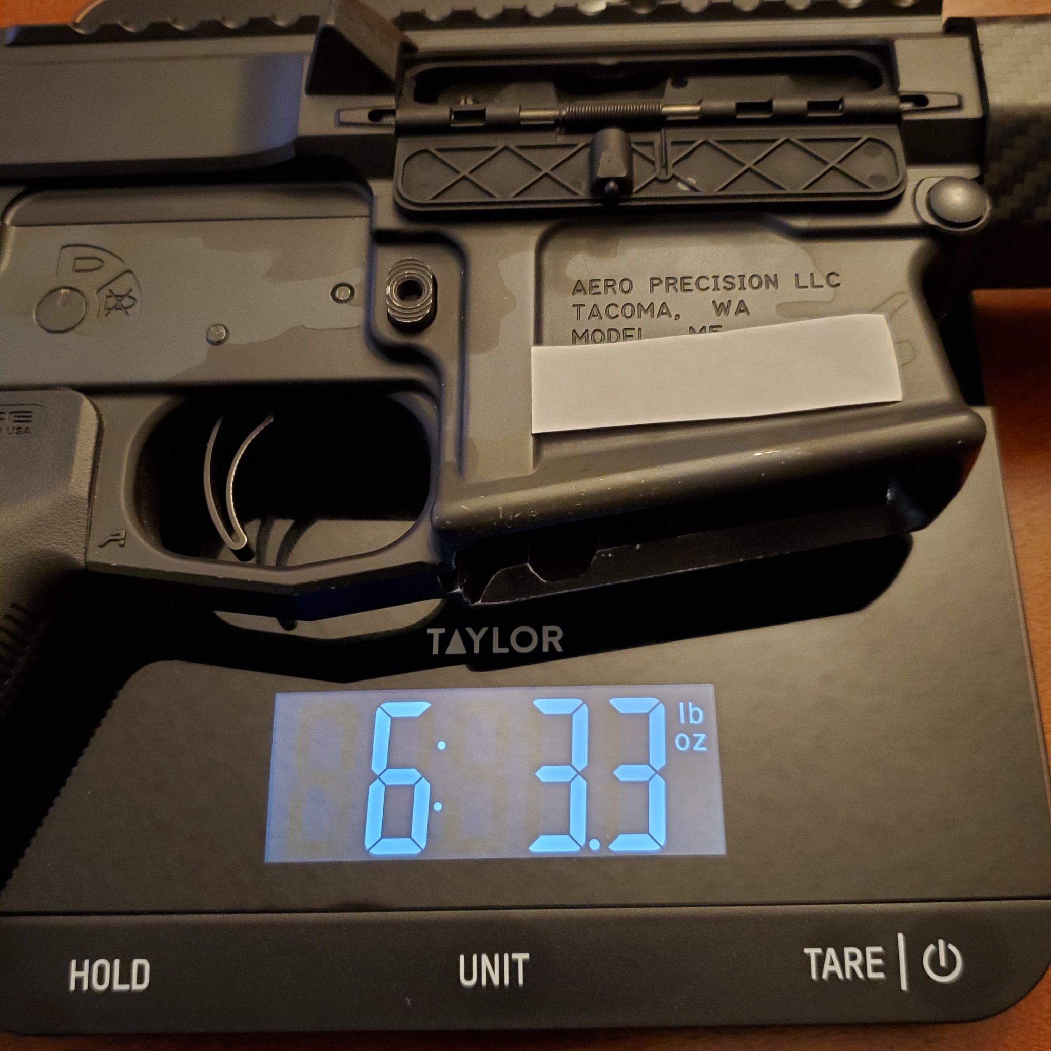

I have heavy AR 10s so I decided to build a light weight one, but accurate if possible, in 308. This one is 6 lbs 3 oz no scope. And it does not have a pencil barrel but a heavier profile fluted 16" barrel, to keep rds on target. Carbon fiber hand guard, 1 oz titanium brake, Roam magnesium upper, titanium bolt carrier. To finish it off with a Leupold Mark 4 M3 3-10X mil dot with appropriate 30-06 180 gr elevation turrent to match trajectory and Warne 20 moa ultra light mount, for 1200 plus yds. Total weight, ready to hunt 7 and three quarters lbs. A delight to carry, feels like an AR 15. Already have some good high velocity loads, in the .5 to 1 moa 5 shot group range...will be testing other bullets, like the 169, & 177 SMK, & 168 gr eldm. The 168 gr Berger 2687 ave 11.4 S/D is very accurate shooting 5 shots half moa, the 150 gold dot 2813 ave 9.4 S/D 1 moa, as well as the 208 Eldm averaging 2442 fps 13.3 S/D fast for a 16" barrel 308. Got some fast velocities with 155 gr to 2900 fps ave but the accuracy was not there..lower or change powder for the 155 grainers, and recheck. Just another project to play with...

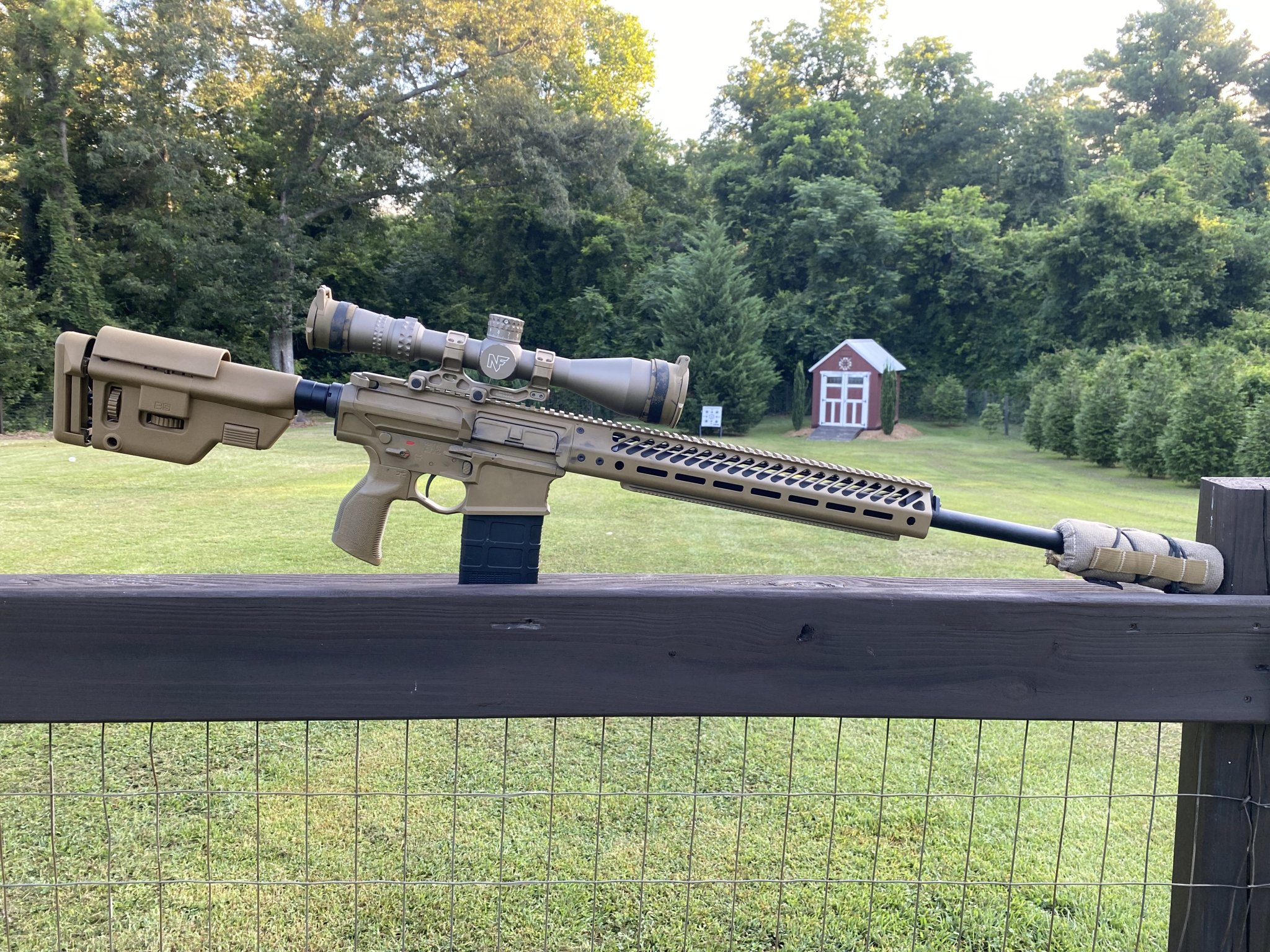

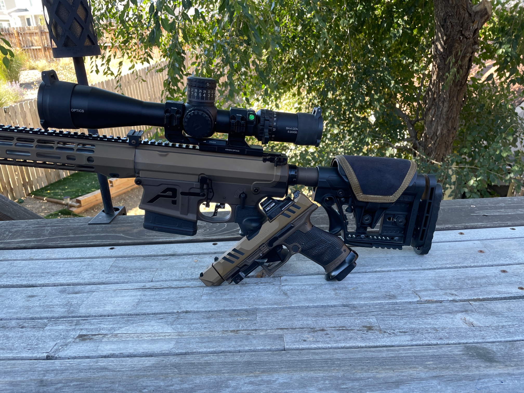

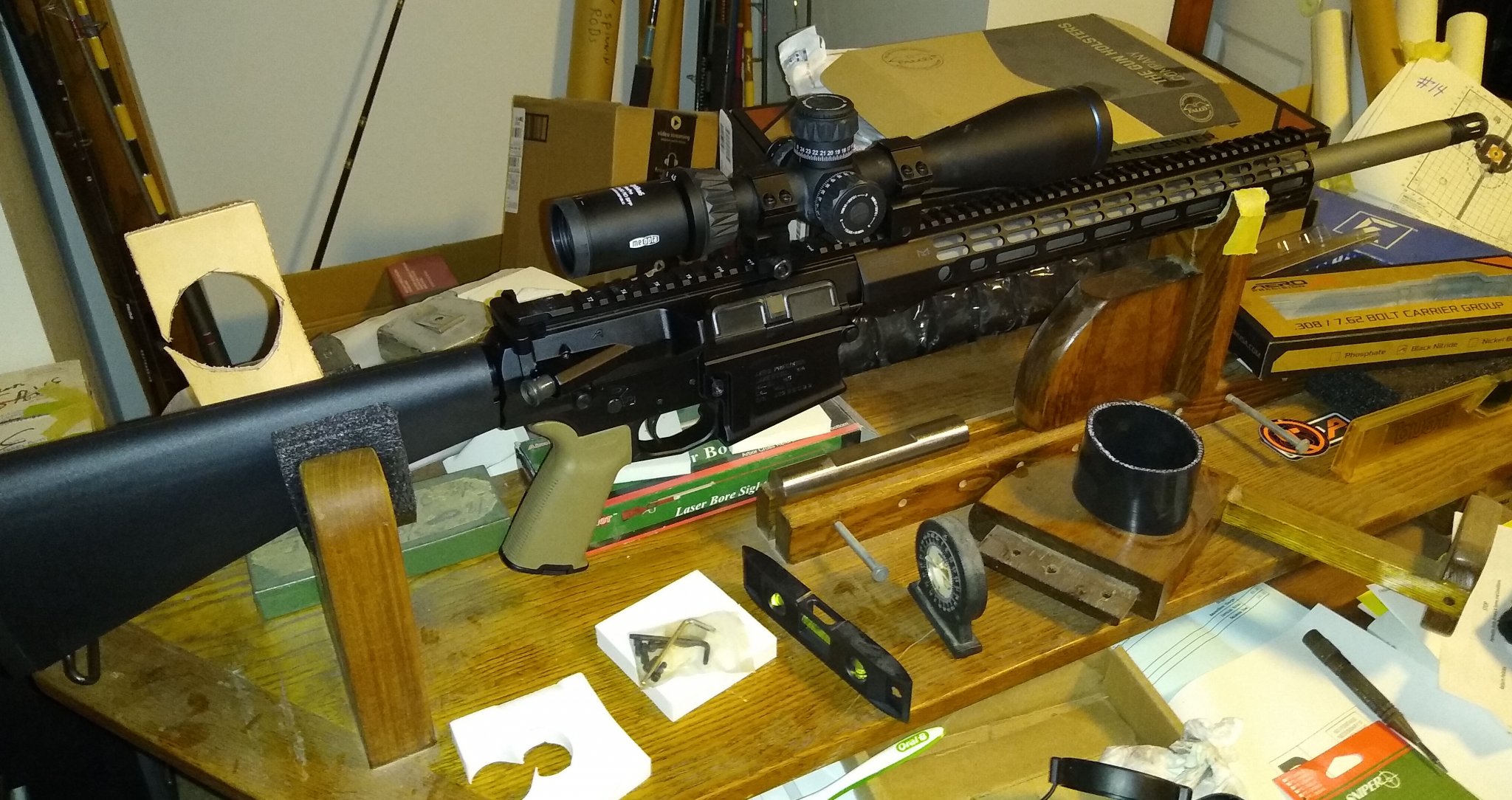

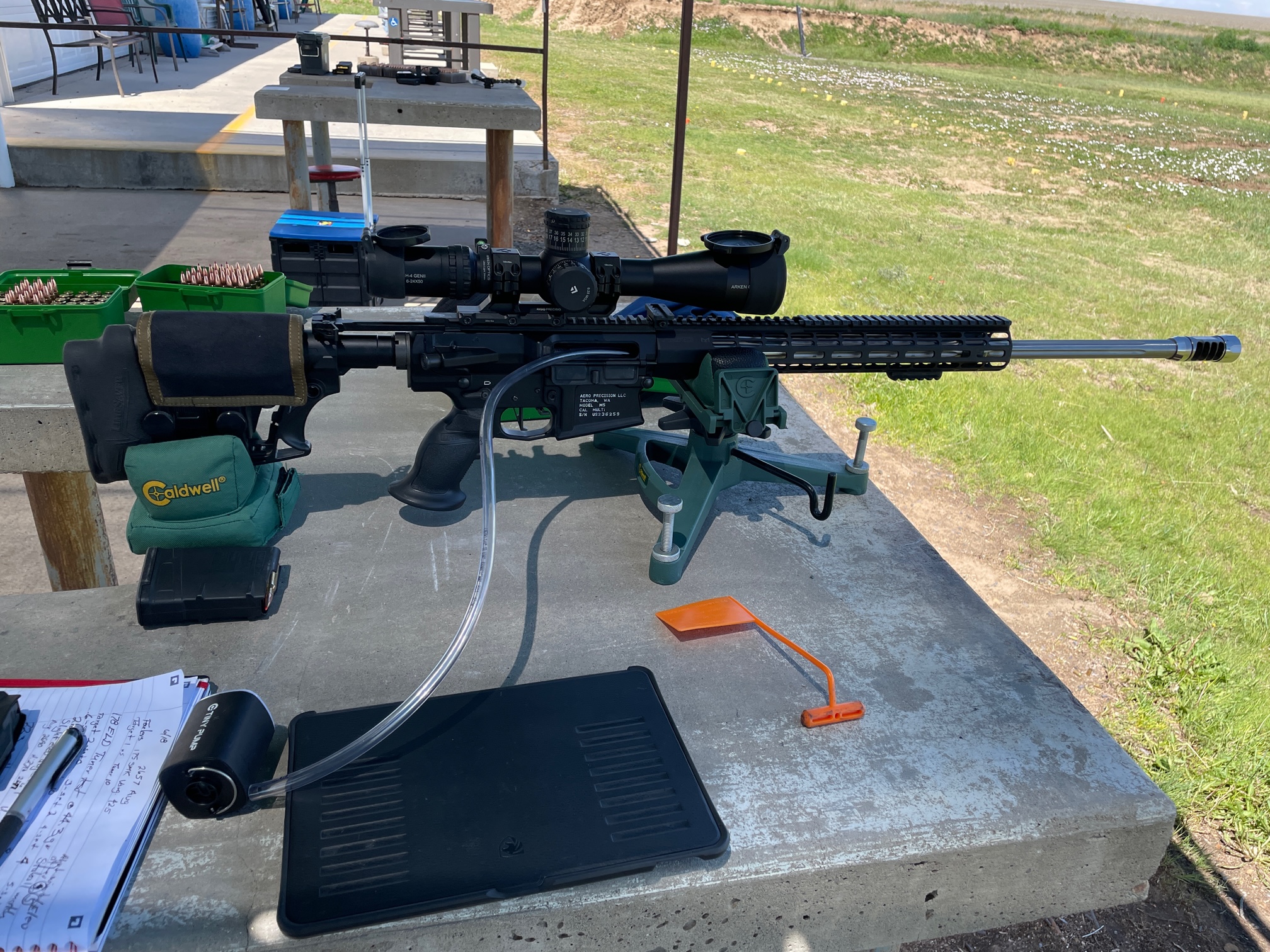

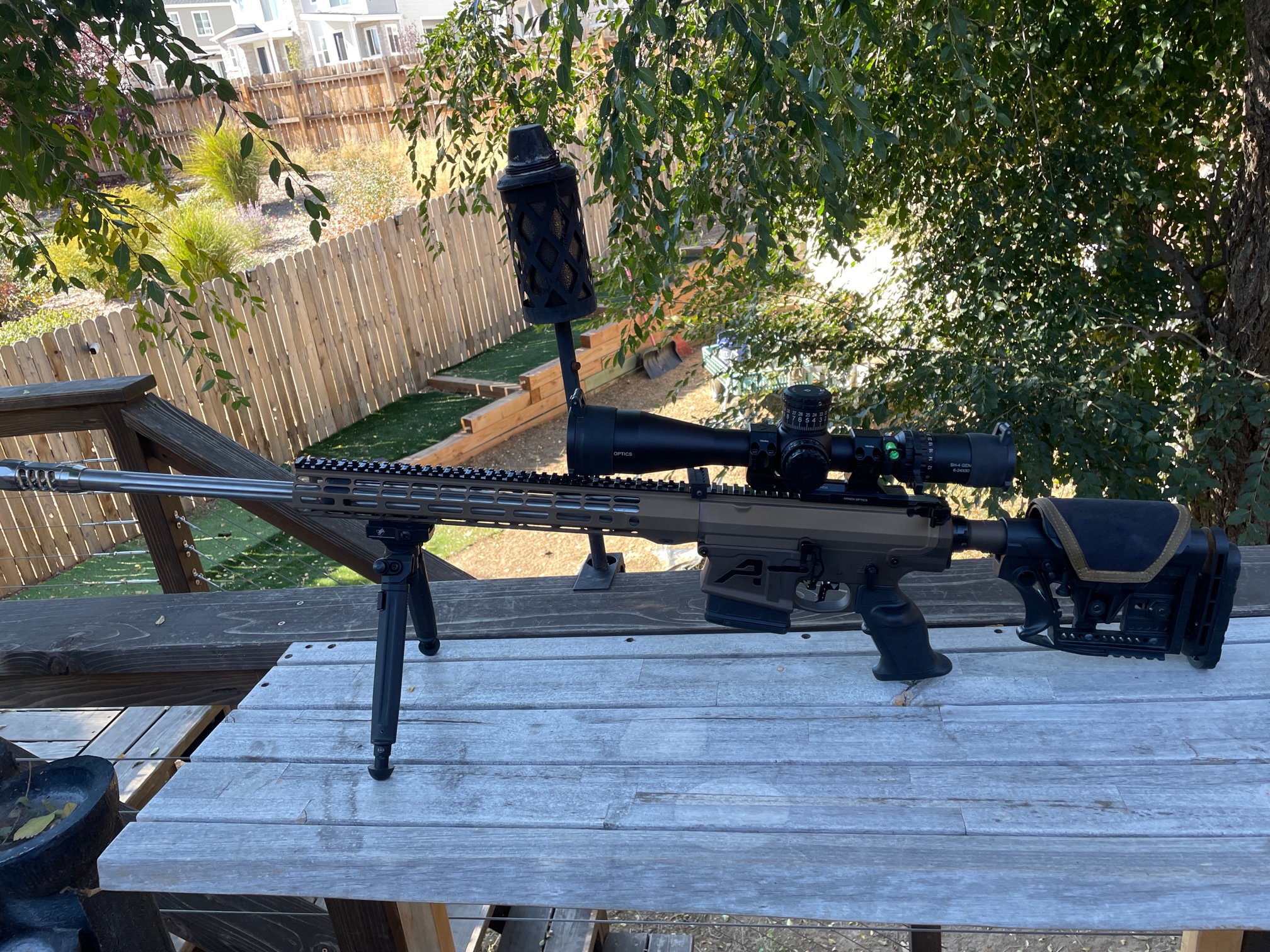

Here's mine. AeroPrecision .308 upper/lower, Krieger 24" SS barrel/JP headspaced bolt with EC tuner / brake, Arken SH-4 6-24x50 scope, velocity MPC-3 trigger ( not in this pic ) Luth AR MBA-3 stock. Cerakoting coming up in the near future.
I'm still working on load developement, so far have it down to .6" and have just bought a Magpul M118 mag that will let me load out to 2.883 so I can do some seating depth work, maybe get it down to .5".
Good Times ! Fun rifle to shoot.

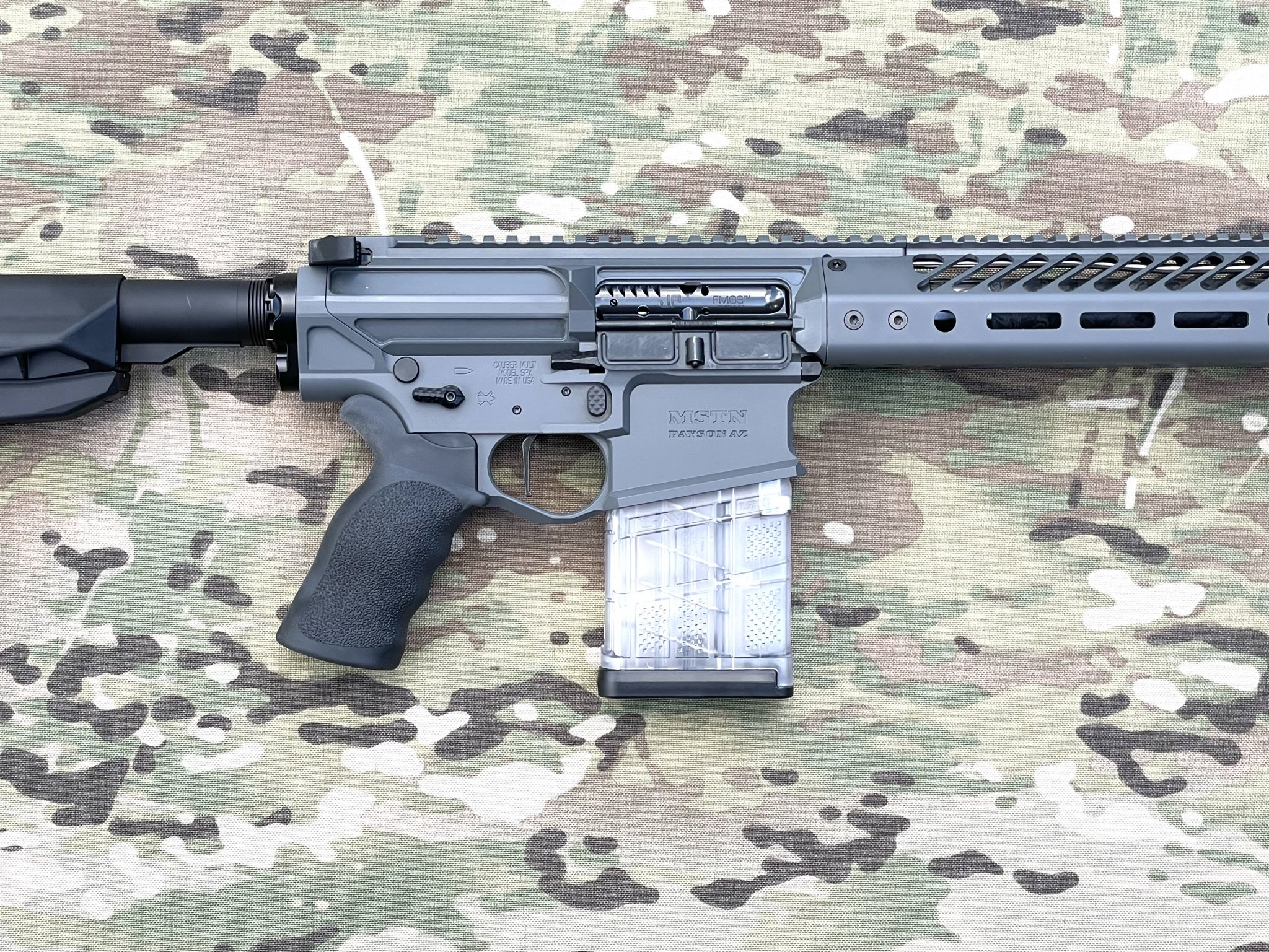

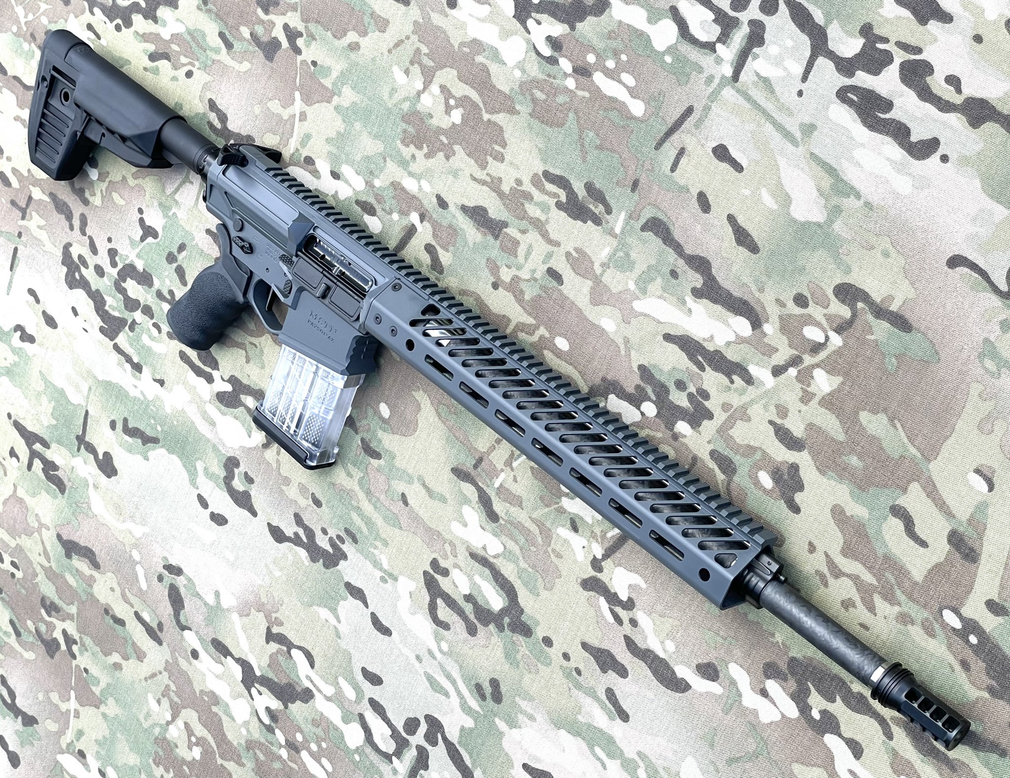

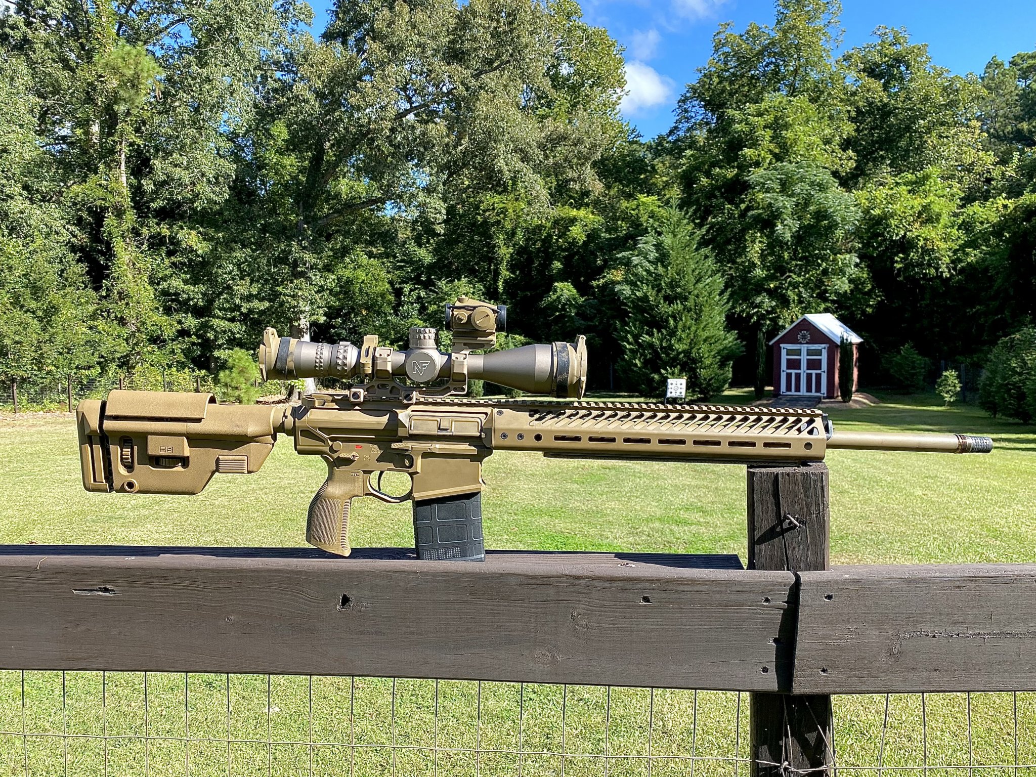

This 16" 308W AR has become my favorite gun to shoot.
View attachment 8233676View attachment 8233677View attachment 8233678

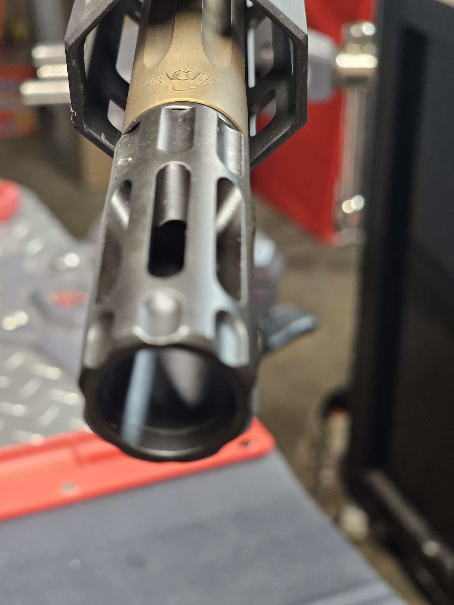

I'm looking at the BA barrels. All of there offering in .308 & 6.5 CM.
Starting with there Modern series. What accuracy do you have with
this series. I have a 22" premium fluted in my cart. I just don't like
paying for looks on something that won't matter much. I'm looking
for real experience here.
Thanks,
Jim

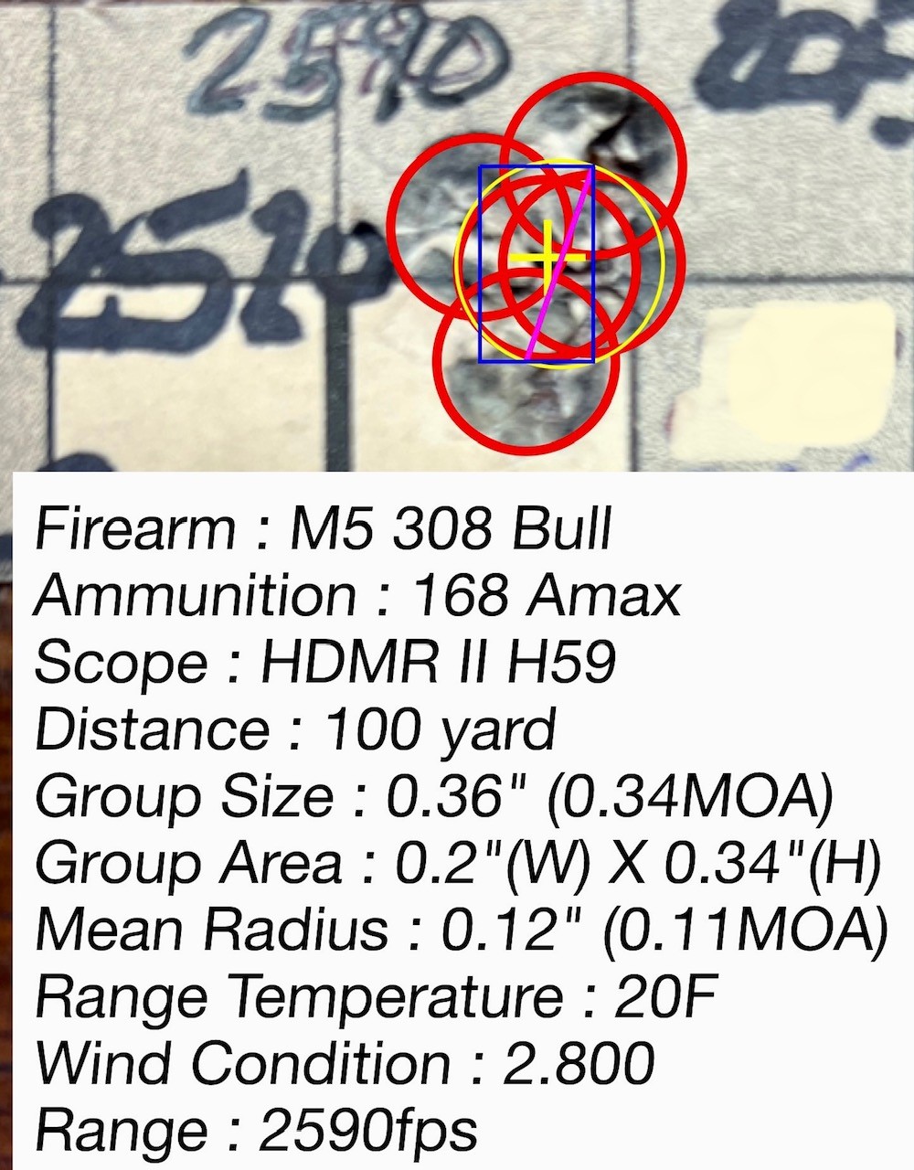

Moderns and Premiums have all been great shooters for me. Sub-MOA 5-10 shot groups depending if my mojo is turned on that day or not! :LOL:
My BA Bull 308 is a stunner:
First shots out the thing to establish hasty zero:

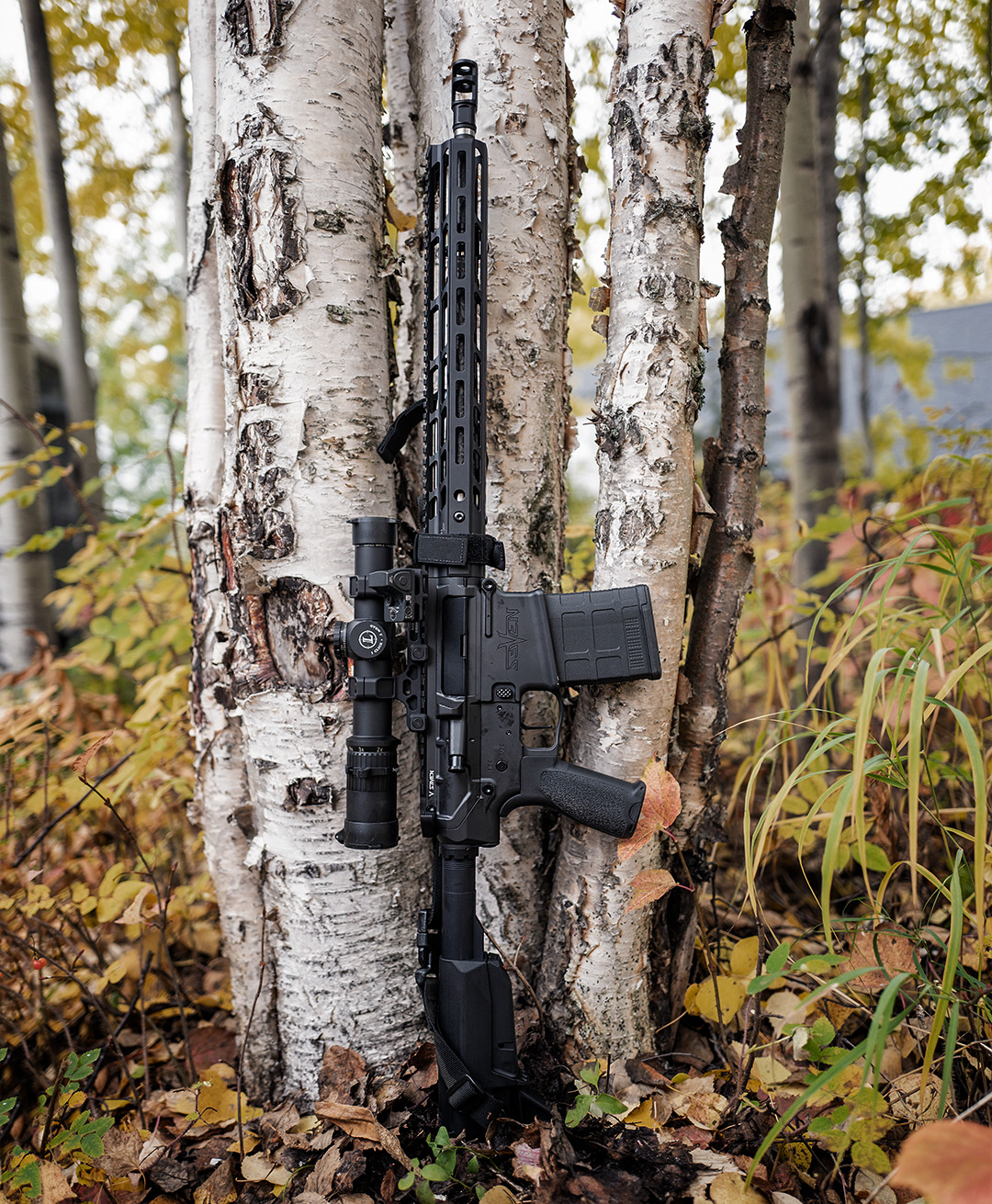

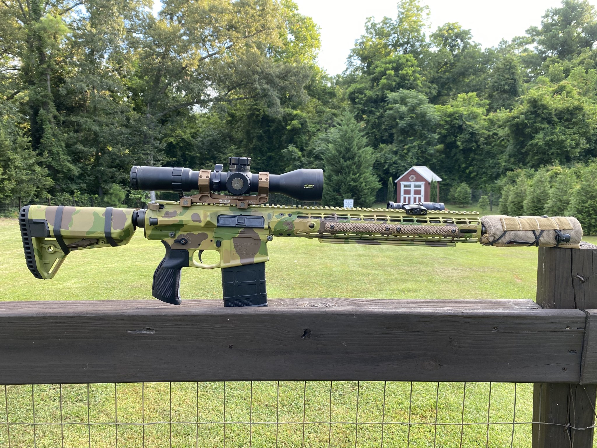

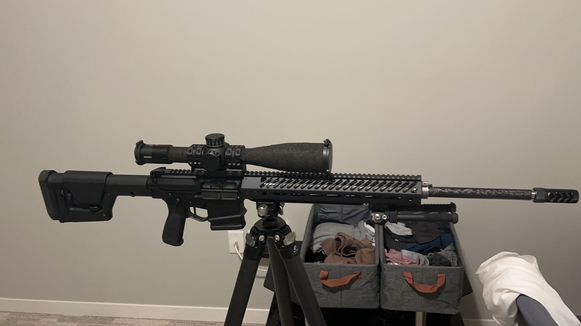

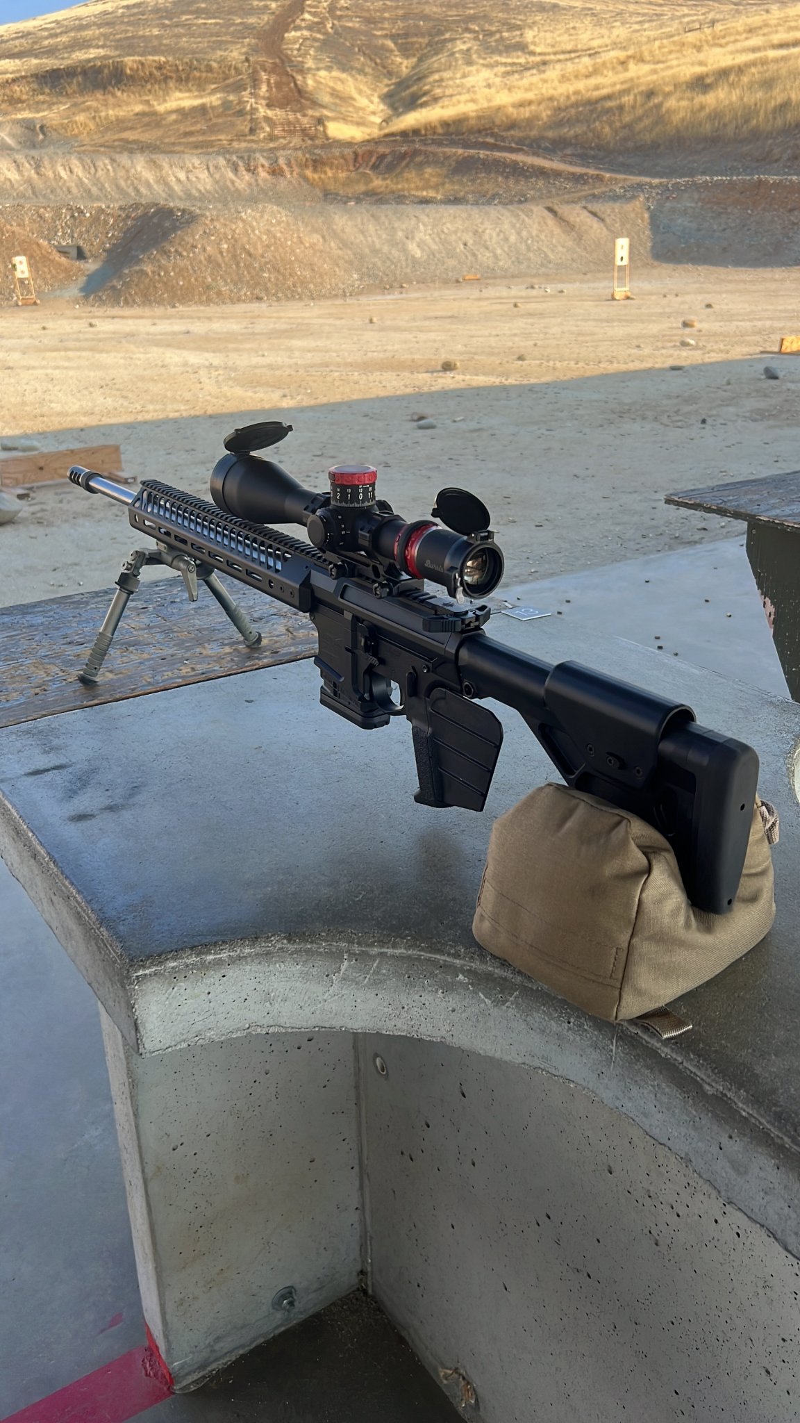

My latest rig: 708 M5, 18” WC barrel, Aero/Magpul/ARC/B5Systems/MDT/Area419/Rise/Leupold VX5HD 2-10, & TT Diamond single trigger. Sending 120 Hammer Hunters 2880 N135.
50/200yd Holosun 510C 3X combo for canyon hog busting. Should I not like the eye box on the Leupold at close quarters.

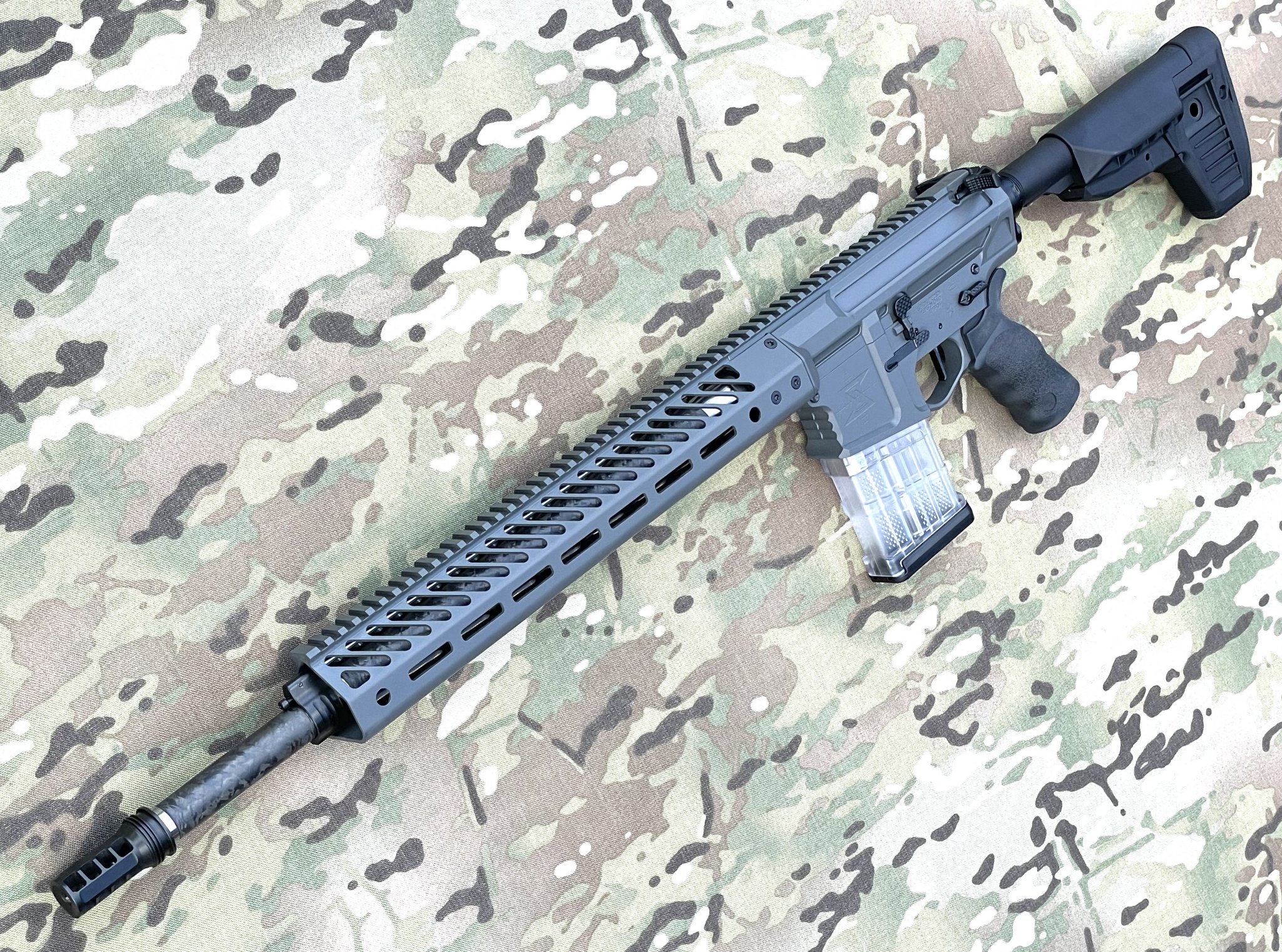

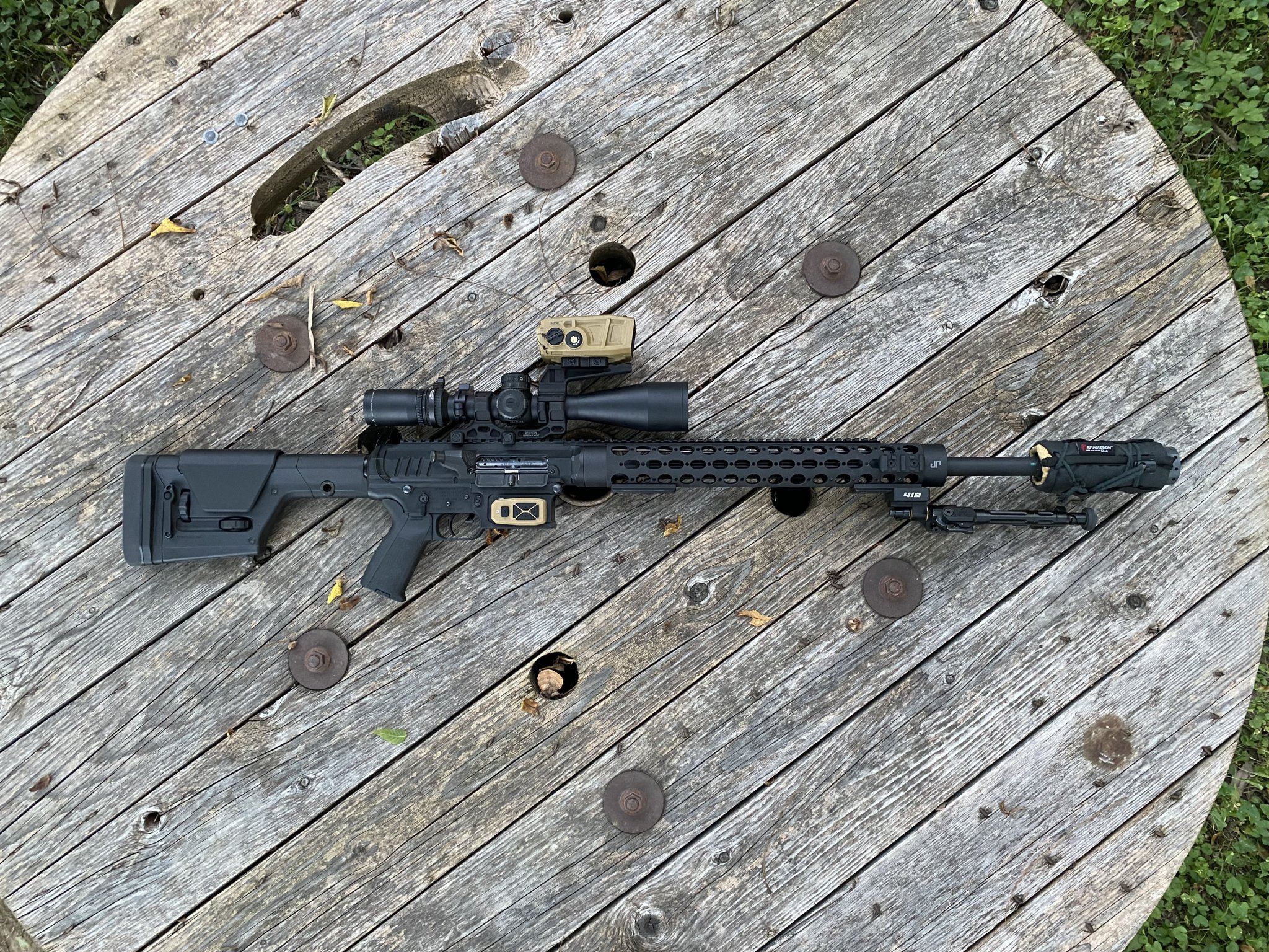

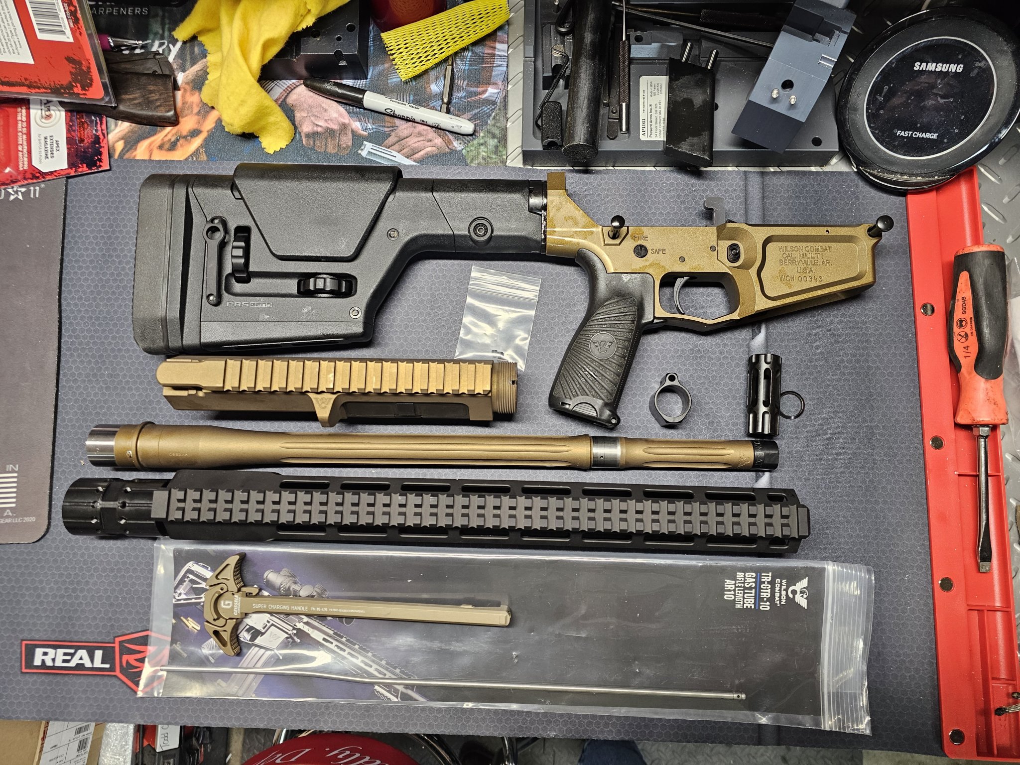

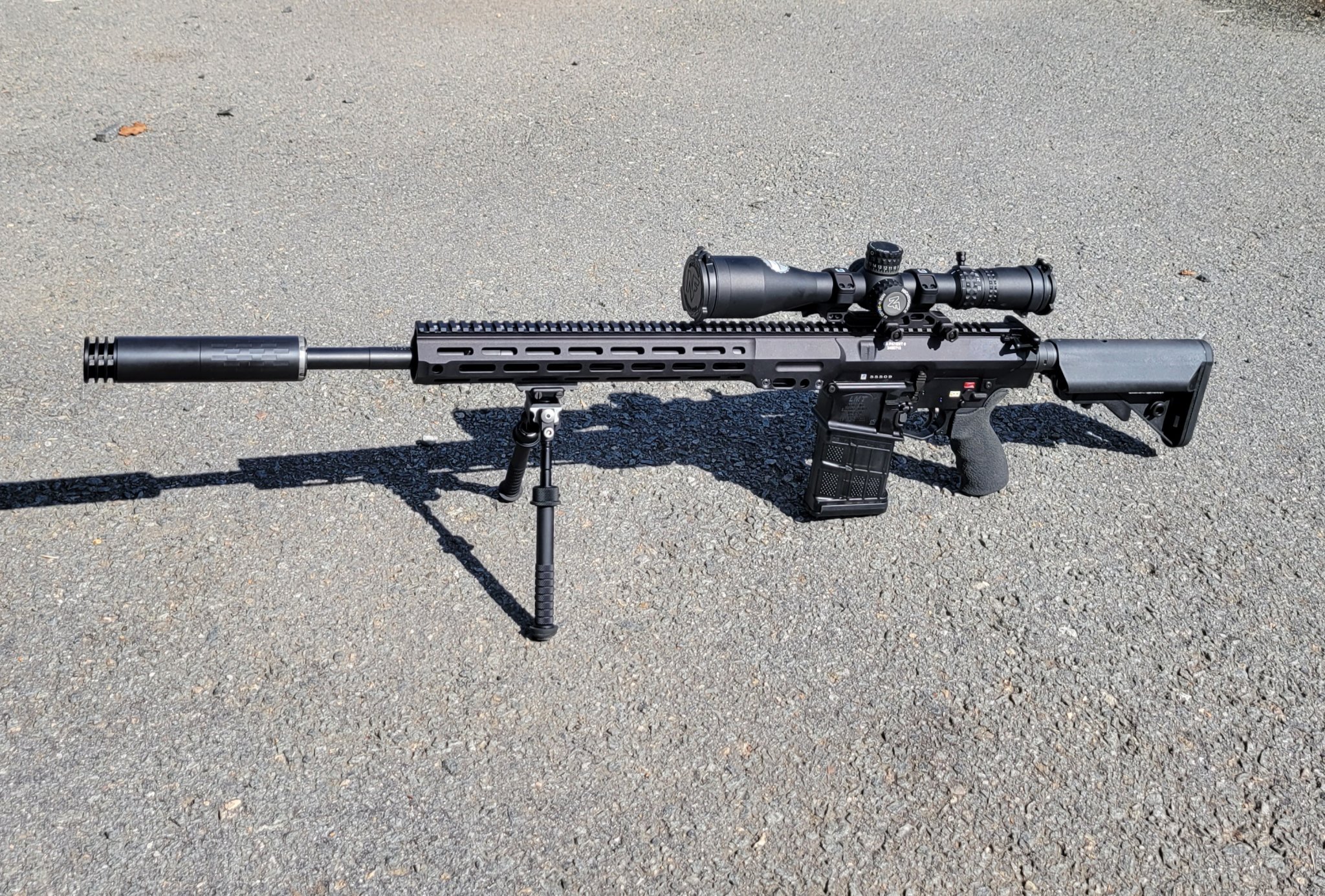

Seekins SP10 kits
Proof 24 inch CF barrel 6.5 CM
Triggertech Diamond trigger
JP silent capture buffer
JP BCG full mass
SLR titanium adjustable gas block
Scope: Minox ZP5 MR4
MDT ARAC rail 10inch for tripod
Proof CF barrel is impressive, very accurate out of box, with my handload it’s consistently .5 moa with low SD. I shot 700 yards with this rifle and got bored because it never misses. I invited a group of new shooters and they all can hit the 700 yard target quite easily.
