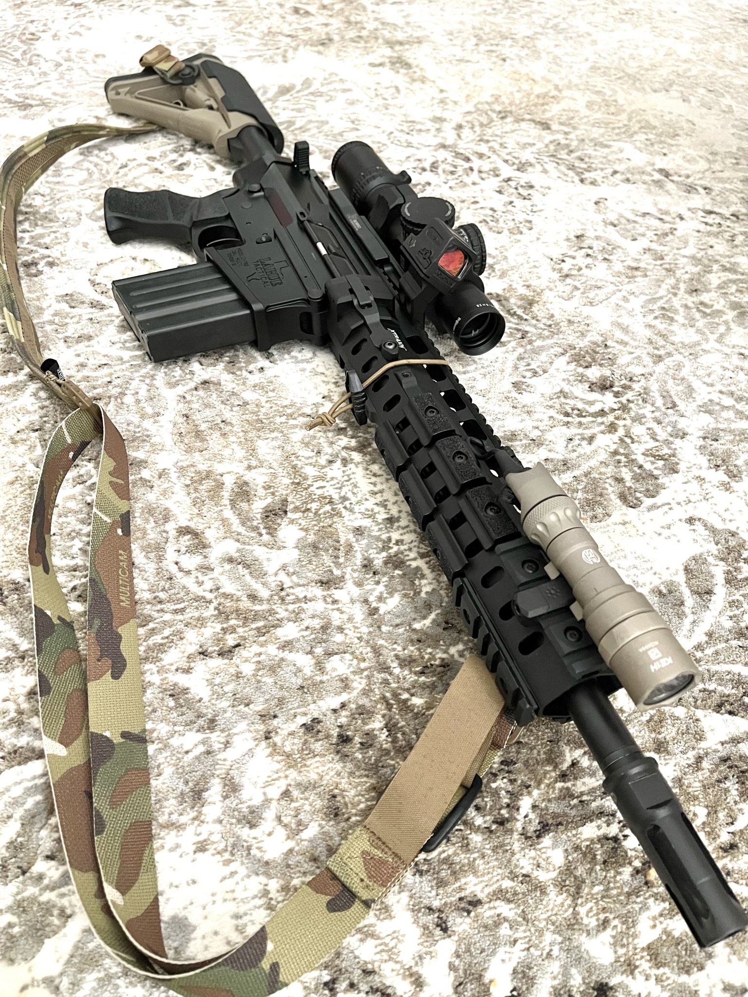

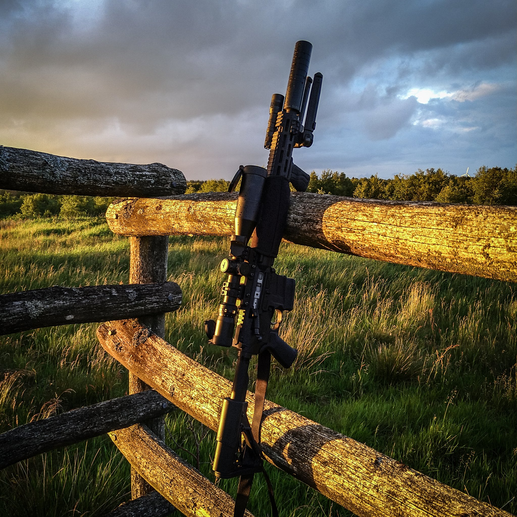

My setup/build:
Savage MSR-10 Hunter, 18” barrel.
From front to back:
  • Nielsen Sonic suppressor (Danish suppressor brand)
  • Magpul bipod
  • Light, can’t remember the brand but does what it’s supposed to when I regulate raccoon dogs
  • FAB Defense Gradus foregrip
  • RRR Gunrest sandbag sleeve (TX)
  • Spuhr 3016 mount
  • Sightmark 3-18x50 MR2
  • Sightmark M-Spec red dot
  • Magpul sling
  • Magpul CTR stock
  • Larue Tactical RISR

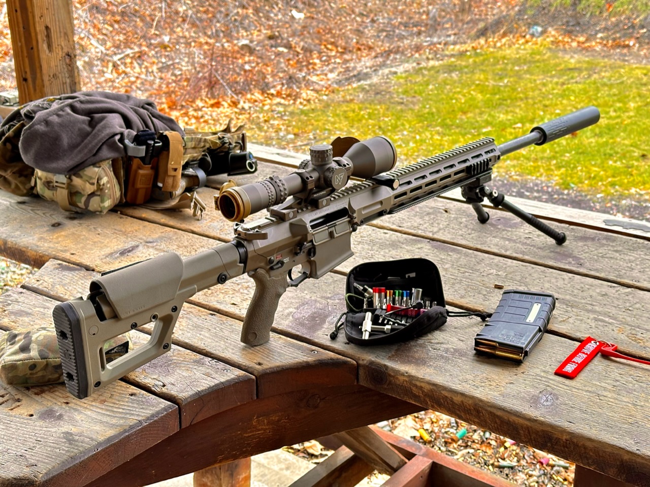

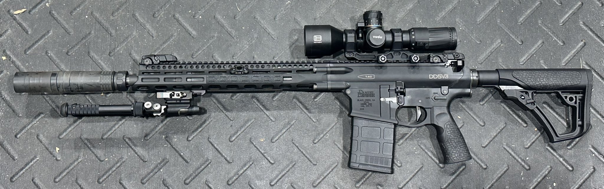

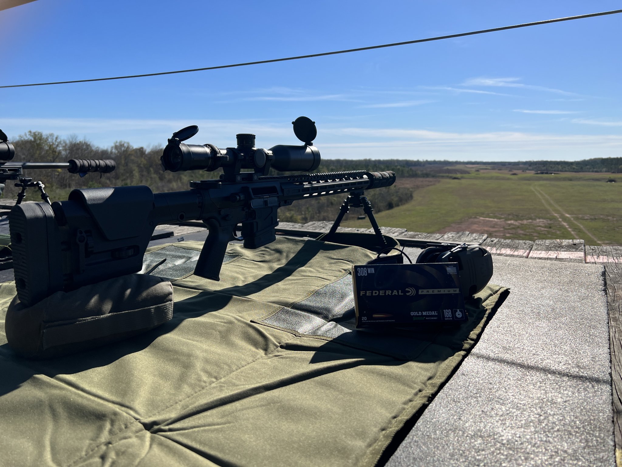

Took the 18" UIC-10A out to Talladega CMP yesterday. Was dealing with swirling 15-20 mph winds all day with the remnants of Hurricane Nicole starting to bear down on the range. With 168gr FGMM ammo I was stacking rounds in the X ring at 100 yds while confirming zero. Out on the unknown distance range, I was able to get the last 7 rounds of a 10 round mag to hit a 10" steel target at 630yds consecutively. I believe this was their furthest target. Could have sworn I had footage of this but apparently the phone wasn't recording. Very impressed with the accuracy of this gas gun. Next test will be 1,000yds at Dead Zero range.
Edit: Definitely need a better grip, that basic Magpul is so uncomfortable.
My 20" loves 168 Sierra Match Kings (about .75 MOA with box ammo). And I hadn't even tried unsuppressed yet. I almost worried to find out it does worse without a can lol
What does that weigh?
14lbs 6oz without a mag
I'm very impressed with the accuracy out of this 18" Criterion barrel. I doubt I'll ever shoot it unsuppressed.
Very nice!

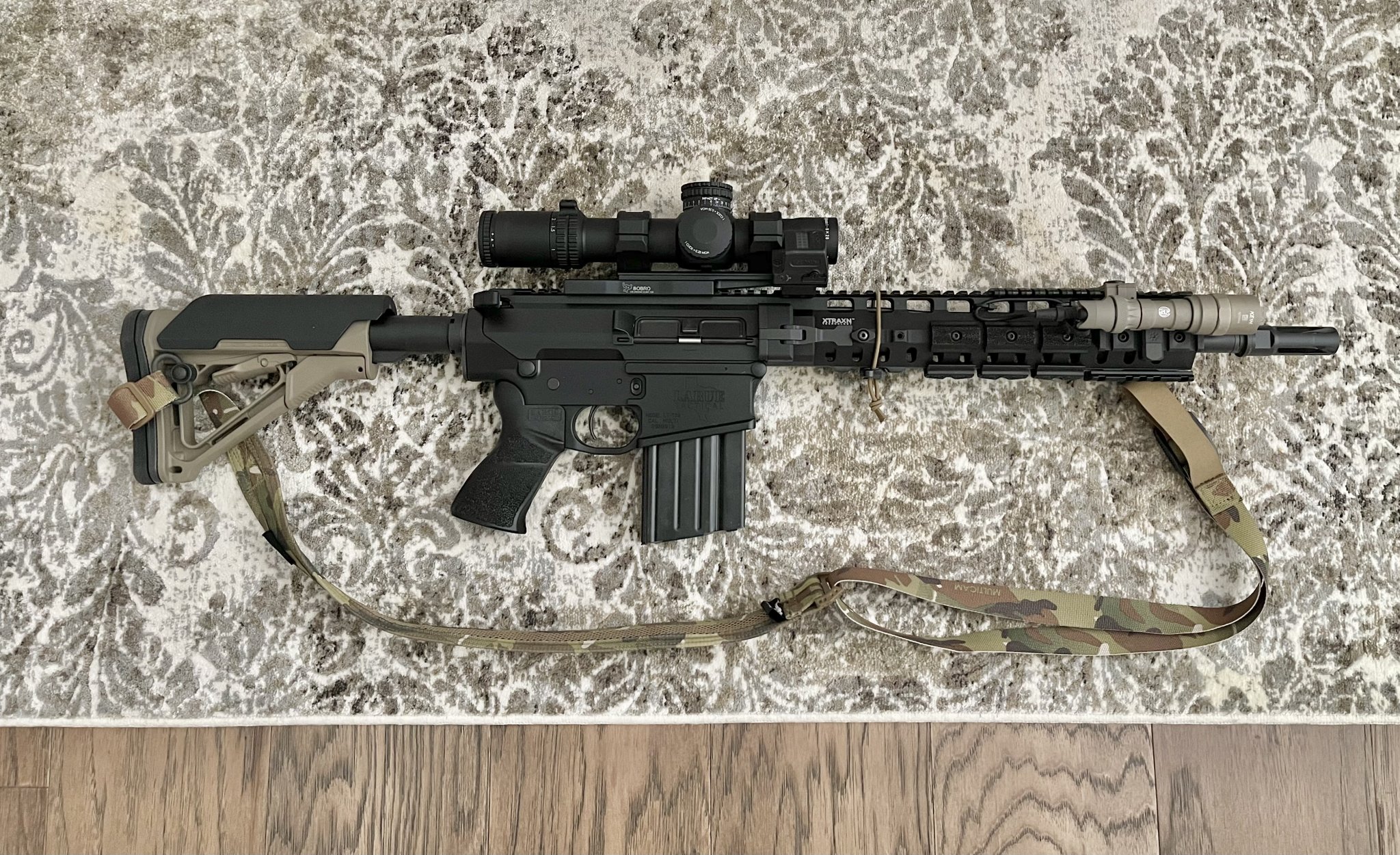

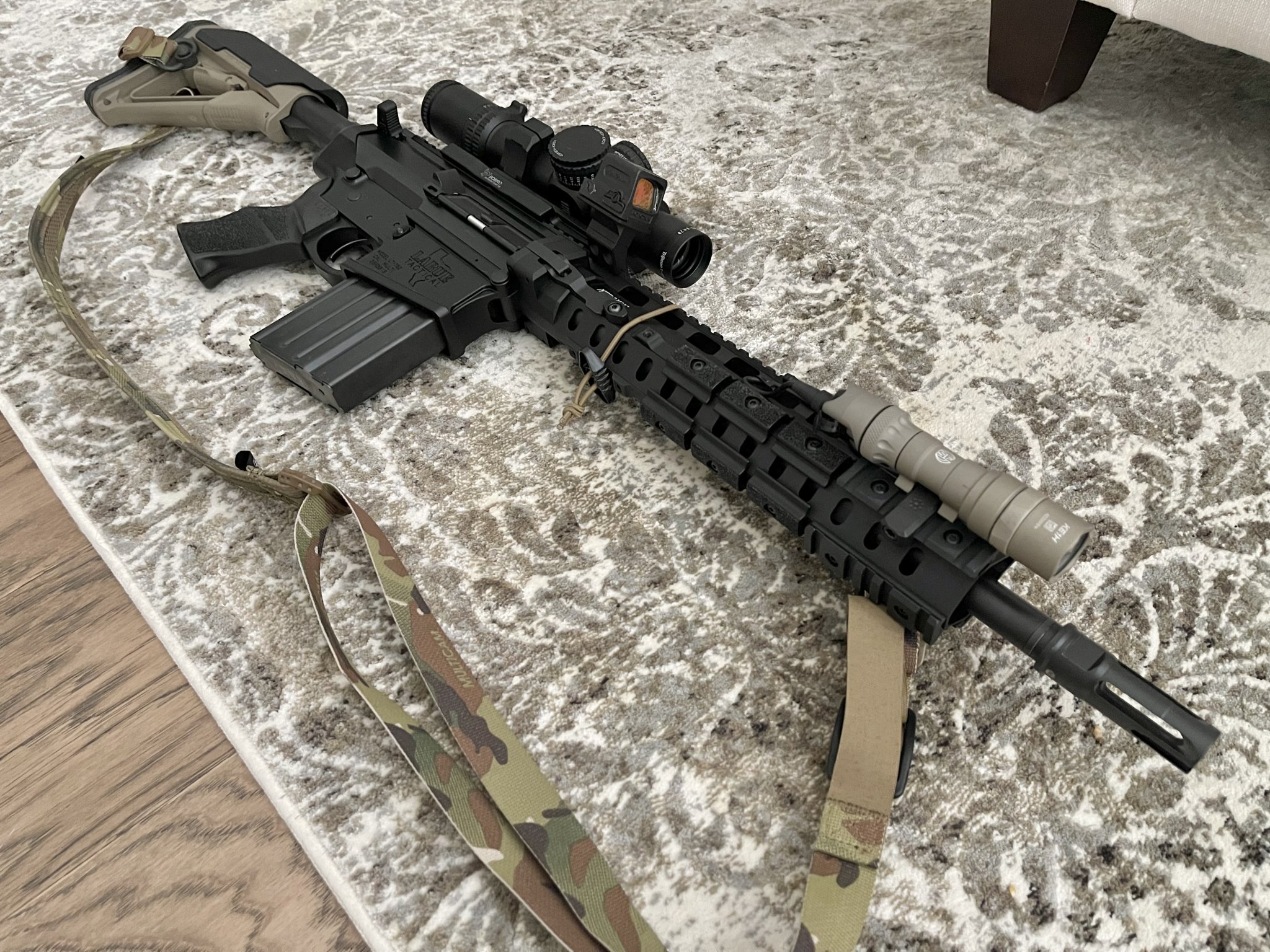

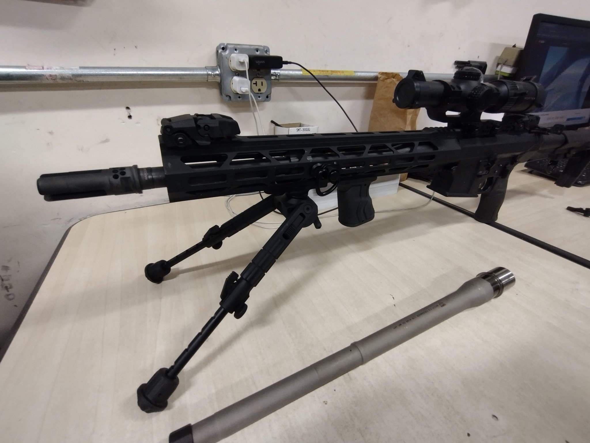

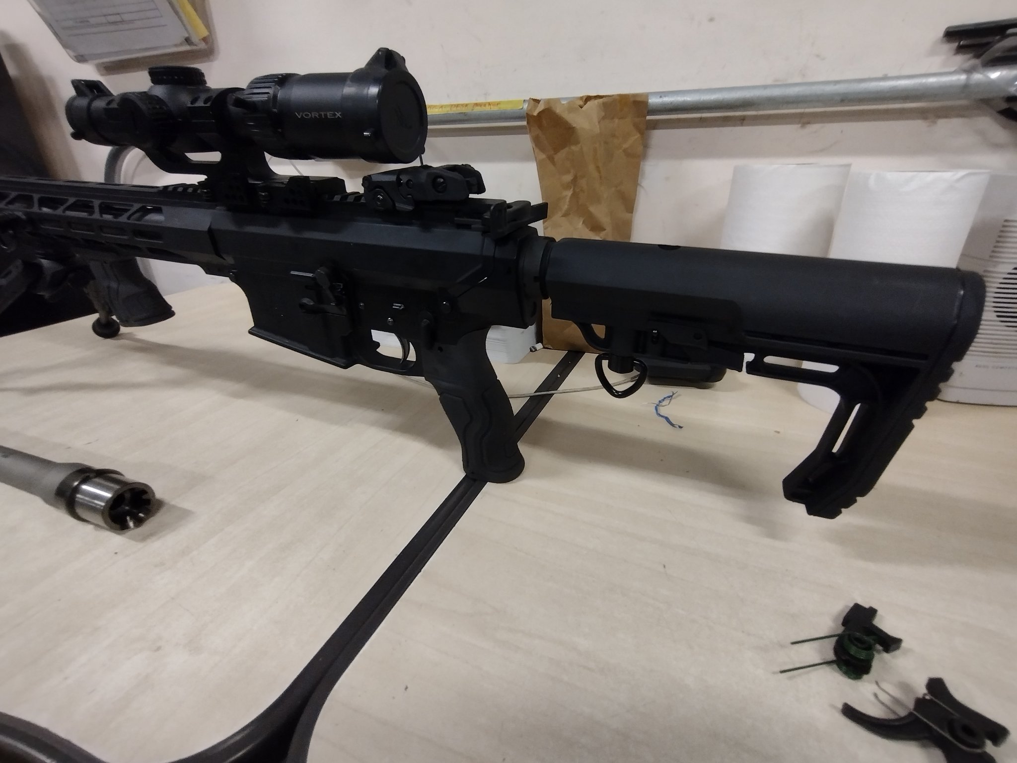

16"DB10; Not my build, perse, but I did mount the Vortex strike eagle 1-8 in a QD cantilever QD mount, added BUIS, changed stock to MFT minimalist, added
, Fab grips, Surefire SOCOM warcomp. And an unfired 16" 6.5 CM barrel (DSG = BA) I only paid $50 for! I will build it as a 2nd upper, already ordered a stripped upper, more as I can afford, as I am a poor.

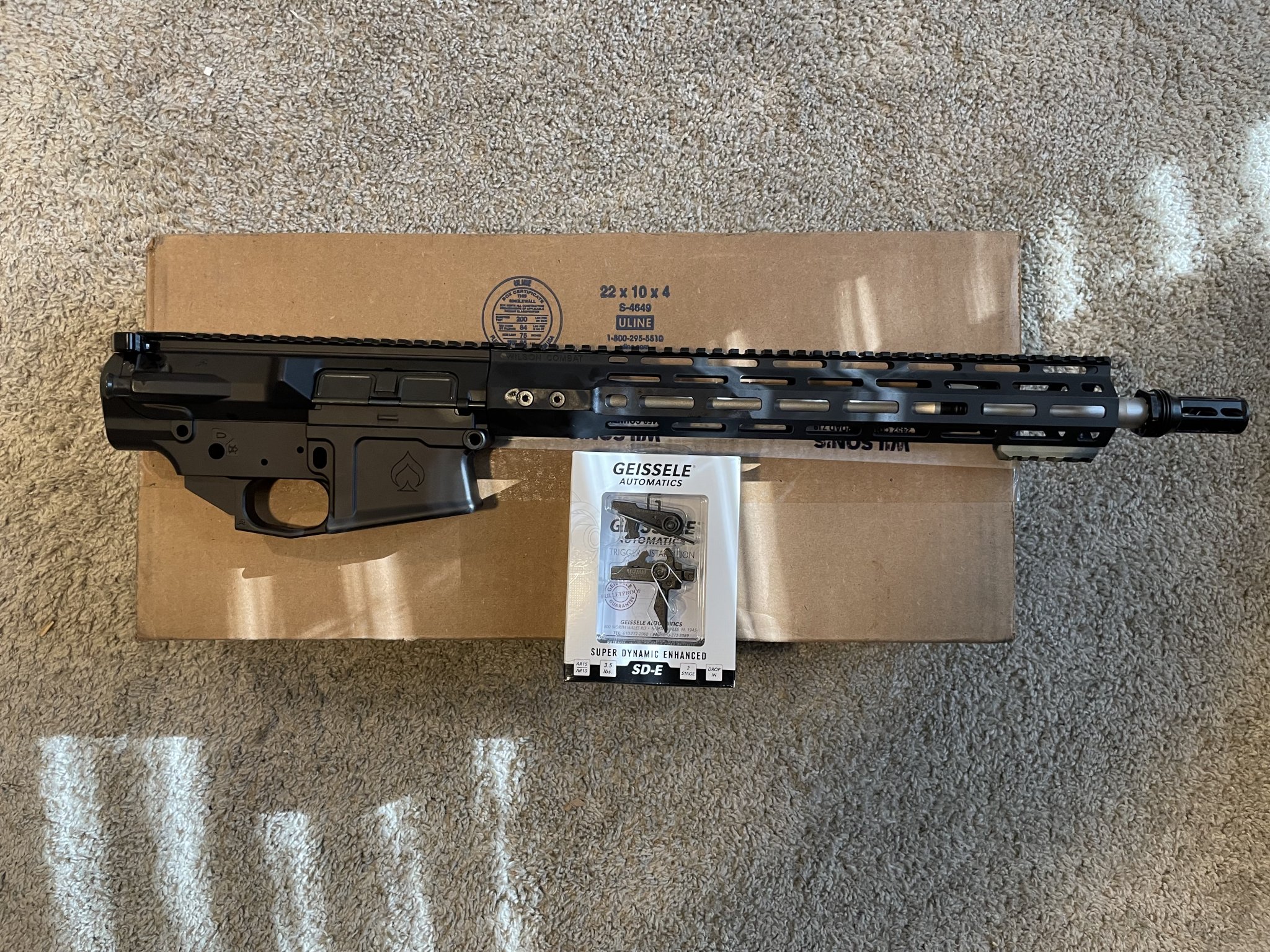

Upper finished. Just need to flesh out the lower. Saved some money on recent sales.
Upper:
BA upper receiver
Wilson Combat Mlock handguard 14.6“
Wilson Combat Recon barrel, 16” intermediate gas, 1-11.25” twist
308W
SLR Sentry 7 gas block
Huxwrx 762 flash hider (for my suppressor)
Aero Precision BCG
Radian SD charging handle
Not my build, but my 16"DB10 with; Vortex strike eagle 1-8View attachment 7998006View attachment 7998007, Fab grips, Surefire warcomp, MFT battle link stock. And an unfired 16" 6.5 CM barrel I only paid $50 for! I will build it as a 2nd upper, already ordered a stripped upper, more as I can afford, as I am a poor.
Because there is no standard spec large frame AR, and I bought this DB10 without that knowledge, I decided in an effort to keep things compatible on the 6.5 upper, I ordered all my parts from Diamondback. Got the stripped upper a couple of weeks ago. I took advantage of their BF sale for 25% off w/free shipping and bought most of the rest (still need adjustable GB, Surefire warcomp, & optic)
$290 + shipping reg price for $215 & free shipping!
So far $368 spent. Had I not gone last week to buy 300 rounds of 6.5 ammo, I'd have picked up another stripped lower, and/or a complete 308 13.5" upper.

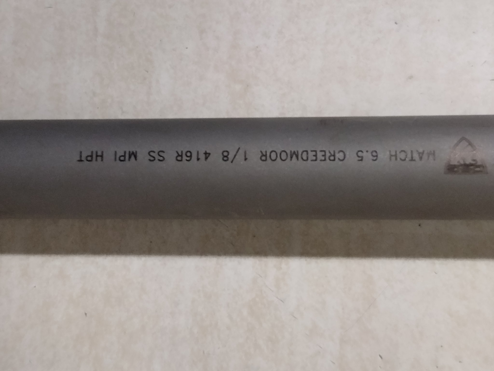

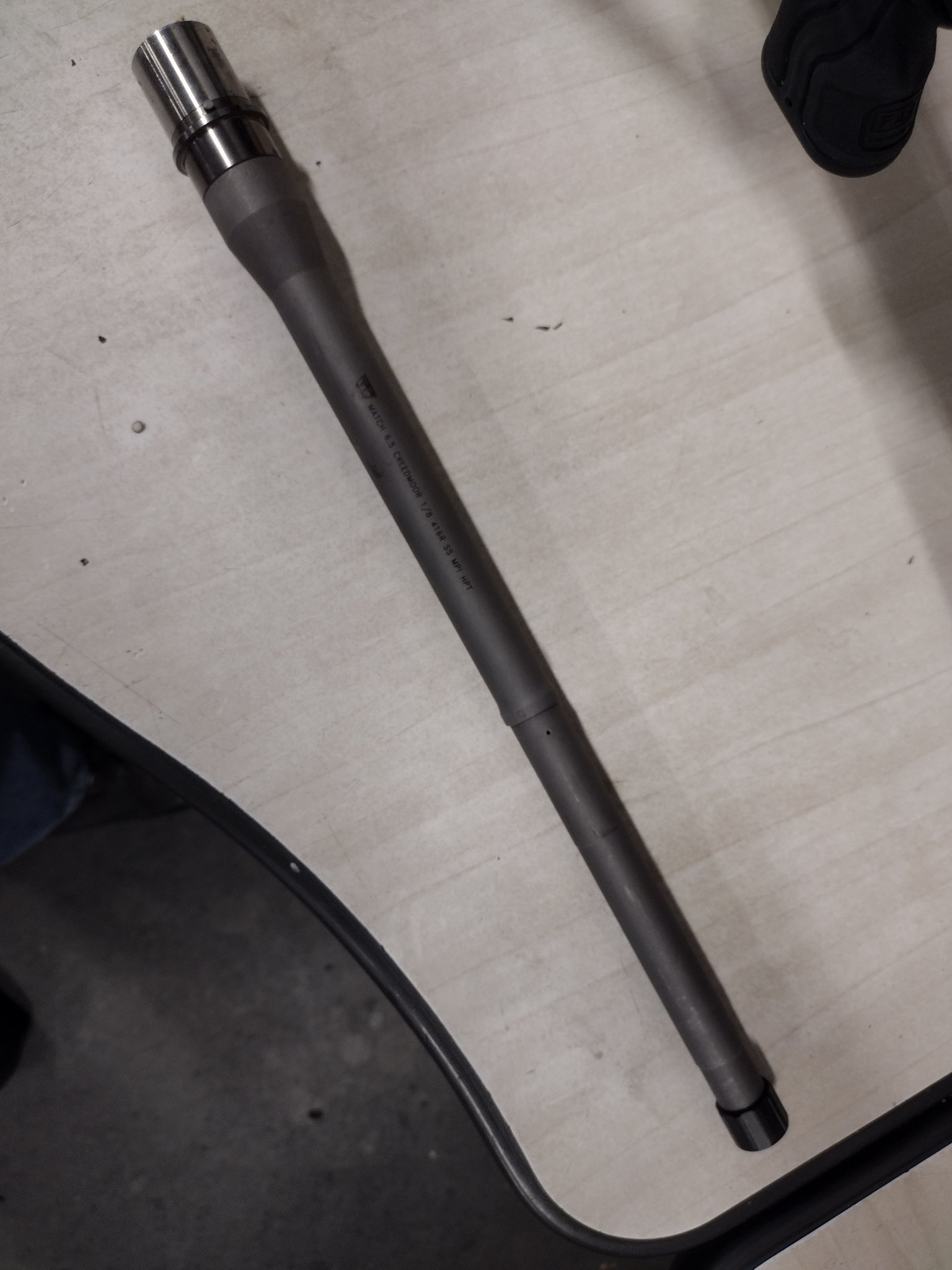

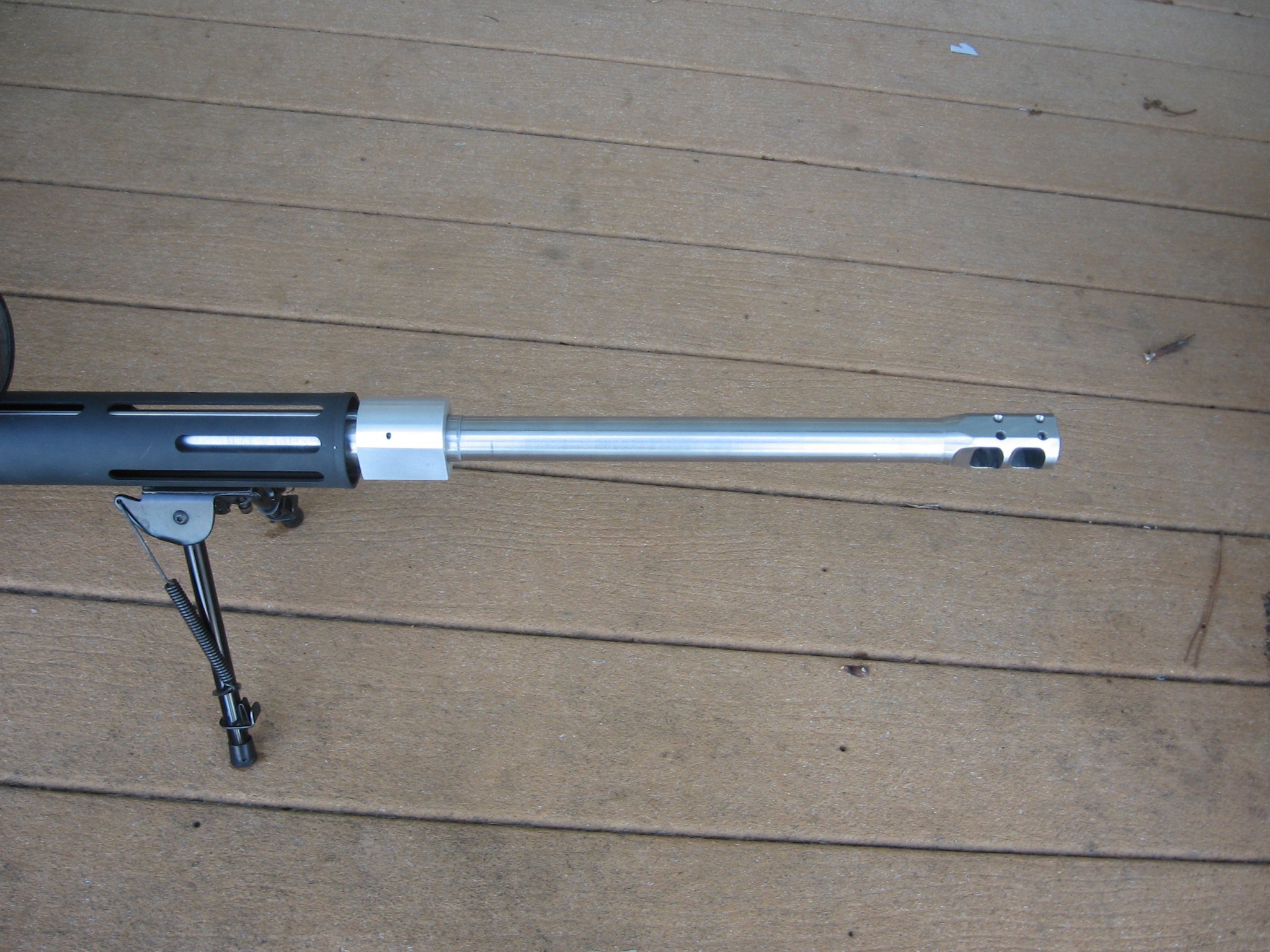

Did up a custom 6.5 barrel for the long mlok upper for this MWS. Also tried my hand at spraying Cerakote for the first time. Took some close up photos of all the engravings beforehand and re-lasered them on afterwards, thought that really looked nice. Been waiting all summer for the Magpul PRS Lites to start shipping…
What color cerakote? RAL 8000?

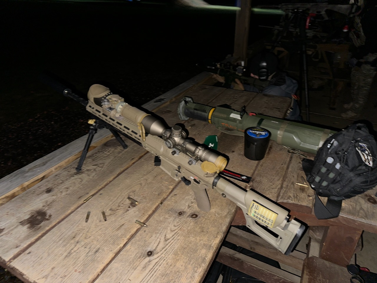

Made a trip out to Arena Training Facility today with a buddy and the ADM 18" UIC-10A .308. I had some pretty good results today. Believe it or not, I hit 1168 yds with FGMM 168gr ammo once out of 15 rounds. Me and my buddy just looked at each other and didn't say a word after we heard the steel ring. :ROFLMAO: I had to dial 21.5 mils and hold 2.2mils for wind. I hit the target on the 5th shot out of 15 but could not get another hit although I was seeing splashes all around the target.
Other than that I kept it within 1000yds. Here is a video of a pretty nice string of shots at target 858yds away from an elevated tower. Forgot my damn M118LR rounds at home.

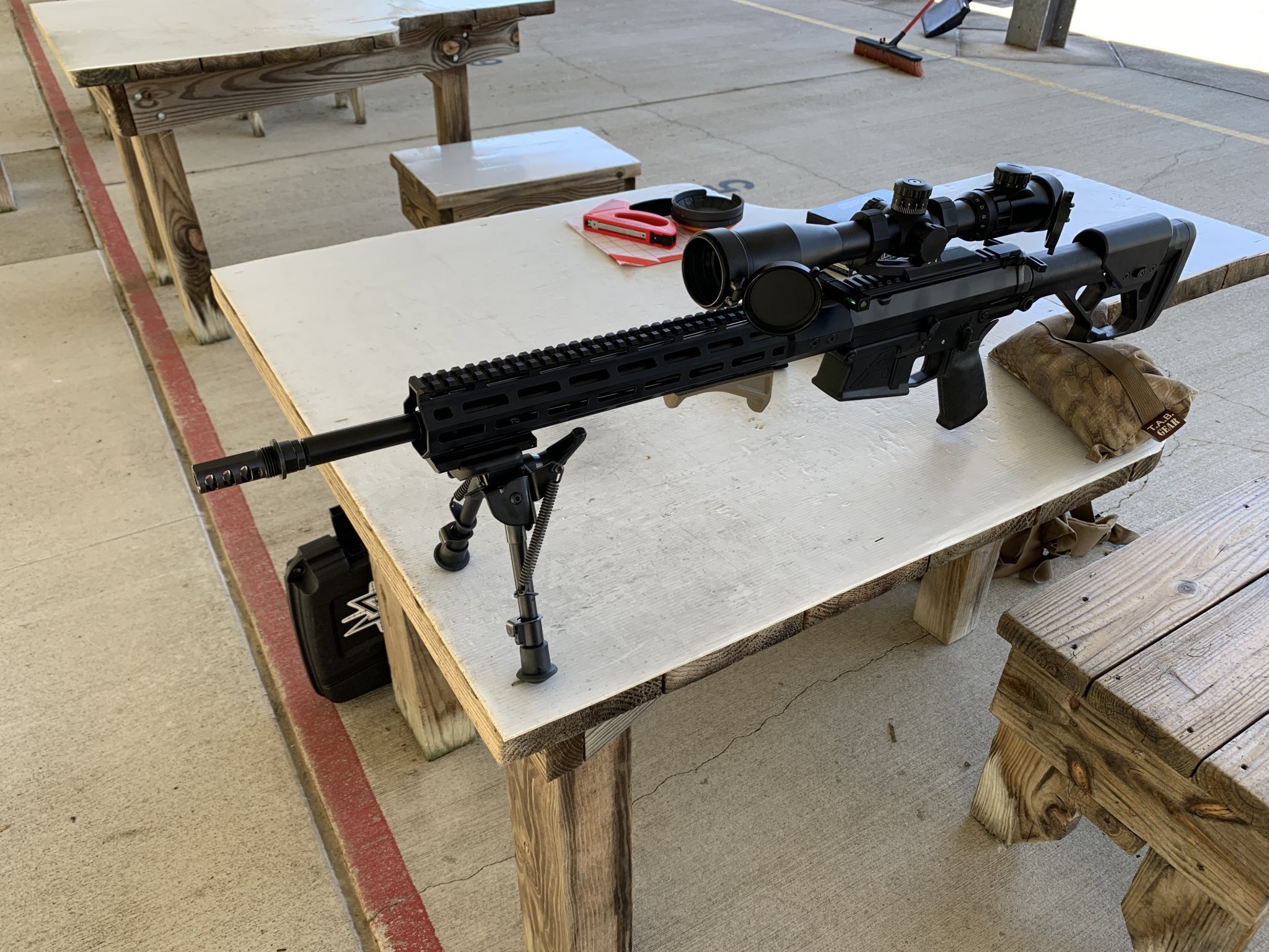

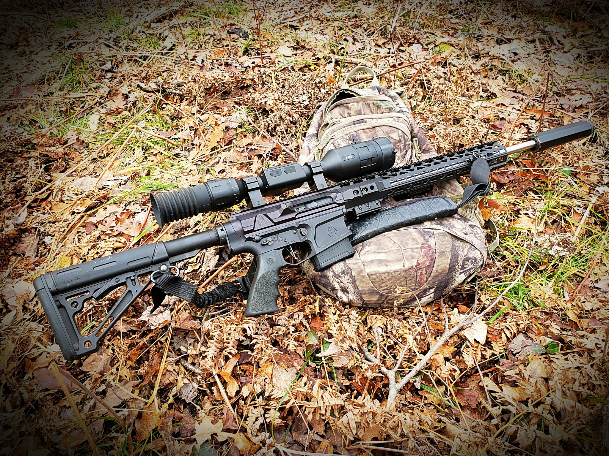

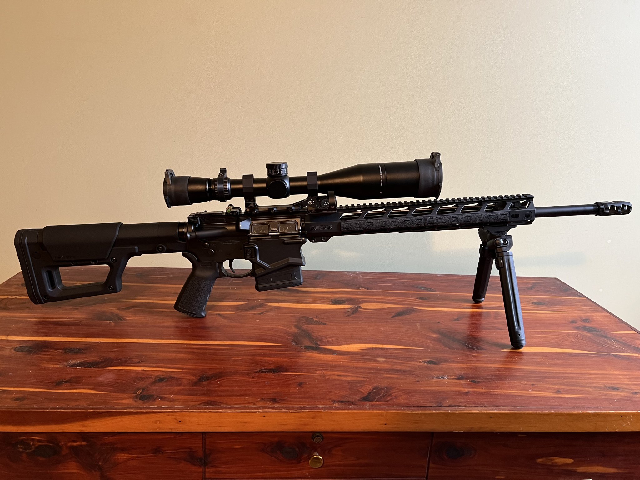

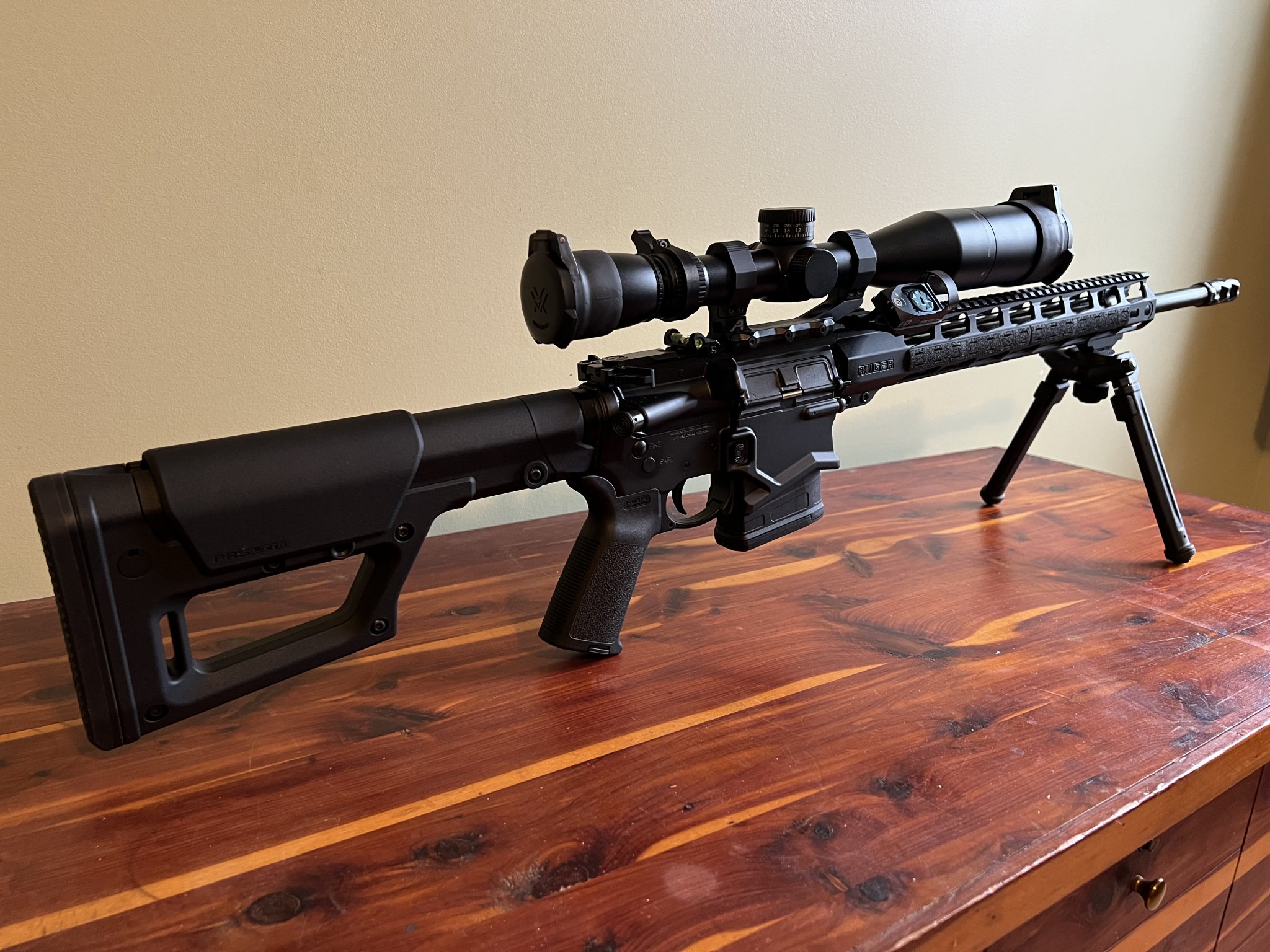

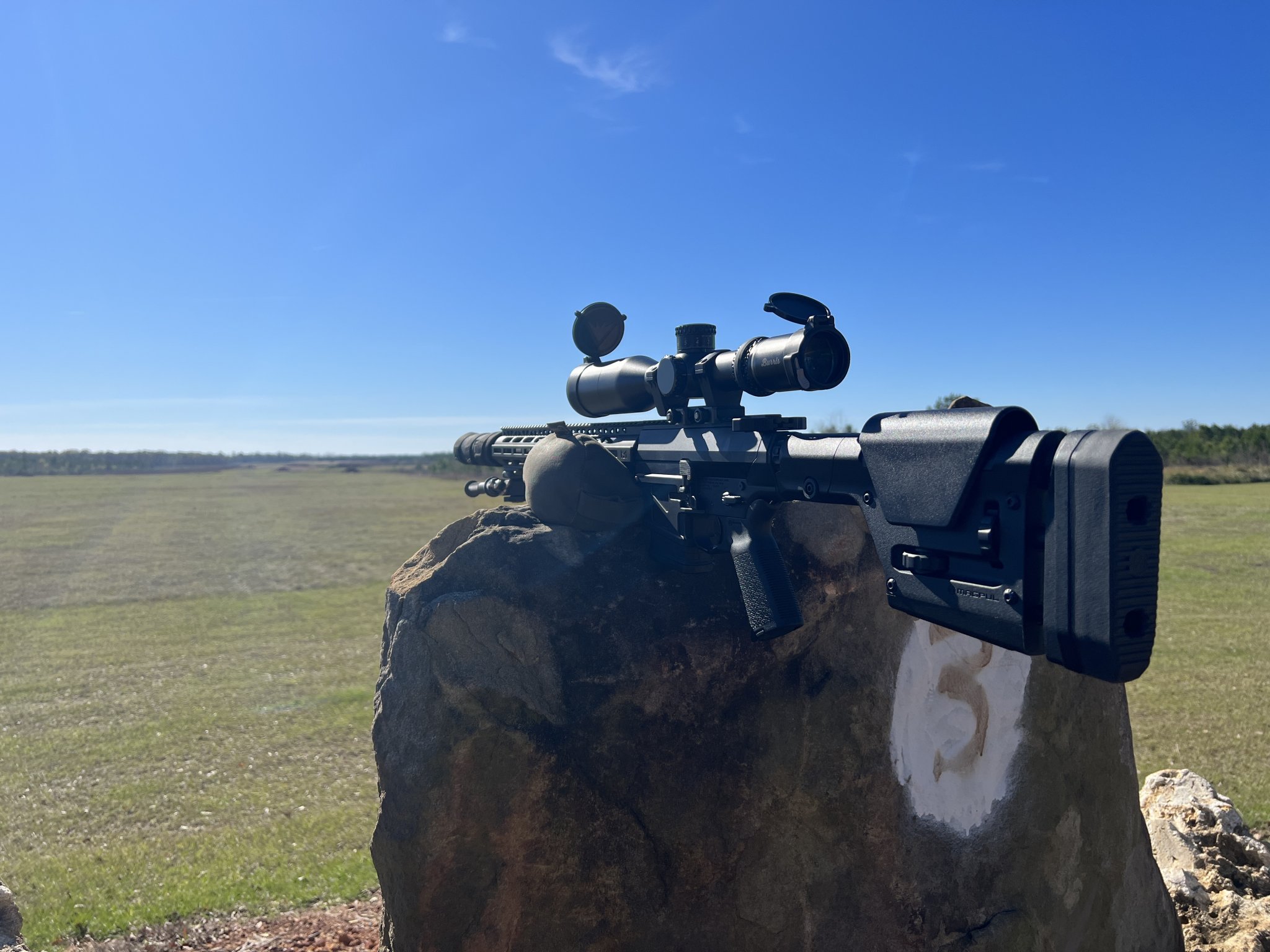

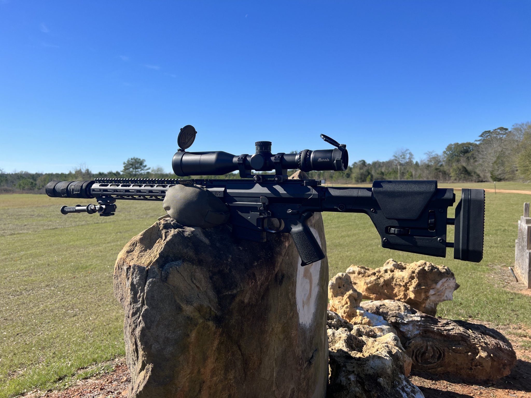

20” Ruger SFAR
Vortex Razor LHT 4.5-22x50
Vortex Venom 6moa offset MRDS
Magpul MLOK Bipod
Magpul PRS Lite
Rifle hovers at a fairly consistent 1moa accuracy. FGMM 168gr SMK BTHP seems to yeild best results.
Built to be a lightweight semi-auto hunter.

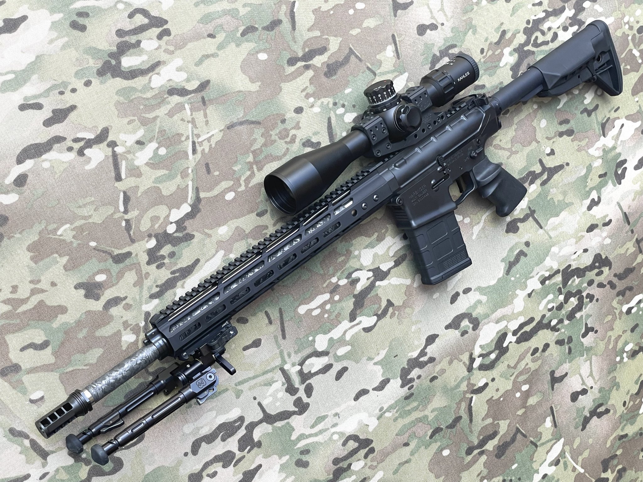

Aero precision m5 upper/ lower/ bcg/ cantilever scope mount/ upper lower parts, ballistic advantage 18” heavy barrel, breek arms comp / charging handle, magpul grip/ foregrip, Wilson combat hand guard/ gas gas block/ gas tube, Harris bipod, magpul arca rail, krg arca adaptor, Timney ar10 trigger, kns pins, Seekins butt stock/ buffer spring/ buffer, primary arms 4-16x44 scope. My budget 308 build! Shoots nice and soft.

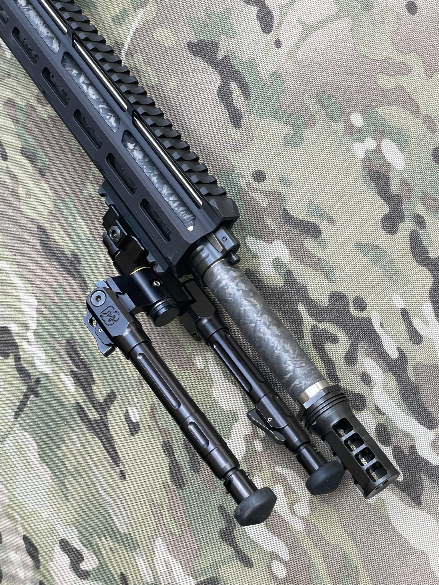

8.5 LB 6.5 Creedmoor with 20" Proof carbon fiber barrel. V7 billet receiver set and 15" rail. JP Full Mass BCG - Needed for this high pressure cartridge! SLR adjustable gas block - Just dial in your optimum gas setting. OSS muzzle brake for customer's excellent OSS 762 HX-QD TI suppressor. Trigger Tech Adaptable trigger set at 2.5 LB. Geissele SCH charging handle. All the small parts are from V7. Kahles K525i with stunning clarity up top in a Spuhr mount. Now, I want one just like it.
