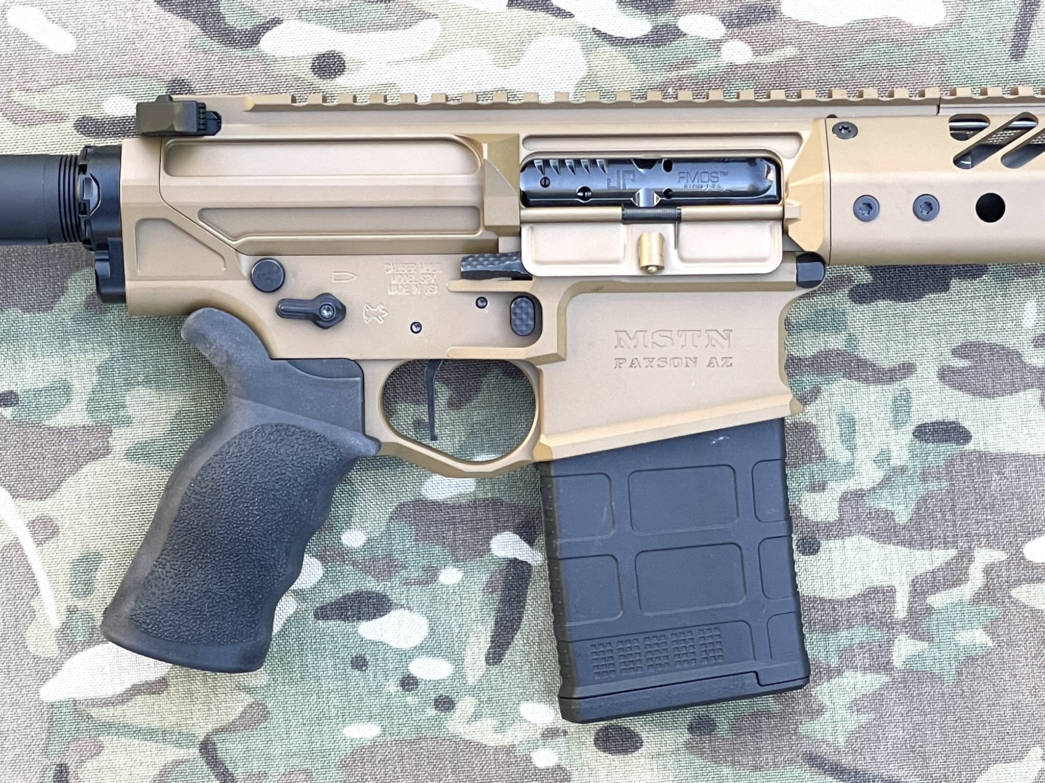

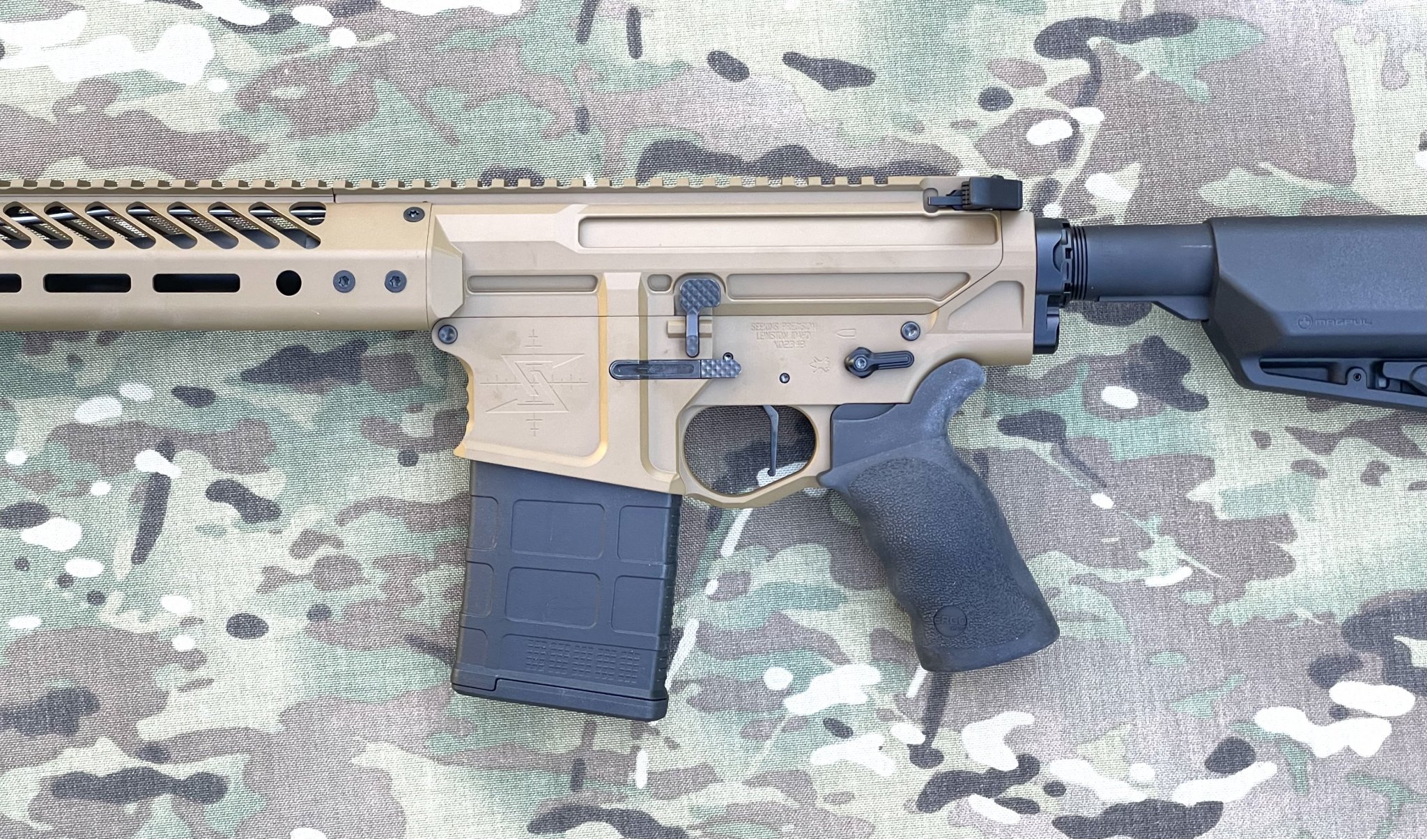

308 AR10 Build Info/Picture Thread

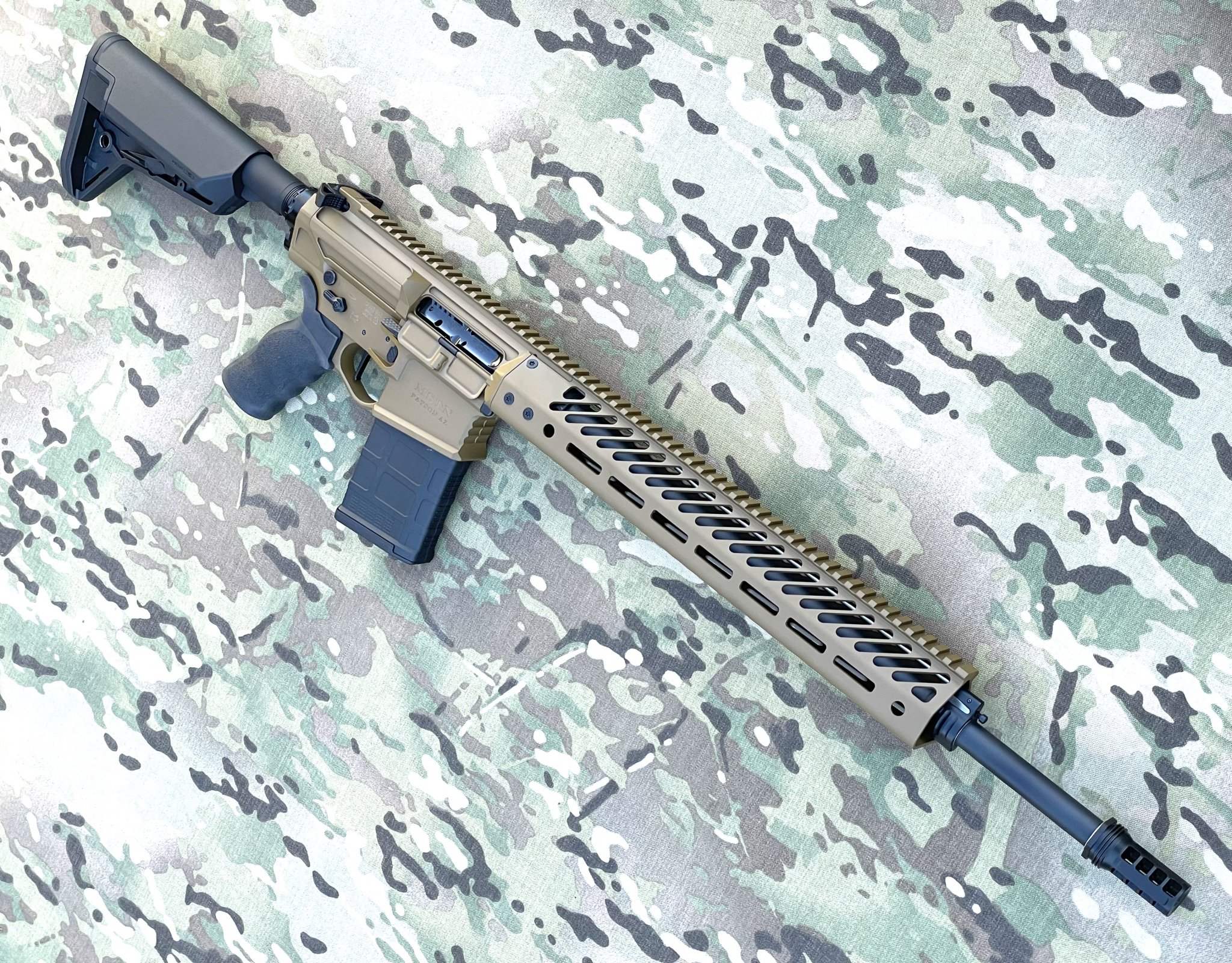

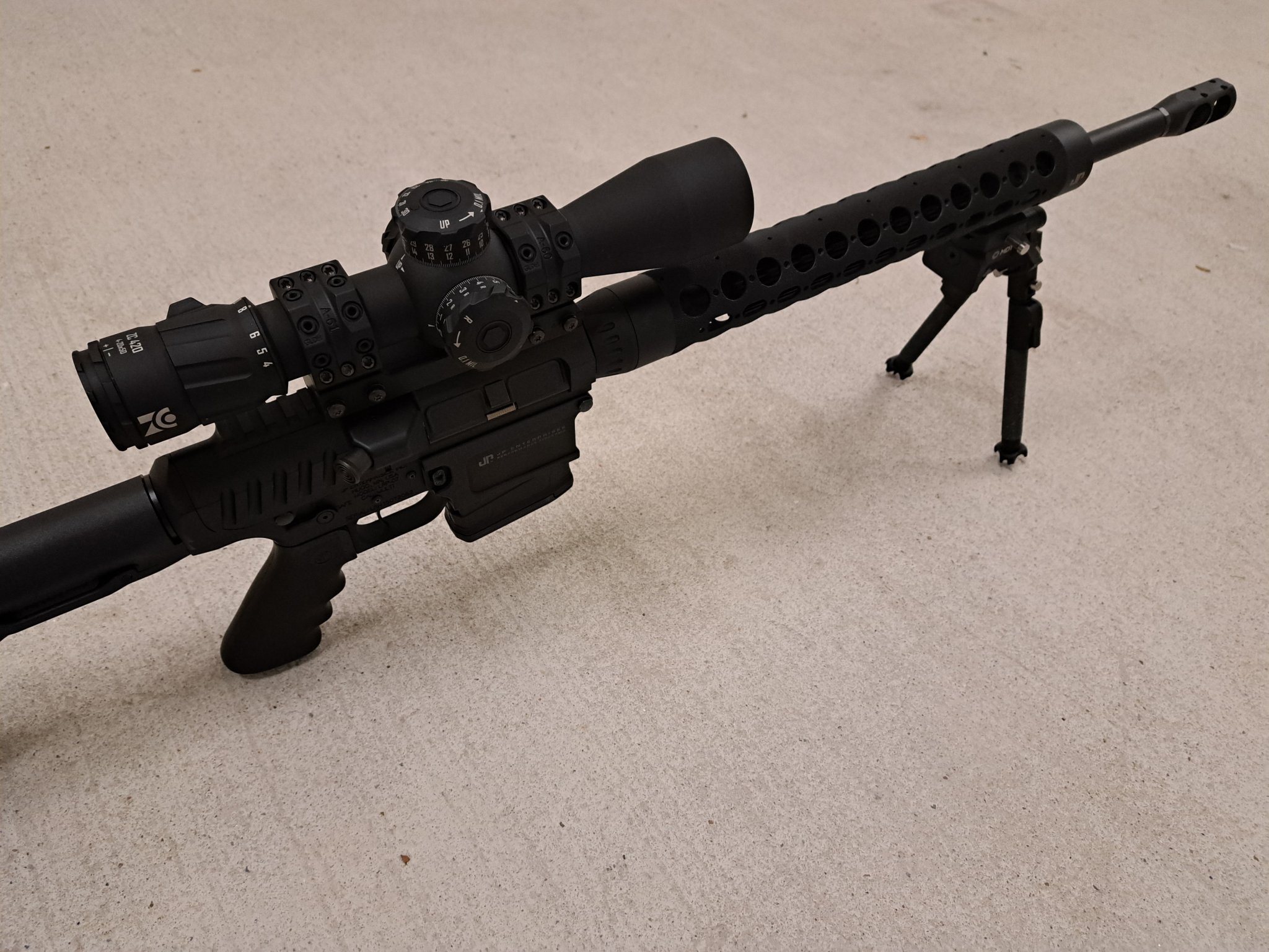

OBR sporting a new piece of glass…

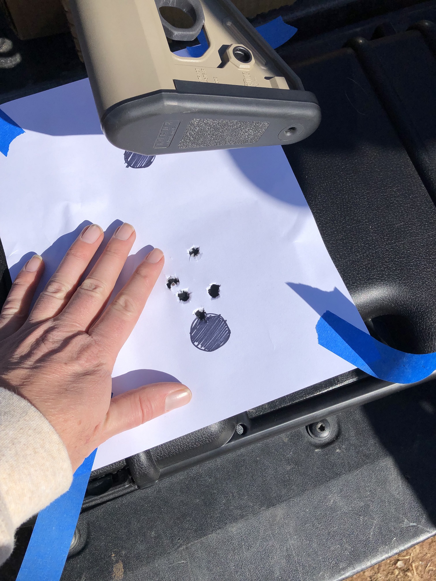

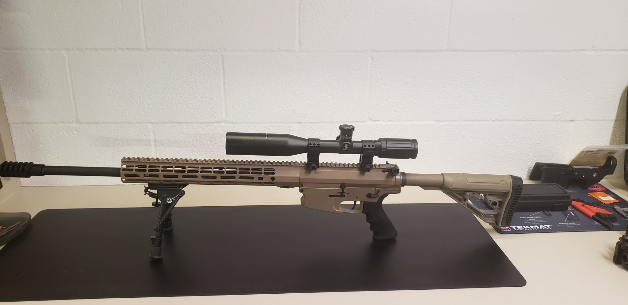

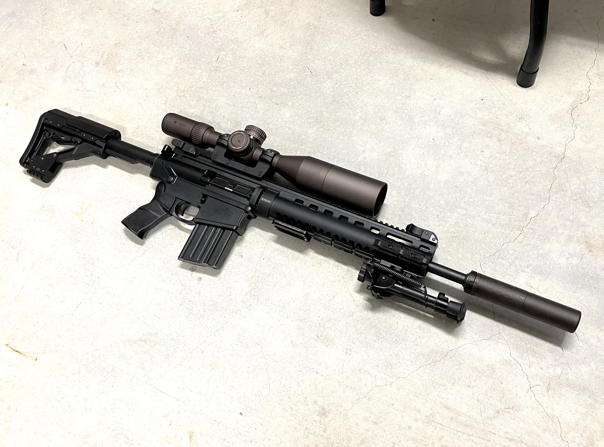

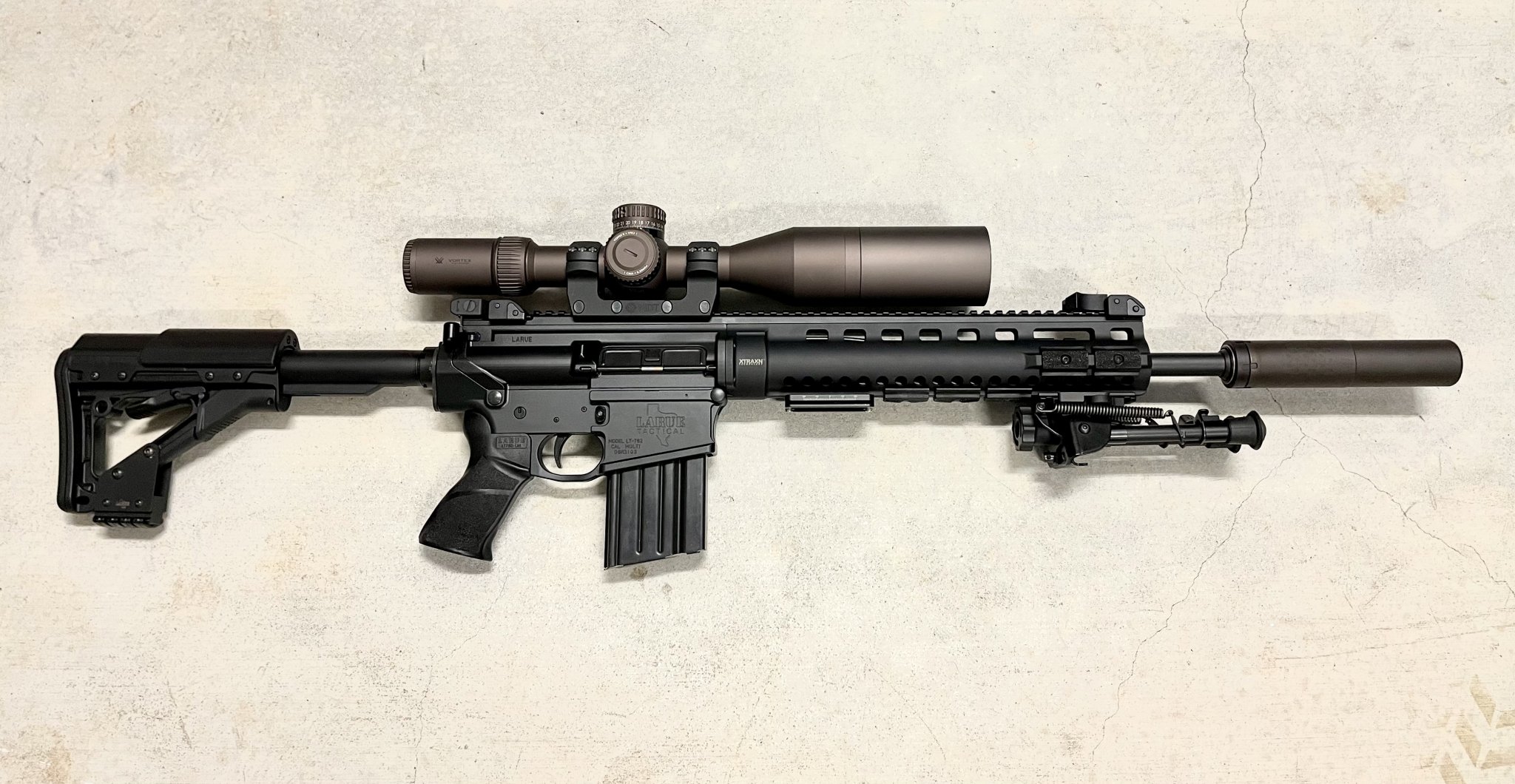

Testing out the "old" site. My JP LRP-07. Has the dual charging upper. I picked it up from another hide member from the scout site. SAS suppressor, Burris XTR II 4-20 in AD mount.
[IMG2=JSON]{"data-align":"none","data-size":"full","src":"http:\/\/i28.photobucket.com\/albums\/c208\/amphotericzenki\/IMG_0819_zpsswwbub9b.jpg"}[/IMG2]
I havent had time to really test accuracy, but I did shoot a quick MOA group out of the back of the truck off the cheap bipod when sighting it in. Smoothest AR platform I've shot yet.
Which case are you using?
Specs/details?

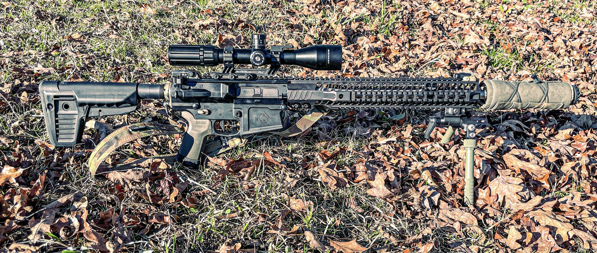

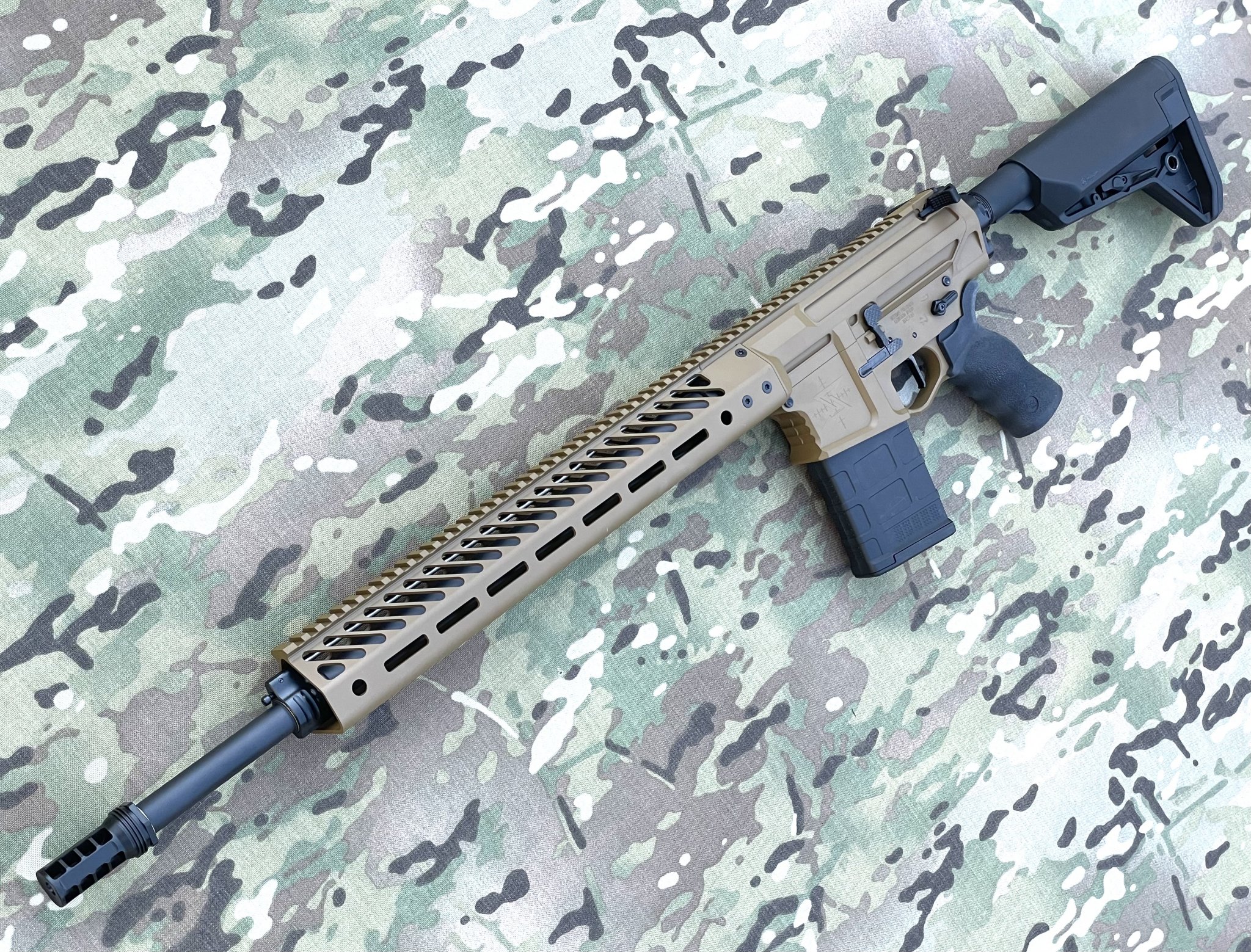

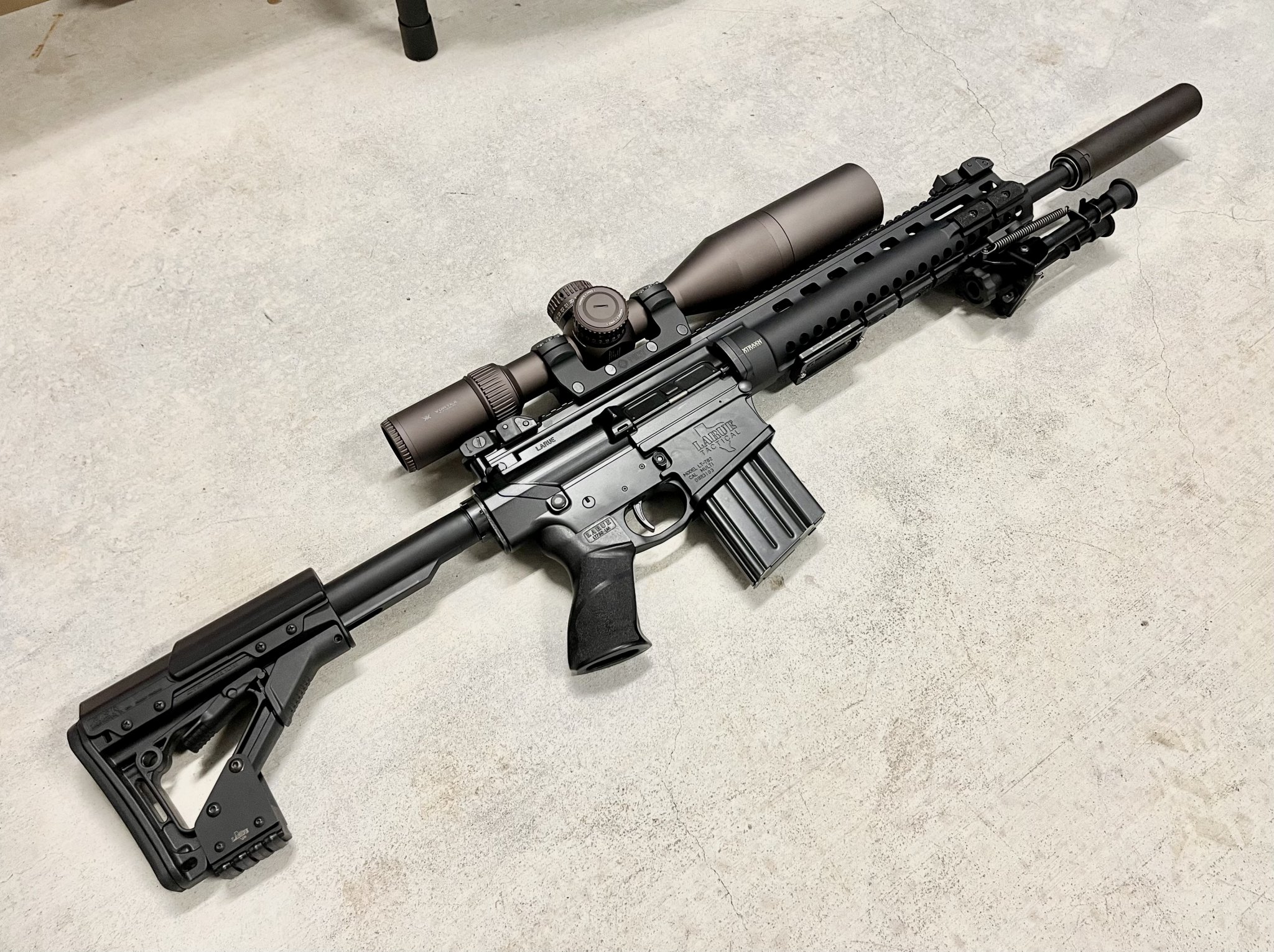

Upper:
Ballistic Advantage receiver set (same thing as the Aero)
Wilson Combat Recon 16”, 1-11.25” barrel
OSS Helix 762 QD on their flash hider
SLR Quad 15” handguard
SLR Sentry 7 gas block
Wilson Combat intermediate gas tube (between mid and rifle length)
Aero BCG
Radian Raptor SD handle
Lower:
Geissele SD-E
Radian Talon ambi safety
Magpul K2+ grip
Aero M5 LPK
Phase 5 bolt catch/release (essentially a one piece BAD lever
Vltor RE10 buffer tube
Springco Green spring (may change to a Red or Orange)
KAK standard length H2 buffer
BCM Mod 1 stock
Stuff:
Primary Arms mount + their RDS top ring to eventually host a 509T
SWFA 3-9x42
Magpul MBUS Pro-LR
Atlas CAL v2 on an ADM QD mount
Trex sling
Armageddon Gear suppressor cover
Will most likely end up with a Cloud Defensive Rein 3.0 on there along with the mentioned 509T, and a multicamish point scheme. This is assuming it works, and I enjoy it.
Finished this build today. Might need to switch to an orange Springco spring as I have a green one, but I’ll figure that out when I shoot it. Still needs an RDS, light, and paint.

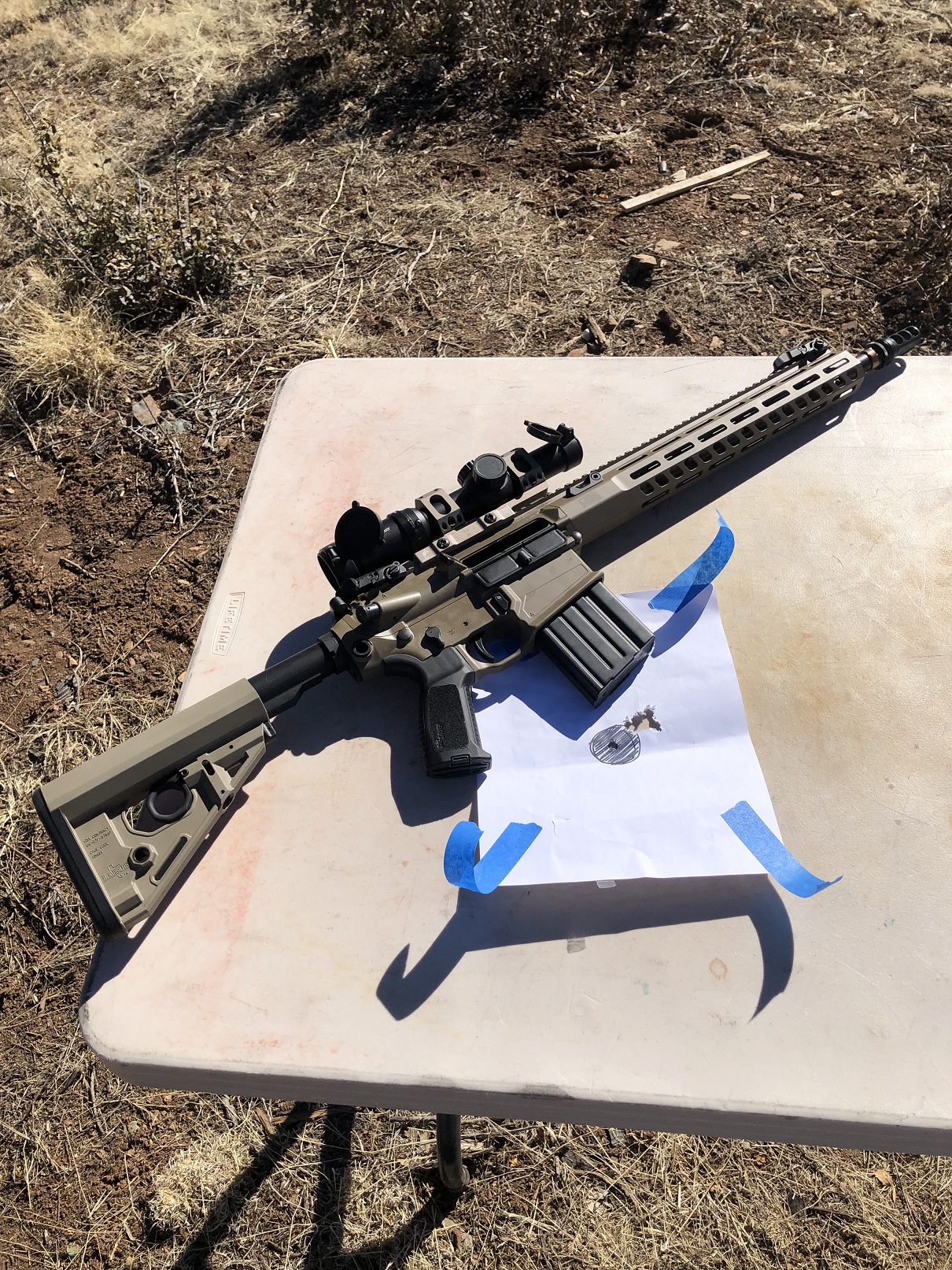

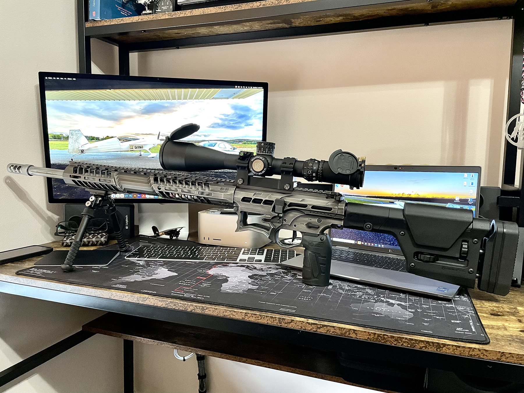

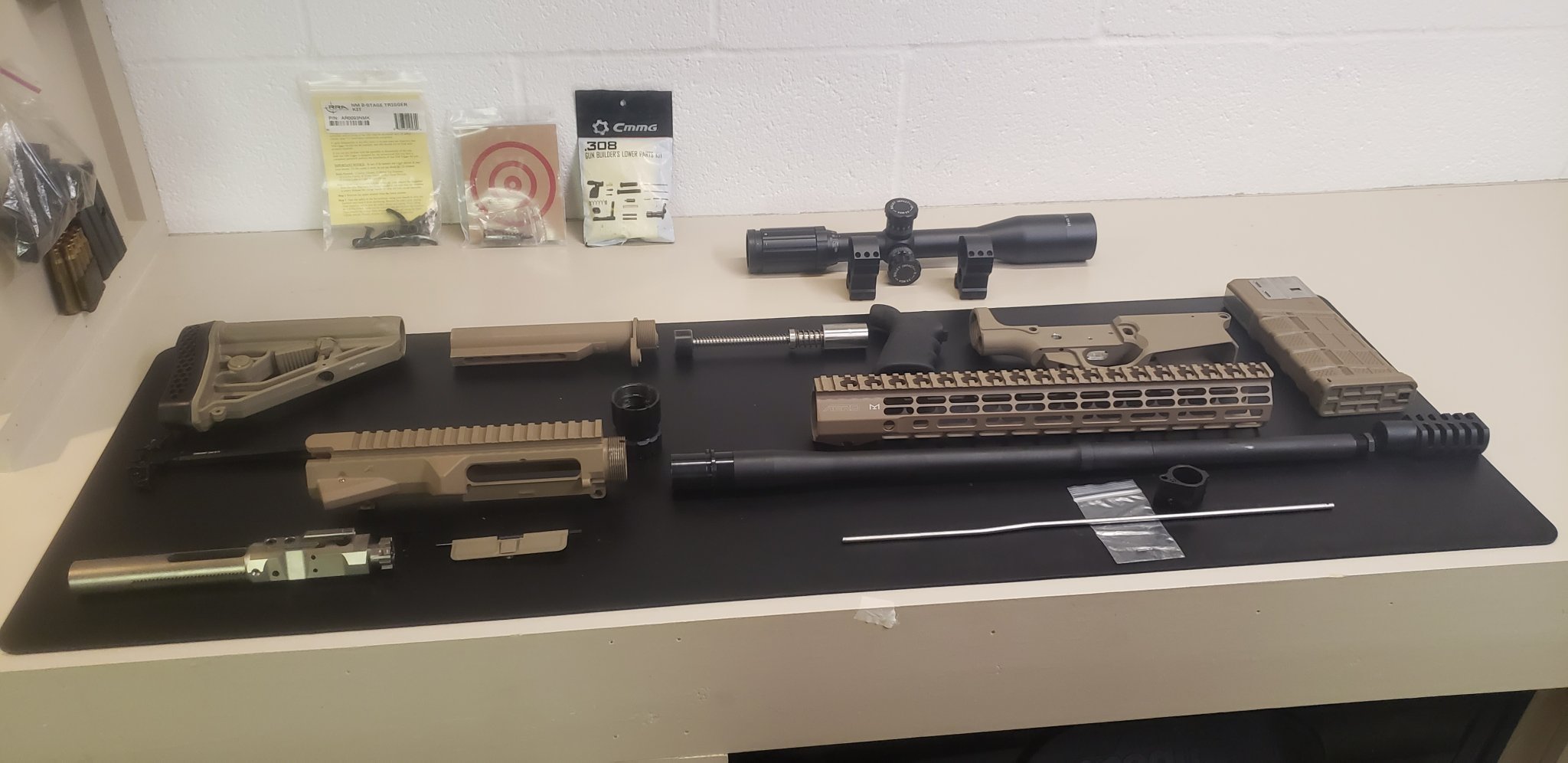

First large frame, probably not my last.View attachment 8047908

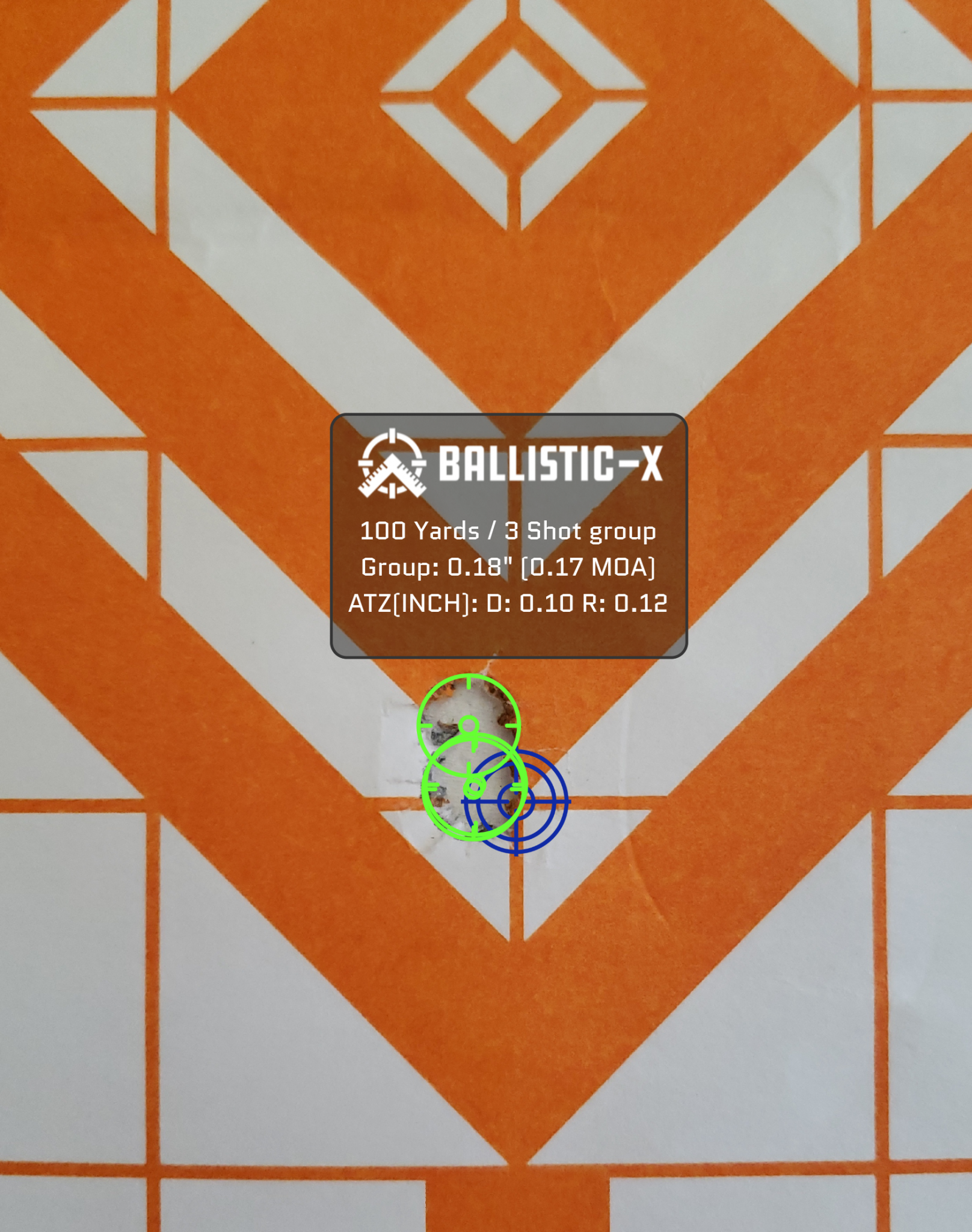

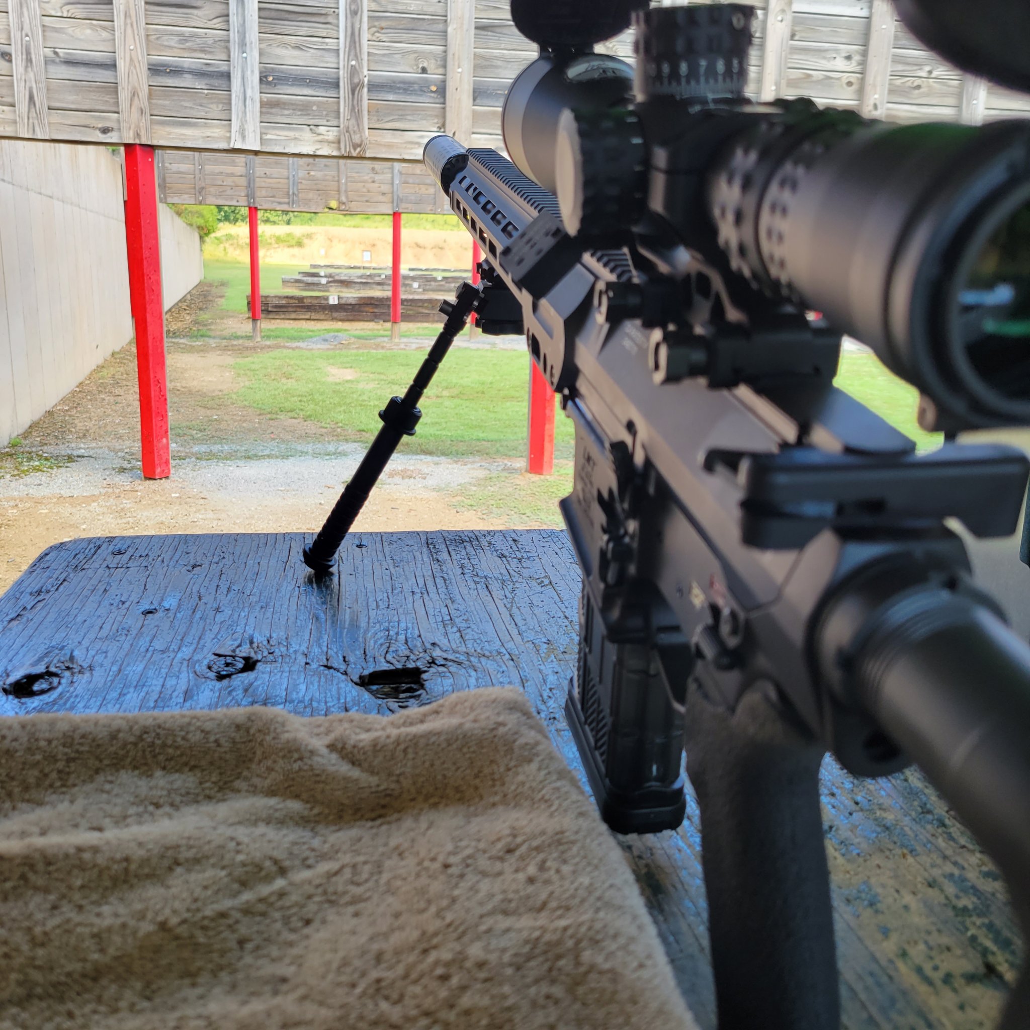

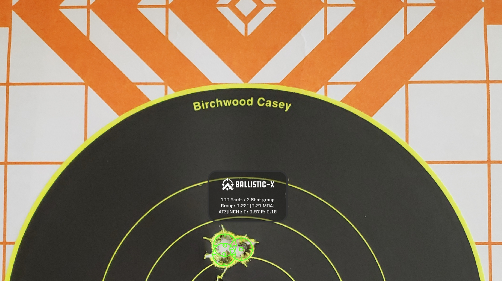

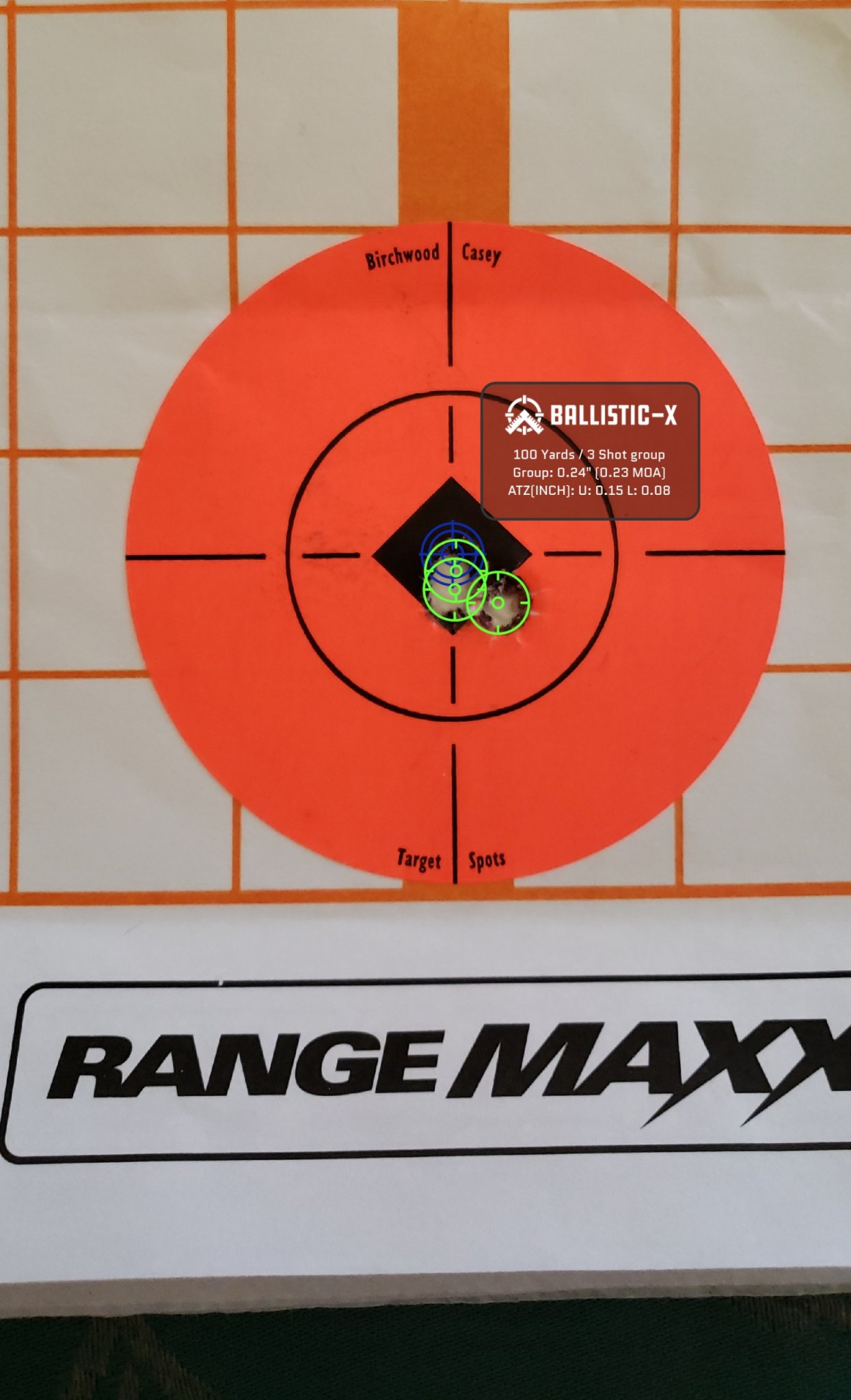

First few groups at 100y today. Nothing impressive with American Eagle 150 FMJ being the best 5 round group. AE top right, 175 FGMM center, S&B M80 bottom left, Winchester M80 bottom right. The drawn squares are about 1-1.5”. I learned today that a large frame exposes EVERY flaw in your fundamentals. These are not forgiving.

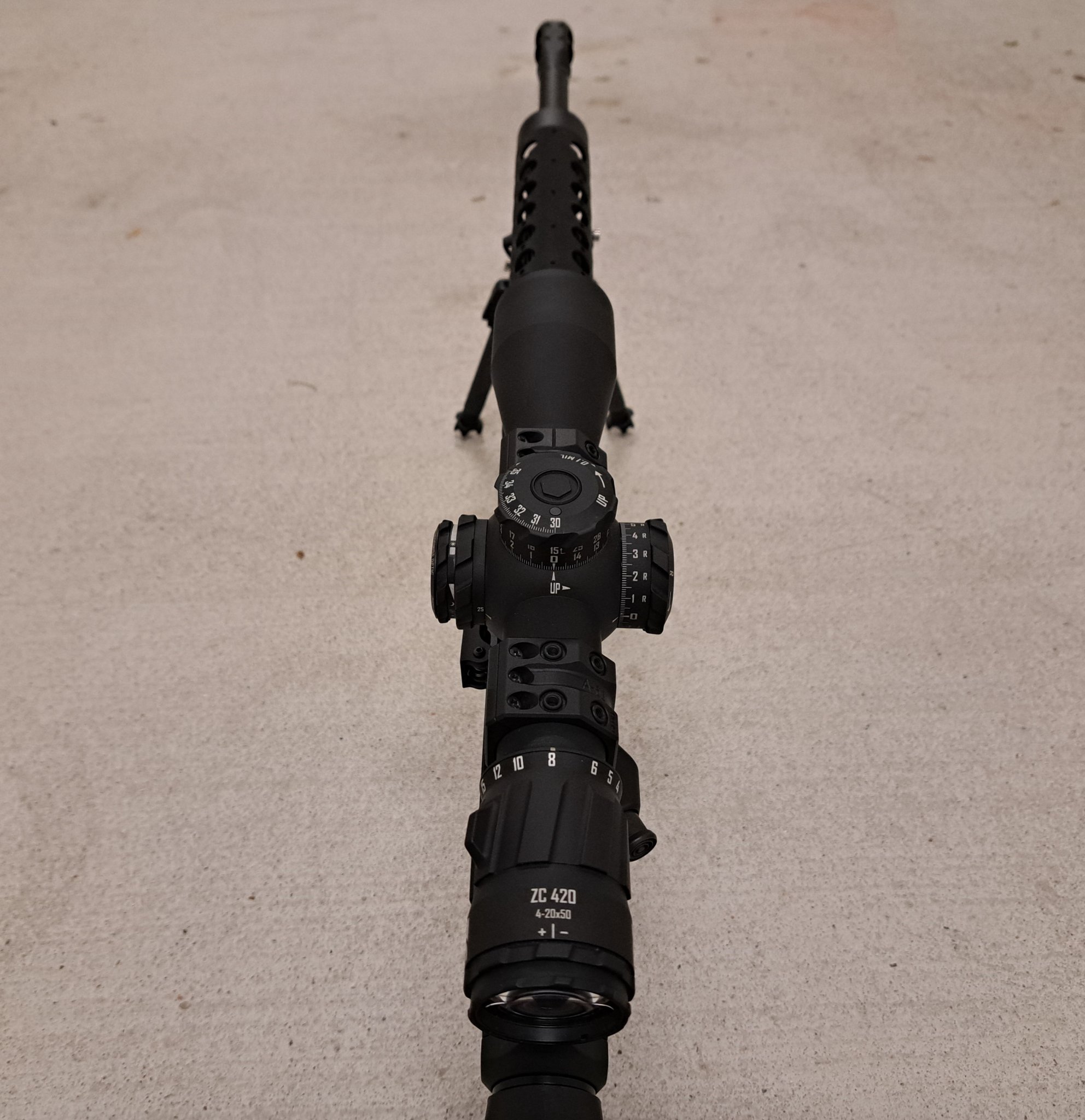

JP LRP-07 .308, ZCO 4-20, TriggerTech Diamond, MDT CKYE Pod, FGMM 168

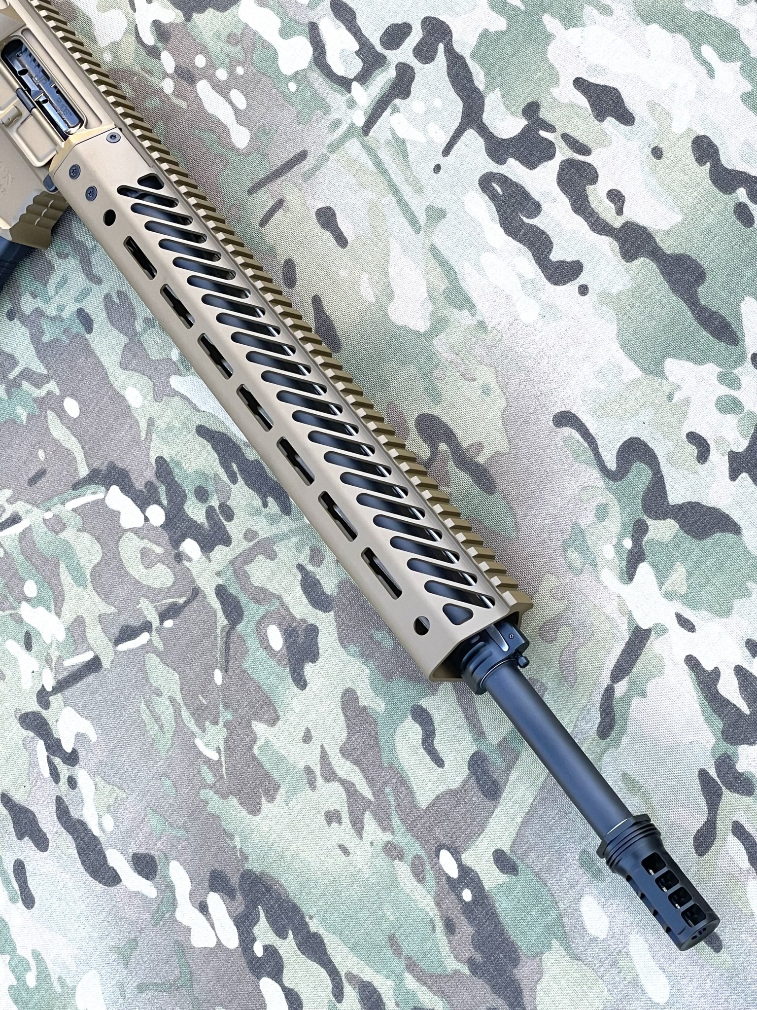

Thinking about building a "SPR" type rifle on an Aero set.
I want to keep it at about 10-12 lbs with scope.
I am looking at Criterion 18" hybrid barrels as I kinda want to keep weight down a bit and not end up TOO muzzle heavy.
Any other recommendations for barrels?

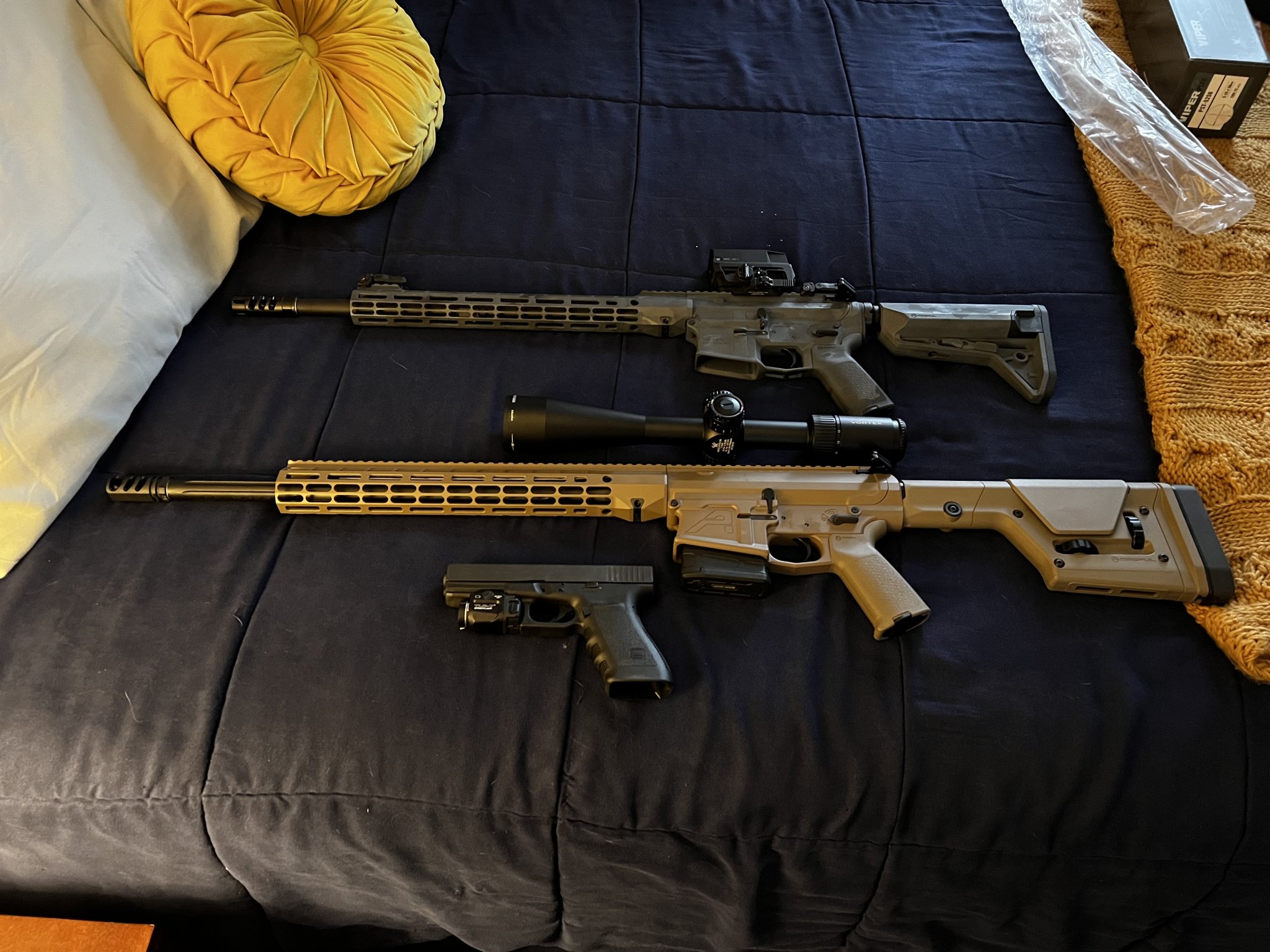

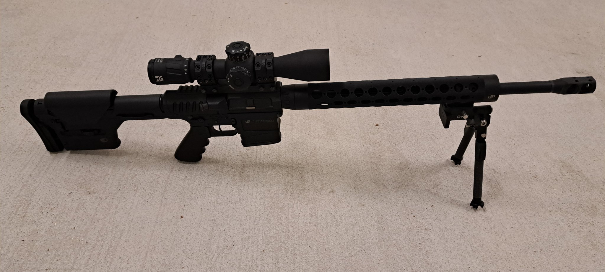

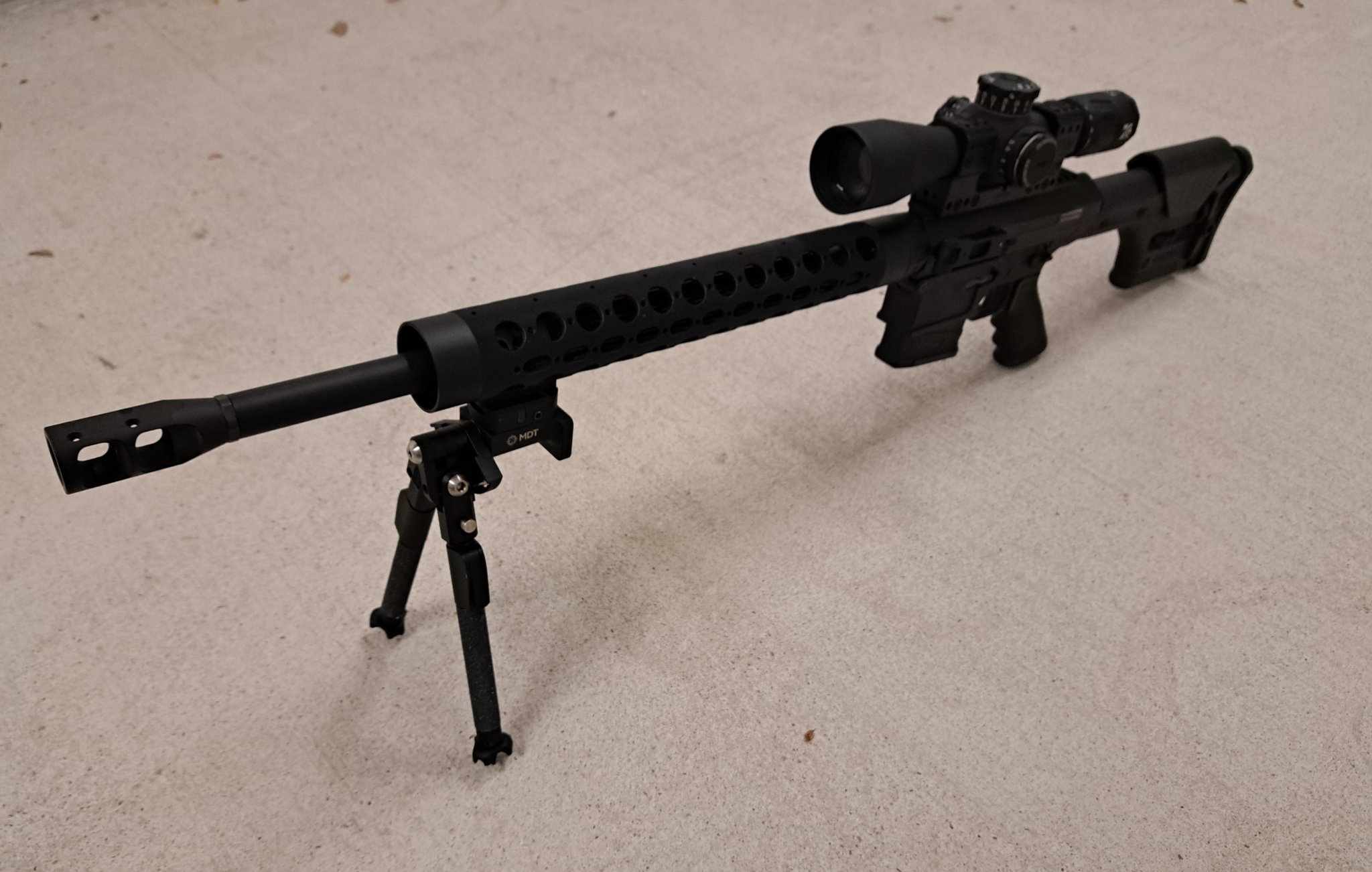

Wilson Combat Recon at 32ish oz.
This build as pictured is about 11.6lbs (minus bipod). This is an 18oz SLR rail as well, so you could definitely shave some weight with an MLOK handguard.

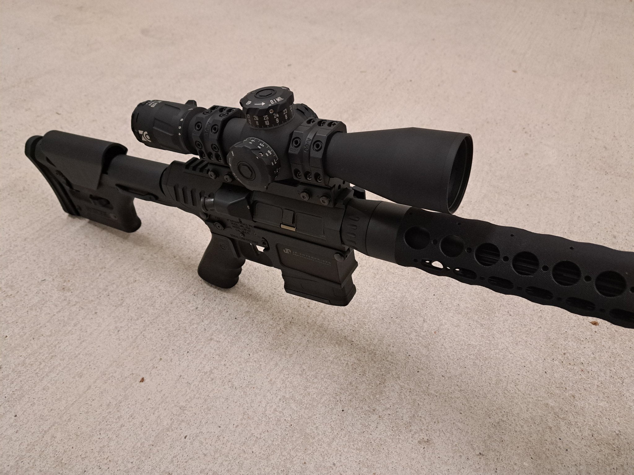

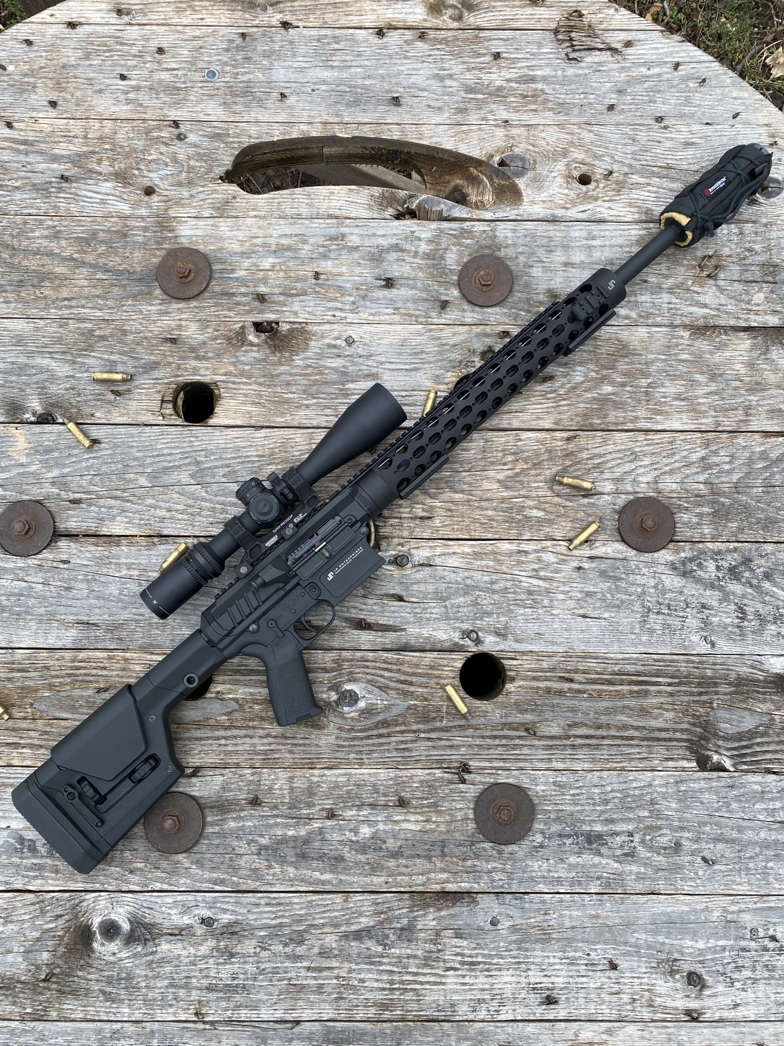

  • F-1 Firearms BDRx-10 Receiver Set
  • F-1 Firearms C7M 16.75” Handguard
  • Craddock Precision/Bartlein 22" 1:8 Barrel
  • Area 419 Hellfire Muzzle Brake
  • Geissele SD-E
  • JP AR10 Heavy H2
  • JP Full Mass w/ Enhanced Bolt
  • JP Enterprises Silent Captured Spring
  • Magpul PRS Gen 3 Stock
  • Wilson Combat Tactical Bolt Release
  • Seekins Billet Magazine Release Button
  • Breek Arms Warhammer Charging Handle
  • MDT Vertical Grip
  • Nightforce ATACR 7-35x56mm F1, Mil-XT

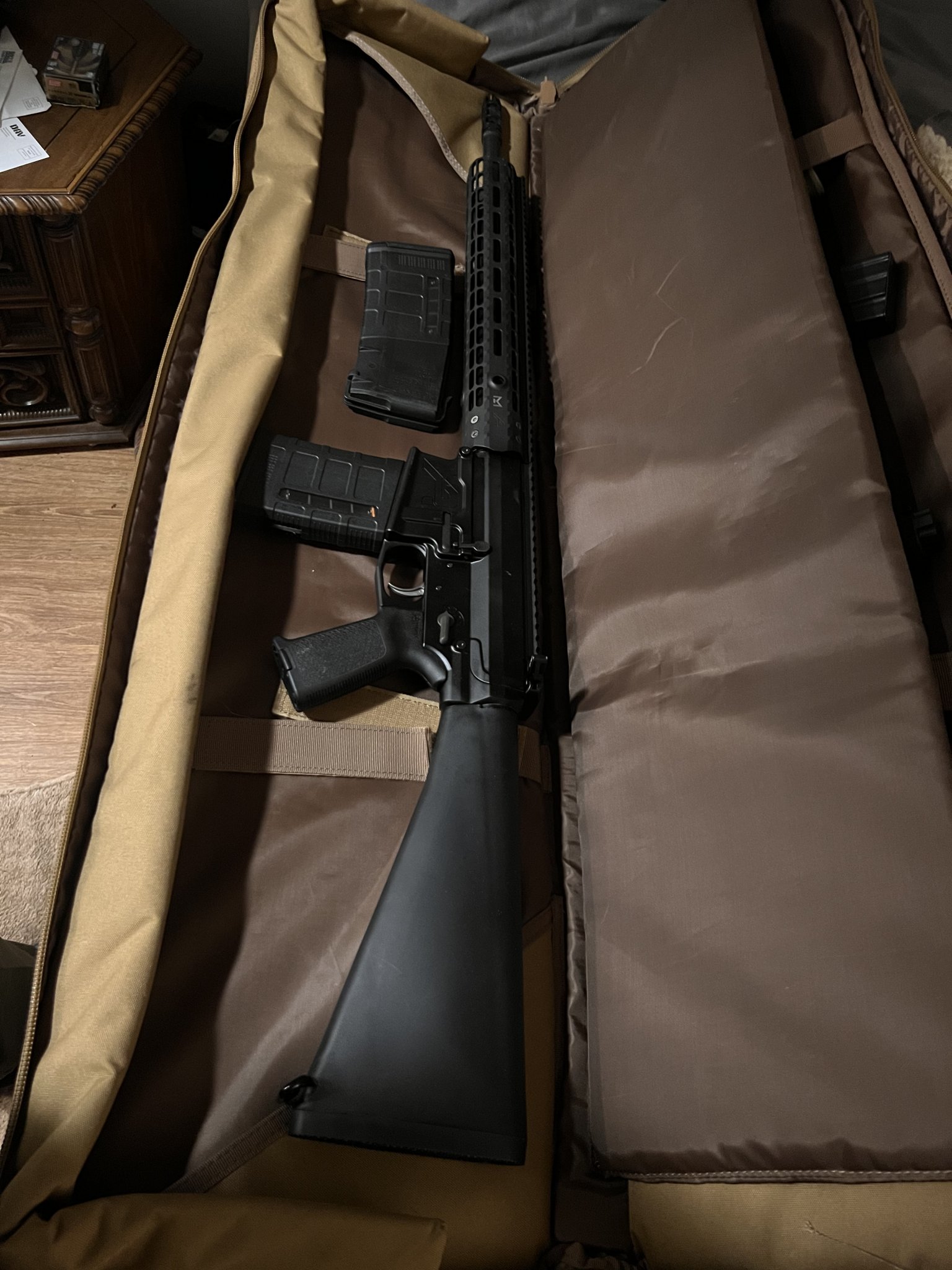

Just got the upper back from Craddock and got it all together.
Edit: Binding likely to be because I'm an idiot and didn't use the spacer since it's a rifle length tube.

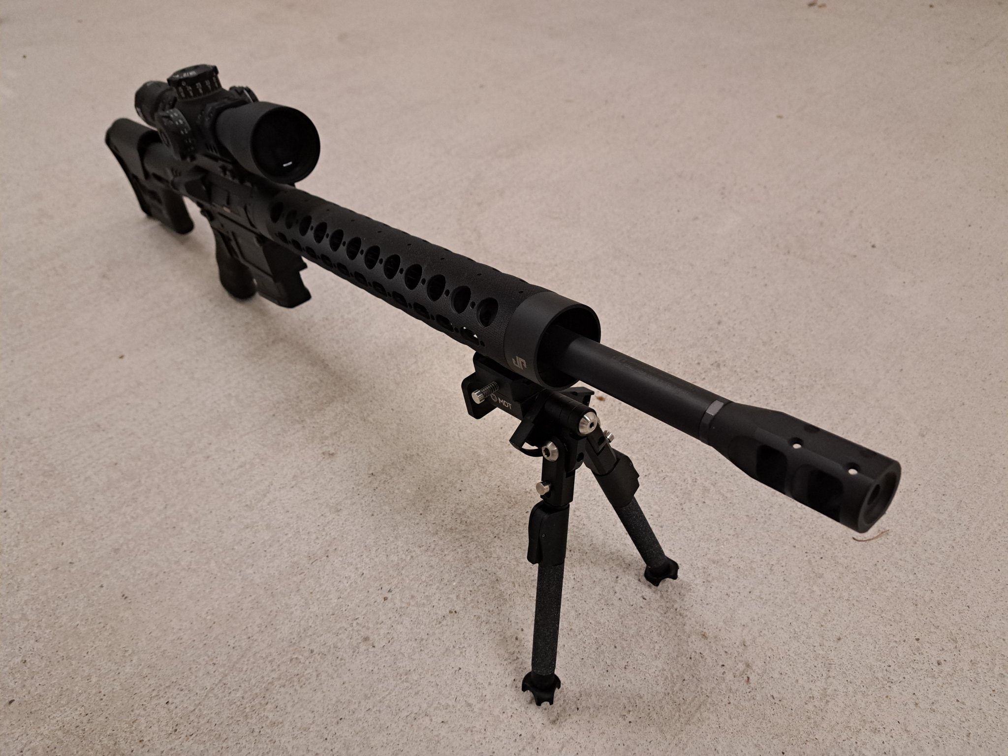

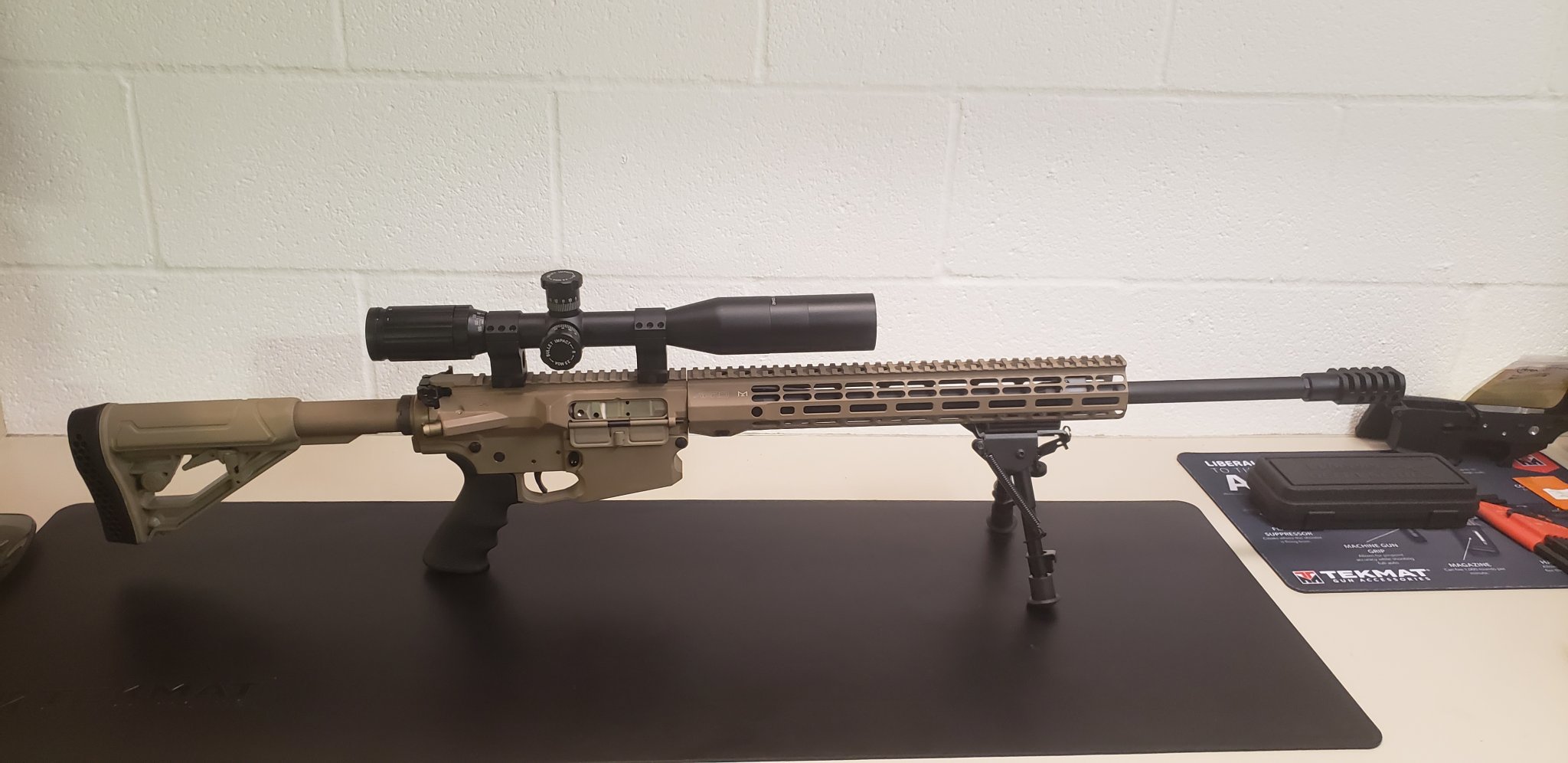

Aero upper, lower, hand guard, LPK and charging handle
SSA-E trigger
PRS srock
Magpul grip
Wilson Combat 20” .308 barrel
Rubber City high pressure BCG
M4-72 muzzle brake
Vortex PST Gen II 5-25
Looking at scope mounts right now. Haven’t picked one yet.

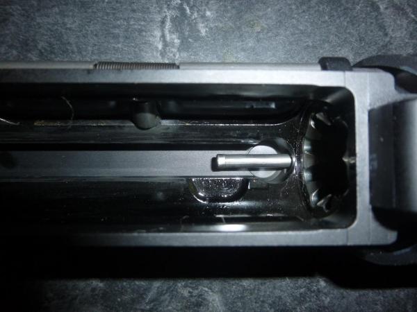

If you can't manually pull it back far enough for the bolt catch to lock on the BOLT FACE, then you have the wrong spring in there. I can affirm this will happen if you have a normal AR15 carbine spring instead of the correct 308 spring. If you CAN lock back on the bolt face by manually pulling the charging handle, then you're under-gassed.
The gas tube should extend to the halfway point of the cutout for the cam pin, as viewed from below through the magwell.
If your gas block is retained by set screws, make absolutely sure it's in the proper place and set screws tight.
Make sure the gas block is open all the way until you get this sorted out.
By all means, you should NEVER have to go even lighter than your Aero buffer.
When checking for function always properly shoulder the weapon so it will have something to recoil against, otherwise it may short stroke.
Oil the crap out of your BCG at least until you have like 200-300 rds through it.
Just put one rd at a time in the magazines for testing and use multiple magazines to rule out the possibility of a weak one.

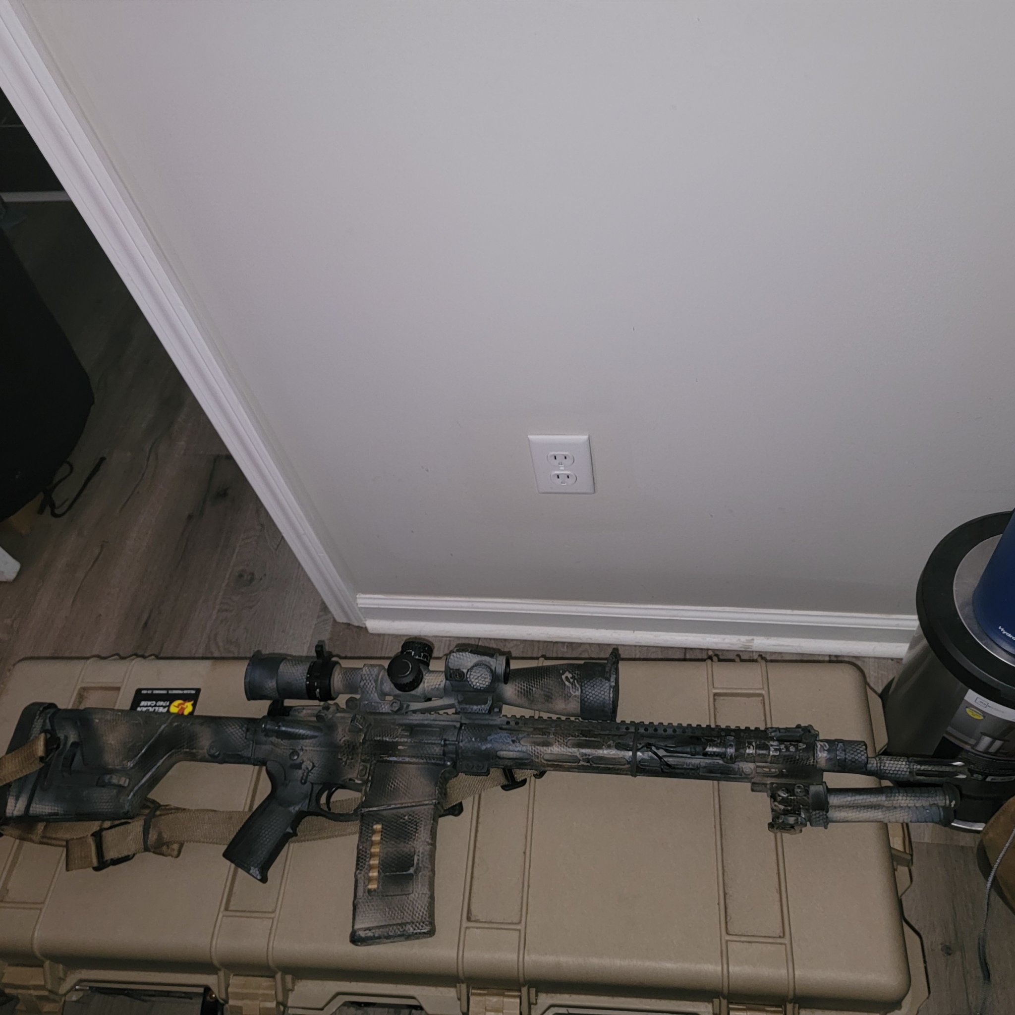

Here's my M&P10. Names Beatrice after my grandmother who raised and protected me all my life. She was a gift from my lovely wife.
Magpul PRS stock
Magpul MIAD grip
Radian Raptor CH
Geissele SSA-E trigger
Midwest Industries rail and gas block
Vortex Viper gen2 5-25x50 MRAD on a Vortex mount
Vortex Sparc Solar red dot on a Vortex offset mount.
Magpul MS1 sling
Surefire 640 light and pressure switch
Atlas BT10 bipod
Complete with an absolute shit rattle can job

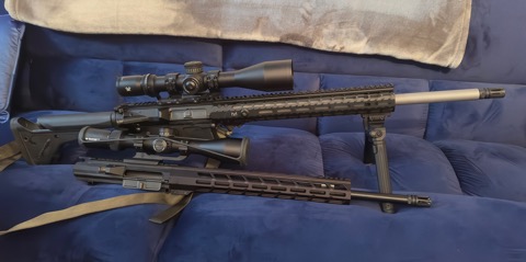

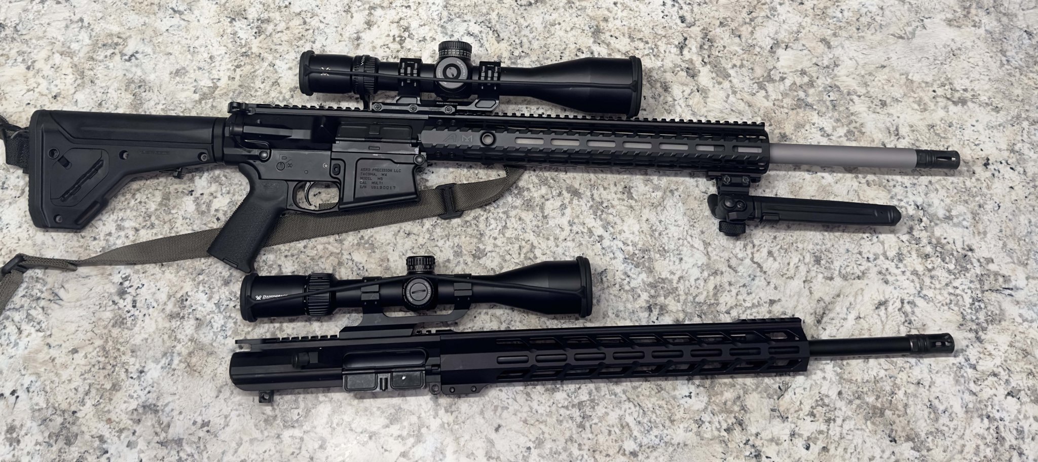

Took the LMT out a couple weeks ago. Decided to really put some effort into groups at 200 yds. Numbers are the order of groups shot with 20 rounds, same box of PMC X-TAC 168 OTM, loaded 5 shots at a time, and all shot suppressed. Two shots on both of the top groups were nearly through the same hole. Pretty impressed..... it's safe to say the gun is far more capable than I am. I think after shooting the top 2 groups, the 4th group opened up from my inner excitement.
Been meaning to pick up some 168s. My Smith loves the Xtac 147s. Haven't found a place to shoot over 100 since leaving Nevada, but at 100 I can stack rounds and I'm far from an expert marksman.
