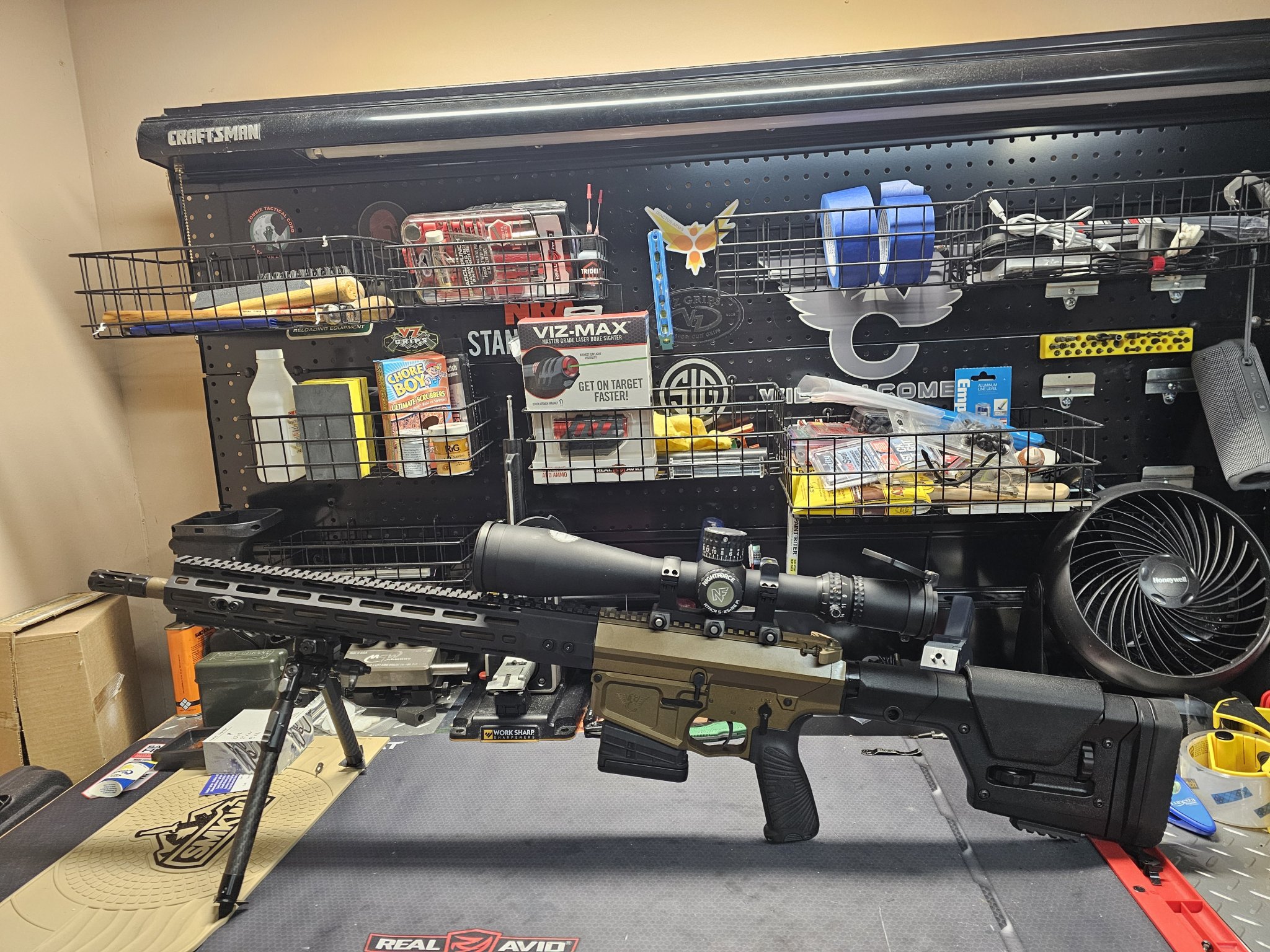

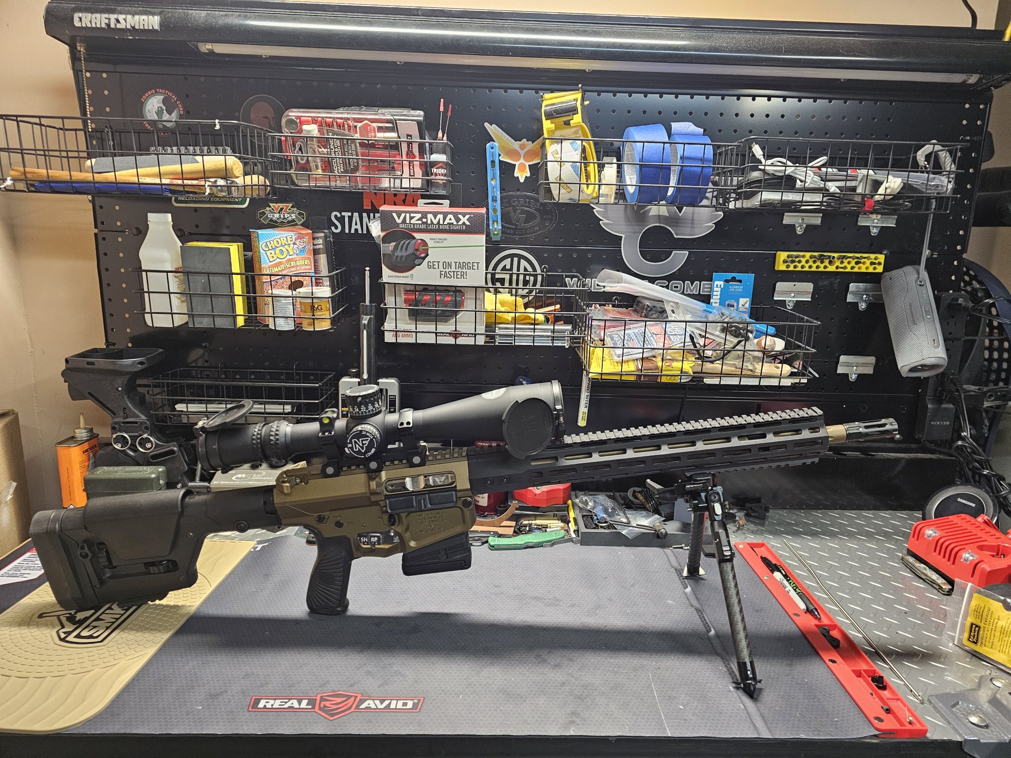

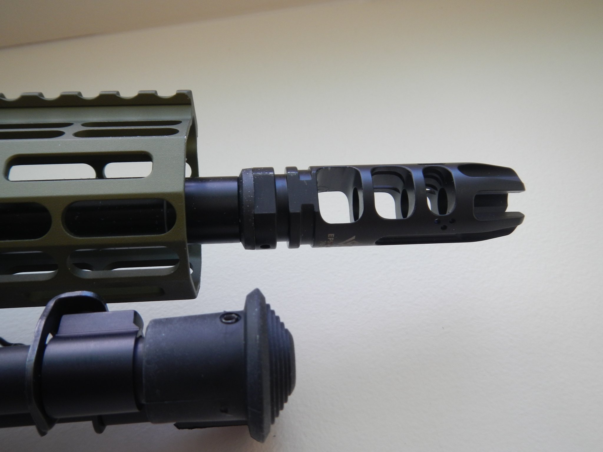

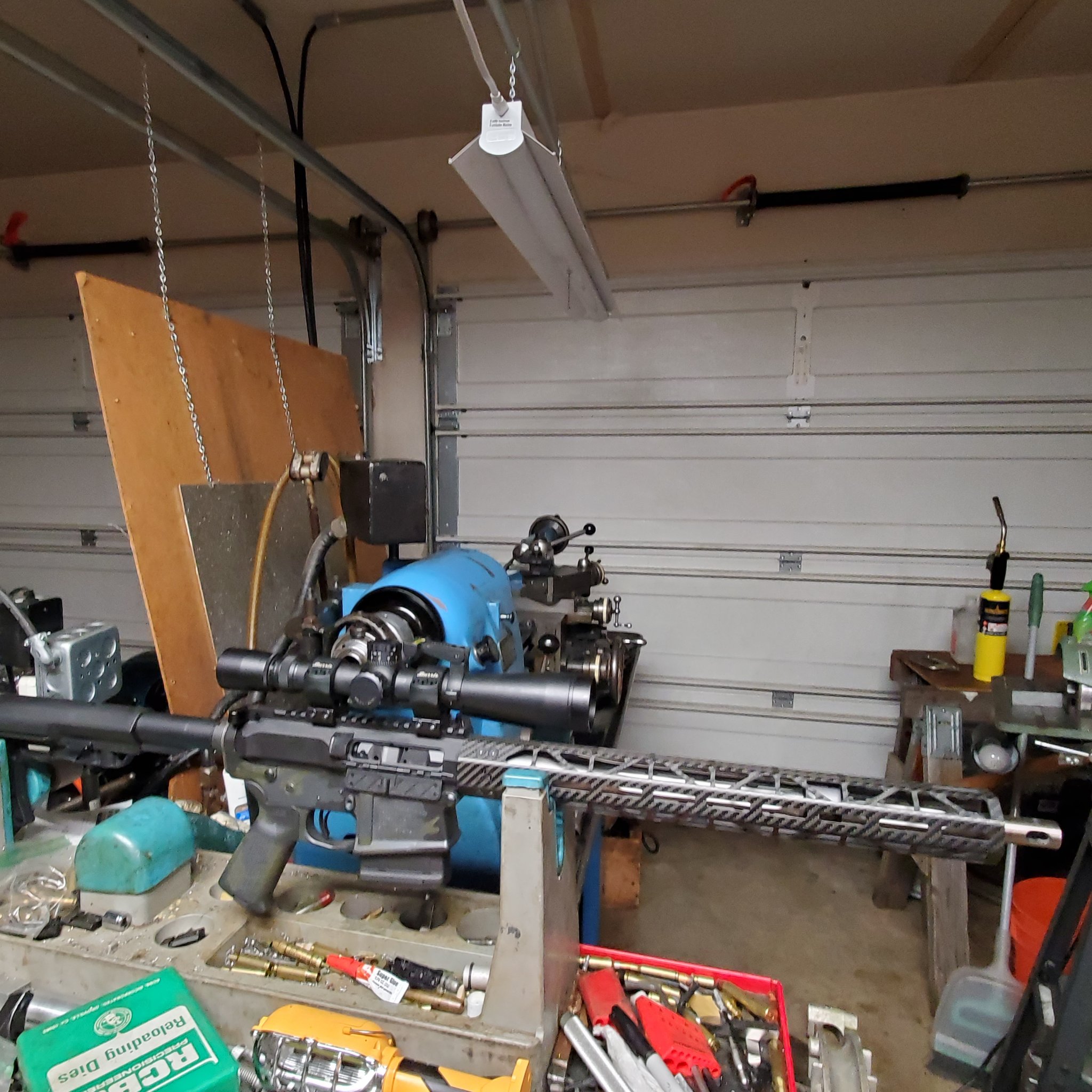

308 AR10 Build Info/Picture Thread

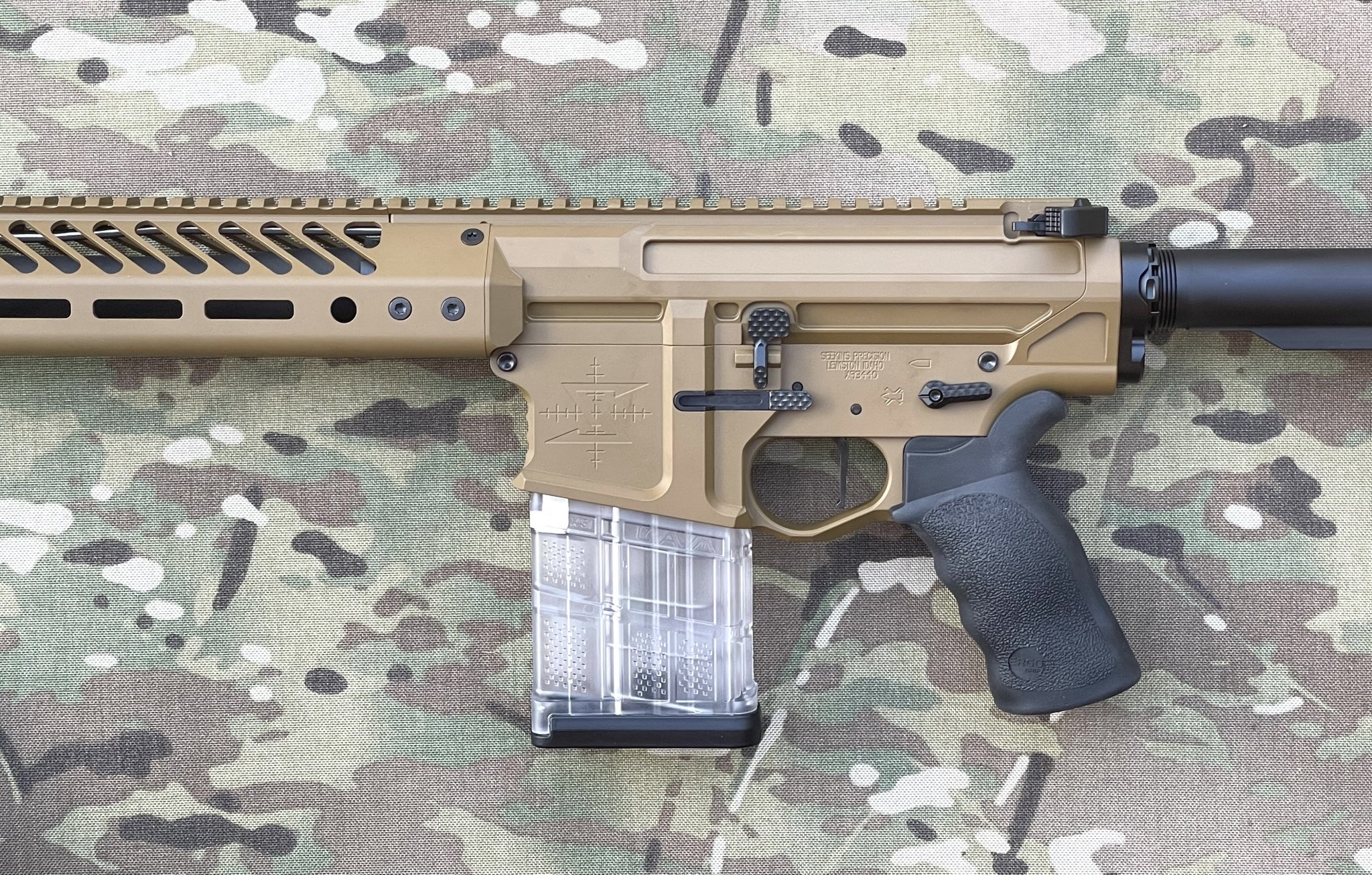

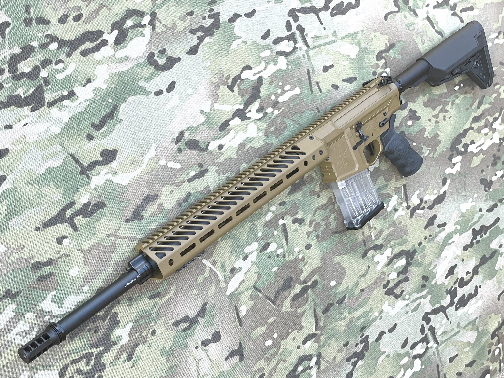

Receiver: ZEV LFAR lego set
Barrel: Shilen 20” barrel 1:9 twist
Bolt and Carrier: Shilen matching High pressure bolt, Lantac Enhanced carrier
Gas block: handmade adjustable gas block I did at work
Handguard: SLR rifleworks quad rail for that sexy M110 vibe
Trigger and controls: Geissele SSA-X trigger, Geissele controls and Radian Charging handle, Geissele Single side 90* selector.
Grips: Running between a local shops 90* grip and some random sand impregnated grip I got for cheap.
Glass and Mount(s): Kahles 624I and ADM 0moa mount, 45* warne topped with an ElCheapo Holosun I had left over from an SBR build. Considering an Acro or RMR piggy backed in ADMs M-Brace mount. Griffin Armament rear peep battle sight and Midwest HK fixed front.
Leg Spreaders: GG&G bipod from years ago.
Muzzle: Made in ID can I made for my 300RUM/30-378wthby before the barrels got torched. Looking into Allen Engineering M5-.30 with SPR mount or an AB Raptor 10 stack.
Figured it’d be a cool match to my dads Knights SR25 from the early 00’s.

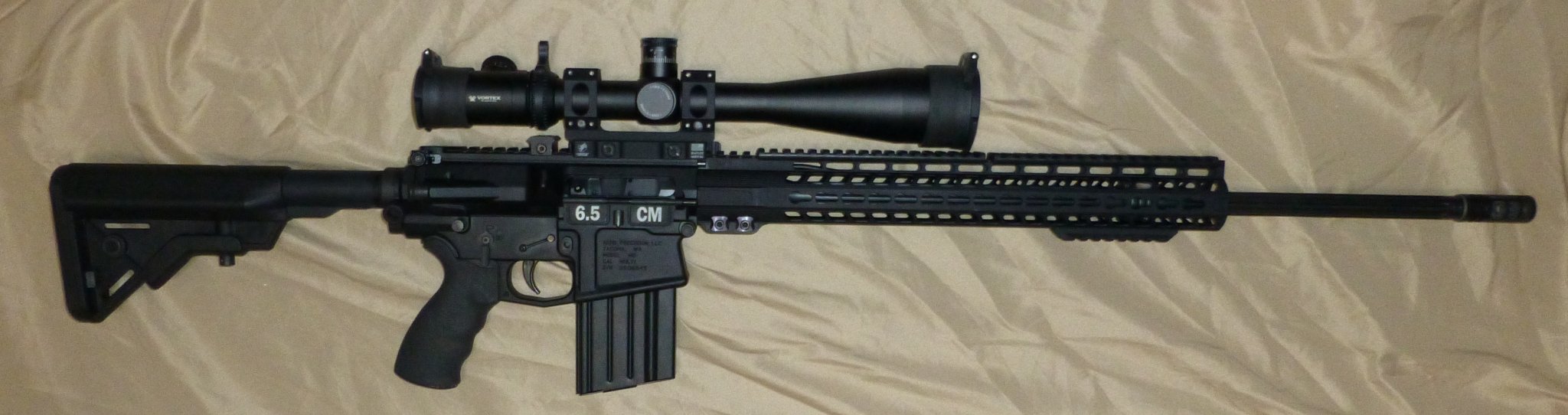

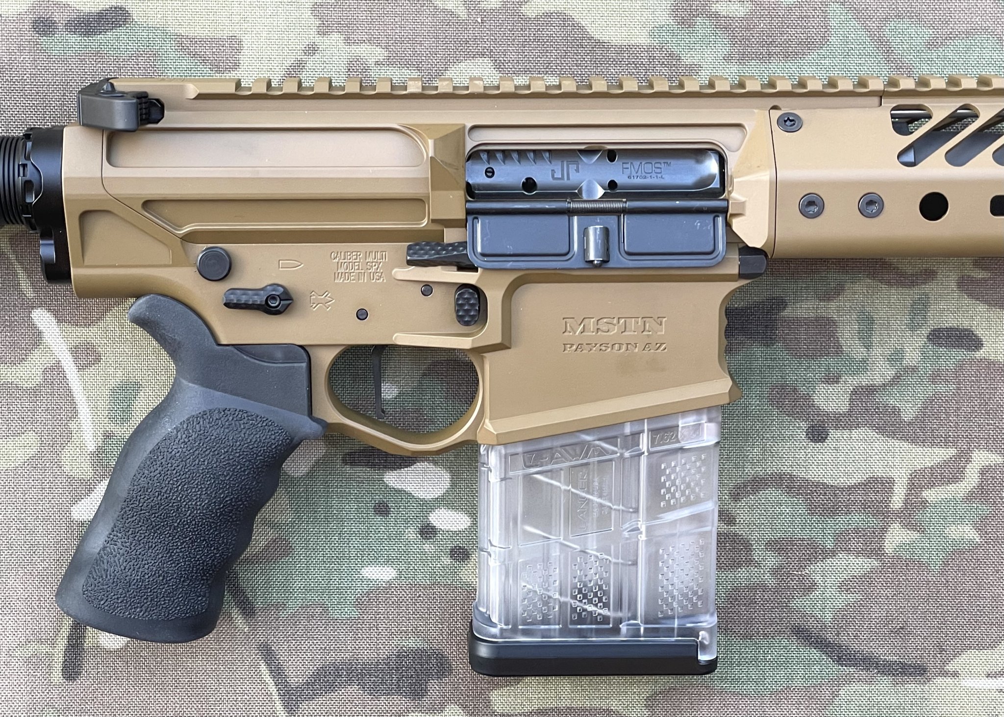

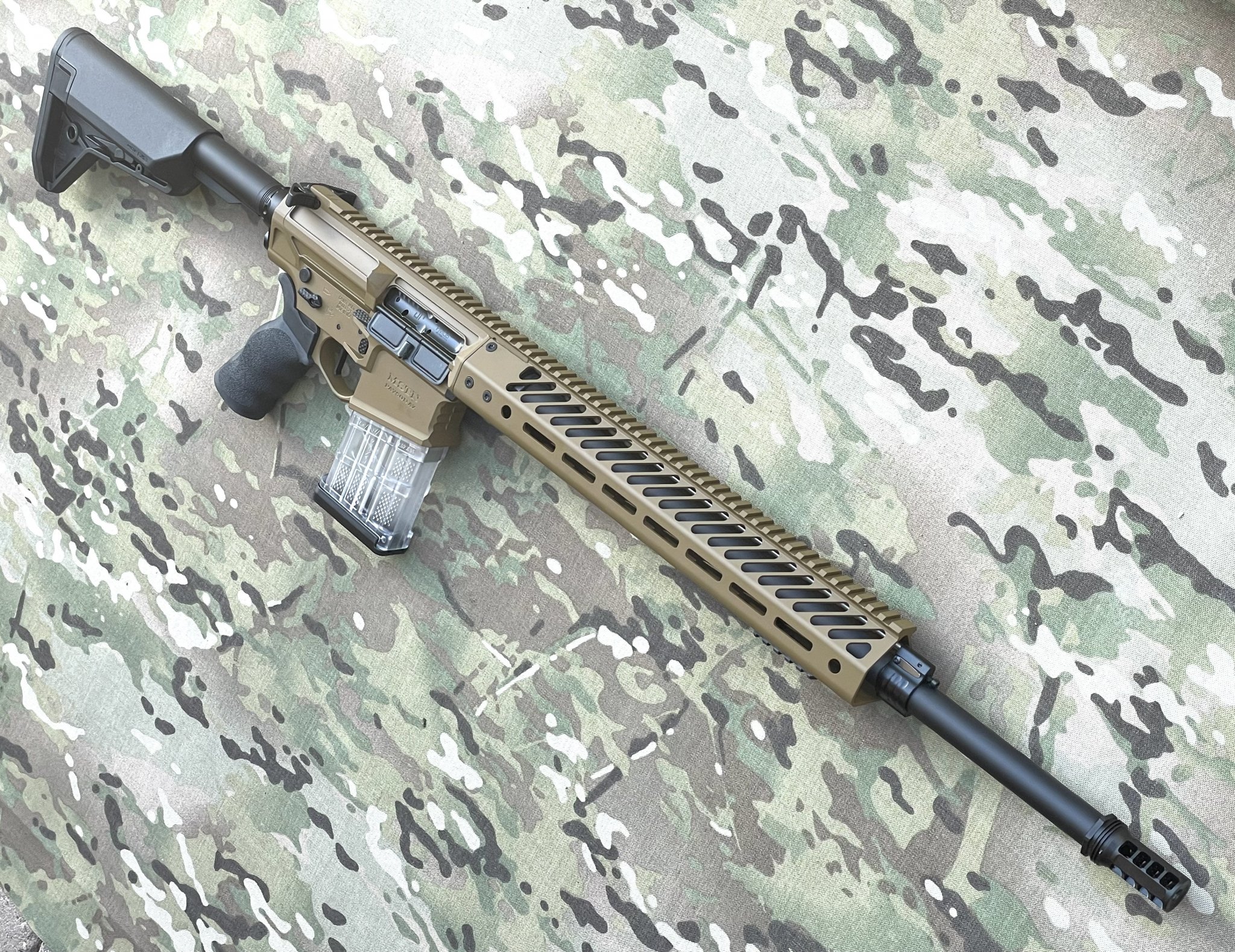

Just finished hammering together another really nice 6.5CM: Seekins SP10 Builder's Kit, done up in Accuracy Int'l Dark Earth Cerakote; Rock Creek 5R SS barrel by Craddock Precision; SLR adjustable gas block; JP FMOS bolt carrier group; JP H2 Silent Captured Spring Kit. I thought I'd see if it wanted to be a shooter, so I threw a scope on it. With no gas system tuning at all, groups were immediately sub-MOA with the first box of factory ammo I picked up.

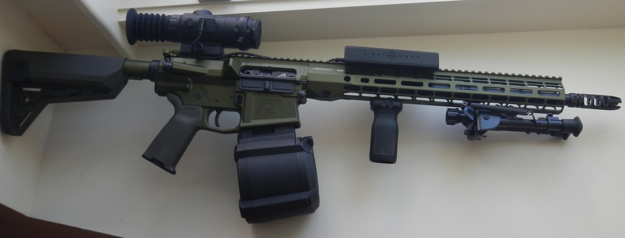

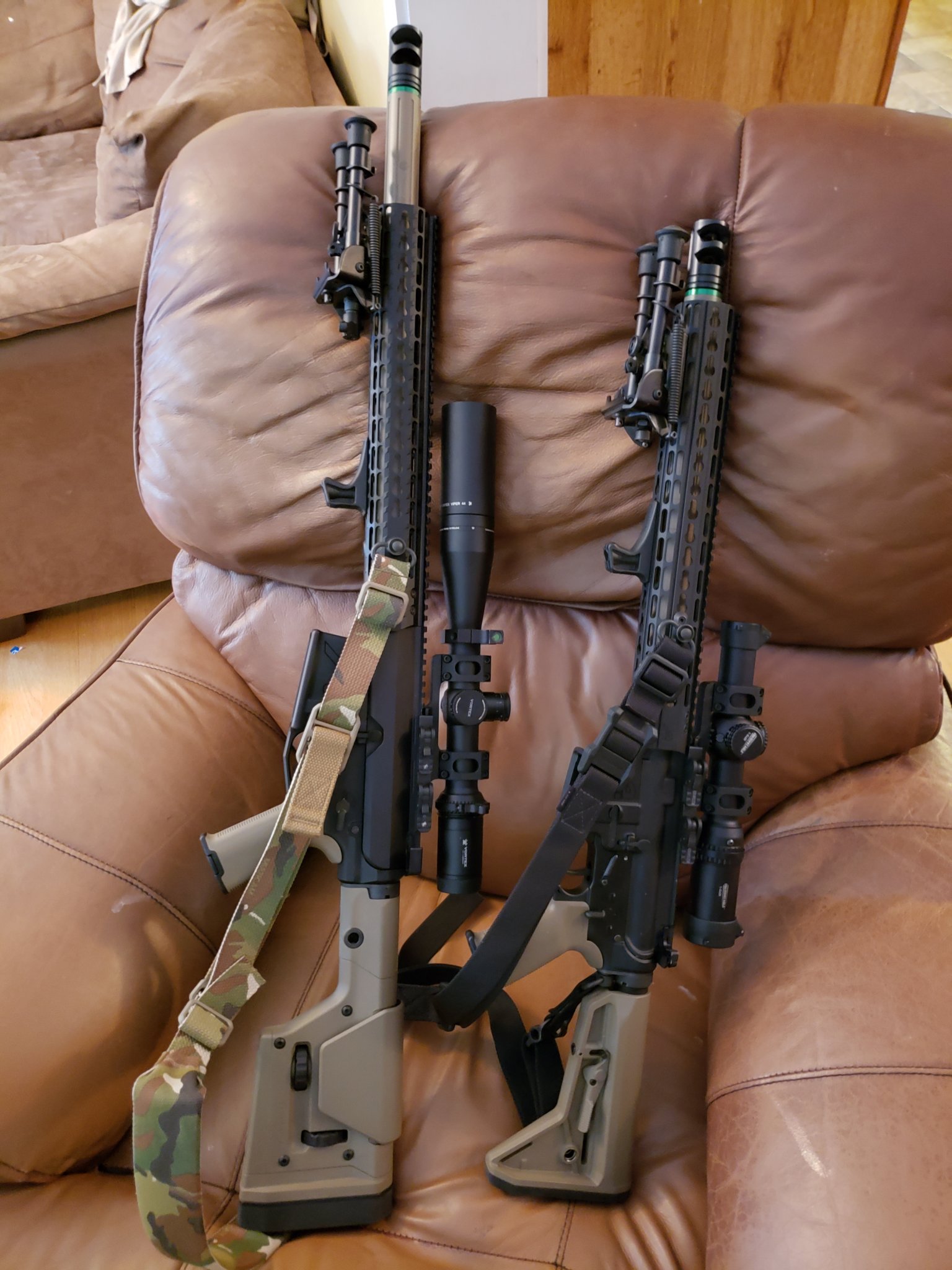

Here's my "twins". AR10 and 15, both Aero sets and handguards. More fun to shoot than they were to build.

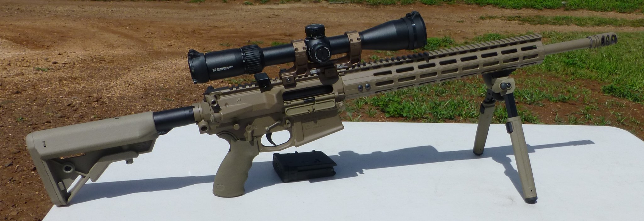

12:00 wind was brutal. There's a plate at 525 that you can hear get smacked if you crank it. Can is the F1 I built for my 26" 300wm.

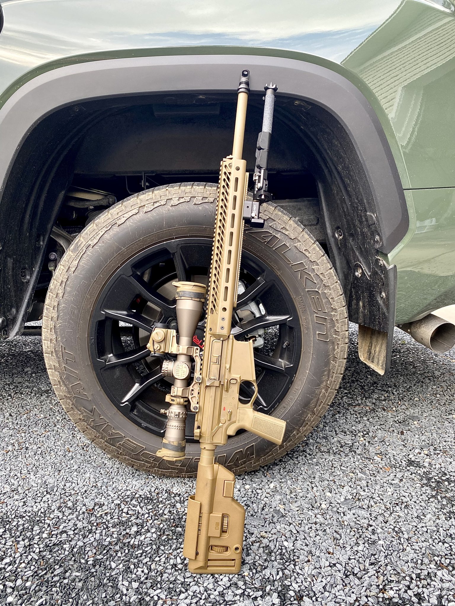

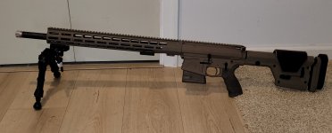

Still a work in progress, just aero upper/lower, prs gen 3, trigger tech for trigger, jp bolt, lmos carrier, silent capture spring, sentry 8 gas block, nos proof 22 plus 2. Caliber is 260, basically its what caliber I shoot, so I went with it, kac and asc mags help with coal. Showing some promise.

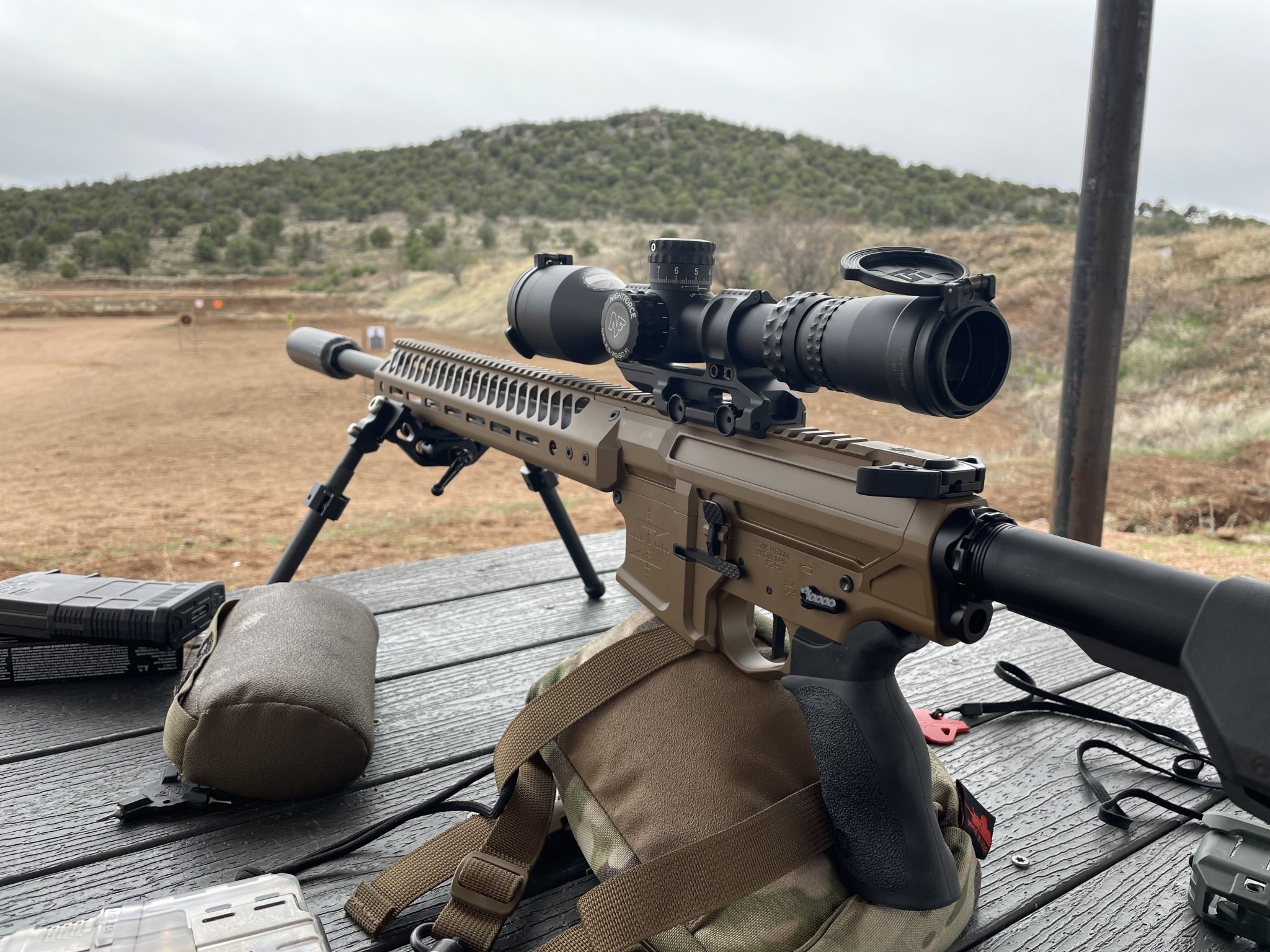

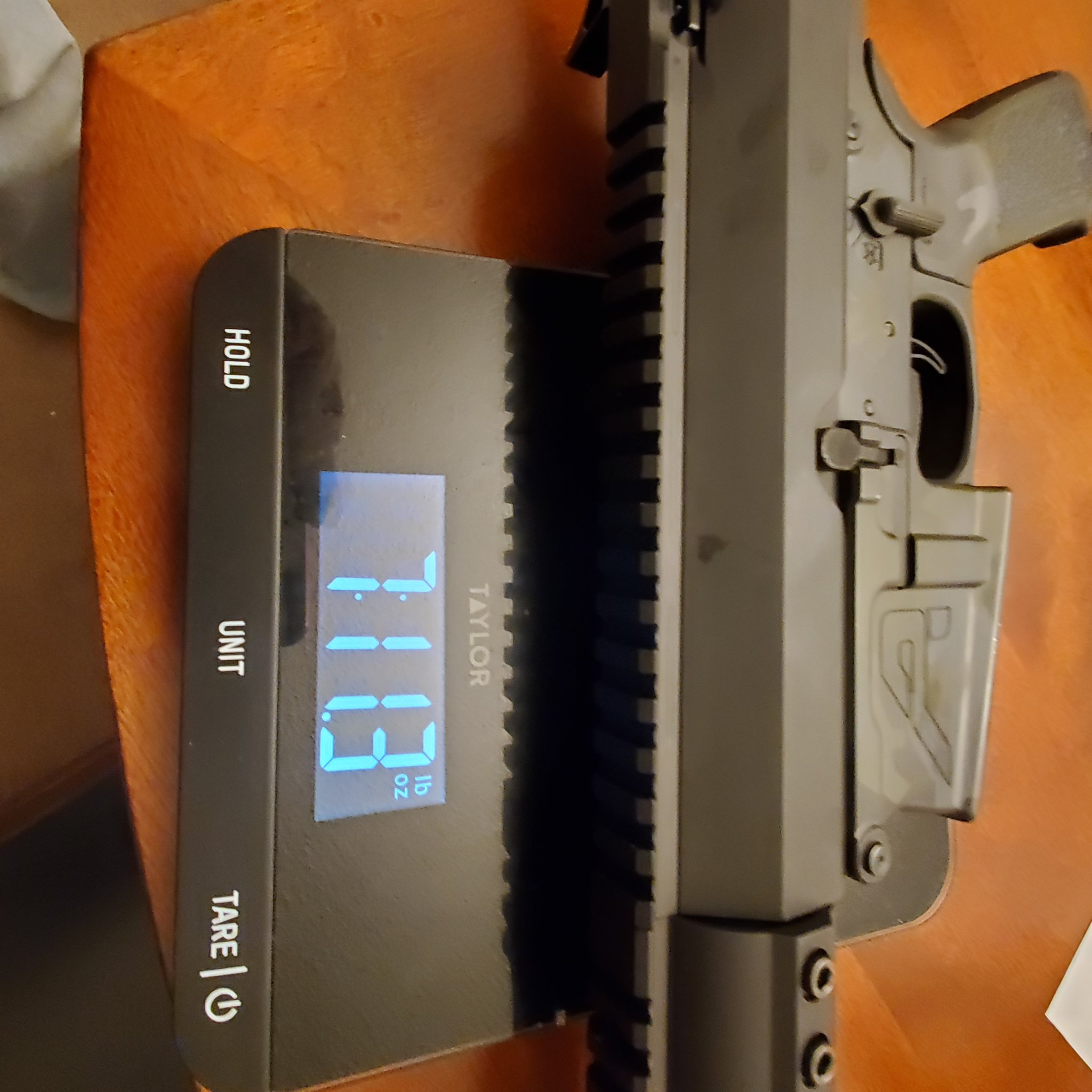

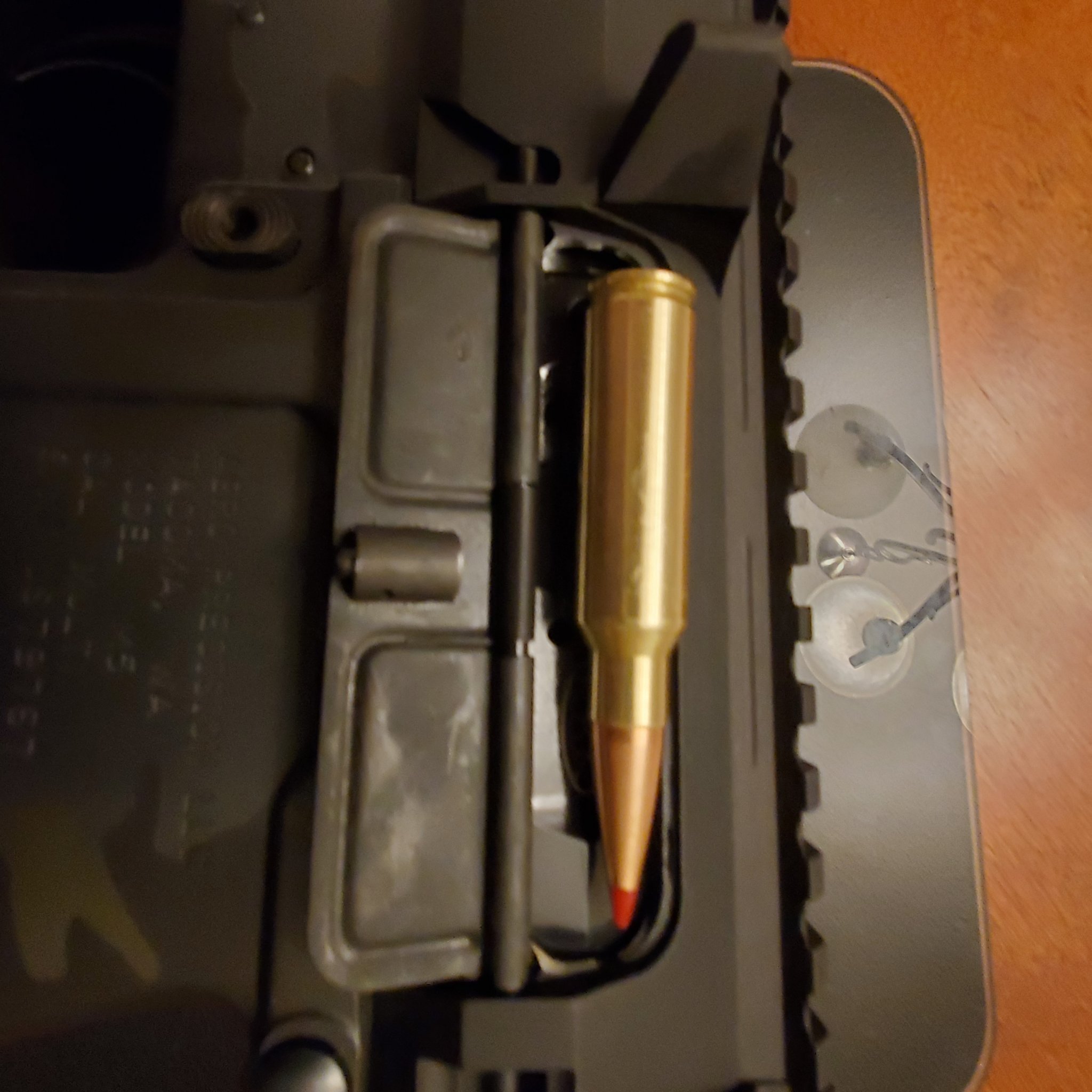

Just finished an AR 10 in 338 Ruger Compact Magnum, with 18" fluted barrel.
7 lbs 11oz, no optic.

That’s pretty interesting. How hard is it to find ammo for that?
Ya, probably don't...I didn't see any locally.

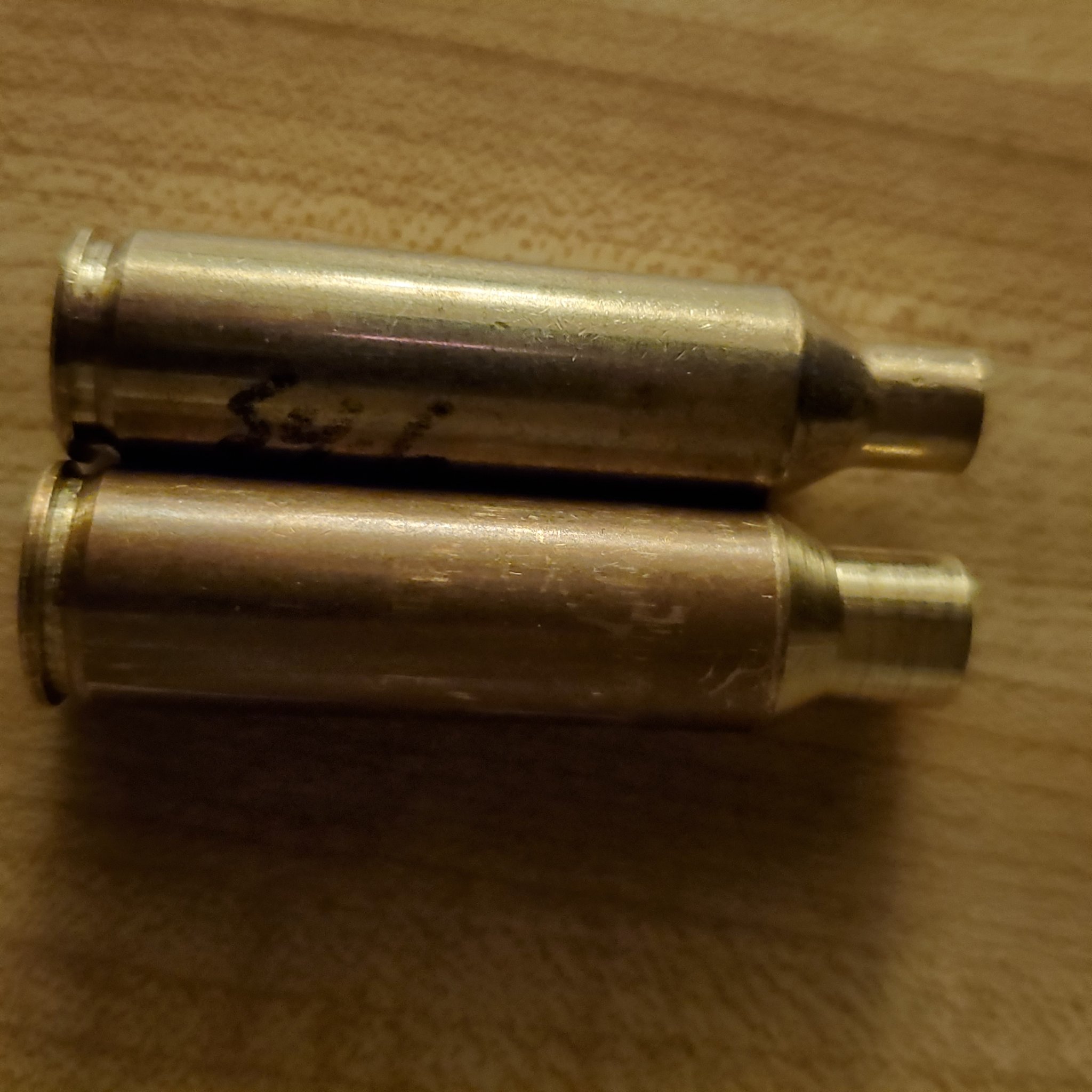

But don't let that bother ya...it's easy to neck up 6.5 PRC brass, and I found that available.
I button bump the 6.5 PRC up with a homemade mandrel in one step from .264 original dia to .284, to .308, .338 in one pass.
Then run through the FL sizer, and skim neck turn to the sholder, and anneal.

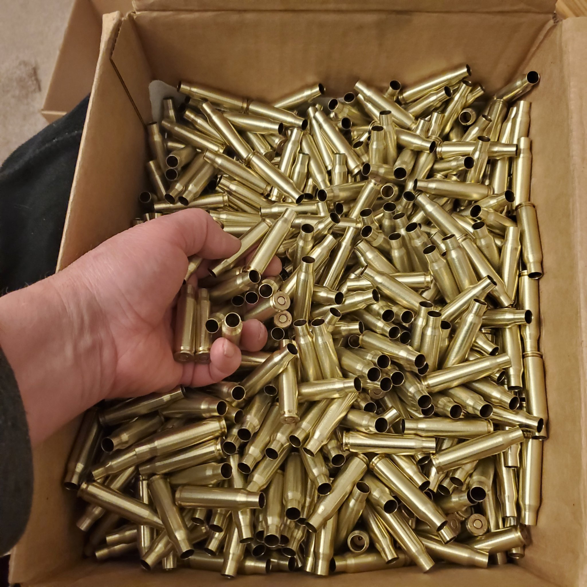

It's primed Lake City brass so who cares, I have thousands more for AR service. Most have held up well as they've been through the primer swage and checked.
I buy them in 1000 piece lots, load em on one the Dillion progressive.
I do sometimes use Lapua in AR 10s like in the 6.5 CM.
But not for the 308 AR 10, they are accurate with the LC brass. And it's no big deal to lose a few cases.
