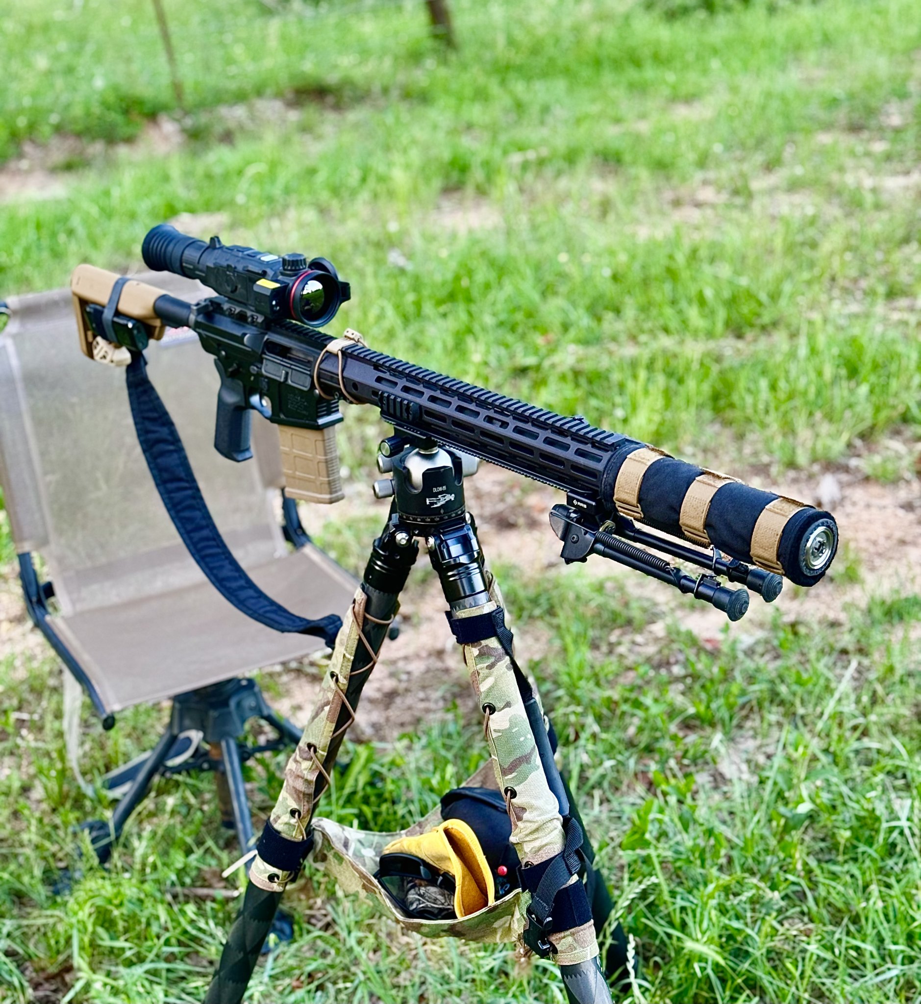

It aint no 308 Win...but a 338 RCM, finish weight 7 lbs 11 oz. Without scope. 18" fluted barrel I chambered.
Shot some nice grouos first time out, with the hunting bullets I tried.
Speer 200 gr were 2700 fps, 225 gr 2500 fps, and 250 gr GS were over 2400 fps, and 160 gr Barnes copper also shot nicely with the first powder I tried.
Most are running 3200 ft/lbs of muzzle energy from the ARs 18" barrel.
Good enough for most hunting as is, but further testing with different powders, and bullets will be fun.

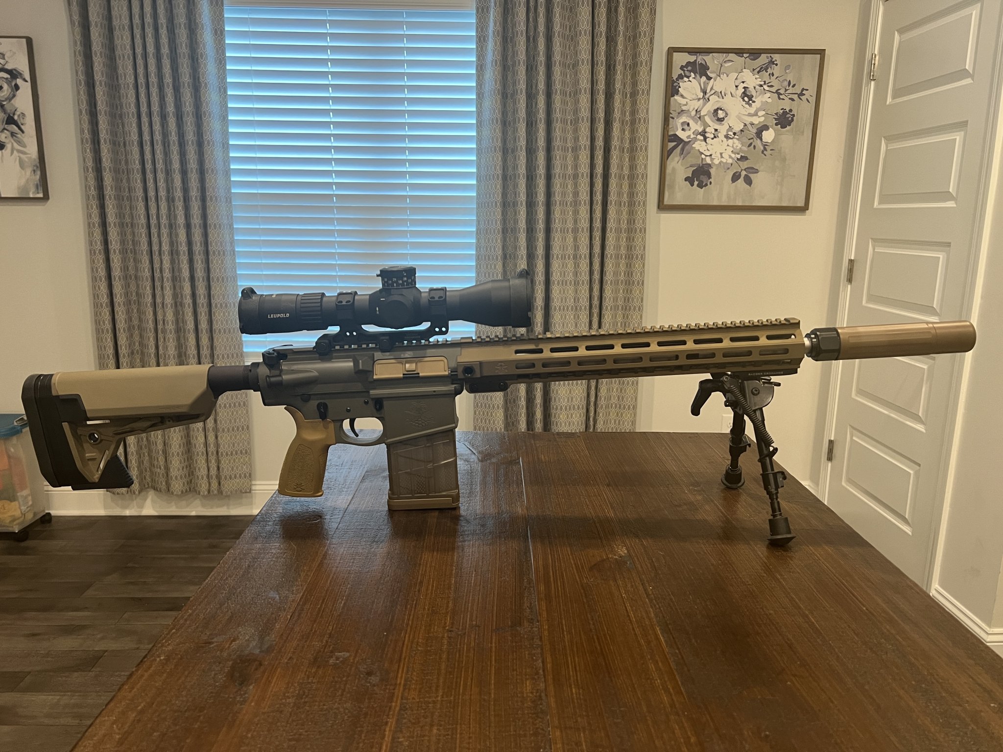

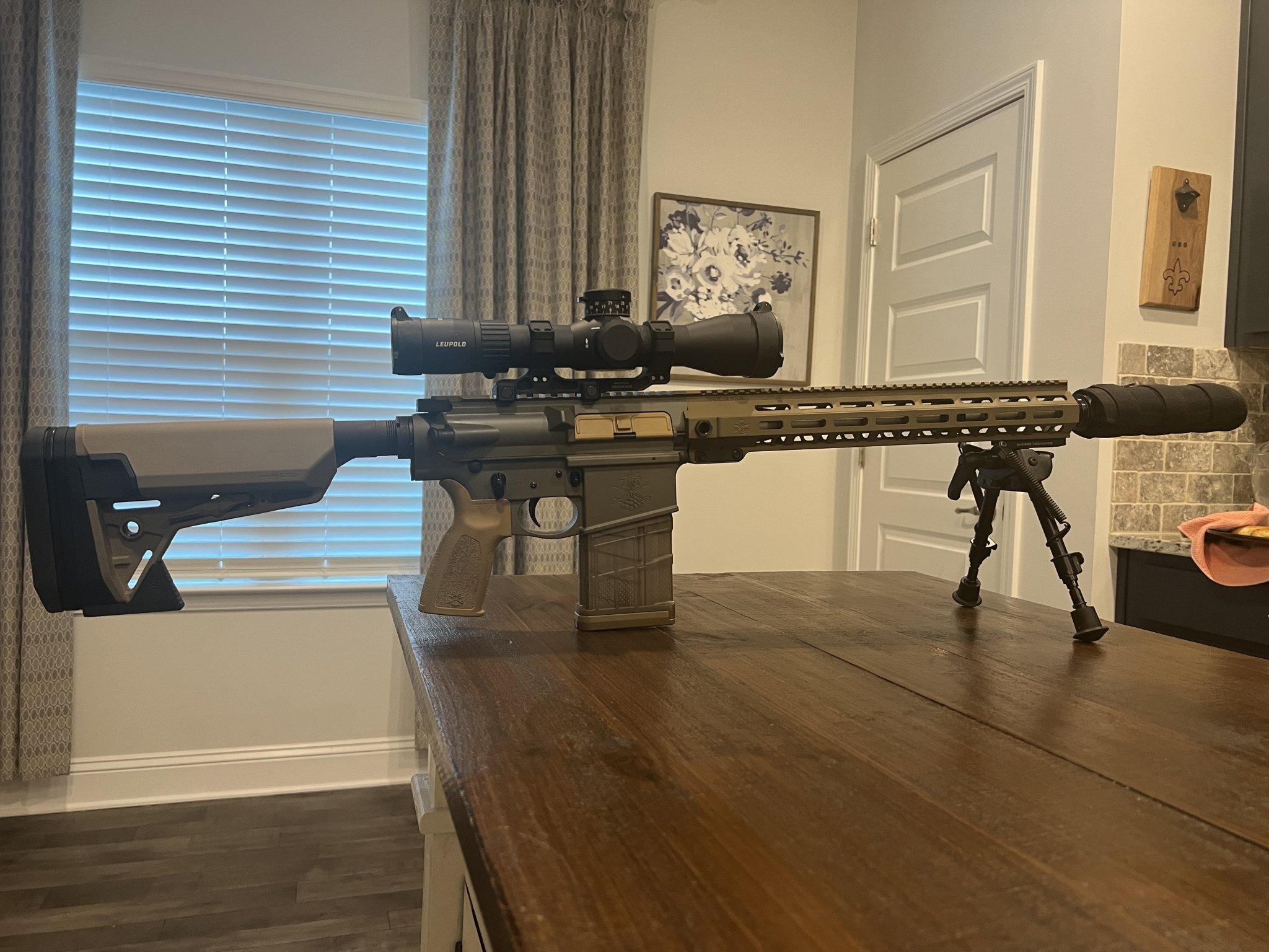

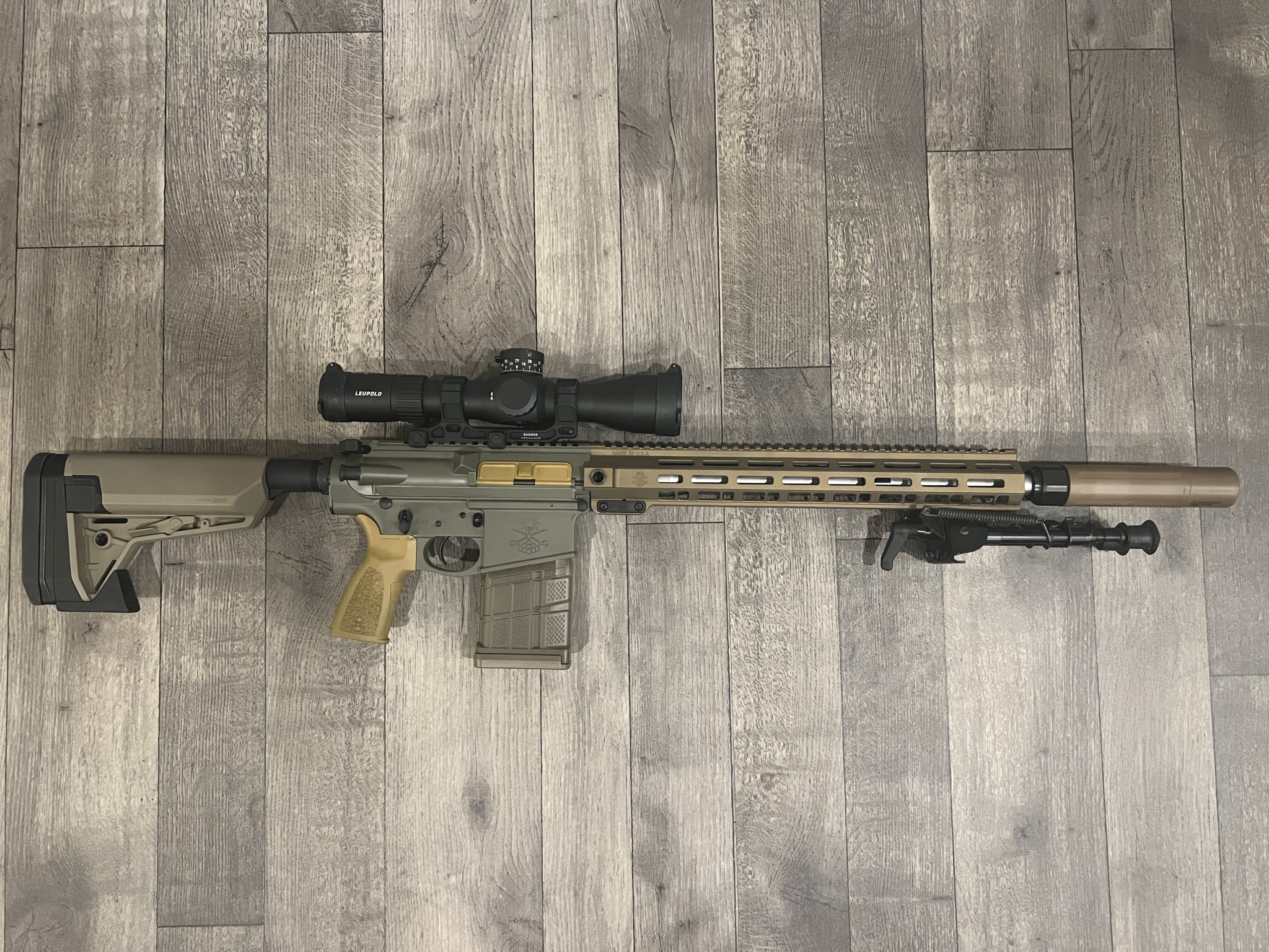

PSA Sabre-10A1
Overall a very nice AR10. Swapped to a SL-S stock to use the limb-saver recoil pad and Arisaka bag rider. Trigger is pretty nice but my reset feels sticky. I have a SSA-E laying around I might throw in it. Factory crush washer was so warped it wouldn't slide off, I'm surprised I didn't ruin the threads trying to get it off. Running a Mk5 3.6-18 and Sandman-mil on a Area 419 universal adapter.
Waiting on my projectiles to get here tomorrow so I can start load development for this thing.
I can't help but want one of those and the Sabre 110 whilst finishing my LM8 lol.
How's the weight? Please post your accuracy results the QVD review had surprisingly good results accuracy wise.

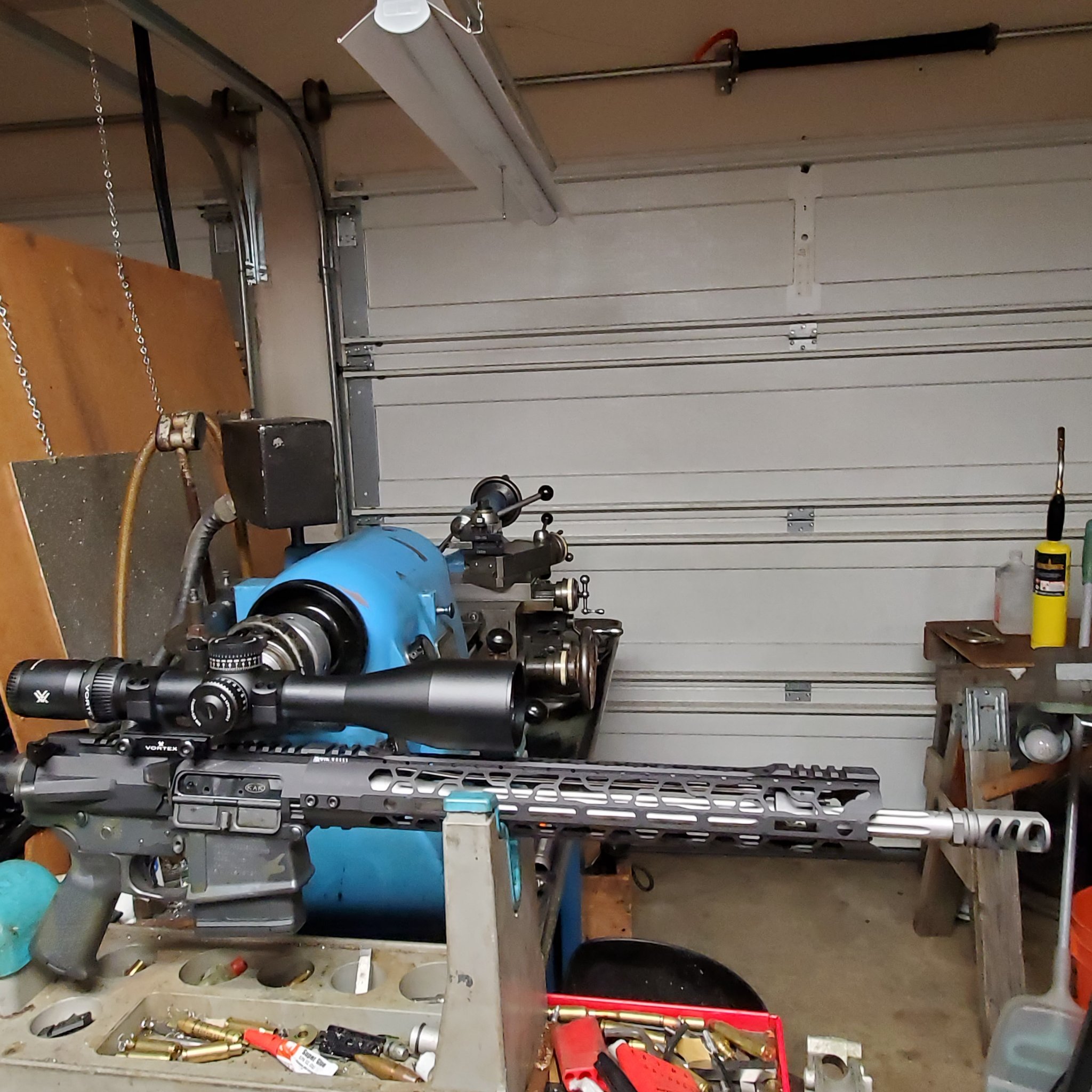

16" 308 for you. ADM UIC 10 builders kit. 16" fluted rifle length gas. JP LMOS BCG, SCS buffer system. Super smooth recoil impulse. 155 Palmas at 2700fps, and 125gr blems at 2820fps. But the Barnes 130gr TTSX at 2800 are the nasty business. Love this gun.
I missed it, what brand barrel?
Exactly what I am wanting.
Thanks

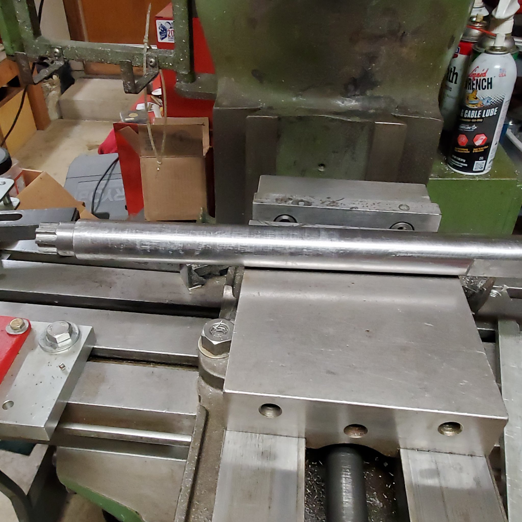

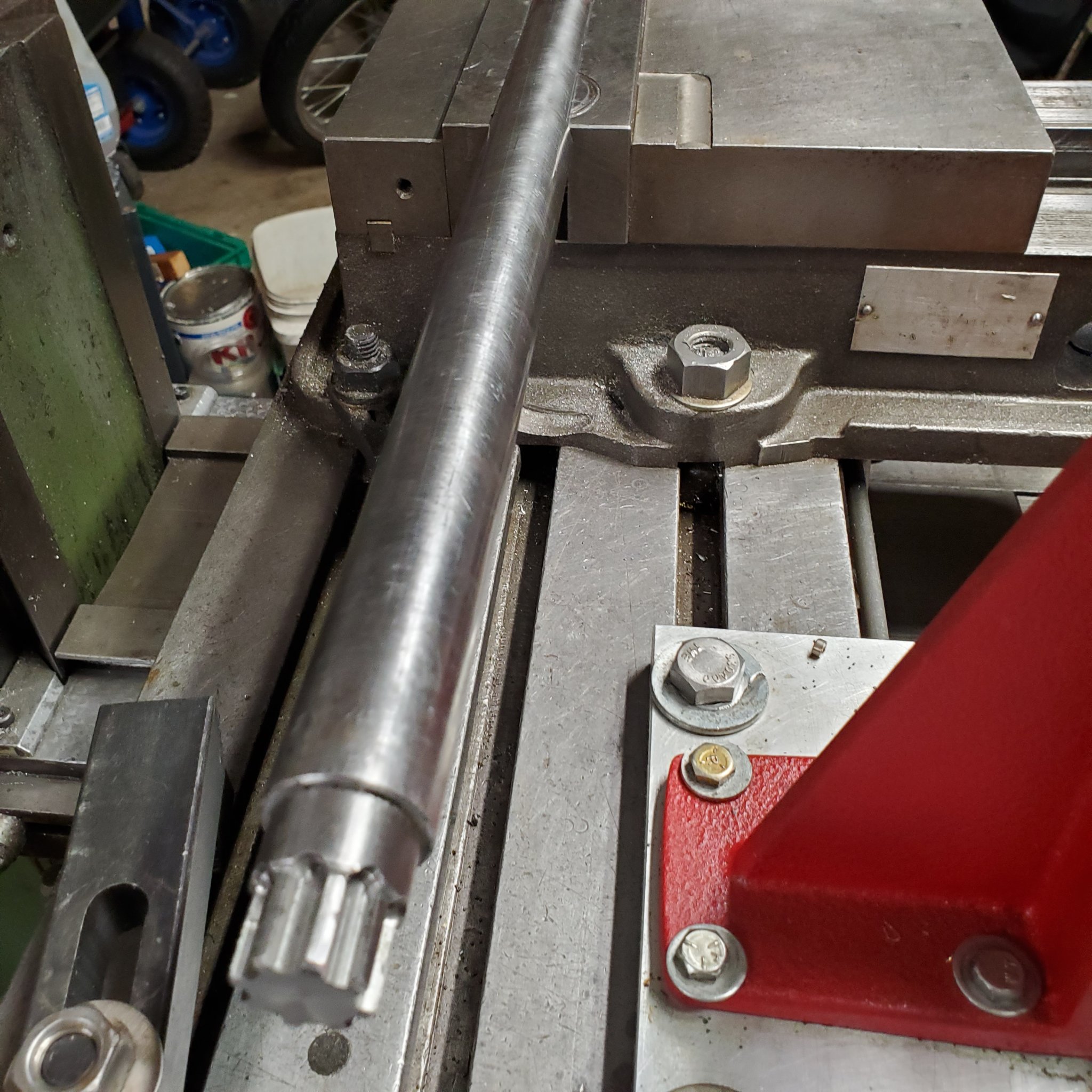

I use a reaction rod as the industry calls it.
I made my own.
It's 17" long 1.180" in dia or 30 mm with a vise flat milled, and diameter turned down and milled to fit the barrel extension.
The upper reciever slides over the rod and locks into the barrel extension.
Or for indexing to get at handguard screws, etc.
An excellent tool for working on ARs use the 1" dia steel for the AR 15.
I do all the work on the Bridgeport milling table, as seen here.

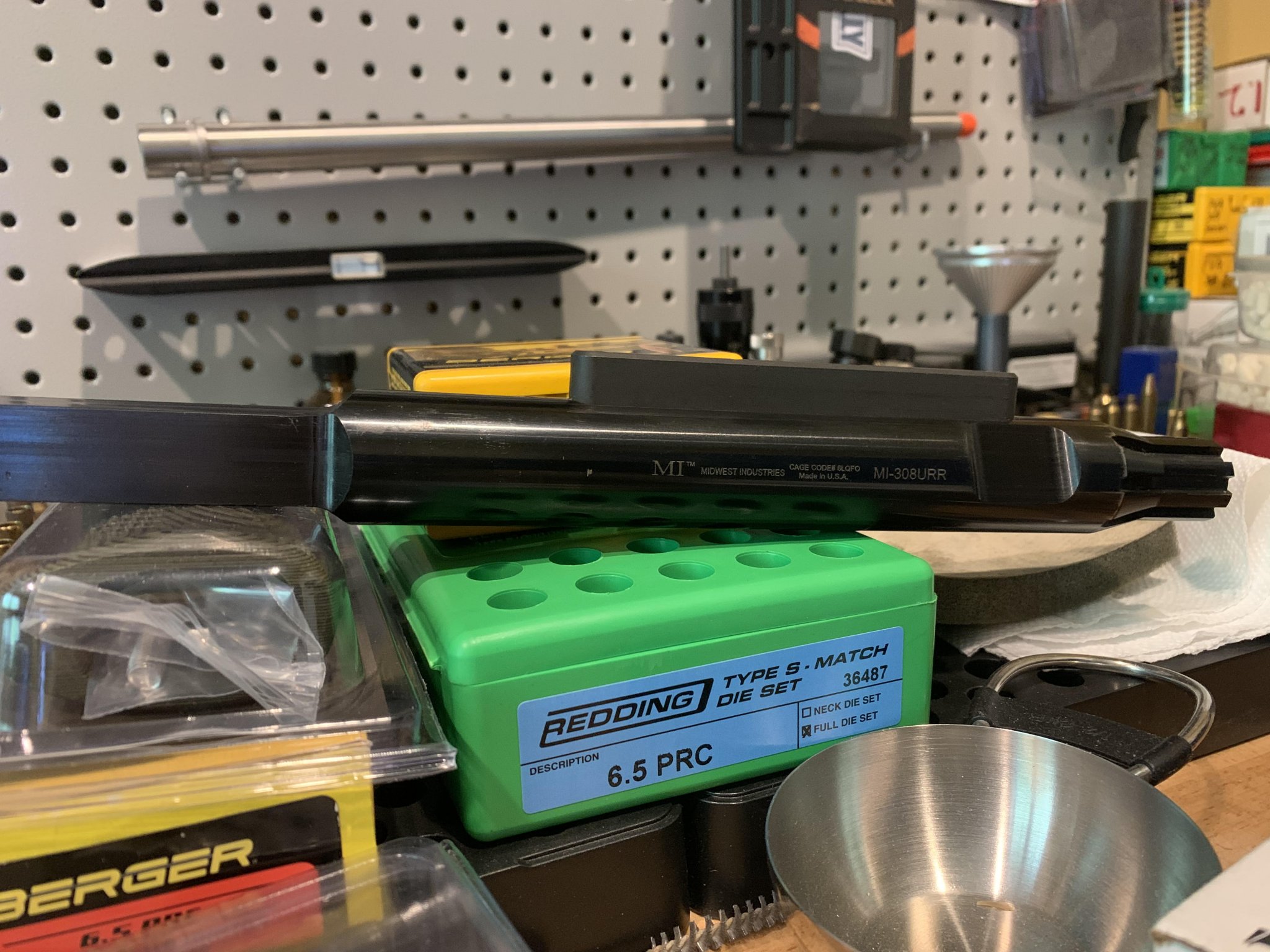

Midwest Industries and Geissele sell versions. The rod needs a vertical flag to prevent the receiver from twisting against the barrel extension pin.
Maybe I misunderstood your post, but do you have a link for the Geissele AR-10/308 RR with a vertical flag/fin? As far as I know, they only offer the Super Reaction Rod for AR-15s, which uses anti-rotation lugs that lock into the ejection port.
No. Geissele and MI sell versions of 45-70's rod. MI is the only one of the two with the vertical flag.
The JP vise blocks are vastly superior to any reaction rod.
IMO anything that uses the holes in the receiver lugs is garbage.
I disagree on that. Superior to a clam shell for sure, but not a MI Reaction rod. The Midwest Rod with the sail on top locks the upper alignment with the extension lugs. This prevents any possible shear on the extension pin when torquing the barrel nut. Also very handy when mounting & leveling a scope.
