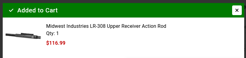

I disagree on that. Superior to a clam shell for sure, but not a MI Reaction rod. The Midwest Rod with the sail on top locks the upper alignment with the extension lugs. This prevents any possible shear on the extension pin when torquing the barrel nut. Also very handy when mounting & leveling a scope.
JP vise blocks provide the same support and work for both platforms. I like the MI rod, the JP blocks are better if you have an AR15 and AR10.
I mean according to JP, they build their rifles in house with these blocks.
Whether you clamp to the receiver or the barrel extension, if you don't secure the two together you will subject the barrel extension pin and receiver slot to twisting force. You can rip out pin and/or deform the receiver slot.
I see what you’re saying. But I think usually the extension pin is only in danger when people torque their muzzle devices on too much.
The pin is usually in danger when the pin wasn't installed correctly by the barrel manufacturer. You normally find that out when you're torquing the barrel nut while clamping or pinning the receiver. Mostly the receiver slot just deforms.

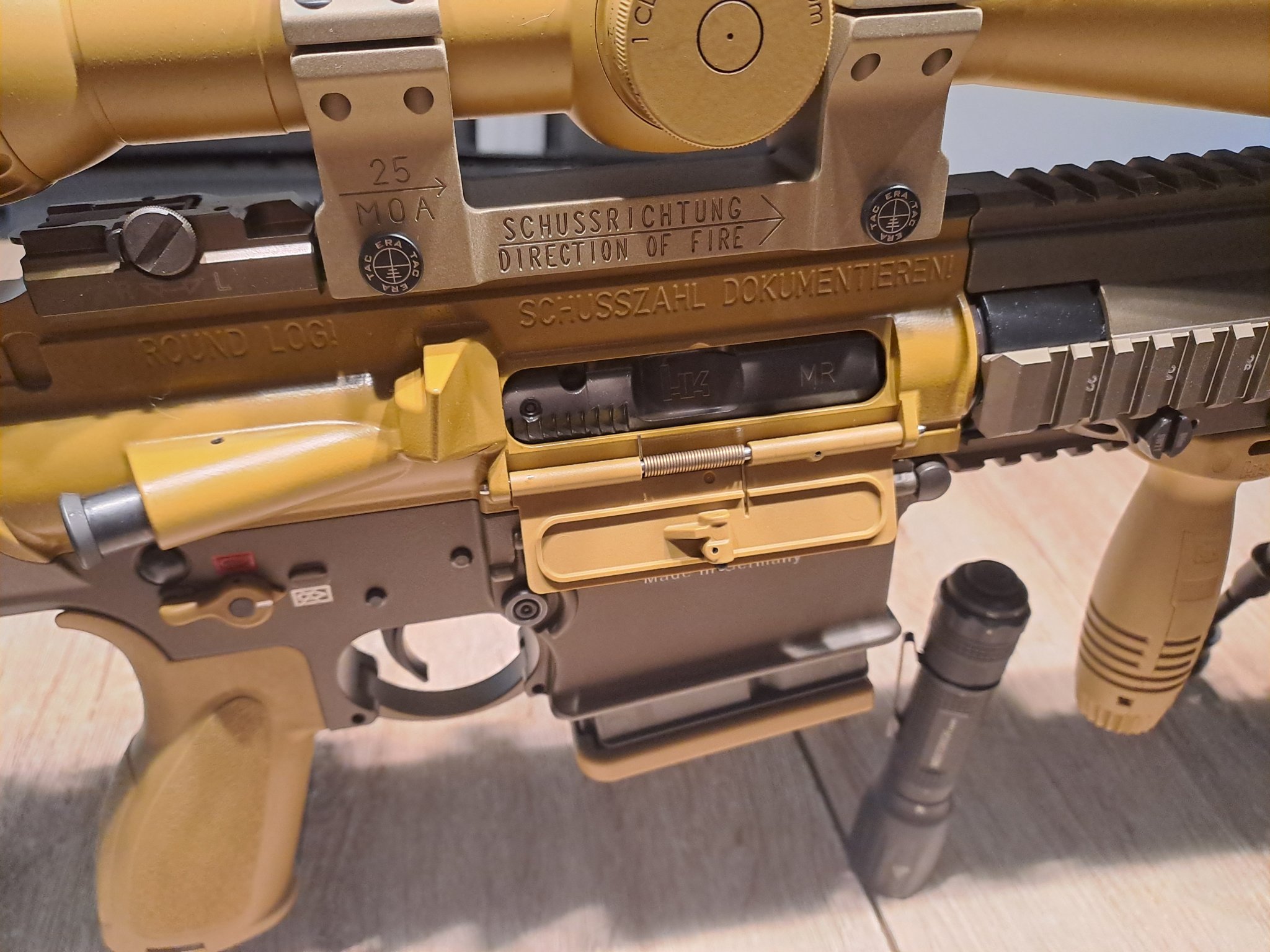

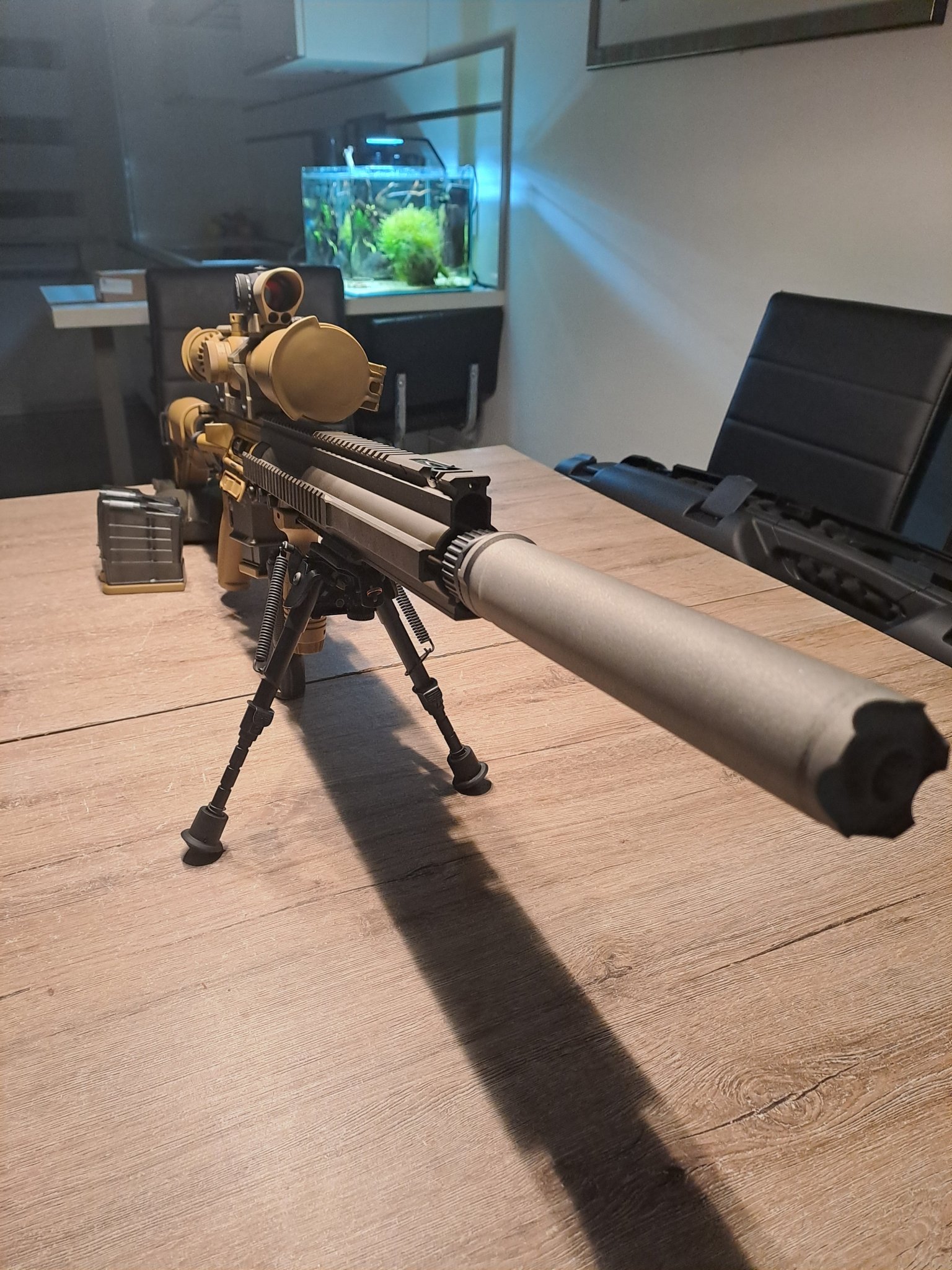

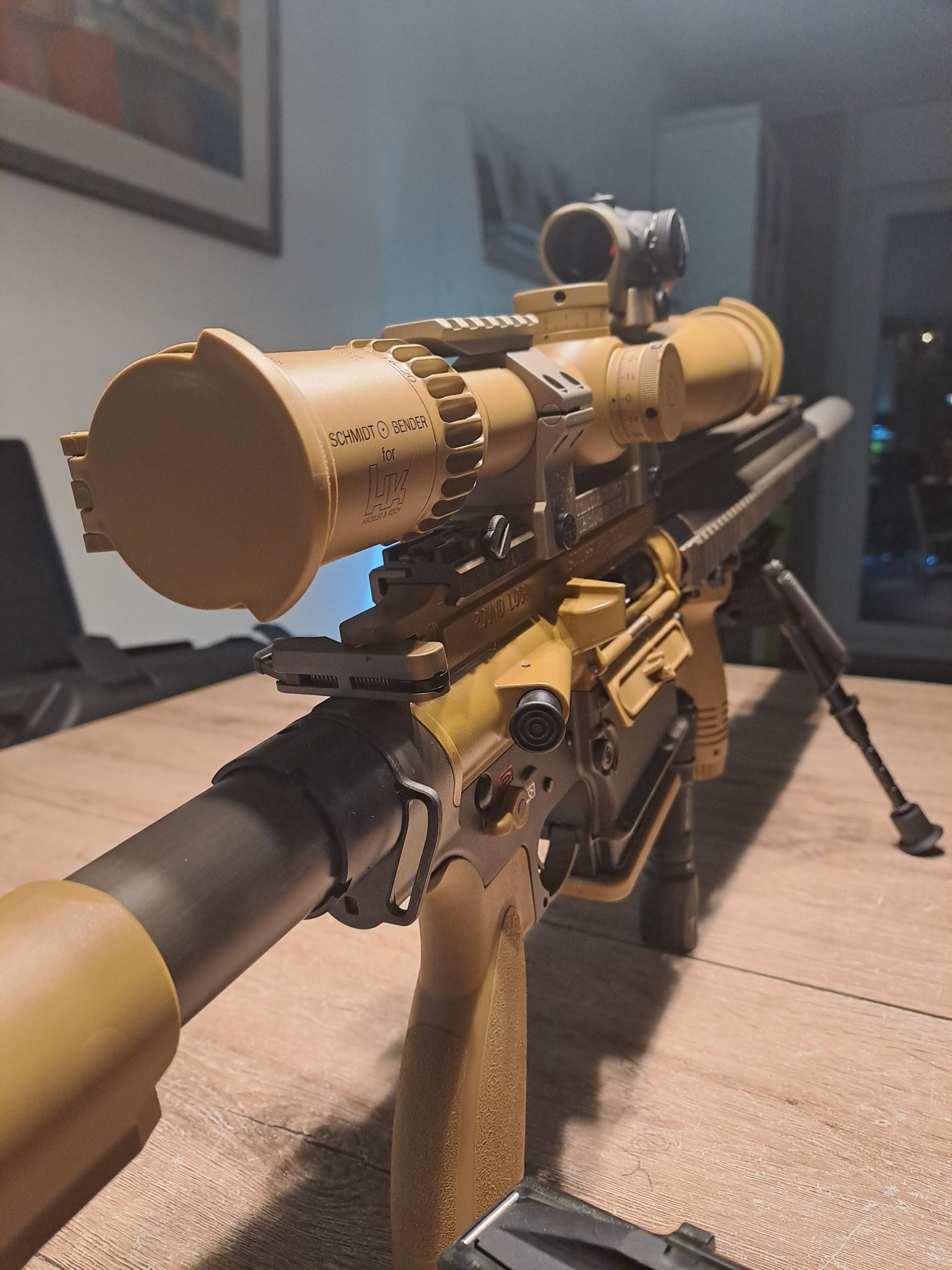

I feel like this is exactly how you would expect to see a bipod mounted on an exclusive, super expensive, military only sniper rifle in the hands of a civilian collector
If there is something wrong with the bipod please let me know. This is how i got it directly from HK. I am no collector at all, the rifle will be shot until it falls apart😉
You cant move it further forward, asked HK and they told me they did that due to impact shifts during testing.
Daniel
Sick. How does it shoot?
Will be testing her in about 2 weeks i guess. Waiting for ammunition. Will post a few pics, V0 and targets to let you guys know.
I am a bolt action guy so this is going to be interesting. First impression: very well made, cheek riser fits perfectly concerning height. If i raise my head slightly i have a perfect view through the T1. Perfectly centered behind the optic, was a bit concerned since i prefer the edgy TRG cheek rest.
The PMII is out of this world as expected.
Weight is heavy even for me although im used to TRGs and AIs.
HK will burn in hell though for the trigger installed. Will need lots of dry fire to get used to that. And i am used to 1-2kg triggers.

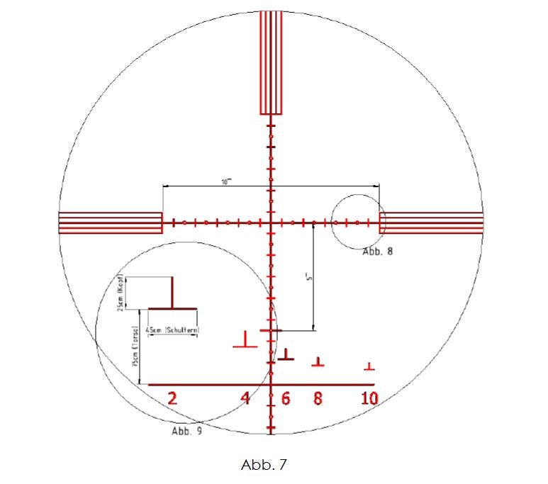

What kind of reticle in the S&B? Are you German?
Nice tank, you running co2?
Hey, no, no CO2. Just a few plant and Shrimps. Everything runs fine, just growing a bit slower!
The reticle is a patent of H&K. Yes i am from germany. Thats why i am restricted to 10 round mags....working on papers for 20-30 round mags though.

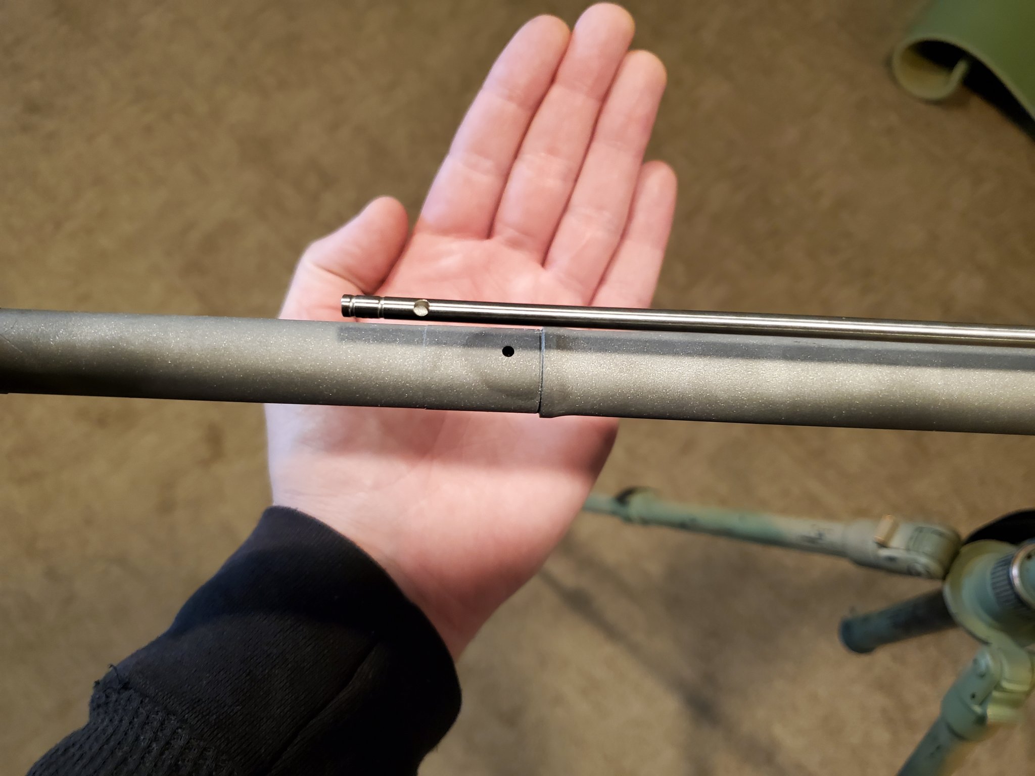

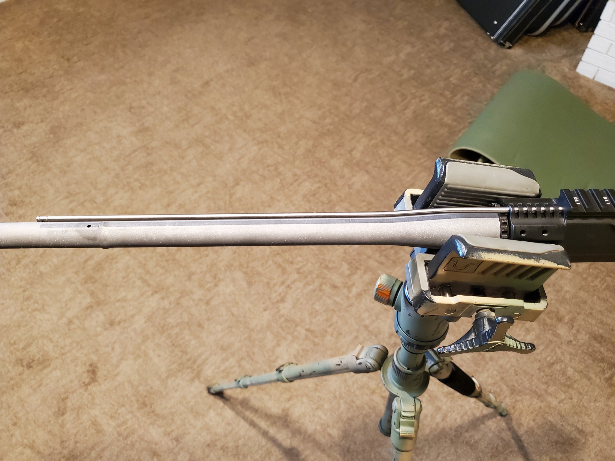

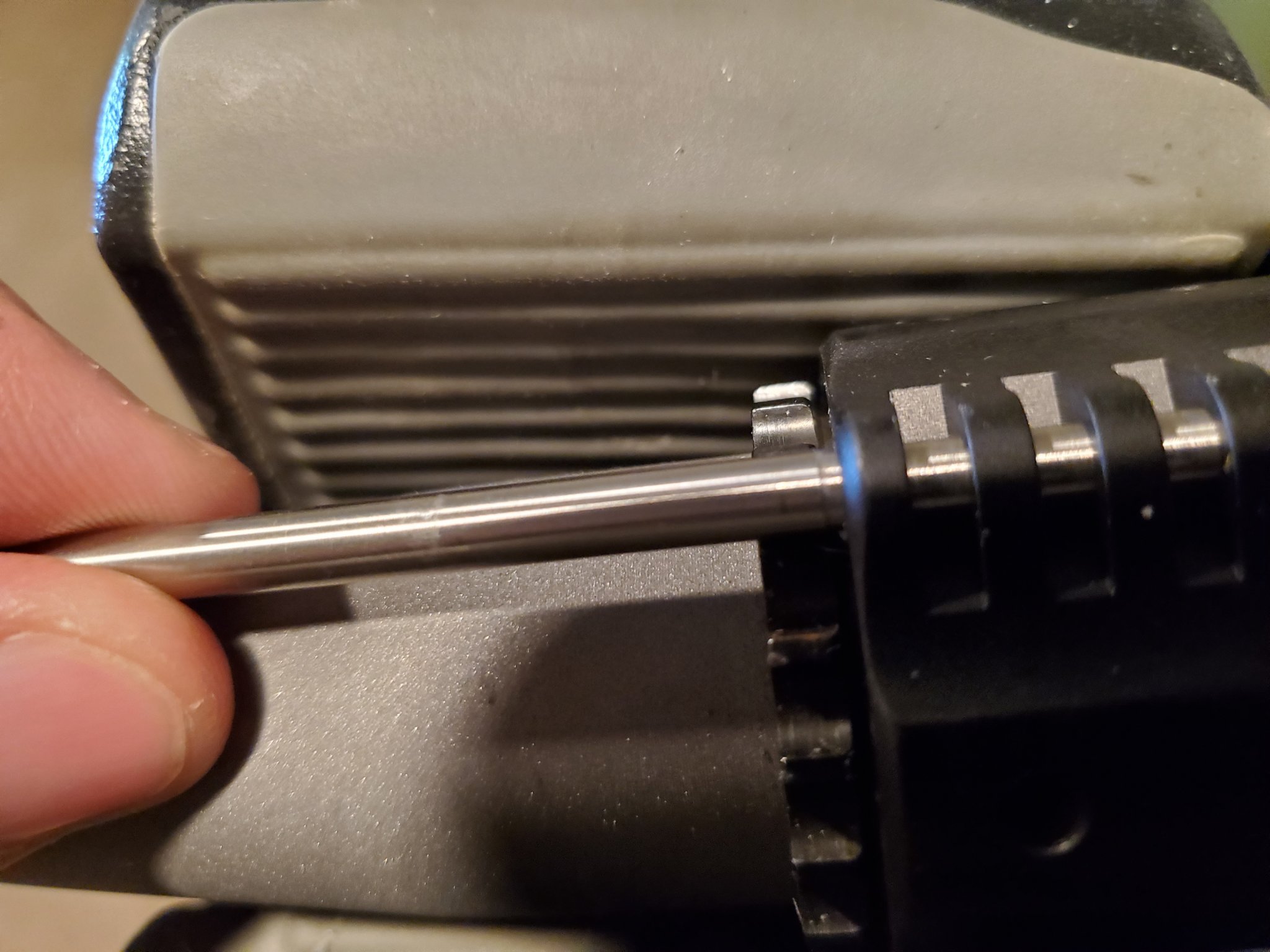

How fucked am I? Aero rifle length gas tube, aero enhanced upper, Rainier Match 18" rifle gas. The gas tube has a slight shoulder that wont let it go into the upper any further. I have a SA adjustable block coming tomorrow but this shit doesn't look right to me.
Also heres a borescope of the barrel, only ran 2 patches of patch out through it, no scrubbing or anything. Looks like I'm gonna scrub some.
You can measure the gas tube to see if it is in spec or if it's the upper. Mil-Spec gas tubes are 0.180" (+/- 0.001") OD for the larger diameter area.
Additional specs not related to your issue: 0.170" (+/- 0.004") for the smaller diameter area, which extends 2.33" from the flared end. The OD spec for the flared end is 0.1800" (-0.0006").
There are heavy wall gas tube that are not Mil-Spec, that doesn't look like one of them. I don't know what Aero specs for the gas tube opening of their Enhanced uppers, but their anno is thicker than most.

Return and replace the gas tube.

I got a new gas tube and cleaned the hole in the upper extension with a 22 cal bronze brush and it finally went together. I now have 2 extra tubes though. Time to build more I guess.

is the tooth on the barrel nut touching the gas tube? IIRC, it helps to time the barrel nut, even though the gas tube sorta clears the teeth. just to give it maximum clearance. But it's been a while since I assembled mine (Aero enhanced M5 upper).
I thought maybe but no you dont have to fit the tube through the teeth with the enhance upper. The tube will clear no matter what. The hole the tube goes in needed brushed out really well. Real tight before I brushed it out.

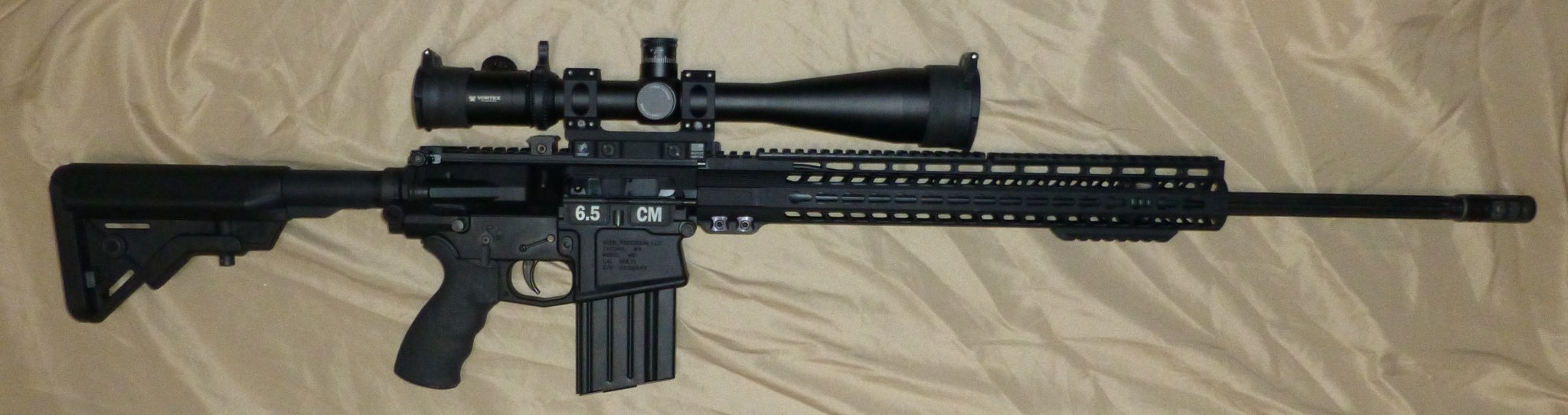

  1. Aero Upper 6.5 CM 24”, SS, Hvy BB .930 dia. At Muzzel, 1-8 twist
  2. Aero M5 Lower
  3. JP Bolt Carrier
  4. JP .308 High Pressure Bolt
  5. Giselle Buffer Spring
  6. Radian Trigger
  7. Radian Charging Handle
  8. Juggernaut Hellfire System
  9. Aero Lower Parts Kit
  10. Precision Armament M11 Muzzle Brake
  11. Magpul PRR Gen 3 Stock
  12. Hogue Grip
  13. Area 419 12” ARCA rail
  14. Leupold MK5 HD 3.6x18
The match had a couple people in the reviews claiming good results. Probably shouldve gone with the ultramatch. Not really a fan of flutes either
Post some pictures of your upper build. Groups like that suggest interference between the gas block and rail, or gas tube and upper. Even the worst barrels will normally print under 2".

I checked all that, plenty of room with the handguard. Gas tube it not binding or anything. The bipod was kid of rough and I can tell that large framer gassers are probably the hardest to shoot well. Even still I can shoot pretty well with my SPR. Lots of follow through. One or two of the groups was 2ish" but not even close to consistently.
I did start with the gas block wide open and worked my way back after each 5 round group. Needed to come back a decent amount before I stopped getting ejector smears/burrs.
Remember some of those way out shots were from zeroing the scope. it came off a gun with a 20 moa rail and the windage was like 5 mils off on the new gun.
If you’ll humor me, my experience with large frame gassers is that one really has to have their fundamentals dialed in consistently to shoot them well. Also, I discovered my gas gun doesn’t like a bipod. It bounces all over hell and creation and doesn’t group for shit. I chalk this up, partly, to the nature of the bipod/hand guard/barrel nut relationship. Once I started using a bag for a rest and really got my body position and head/eye position correct and consistent, my rifle showed its quality. It could be that none of this applies to you and if it doesn’t then just ignore me.
