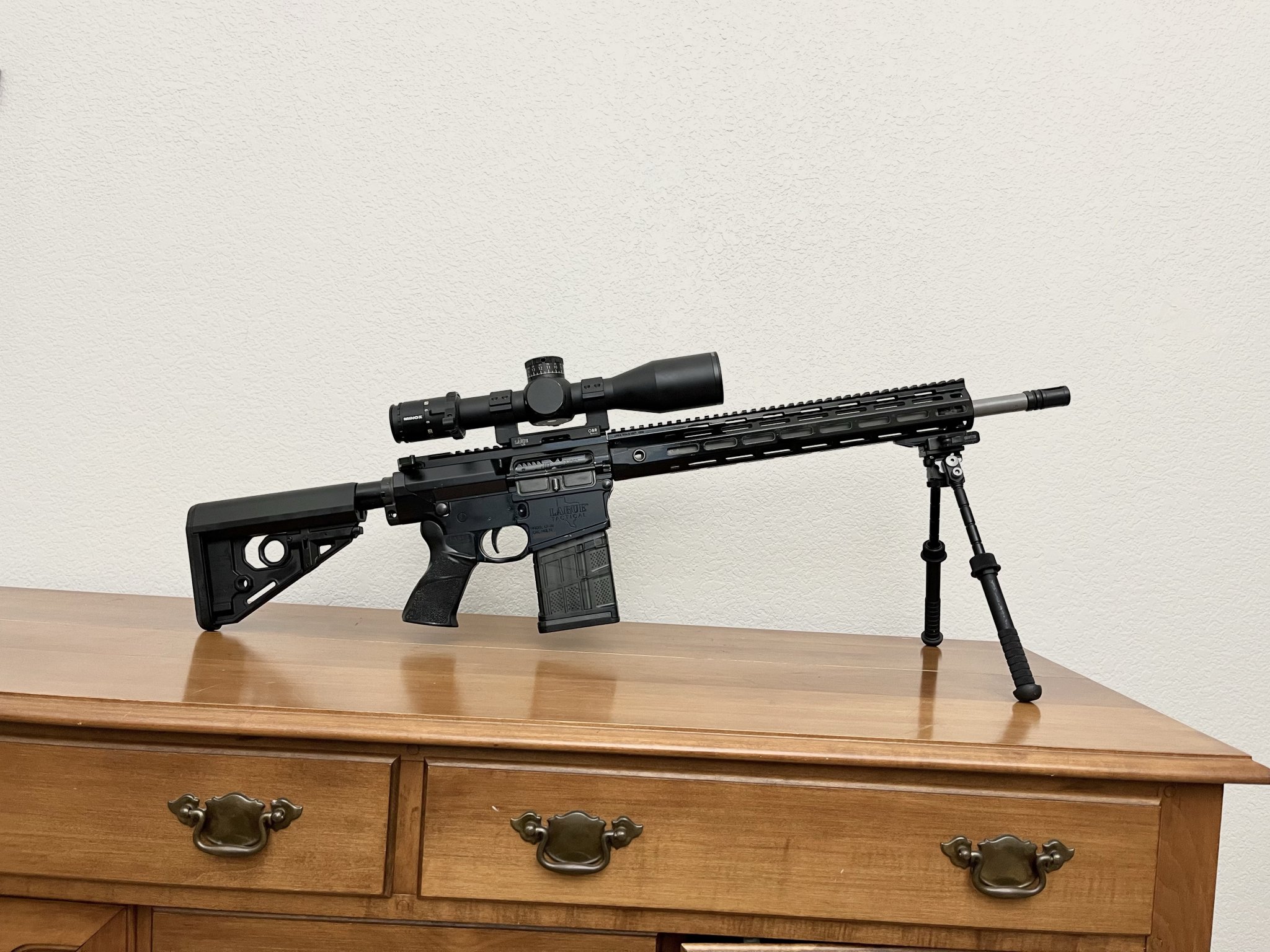

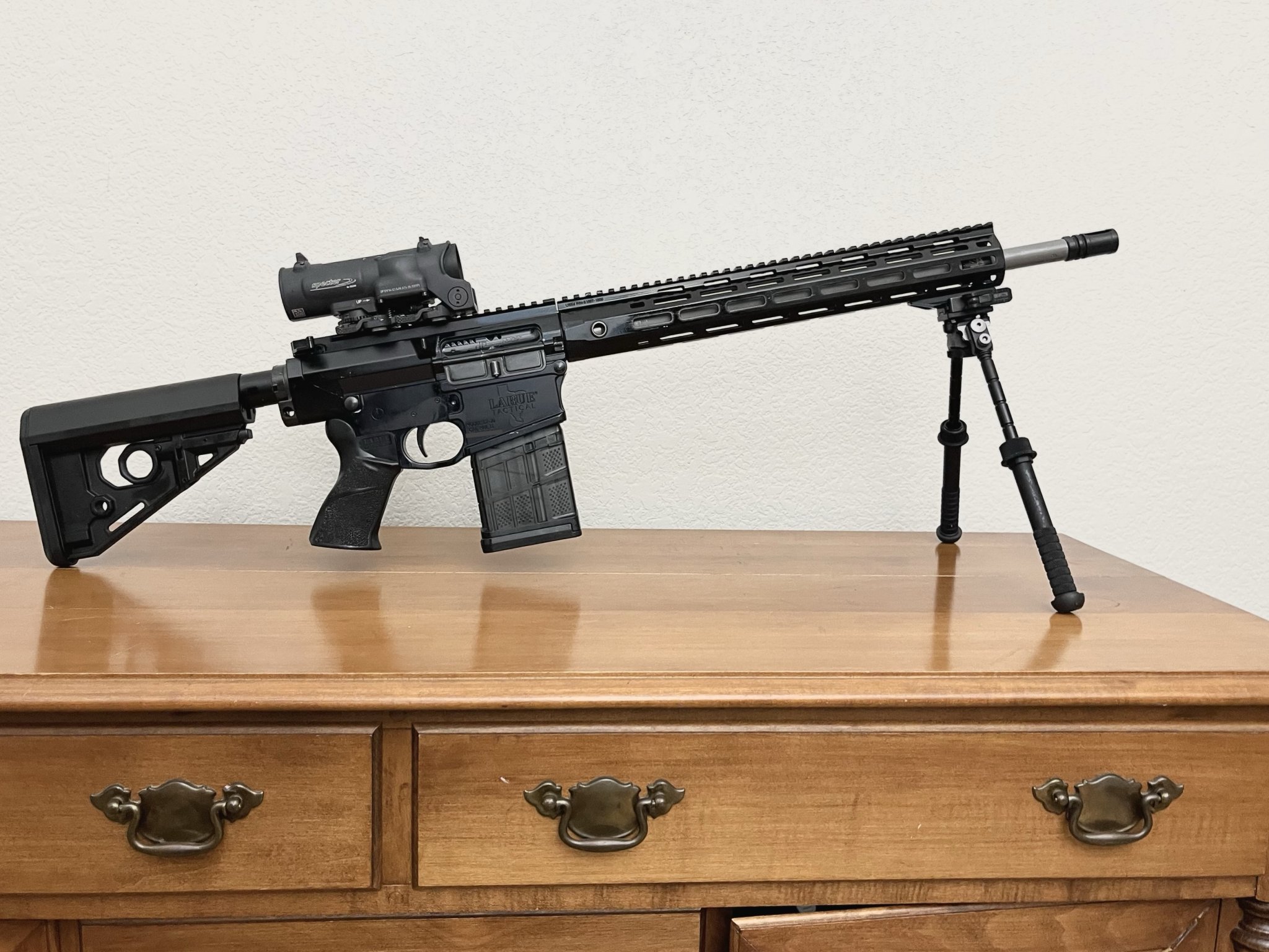

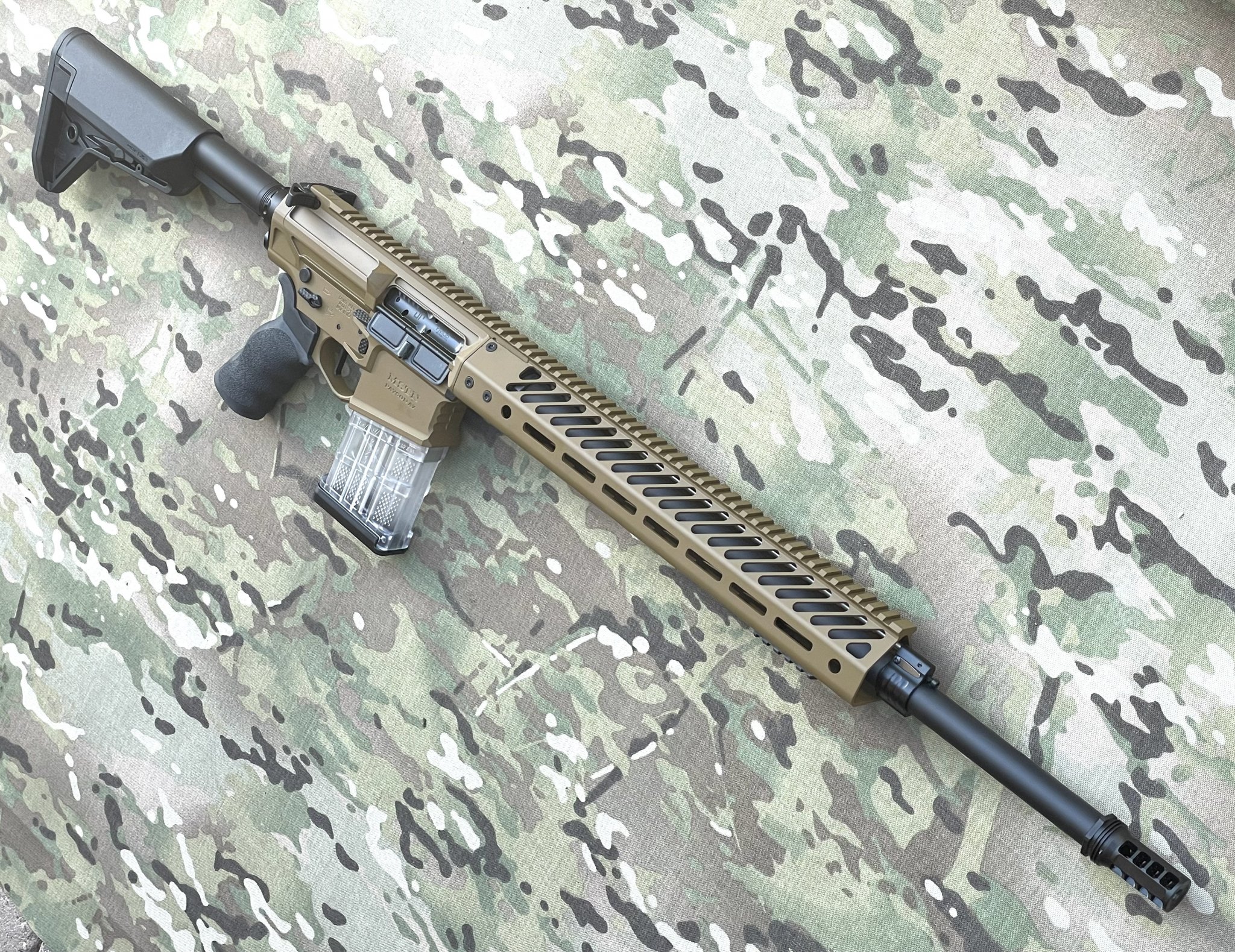

18" barrel from Craddock Precision in 6.5 CM (Criterion blank, rifle +1)
SMF Tactical TAC-10 upper
KAC URX4 15" handguard (paint to install, lol)
Superlativer Arms AGB
JP LMOS full BCG
Lower is a Larue complete (other than the ambi end plate and a silent capture spring).
Weighs 8 lbs 14 oz stripped. Look forward to running this suppressed in next few days.

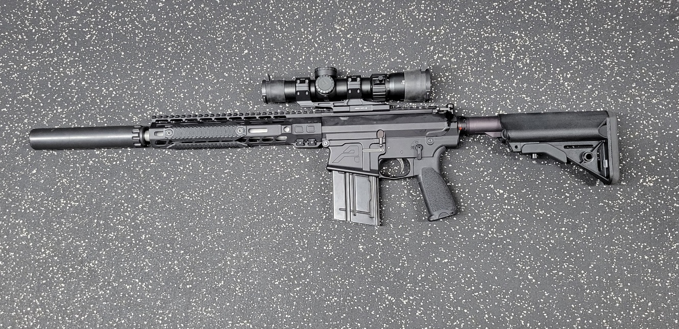

-M5 registered SBR receivers, trued, shimmed, glued
-Rainier Arms Ultra Match 308 Win MLGS barrel 16" cut down to 12.5". .0715" gas port
-Low Mass carrier, 2.2oz buffer, red Sprinco Spring.
-Aero AGB
-Whatever the cheapest Geissele trigger is. It's mediocre.
-7.3lb base weight. Kinda porky.
This started life as a barrel I took out of another gun due to dwell problems with the MLGS. Cutting off 3.5" of barrel completely resolved the early unlocking. The gun runs with full mass and low mass BCGs. It has enough gas for -20f weather, with and without the silencer, FMOS and LMOS. The scope is a cheap placeholder until I decide what to do with the gun
View attachment 8368955View attachment 8368956View attachment 8368957View attachment 8368958View attachment 8368959View attachment 8368960View attachment 8368961View attachment 8368962Just finished hammering together another really nice 6.5CM: Seekins SP10 Builder's Kit, done up in Accuracy Int'l Dark Earth Cerakote; Rock Creek 5R SS barrel by Craddock Precision; SLR adjustable gas block; JP FMOS bolt carrier group; JP H2 Silent Captured Spring Kit. I thought I'd see if it wanted to be a shooter, so I threw a scope on it. With no gas system tuning at all, groups were immediately sub-MOA with the first box of factory ammo I picked up.

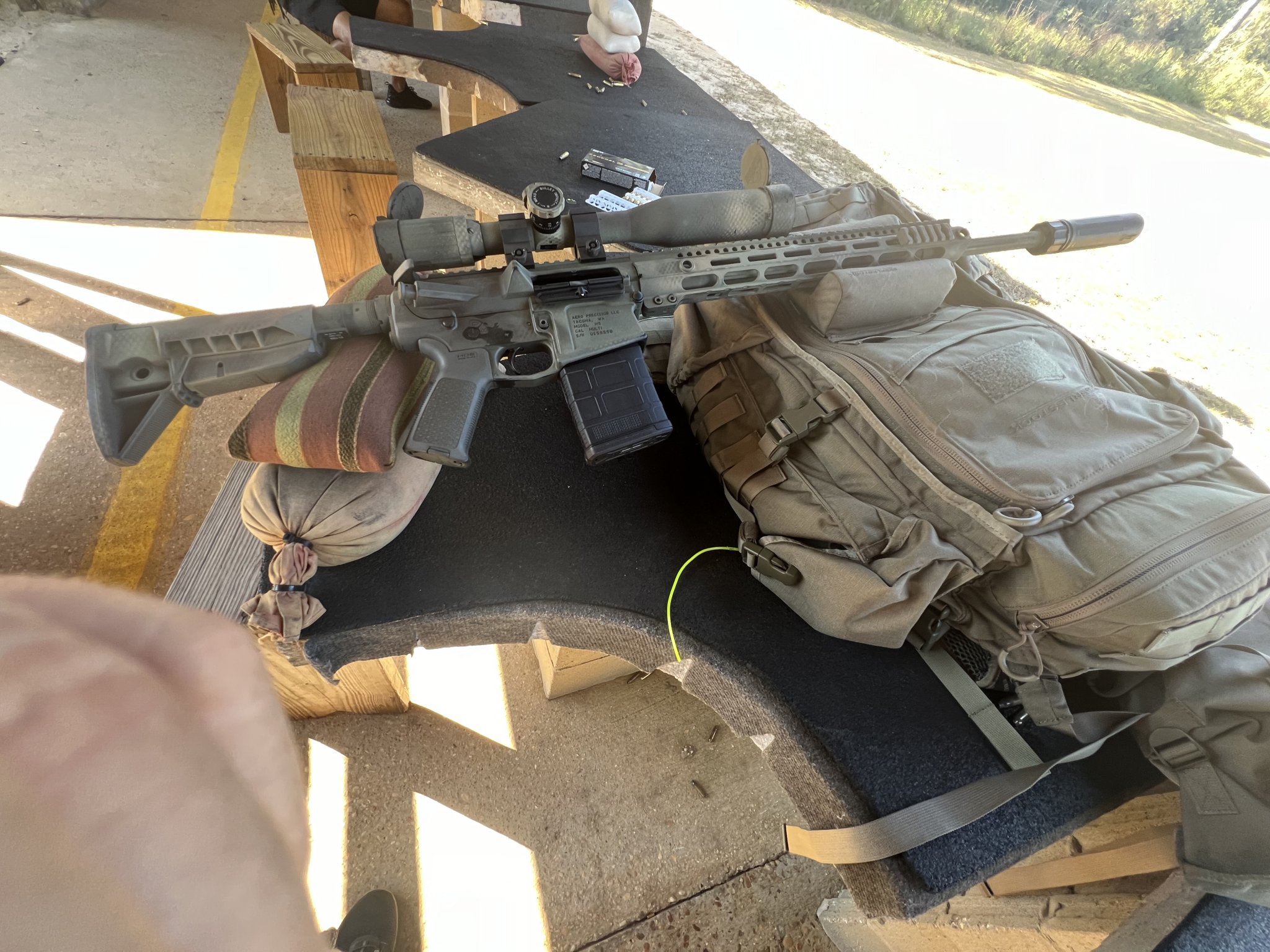

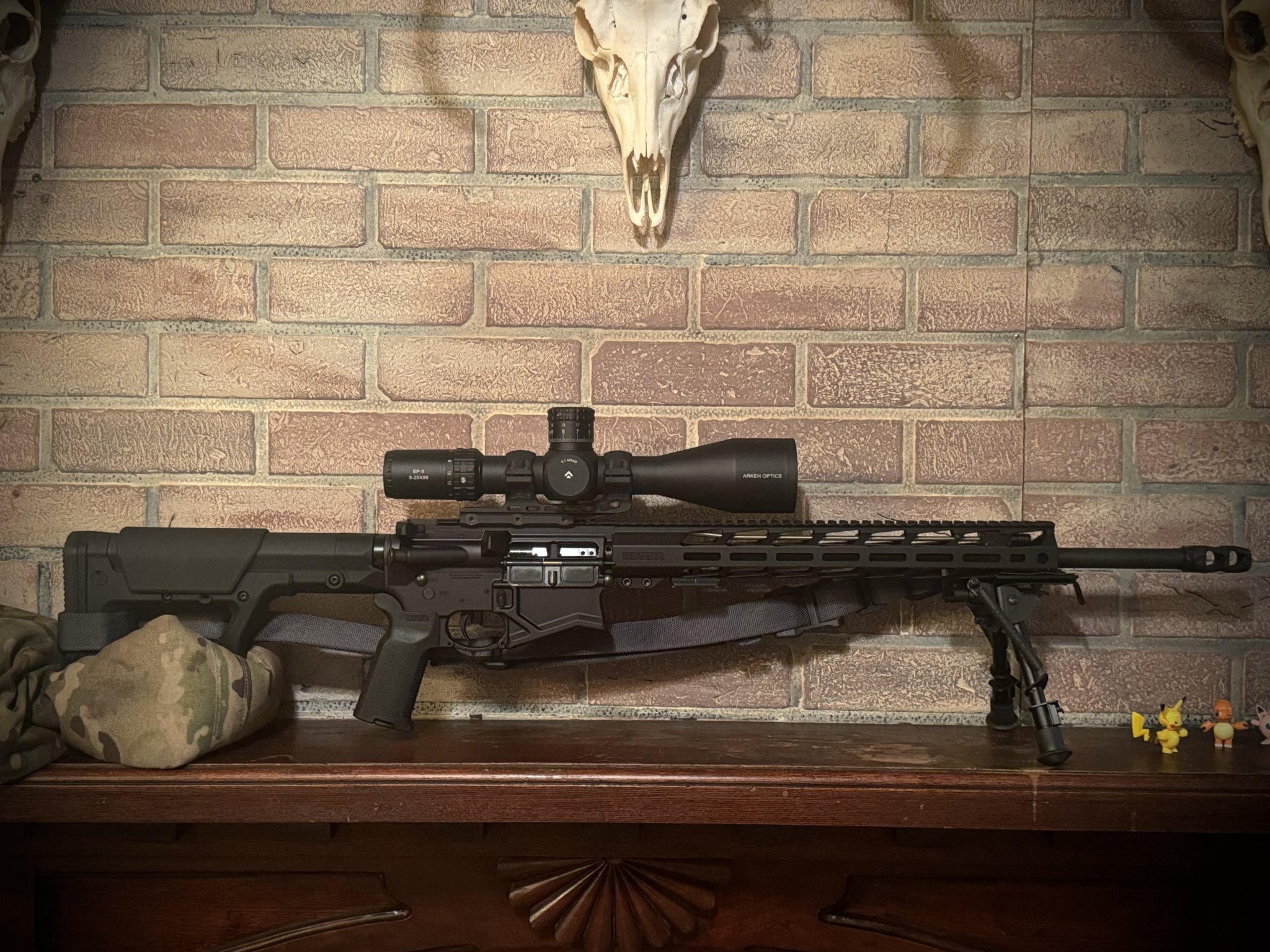

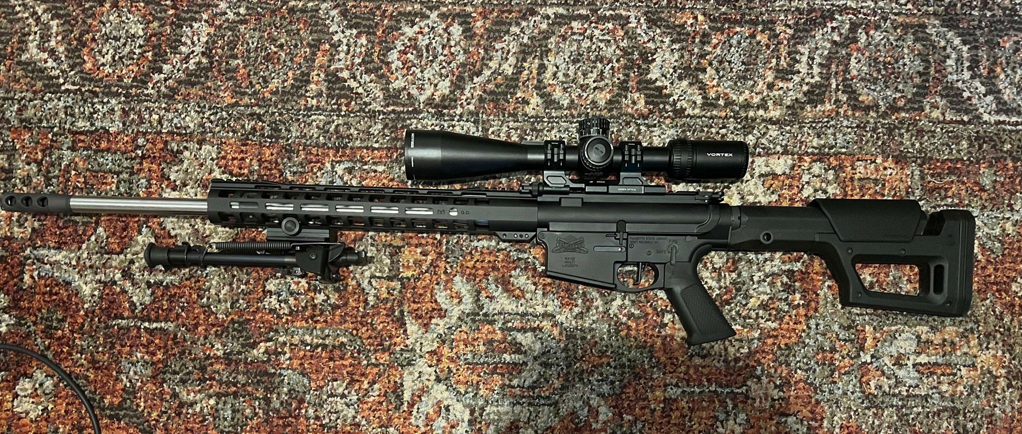

PSA receivers
Criterion 22" 6.5 CM
Magpul PRS Lite
CMC 2.5# trigger
Vortex PST Gen II 5-25x50
Harris Bipod
While some may decry PSA, their large frame receivers are very serviceable as long as you keep an extra bolt catch or two on hand. This is coming from a guy who has used a bunch of receiver sets from old school DPMS to LMT to SR-25. Very functional basic build.

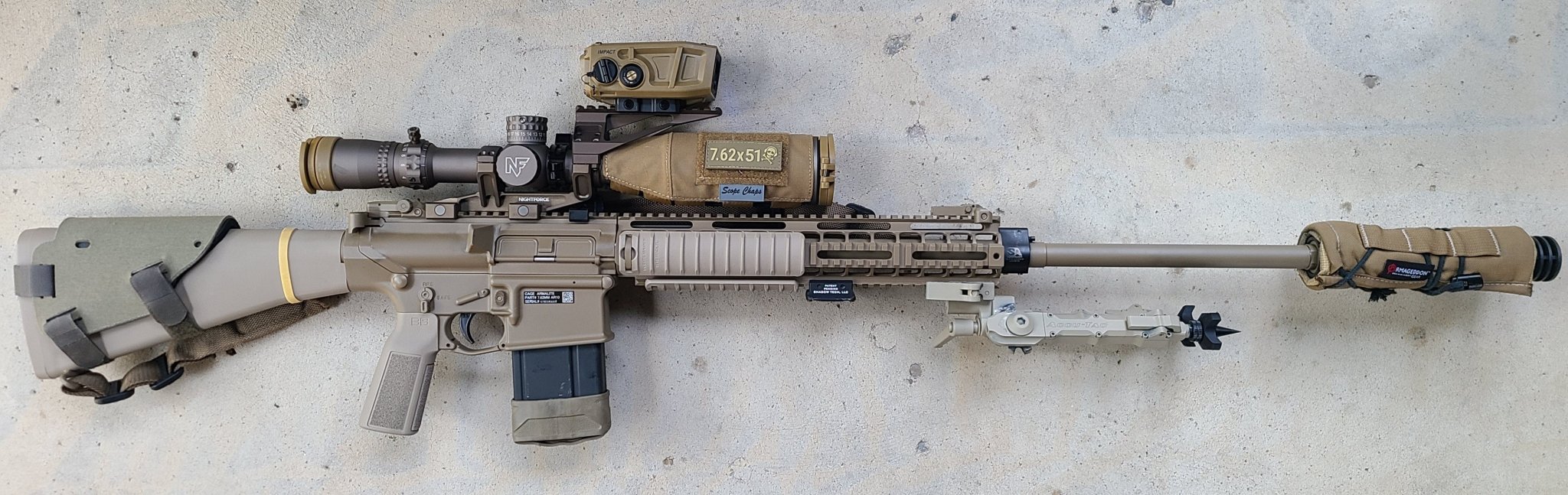

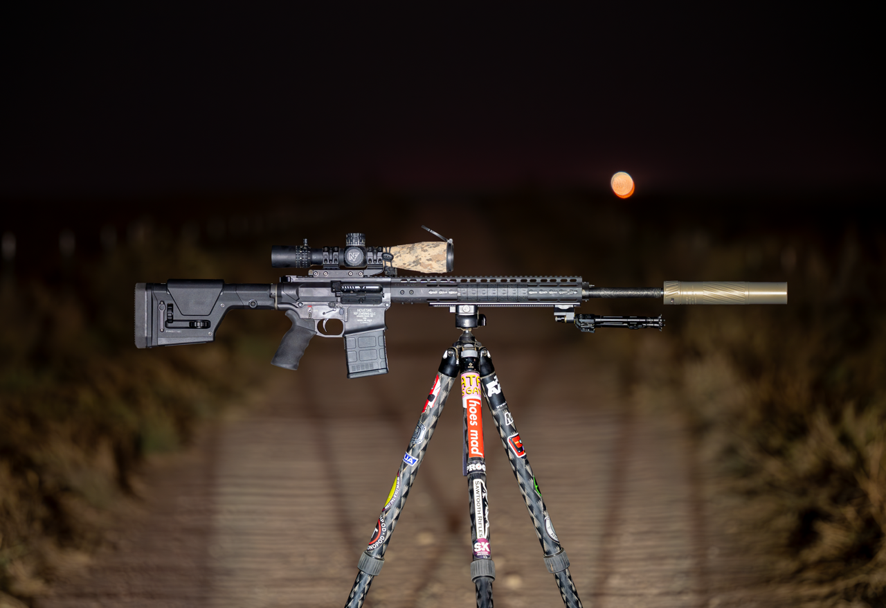

Noveske N6 Recon
Proof Carbon 22” 6.5cm
Superlative Adjustable Gas Block
Magpul Gen 3 PRS Stock
Area419 Arca Rail
Geissele Trigger of some sort (will be swapping to a TriggerTech)
JP VMOS BCG w/ HP bolt
JP SCS
TBAC Magnus SR
TBAC Bipod
NF ATACR 4-20
16.8lbs as pictured

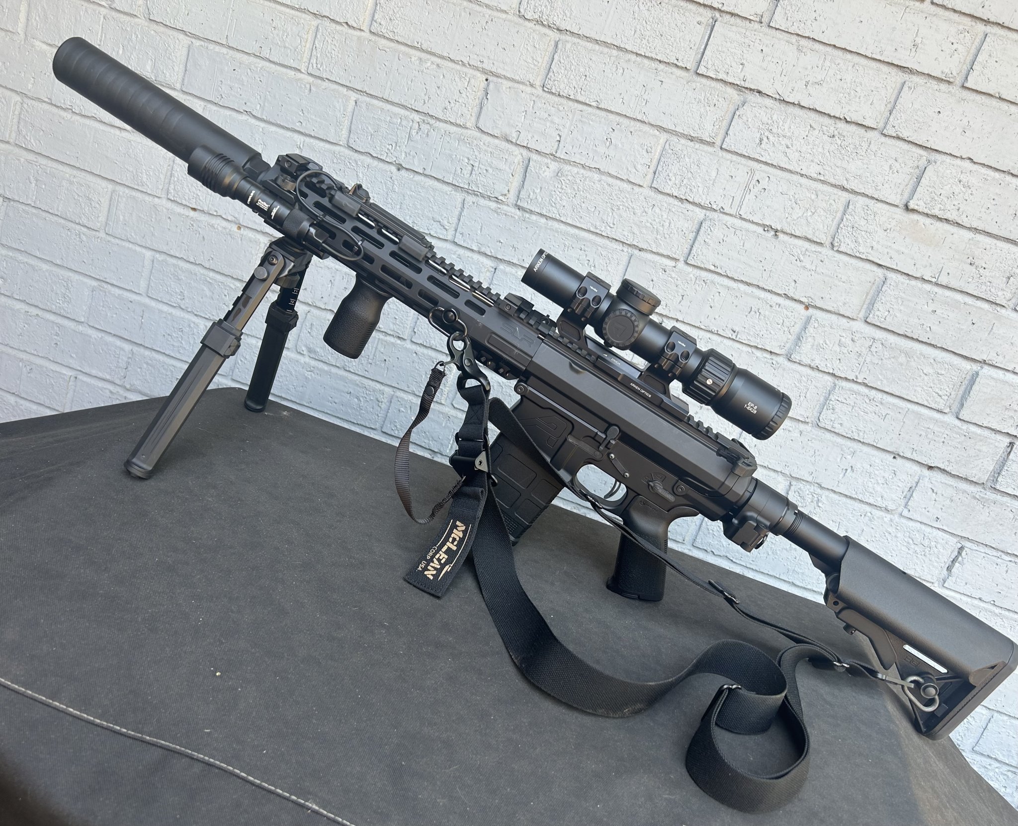

Anyone running an AR10 SBR for subs???
Thinking of a 10.5” suppressed for hunting.
I built my 8.6 Blackout in 12”, so it’s a two stamp gun with the can. It’s quickly become my favorite rifle. So much fun and stupid quiet. It’s a bit difficult to explain the joys of shooting a .300 grain projectile without ears. The first time I did it all I could do was laugh.

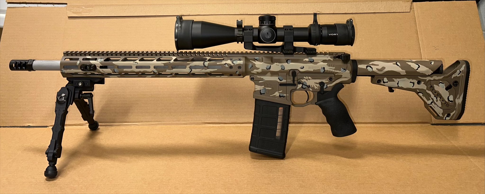

Placeholder for the completed build and range report, but here is a teaser pic. The barrel will be coated black this week. Chocolate Chip Cookie Camo Cerakote. Build list:
Mega Arms MML billet receiver set
X-Caliber 20 inch bull barrel .936 gb (6.5 Creedmoor)
Trigger Tech AR-10 Duty 3.5lb single stage trigger
Vortex Precision Cantilever Scope Mount
Vortex Strike Eagle 5-25x56 mrad
SLR Sentry 9 adjustable gas block
APA Little Bastard nitride muzzle brake
Brownells 308 nitride bcg
Accu-Tac Picatinny bipod
That’s a nice set up. I put that same trigger in my 20” 6.5CM build and love it so much I put it in half my builds. How is that Brownell’s BCG? I’ve seen them, but almost always go either Aero or Radian if they’re on sale.

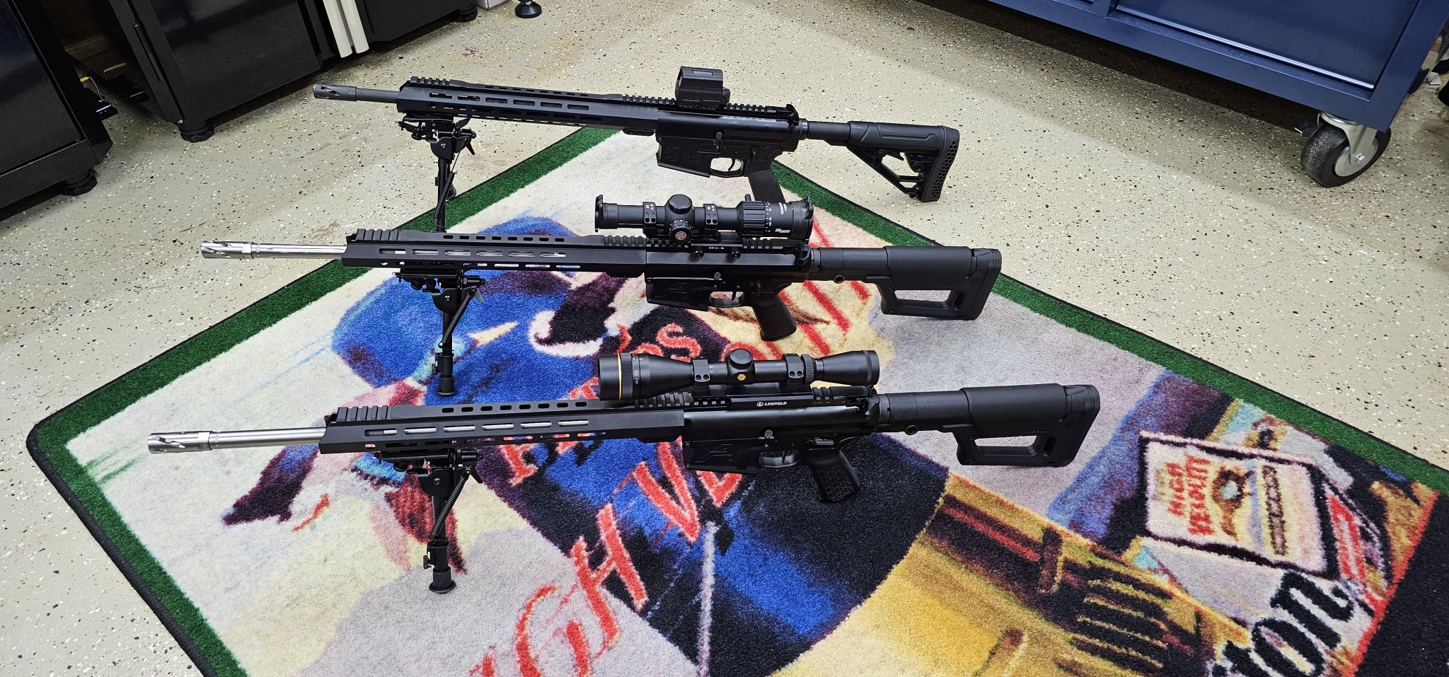

Aero M5 stripped receivers
Midwest Industries 15”
Faxon 20” 308 Fluted Heavy Match Barrel and matching BCG
Geissele SSA-E
VLTOR RE-10/A5SR Buffer system w/ Green Spring and AR15 H2 Buffer
Currently just the SWFA 12x and planning to swap over to the 10x w/ zero stop turrets until I can do a Leupold.
I swap my Sandman K across several rifles, but eventually plan to get a dedicated suppressor for this guy. Looking at either the Nomad L or the GA OTB suppressor system.
I like the Brownells bcg. I have several other Brownells bcgs in both AR-15 flavor and AR-10 flavor. Runs just fine and the price is superb. I have a few JP bcgs, and for the money, these things are a great buy. They look like Toolcraft, but I'm not positive. Maybe someone else knows?
Reactions: Top O' Texas
i have no experience with toolcraft, but do have bcg's from brownells. i have their lite weight bcg in 308 and 556 (bolts to match which ever cartridge i'm using).
i've found that the Brownells nitride 308 BCG has the HP firing pin. worth mentioning, FWIW.
