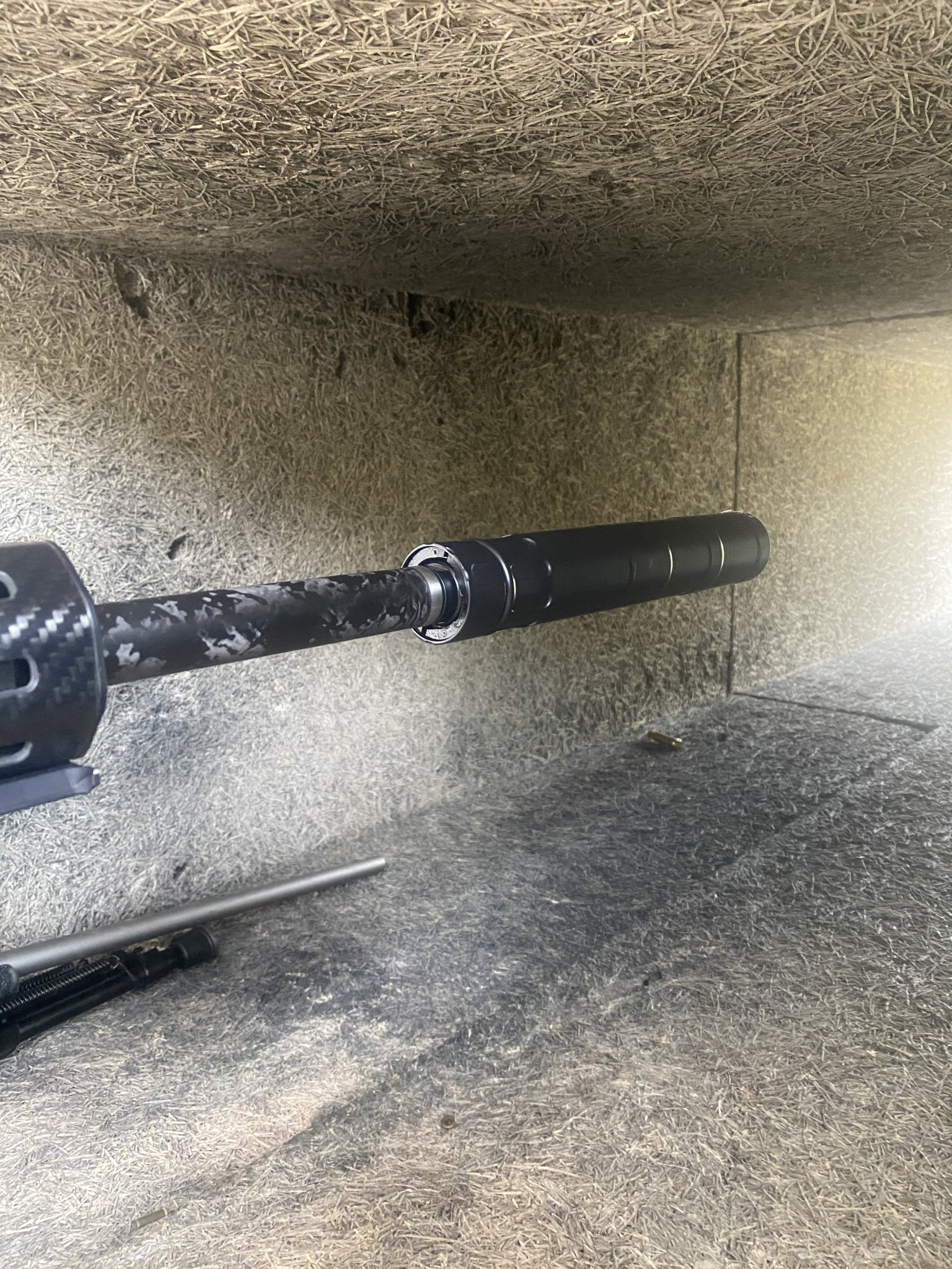

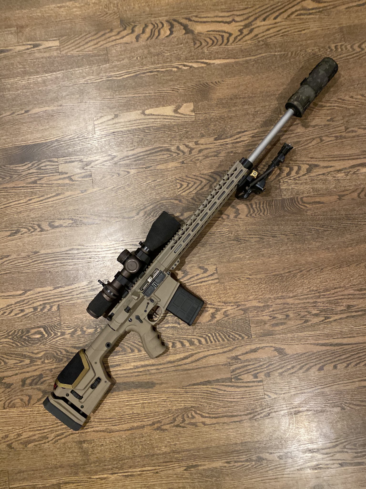

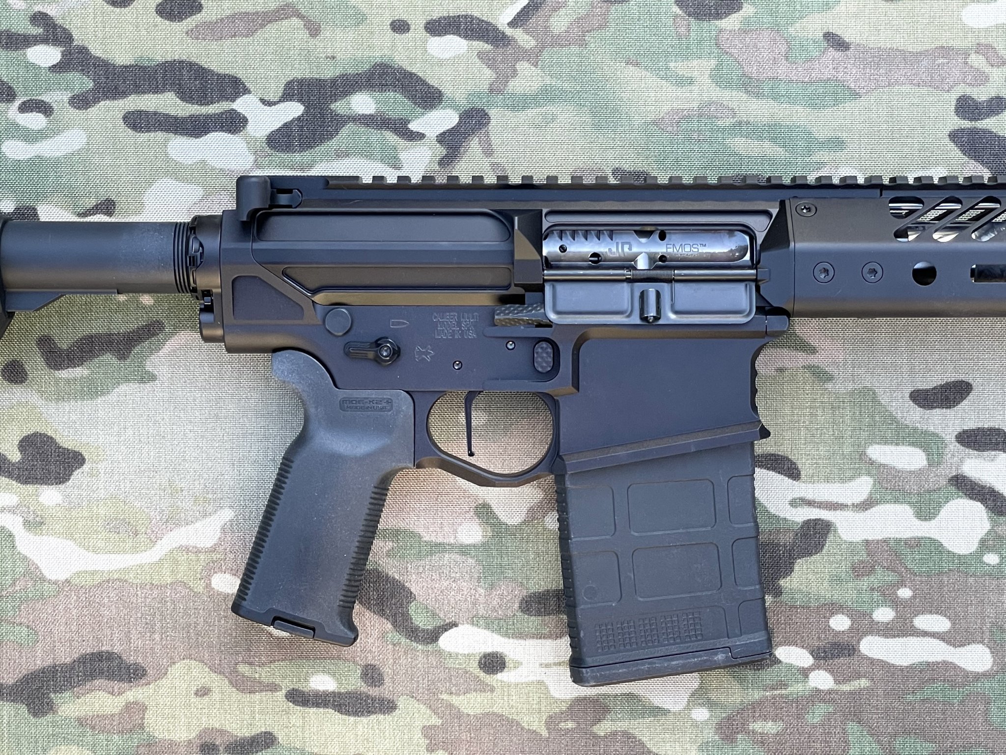

DNA Firearms Systems .243
Proof Research CF 1-10 twist 22” (DNA exclusive)
DNA Billet Reciever Set
Lancer CF Handguard w/ full length arca rail
JP LOMAS BCG
JP SCS
TriggerTech AR Diamond Trigger
Odin Adjustable Gas Block
Luth AR stock
Rugged Surge 7.62 suppressor
Trijicon MKII 35mm thermal
Sierra Prairie Enemy 70gr ammunition

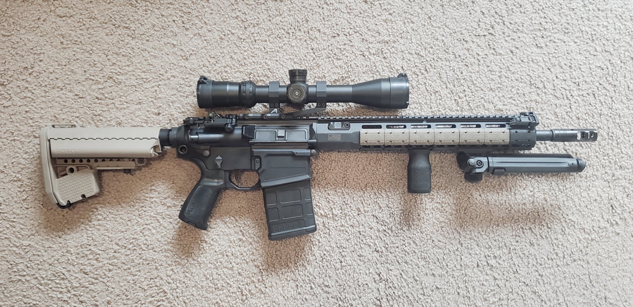

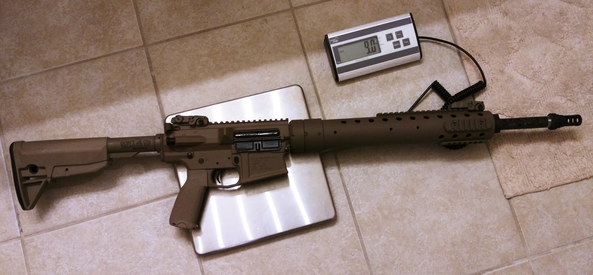

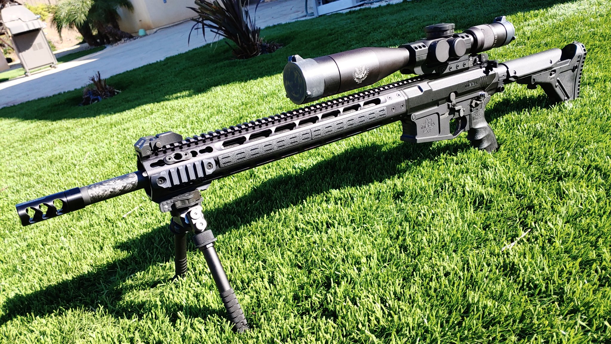

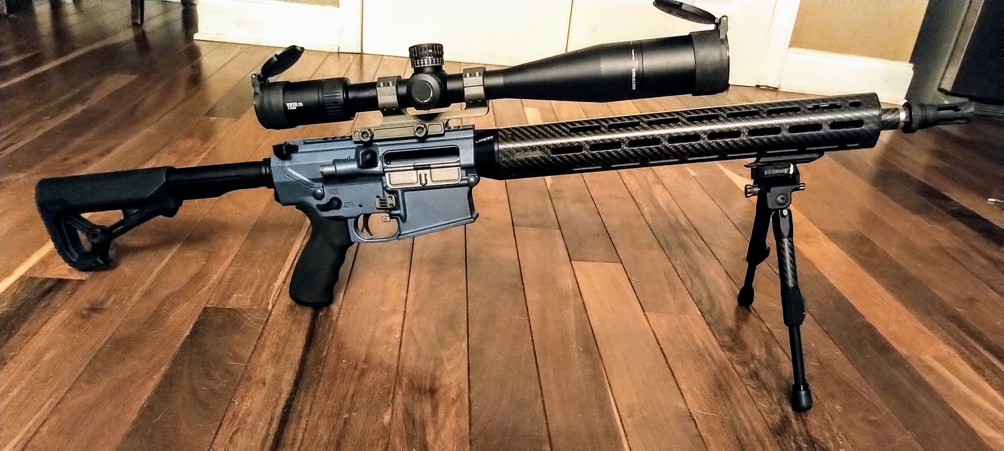

This was my first AR build. I did the entire lower but ordered the upper already assembled. I built its almost twin in .223 Wylde from the ground up. I test fired it with an old Nikon scope I had in the safe and it shoots very smooth.
Specs:
Aero M5E1 lower, enhanced upper, 15" M-Lok handguard
Aero LPK
Geissele SSA trigger
Ballistic Advantage 18" 416R Stainless QPQ Black Tactical Government Profile Rifle Length Barrel
VG6 muzzle brake
Aero nitride BCG and charging handle
Magpul MOE+ grip
JP Silent Captured Spring
B5 SOPMOD stock
Atlas PSR bipod (from my RPR for the photo, I have a Harris that is going on it with a LaRue QD adapter)

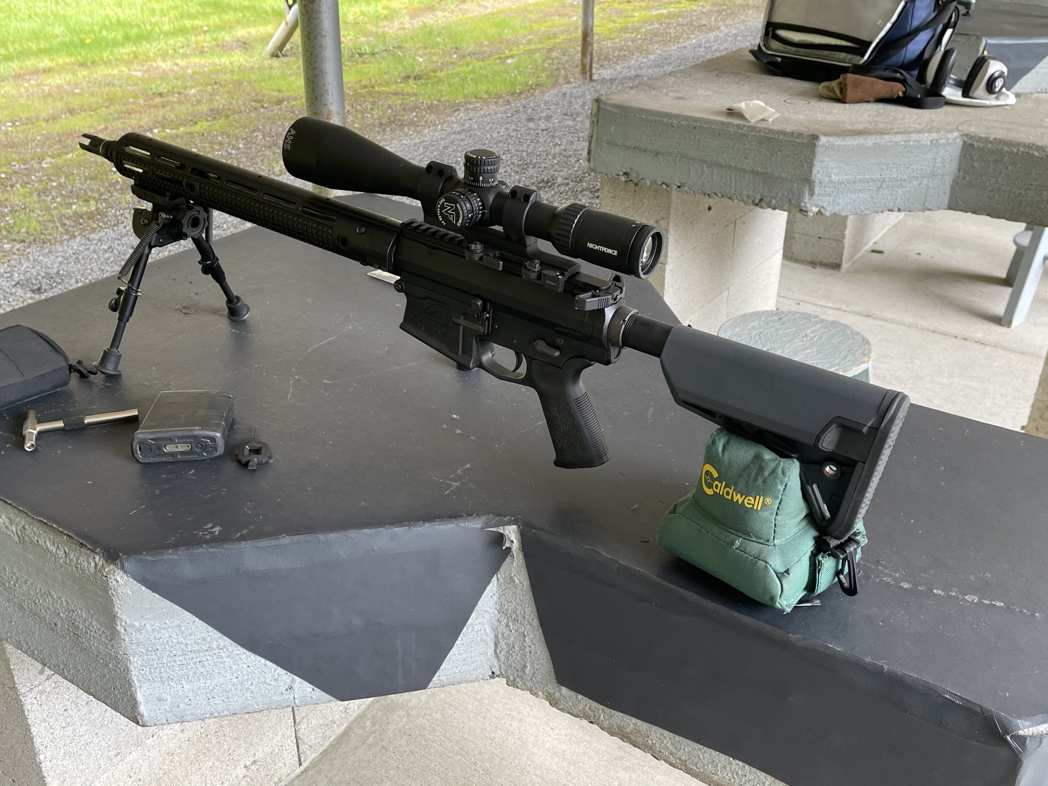

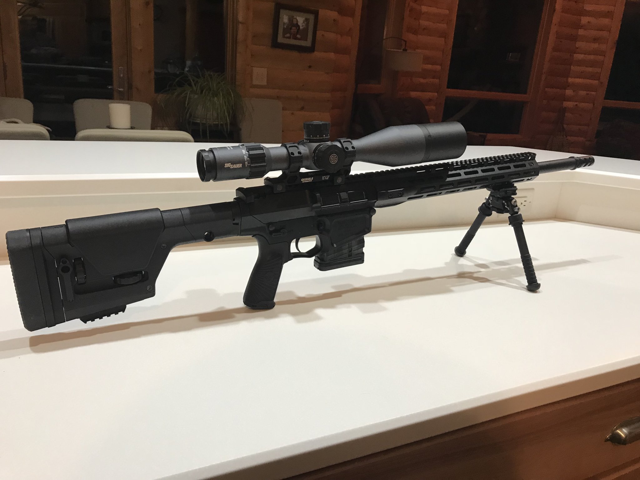

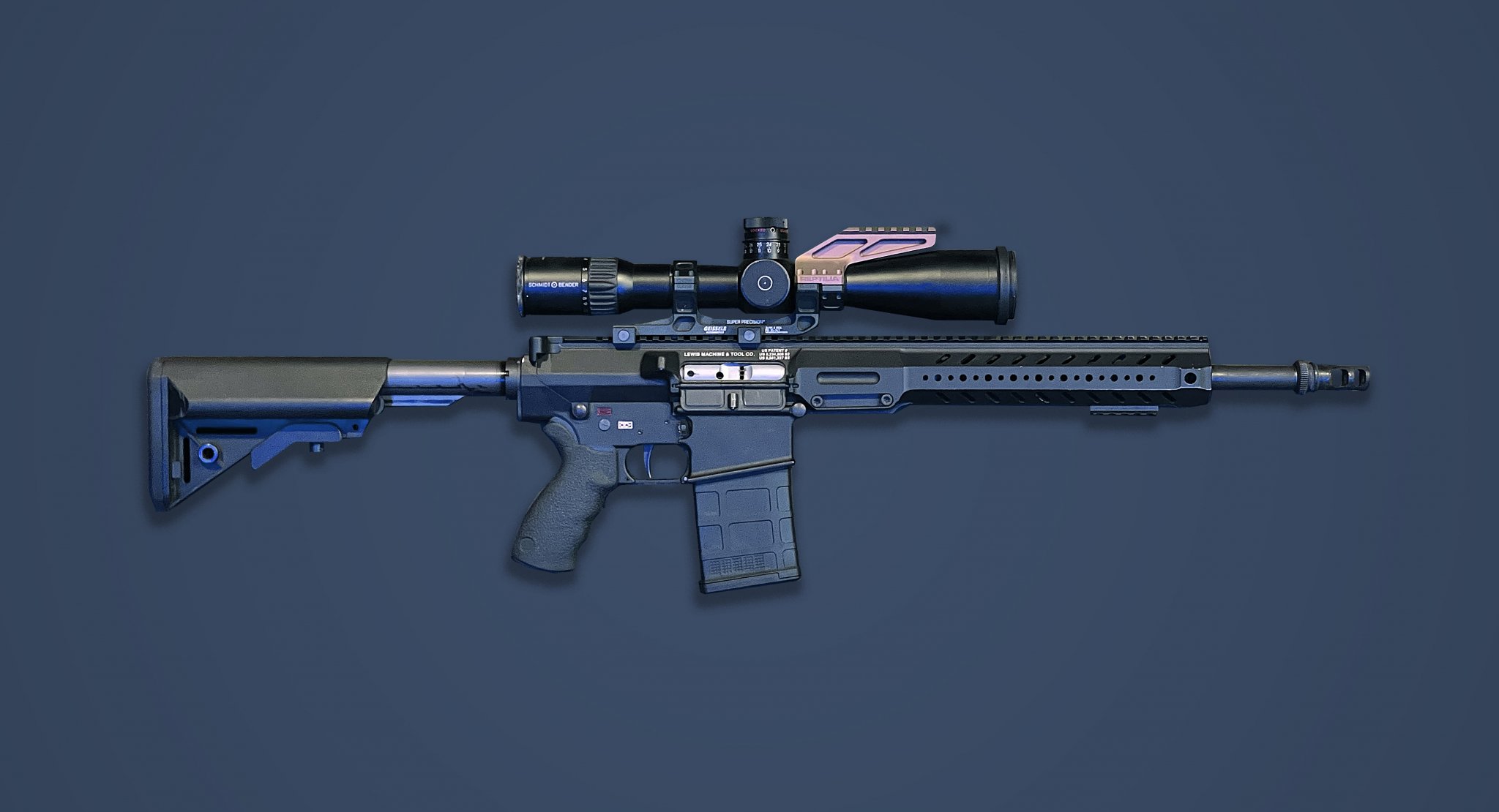

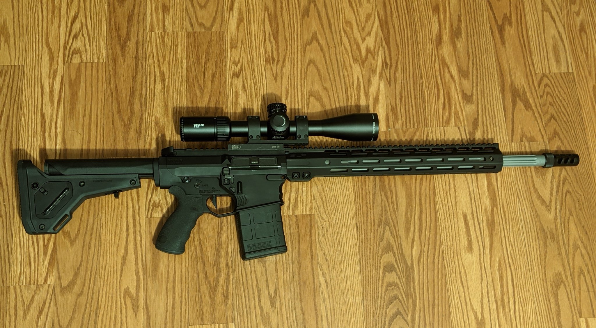

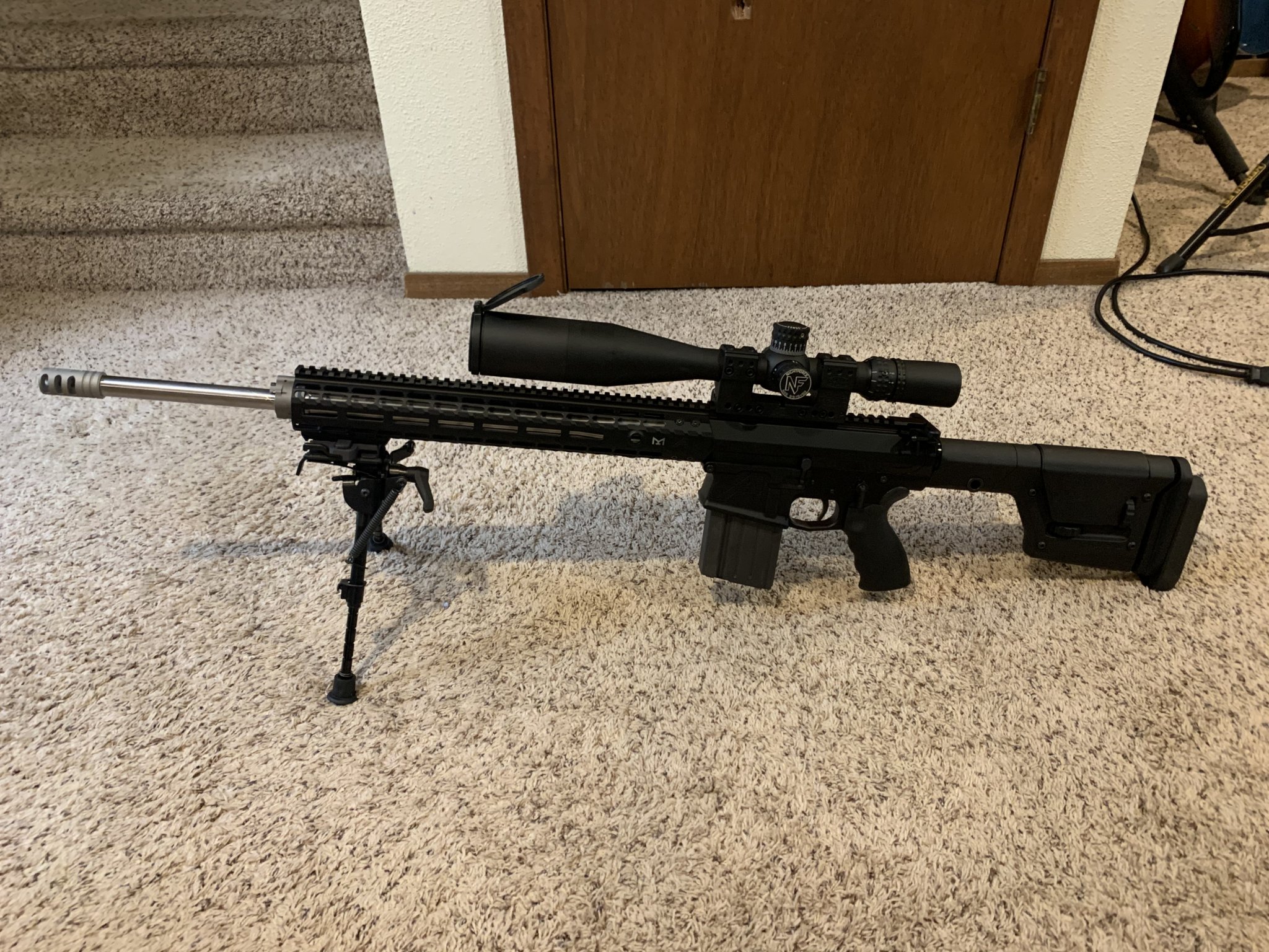

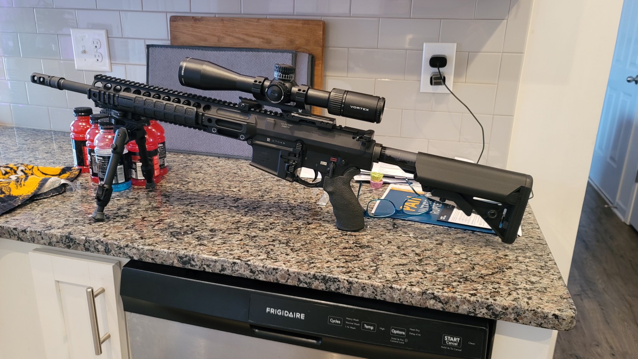

My first venture into 6.5 Creedmoor. Follow up post range session TBD.
- Aero Precision M5 upper/lower
- Aero Precision M5 lower parts kit
- Geissele Automatics SSA-E trigger
- BCM Gunfighter pistol grip
- BCM Gunfighter Mod 1 collapsible stock
- Tactical Expressions "Don't Tread on Me" buffer tube
- Timber Creek Outdoors QD end plate
- Forward Controls Design castle nut
- JP AR-10 silent capture spring system
- JP full mass carrier and JP high pressure bolt
- PRI Gen III Carbon Fiber forearm
- PRI 308 Gas Buster charging handle
- Proof Research 20" 6.5 Creedmoor carbon fiber barrel
- Aero Precision .875 gas block (Seekins adjustable gas block inbound)
- YHM QD muzzle brake
- MAGPUL BUIS
- American Defense 30mm QD mount
- Vortex Viper 6.5-20x50 coated by US Cerakote

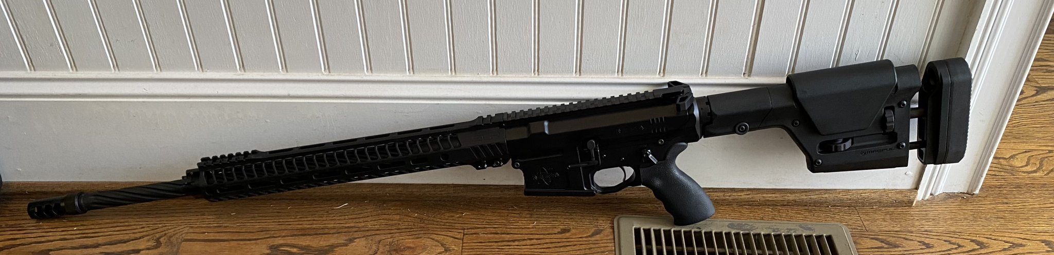

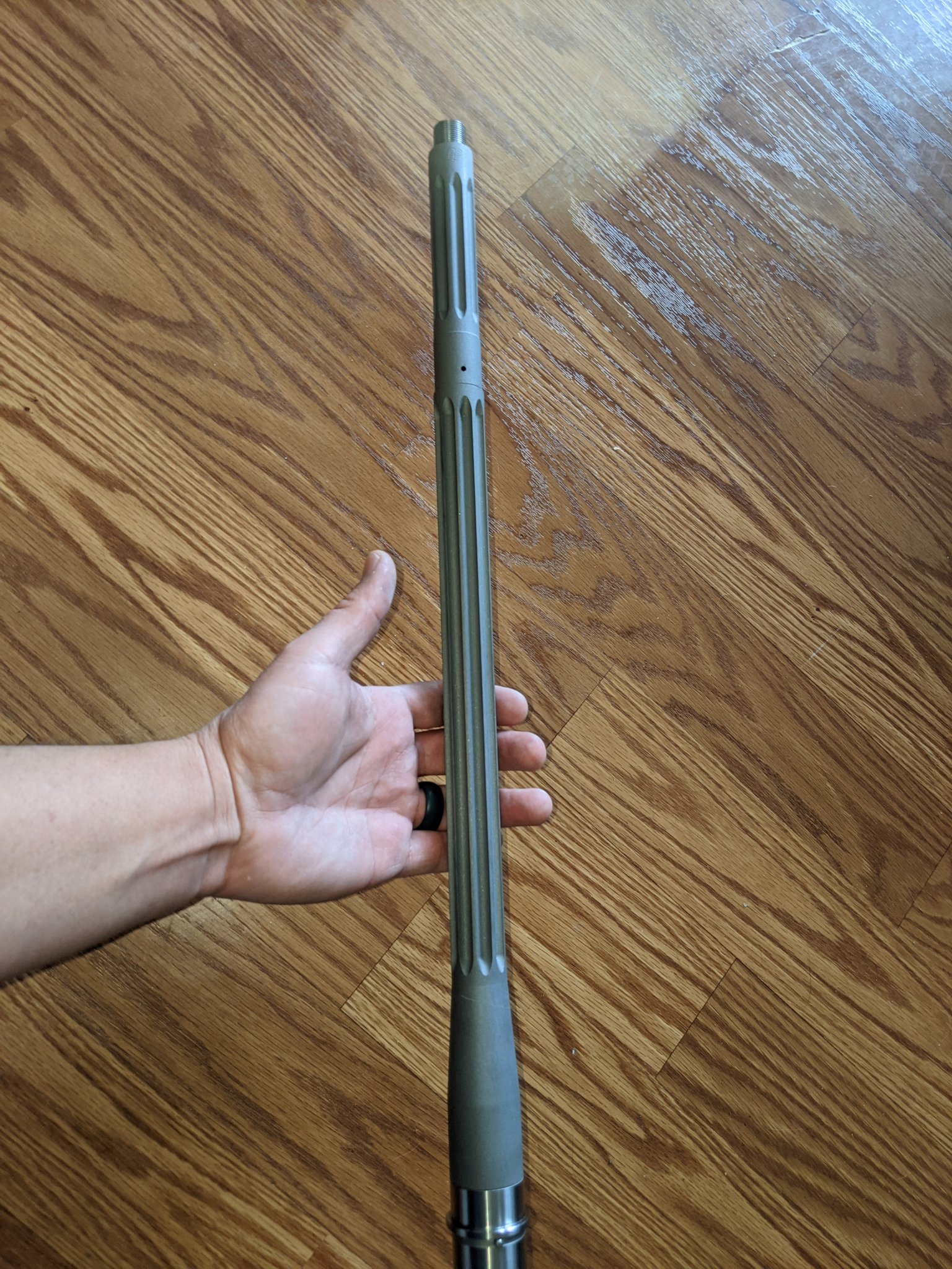

Hey guys! First real post on the hide. Just finished my build. Wife said she wants a baby so... I made myself one🤔 haha. First time with "thermo-fitting" a barrel and quickly realized not to hesitate. Got it stuck halfway the first time but perfect the second. Overall very pleased with how it turned out. Still got to get to the range to get zeroed in and gas block adjusted properly but I have faith it will be lights out.
Shout out to Paul @craddockprecision! My barrel is sweet! Wait time for it hurt a little lol.
~9.5 lbs no optic
~11.5 lbs optic and mount

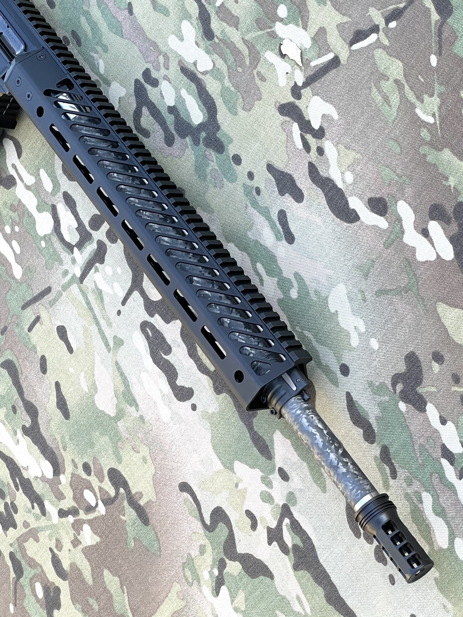

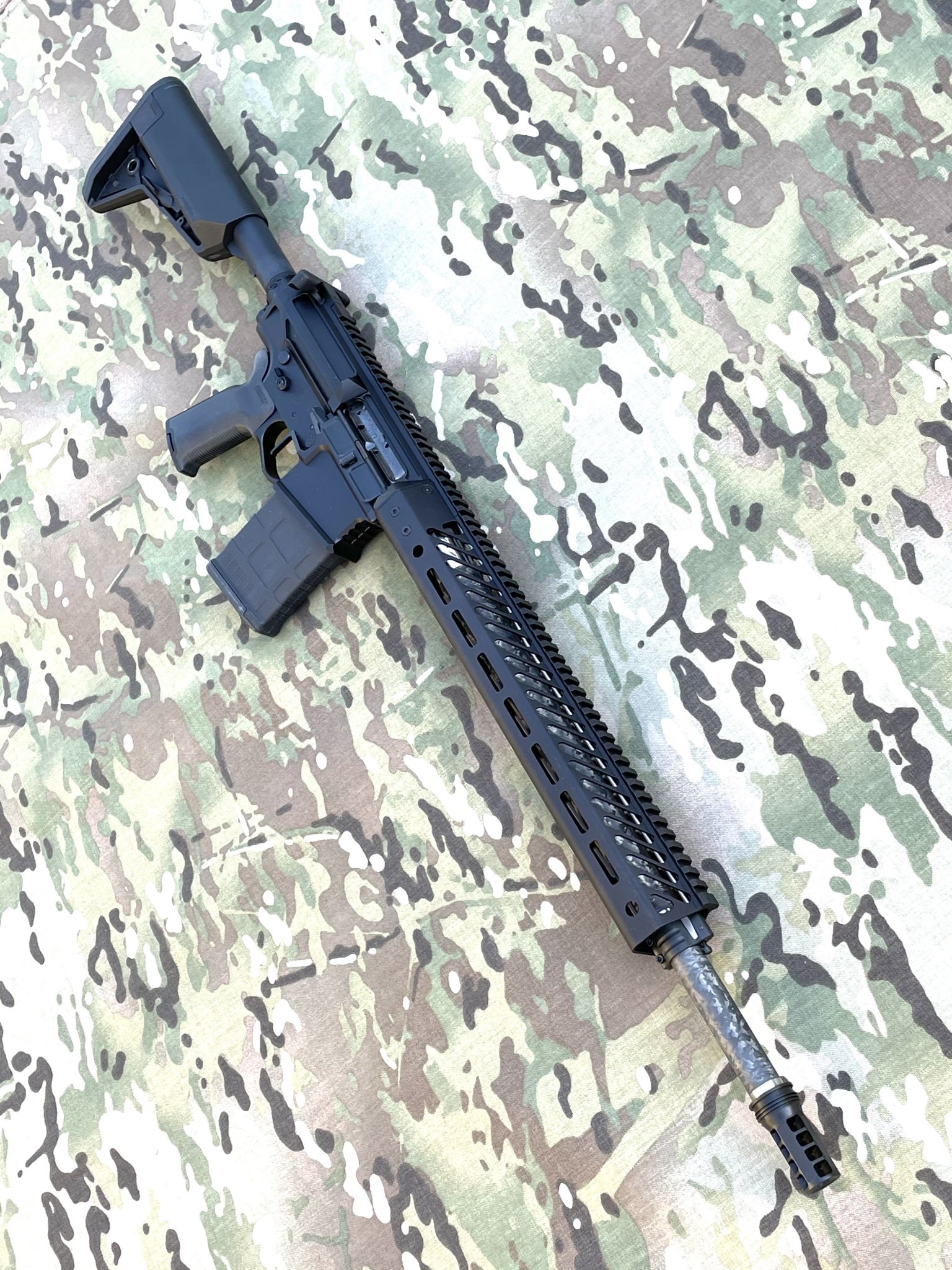

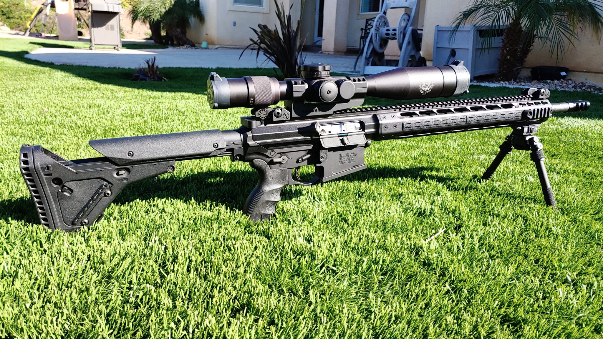

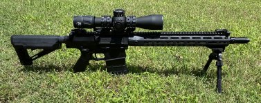

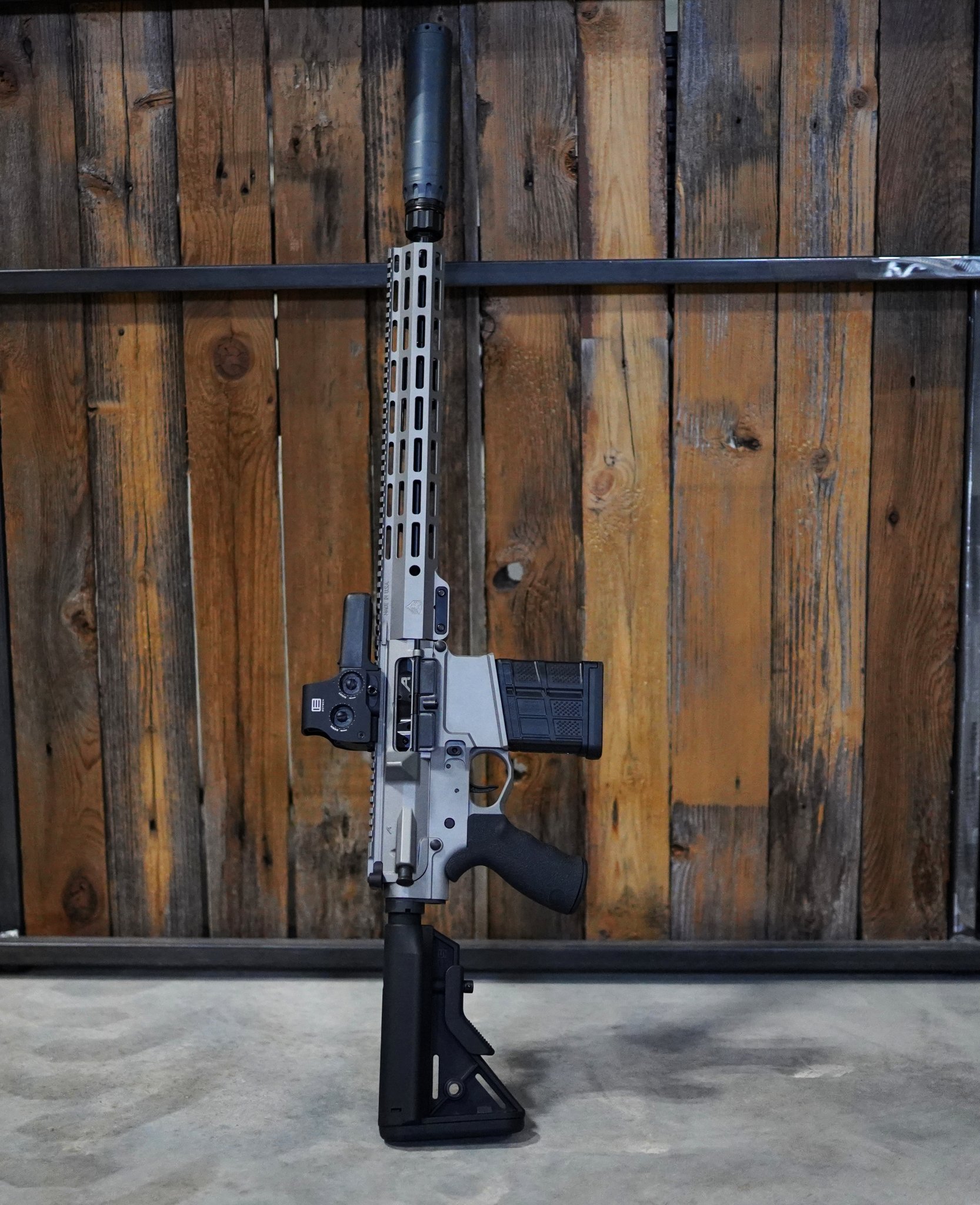

Just put this together.
Mega MATEN receivers, extended rifle rail
Proof Carbon 20" 6.5cm rifle gas
Fail Zero BCG
Slash heavy buffer/spring
VLTOR GB CH
Seekins adjustable GB
USO SN3 20th Anniversary
Aadmount
Noveske BUIS
LW Jetblast
Timney skeletonized drop in
UBR Gen 1
CAA G27 pistol grip

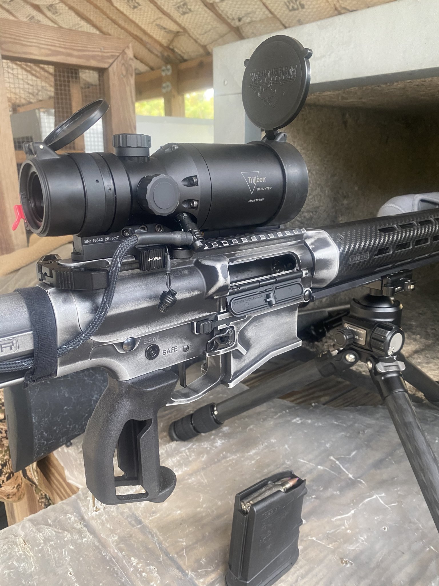

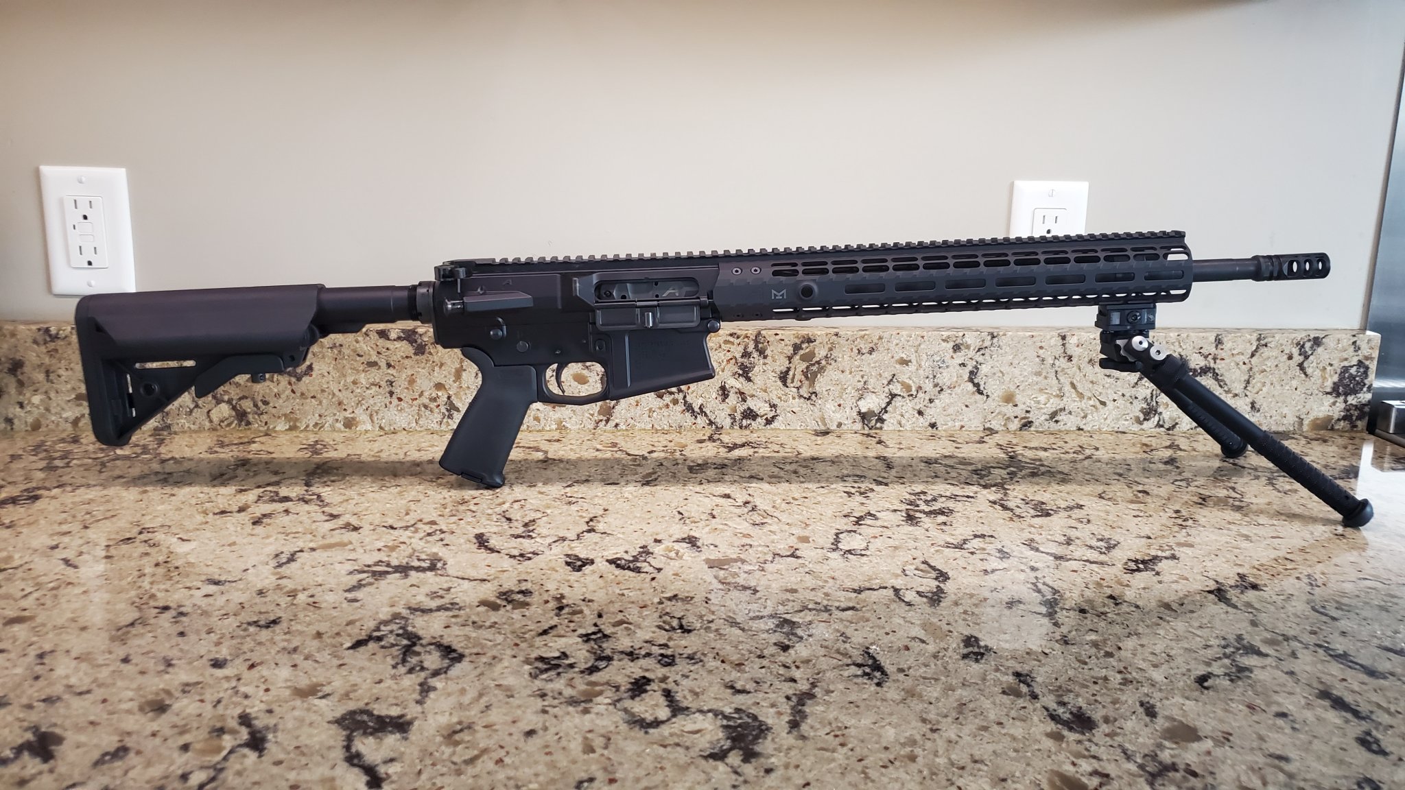

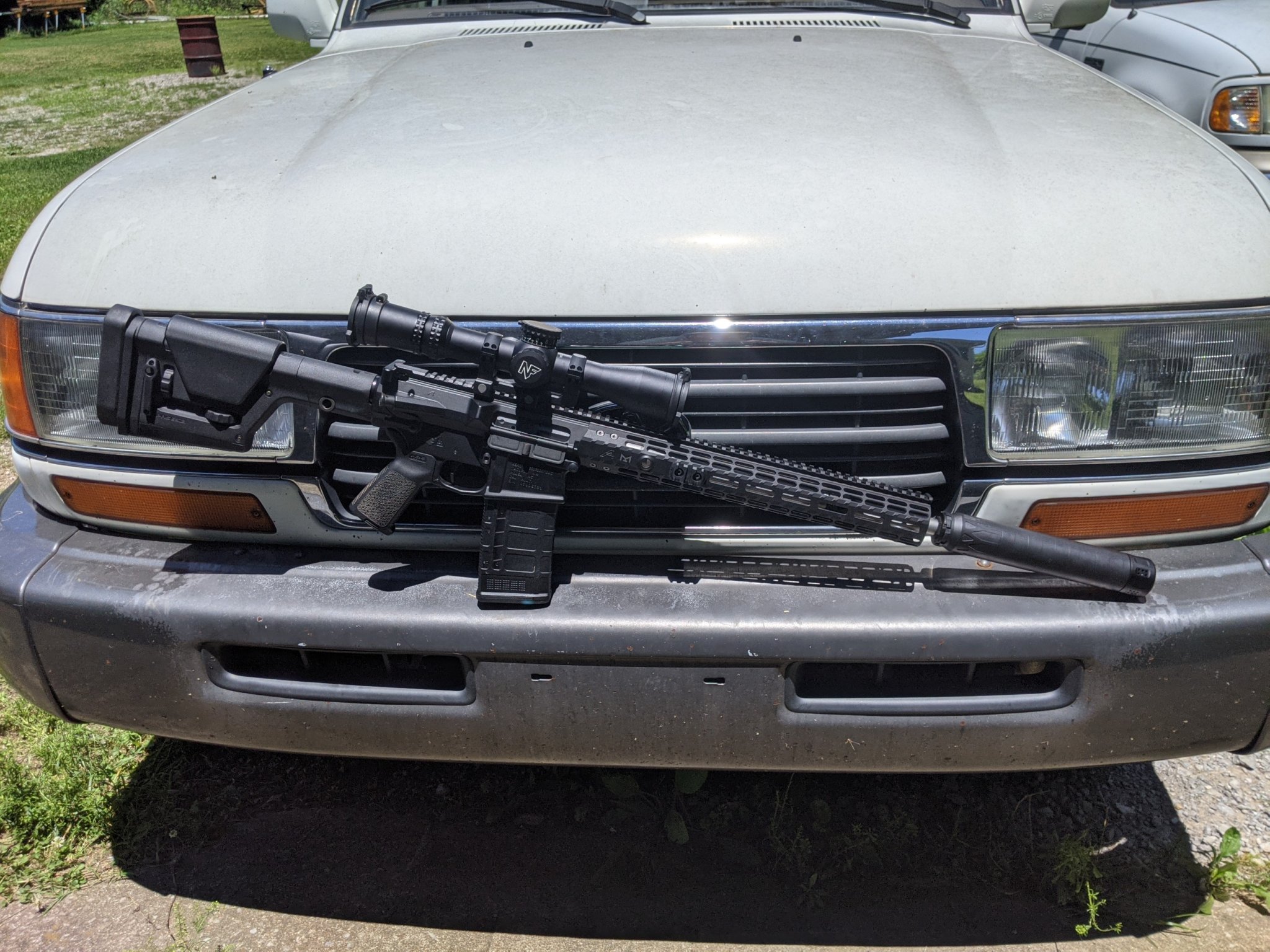

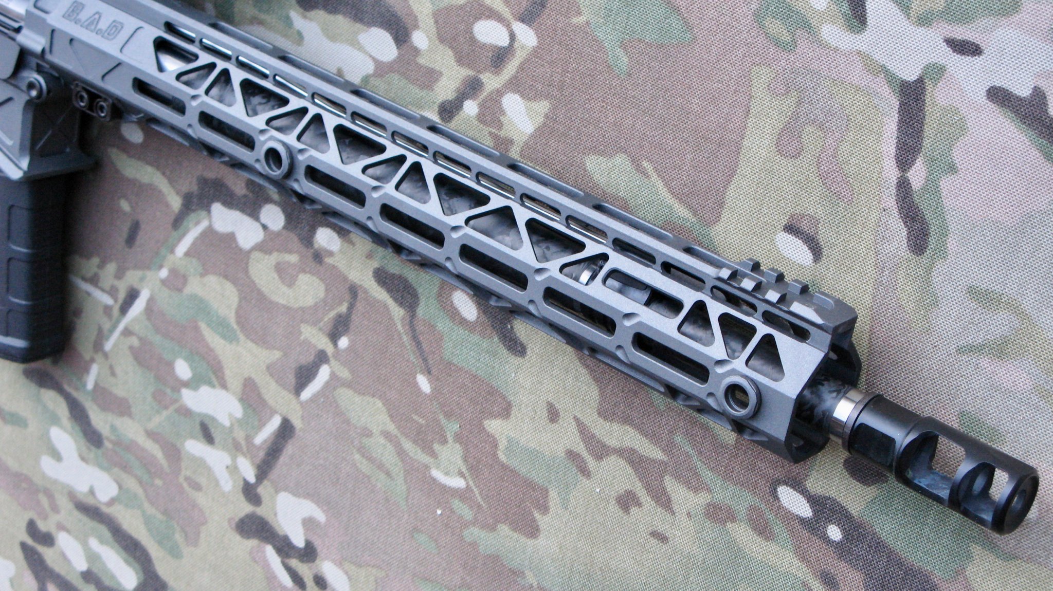

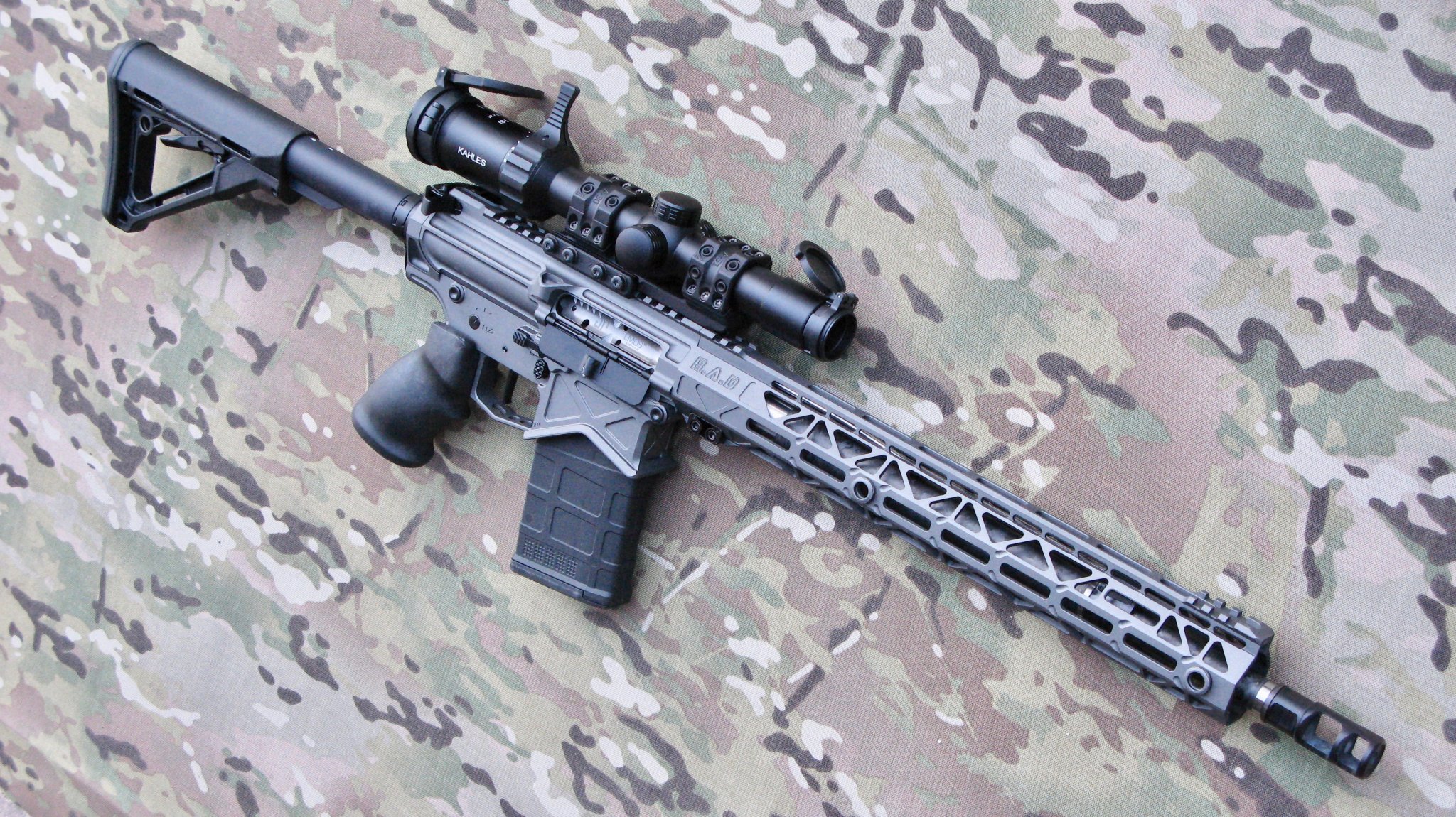

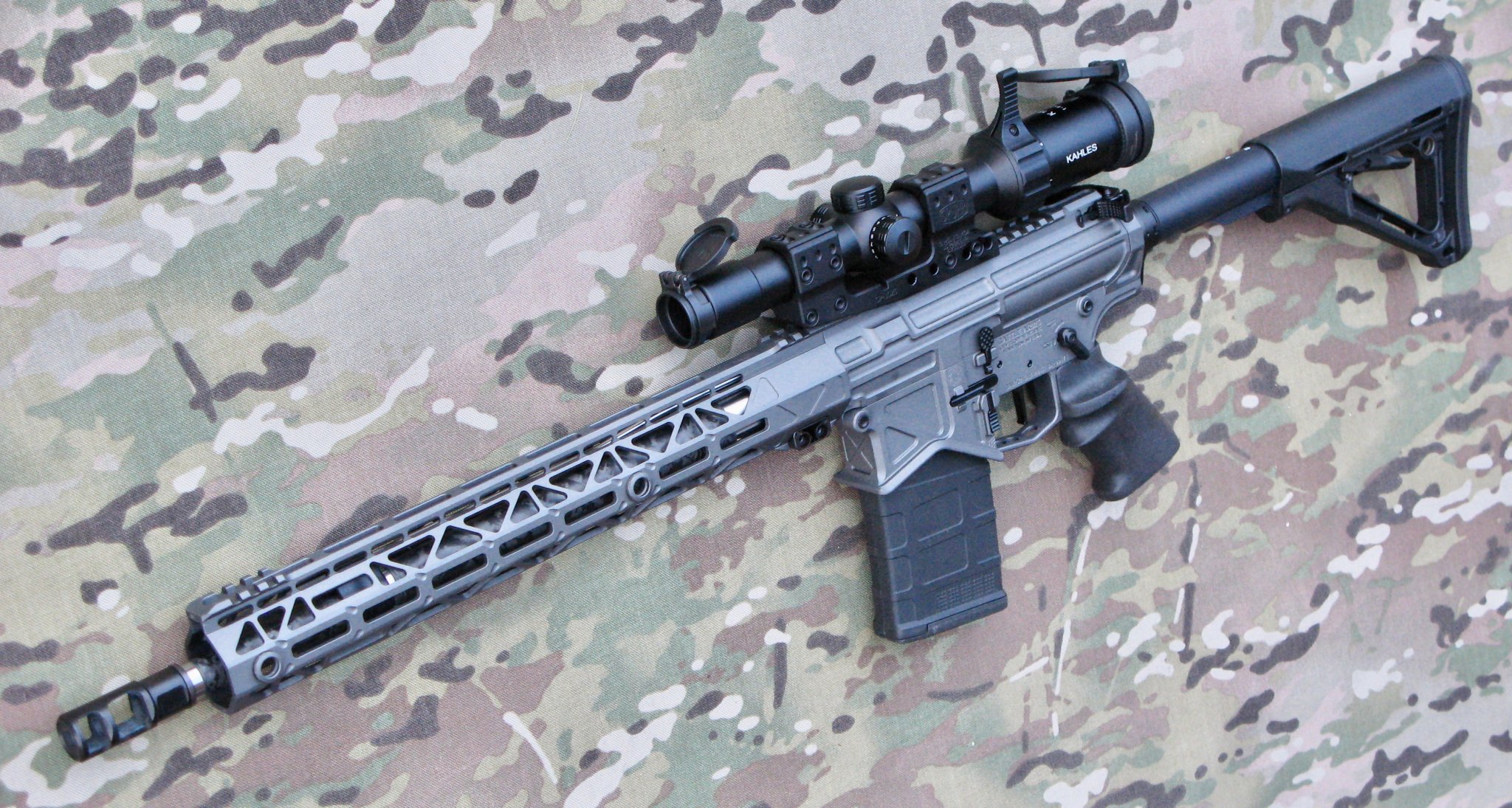

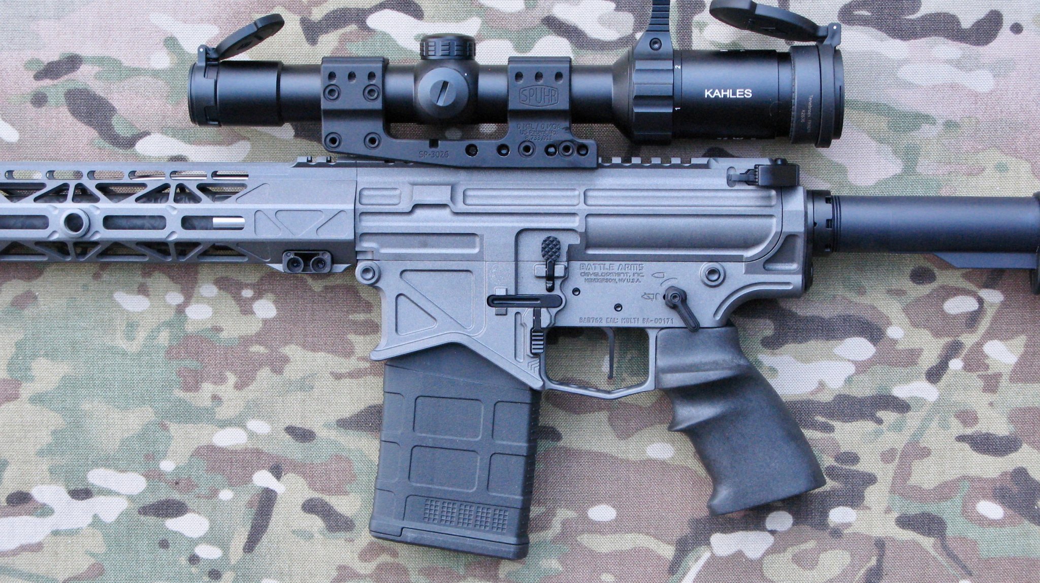

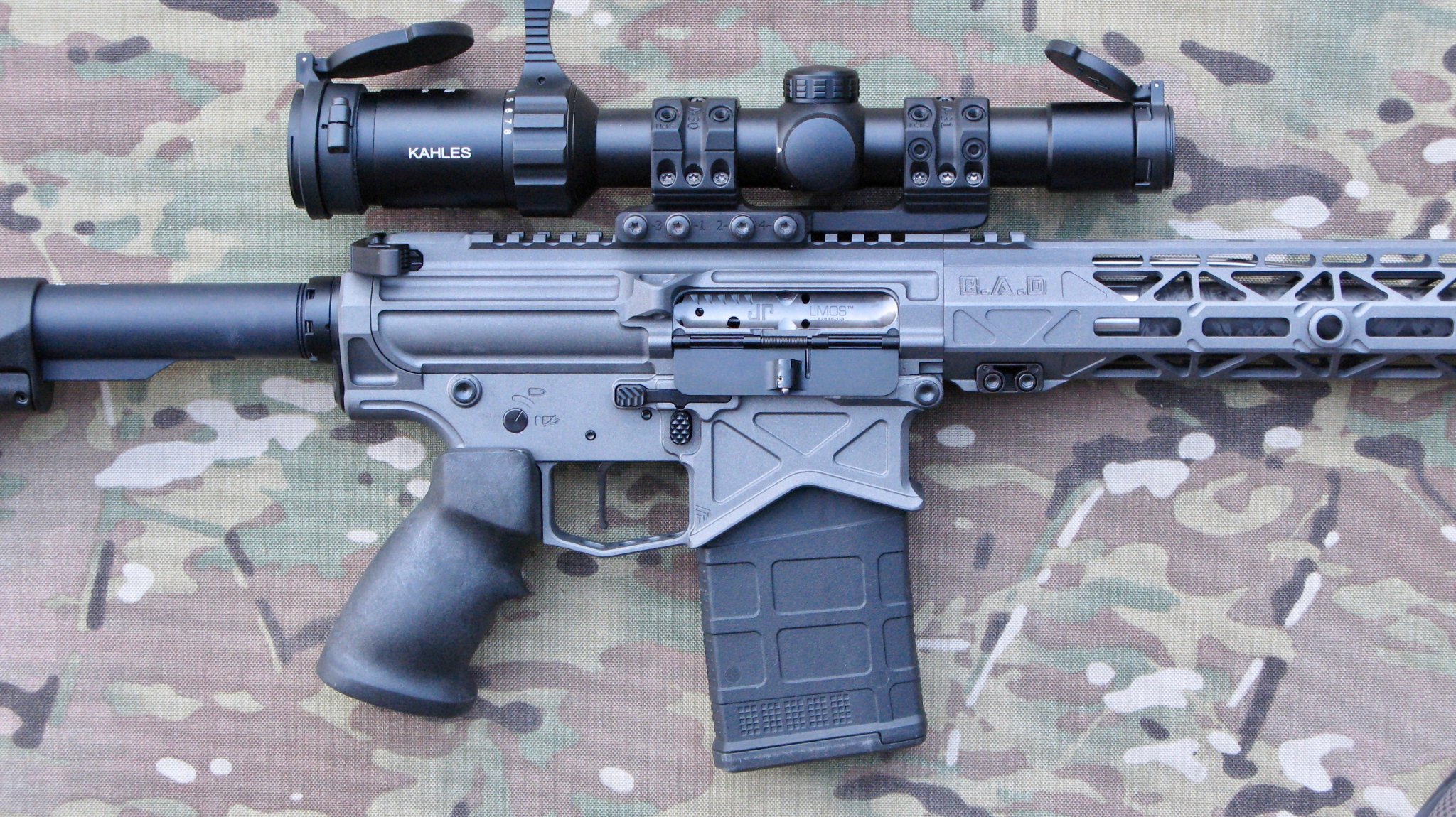

BAD 762 billet receiver set and 15" rail, all done in Titanium Cerakote; Proof Research 16" CFW barrel with intermediate length gas; SLR adjustable gas block; V Seven titanium Furion brake, push pins, receiver end plate, tube nut, grip screw, buffer stop, safety, mag release, fire control pins, etc.; V Seven S7 tool steel bolt catch; Trigger Tech Adaptable adjustable trigger set to 2.75 LB; Vltor A5 lower receiver extension with correct weight .308 spring and recoil buffer; JP LMOS bolt carrier group; SPR pistol grip; Magpul CTR stock and
25-Rd magazine; Kahles K18i in Spuhr SP-3026 mount. Base rifle comes in at 6 LB 14 OZ. Doesn't kick at all. Shoots great.
View attachment 7483685View attachment 7483686View attachment 7483687View attachment 7483688View attachment 7483689View attachment 7483690

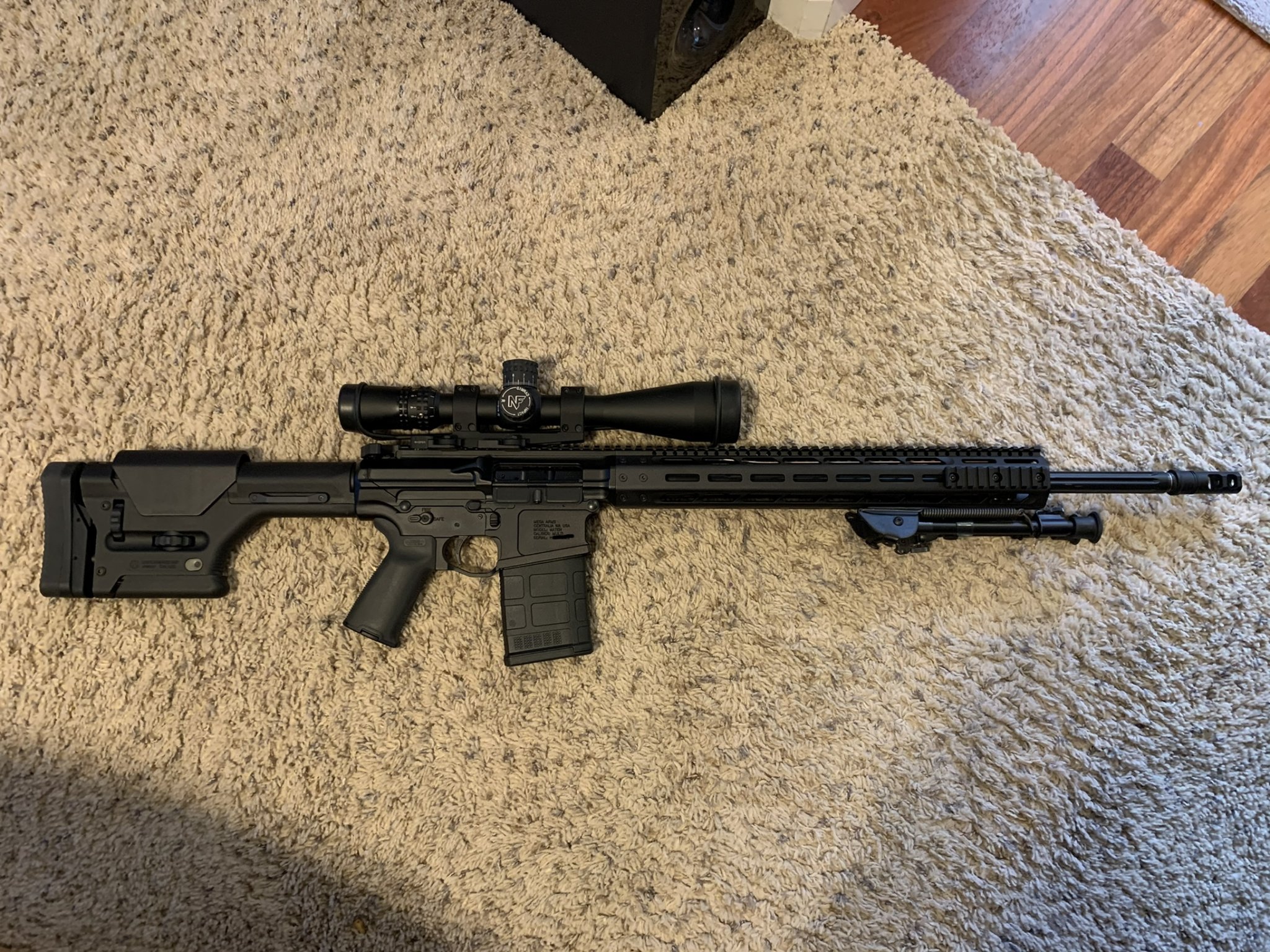

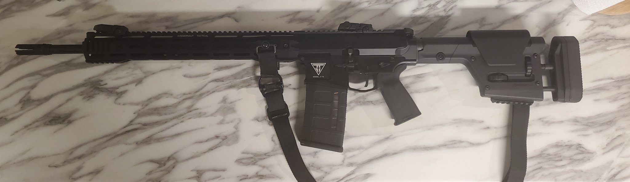

This is one I built about a year ago, but here it is.
Mega Maten billet matched set found on GB
Rainier bolt carrier and 22” .875 barrel in 6.5 CM
Superlative adjustable gas block
Larue MBT trigger
BAD selector
PRS gen 2 stock found on GB
Surefire brake for suppressor attachment
Radian charging handle
Larue 20 MOA scope mount
Nightforce NXS 3.5-15x50 Mildot
Shoots around .80 MOA consistently with 147 ELDM and 144 Berger’s over 41.8 grs. H4350
Recoil isn’t much more than my 5.56 AR15s

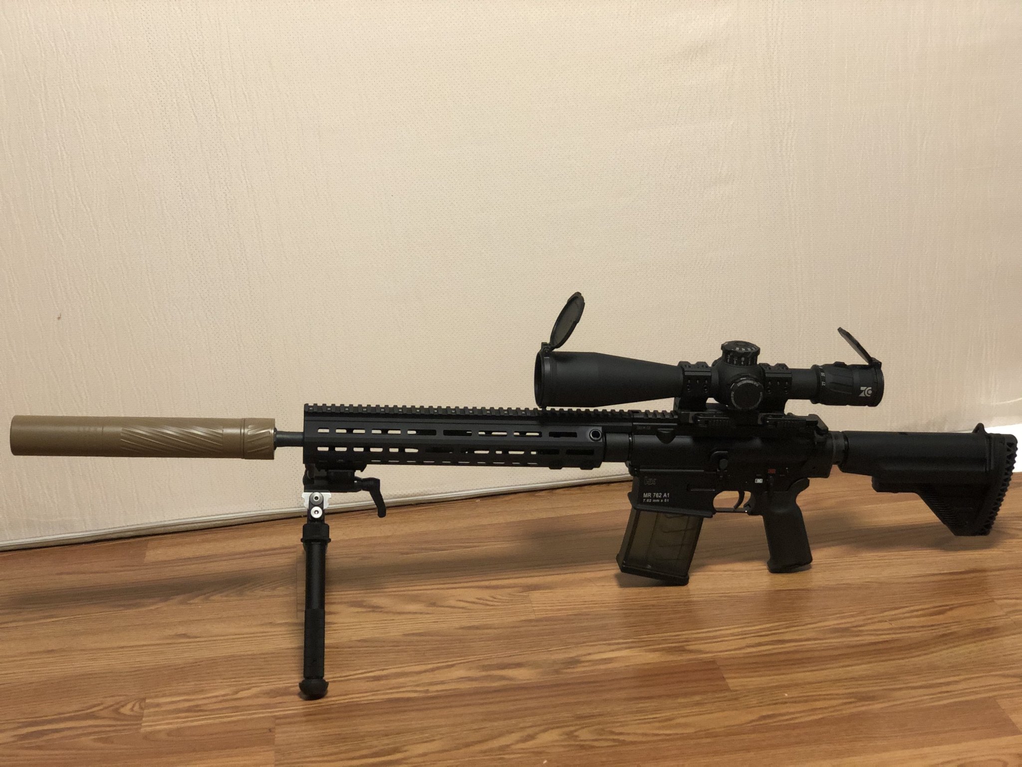

I've fired most SASS platforms and she's definitely a keeper.
SF Edition 18" OBR in 308
Magpul PRS
Larue bipod
NF ATACR F1 5-25x w Tremor 3
M118LR hushed up w the Surefire can

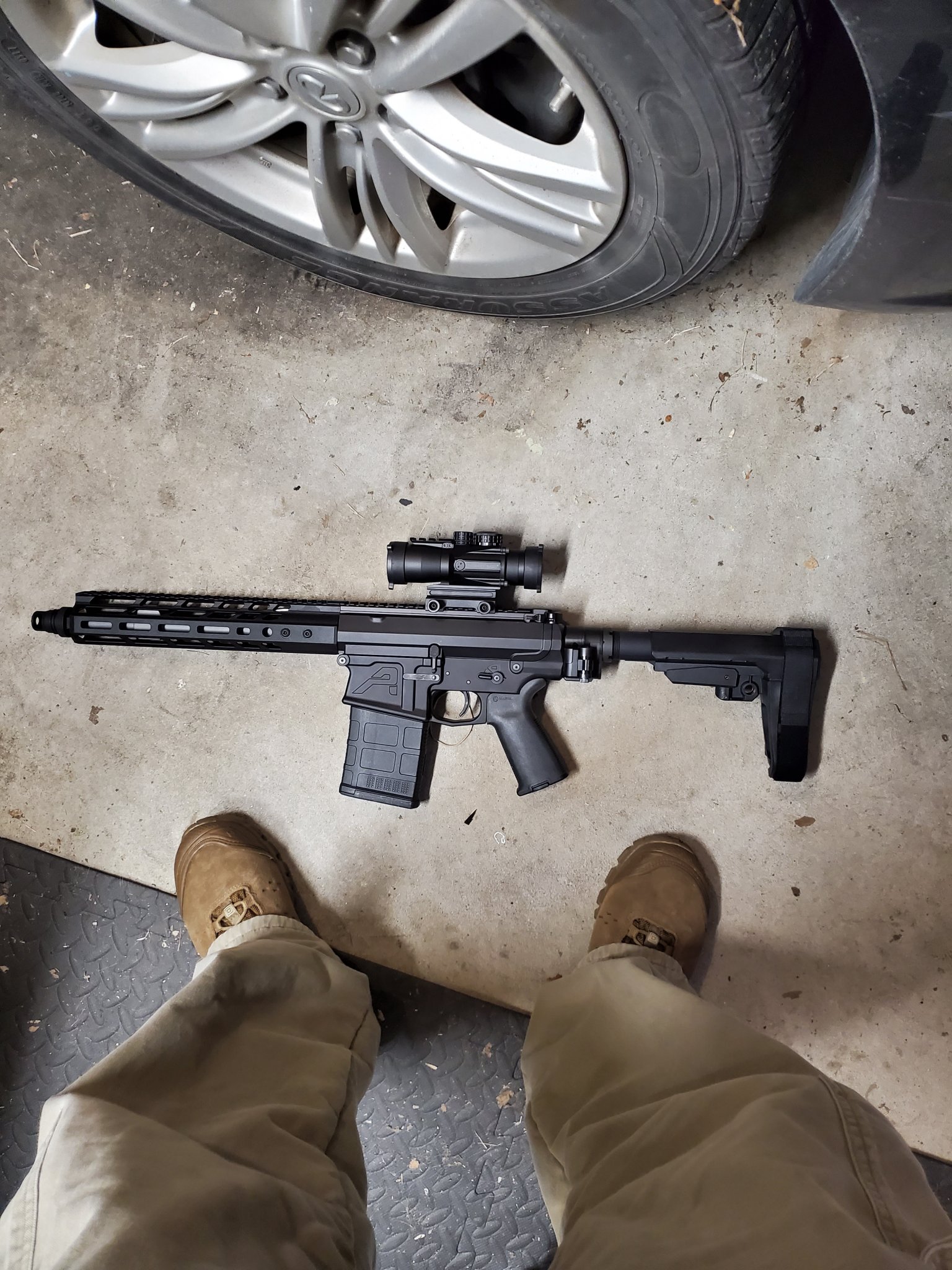

Just finished this California Compliant build.
I put 100 rounds through it yesterday and it ran great after I got the gas block dialed in. The SLR gas block is set to the 7th click open. The groups were @ .6 mils at 100yds, (2-ish inch)
All day long it would put 2 rounds on top of each other and then throw a flier. I hope that once I get a good copper base inside the barrel the groups will tighten up.
Aero M5 lower/upper.
Lantac BCG.
Proof carbon 18" 308 10-twist.
APA Lil bastard brake.
SLR adj gas block.
Gieselle SSAE FCG.
API carbon 12" rail. I had to go 85lbs on the barrel nut to get it lined up for the gas tube. It was either 85lbs or 35lbs, I went with 85lbs.
Vintage A1 stock.
Bullshit CA compliant kydex wrapped pistol grip.
Rifle buffer spring with Standard buffer.
KAC Micro BUIS.
Armalite dust cover rod (longer). The DPMS rod was too short.
Pivot pin was very tight. I had to do a bit of sanding on the pin and hole.
Vickers sling with MASH hooks.
Atlas B10 bipod. I will probably go with a Harris 6-9.
I am still looking for an optic. Probably go with a 12 or 16 power.
Edit due to spelling.......

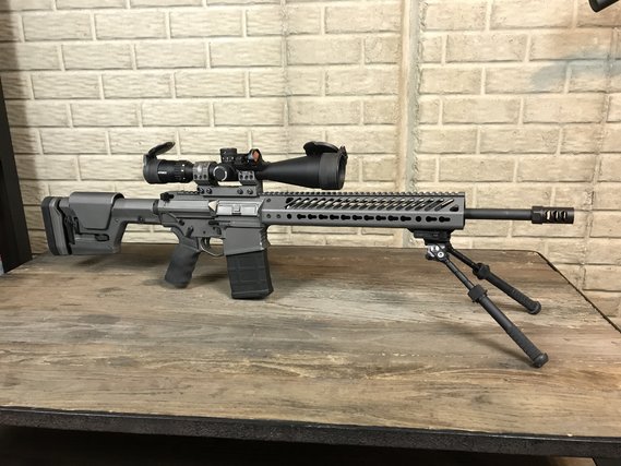

Finally got around to scoping and shooting my M5 build.
Aero Precision M5 builder set with 15" mlok fore end
Krieger M110 AMU profile 20" .308 1 in 10 barrel
Precision Armament M4-72 brake
Geissele Hi Speed DMR trigger
Magpul CTR stock with LaRue RISR at A1 length of pull
Nightforce NX8 2.5-20x50 Mil-XT
Nightforce Extended Unimount 1.375" 20 MOA
Harris 6-9" bipod
Currently it has an AR Stoner 2.5 inch 3.7 oz buffer and .308 spring in a standard 7" receiver extension, but is under-buffered with a .100" gas port - one magazine with longer feed lips has bolt over base malfunctions. I'm swapping in a 5.3 oz buffer, Springco orange .308 carbine spring, and SLR Rifleworks Sentry 8 gas block so it will run reliably using all magazines and not move around so much. If I'm not happy with that, I'll move on to an A5 extension with a Springco red and heavier buffer.
The A2 stock I started with was way too long with the extra 5/8" of metal behind the pistol grip, the Magpul by itself was too low, and while I was able to trim a 1/4" Magpul riser to clear the charging handle I didn't like where it stopped leading to the spring loaded RISR that's a hair high a little past 1/2".
12.5 pounds empty, nearly triple the weight of my lightest AR at 4.6 pounds.
10 rounds at 100 yards sighting it in off the bipod, Hornady 168gr BTHP Match. I'm not a good marksman.

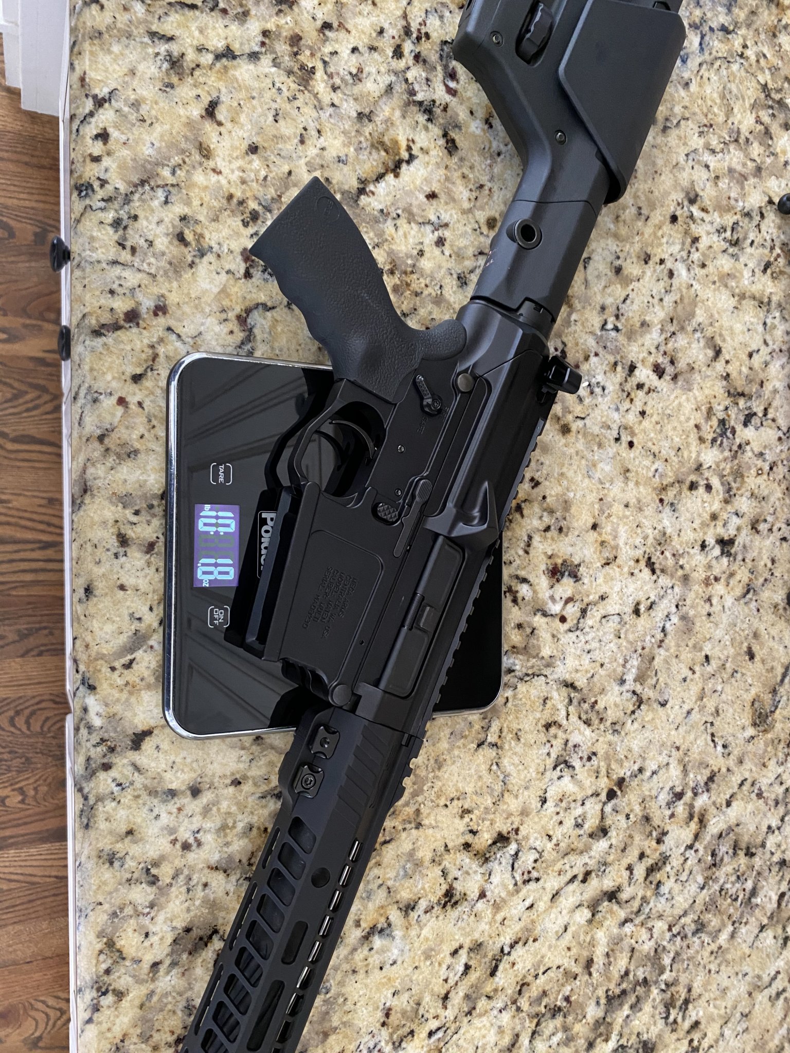

Spent a while trying to track down an LMT MWS recently and prices were crazy. Lucked into this PD trade-in for a great price this week and just arrived - taking to the range tomorrow.
Got a 6.5 blank coming next week to play around with converting over to the MWS extension profile. Anybody else do one themselves and have any tips? Trying to decide on a gas system length too, looking at 18” with a suppressor most of the time. Think a rifle length would work out?

Horner
I just Cerakoted mine in "Cobalt Kinetics Green" and it looks similar. Mine has a very faint flake in it, and looks great, not sure if same color but it's the same shade. Check out their color chips that may be it.
How long is the handguard/gas system/barrel?
Any accuracy results yet?
The handgaurd is 15", the gas system is a +2" and the barrel is 24". From the research I did and after talking with CLE, I came to the conslusion that a +2" was needed, especially since I am running suppressed. It has an adjustable gas block to dial everything in from there.
The rifle shoots great, half inch at 100, 2887fps with an SD of 6. Ran it out to 1,100 yards, shot great!
Reactions: WVshooter
Took me a little more than a weekend to get out with this one but hats off to Craddock on this barrel. 0.6 MOA with factory Hornady 140 while sighting in a scope this weekend...I was thrilled. Can’t wait to do some load development and take it out to distance.
Reactions: Bigtrucknut
16” 6.5 creedmoor
wilson Combat fluted barrel and BCG
Aero Precision upper and lower
apex 15“ handguard
la rue trigger
Wilson Combat adjustable gas block on order
Reactions: P47rr
Just finished building this one. Haven’t gotten to the range yet.
Aero recv set, BCG, and m5e1 hand guard.
PRS gen 3 stock
Proof Research SS 22” +2 barrel
PRI muzzle break
Superlative Arms gas block.
Ergo grip
PRI gas buster CH
3.5-15 NXS in a Spuhr mount.
Have a Harris bipod with an ARMs bipod mount for now. I’m going to replace that in the future.
She is heavy but hopefully she will be a shooter for me.
PRS gen 3 stock
PRI muzzle break
Ergo grip
PRI gas buster CH
Good looking rifle. What you shooting through it?
Cool, Enjoy. I've got a similarly built rifle using Aero receiver, BCG, and handguard, PRS Gen 2, SSA-E trigger, but a 24" barrel in .243 Win. I absolutely love shooting it and have had it in two PRS matches to date. I'm sure yours will shoot.
Thanks
I will be taking her out on my next day off to break in the barrel

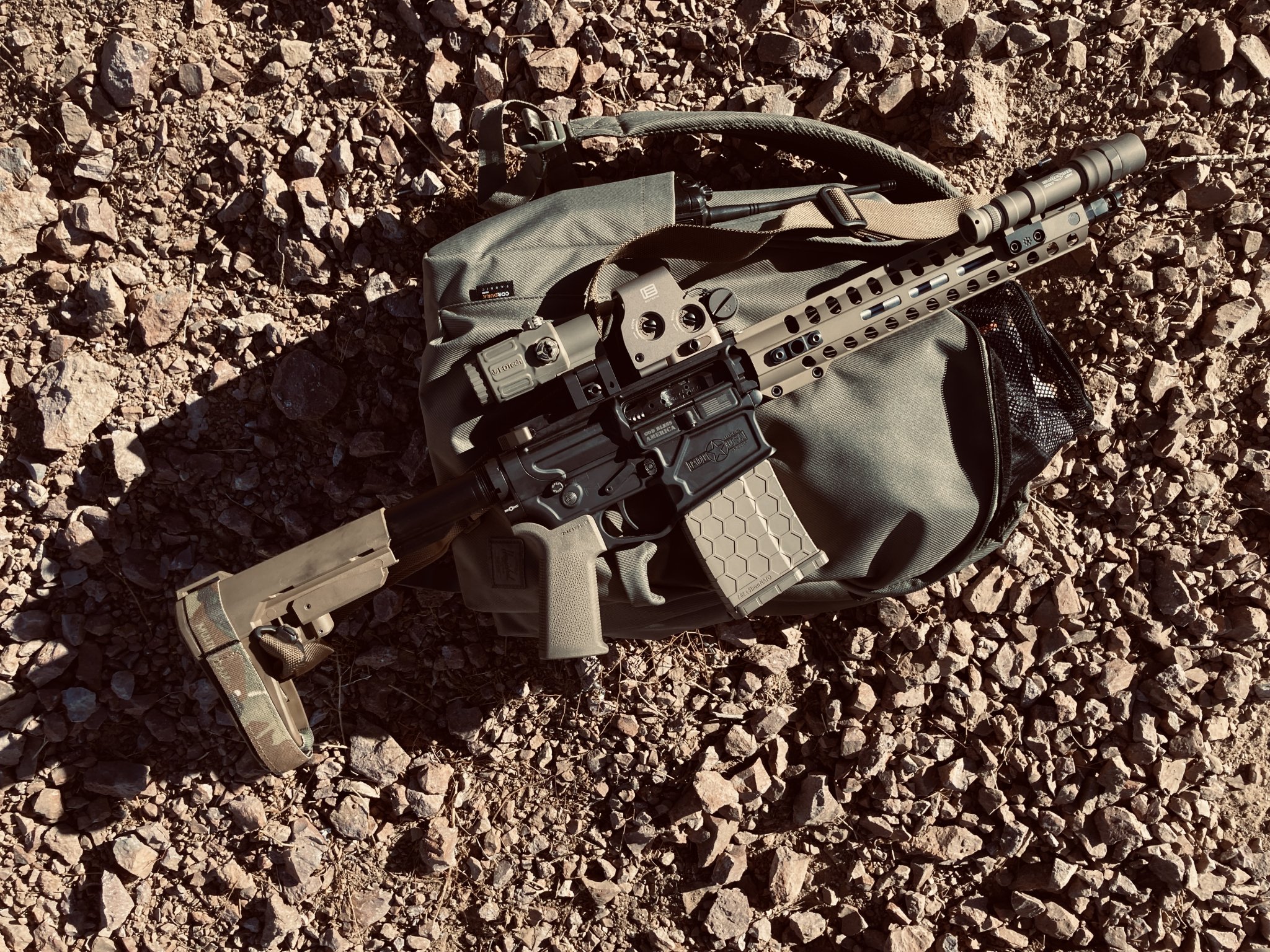

POF Rogue, AR15 barrels added the dissipator adjustable gas block - they also milled off the upper and lower pic rail sections, except 6 in the front, he also milled down the surefire body so it mounted flush with the arisaka mount brought it in an extra 1/3 inch or so.
Cerakote by Immersed Hydrographix - Shooting when its hot is sooooo much better now.
Rogue with no optics or light 5 pounds 9 oz.
XS tritium front and rear big dot dangerous game sights - 0 inch radius because they are so low profile and it IDHTF they work shouldering a rifle unless its something like an ACR or SCAR, they work fantastic at point blank to 30 feet, I call them hallway sights and they are always on - 192 yards is my farthest shot with them - 100 yard hold is 1 foot high and left for center mass.
Eotech XPS3-0 / G33 Magnifier - just got the Unity riser and flip down mount - haven't been to the range to zero.
Hexmag 10/20 because CA
Hellfighter Mod because CA
Elf tactical push button safety because Hellfighter and also its super fast, ambi and its very quiet.
Magpul MOE SL grip - I have big hands, people with small hands should be the Moe K - check your natural trigger finger placement
SBa3 pistol brace with split fix
Radian brown Raptor SD, edges rounded.
Mapul SLS sling with QDM mounts.
Future stuff - 86BLK conversion + muffler
Surefire M640V
SBR's with MOE SLK stock with extended butt pad for +.5 LOP
G45 Magnifier
Next Gen Eotech
PEQ-15
DIY sling
MOE Vert grip
Silent capture spring?
Florida camo?

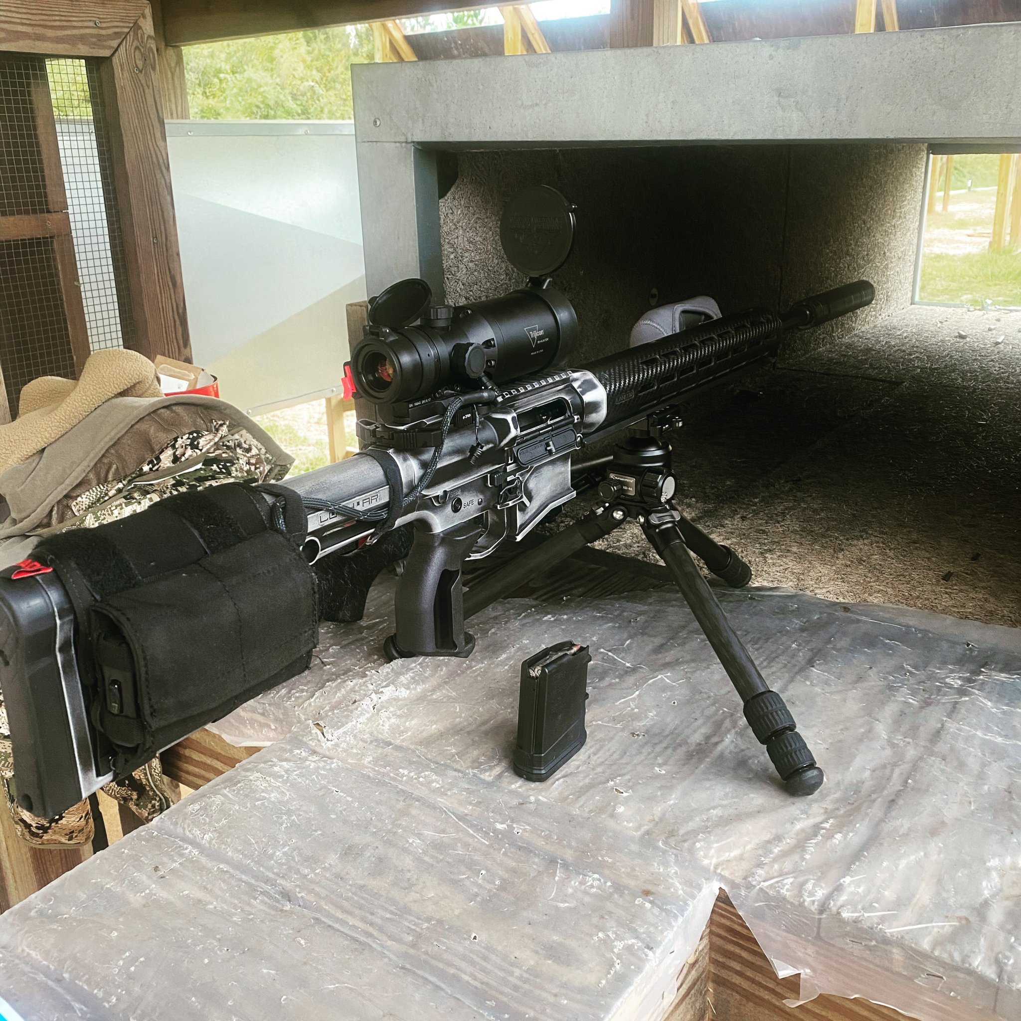

I mostly build rifle back in 2018-19, but the can came in recently.
Shopping black Friday sales and aero blems, I put it together around 800 ish.
Aero M5 upper / lower / hg.
Wilson combat 16" 308 fluted ranger.
JP scs with 3 tungsten.
Toolcraft BCG.
Large 2 stage trigger.
SA AGB.
Nomad L with Ebrake.
4-16x42 Atacr with NF 20moa mount.
I do some swapping around with this rifle.
It's fun to swap in a Moe rifle stock, 1-4 Optic, and yhm 10 oz k can for more of a "battle rig". Comes in under 9 with that guise.
Can't decide which setup I like better- if prices ever come down to 2018-2019 levels I might just wind up with two.
A good compromise would be the standard nomad or dominus with an NXS 2.5-10 or similar, but hey, once you get to where you're shooting she's hard to beat as she sits.

Hi y'all. I'm new here and not sure if this is the right thread to post this but it seemed like it to me. I'm building my dad a LR-308 and was wanting some advice. I've built about 10 AR-15's and a couple AR-9's but I know the large frame is a whole other beast. It's mostly going to be for fun and maybe some white tail hunting. Most shots 50-100 yards. We have a spot where we can reach 200 but it won't be something very often ( the property is a couple hours away). I'd like to build with the ability to reach 500 in case one of us gets some property. Here's what I've got
I have:
Lower = American Made Tactical
Upper = American Made Tactical DPMS low pro
BCG = Fail Zero Nickel Boron
Parts I'm looking at:
LPK = CMMG MK3 kit
Trigger = Rose Armament RA-434
Buffer group = KVP carbine tube with 5.6 oz buffer
Stock = MFT Battlelink (he has it on his 5.56 and wants it the same)
Gas Block = probably Faxon or Aero unless y'all recommend an adjustable
And now for the big question;
For the barrel I was looking at the Faxon 20" heavy fluted (p/n: 10B810R20FHQ-5R-NP3) or the Wilson Combat 20" Super Sniper fluted (p/n: TR-308SSRG20FT10) . Everywhere has been out of stock for at least 8 months. Should I wait until one of these comes available or is there another option for around $350?
Also, I'm going to build one for myself as well with pretty much all the same parts except I think I'm going with the PRS stock and I'm willing to spend between $500-600 for the barrel if the extra money is worth it. I was looking at the X-Caliber barrels but they seem to have mixed reviews on here.
Thanks for all the advice and help

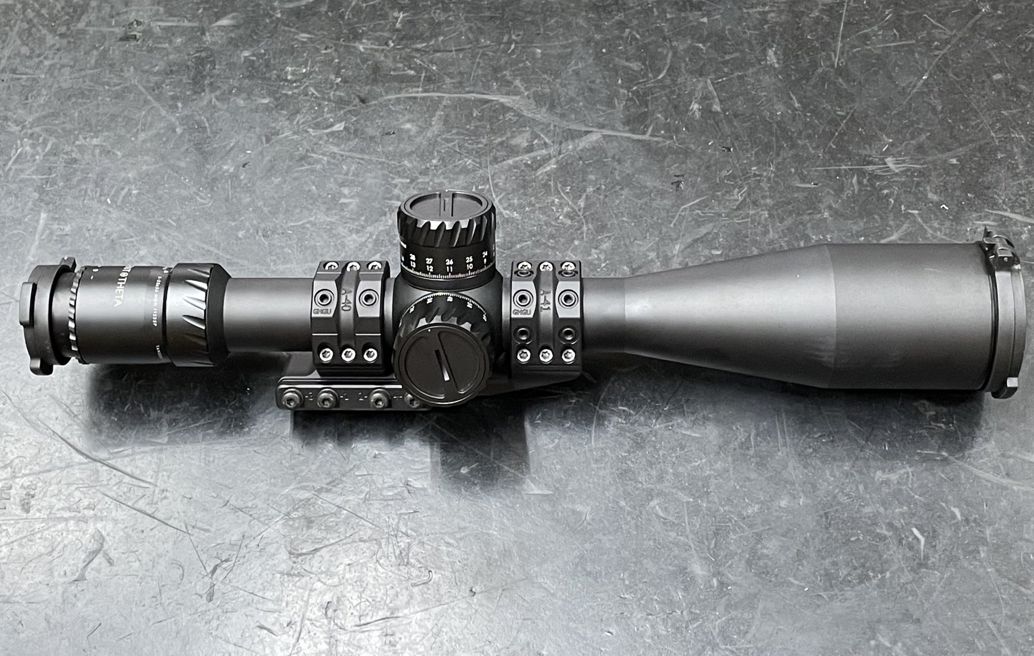

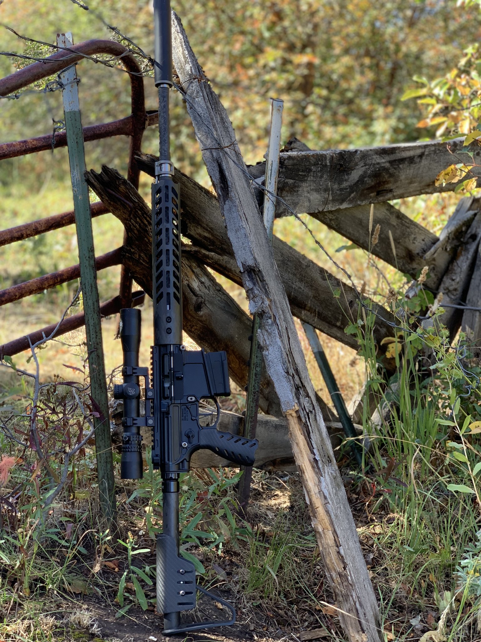

Another big block 6.5 Creedmoor built on a Seekins SP10 Builder's Kit. This one has a 20" Proof Research carbon fiber wrapped barrel with rifle +2 gas system, JP Full Mass Bolt Carrier Group, TriggerTech Adaptable trigger dialed down to 2.5 LB, SLR adjustable gas block, etc. It's set up with an OSS 7.62 brake for future inclusion of an OSS HX-QD 762 TI suppressor. Check out the incredible Tangent Theta 5-25x56 in Spuhr mount that ended up on top of it.
My CT compliant LR308 "Other"
Aero Precision M5E1 Lower
  • Geissele Posi Snap Safety
  • Geissele SSA-E Trigger
  • Geissele Ultra Duty Mag Release Button
  • Geissele Super Stainless Mag Catch
  • KNS Gen JJ Non-Rotating Trigger Pins
  • VSeven S7 Bolt Catch
  • VSeven Titanium Pivot and Takedown Pins
  • JP SCS Buffer System
  • VSeven Titanium Castle Nut
  • POF Endplate
  • GearHead Tailhook Mod2 Buffer / Brace
  • Lancer L7 AWM Magazines
Aero Precision M5E1 Upper
  • Toolcraft 6.5 Creedmoor Double Ejector BCG, Reduced Firing Pin Diameter, Black Nitride Coated
  • POF Roller Cam
  • Radian Talon SD Charging Handle
  • VSeven Ultralight Forward Assist
  • Criterion Hybrid Profile Barrel, 20 inch, 6.5 Creedmoor, Black Nitride, Rifle Length Gas System
  • Aero Precision Gas Tube
  • Seekins Precision Select Adjustable Gas Block
  • Q Cherry Bomb, 7.62
Aero Precision M5E1 15 inch Handguard
  • Magpul Offset MBUS Pro
  • Rugged Ridge Outdoors Gen2 Bipod
  • Magpul VFG
  • Magpul Rail Covers
Optic
  • Nightforce NX8 4-32x50 F2 MOAR-CF2D
  • Geissele SOPMOD Super Precision Scope Mount, 30mm
Suppressor: JK Armament 155PRO MST Form 1
  • Q Plan B, 17-4 Steel
  • Titanium Blast Chamber
  • 2x 17-4 Steel Blast Baffles
  • 7x Titanium Baffles, Clipped
  • Titanium Flash Hider End Cap
  • Cole-Tac HTP Cover
My lightweight hunting 2aArmament 308 build
2aArmament Xanthos receiver set
20” Rifle Gas ProofResearch 308 Barrel
SmokeComposites CF HG
SmokeComposites Pistol Grip
SmokeComposites Fixed Rifle Length Stock
2aArmament Ti GB
2aArmament Ti RBCG
2aArmament Ti Pins
V7 Small Bits
NF 2.5-10 NXS in a NF Mount
JPSCS
SiCo Harvester30
CMC 2.5lb Single Stage
