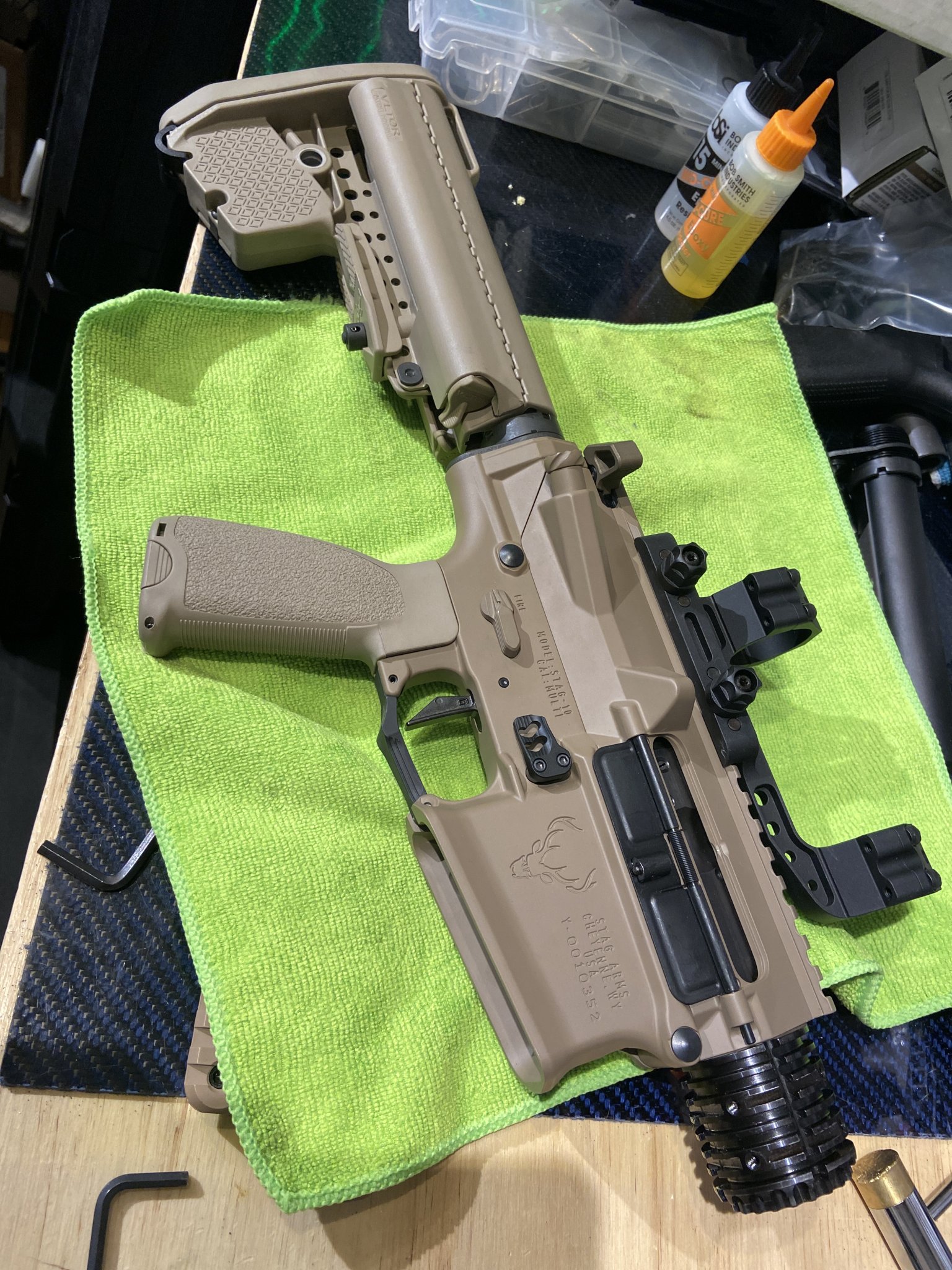

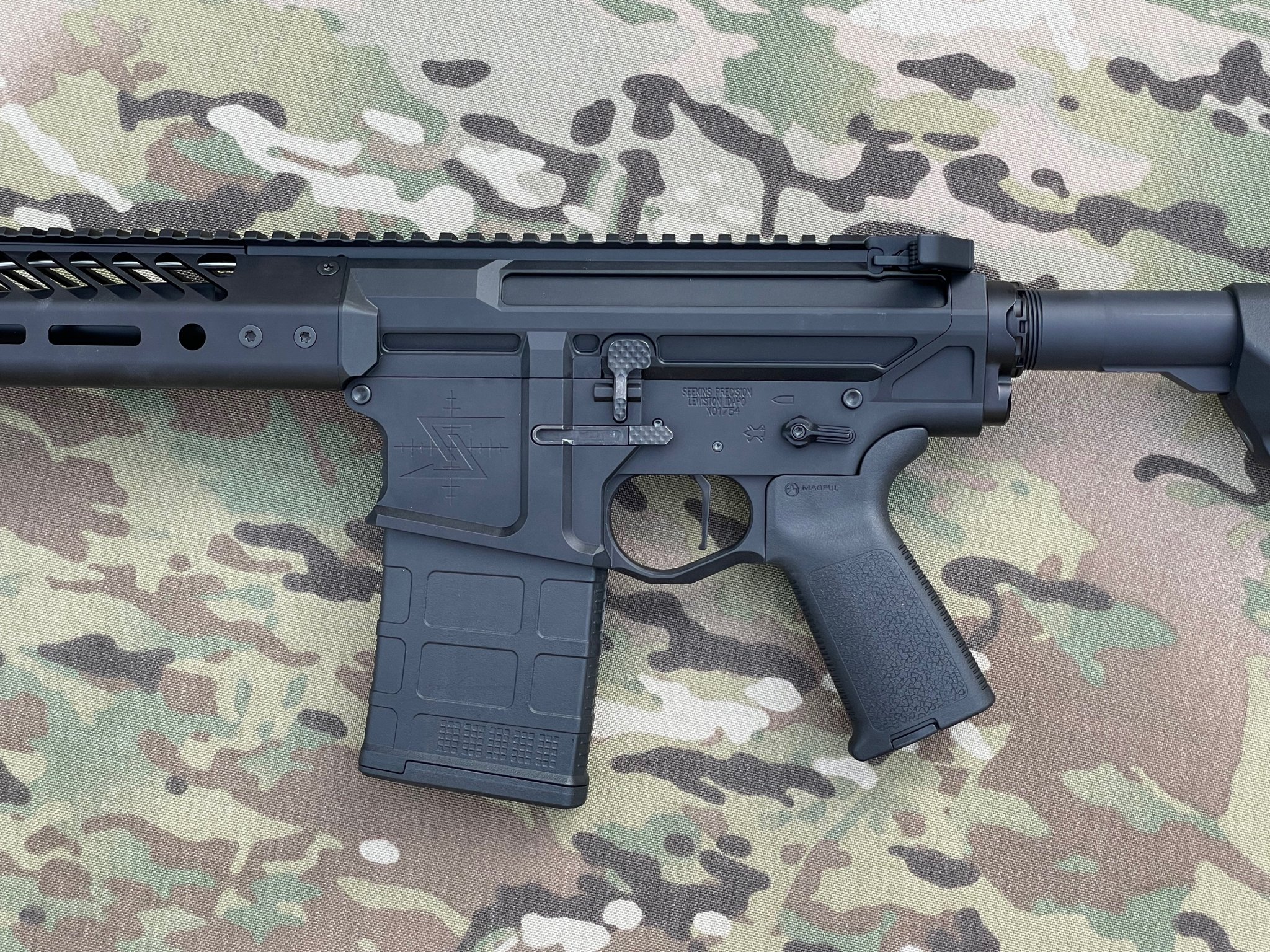

So this is my second .308 build. I wanted to see what a pistol version would do. Weighs in around 7 lbs without optics.
Build sheet:
PSA lower
Gibbz Arms SIde Charger upper
SSA-E trigger
Ballistic Arms barrel
JP Enterprises LMOS (Gosh these are expensive)
SLR
Solo handguard
Superlative Arms adjustable gas block
SBA-3 Brace
5.6oz buffer with heavy spring
Lantac Dragon SIlencerCO ASR (I'm hoping this tames the muzzle flip)
I've limited experience in building these machines but this one flowed together after the AR15 experience and my first 308 build. Does anyone else have a 308 pistol? If anyone has any experience with the Saint Victor 308 (28" OAL) please PM me, I've got some questions.
View attachment 7746629View attachment 7746630View attachment 7746631

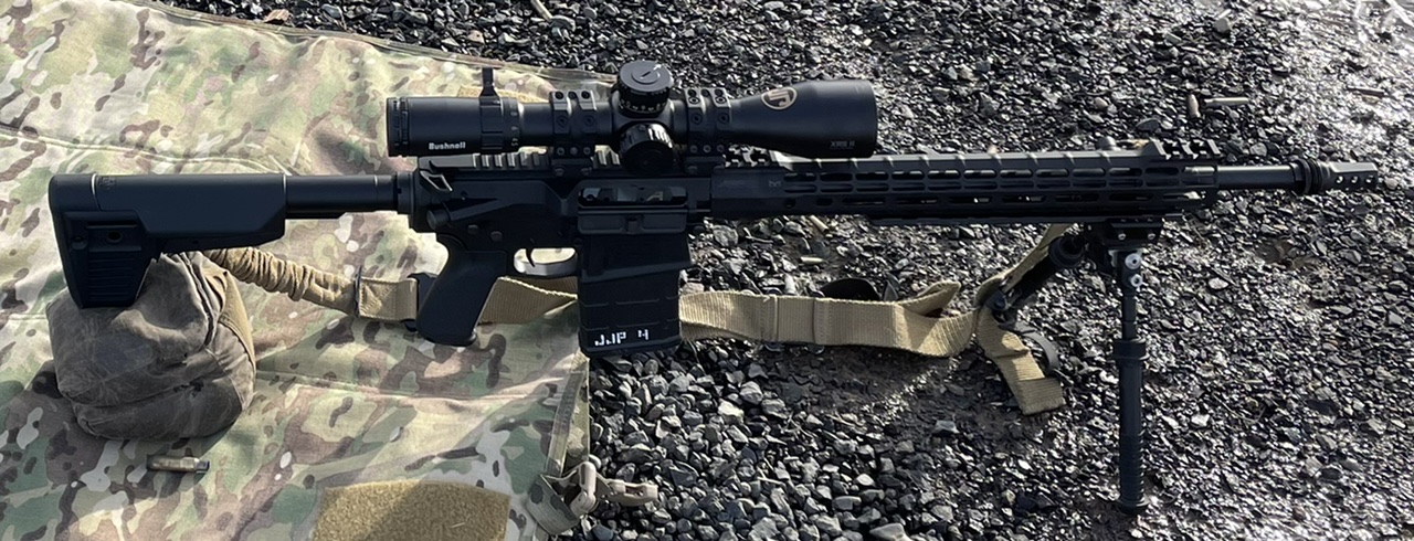

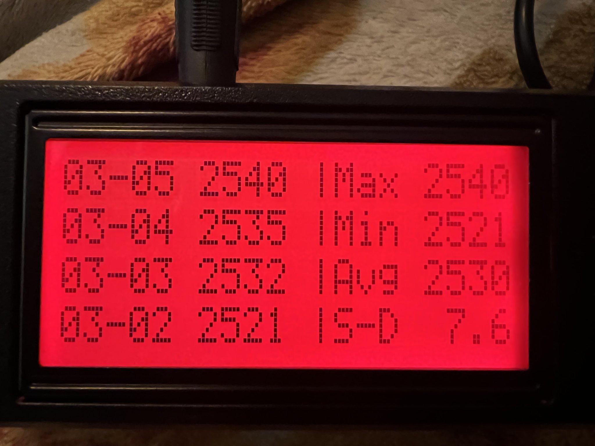

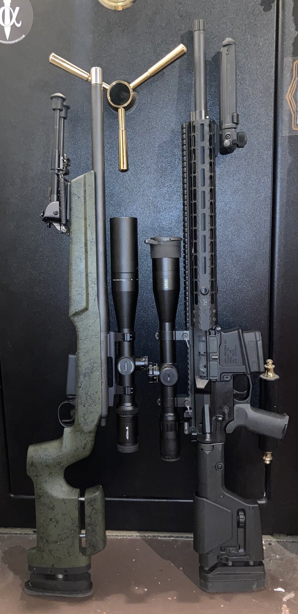

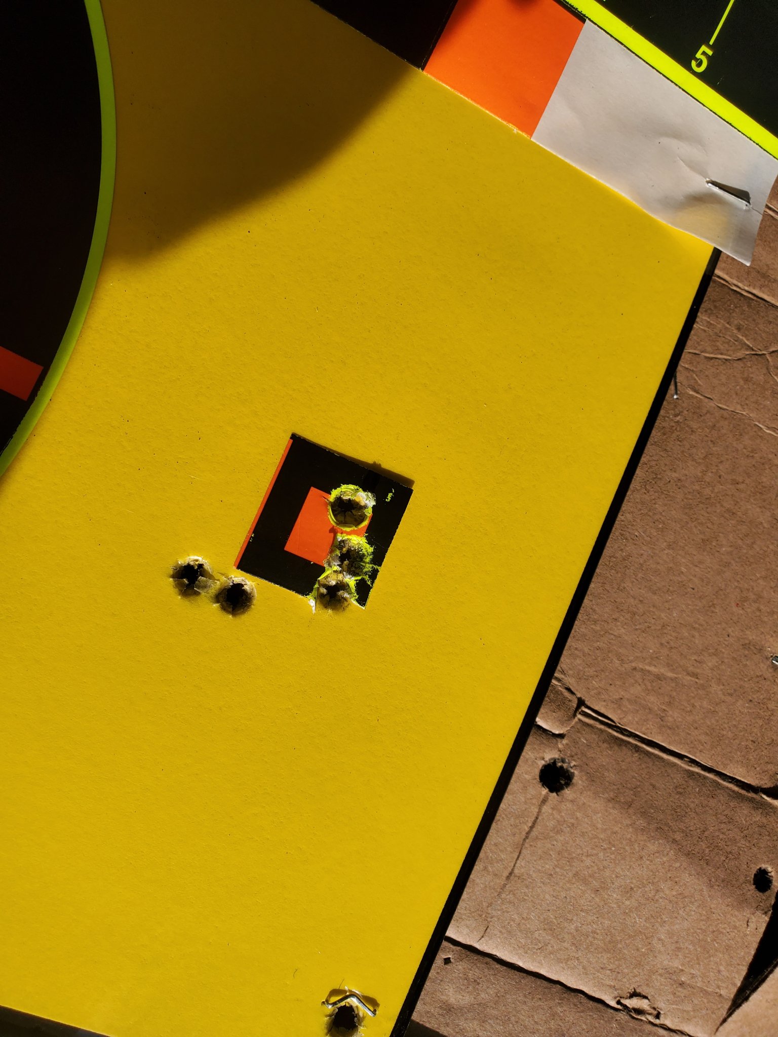

Got out and shot this bad boy today. After getting the gas block adjusted, it shot well. These big boy pistols are quite something to shoot. Exhilarating! I was shooting some 168gr BTHP I loaded up for another semi-auto I have and tore a ragged hole in the target 3 inches wide at 50 yards with this Eotech. I think some lighter 147gr bullets would serve the purpose of this firearm better. Also, I was getting quite the blast of gas in the face from the back of this Gibbz upper. I'll have to shore that up somehow.

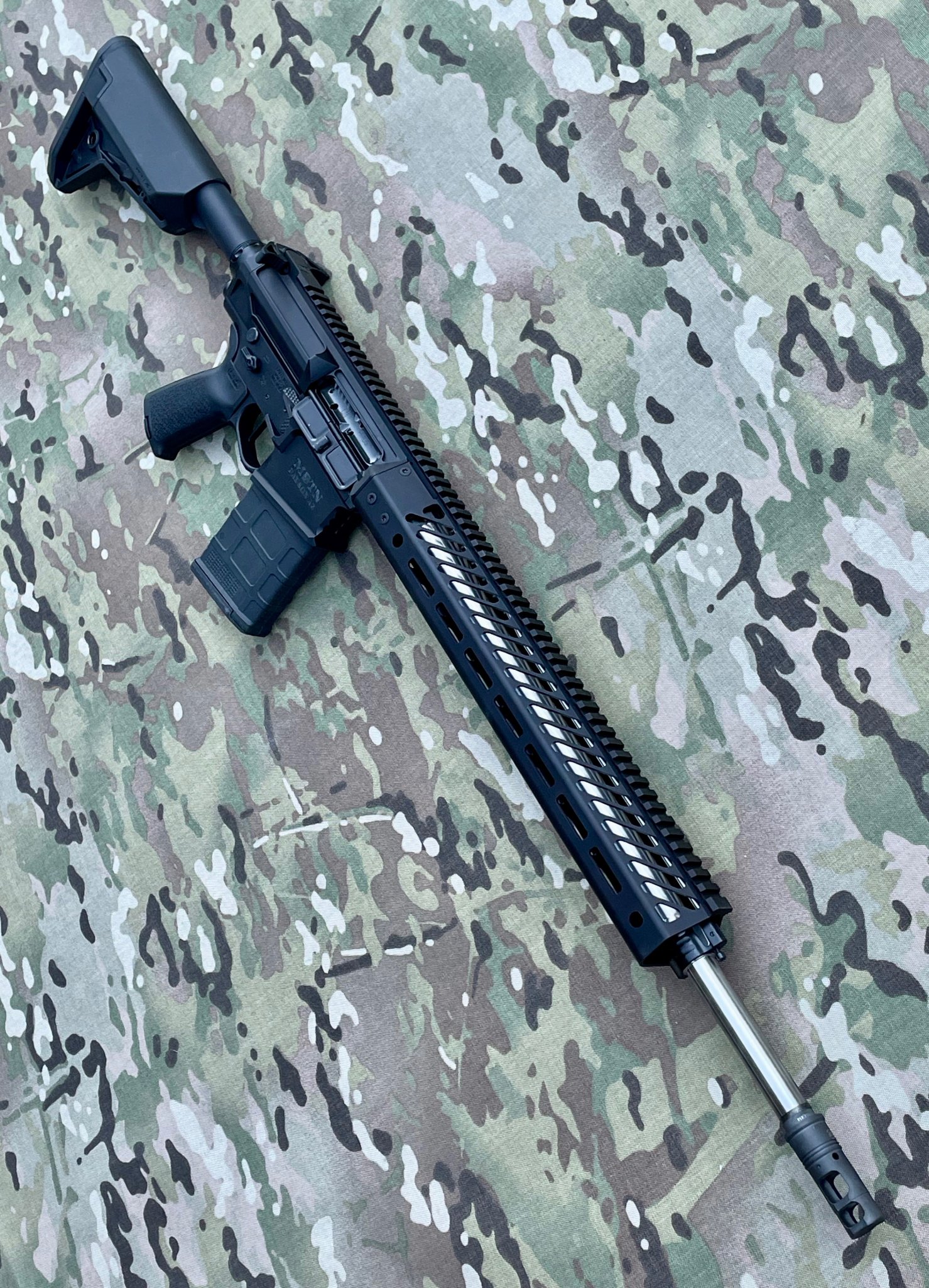

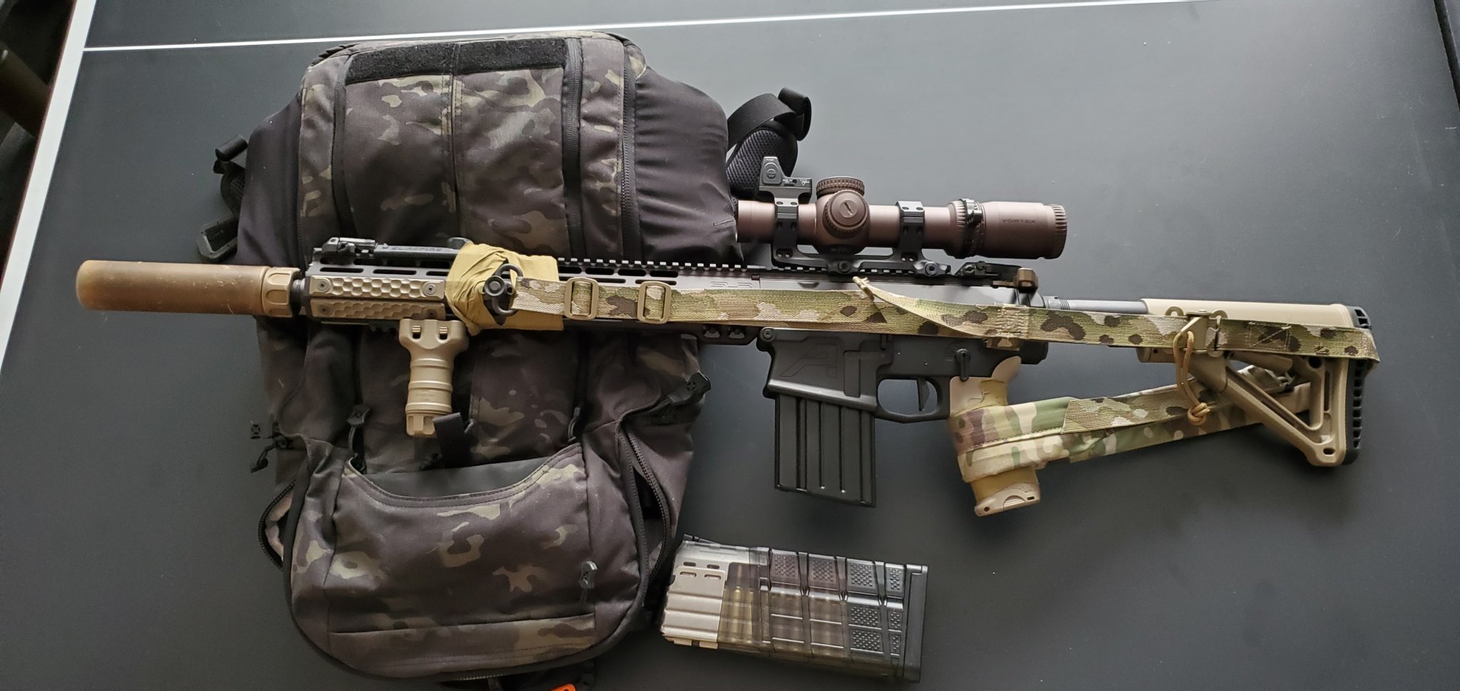

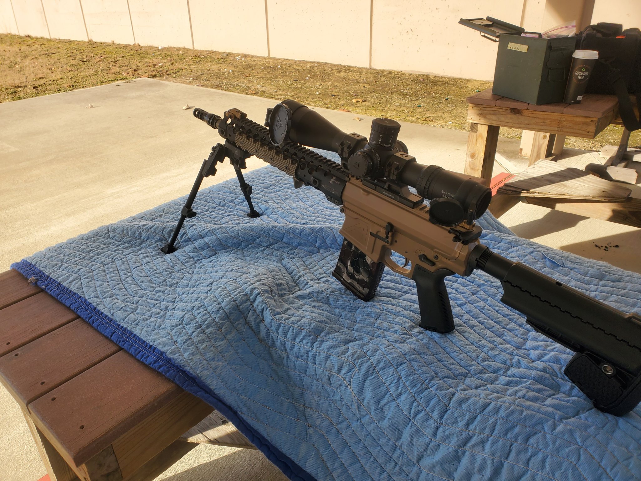

Aero M5E1 Builder’s set
Criterion barrel turned by Craddock
22” 6.5CM with Rifle+2” gas port
Nitrided by WMD
RCA Adjustable Gas Ti BCG
Hiperfire Trigger
Radian Raptor CH
Magpul Bipod, K2+ Grip & PRS3 Stock
4.5-18x LRTSi in Warne QD Rings
Q Full Nelson
Shoots sub-moa all day long with factory Hornady and has zero clean/cold bore offset. I really need to get the scope into a 20-30MOA mount because I run out of elevation dial at about 1000yds.

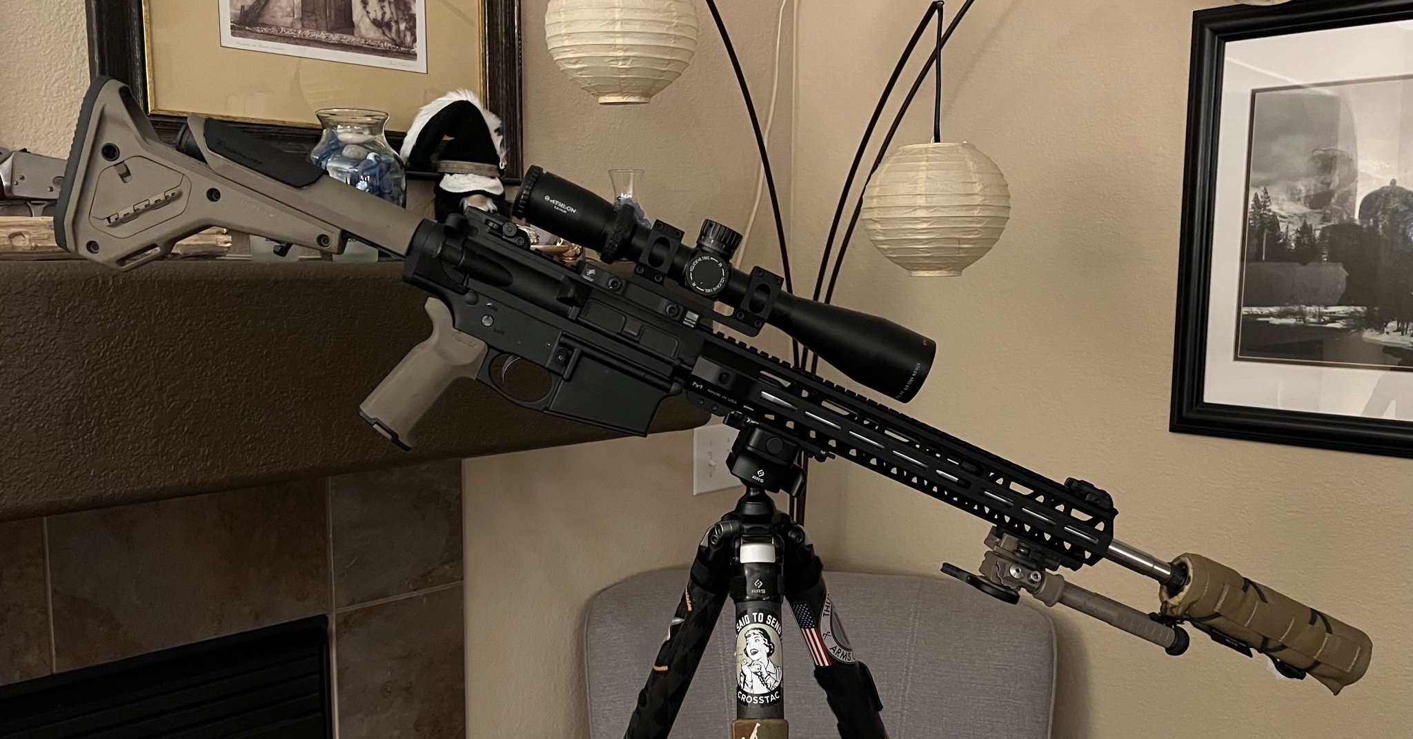

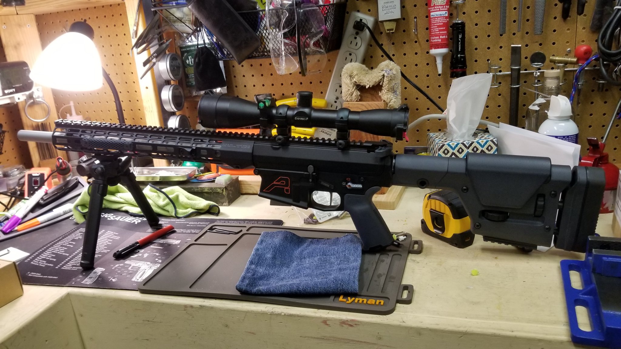

Fun build with aero upper and lower, lpk, bcg, adj gas block, centurion rail, dead air brake, imod stock, kak value line 16" cut down so brake and barrel at 16". Windy and did not have my stand brace so target moved on last 2 at 100yds using suprlus Dag. Pretty happy with it

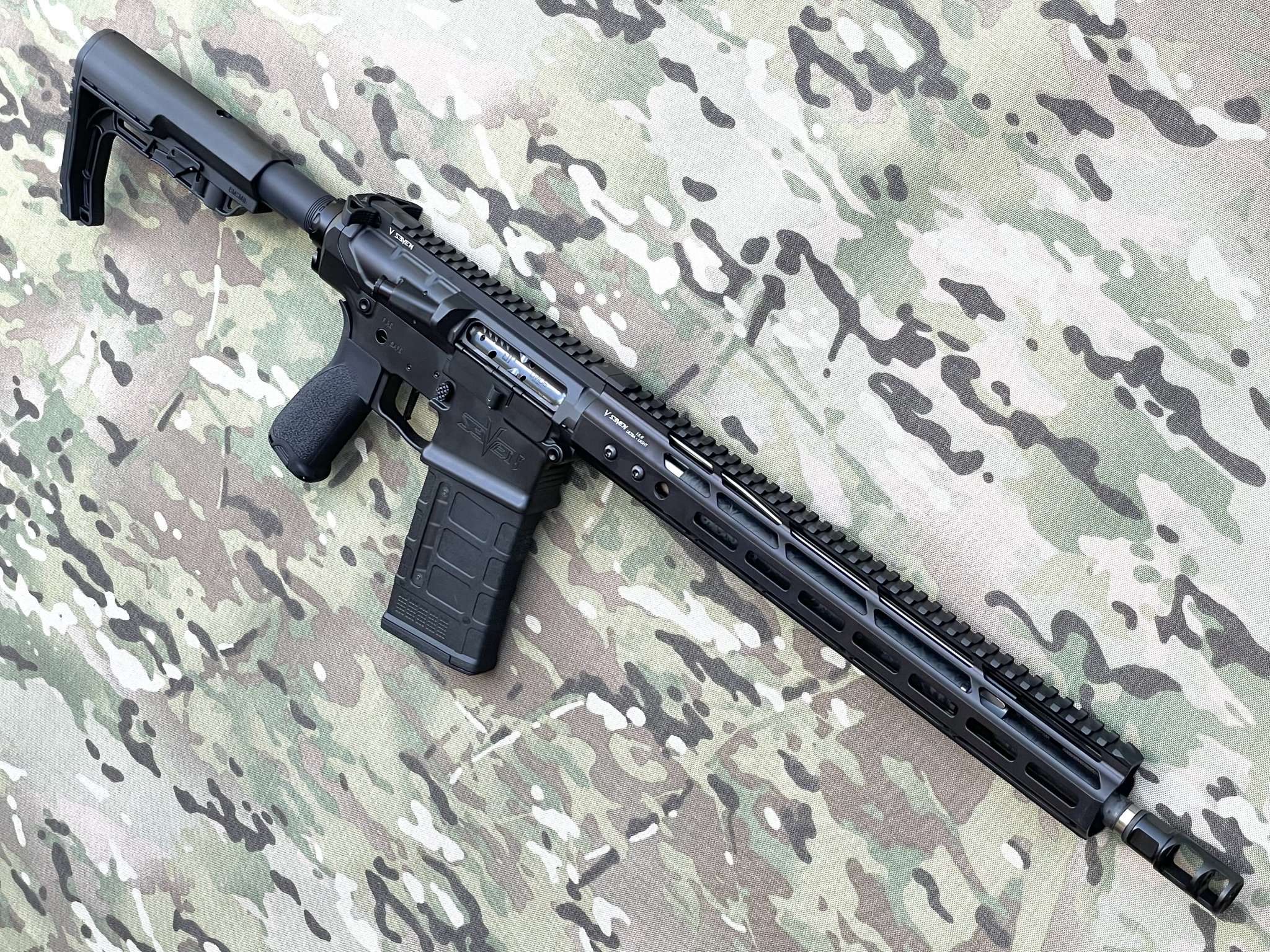

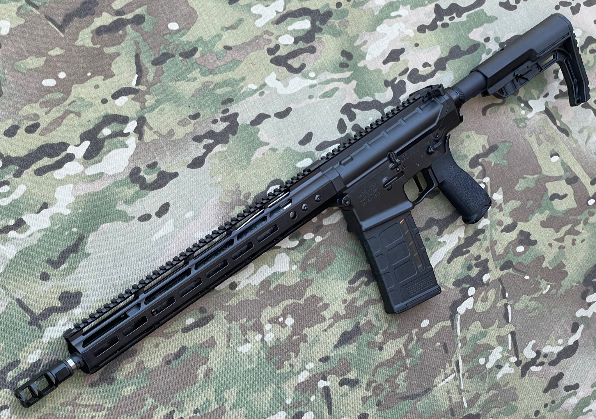

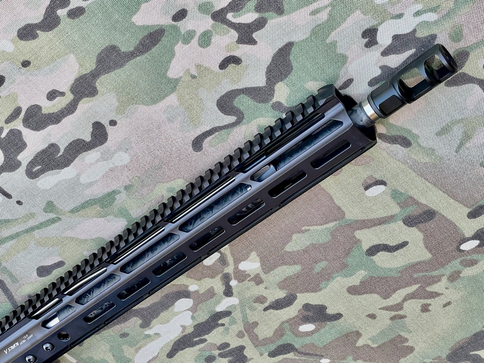

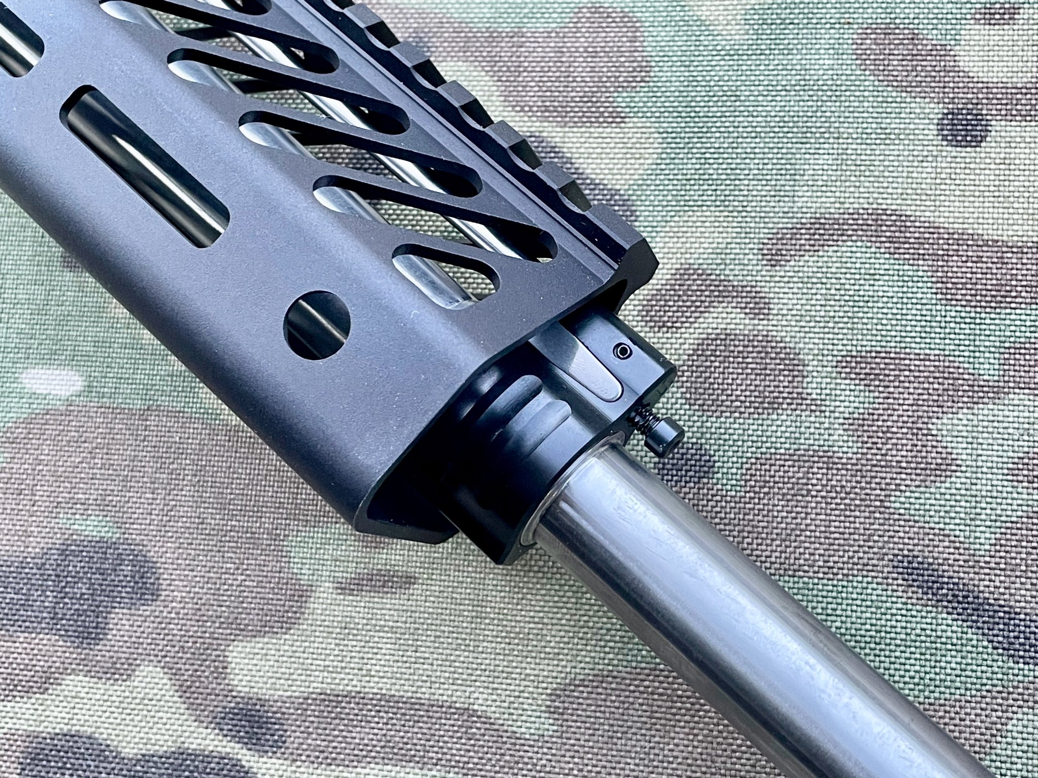

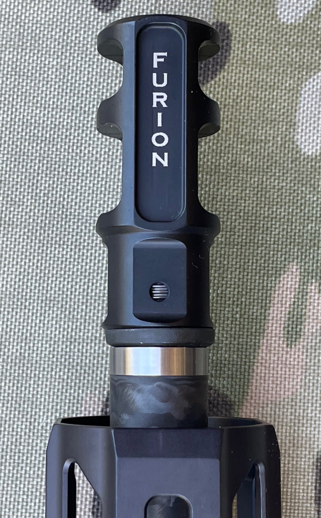

I finally got my 338FED upper mostly assembled, still waiting on WC to send their Intermediate gas tube, it measures 13.25”
Upper build is as follows
2aArmament Xanthos Upper Receiver
16” WC 338FED
RifleSpeed AGB
WC gas tube
SmokeComposites HG
JP VMOS w/ JP HP Bolt
SiCo Hybrid
NF 4-14x40 SHV FFP in NF mount

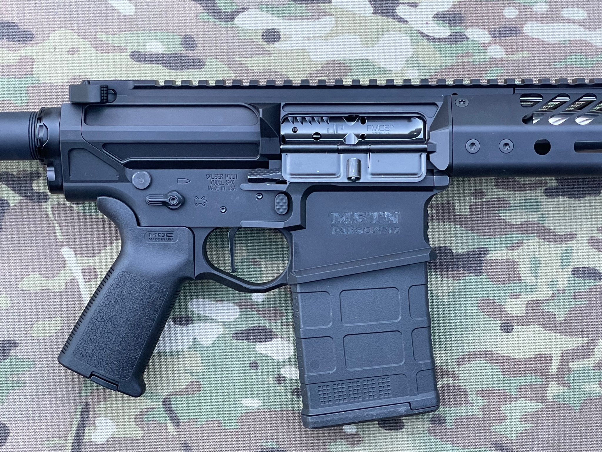

AeroPrecision Enhanced Core

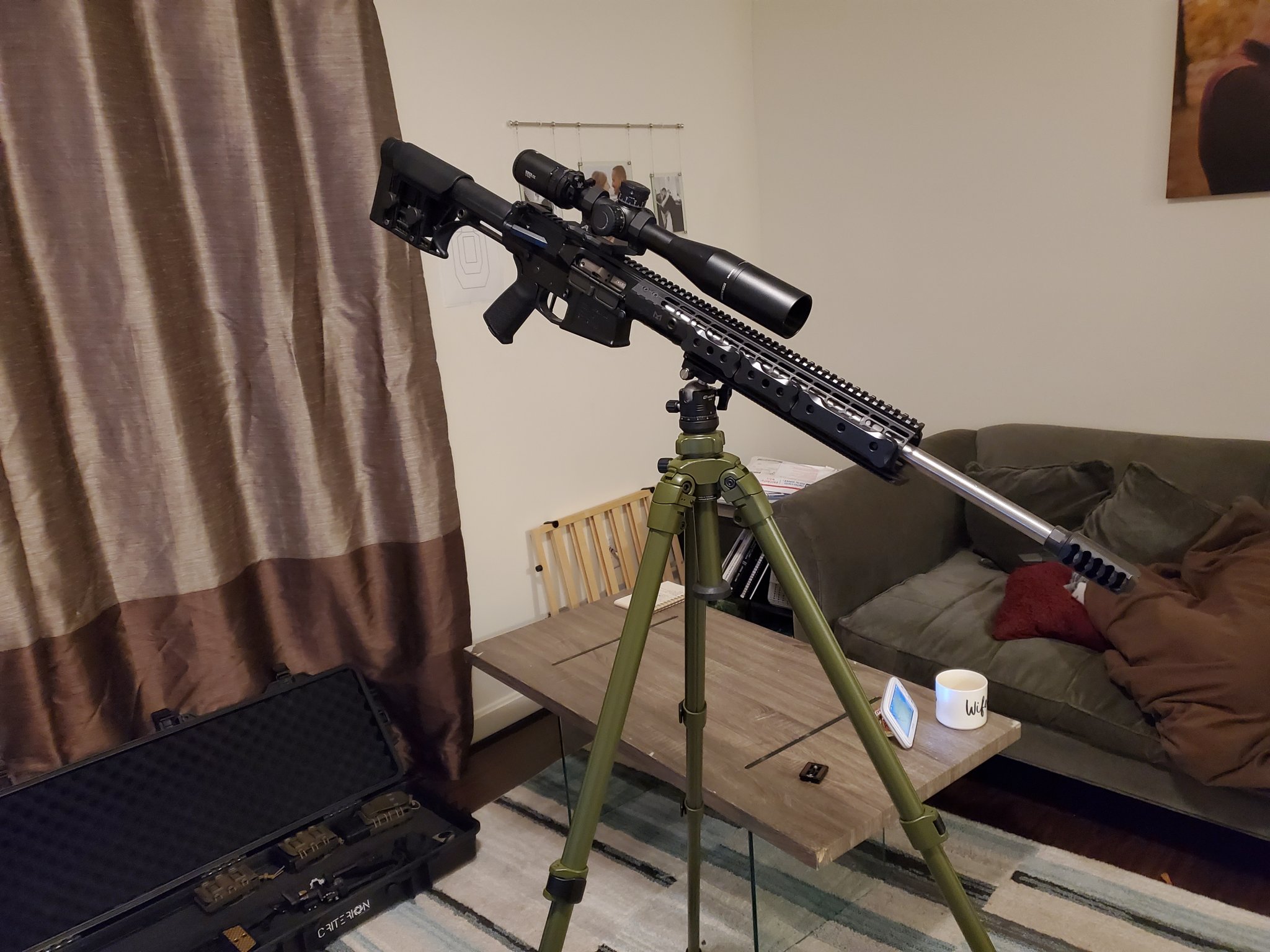

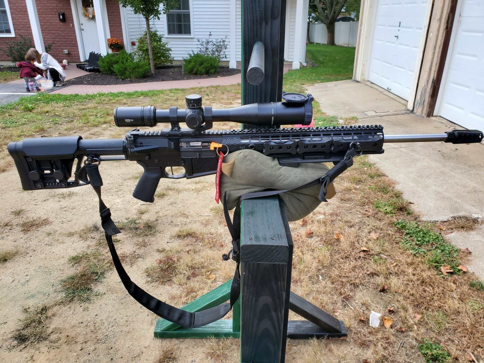

Lantac HP NiB BCG
Criterion. 308 Heavy Hybrid 22"
Triggertech Special 1.5#
APW Raptor Brake
Viper PST2 3-15x
LuthAR Stock
GrayOps CNC Flat Plate and MLOK Wt. Kit

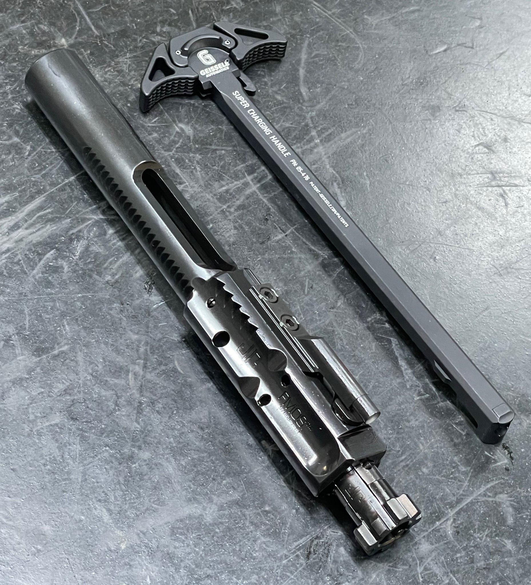

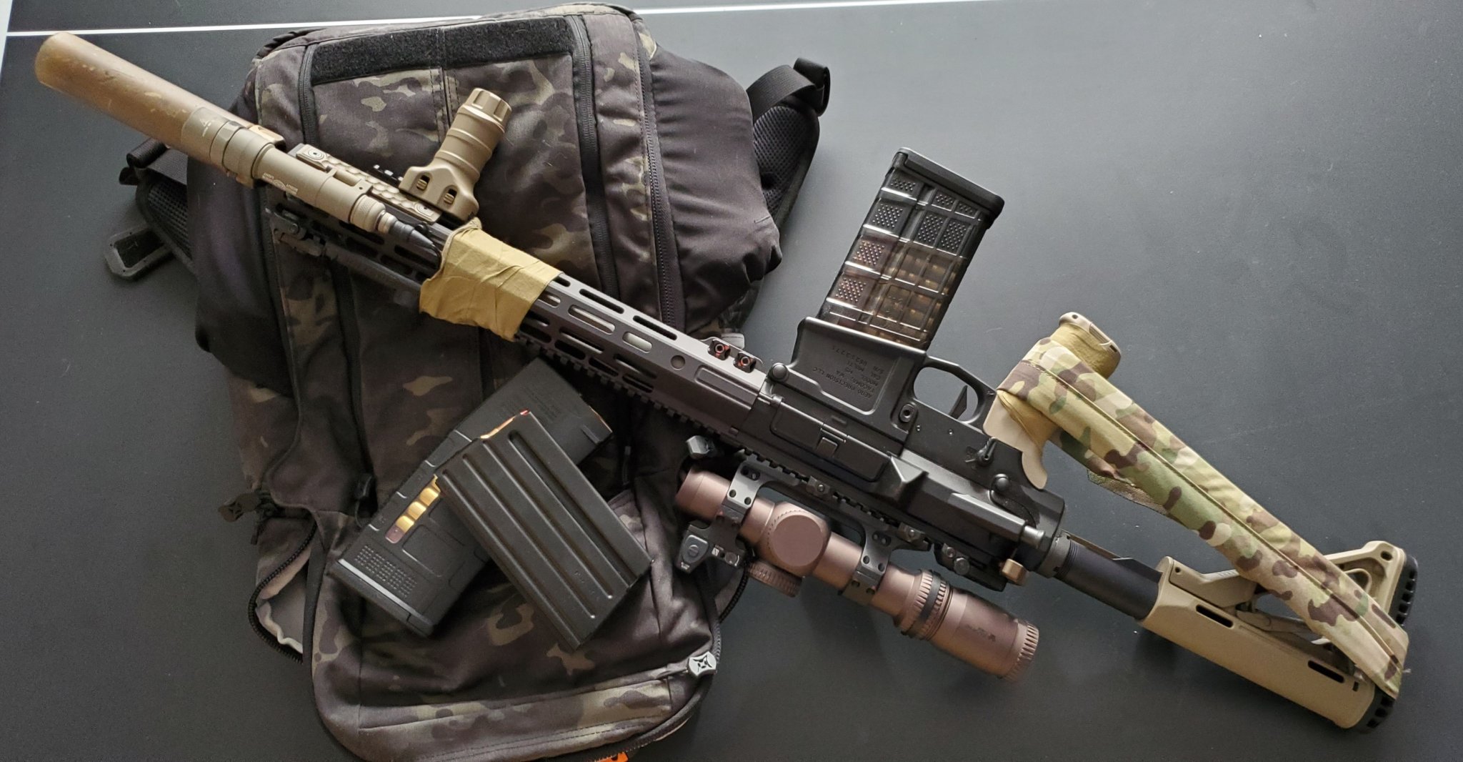

Thought I’d posted this here, but don’t see it.
2A Arms Xanthos receiver set and hand guard
Smoke Composites rifle-length butt stock with extra thick Magpul pad
Tubb’s spring and whatever buffer needed to run with the BCG I’m running at the time
V7 lightweight titanium bolt carrier or the KAK full weight weight carrier
All V7 or 2A ‘guts’…small parts, pins, springs, bolts, selector, etc.
Geissele trigger
Ergo grip
V7 inconel gas tube and Master of Arms adjustable titanium gas block
Faxon pencil-profile 16” barrel chambered in .308; AAC 51T muzzle device (for now)
Griffin offset BUIS
Aero Precision lightweight scope mount
Night Force NXS 1-8 scope

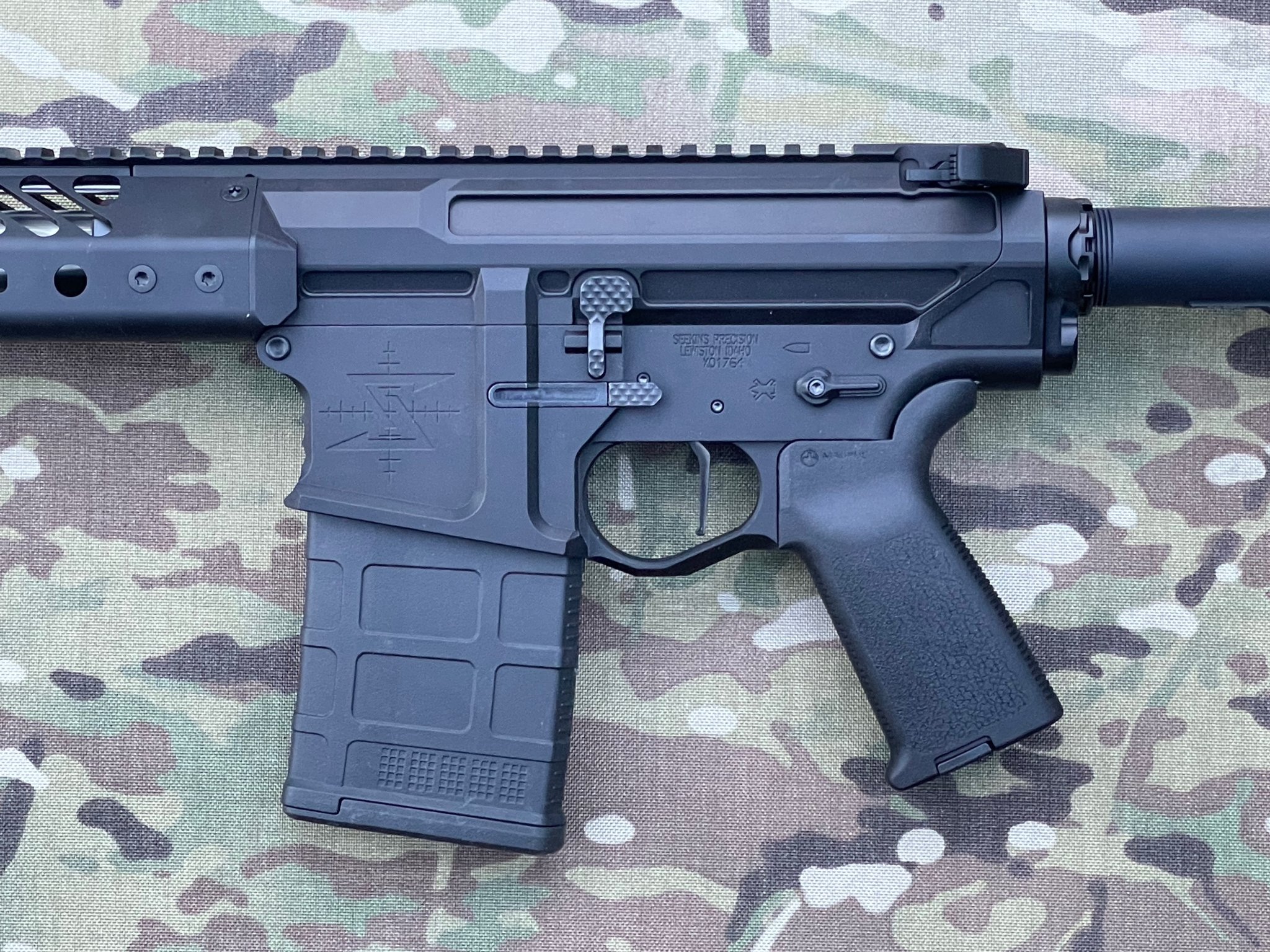

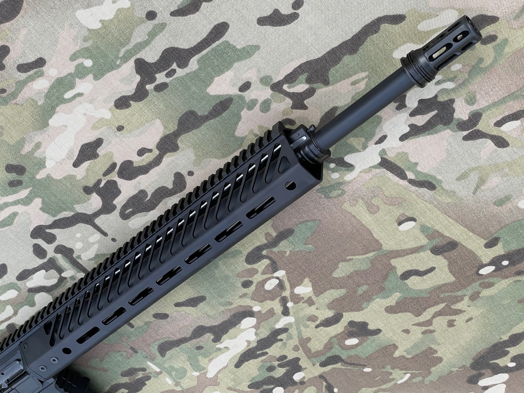

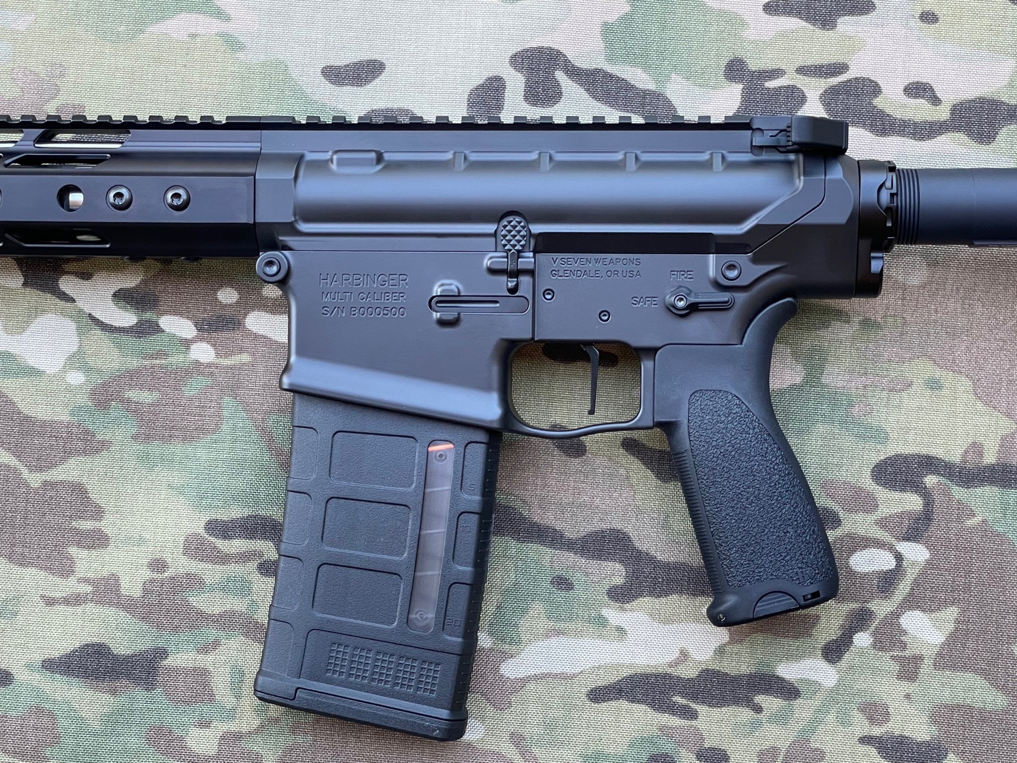

Everything Cerakoted burnt bronze, including several 10 and 25-round mags. Everything but the scope done in a ‘battle worn’ finish…basically a light mist of flat black shot over the burnt bronze and then partially sanded off.
Did the same on this one’s AR15 little brother in 5.56 on a 2A Balios Lite set (the original design). Similar build but with an Aimpoint red dot:
^ older pic with a S&B short dot, also 1-8 zoom, now on a different 5.56 upper. Fun fact, I pre-paid for both those receiver sets, and waited for very specific (and matching) serial #s to come up in the production rotation…had to wait almost a year after I finished the Balios Lite build for the Xanthos set.
Shoots nice once I got the new NF scope dialed in (final POA was the ‘8‘ above the x ring):
And minimal POI shift with a different can. Different target here of course, POA was the vertical hash mark between the 8 and the 7:

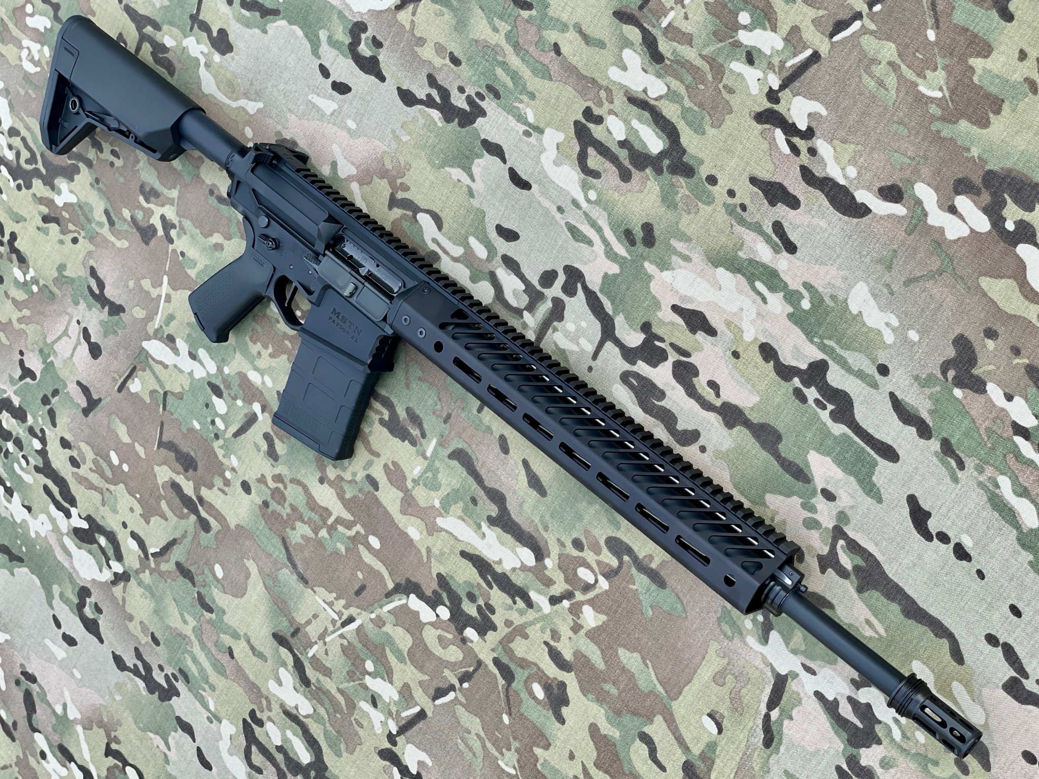

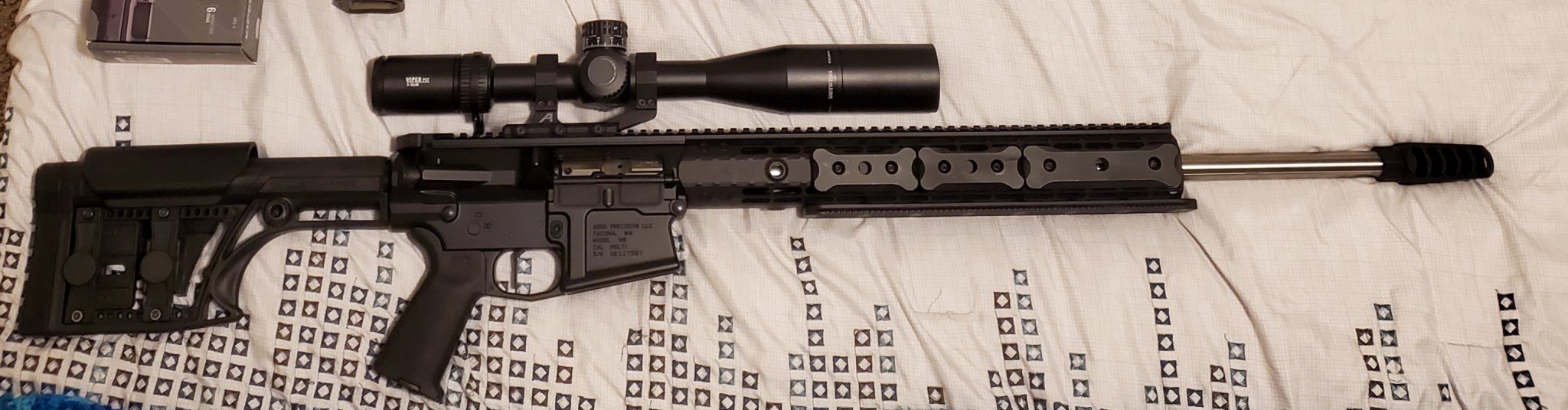

Here’s my AR10 I’m building in 6.5 creedmoor
Waiting on some parts to get cerakoted to match.
Stag set
Geissele trigger
JP HP308 bolt
JP silent buffer
VLTOR stock
Rainer arms match 22” + 2 gas system barrel
Superlative gas block
Sgt Arms arca rail/ handguard

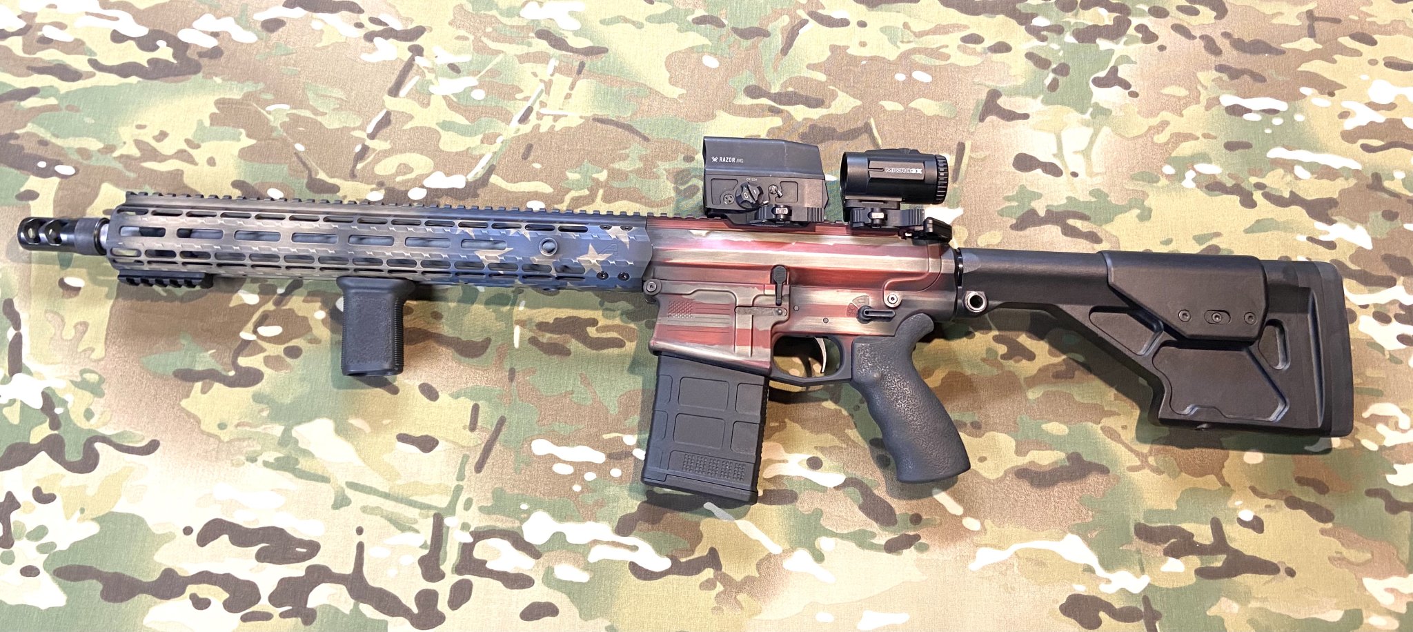

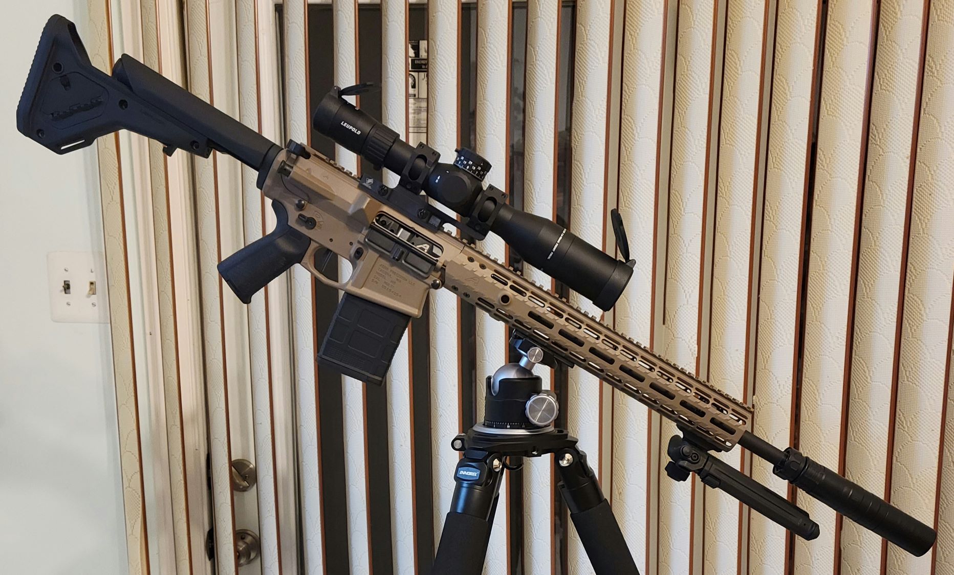

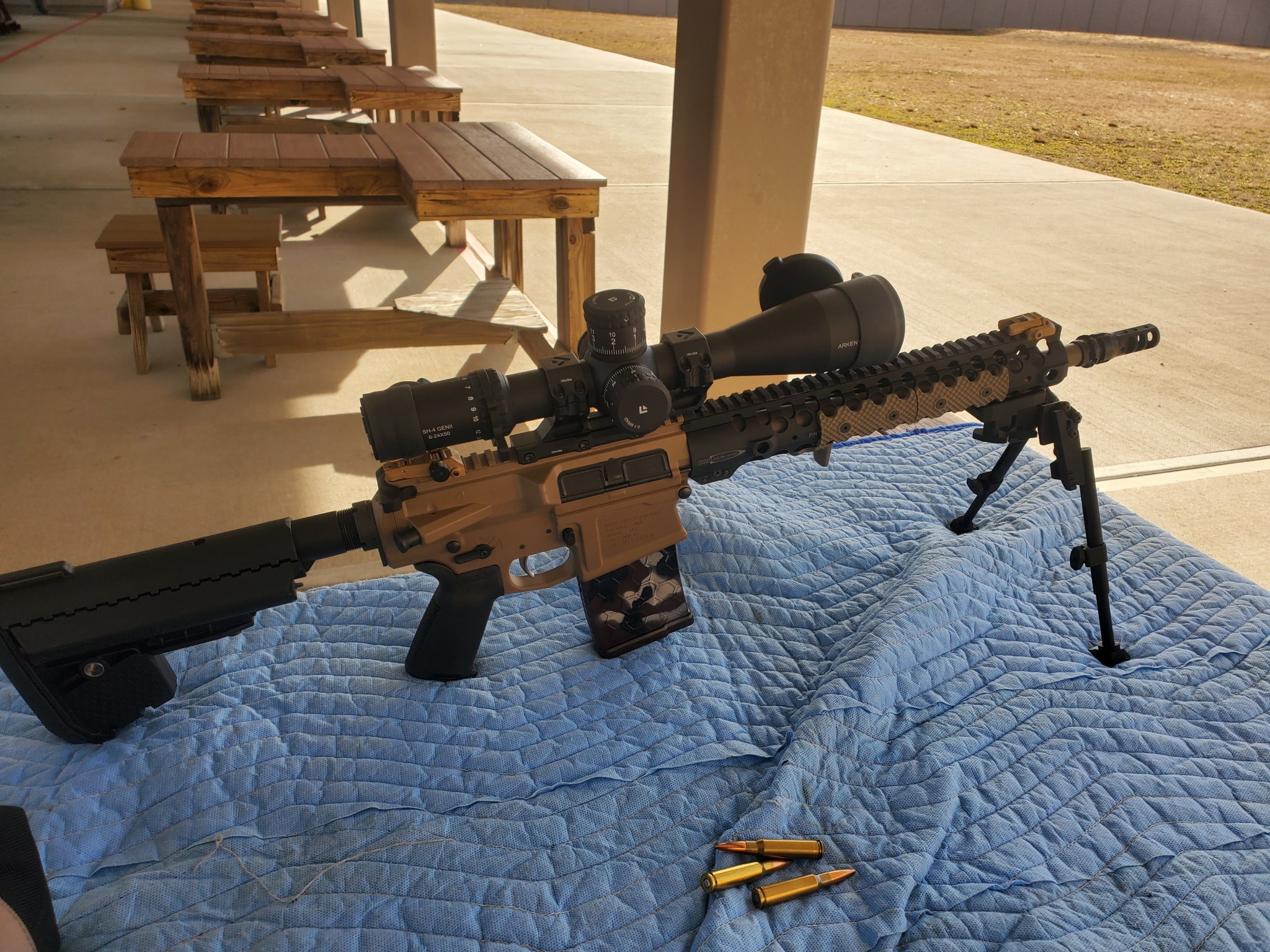

Aero M5 Upper/Lower
Criterion 6.5CM barrel cut by Craddock Precision
SLR Rifleworks M-lok Handguard and adjustable gas block
Surefire SOCOM 762 Mini
Vortex Gen III Razor 1x10 in a 1.54 Reptilia mount and an RMR at 12 oclock.
Geissele SDC, Battle Arms ambi selector, Radian 7.62 CH, SF M640DF, Tango Down Sstubby vert grip, and BCM pistol Grip. VLTOR A5 buffer setup.
How does it shoot?
I havent zeroed it with the Razor yet but I took it out when I first got it finished up and put 100ish rounds through it. It was amazing. It turned out to be really soft shooting, extraction/ejection pattern was perfect and its surprisingly quiet with the SOCOM Mini. Once my other four Cans clear the mini will probably just stay on this one. Just a really solid "battle rifle" setup. I have a buddy that has a chrono that i want to get some data with if we can ever make the time.

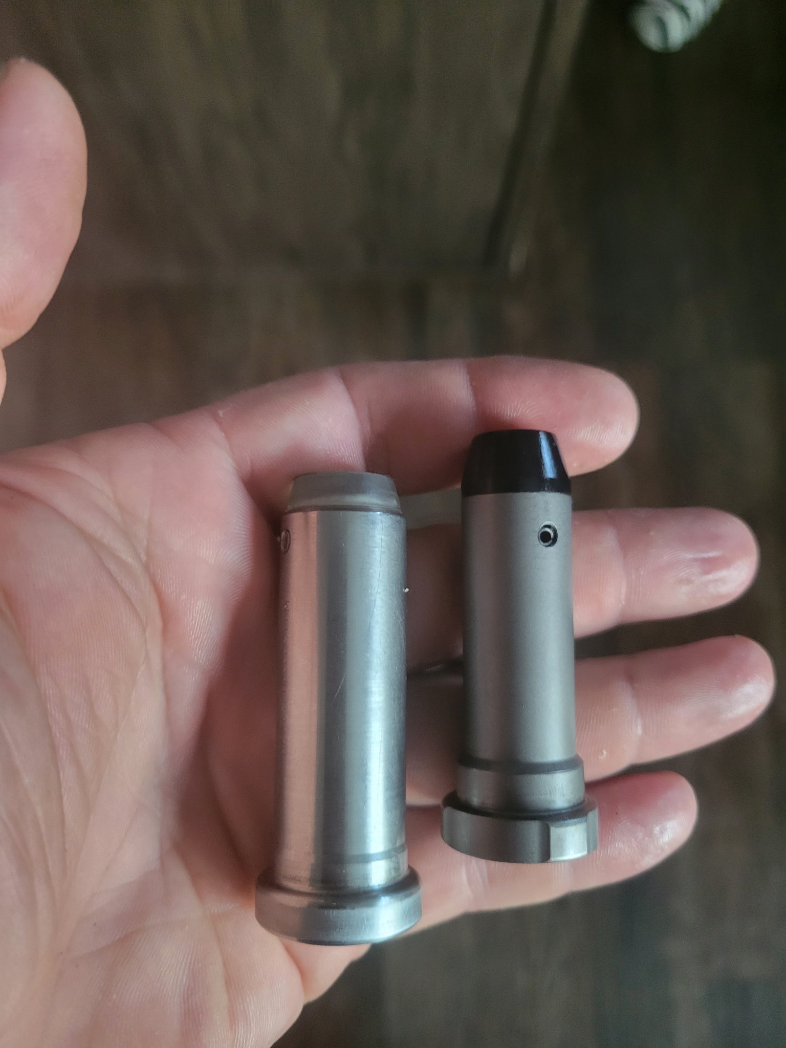

Question, the armalite ar10 carbine buffer tube that measures 8" uses the standard length ar buffers correct ?
I've got a pws mk216 in 308 that's been horribly over gassed with a can since day one. Ran like a top without. Shot them an email detailing my experiences and was told well that's just how our guns run. Okay. Bs answer but whatever.
Got the heaviest shorty carbine buffer I could find (heavybuffers.com) and a stiffer sprung from the same place and still no joy. All it succeeded in doing was making it kick like a mule and put even more gas in my face. Heavy buffer stock spring seemed to work best.
Fast forward several years and a few hundred rounds later and the gun begins to have problems. Skipping over rounds in the mag, lite primer strikes and it's just beating itself up.
Another email to pws detailing my experience with my initial contact with pws and my current issues with the gun and I got a completely different response from them. They were very apologetic about the first contact experience and very helpful with getting issues resolved this time. They sent me a label and I sent them the gun.
THREE MONTHS LATER! I finally get my gun back. Best I could tell all they did was change the gas block. It went from a four position to the new three. And it shot like crap.
It was always a solid .75-1 moa gun, better on occasion. Now we're deep in 2 moa territory. Started playing with the buffer/spring setups again and got it back down to about 1 moa. Still a 1:30-2:00 ejection pattern and still a pile of gas in the face suppressed. But, to their credit it function with all but one of six loads I shot. Federal premium with the berger 168 hybrid hunter was the only one that caused a malfunction. Ammo is way hot for a gasser.
Through a little more research I ordered a Tubbs flatwire spring and installed it with the xh carbine buffer. Ejection is now 2:00-2:30 and it shoots soft. Like a pws should. But it still needs just a little more.
So I'm wondering if I go to the armalite 8" carbine tube, with the slightly longer buffer, and machine my own heavy buffer and add a third weight inside if that could get me to the 3:00-3:30 ejection.
Both the xh and standard buffers in my rifle have two weights that weigh exactly the same and are identical dimensions. But the xh is made of stainless and is bigger bodied. I actually had to turn some off the od on the xh for the flatwire spring to work freely and fit inside the tube.
If I don't go the buffer route I'm considering machining some kind of orfice to go in the gas block between the gas plug and the piston. If there's room. I've had it apart but can't remember what it had for extra space.

ArmaLite does use the A5 length RE, but it's not an anti-tilt design. 2A Armament (and others) has an A5 length anti-tilt RE. Personally, I would try the LMT LM308A9 or the ArmaLite EA1095 spring with the A5 length RE. To clarify, you can't run a 3.25" long carbine buffer in a 7" inside depth carbine RE. I'm assuming you're running at setting 3 on the gas.

Yes #3 on the gas. In stock trim it would run just right at 3 with no can. Haven't shot it without the can with the flatwire xh buffer setup.

For resizing the gas port/passage, BRT used to sell the CustomTune kit. You can do a DIY version, but I'm not sure if it would work with a PWS piston. There was a guy, Randall at AR15barrels, that did the CustomTune method in the barrels gas port. I'm not sure how it turned out and it was a long time ago.
