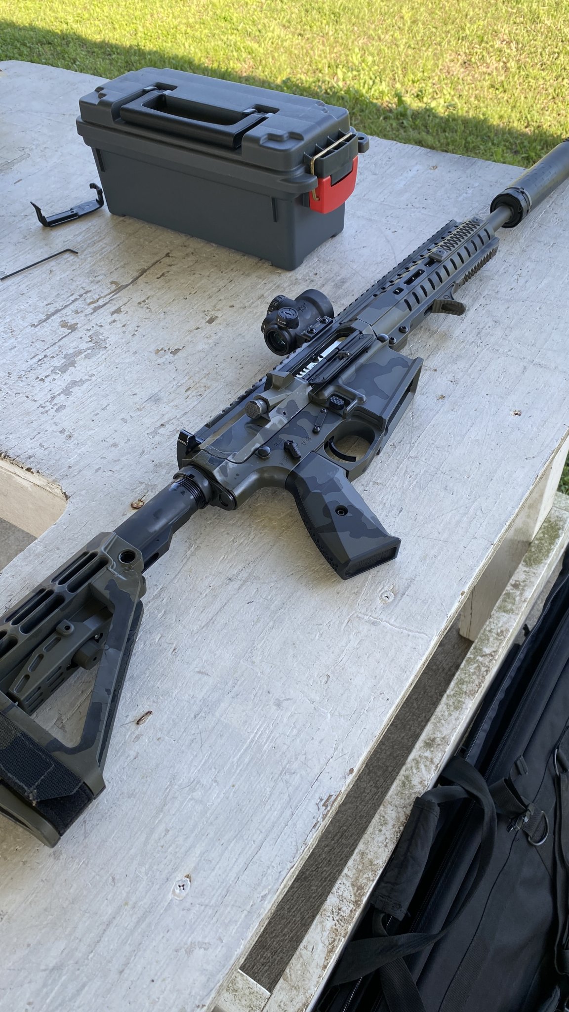

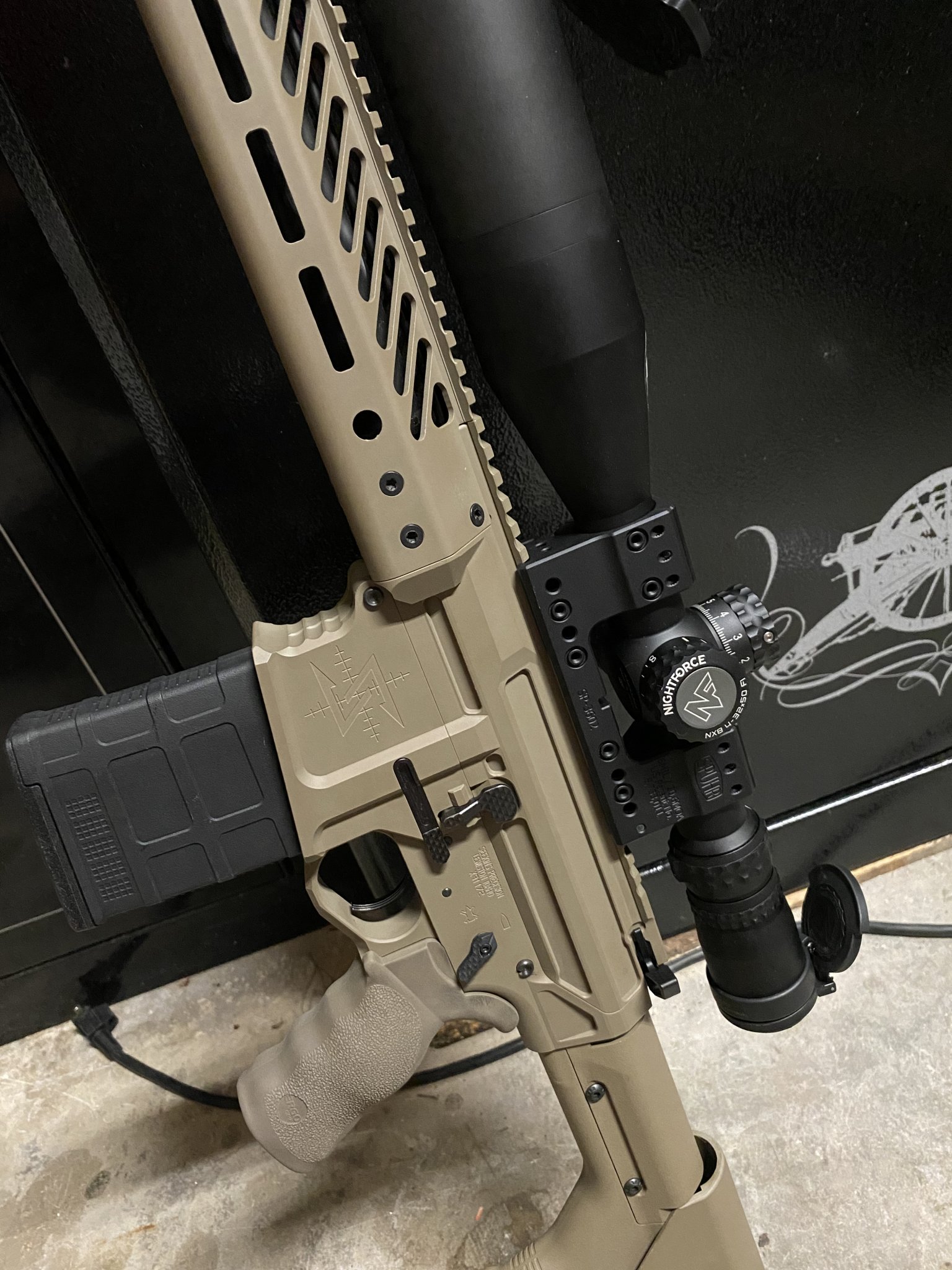

Nothing fancy. Just an older Sig 716 patrol in 7.62x51 that I customized a a few years ago.
One of the early elite Cerakote colors, magpul furniture and TT trigger with atlas bipod. Hanging off the barrel is a Sandman S.

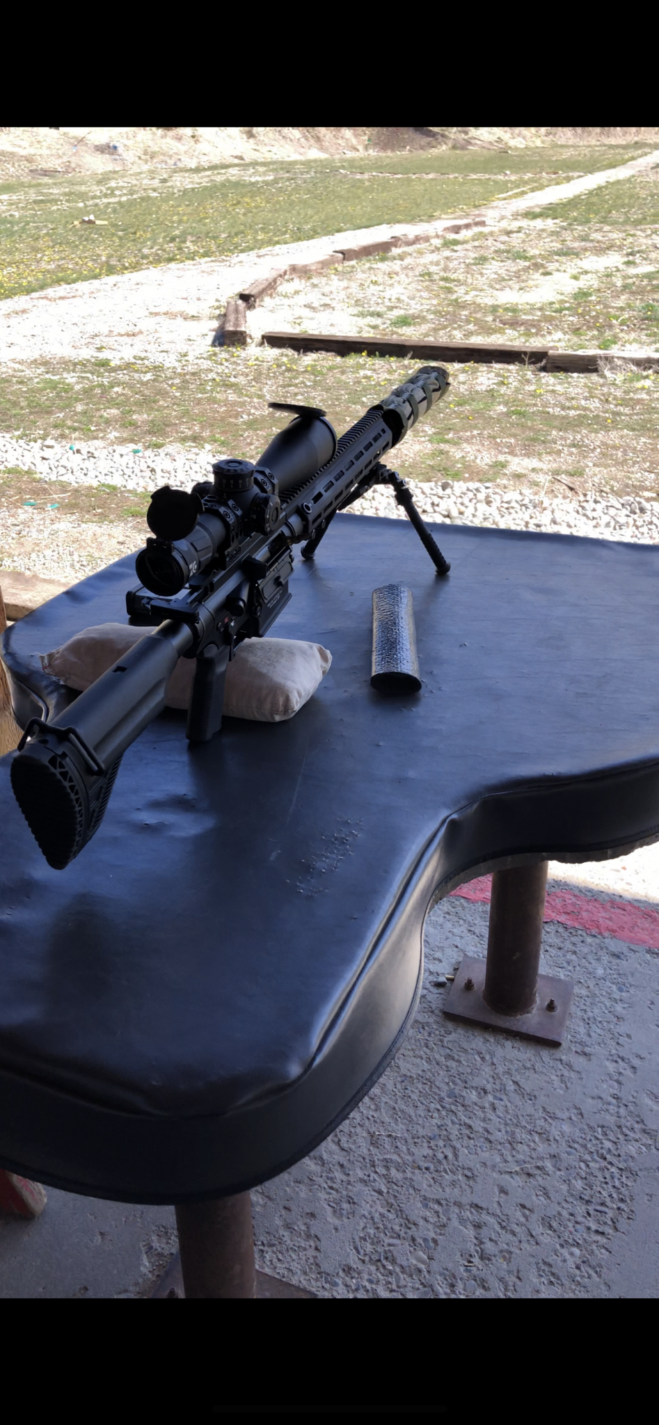

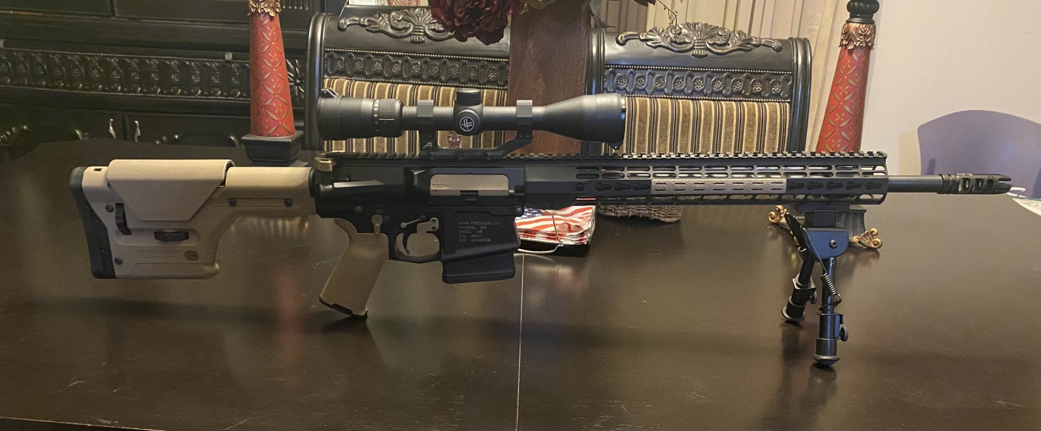

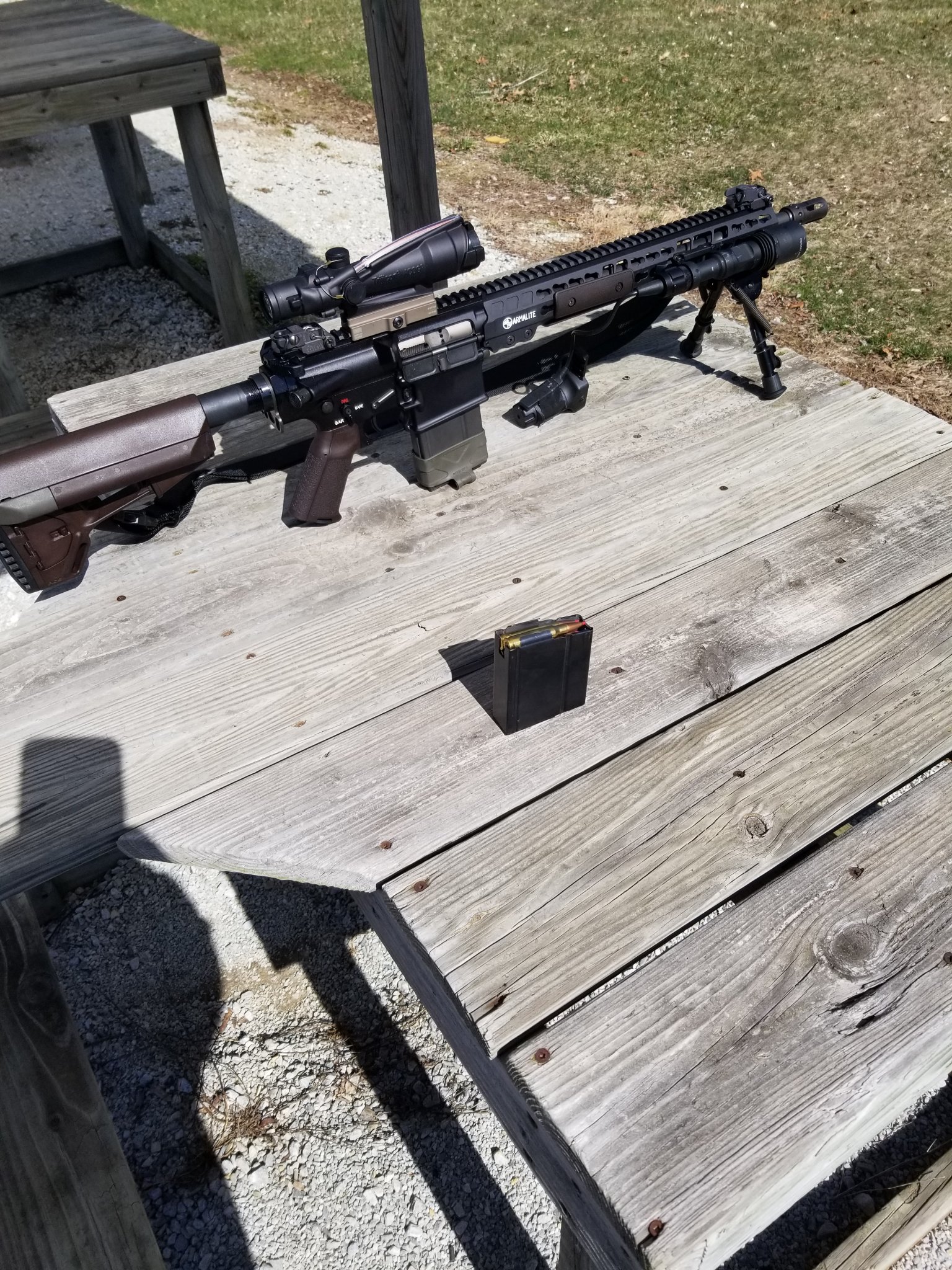

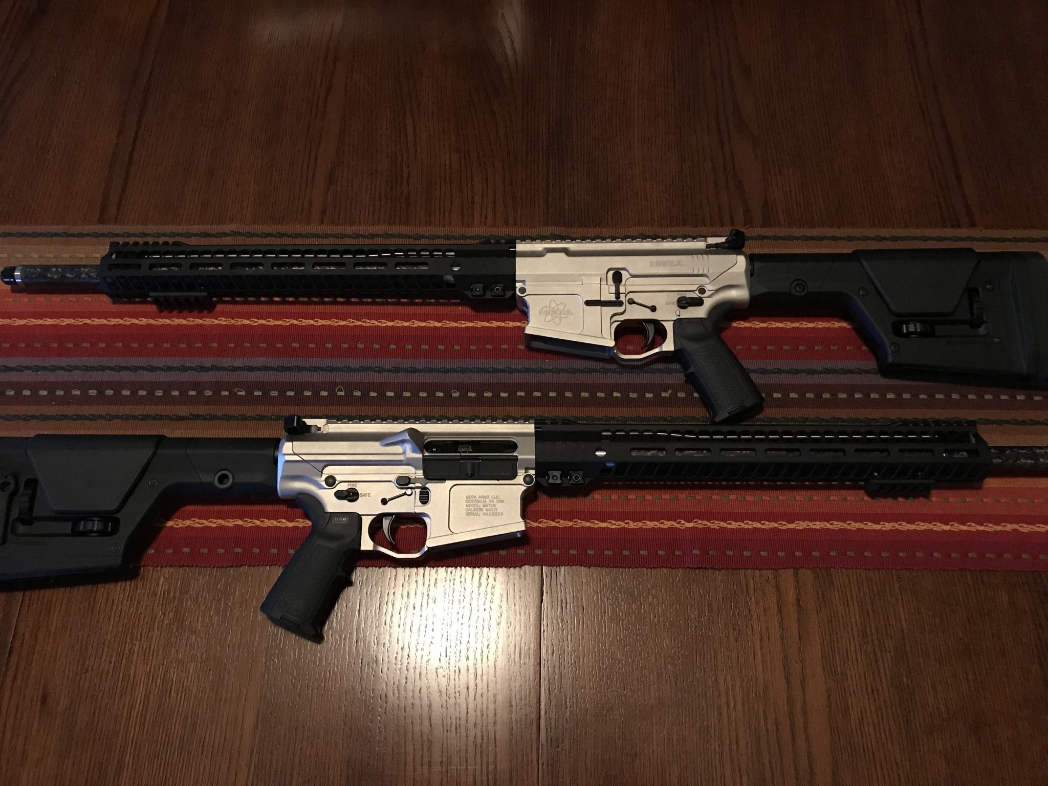

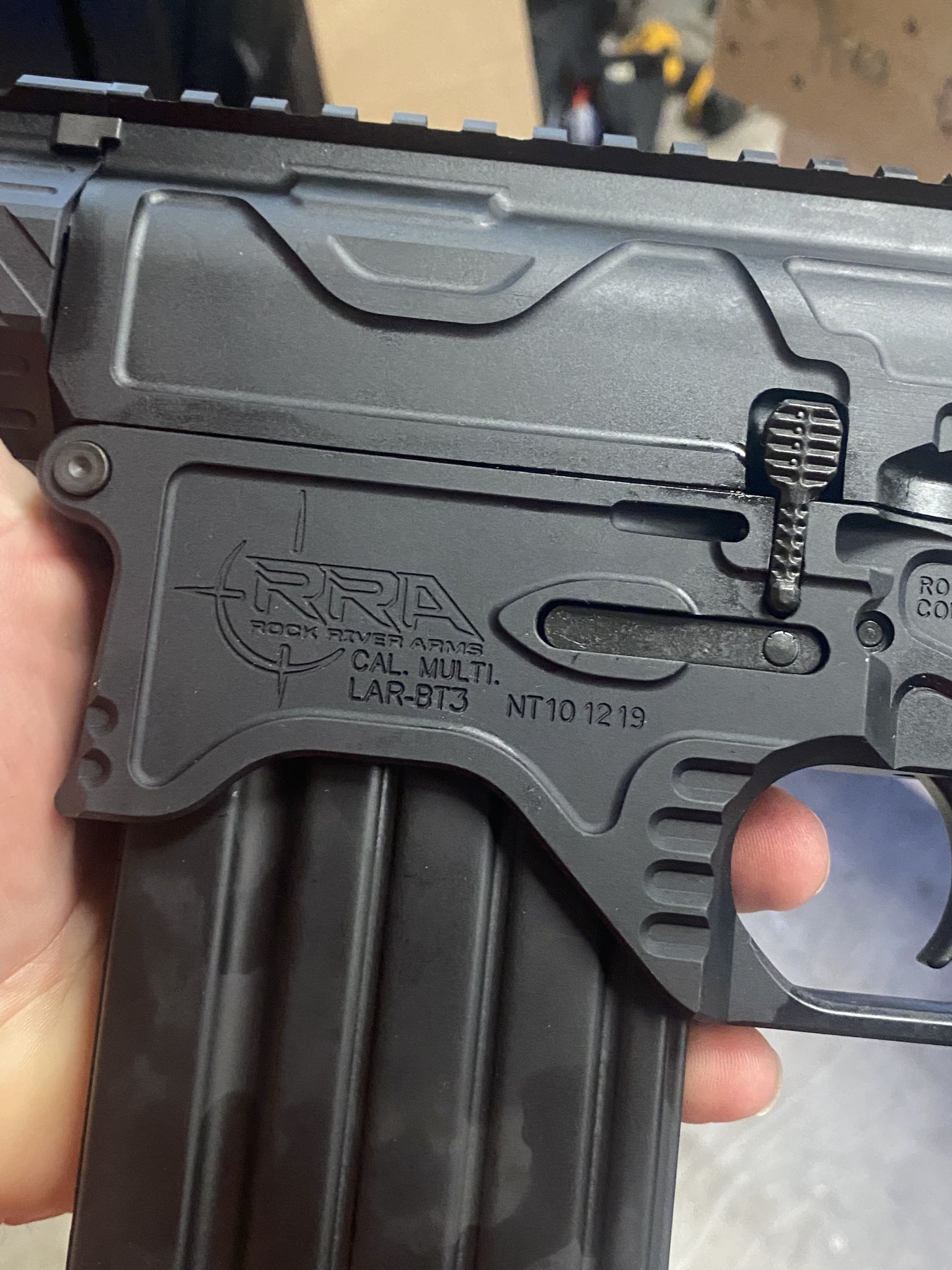

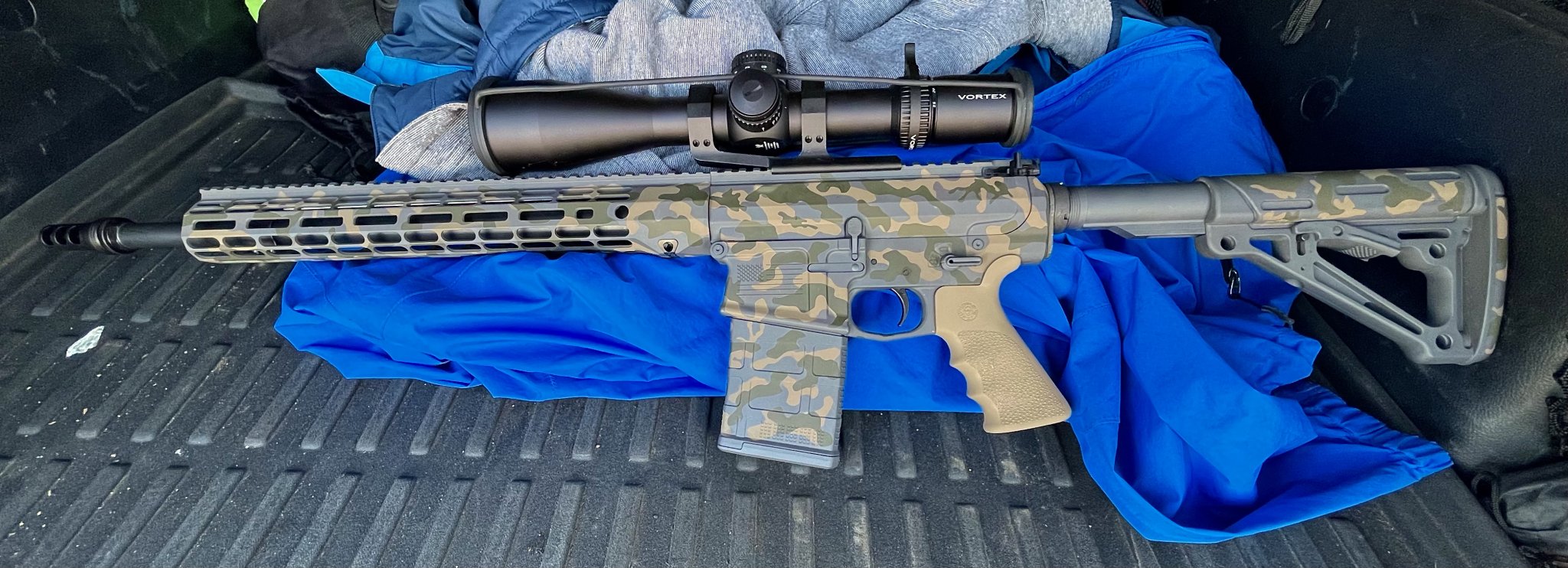

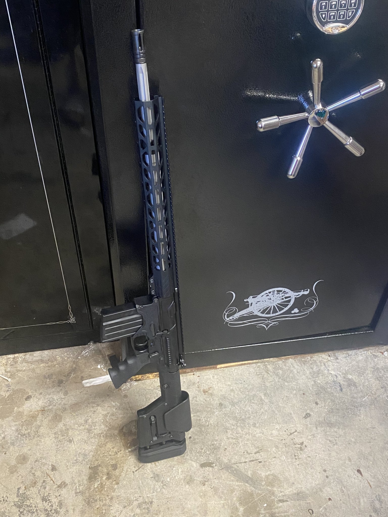

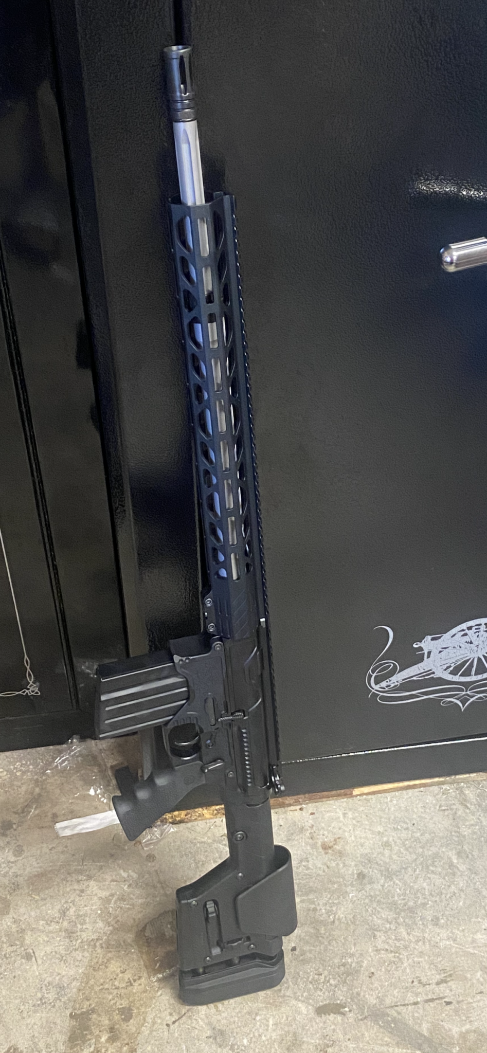

Just received my new rock river arms LAR-BT3 in 308, it has a 20 inch barrel, barrel is fluted. I am also putting EC Tuner Brake on it , i’m waiting for my Sphur mount to show up and I am putting a Nightforce NX8 4 x 32, this is going to be my hunting rifle and I might try to shoot some competitions with it as well, I also put up one of the shirts I bought at my gun show today 😁 they have some great ones there

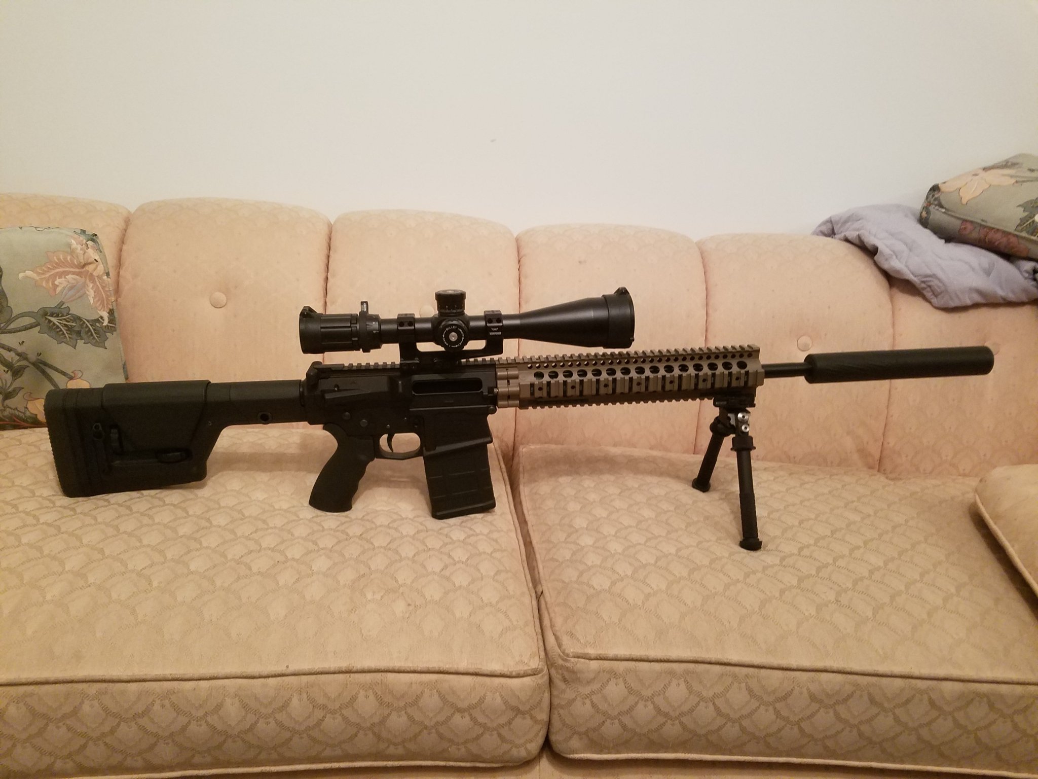

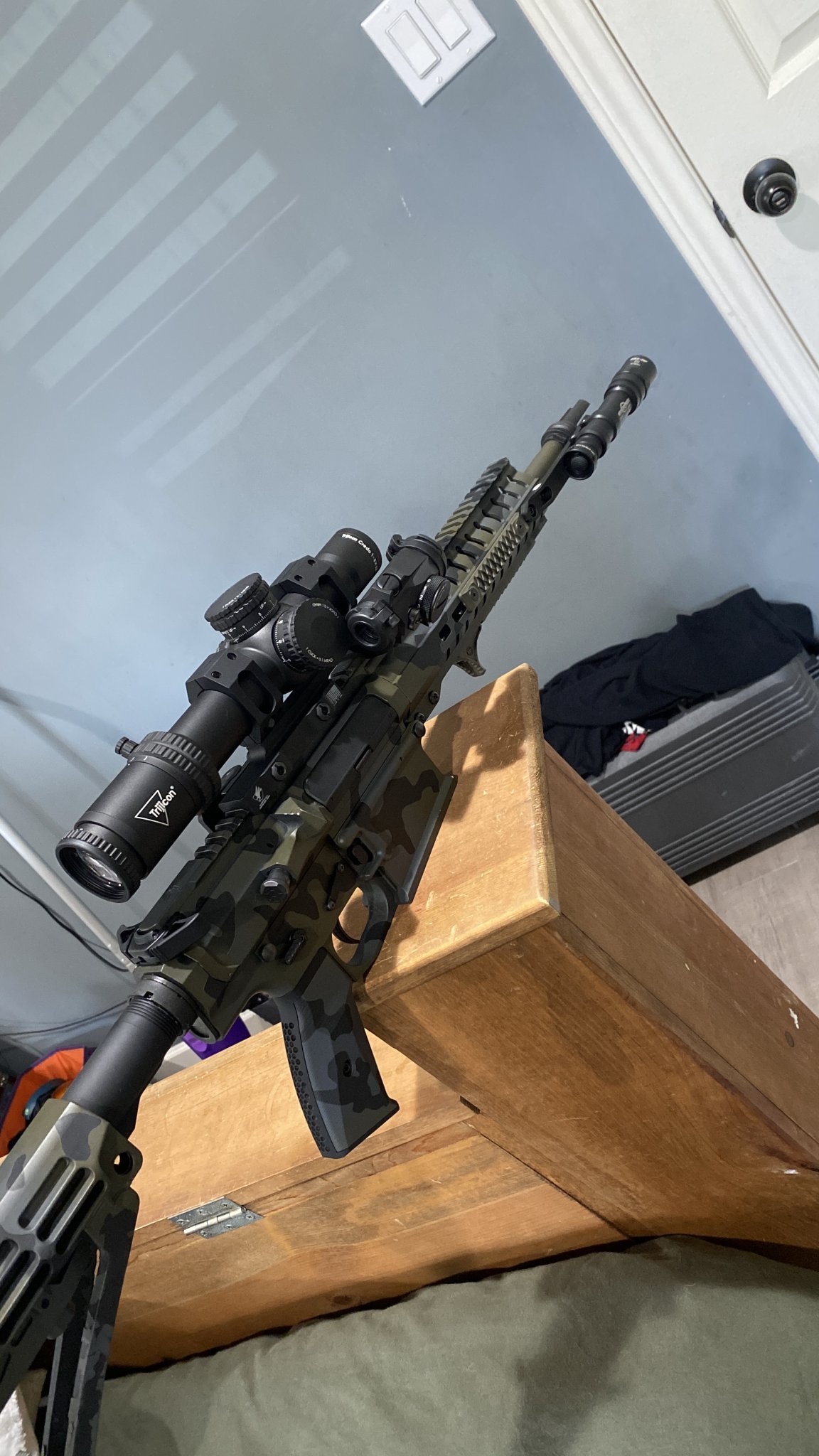

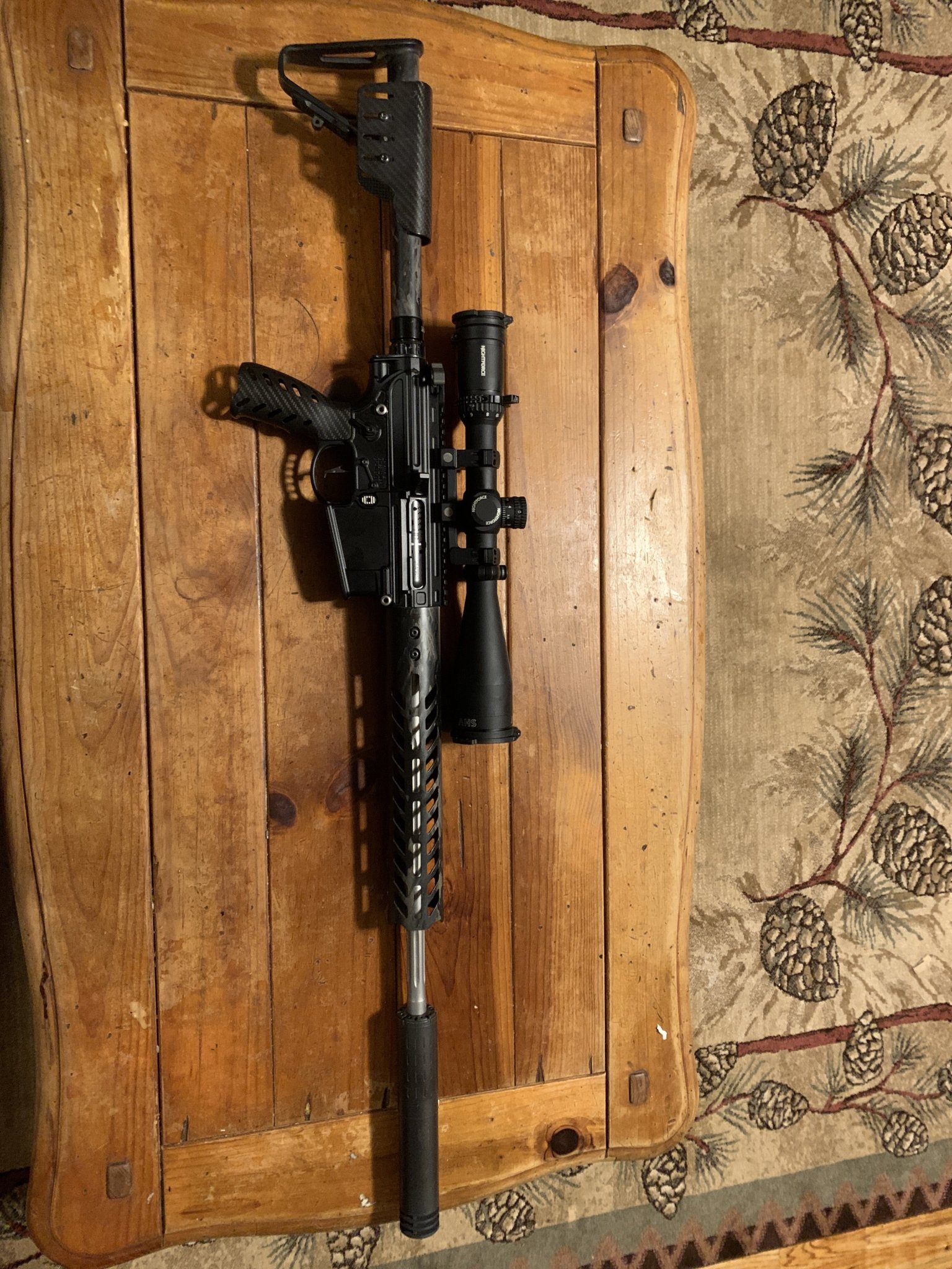

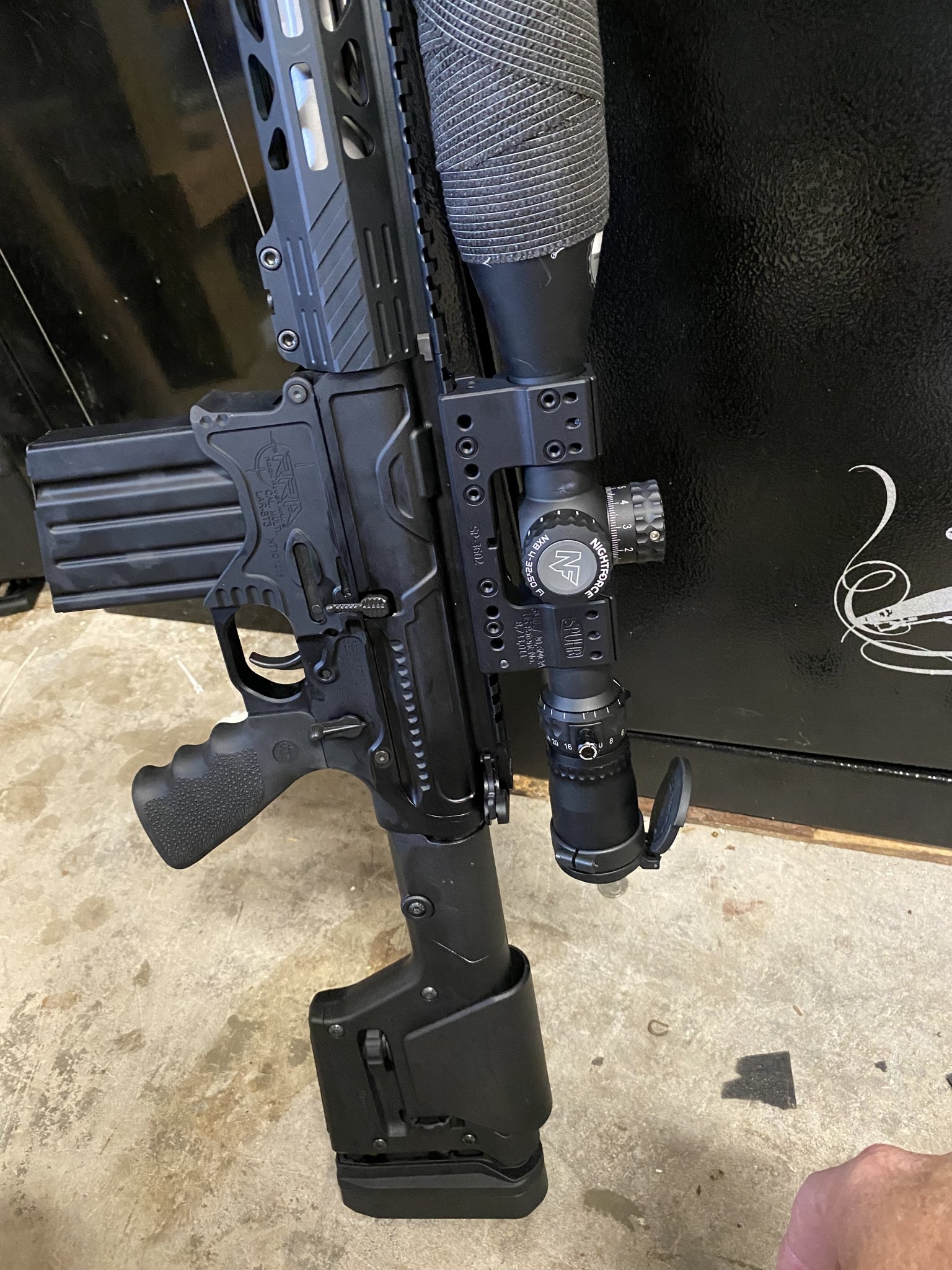

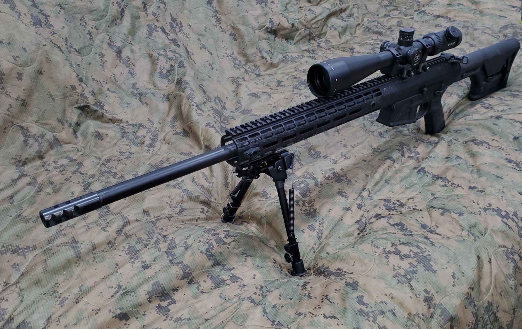

Just bought this gently used Aero AR-10.
Let me tell ya what Melba Toast is packin’, alright.
Aero Precision M5
Aero 18” barrel (1:10)
Aero VG6 Epsilon 762 brake
Aero Atlas R-One 15” handguard
Geissele trigger
BAD safety selector
Odin mag release
Aero nickel boron BCG
Raptor ambi charging handle
Magpul PRS stock (2nd gen)
Magpul grip
Magpul anti-roll pins
Vortex Diamondback 4-12x40 scope
The scope will get swapped out with a Vortex Viper Gen 1 PST FFP 6-24x50 that should be here on Tuesday.

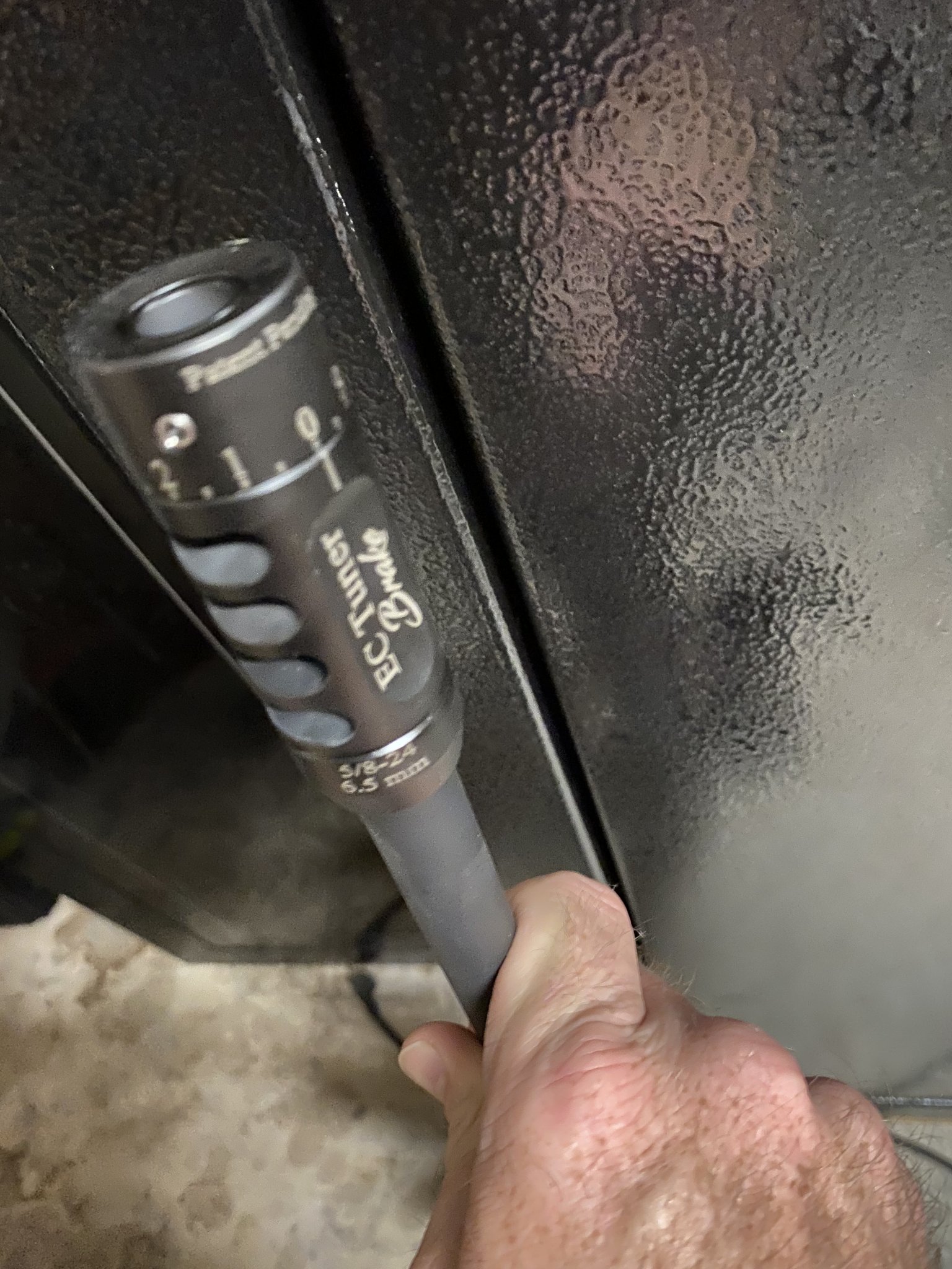

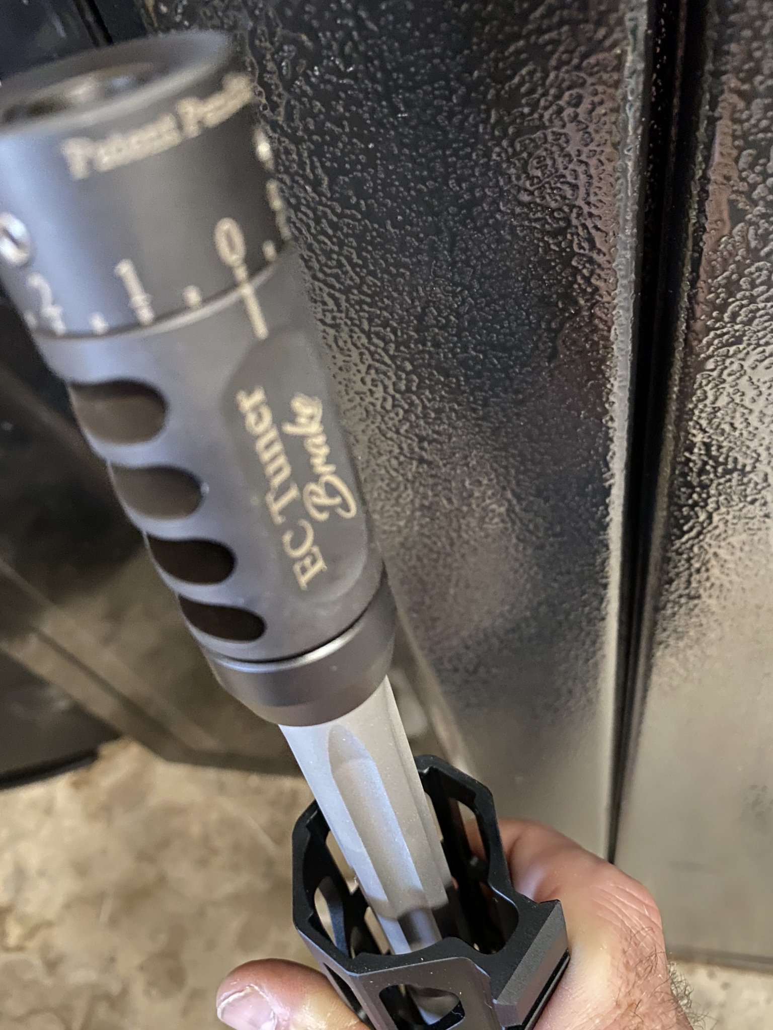

Added my NX8 4x32 and also put a EC Brake tuner, Caine wait to shoot this bad boy

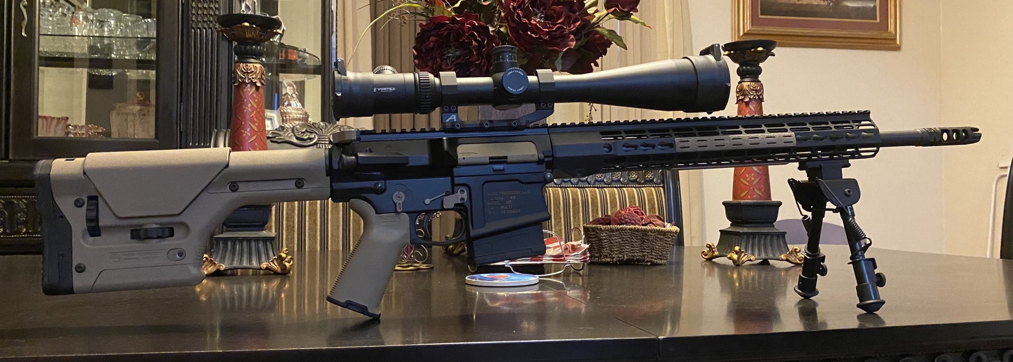

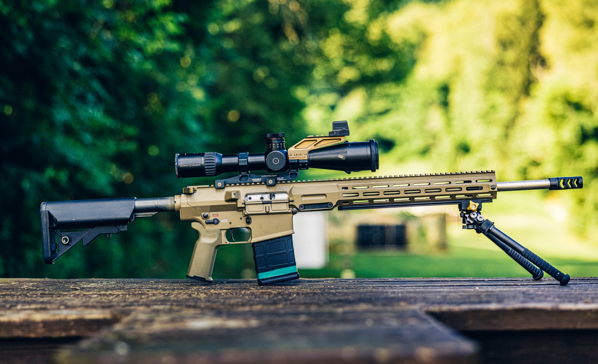

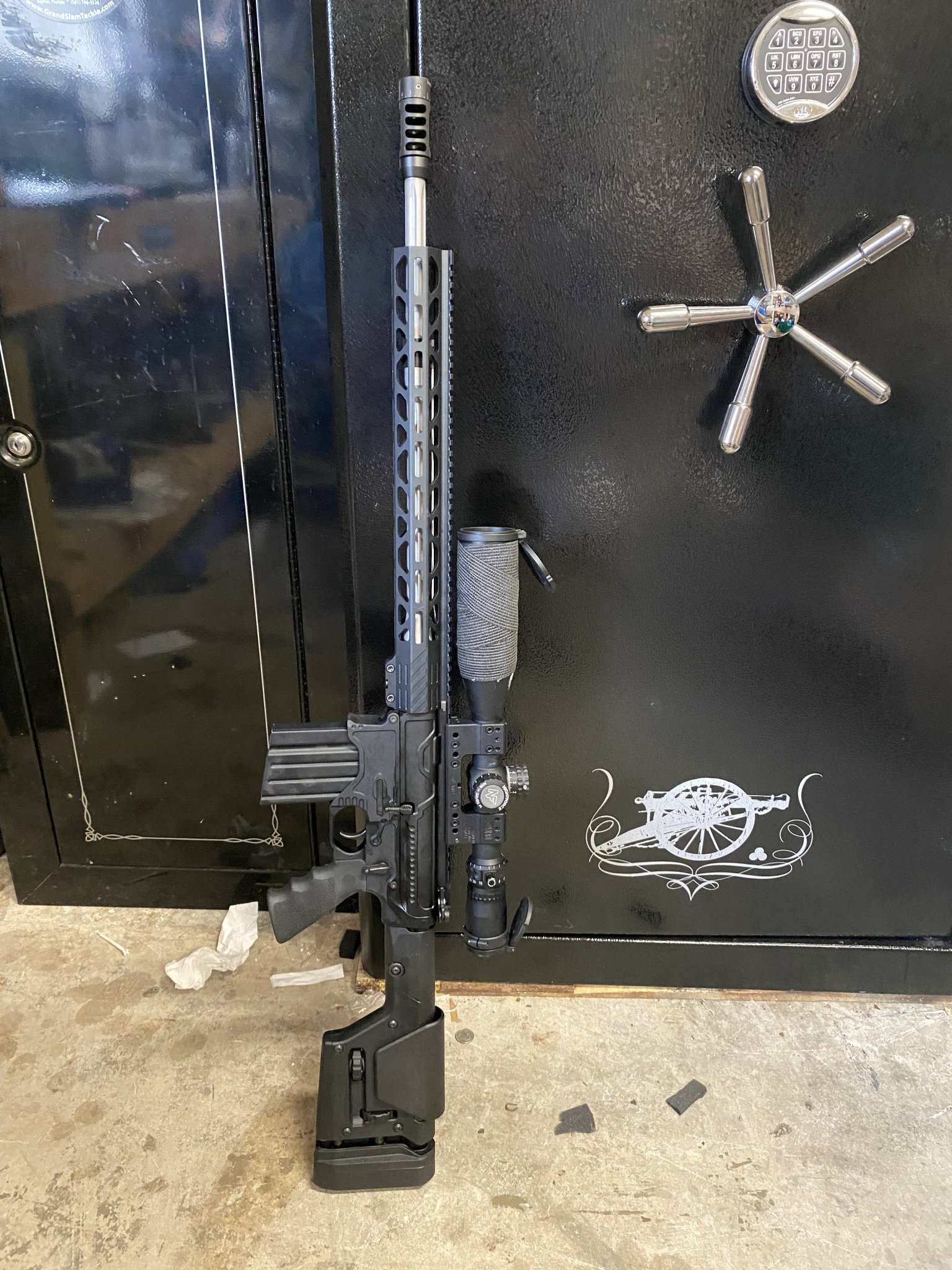

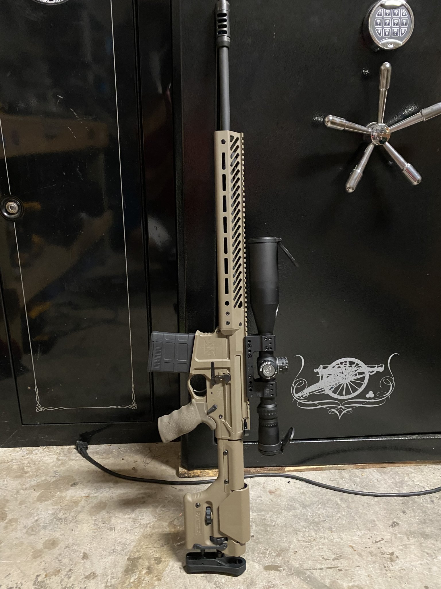

Zev Tech builders set
Proof Research 6.5 Creedmoor 22" stainless
Deadair muzzle brake
SLR sentry 8 adjustable gas block
JP FMOS HP bcg
Radian Black/NP3 SD charging handle
A2 buffer tube
KynSHOT AR10 hydraulic marksman buffer
JP tuned and polished extra power buffer spring
Magpul PRS gen 3
TriggerTech Diamond
Kns trigger pins
Radian 45⁰ selector
Ergo TDX 0 angle
Trijicon Tenmile 4.5-30x56 FFP precision tree
ADM Delta Cantilever 34mm 20 moa mount
JP FMOS HP bcg
A2 buffer tube
Magpul PRS gen 3
TriggerTech Diamond
Kns trigger pins
Radian 45⁰ selector
Ergo TDX 0 angle

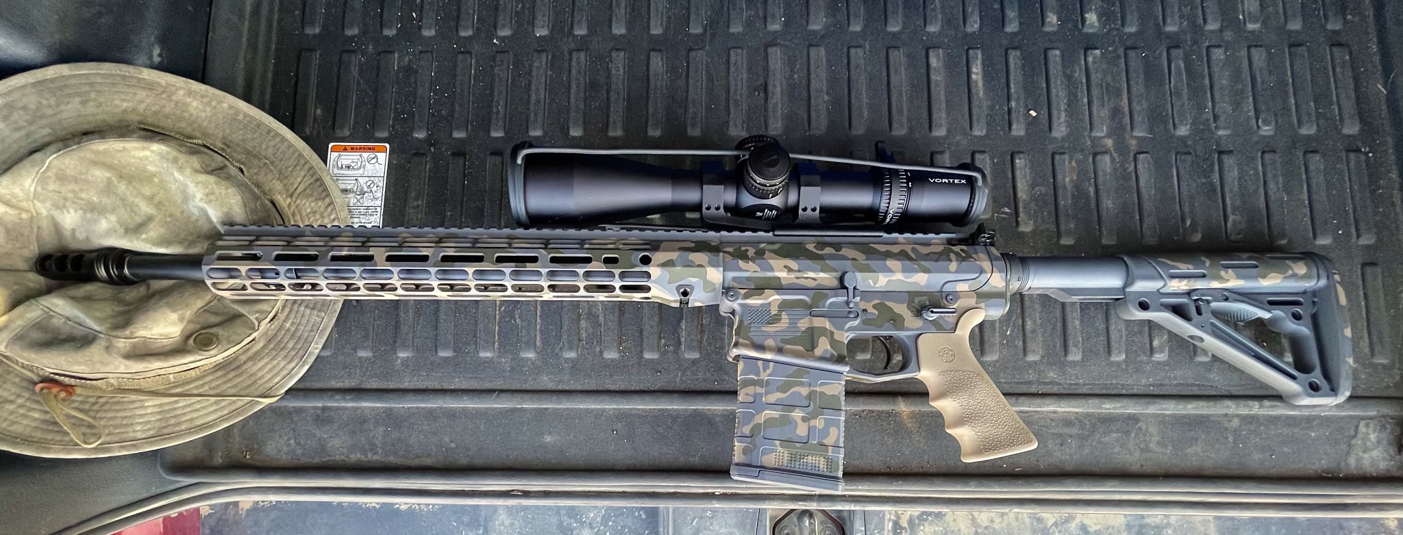

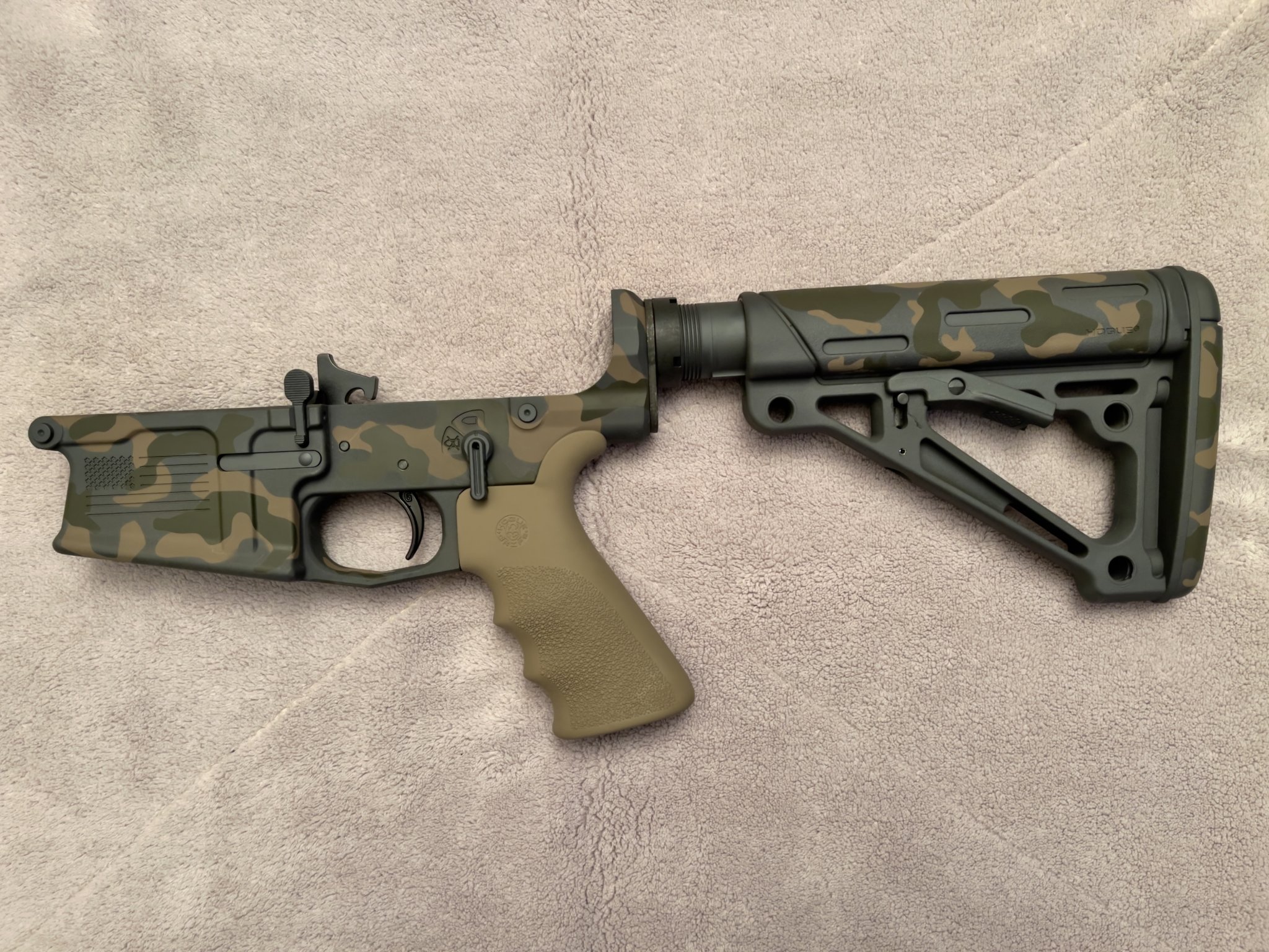

Cerakote camo job

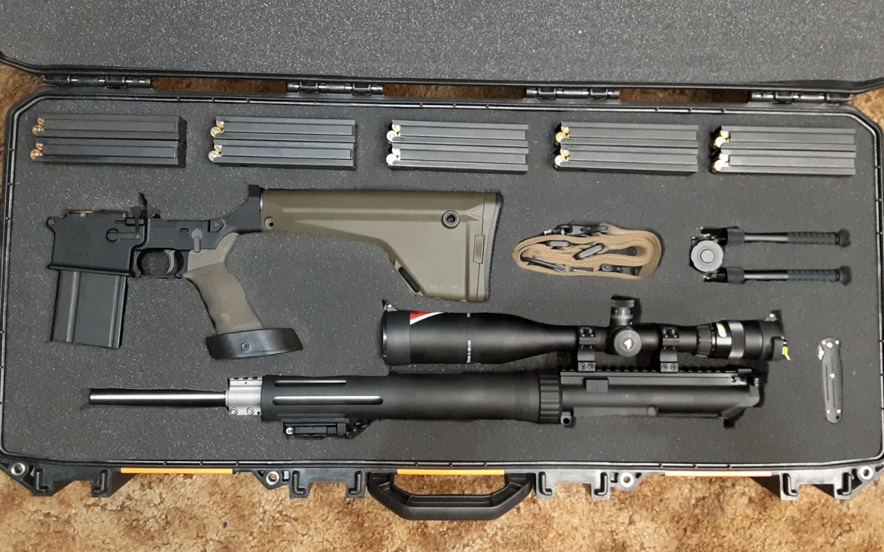

I've completed the lower assembly; will work on the upper/barrel/handguard soon (work has been crazy busy)!! Pic of the lower attached. Had a local shop here in metro Denver do my Cerakote job. The Cerakote colors I chose were:
H-234 Sniper Grey
H-264 Mil-Spec Green
H-265 Flat Dark Earth
Cheers!

First photo edit attempt. Some rough lines/edges but I think it's alright for doing everything on a phone.

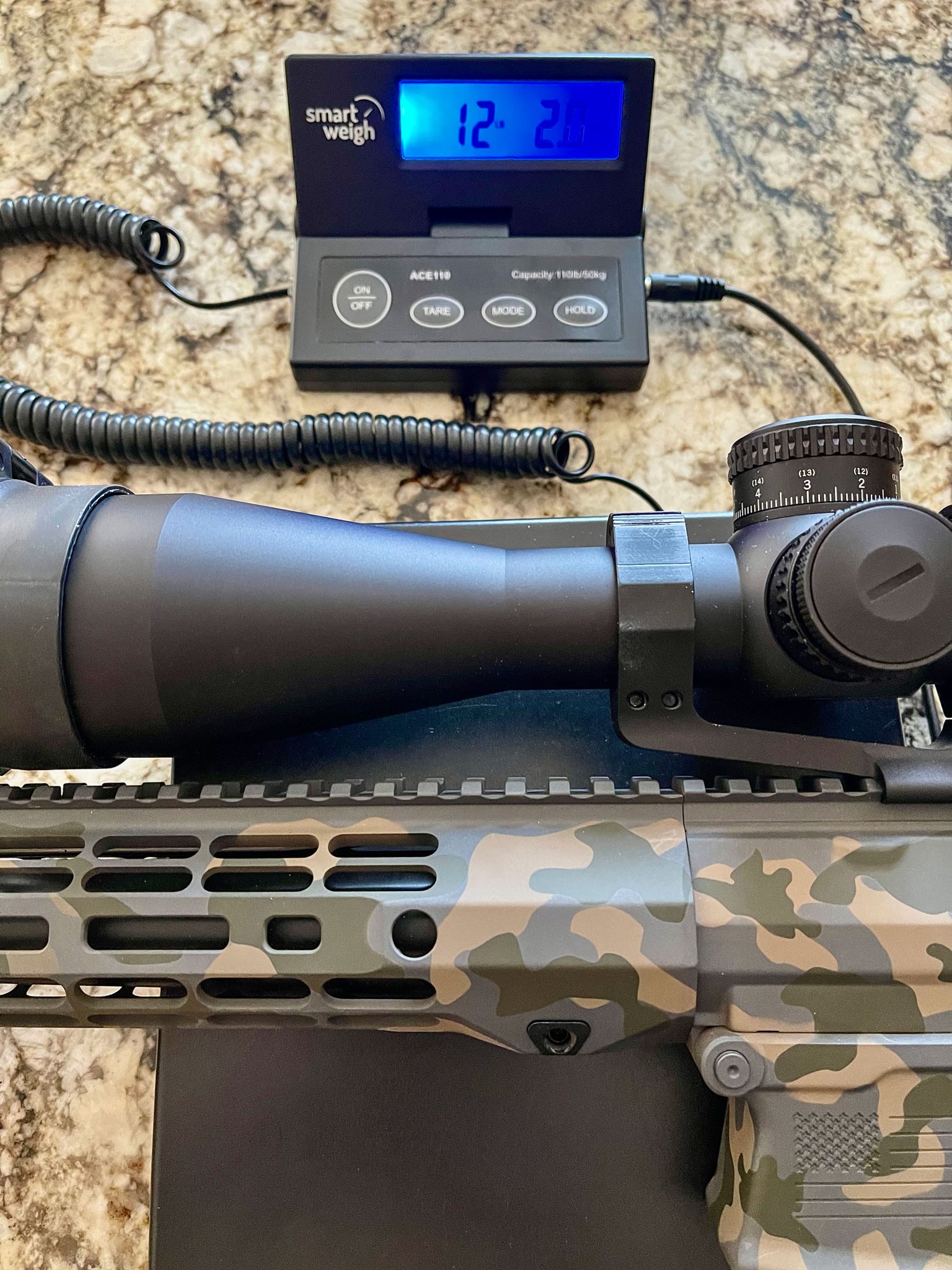

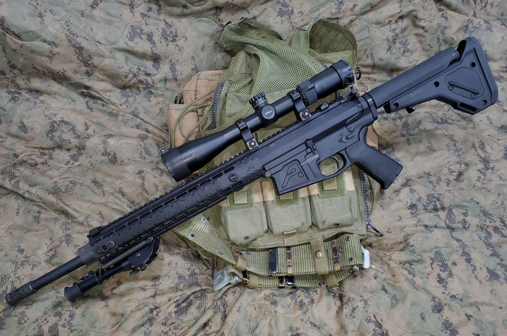

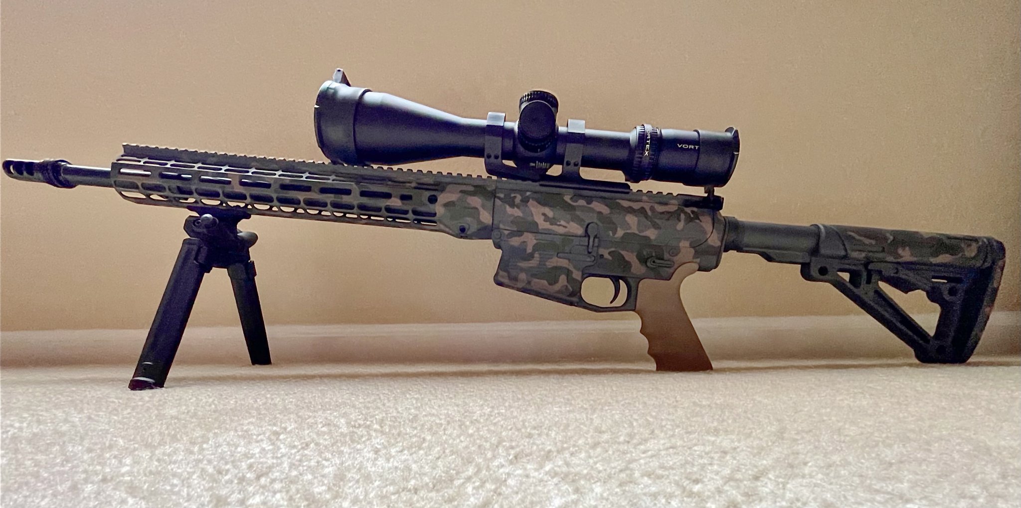

After way too long a wait (had to wait for a dimpling jig and a carbide bit)...I have finally assembled the upper/barrel/gas system/handguard/muzzle device. The build is 99% complete. All that is left is the bipod, Objective & Eyepiece flip-caps from Vortex and it's done!
Overall, I'd say this was a complete success on my part! Learned a number of things along the way, for example:
1) If using an adjustable gas block, make sure you open it wide-open before you start working the installation of the gas block. Make it easier to do the 'blow test' (lol).
2) Make sure have your work area well lit. Sometimes, the little set screws can be a real PITA to find unless well lit.
3) Pay attention to direction of things as you install. If you're installing a "Bad Ass Pro Ambidextrous Safety," for example, it is an easy mistake to install upside down (especially if you're working fast and not in a well lit environment).
4) Make sure you have all your tools needed laid out and ready. Just makes the job easier...
5) Plenty of other observations
Now I am ready to get it out to the range and start fine-tuning! More pics once I get the bipod and flip-caps.
Edit: bipod added along with scope flip-caps. Total weight of the rifle: 12lbs 2.0oz

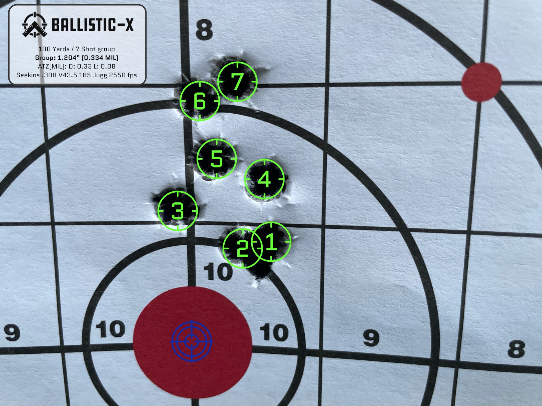

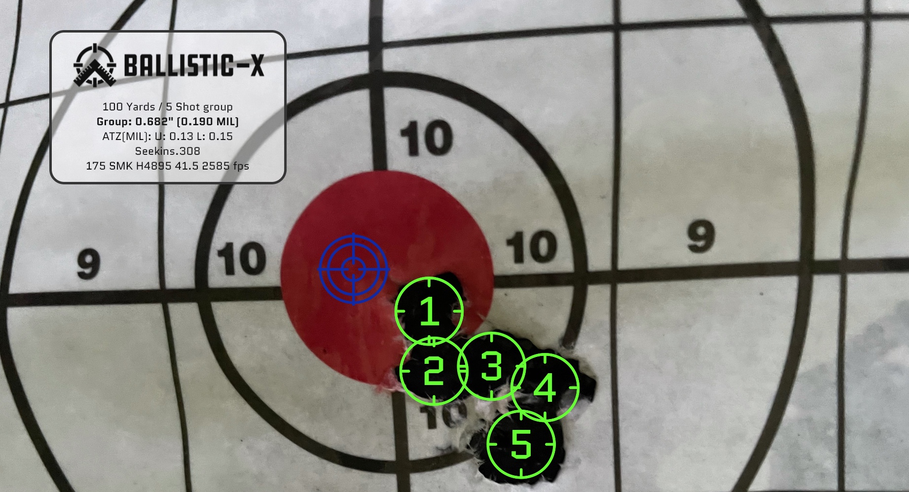

Seekins .308 w/ Geissele SSA-E

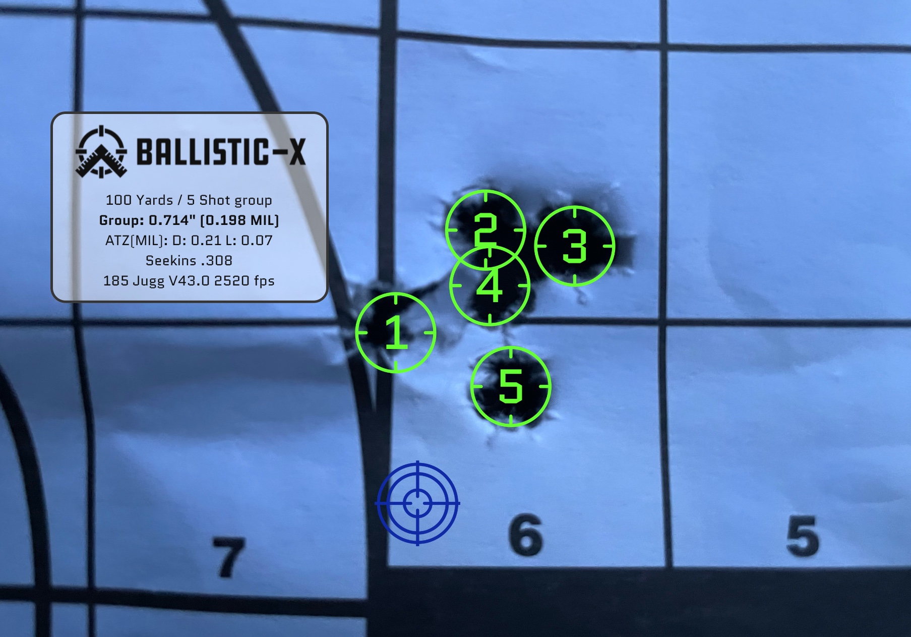

Tubbs/Kaw Valley 5oz, Fail Zero/JP bolt, 18” Proof 1:10, Omega
Good group during barrel break in.
185 Juggs V43.5. A little hot in this gun but only 120 fps slower than my bolt gun 24”barrel and cycles great suppressed with the Superlative AGB bleed off, Tubbs flat spring and 5oz Kaw Valley buffer.
Varget 43 0.7” group 2520 fps
Reactions: Jefe's Dope

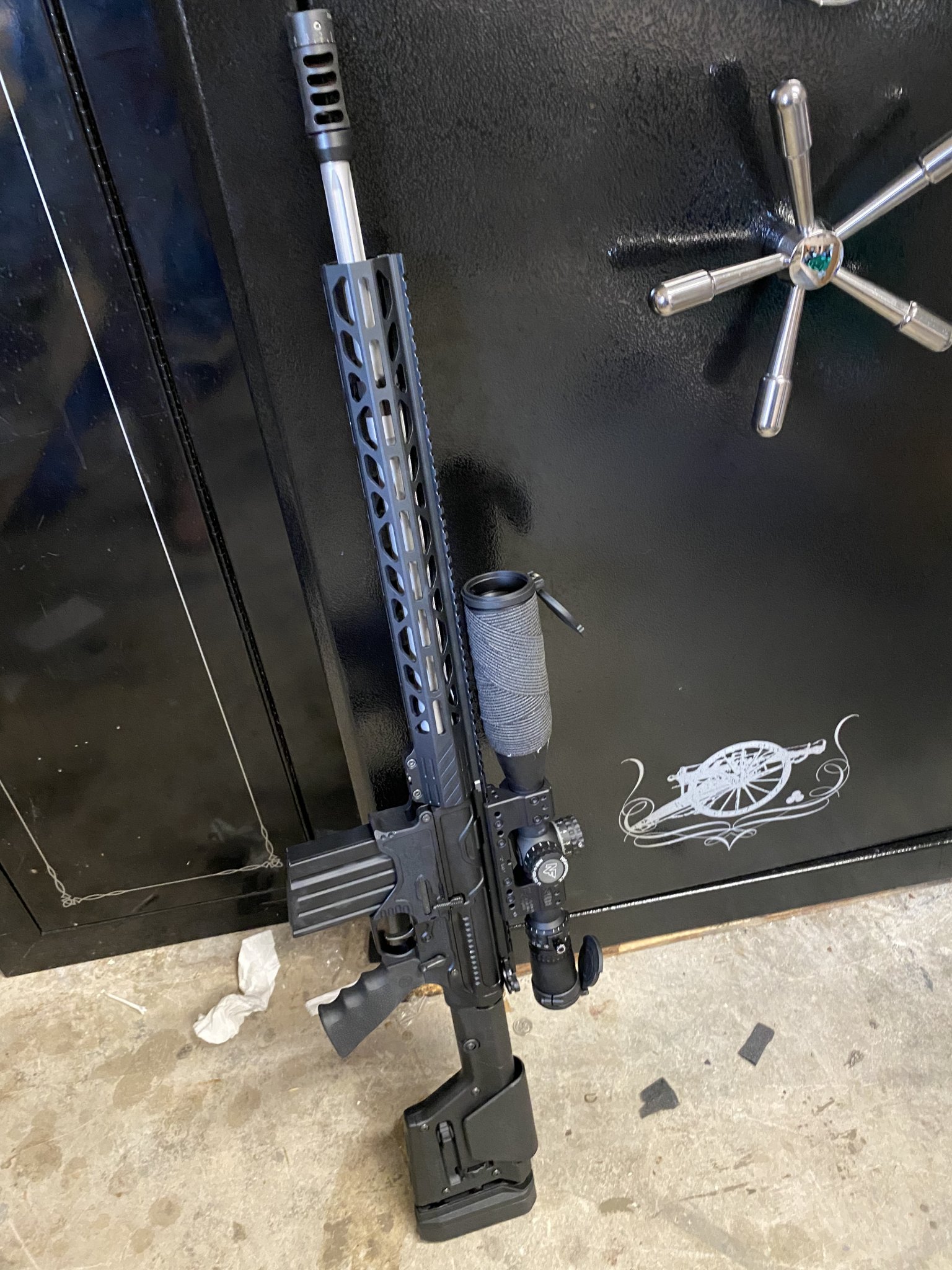

Seekins SP10 in 6.5 creedmoor, I put the magpul PRS stock on and added a EC Tuner Brake . I will do some load testing this weekend

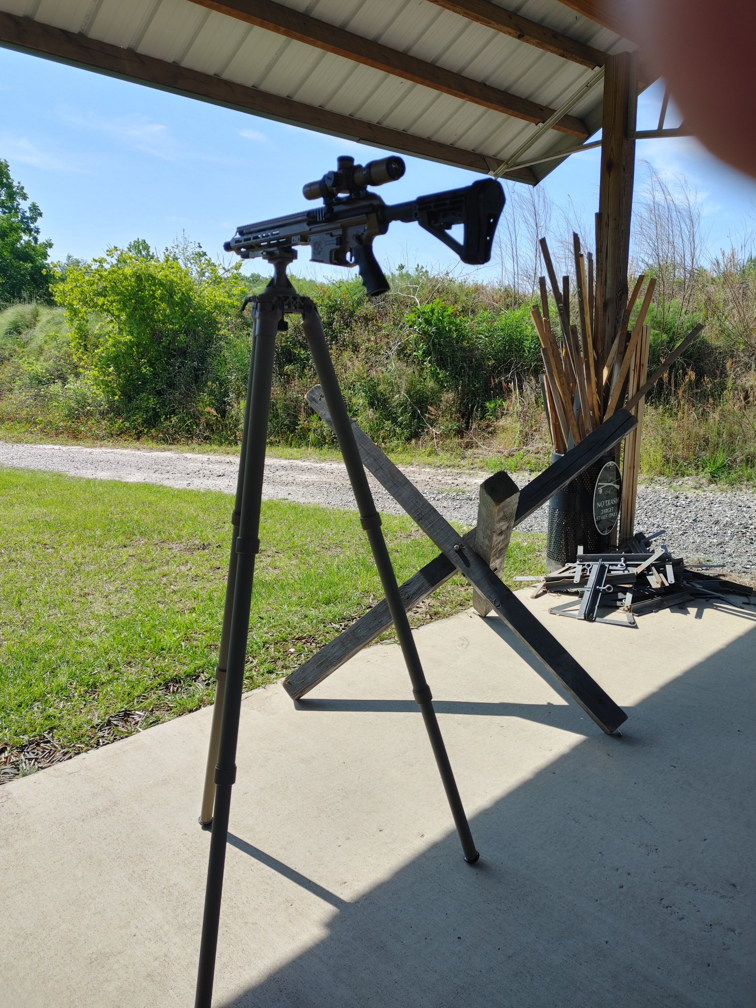

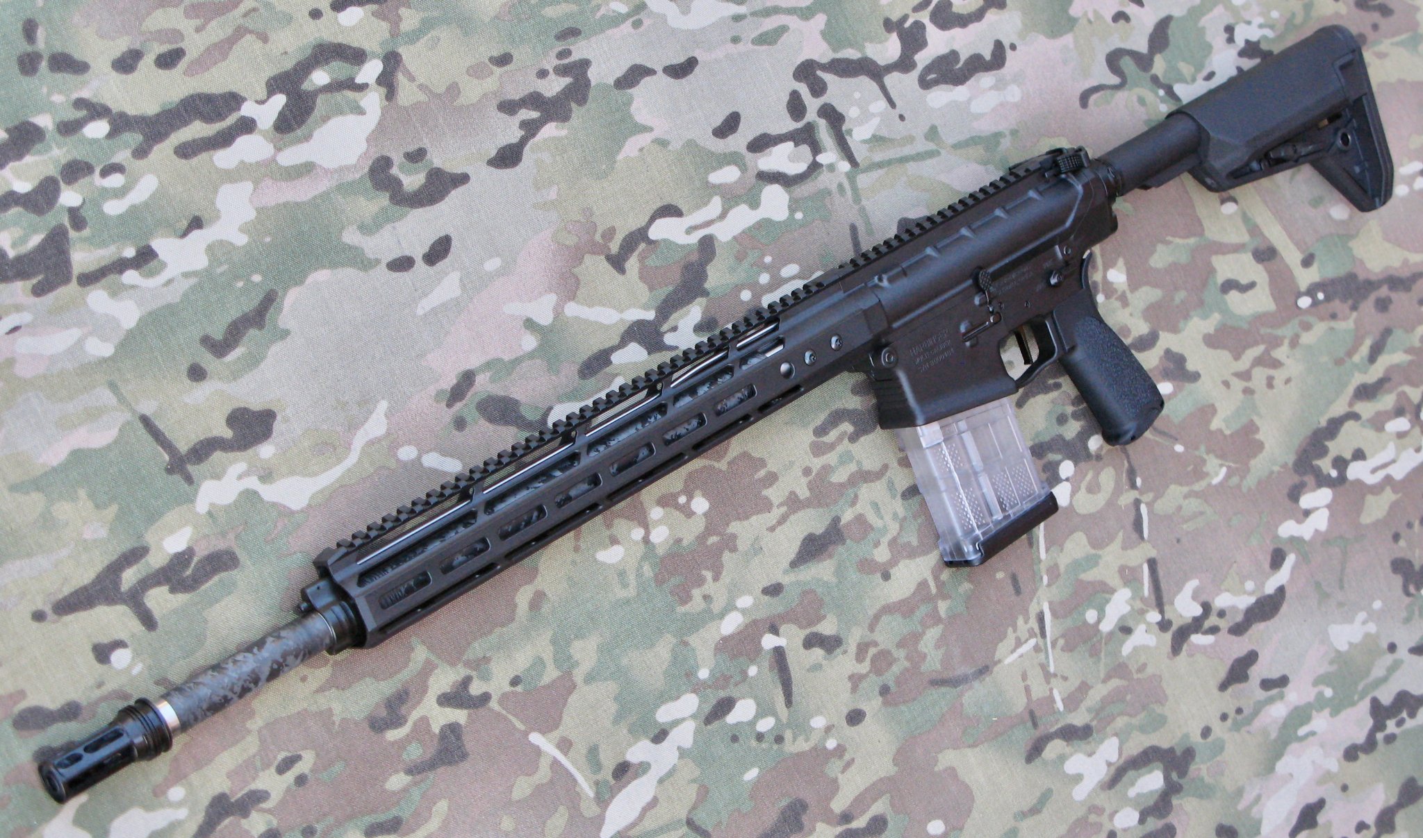

Just slapped this together. Blatant rip-off of @big_beau13 's gun here. https://www.snipershide.com/shooting/threads/308-ar10-build-info-picture-thread.6252642/post-9438572
But oh well, his build inspired me.
SLR Rifleworks B-30 builders kit w/ 16" Ion Lite handguard. Lantac heavy BCG, JP HP bolt, JP SCS, Proof 24" CF 6.5 Creed, CMC 2.5lb SS straight shoe, PRI M84 gas buster charging handle.

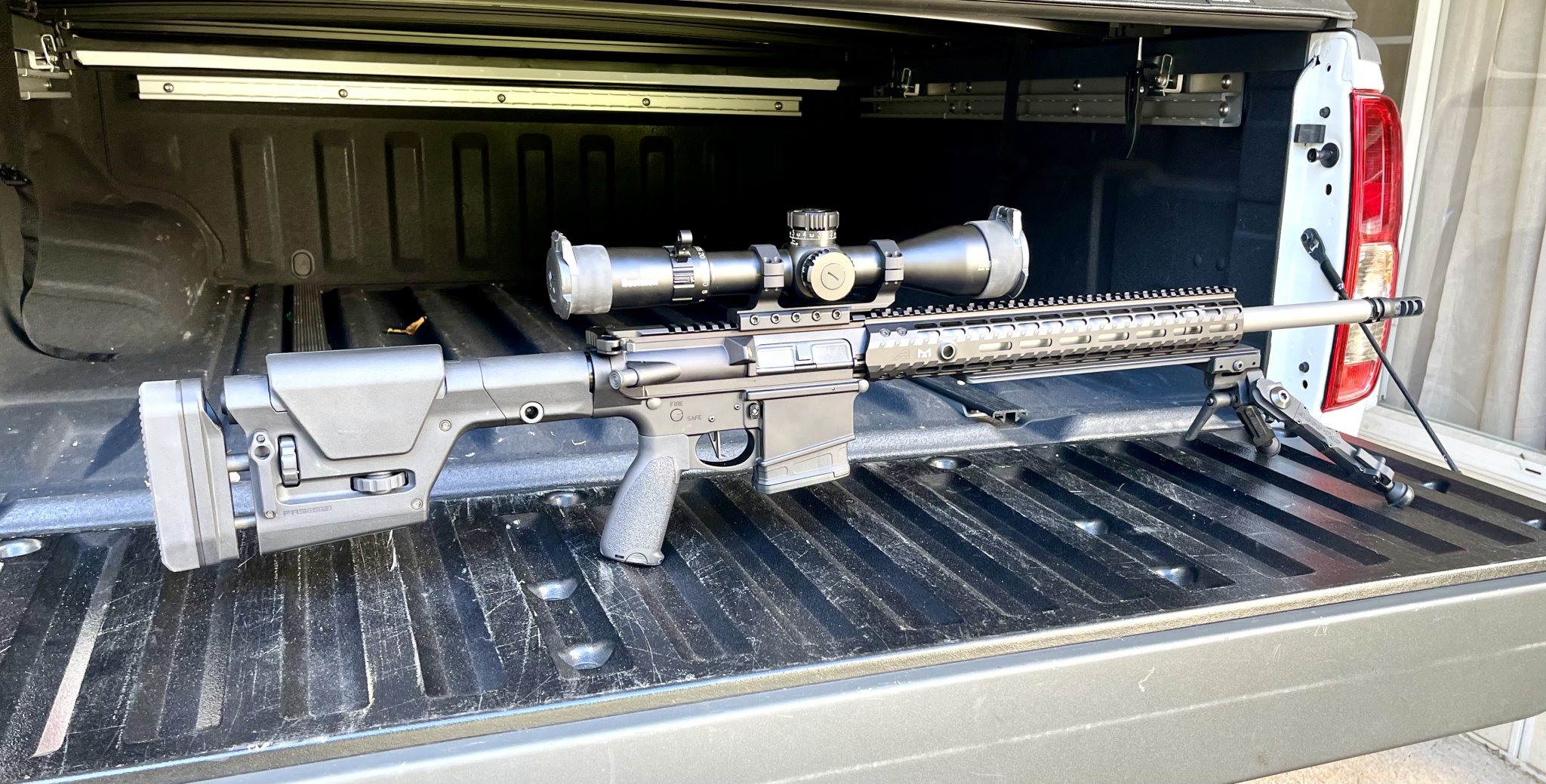

Gen 3 pa65
22” BA barrel
Aero m5 handguard
Cmc trigger
Bushnell elite
Dead air keymo brake

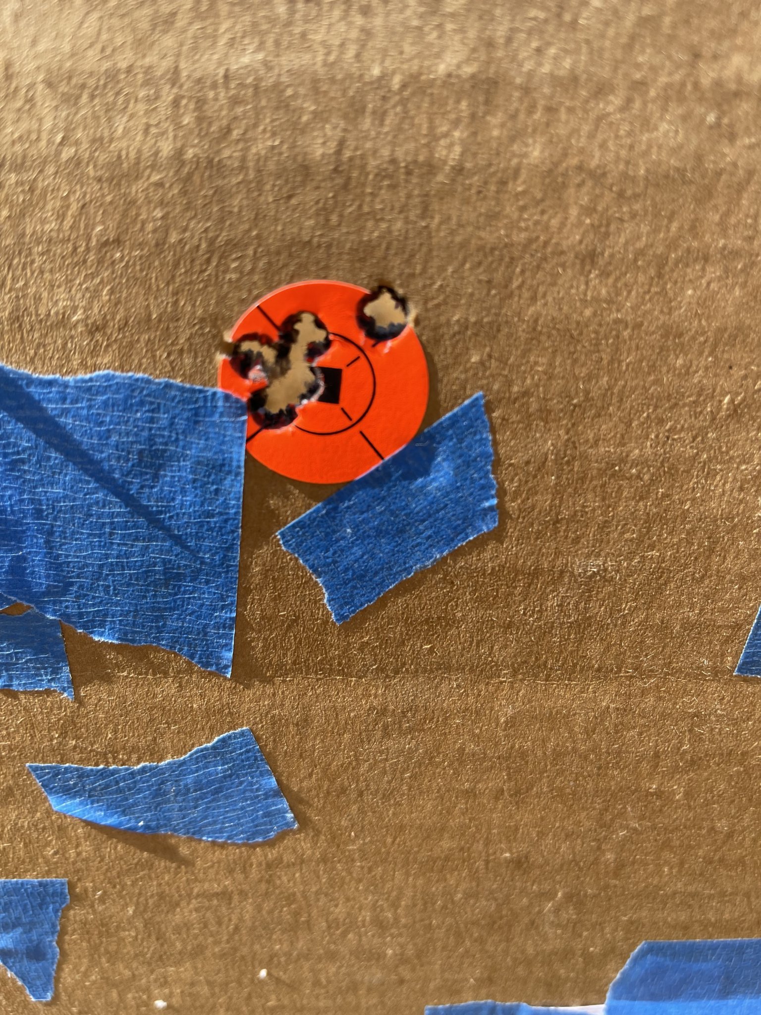

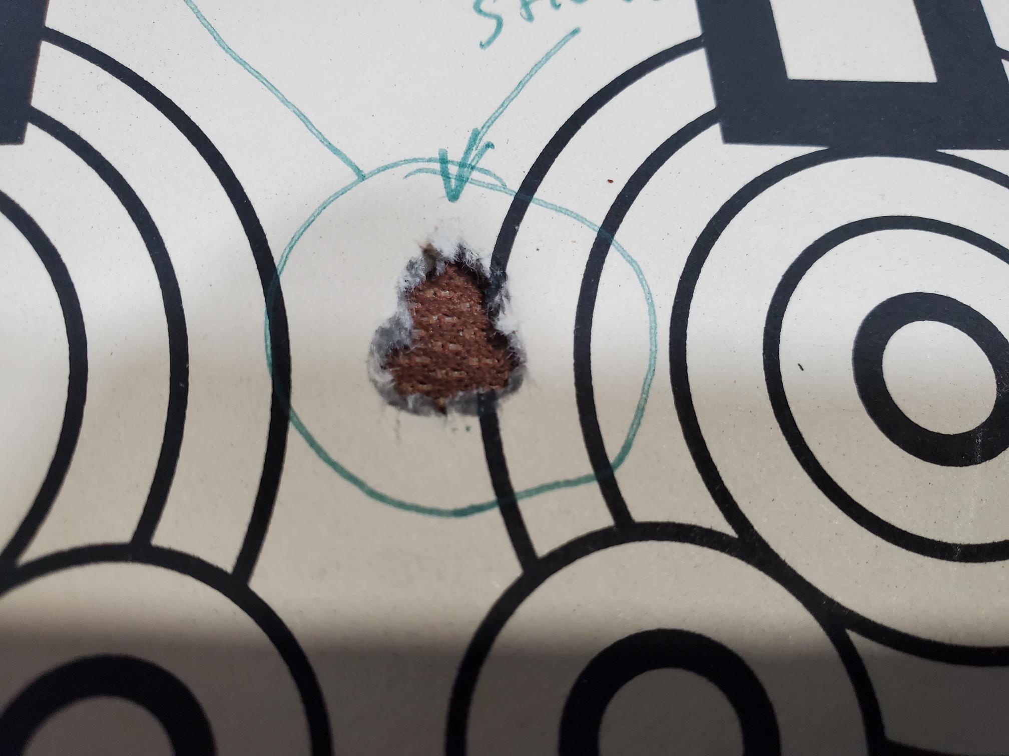

I’m really hoping the new barrel speeds up a little, 5 rounds of 140 eld, starline brass, cci450 and 41 gr of h4350. Netted 2615 fps.
Flyer was cold bore shot. Measures center to center 0.66 with the flyer and .34” without.

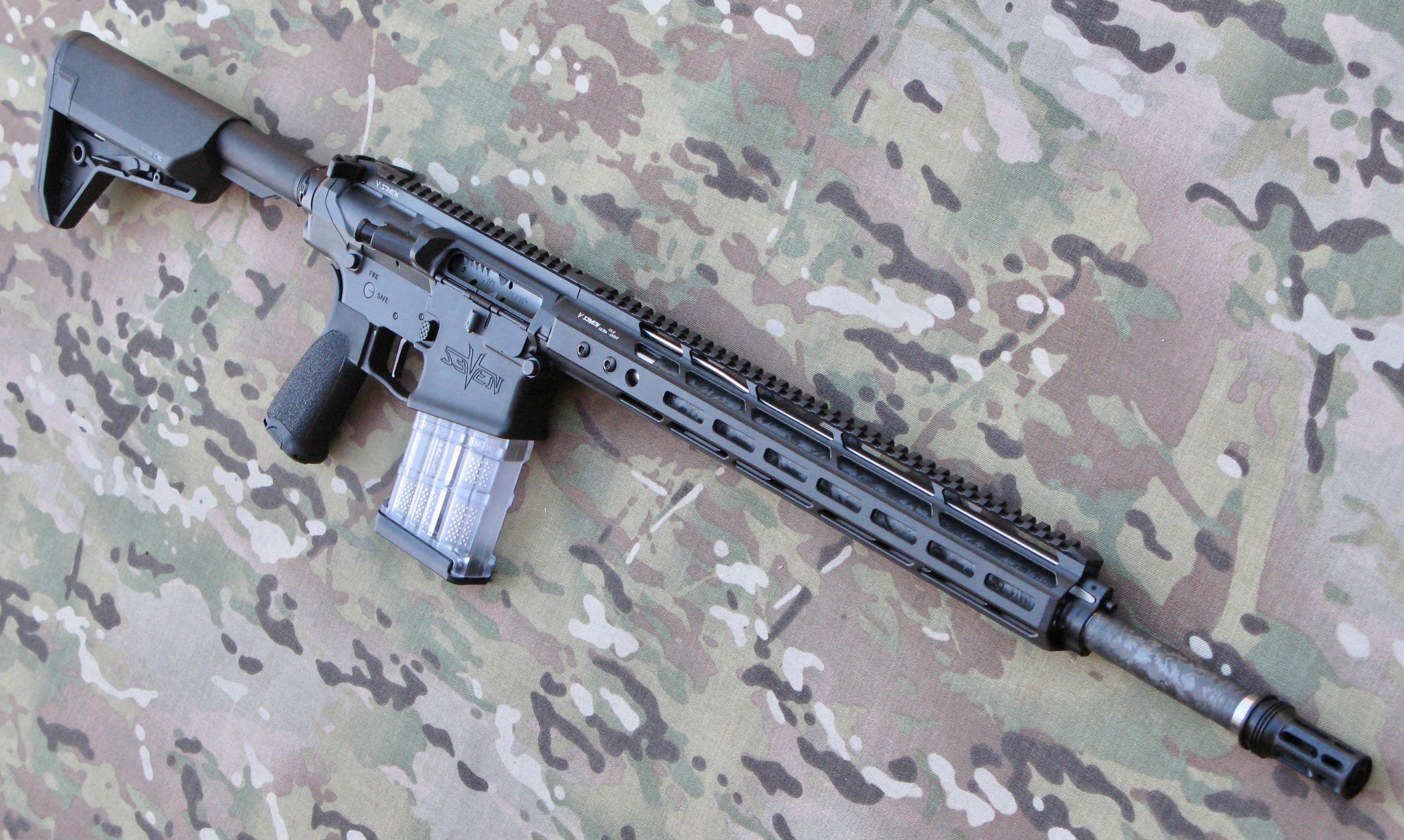

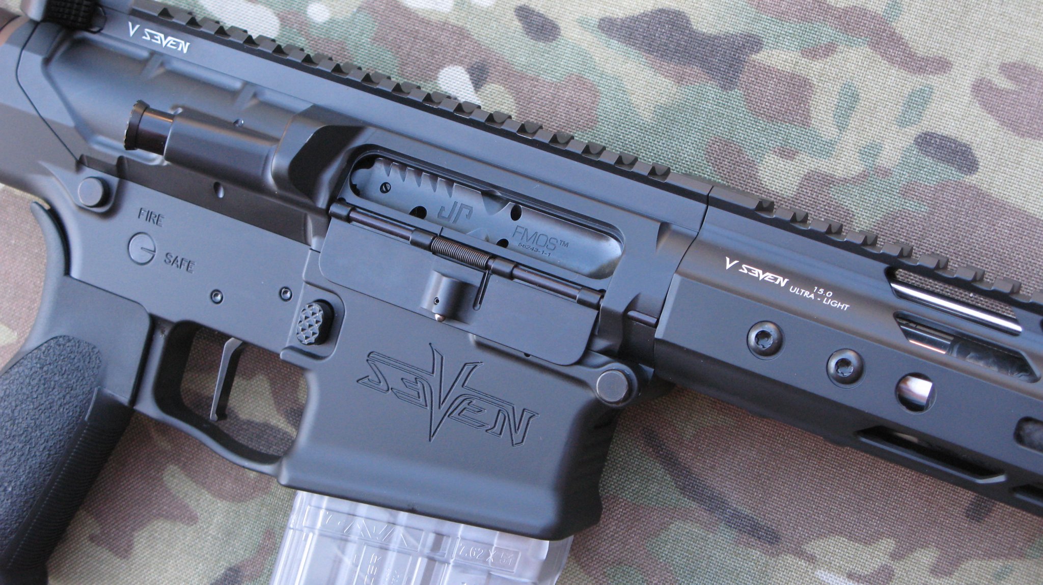

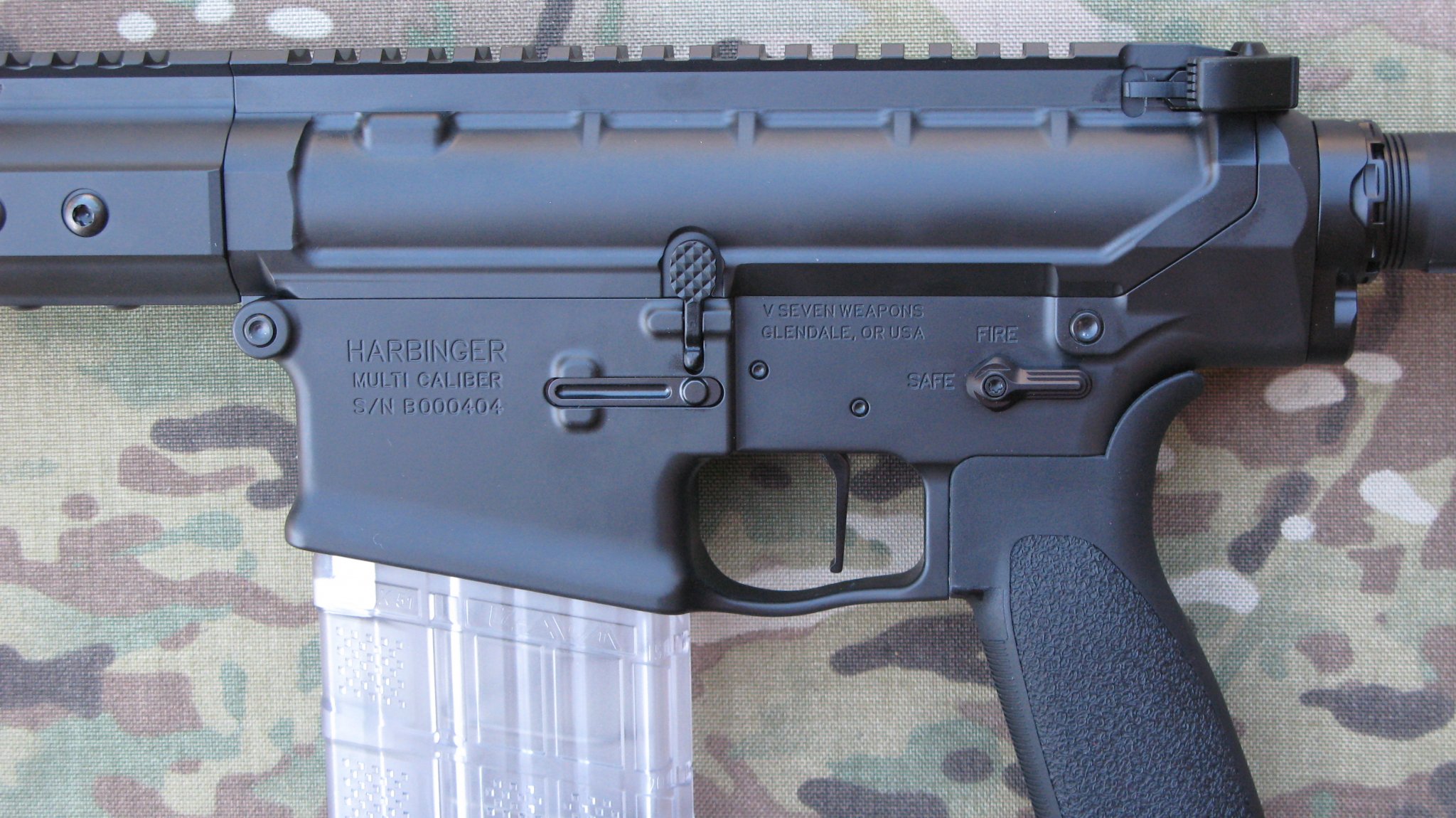

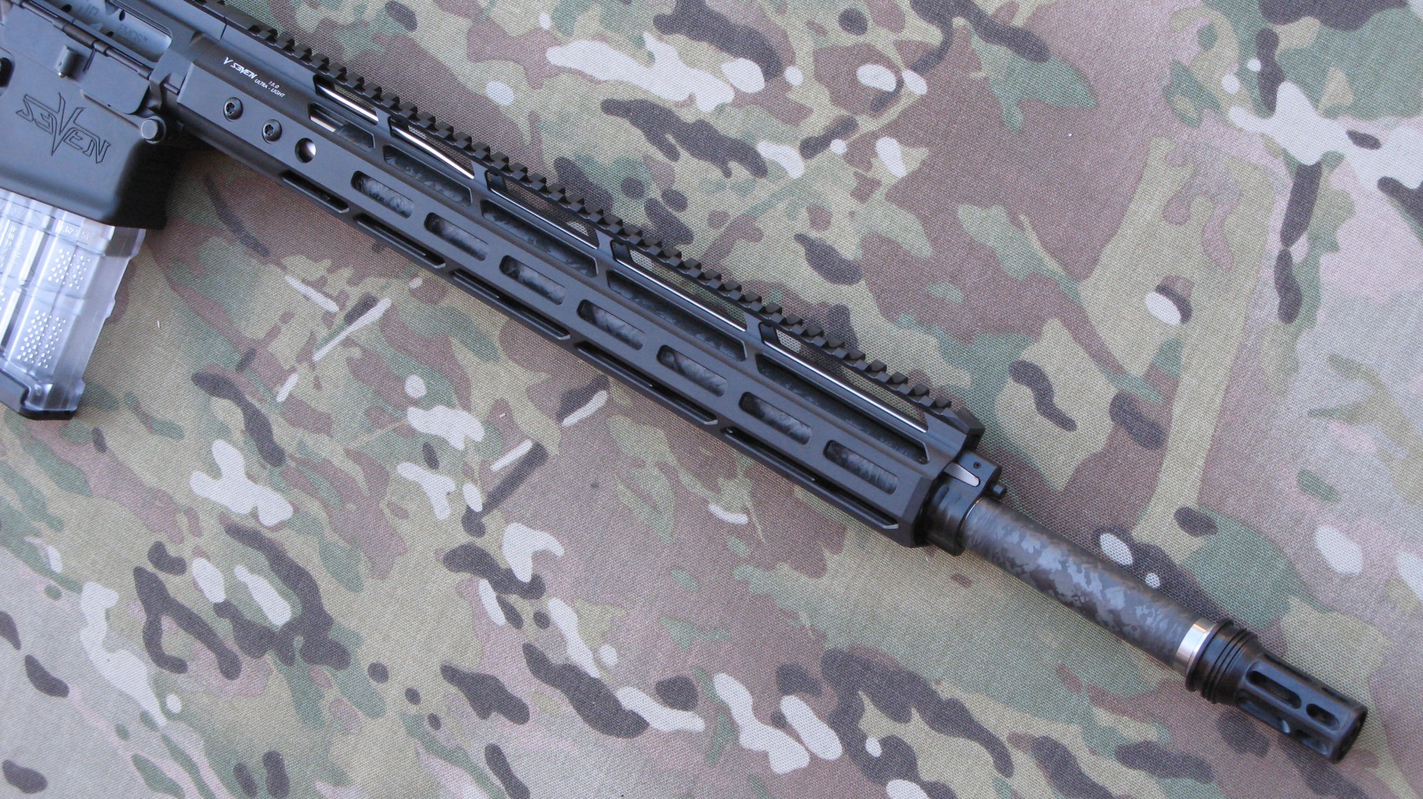

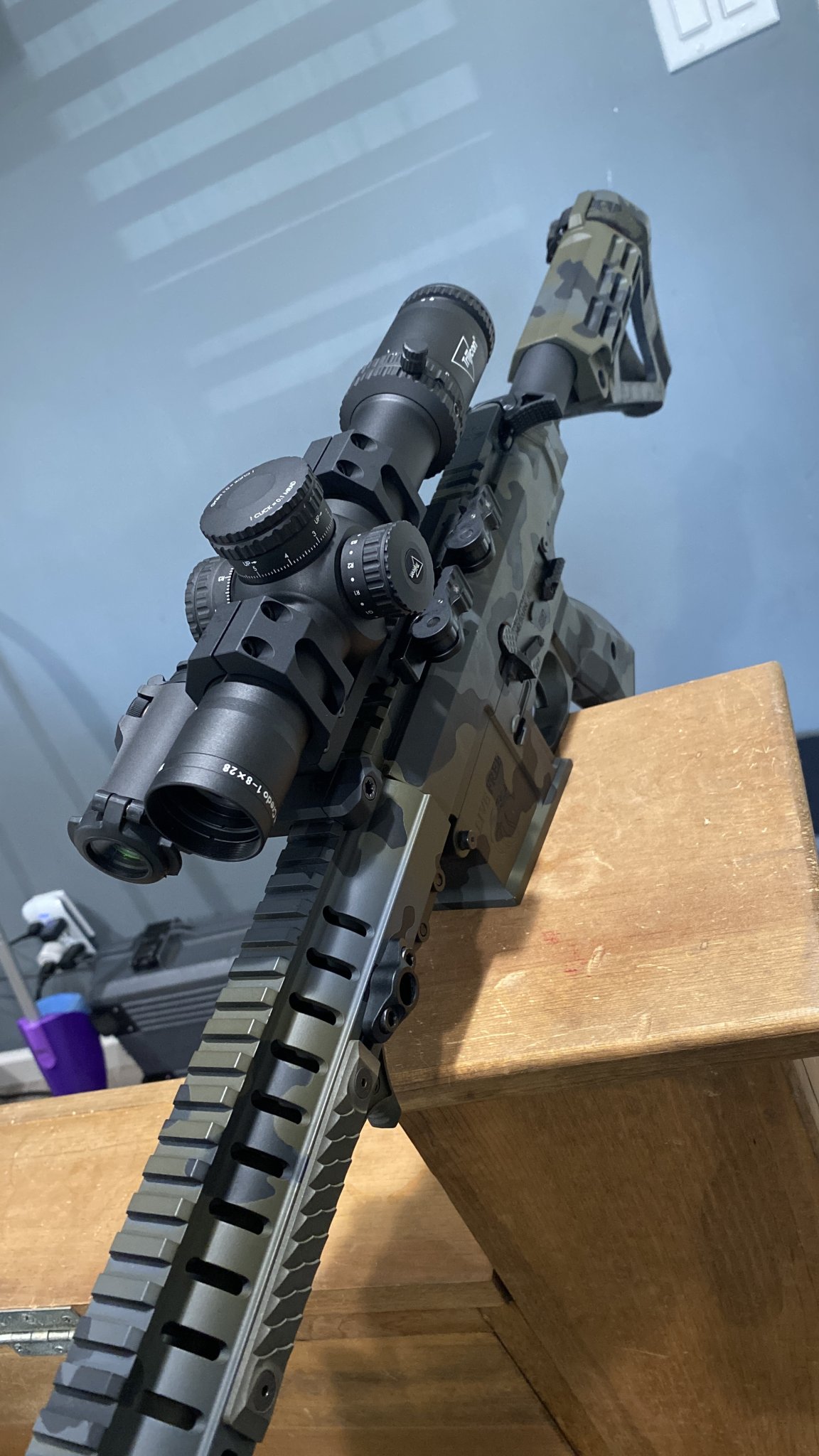

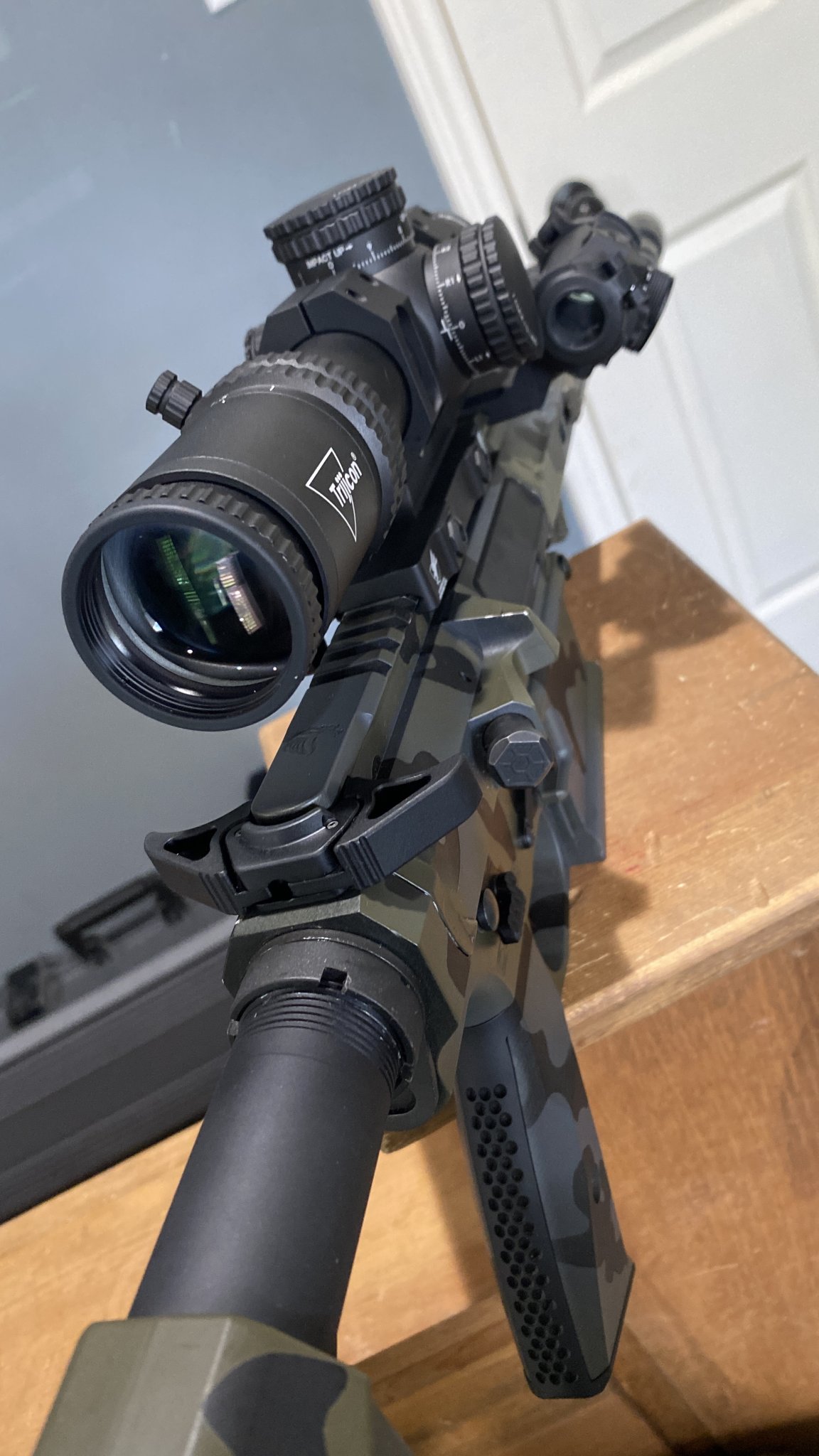

The goal here was to build a totally uncompromising ultralight long range gas gun. This is the result: V Seven 7075 Harbinger Billet Receiver Set; V Seven 2099 Ultralight Mlok 15" Rail; Proof Research Carbon Fiber Wrapped 20" 6.5 CM Barrel with +2 Gas System; SLR 0.875" Adjustable Gas Block; OSS 7.62 Flash suppressor (other designs may easily be substituted); Geissele 7.62 Super Charging Handle; JP Full Mass Operating System ("FMOS") Bolt Carrier Group; V Seven Lightweight Forward Assist and Ejection Port Door; V Seven Titanium Push Pins, Fire Control Pins. Grip Screw, & Buffer Stop; V Seven S7 Tool Steel Bolt Catch; TriggerTech Adaptable Trigger, 2.5-5.0 LB, set on the low end; Vltor A5 Lower Receiver Extension; Recoil System Consisting of JP.308 Polished Carbine Recoil Spring and V Seven H3 Buffer; Magpul SL-S Buttstock; BCM Gunfighter Mod 1 Pistol Grip; Lancer L7AWM Clear 20-RD Magazine. Empty weight 8 LB 9 OZ.

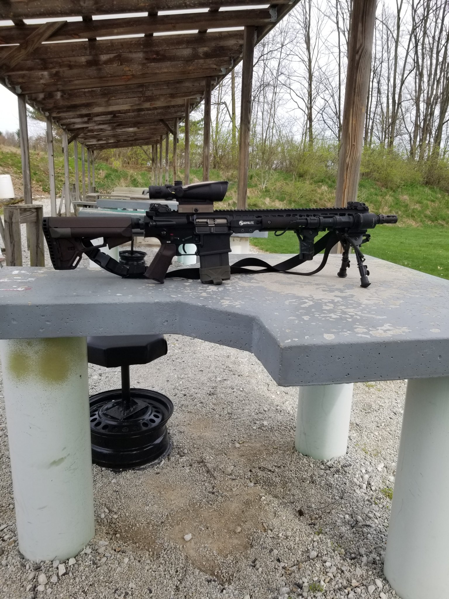

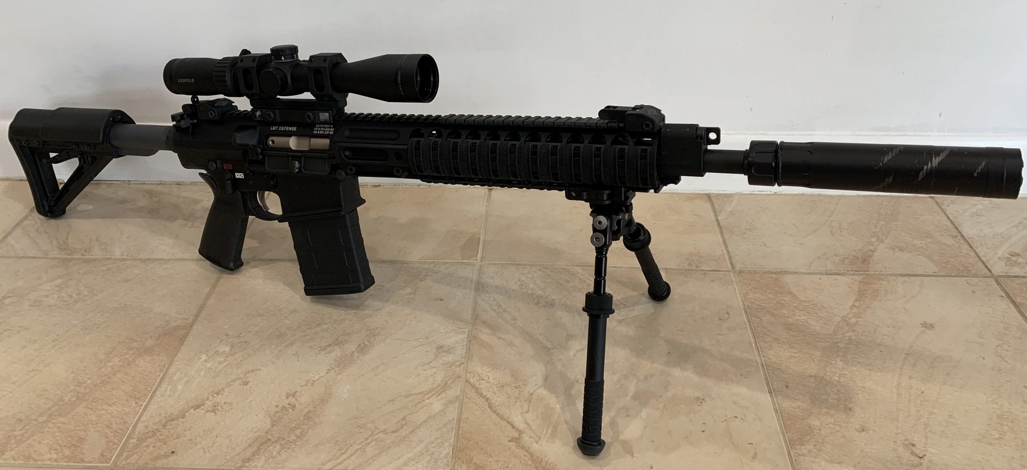

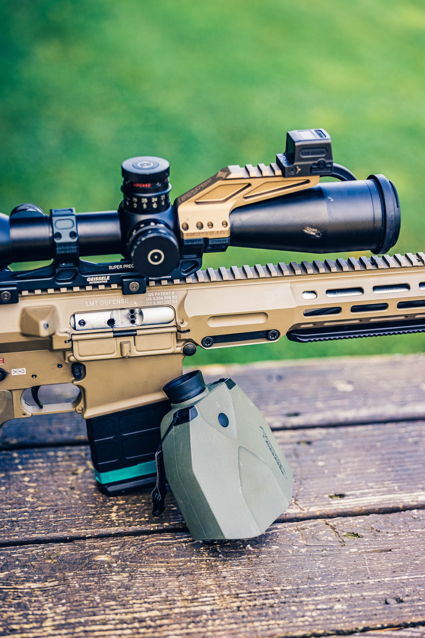

A few LMT .308 piston barrels and bcgs hit gunbroker recently, and even though I just finished my MK12, I caved and picked one up. They’re overruns from LMTs Estonian Defense contract. It’s heavy, weighing in at 14 lbs fully loaded and as pictured. I’ll follow up with a range report when able.View attachment 7727743
Now THAT. Is interesting. Thanks for sharing.

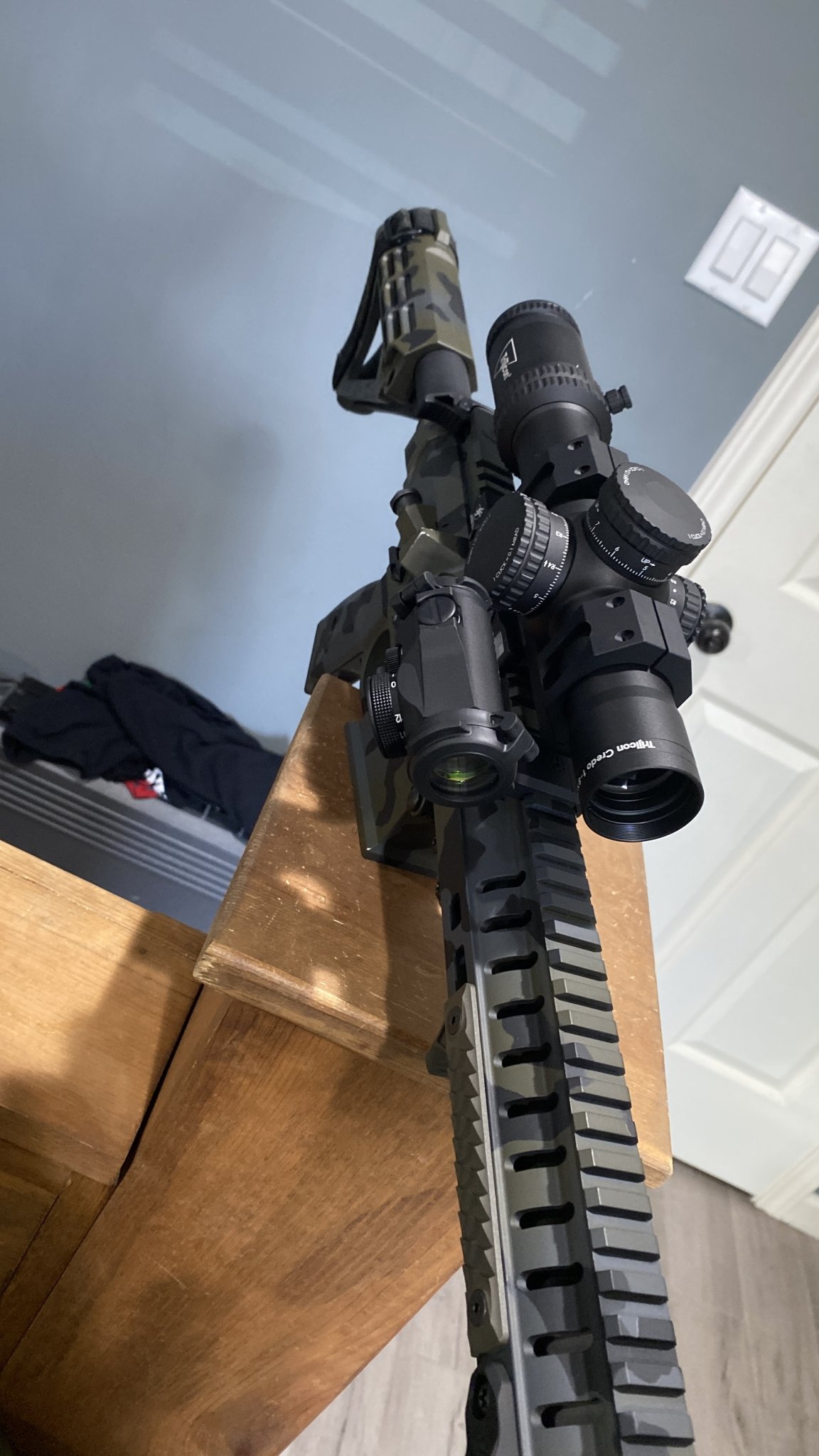

SiCo Flash hider
BA Hansen 12.5” Barrel
Surefire duel fuel with trex arms extension
Cmmg 9” handguard
Superlative arms adjustable gas block
JP low mass bcg and high pressure bolt
Geissele g2s-e trigger
Geissele super charging handle
Tubbs flatwire spring
Custom weighted buffer from CTS trimmer
Sba4
Executive ordinance grip
Dragon scale rails panels
Trijicon credo 1-8 in ADM mount
Ariska 45 offset and T2

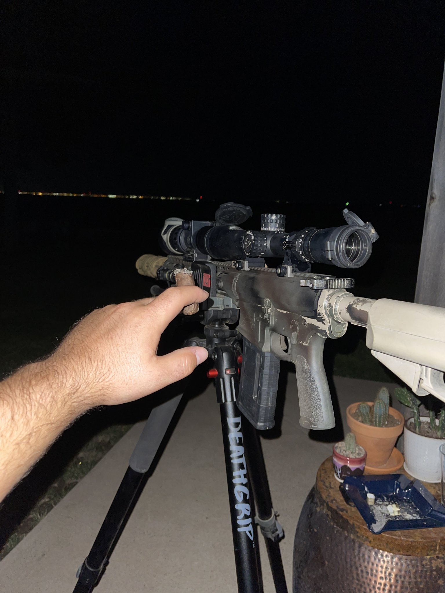

Custom black multicam by myself.

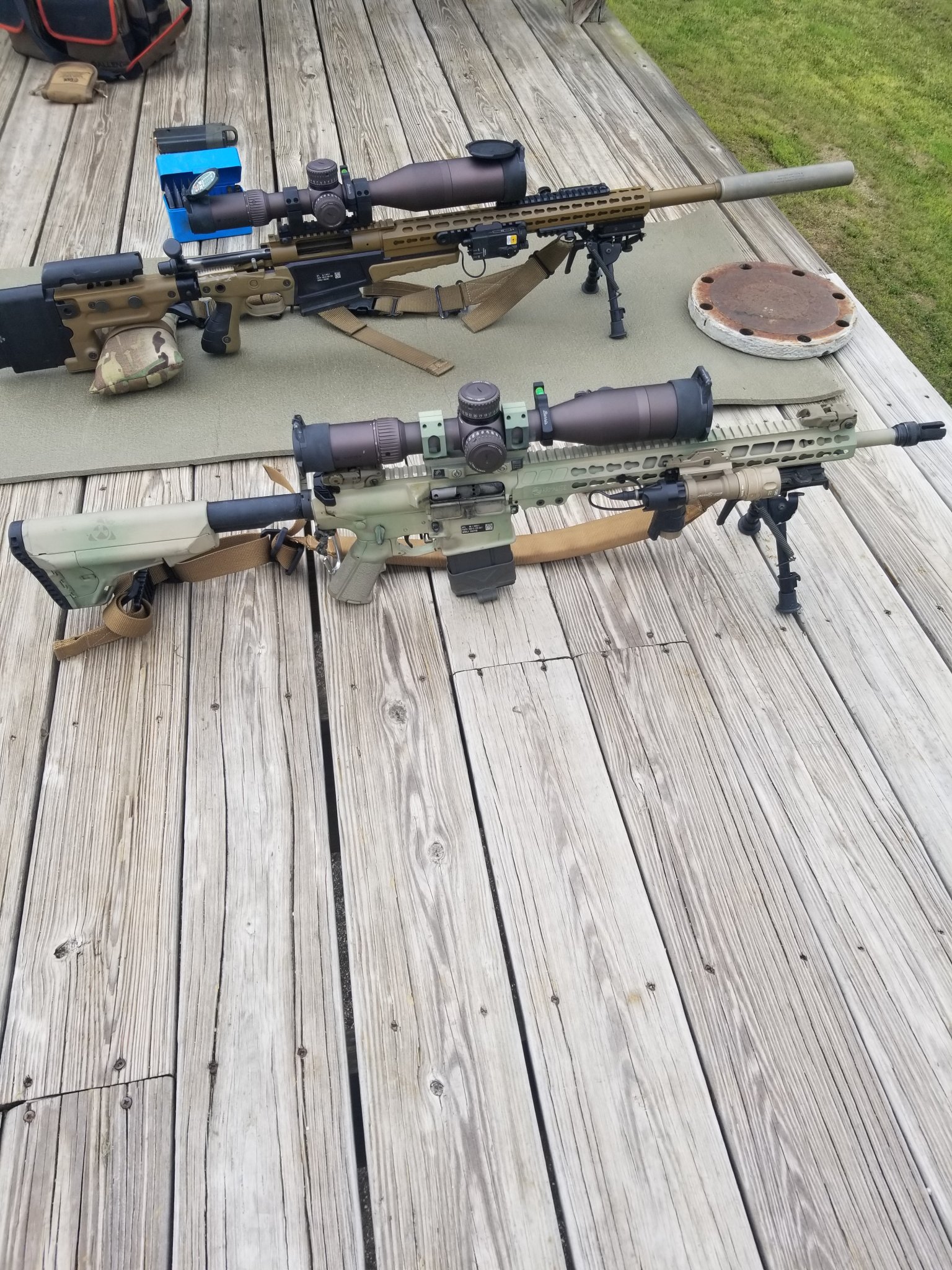

LR243:
-AP M5E upper and lower receivers
-X-Caliber 24" chromoly barrel, .243 Win, 8:1 twist, AR-10 HBAR profile, rear fluting, .0935" gas port, rifle-length gas tube
-AP BCG
-SLR Rifleworks .750" steel adjustable gas block
-Rifle length buffer with tungsten weights (8.85 oz)
-Mil-spec charging handle with Badger Ordnance Tactical Latch installed
-AR-Stoner Precision (3-port) muzzle brake, 5/8-24 thread
-Geissele SSA-E trigger
-Timney 45/90 ambidextrous safety
-15" AP M5E Gen 2 M-Lok handguard
-Magpul PRS 308 Gen 2 stock, MOE grip
-Vortex PST 6-24X scope (MOA), Nightforce 20 MOA base/rings
LR308:
-Ballistic Advantage 18" chromoly barrel, .308 Win, 10:1 twist, low profile gas block, rifle-length gas tube, birdcage muzzle compensator
-AP BCG
-Carbine length buffer (3.80 oz) (intend to swap to heavier buffer)
-Geissele SSA trigger
-Mil-spec safety
-12" AP M5E Gen 2 M-Lok handguard
-Magpul UBR Gen 2 stock, MOE grip
-Nikon P-308 4-16X scope, Nightforce Ultralight rings
-Magpul MBus Pro Offset steel sights
LR45:
-AP M5 upper and lower receivers
-X-Caliber 16" stainless barrel, .45 Raptor, AR-10 Heavy profile, 20:1 twist, .0935" gas port, mid-length gas tube, thread protector
-Brownells LR308 Nitride BCG
-Mil-spec charging handle with gun show tactical latch installed
-SLR Rifleworks .875" titanium adjustable gas block
-Geissele G2S trigger
-Magpul MOE Carbine stock, MOE grip
-Vortex SPARC II red dot sight
Built a new rifle - Aero Precision LR308 with 24" barrel similar to my LR243 build. So far, SMK 168 and IMR 4895 handload development is going well - best 100 yard 3-shot group.

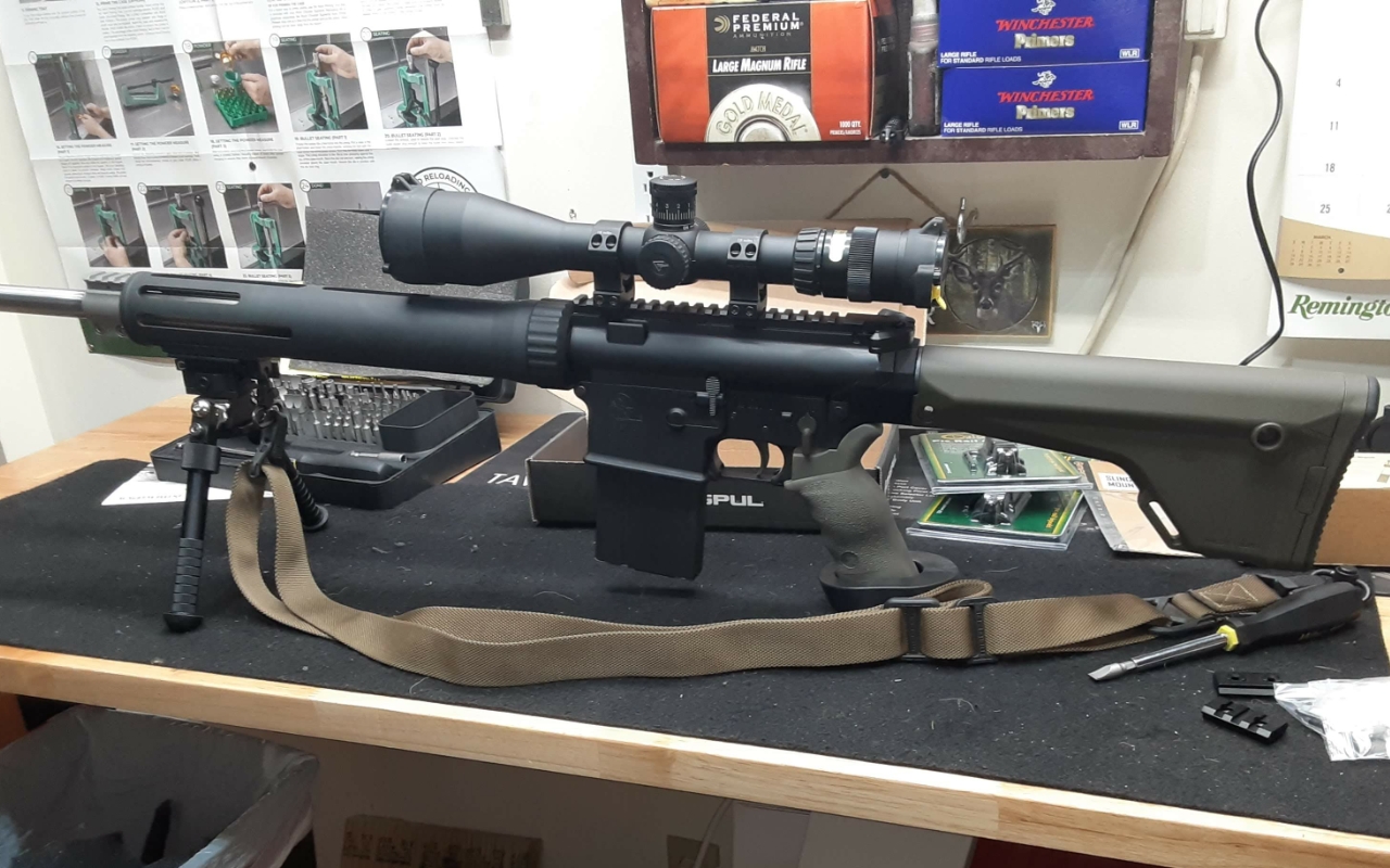

-Magpul UBR Gen2, MOE grip
-Crimson Trace 4-16x FFP (MOA), Nightforce Ultralight rings
I finally got my 338FED upper mostly assembled, still waiting on WC to send their Intermediate gas tube, it measures 13.25”
Upper build is as follows
2aArmament Xanthos Upper Receiver
16” WC 338FED
RifleSpeed AGB
WC gas tube
SmokeComposites HG
JP VMOS w/ JP HP Bolt
SiCo Hybrid
NF 4-14x40 SHV FFP in NF mount
