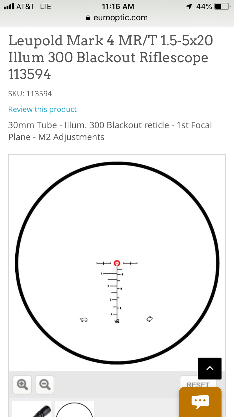

If it’s like 300 whisper v 300 blk, more better factory support for firearms and ammo and scopes
I would imagine that the heavy 338 subs have a pretty similar trajectory to the 30 cal subs and if so the optics would probably work just fine.

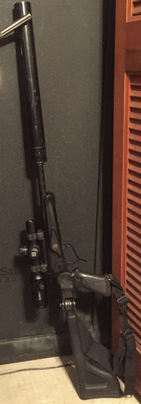

Yeah I was somewhat joking. Took that gun in on a package deal years ago. Finally able to shoot it now that Hornady makes ammo
