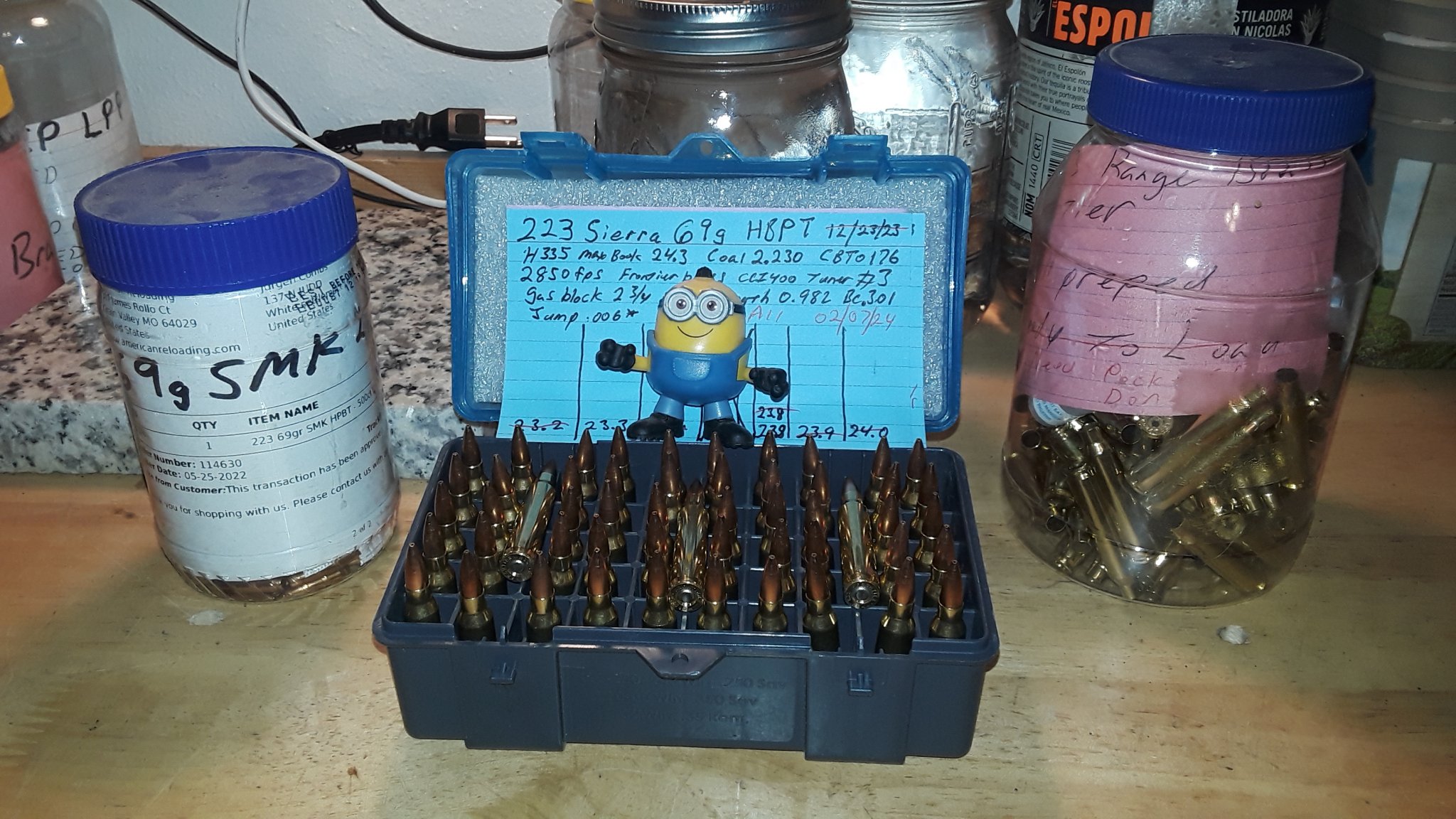

Not sure what if anything I was doing that delt with hornady 68g bullets?
Today I re measured my chamber and the Sierra 69g bullets.
I found the error in the load and where the data came from.The source of the discrepancy has been advised.
I will have to redo my tests without the bullet starting in a jammed condition.
Suppriseing how far a bcg will slingshot a projectile to get into battery.
Update: Removed the word "bad" from in front of data.
Just strange to me that 0.025 thousand difference in coal for different powders listed on same pages.
Wee haw
All the tac / 69g data runs them long.
Hit my lands and caused some pressure .
Funny the H335 loads with the same bullets run shorter and don't hit the lands . Faster than the tac but at that rate figure the node to be narrower towards the top.

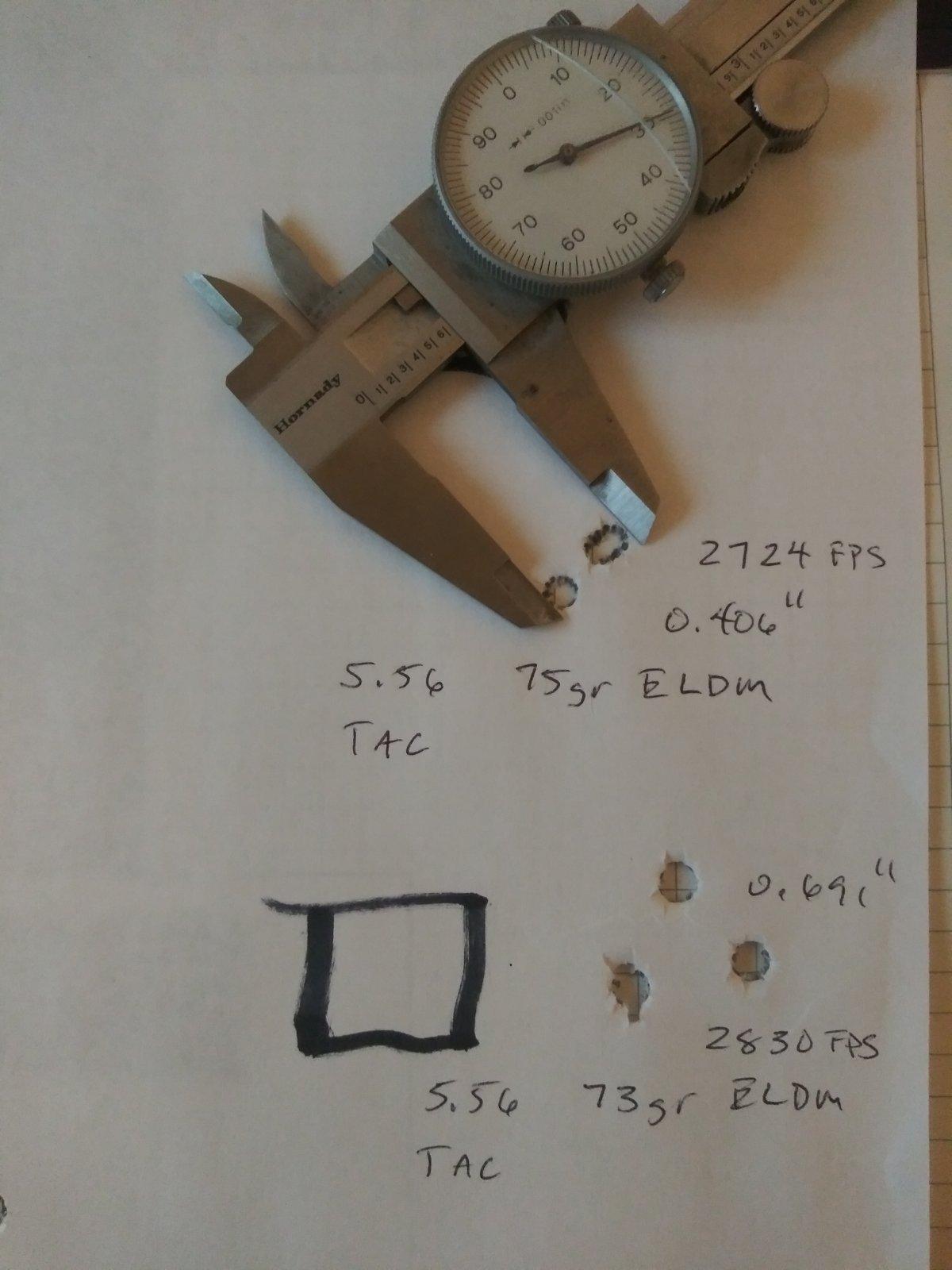

Anyone loading Hornady 75 AMax'x to Mag. length ?
I use ASC mags and load 73 ELDMs out to 2.300". I tested 75 ELDMs at 2.380" ish single fed. but if I cut out the front of my ASC mags I should be able to seat out around 8 rounds to 2.380" without modifying my magwell. The 73 gr EDLM is a max load, the 75 ELDM isn't. But both are the most accurate loads for the bullets so far.
Old school wisdom was 0.004 on semi auto.
I run 0.002 and a slight crimp on everything and have never found a problem.
I can do the shove test on a piece of wood and can't move it, also measured some that were chambered and removed up to 6.5g and no movement.
Also have been hard to remove in an inertial puller.
I have not tested anything larger.
Reactions: 232593 and Balor

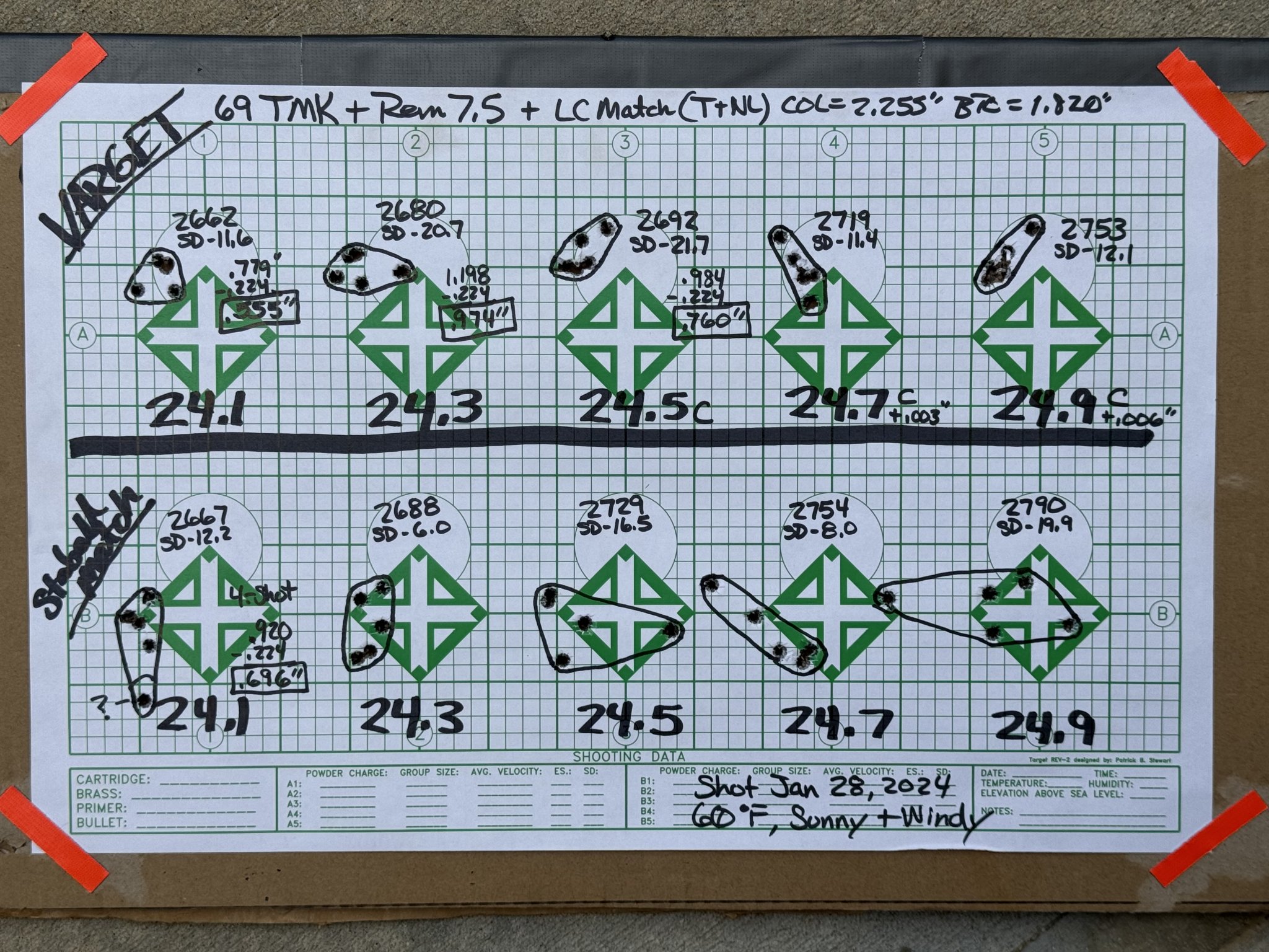

Did some comparisons of Staball Match vs. Varget using the same exact loadings. I did this with several different bullets, here is the 69 TMK as an example.
Are you sure you are not in the lands ? I had to drop all the way down to 2.230 inches to stay out of them on smk 69's. (0.006 jump)
Half the data out there said 2.250 and the other half said 2.230 coal.
Are you testing powder and changing seating in the middle of that?
Reactions: Balor
No where even close to the lands in this AR rifle.
In my varget vs. Staball match comparisons…charges with a ”C” out beside them means compressed. If it has a “+.00x” out beside it, that means it’s compressed and with the same seating die setting it grew that much longer. None of the Staball match loads are compressed.

Looked like loads when I was in the lands, over pressure signs would not come that last bit togeather no matter what.

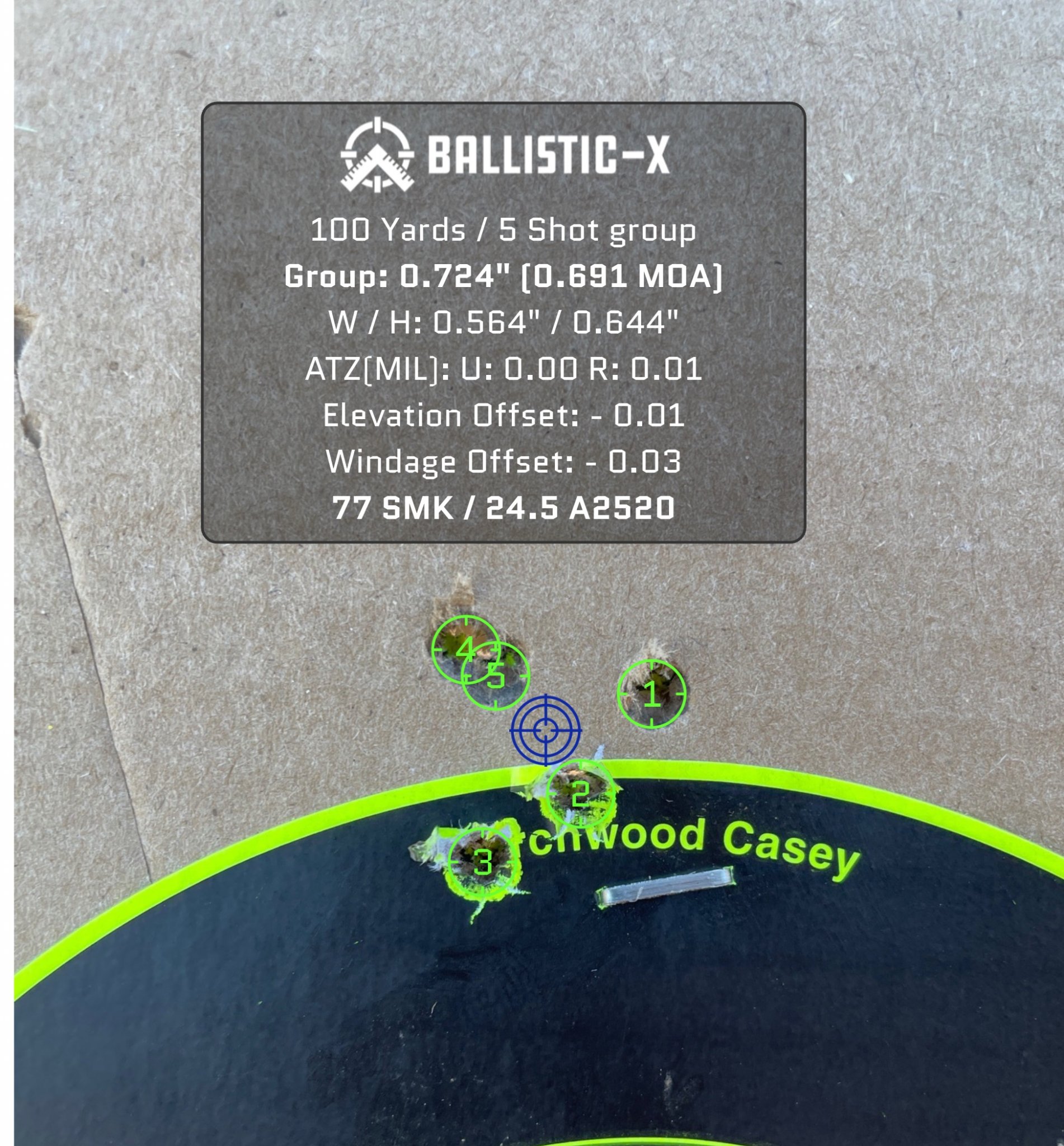

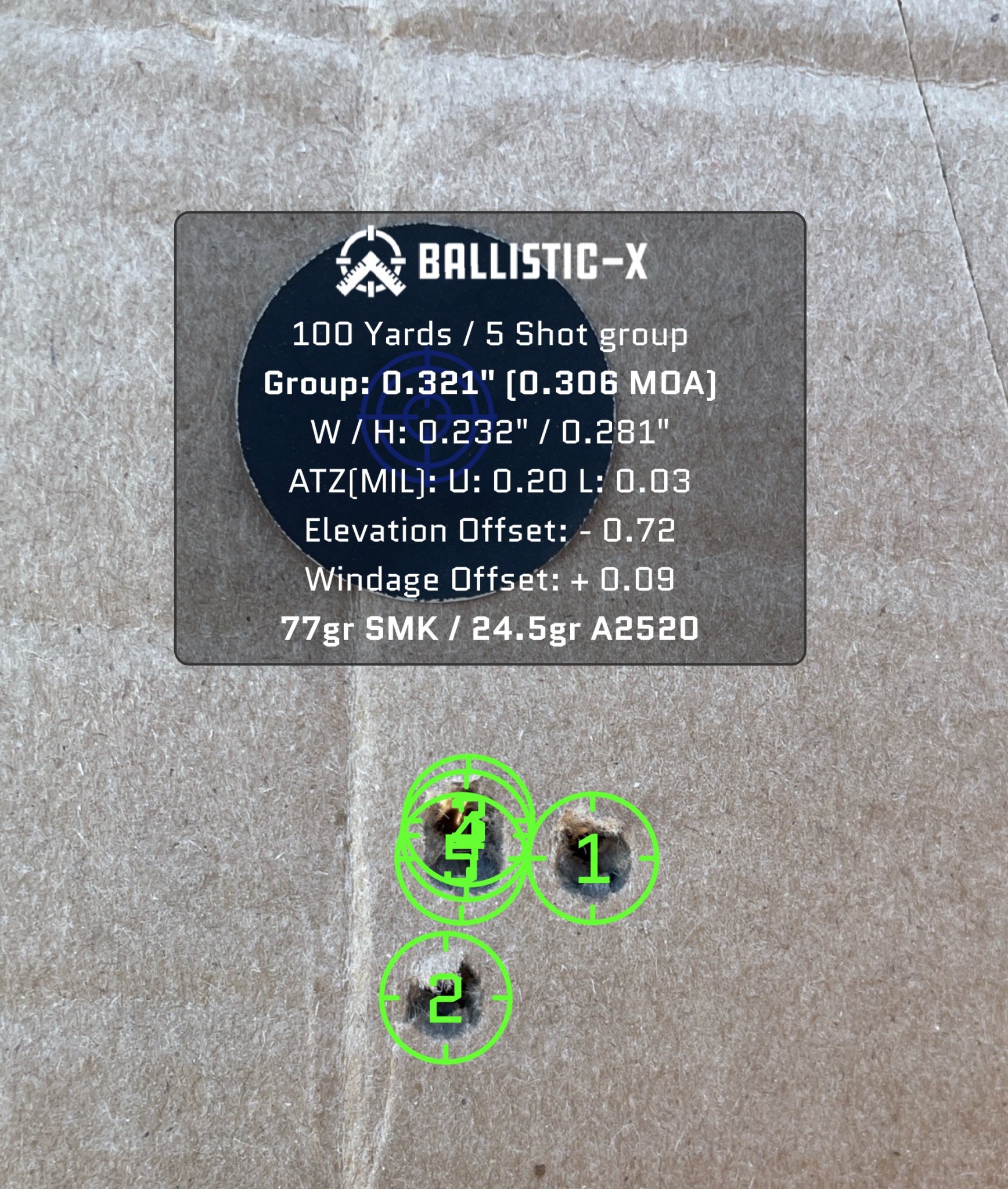

I kept load development it REAL simple. Loaded 24, 24.5, and 25 grains of A2520 with 77gr SMKs, CCI #41, Lapua Brass, and 2.260" COAL and hit the 100 yard range. Needless to say, I'm pretty happy with Accurate 2520. I caught a couple shots on my my buddy's Garmin chrono around 2,730 fps. Curious how this load will perform at 600. I think the 0.3 may have had a little luck involved - but the load clearly shoots.
My first venture with 2520 and 77 tmk's was similar. Winchester standard small rifle, 24.5gr of 2520, oal. 2.245, LC cases. Came in around .75moa.
I was trying to make 25.0gr work but it was hit or miss. Dropped back to 24.5 and bingo! I've got 50 loaded to verify at distance but I'm seven twelves for the next nine weeks at a minimum so it'll be a while before I get to shoot them.
Edit to add, this was in a 14.5" pws.
