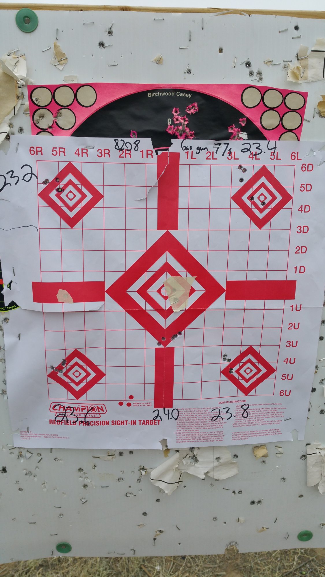

I've been struggling a bit with my white oak too, although I've only had it our a few times working on loads and I probably suck at shooting a has gun. This is the best I've done. If it'll shoot the 23.2 load consistently I suppose that would work.

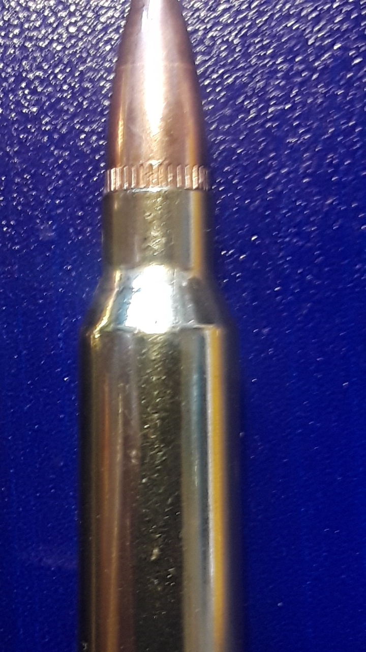

I use a Lee collet type crimp on ar rounds. A separate step that is not hard to set up.
Basically you can watch the gap in the collet close from the top.
You start by turning the die down till it just touches a case and make a timing mark on die and press.
That is zero, then turn it down till you see the collet close compleatly without a round and mark that.
You can make 3/4 1/2 and 1/4 timing Mark's by eyesight.
I like a slight crimp at around 1/8 to 1/4. That's just enough you can tell it moved tha brass and smothers off that square end.
It's not what everyone wants to do but that's how I do it.
Hard to get a good picture of.
I forgot to mention that I have LC brass that was prepped by a co a while back. I measured the prepped brass and some of the same brass that I've shot ( now twice fired ) after being run through the die, My brass takes a .222 minus pin ( snug ) , whereas the prepped brass takes a .221 minus pin with less effort. The mandrel measures .2237 .
I do have the Lee FC die and will mess around with that this weekend.

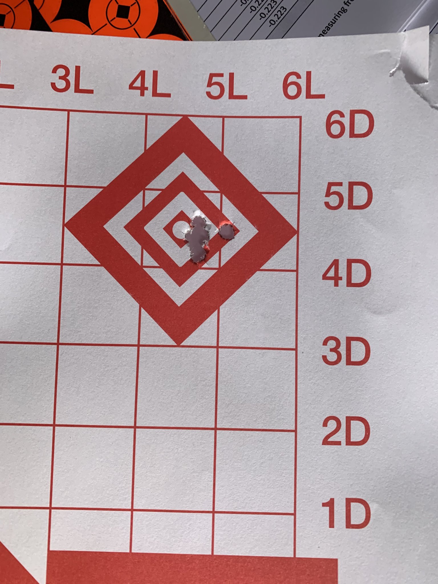

Staball Match
25.1 2772 /SD 36/ .822" all @ 100y
25.4 2804 /SD 11.5/ .819" light swipe.
Will try 25.7 next & load out to 2.295
Accurate 2520 best accuracy
Same brass & bullet
25.1 2735 / SD 6.0 / .464"
25.4 2786 / SD 10.0 / .175" light swipe

Vit N135 of note, the speeds below exceeded Gordon's prediction by 100fps with the N135
23.4 2825 / SD 23.4 / .479" This is top load for N135. light - Med swipe, but SD sucked.
23.7 2859 / SD 8.6 / .735" medium swipe
24.0 2877 / SD 8.1 / .336" To hot, N135 seems to get spicy/erratic on top end loads.

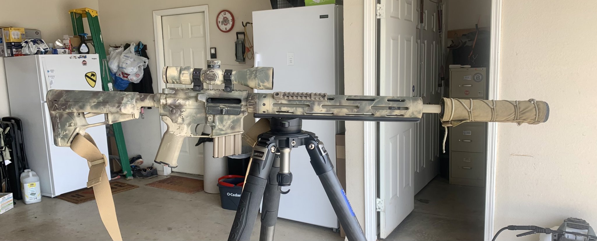

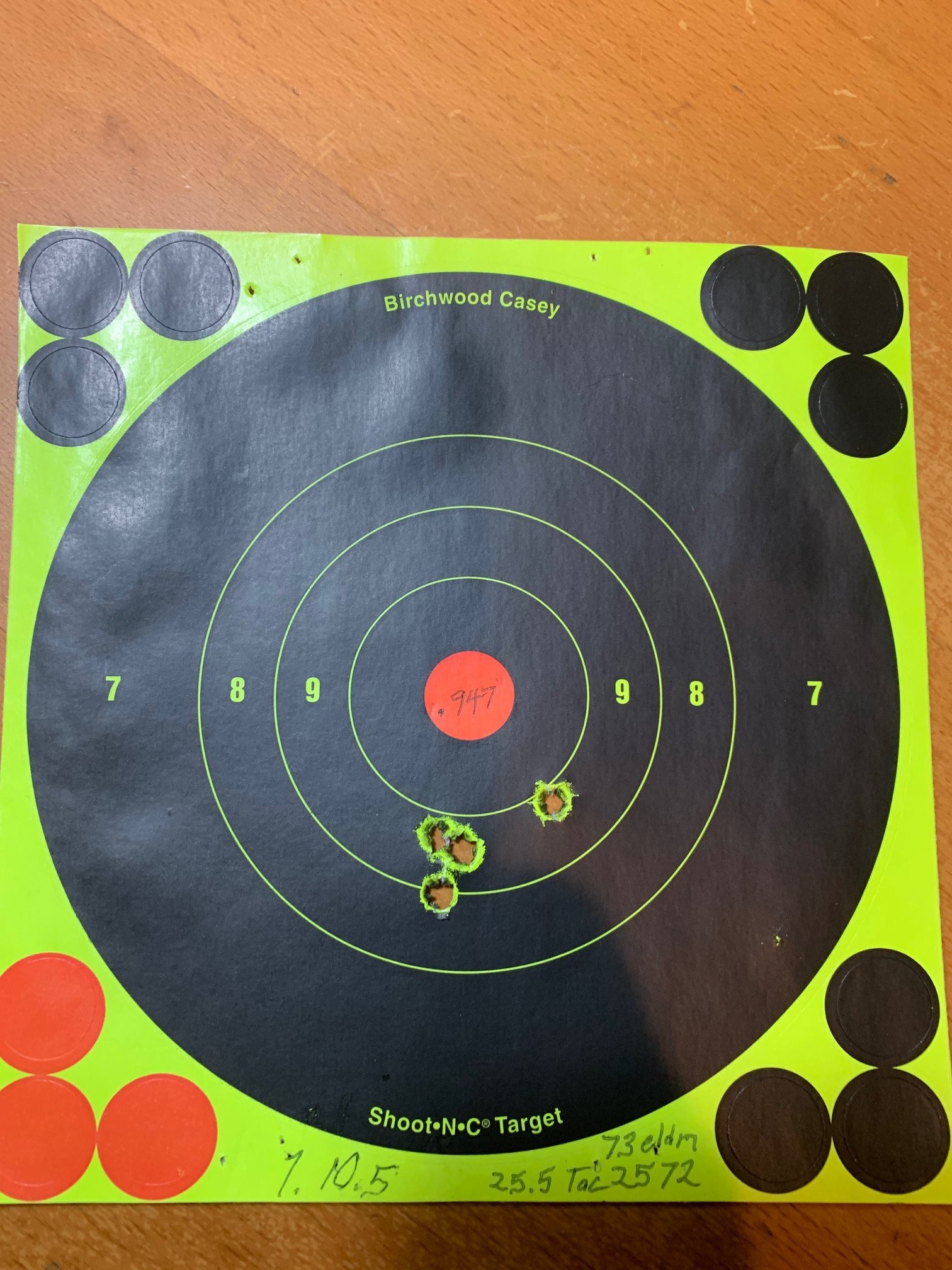

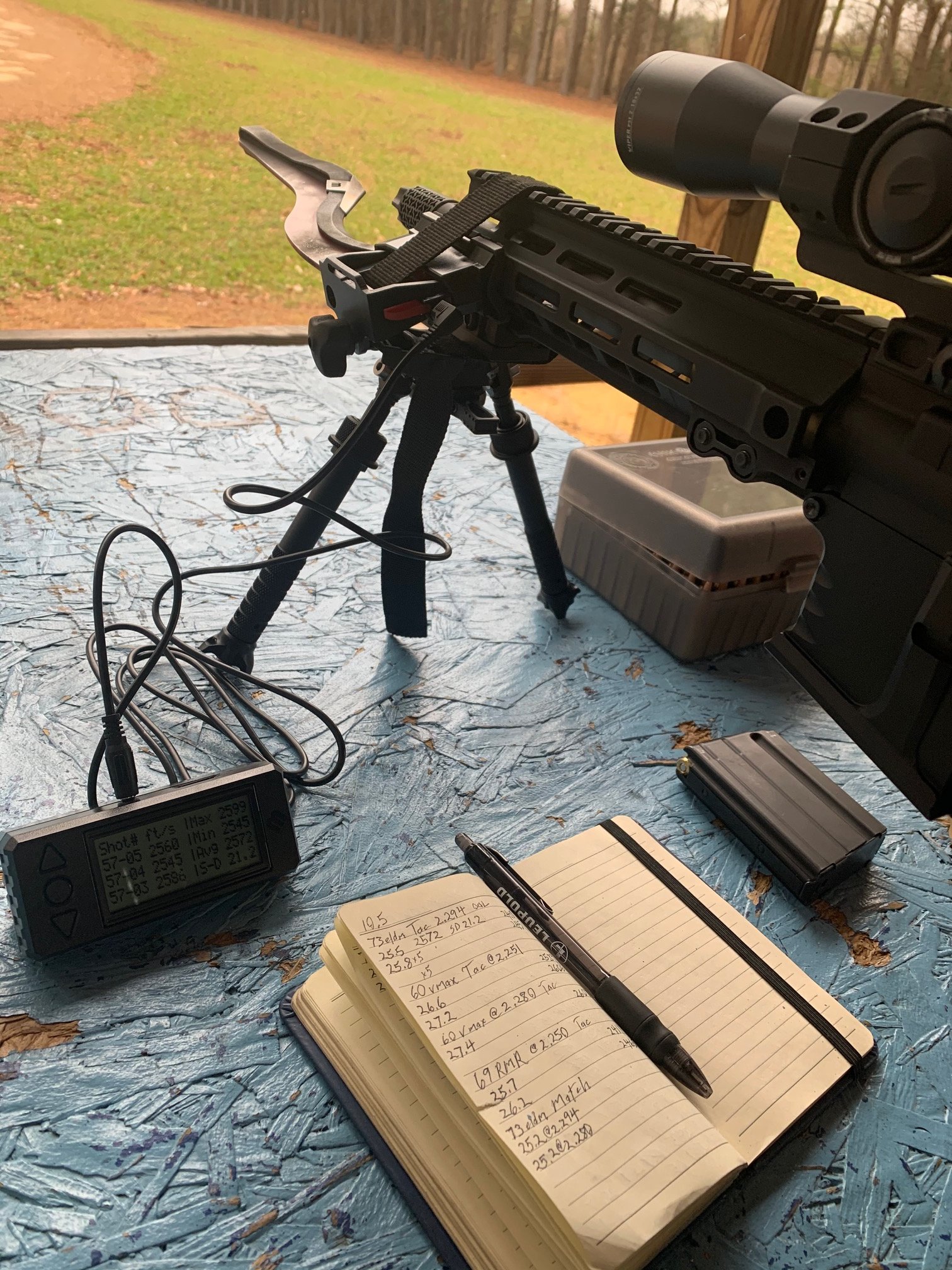

Working on some short barrel loads now.
This is a first attempt. For now this shorty is wearing a PST 2-10. Once I get a few loads I'm happy with it'll get the Gen 2 Huey.
10.5" Craddock 223W 8T Carbine gas
Precision Armament EFAB brake/flash hider
Seekins adj. GB
Geissele MK 4 9.3" rail, Super Charging handle, & SSA-E trigger.
BCM thermal fir upper.
Win. White box 5.56 55gr used to zero scope & it was running 2739 Gas block was set for these.
Shot everything at 100Y bipod & rear bag.
All loads in Virgin IVI 223 brass.
73 eldm @2.294/1.838 no seating changes yet.
Staball Match
24.8 2398 / SD 19.9 / 1.752" yuck
25.1 2438 / SD 10.4 / .807" *
25.4 2454 / SD 12.8 / .863" *
25.7 2473 / SD 17.0 / 2.03"
No pressure on any of these so will push higher & see if it tightens groups back up.
Did not cycle with any of these. Needs more gas.
Vit N135
23.4 2464 / SD 15.8 / 1.743"
23.7 2497 / SD 9.3 / 1.981"
24.0 2522 / SD 15.2 / 1.807"
24.3 2551 / SD 15.6 / 1.723" Cycled with top loads only.
Hornady 75 BTHP @ 2.285/1.860
Staball Match 25.7 2450 / SD 13.2 / 1.475" did not cycle
Vit N135 24.3 2545 / SD 8.4 / 1.085"* cycled well 3:30 ejection

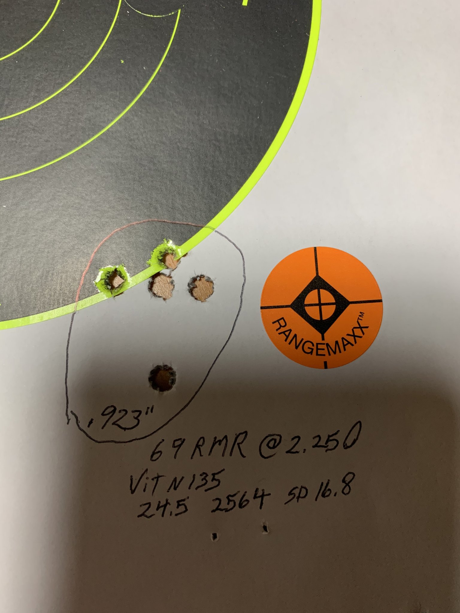

69 RMR @2.250/1.885
Vit N135 24.5 2564 / SD 16.8 / .923" Now I know what to do with the 1K of these on hand. cycled well 3:30
Hornady 60gr Vmax @ 2.292
TAC
27.3 2855 / SD 22.9 / 1.56" did not cycle
27.6 2881 / SD 6.5 / 1.481" :eek: Holly shit! Gordon's predicted 2621 for this load. I don't know WTF is going on here but I like it. No pressure signs on this load at all. This one was on the edge of cycling, needs a little more gas
Let me repeat before you try this one!
Lever
28.6 2663 / SD 27.8 / 1.315"
28.9 2665 / SD 12.5 / 1.861" I think this is indicating incomplete powder burn as predicted. Speeds are in line with Gordon's
Top Lever load cycled.
I will be trying TAC with the 73 eldm in the next load ladder.
Reactions: TonyTheTiger

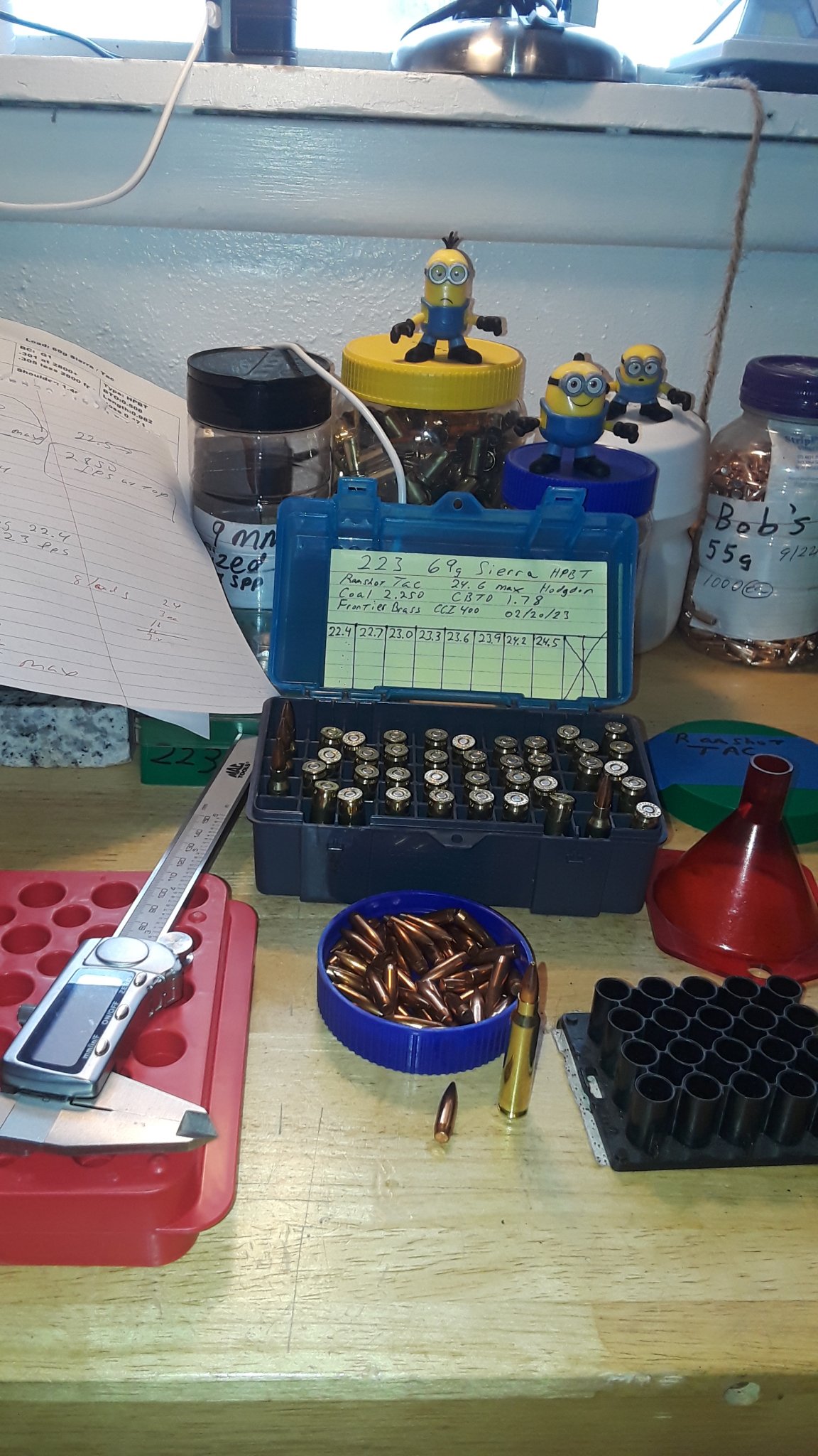

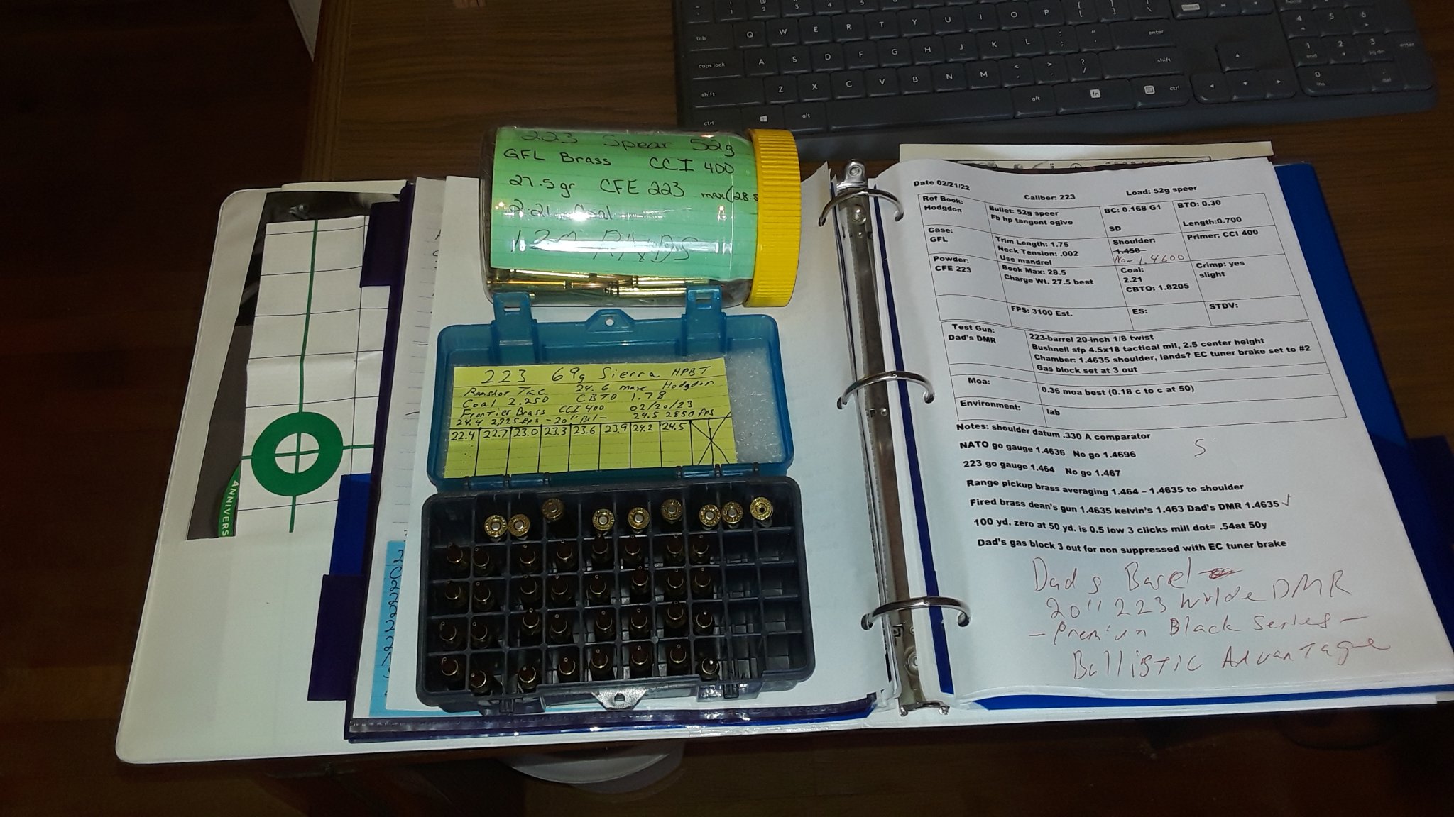

Need some experience with 69g Sierra HPBT and Ramshot Tac.
A Western Products page has it listed as :
22.9g / 2775 fps and 25.4g / 3049 fps 2.260 coal
The current Hodgdon site has it listed as:
21.9g / 2671 fps and 24.3g / 2921fps 2.260 coal
Some of my notes have been lost and not in the binder.
This project got delayed by request of the AHAES, took over the Dillon and time,
finally getting back to it.
(American Handgun Ammo Eating Society) Largely comprised of family and friends.
I realize it's old hat but I have no experience with Tac and wonder if it's like CFE 223,
ugly, -------- ugly, better, perfect, scatter, oh hell no, in 0.3g increments ?
I always do tac in .2gr increments . Not sure about a 69 gr. In my bolt gun I run 25.2 (a grain over max) with a 75gr ELD- MV = 2975
My AR I run 77gr smk and 24.3 gr in Lapua brass, 24.4 in Starline Brass, and 24.3 in FC (sucky brass don't recommend it) MV= 2850
I would start a few grains short of max and go up from there in .2gr increments if it were me
Reactions: simonp

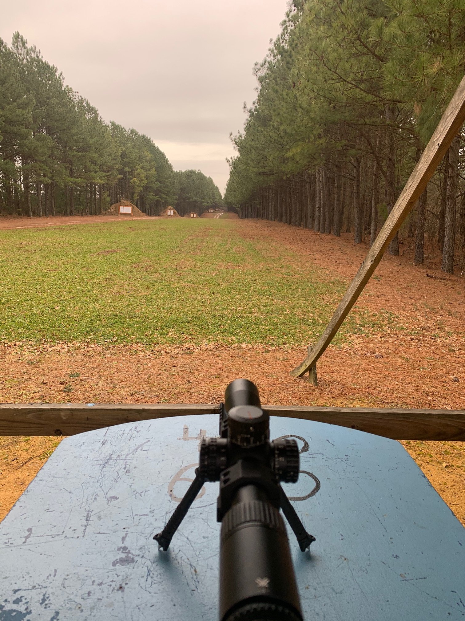

Follow up to post #328 short barrel loads.
Seekins adj. GB
Win. White box 5.56 55gr used to zero scope & it was running 2739 Gas block was set for these. Had to open it up 1/2 turn more.
Mainly I wanted to explore Ramshot TAC in this shorty based on the past outing.

Today I shot 2 loads with the 73 eldm, both loaded at 2.294
First up with cold clean bore.
25.5 = 2572 / SD 21.2 / .947" Shot to the right was first. 5 shot group. This load is pretty warm, but brass looked good. Going to back down a touch to 25.4 next outing & play with seating depth.
73 eldm 25.8 = 2603 SD 15.2 first 4 shots were .663" & I pushed the 5th low opening to 1.5". This load was to hot.
I couldn't believe the speed I got with the 60 Vmax's before so I tried them again.
60 Vmax @ 2.251 5 shot groups
26.6 2762 SD 25.4 / 1.173" brass looked good. Gordon's prediction 2539
27.2 2847 SD 20.7 / 1.385" Swipes & primers getting pretty flat. Gordon's prediction 2606
OAL bumped to 2.280
27.4 2871 SD 36 / 1.278" too hot primers flat & ejector starting to imprint. Gordon's prediction 2607
Based on the above I'll set 26.8 as the ceiling and play with seating depth. They liked jumping a lot in the Valkyrie.

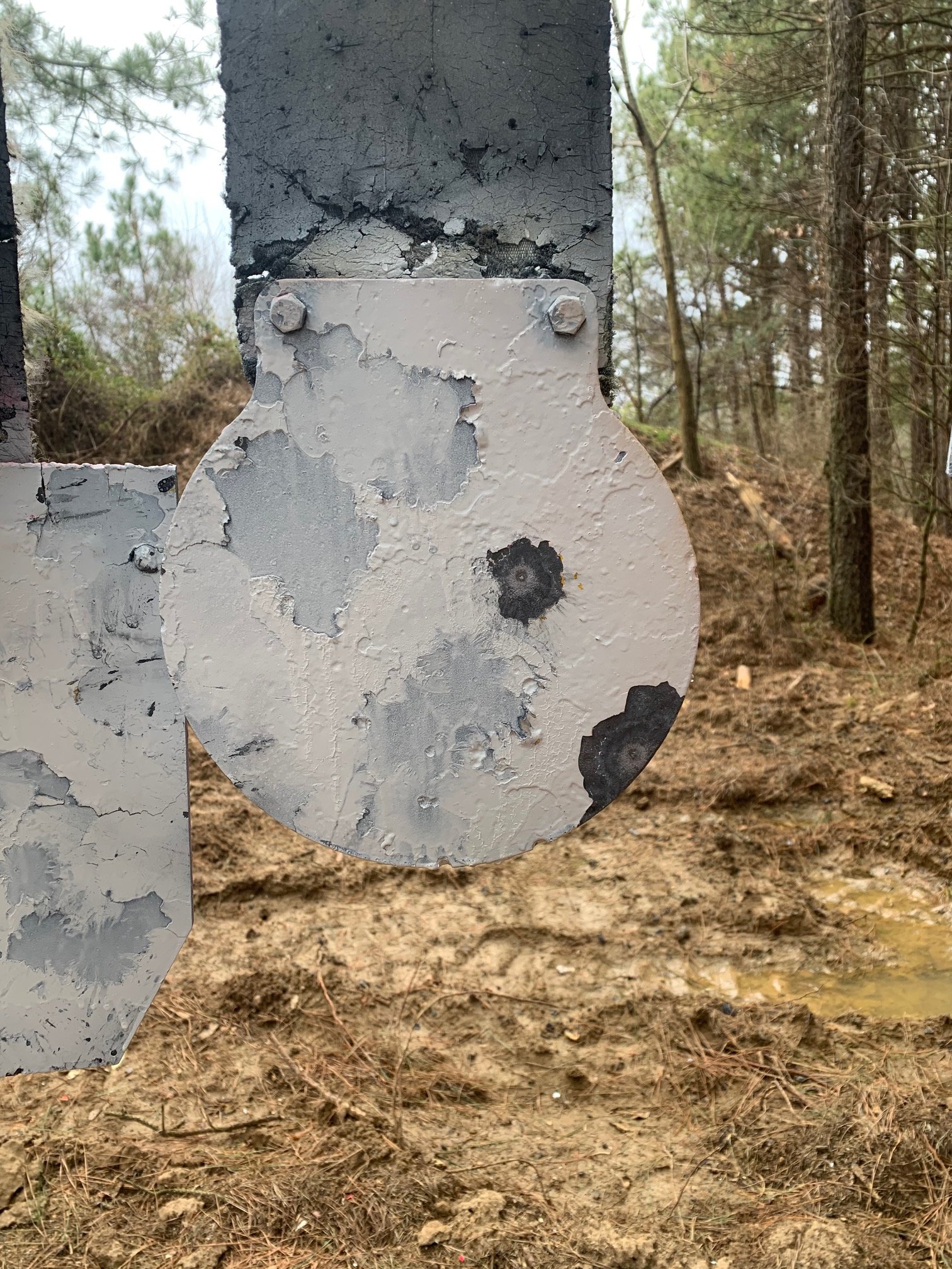

I had loaded an extra 5 of the 73 eldm's at 25.5 so for fun I took them to 600y steel 10" plate.
Plugged 2572 in 4 dof & dialed 5.2 mil. Went 2 for 5. Couldn't see the first 3 misses through the 10x scope. Wind is what got me. I started holding center & couldn't see misses. Moving hold to left each shot & hit last 2. Elevation was pretty spot on.

My first batch with the RMR 69g
"Clones"? Loaded today.
I wrote Sierra since that's the load data I used.
We will see soon.
I've got a pile of the little load cards that manufacturers include in a box of bullets... But, like you, I just use a 3x5 index card. Hard to beat.
I got tired of having to do repeat tests because I forgot what worked well... So I circle the charge that performed best, date it, staple it to the target, and throw it in a manila folder for that gun.
Getting old sucks.
Mike
Reactions: Lightning8
There is some software out there that organizes all this load development but got tired of buying and maintaining software.
Made my own word document template. I just copy rename and change the info. Changes are scribbled in red ink till redone and printed. I use a printed copy of the saami spec in a sheet protector to separate calibers.
The 3x5 cards start by using the back side to document stage / cycle of brass worked .
Then the load development card in the ammo box, final working round in a free container.
Retired / fixed income so this stretches the budget.
I take pictures of the targets then toss those out.
By the way the peanut butter tub holds 120 rounds of 223 and a small desiccant pack nicely.
Kind of a way to meter out allocation.

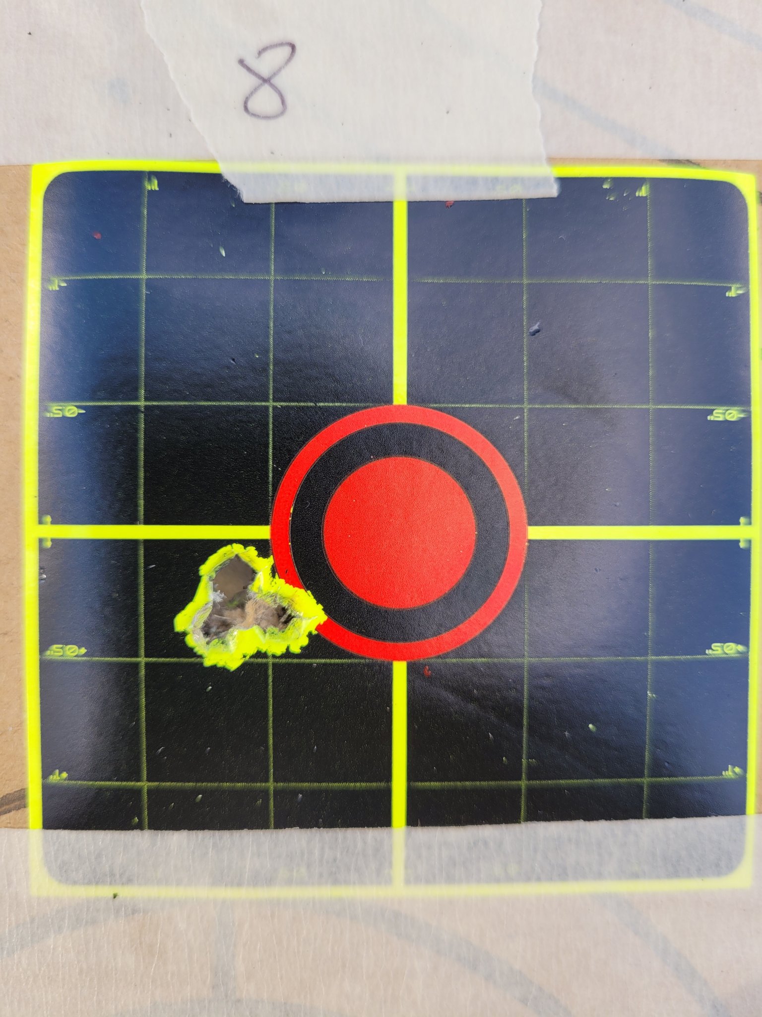

Took my AR out today just to do a seating depth test on the new barrel and might just call it good.
Noveske upper and lower
JP hand guard
CLE Douglas 1-8 at 18.1”
Rifle length gas with Superlative block
Wylde chamber
TBAC Ultra 9 30 cal
135 rounds on the barrel
77 SMK’s
Varget 23.4grs
OAL 2.265
Lake City 1x fired mixed date
CCI 400
2601fps
SD 9.5
ES 20
5 shots at 100yds .452
I’ll probably still test it up to 24grs but this is not bad where it’s at.
