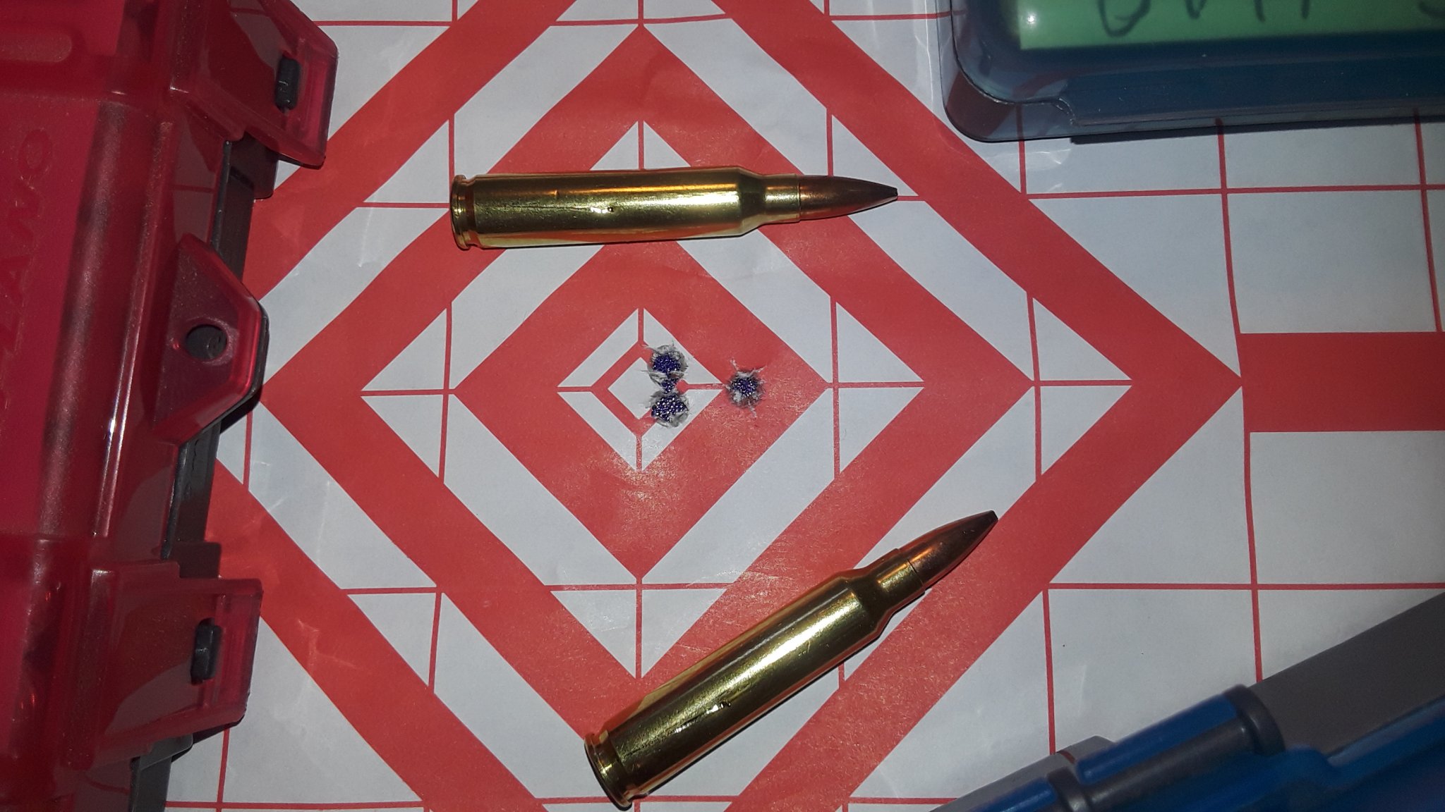

Ok I might have a chronograph giving me a bad reading. But two three shot groups of 53 gr vmax, over 25.0 gr Benchmark, Winchester case, WSR white box primer giving me 3284 fps from 20" HBAR 1-9". No pressure signs. This is the second time I've gotten this velocity reading. I'm just checking to see if anyone else has gotten close to this velocity. I got these readings in party cloud to cloudy skies. I'll try again when it's better lighting.
Sounds about right to me. 25 grains is just getting started with benchmark and a 53 grain bullet!!!

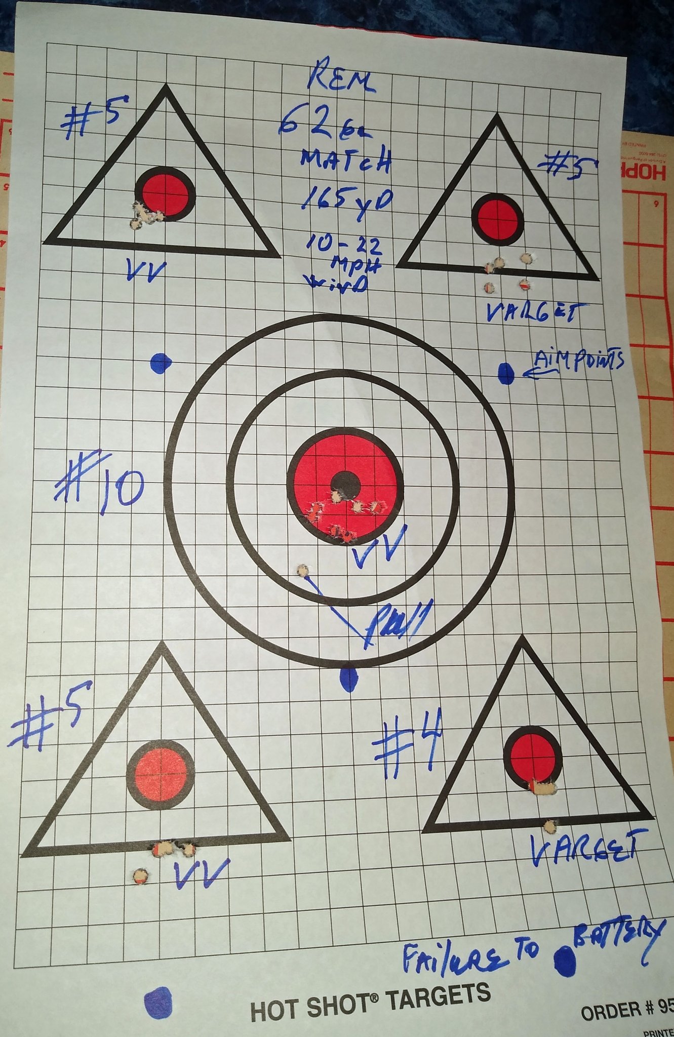

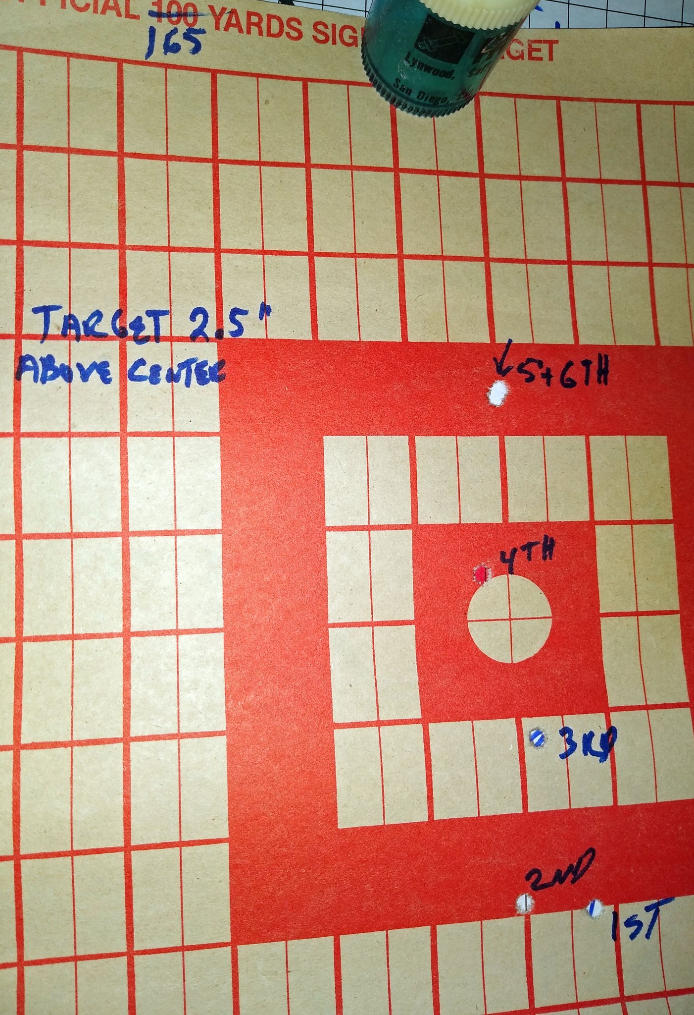

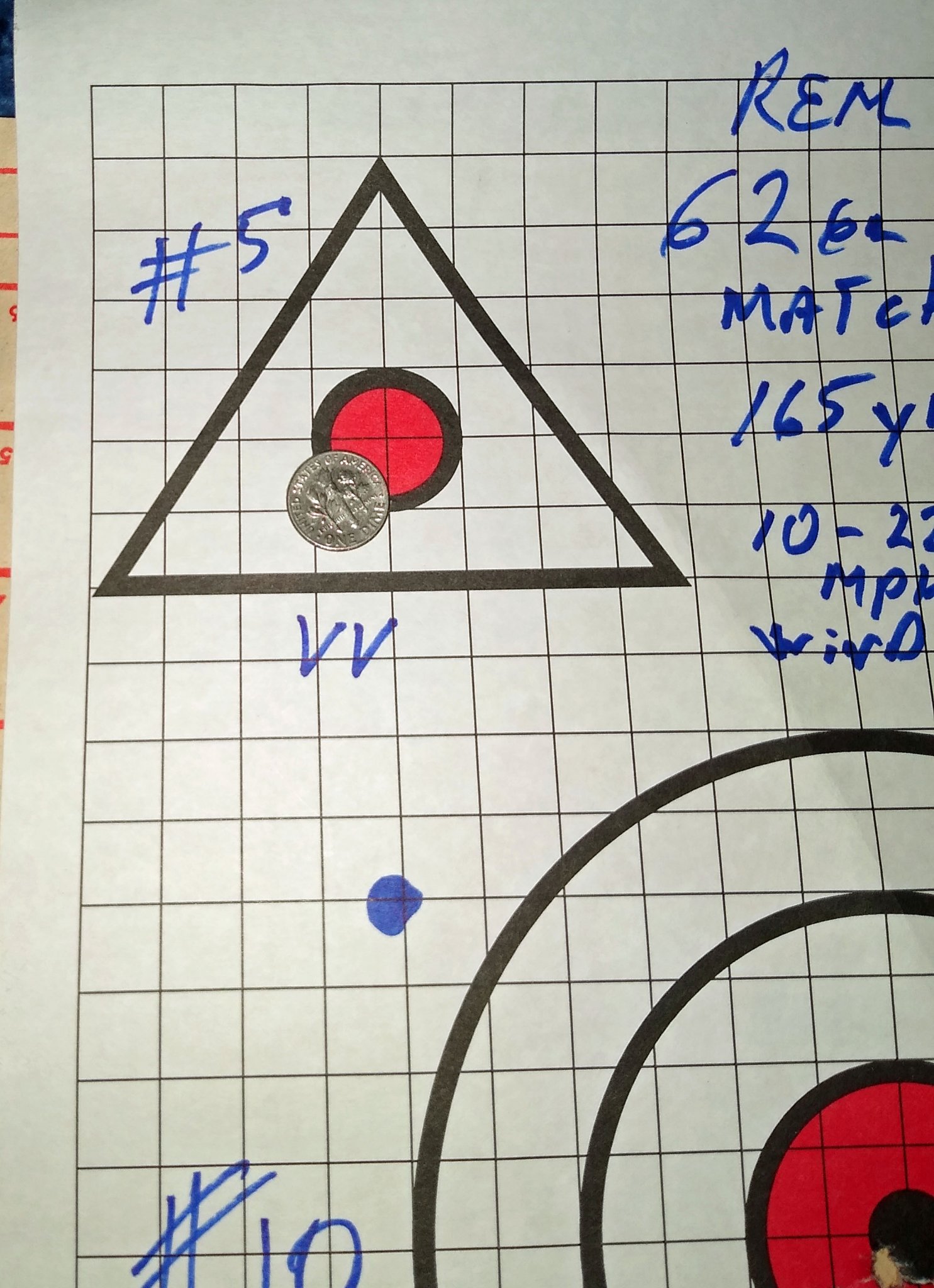

FYi : I ran a group of 5 X 5 for New build ,along with 5X3 intentional spp srp smrp with #3 different powders Extreme spread ran 72 Fps .
Load examples BLC-2 , 26.5 gr. Varget 25.6 , N140 25.6 W/55 gr. pills . All behaved and stayed on paper . As this was multi purpose ,small rifle case goes bang with any primer ,velocity varies as I should imagine small pressure variation would also . I had lose primers lying around of various manufacturers and wanted to dispose of the orphans . I was simply putting rounds down stream for function and later with known loads for barrel assessment and scope zeroing .
I wouldn't recommend doing hodge podge primers at LR but most certainly didn't hurt at 165 yd .
...I found that reference to using small pistol primer (spp) interesting.
I had some lose primers lying about and decided to use them . I had already filled ammo boxes and had NO room for spares ,so I hopefully have dispelled the myth about spp srp and smrp I would suspect smpp would do the same . Larger cases and tubular powder could be very problematic ,as dependable burn relies on proper cone ignition and BAD things would more than likely occur .
Small case as long as there';s sufficient powder ,not much chance of error .

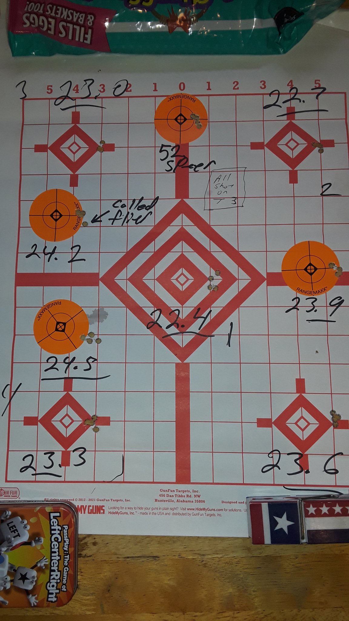

Been anticipating this test for a while. Rain wind, screw it, on to the lab. (50 yards) could not wait any longer.
Well going to like 69's over tac.
Deciding which one is harder than usual.
Also found my 1/2 inch discrepancy in math.
Something about adding 1/2 inch more riser under the scope maybe. Lol

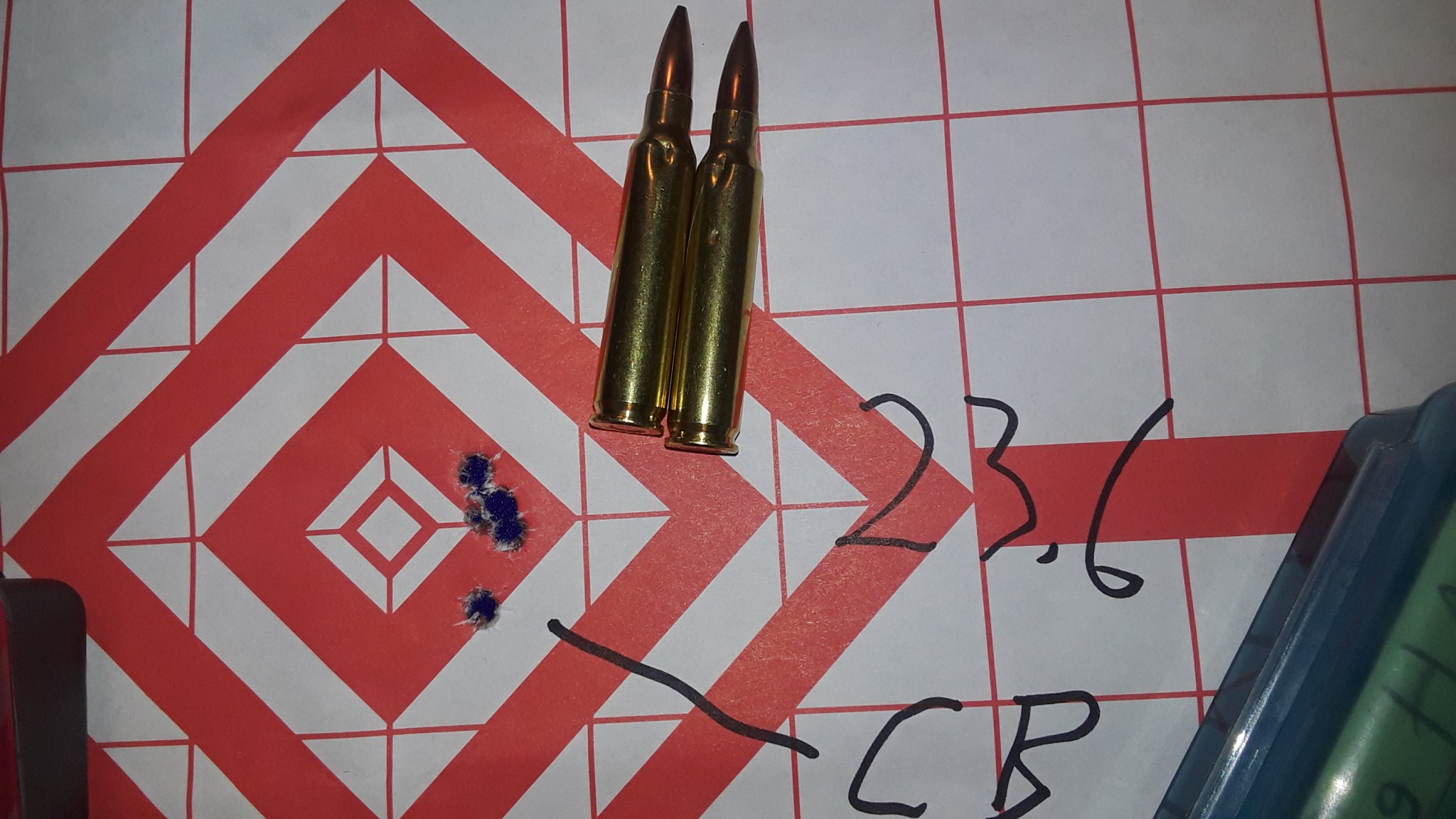

Well back at the 69g SMK over Tac.
Looks like the 23.6g is the winner.
Now for the bad news.
I have had 3 failures to feed, one last week and two this trip.
Bullet all beat up not in battery. A defining click of silence.
A couple other loads near book max in 52g and 55g preform well under moa
and have not malfunctioned.
Come to think of it a couple different failures to lock back on empty mag also.
Which leads me to believe the 69g needs more gas than the lighter bullets?
It seems backwards to me but yes the are moving much faster. (400 fps faster)
Anyway the handguard will have to be drilled or notched to get to the adjustment screw. Pita
One pix has the first cold wet bore, I forgot to foul it.
And two different sides of the failure to feed bullets.
These were shot at 50 yards from a bench with bags.

I wonder if trying a different mag will help. I had something simular happen with some of my 53 gr vmax loads. After looking I'm sure my mag spring is on the weak side. Changed mags and running fine.
