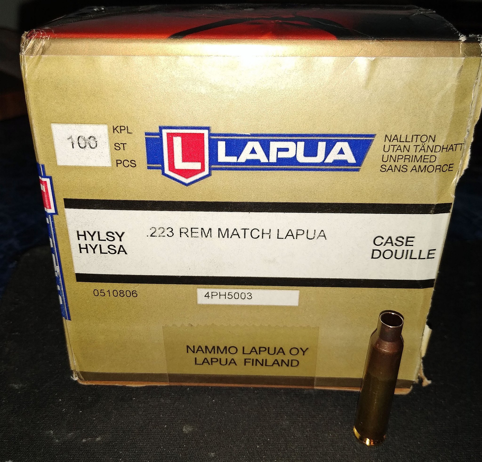

Yep Lapua makes Brass cases and at one time reasonably priced . Box of 100 X #25 to a case ran Me $285.40 delivered a lifetime supply #2500 Match cases . Late 80's through 90's L C Cases have also served Me well .

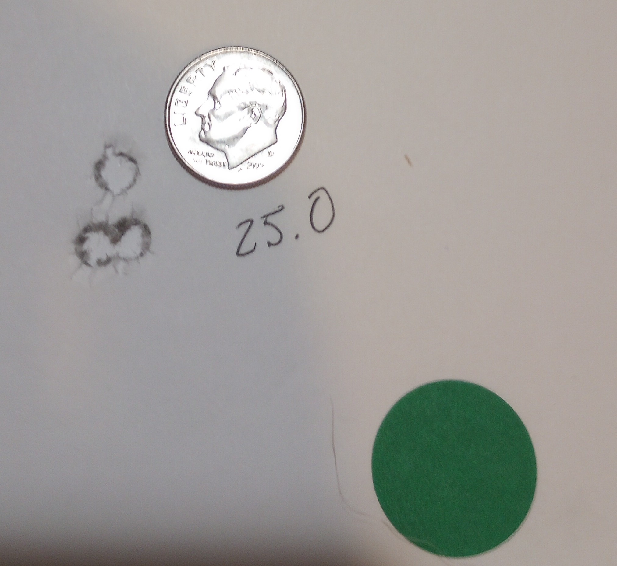

AR-15 chambered in 5.56 NATO
16" x 1:9
LC brass
CCI 450
69 gr SMK
CBTO: 1.846" (COAL would be 2.255-.260)
Research on the interwebs said AR Plus is similar in burn rate to AA 2230. So I cross referenced Western Powders AA 2230 5.56 69 SMK load data against the Shooter's World 5.56 data... SW didn't have a listing for the 69 SMK, but they had data for the Hornady 68 BTHP and a Nosler 70 gr bullet. I split the difference between those and it was within a few tenths of the WP data. So it's pretty doggone close to AA 2230.
I stopped at 25.0 gr max and that gave me the best group (.35" CTC). Primers looked great although I did have an ejector mark on one piece of brass... But honestly it could have been there from a previous firing and I didn't pay attention. Nothing I would get in much of a twist over, it was pretty light.
Velocity averaged 2849 which seemed incredible to me. But the brass and primers seemed fine. ES was 42 on those 3 shots. Not great. But I didn't figure that would matter too much out to 600 which is about all I would try with it if it holds up.
There was another "decent" group at 23.1 gr (IIRC) although it did throw one of the 3 out. But that was very likely my fault... Didn't feel too great when I touched it off.
This gun likes the 69's a lot. It will group them well if I don't push it hard and heat up the skinny ass M4 profile barrel.
Mike

Still pancakeing primers with 23.6 - 24.2 of tac.
24.2 went scatter on me.
Reactions: xsn10s
Well this load isn't ready for an hour long drive yet.
No use wasting the gas till I get it behaving better.
Still pancaking primers and getting slightly over Hodgdon's 24 inch barrels velocity
in my 20 inch barrel gasser.
Possible Frontier brass not very consistent and I might be close to jam.
Sierra 69g and tac.
This was at 50 yards because it's close to the house and a dead air lab.
