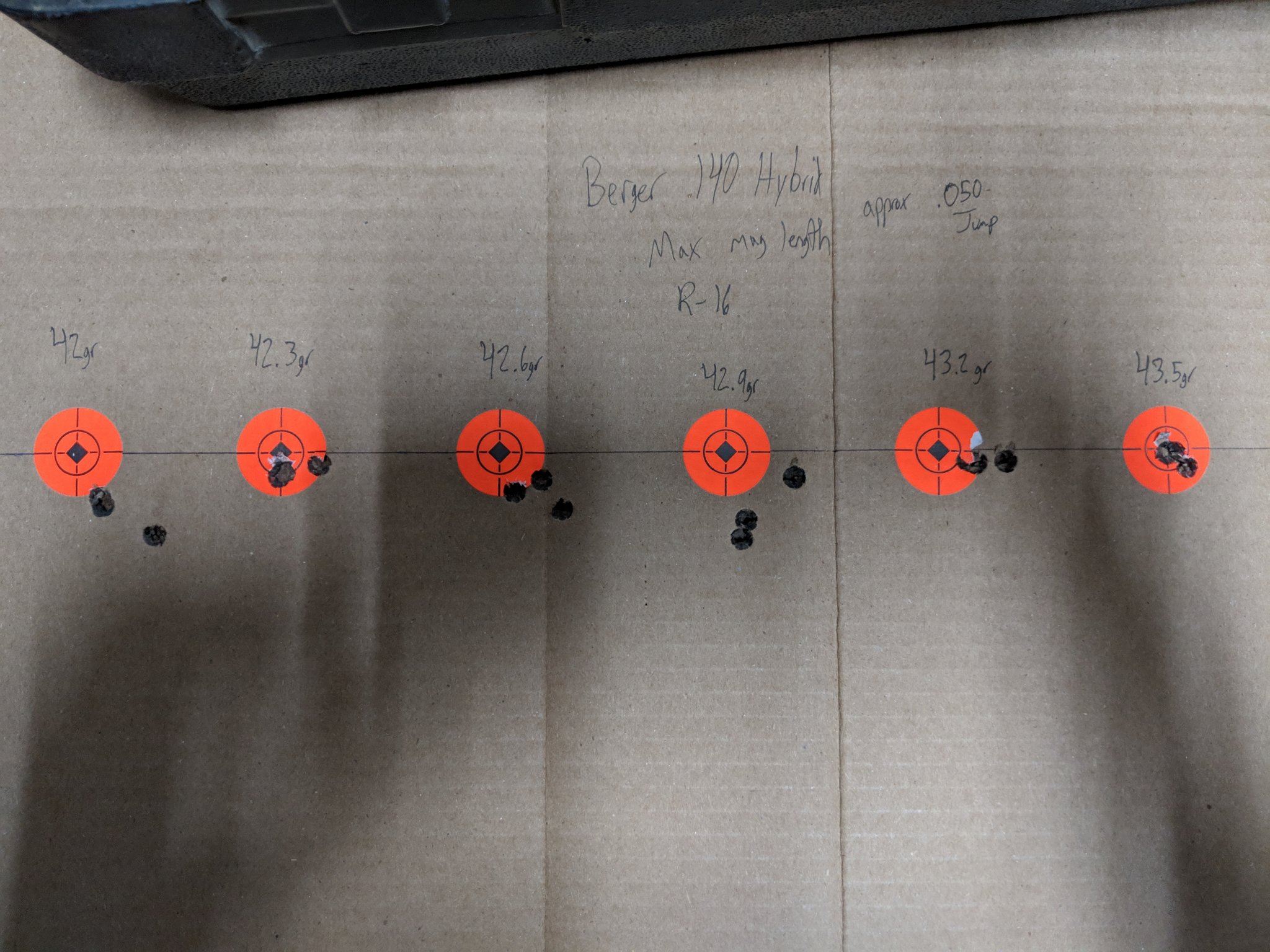

Tried a OCW with Berger 140 hybrids loaded to 2.950 (max mag length for mags without binder plates) very long throat on my Tikka CTR that's still a ~.050 jump to riflings. Did not see any pressure signs wondering about trying higher loads, what do you guys think?

Trying to learn the process just wondering what makes this load stand out to you?
Looks round - no vertical stringing - easier to tell with 5 round groups, though and a couple through the same hole. That powder charge should be mid node and easy on the brass and barrel. Just my .02.
43.5 Grains with no pressure signs? wow. Any idea of speed? Just wondering..

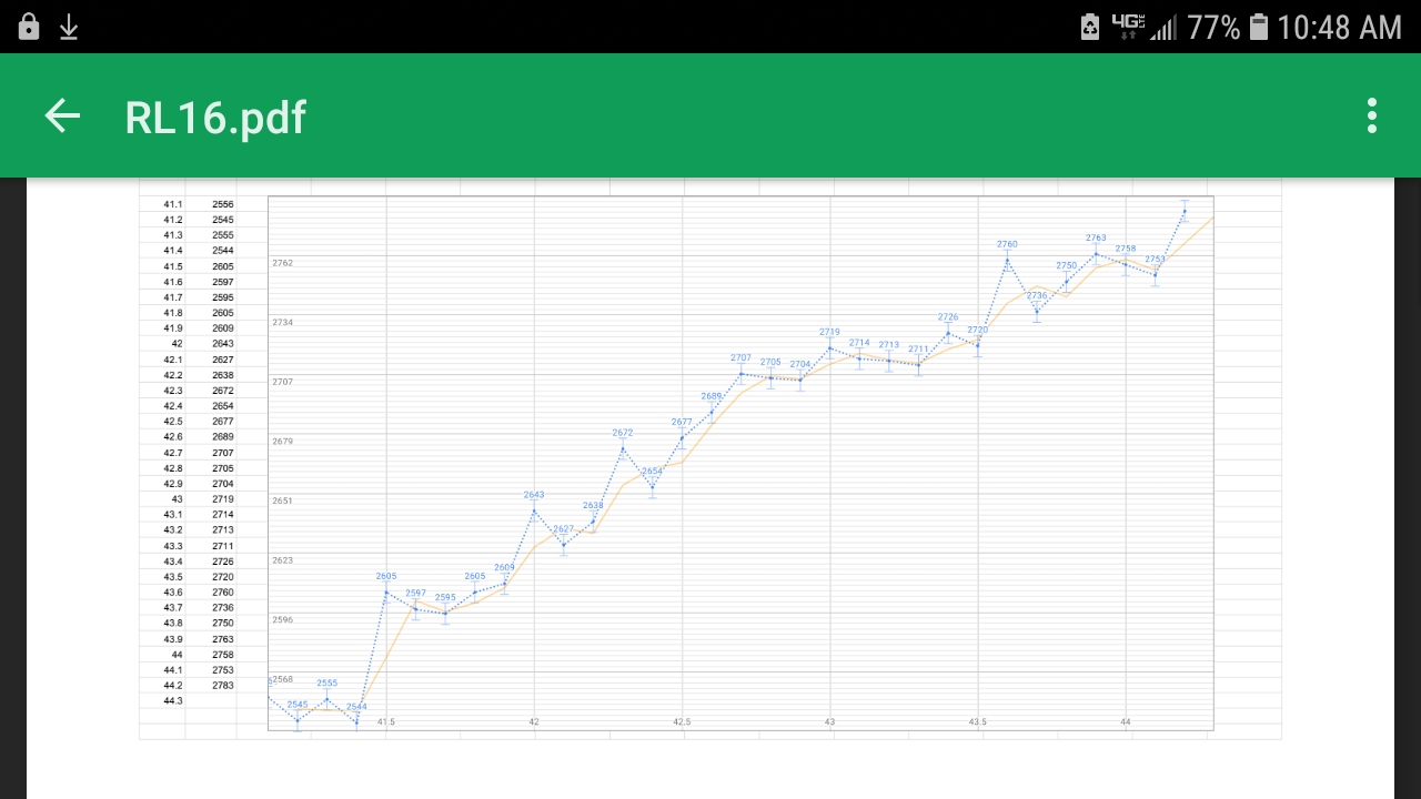

I like the plot of muzzle velocity as a function of powder mass. I have seen a stair-step graph for 130gr Berger OTM AR hybrid. I am wondering if seating depth ha

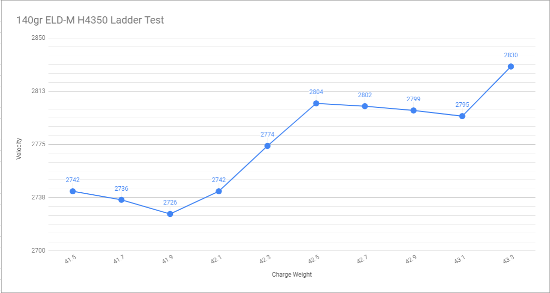

I did a ladder load test for my RPR using 140 Gr ELD-M and 41.5 gr - 43.3 gr of H4350. It looks like there is a node between 42.5 and 42.9.
Does this look correct or did a screw something up?
Cheers,
Conan
I like the plot of muzzle velocity as a function of powder mass. I have seen a stair-step graph for 130gr Berger OTM AR hybrid. I am wondering if seating depth has an effect on the nodes as well. I have gone to magazine depth for precision shooting in the field. My load is 130OTM, Peterson Cartridge small primer, 43.2gr H4350, CCI BR4 small primer, COAL 2.815. I will shoot a couple more ladders with 5 round groups to verify powder charge after optimizing seating depth for magazine.

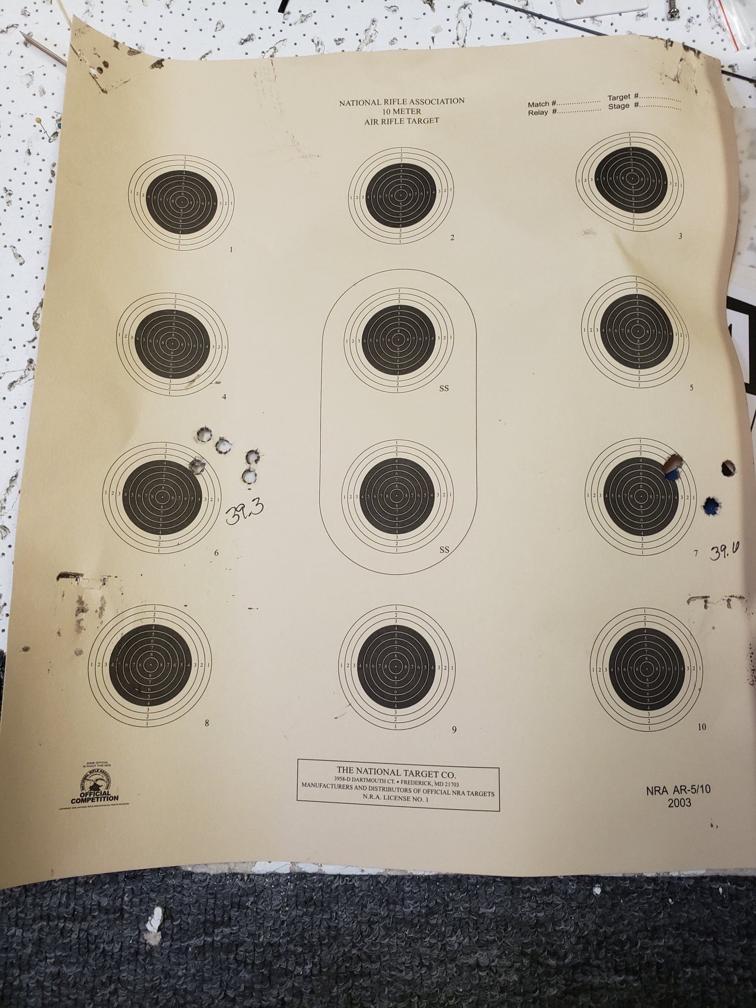

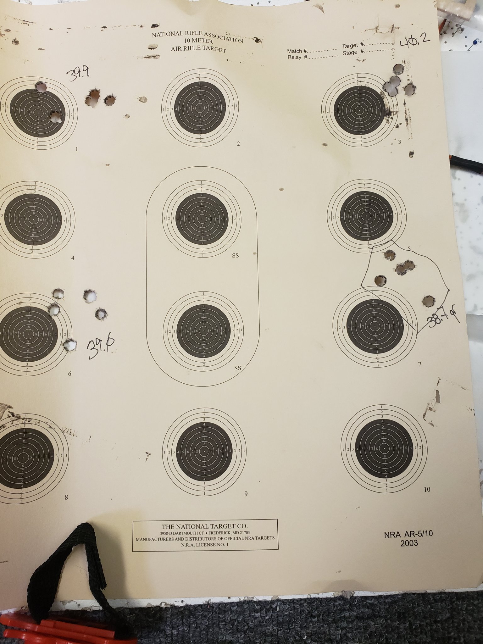

Just trying to understand and read these results correctly. Shots were at 100 yards in quite stiff wind coming from 3 o'clock from 15-25mph.
Looking at the targets the 40.2 grain load seems to be the tightest group.
Sorry to be "that guy" again. But would rather ask those that know more than me about reloading. As these were my first reloads, after reading the hornady manual and reading around here quite a bit.
