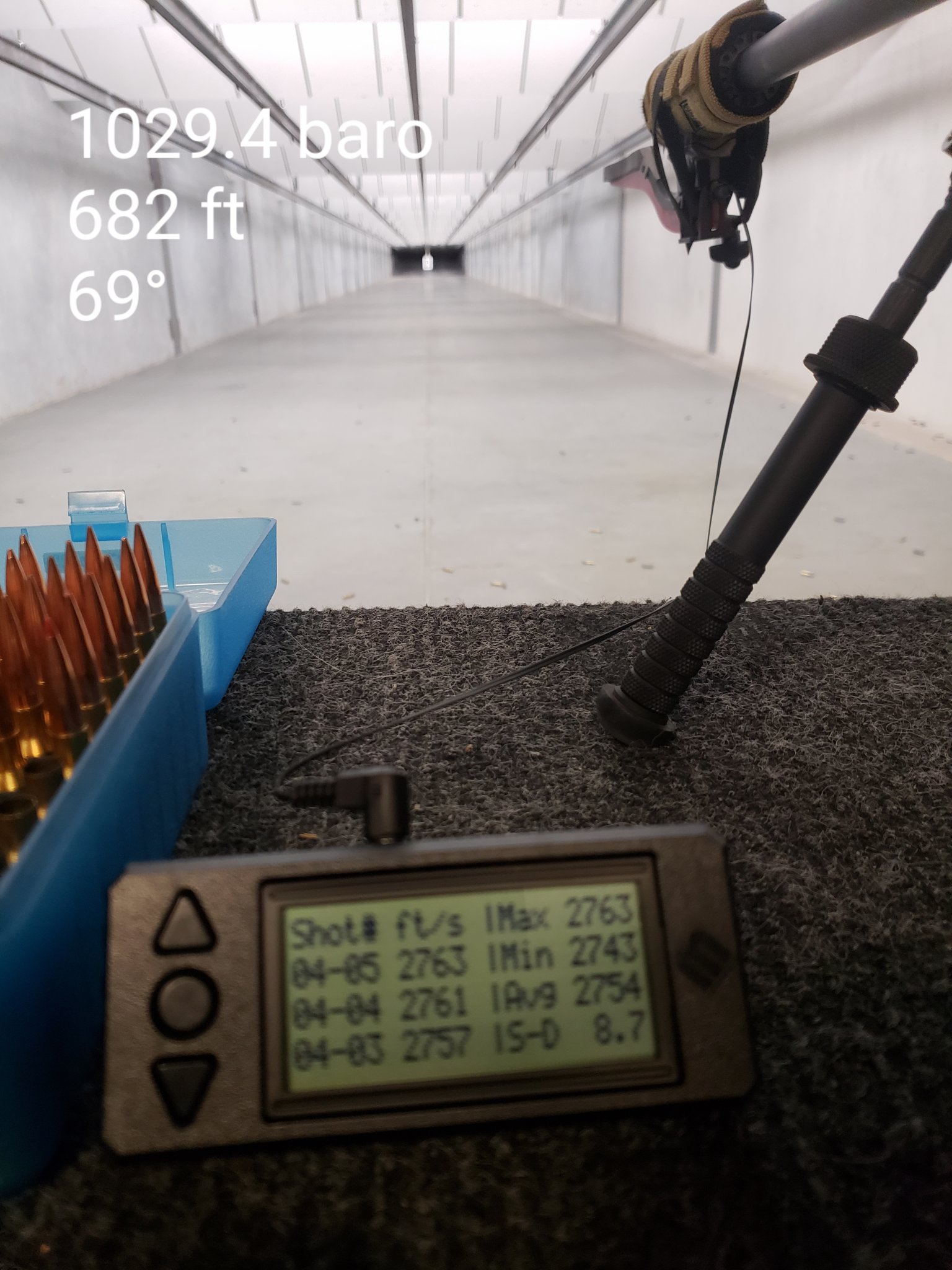

Im on reload #6 of my lapua brass and I only neck sized for the first 3 loads. Then I started salt bath annealing, I just use the little lyman deburing tool on the inside and outside and then check the cartridge length. I full length resized after 3x shot and will after 6x. This brass doesn't grow at all! Im shooting a mild load:
H4350 41.7 at 2750, lapua SRP, cci 450, 140 eldm and consistently get 1 digit SD and my ES is usually 20-30 fps max

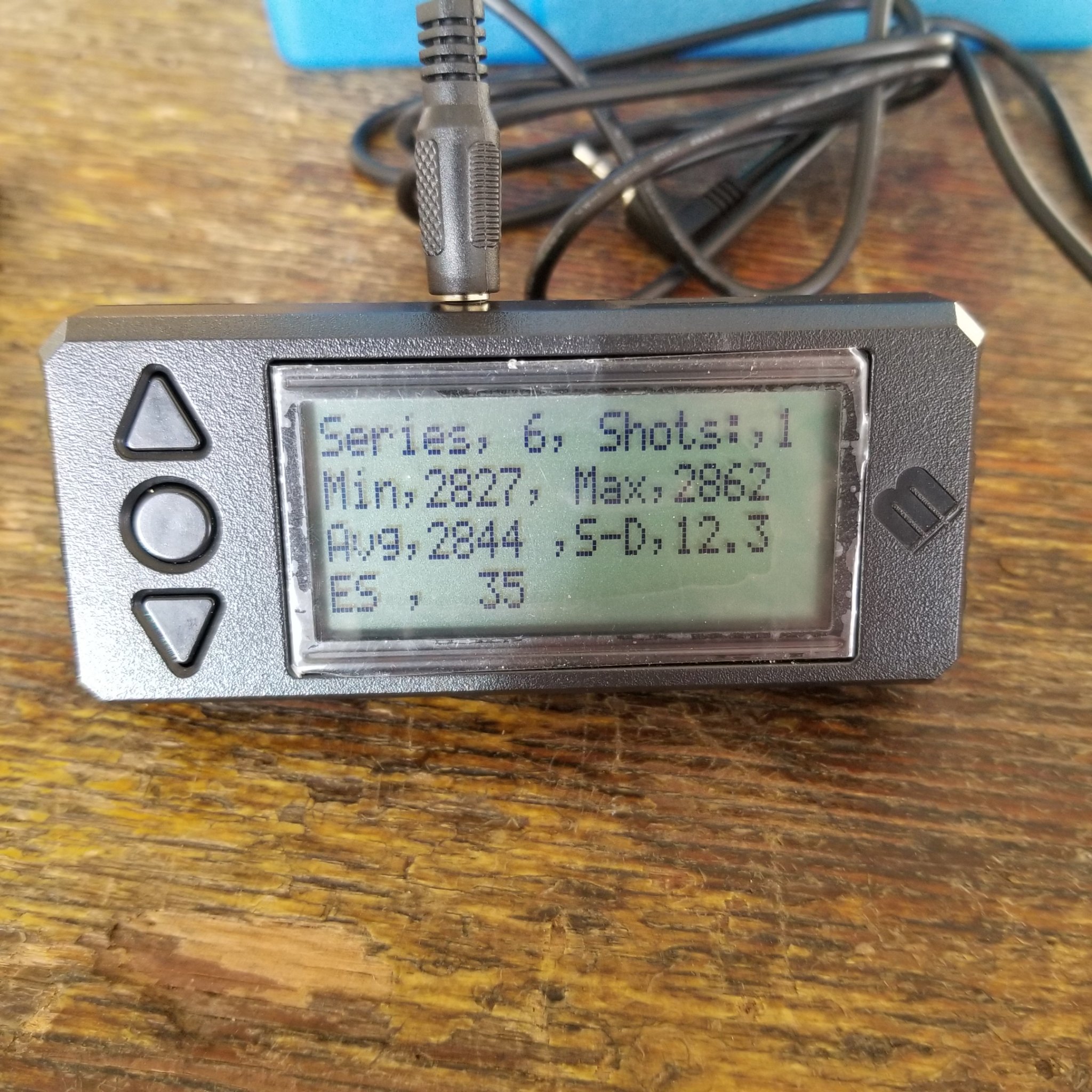

Testing out some RL16
22" barrel
Hornady 140 ELD
No signs of excessive pressure. To be continued.
Those seem like some slow velocities. May be a slower lot of powder and the 22" barrel but I got 2790 @ 40.90 grains in Lapua brass with 136 Scenar and 26"barrel. I'm at 200 feet altitude. Been getting very good ES and SD's with the Re16 and CCI 450's.
I'm using the same load with Berger Hybrid Target 140's and my experience has been the same. Very consistent brass. I went up to 41.9 with H4350 and poi on target was the same. Velocity was 2769 from 26" barrel.

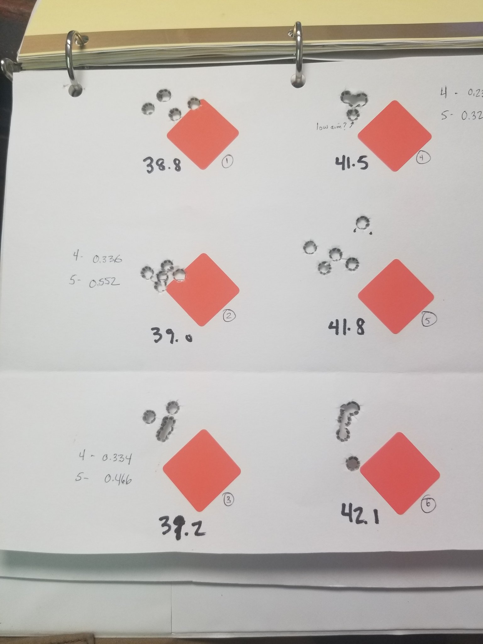

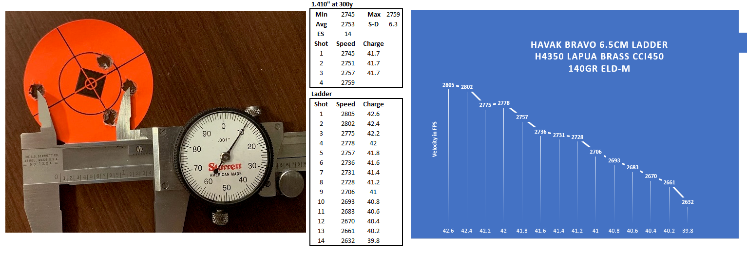

Working up my ladder.
What do you think? I think I should dial it back to 41.4-41.5 but it shoots nicely at 41.7 I don’t wanna mess with it. Hmm

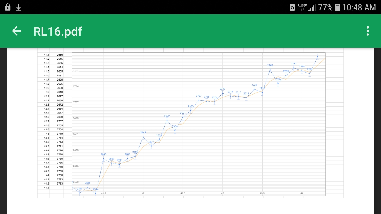

Microsoft Excel or Google sheets
Thanks, I'll use Excel for my plots. I was just wondering if there may have been a new app.

would like to see 42.8 group unless the pressure is to much ? to see if group opens up or not? flat line groups find the middle then adjust seating depth. just my 2 cents

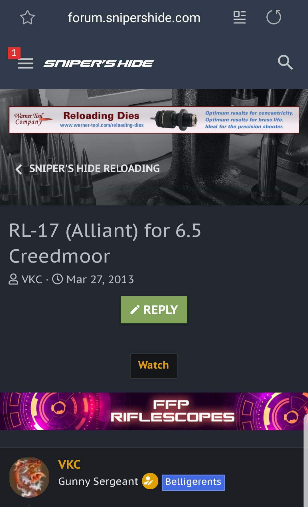

I’m surprised to see that kind of velocity with RL-17. I was never able to get good results with 17. I switched to RL-16 and have never looked back. I live on the coast range and have huge temperature and humidity sweeps on any given day and I think that was the problem with the 17.
It shoots about 100fp slower than box ammo specs which is usually with a 24". I think a 26" would be an even bigger gap.
Reactions: BugIn762
How many rounds do you have through it? Maybe different lot of powder, brass capacity or maybe my chrono just reads faster. I don’t have another one to check it with. The difference in rifles is why we have to work up each one individually.
I was getting some significant swipe and primer cratering at 42.6. I don’t want to push it but it is interesting. If 42.8 is flat too it would be a good node to get me close to a mile. Just need to decide if the lower brass life is worth it.
Your brass is telling you to back off. If you need more velocity you could have your chamber throated longer or switch to a different caliber. 42.8 might get your hand and/or face.
Is your barrel broke in? Those were identical to my speeds for about the first 300 rounds in my Havak Pro HP1 (now the Bravo).
Same components except Starline brass instead of Lapua. I'm also using a suppressor, not sure if you are.
Mine sped up after 300 rounds and now I'm around 2810fps with 41.9gr. I did another ladder test after the speed up and it was nearly identical curve, just faster.
Not sure what brass you’re using but with Hornady brass and 140 eld-m’s I’m at 2850 with 41.9 grains at sea level. 44 GR of anything in the 6.5 cm is a ton.
I was thinking the same. I ran out of case volume trying to find the pressure ceiling.
Recycled Hornady Gunner brass. Im at sea level also for what its worth.
After that ladder I have exactly 94 rounds through my rifle, so no it’s not broken in.
You said your node didn’t change (as far as powder charge) the velocity just increased?
I thought rifles are pretty broken in by 100 but I’ll check it out and do another ladder in another 200 rounds. I thought my stuff looked slow.
I’m also using a suppressor.
I don't know that it was exactly 300 rounds when it sped up, that's just about when I noticed it. I'd keep shooting the load/node you found and just don't be surprised if later you notice an increase in speed.
I live in wa near the Puget sound, I will repost if I find the same results.
Check this thread

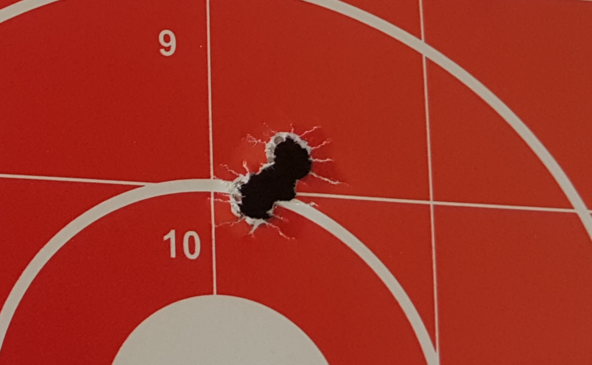

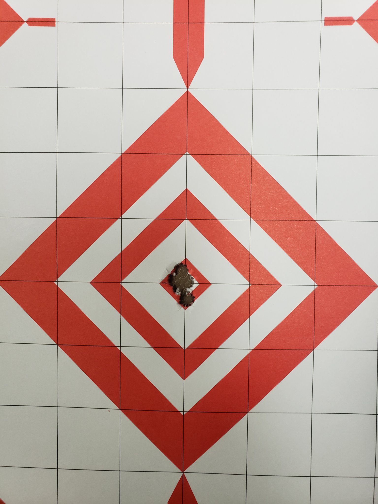

Some recent work. No signs of pressure. This is WAY over the Hodgdon / Berger maximums, so....proceed at you own risk. But confirmed by several other posters here.
Bullet: 140B Berger Hybrid Target
2.247 COAL (to ogive)
Powder : H4350
100 Yd
7095830
