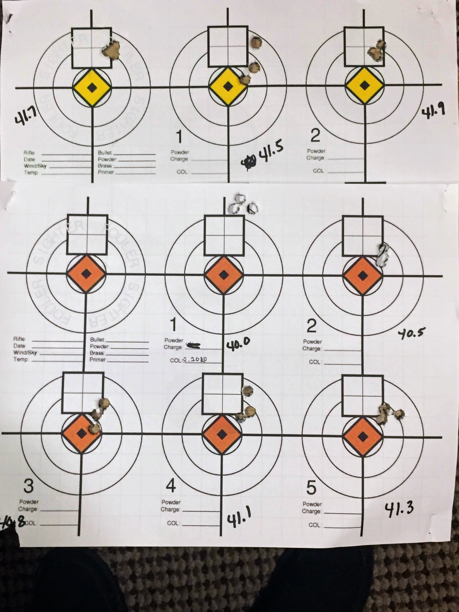

Did you go from 39.2 to 41.5? If so you learned nothing.
I did not. This was "fine tuning" work from previous range sessions that found nodes in the vicinity of 39.x and 41.x loads. ... literally hundreds of rounds down range. And this was followed up with yet more rounds down range confirming what was found here.
Briefly, H4350 has nodes at 41.4-5 gr and 39.0 -2 gr. That data will be followed up with yet more testing .
I have not yet found a way to put Hundreds of rounds down range onto a single picture to post on the Internet.
How far out of the lands are you? I’ve heard that the Hybrids like a little jump. Mine seems to like about .050 run at the rifling. I found a node for mine @ 41.7-41.9 with H4350 in Lapua brass. Avg 2769. I’ve started with the Bergers in a new stick and trying Reloder 16 with this one. Also Starline LP brass since the big firing pin doesn’t like small primers.
Distance to ogive on loaded rounds is 2.247" On the Hornady Comparator is 2.262" to lands. (avg of 10 measurements) I need to try something more like what yer doing... tho my results are decent. Havent chono'ed the 41.5gr H4350 yet. Or tried any other powders.
I’ll try to post some pics of my load work up. Keeping velocity down will help with barrel life. I went on up to 42.3 but it didn’t work. 61869A1C-84D9-4107-A650-D18FB28CBF67.jpeg

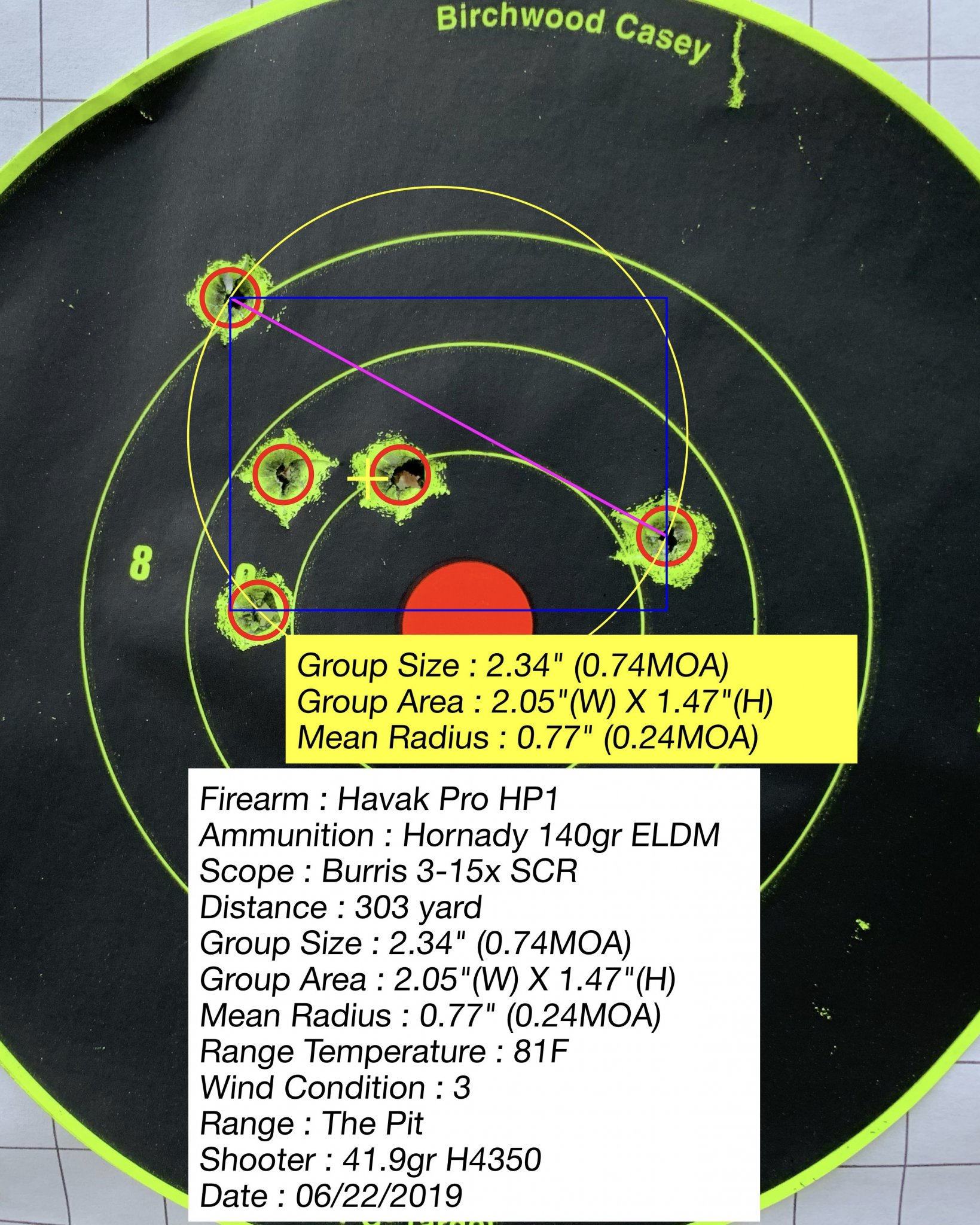

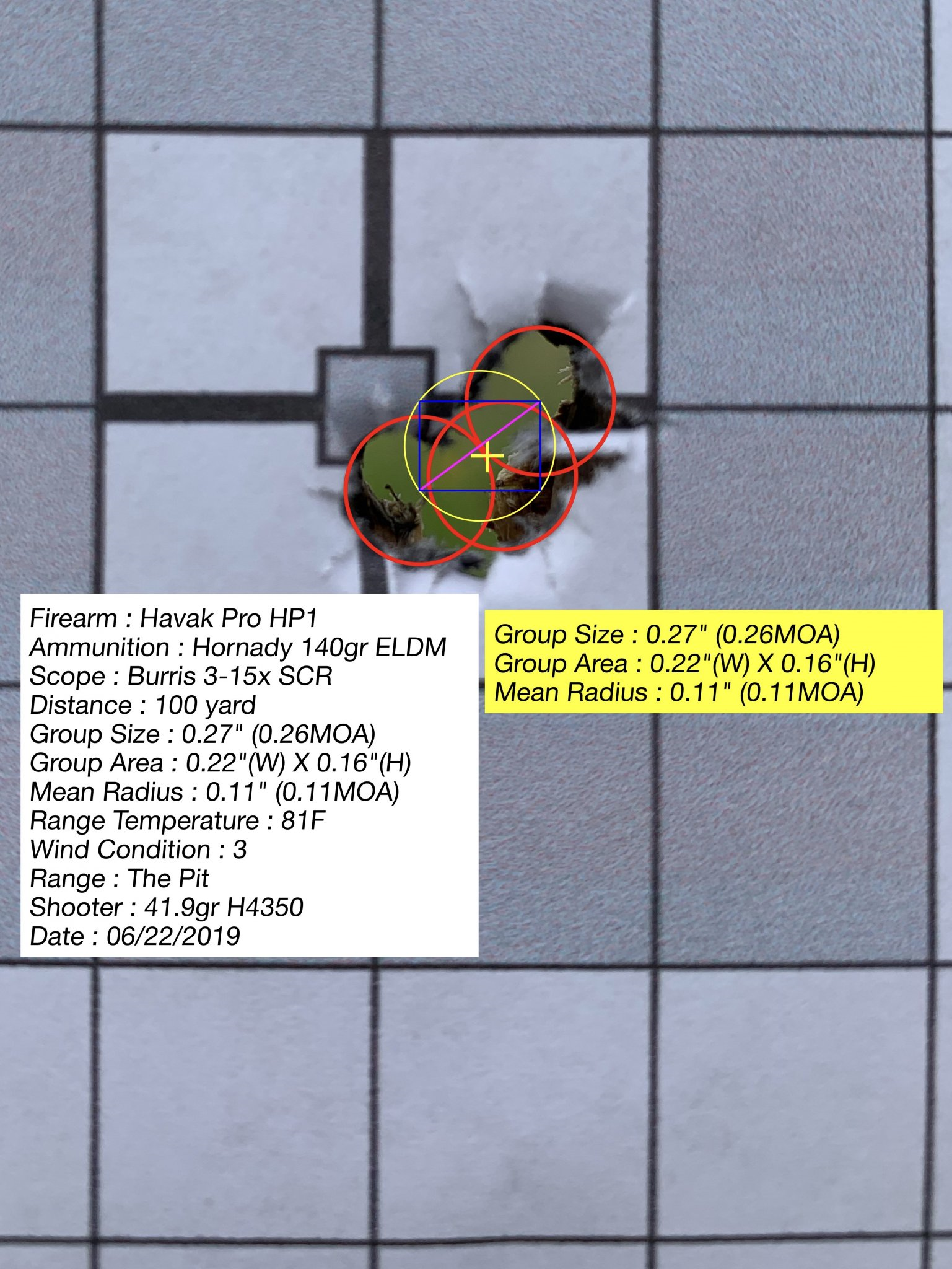

Seekins Precision Havak Pro HP1
6.5 Creedmoor
24" barrel
about 2815fps
Starline small primer
CCI 450
140gr ELDM
41.9gr H4350
Burris 3-15x50 SCR mil/mil
AAC 51T brake (no suppressor this time)
Timney 510 trigger
Foundation Stocks Exodus
Atlas bipod and Wiebad mini-fortune cookie rear bag, bench
7100688
7100689

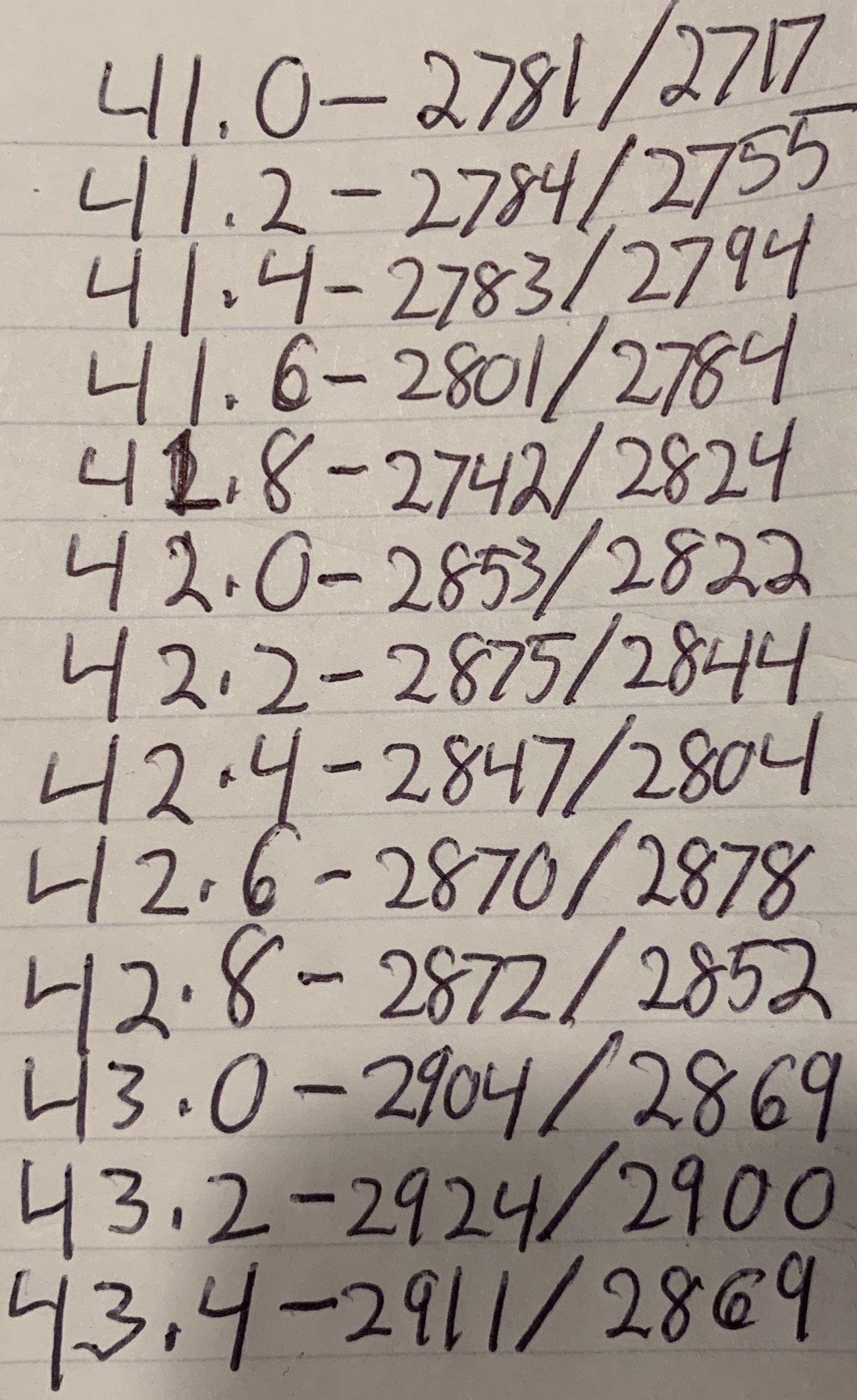

Here are my results from the ladder test this morning. I’m somewhat lost on where to go other than a 41-41.6grains. Using Rl16/prime brass/140g eldm,cci200 primers. The velocity difference between the two rounds done exactly the same is throwing me off. First numbers are from the blue target, the second are from the red/white targets.4A8024EC-F81A-4670-9471-6F6C10CEB758.jpegFFD82DB6-0D75-48EE-BCD5-3E046D744C87.jpeg0CC8BF3A-D0A8-4827-B623-B743E8F5759D.jpeg
I did 3-4 shots and waited a bit, sometimes checking the target so I don’t mess up where each round landed. I did a deep clean on the barrel 40 rounds before this, since it was a used barreled action that I bought.
I don’t know about your situation but I’ve had mine do the same thing after letting the barrel cool. Maybe your ammo got heated more. I shoot at my house so I’ll shoot about 10 rounds then stop to load some more letting the barrel cool. So my ammo never gets heated up. Since you are only checking 1 round at each charge, you don’t really know what kind of ES you are getting with your ammo. I’m just kind of thinking out loud.
I shot 2 rounds at each charge, same day, roughly the same conditions. I did the first 13, took maybe 30 minutes off. Did the second set of 13 on a separate target. I cannot say for sure that the ammo didn’t heat up, but it was still pretty early in the morning and everything was in the shade. I did realize that the one node I have, at least 41-41.4 on the first string and 41.6 on the second is a known good load, but is 2784 FPS enough? I enjoy shooting for groups, but would like to eventually go to prs Competitions. I am fairly new to all of this though. Any preference on the Barnes 140grain match burners?
I cleaned the barrel doing the whole copper removal and then another solvent cleaning until the barrel seemed perfectly clean. I had the thought that it could be fouling, but would it really not settle over the now 63 shots through the barrel since I’ve received it and cleaned it? I’ve usually had my barrel go back to “normal” after 5 on my other rifles. The previous owner said he put 400 down it, all factory ammo, but I’m not sure if that info is relevant.
