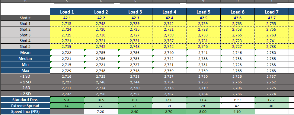

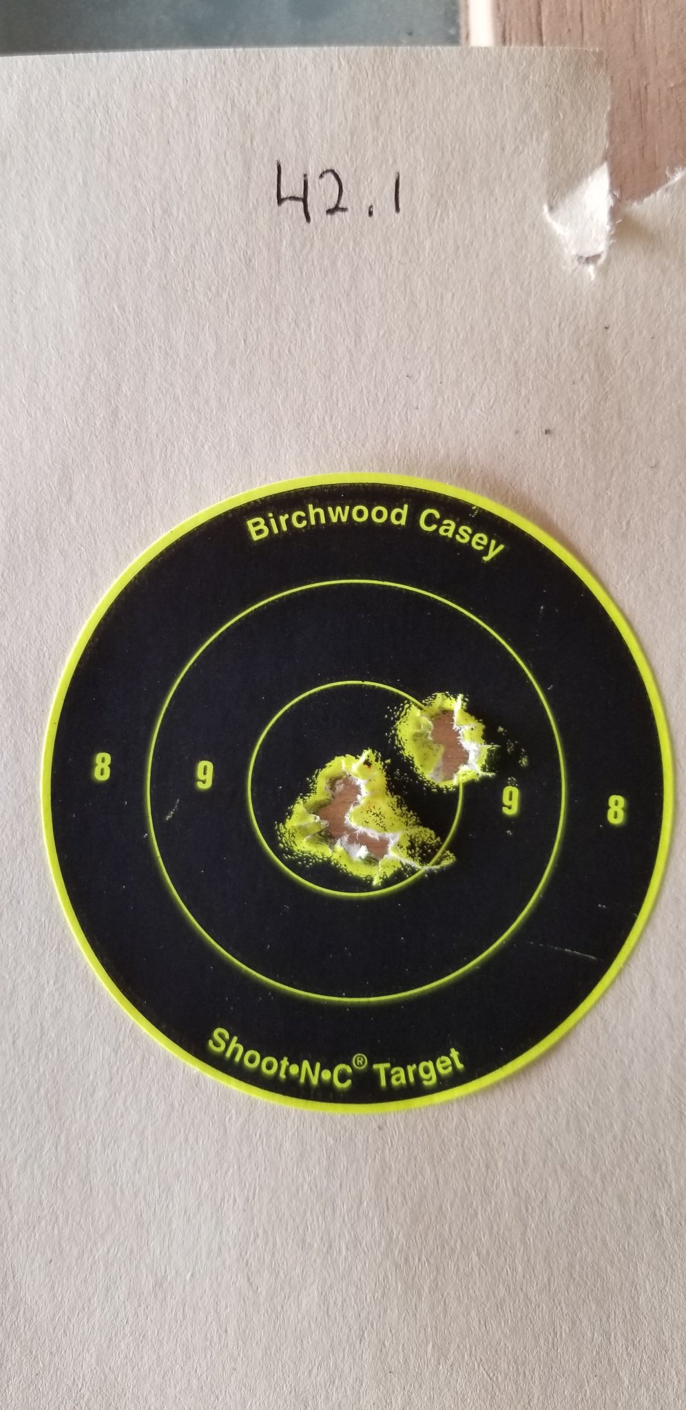

Just started reloading for a 22 inch 6.5 using once fired Hornady brass. Here is what I was able to do today.
Total of 5 rounds each and as you can see I need more practice... the five rounds are split 2 and then 3.
The RL16 42.1 to 42.4 had the best groups. I also want to try 41.8 to 42.0 to see if there is a more accurate load and a little less recoil. My goal was 2700 which was modest. There may be areas above 42.7 i.e. 42.8/9 that will liklwy get me in the 2800 FPS area but not sure if I am going to push it that much since there are other powders\bullets\primers to try as well.
Thoughts?
