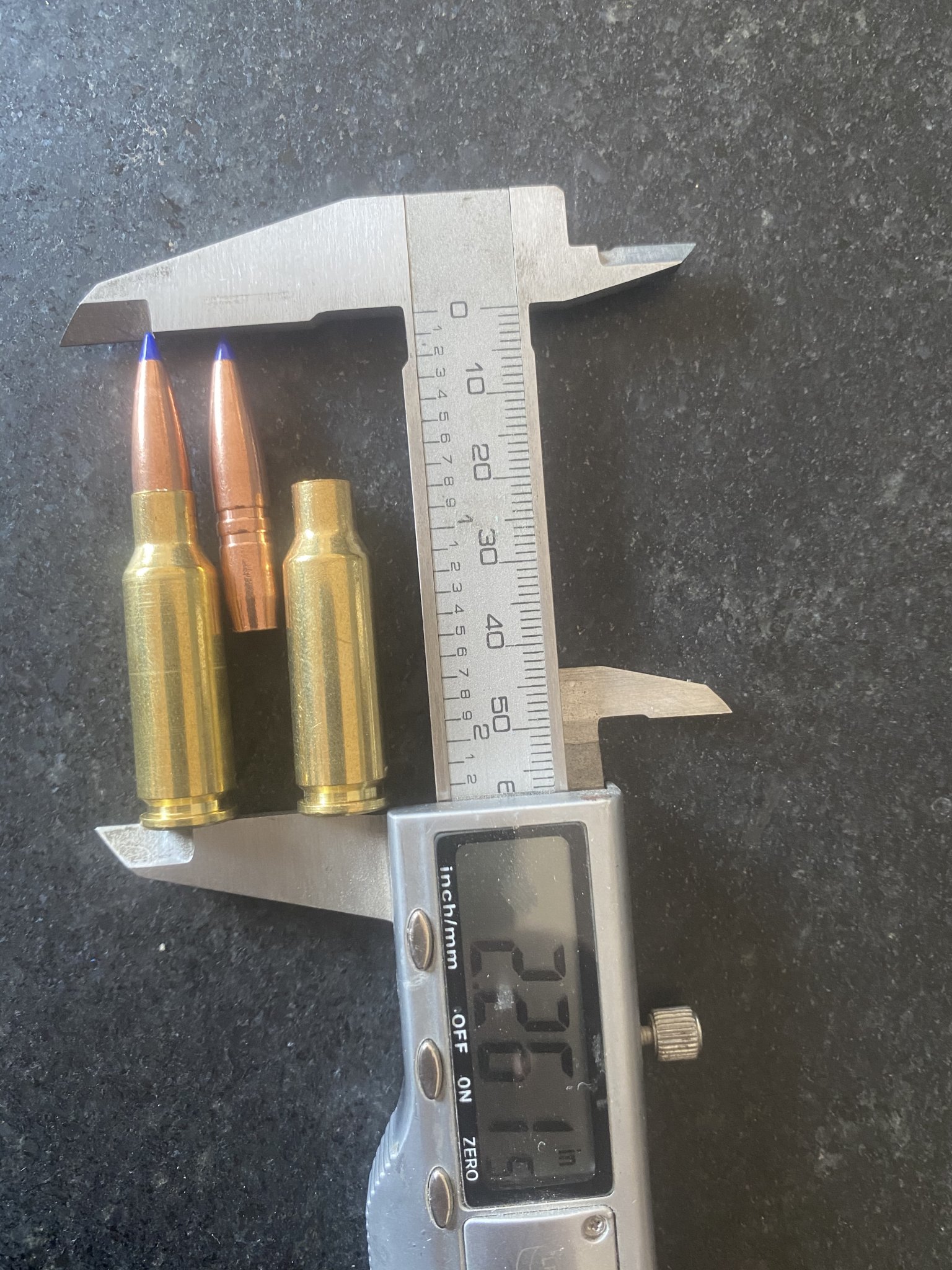

6.5 Grendel
129gr ABLR
17.6” Barrel
Red line is where I identified the cut-off doing pressure ladders with 129gr ABLR and CFE223 trying out longer COLs.
If you’re loading to 2.260” or less, I wouldn’t go over 30.4gr working up in .3gr increments (1% case capacity).
These velocities were all 15ft from the muzzle over a Chrony Beta. You can see where velocities departed the trend.
Look how the 2.271” COL stayed very predictable as charge weight increased, whereas 2.284” was all over the place.
This is from an actual SAAMI chamber with the compound throat.
I had already done pressure ladder work before with 2.260” COL starting at 29.0gr.
Lapua Brass
Rem 7 1/2 BR SRPs
If I was headed to the load bench right now to mass-produce a load, it would be 31.2gr CFE223 under 123gr A-MAX, but I’m running out of A-MAXs so I would substitute ELD-M after working it up again.
I know that CFE223 isn’t the best for temp stability, but it has shot well for me. I like it loaded to 2.272”, which runs in CProducts mags fine, but not in Elanders. Elanders came out later and have a very strict maximum COL with a little clearance over 2.260” in all the ones I have, but they have a more smooth surface coating and run well with ammo at those COLs.
123gr A-MAX
31.2gr CFE-223
Lapua brass
Rem 7 1/2 Small Rifle Primer
2.272” COL
Here is a rapid 9rd group at 2.267” COL:

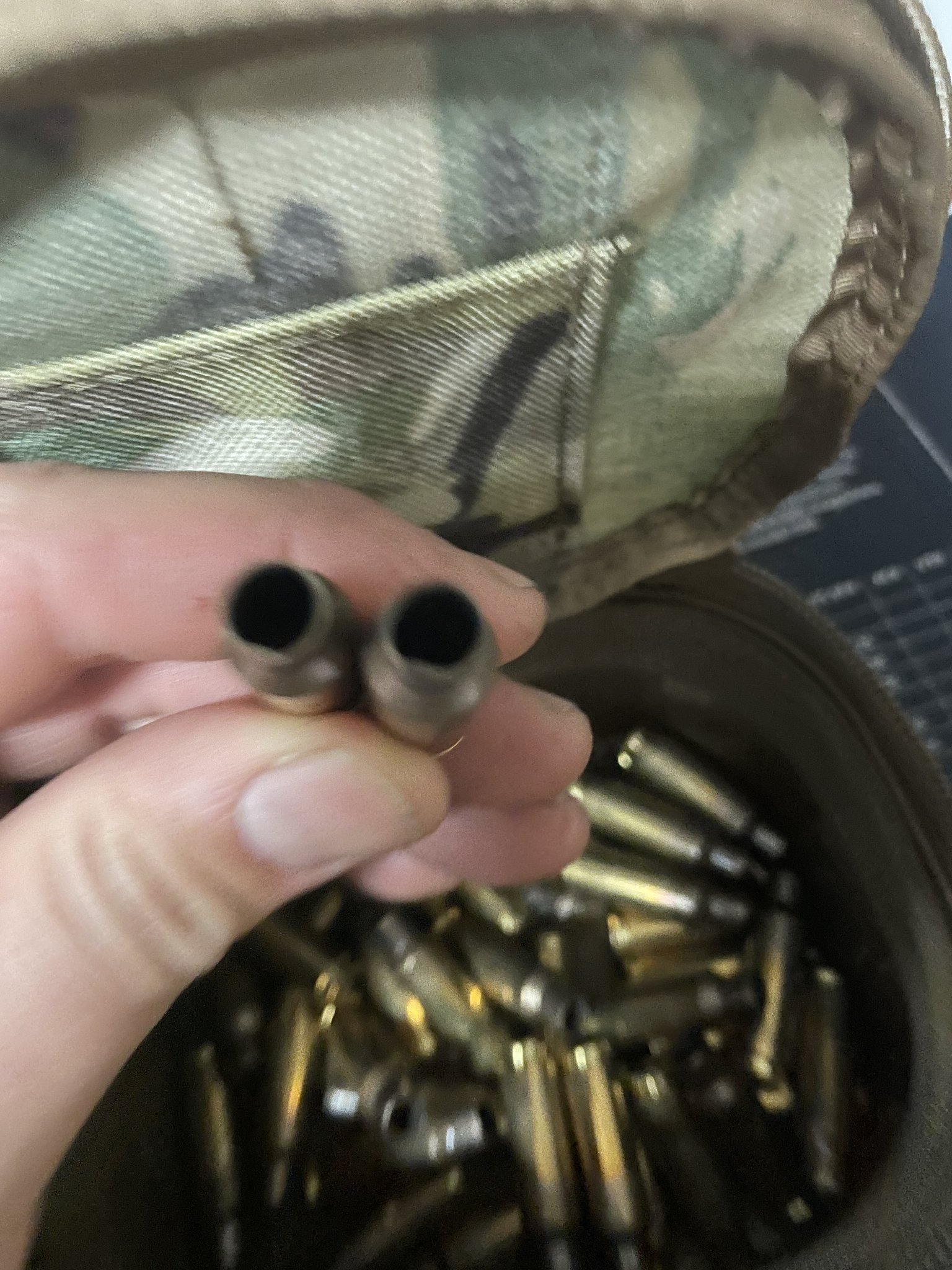

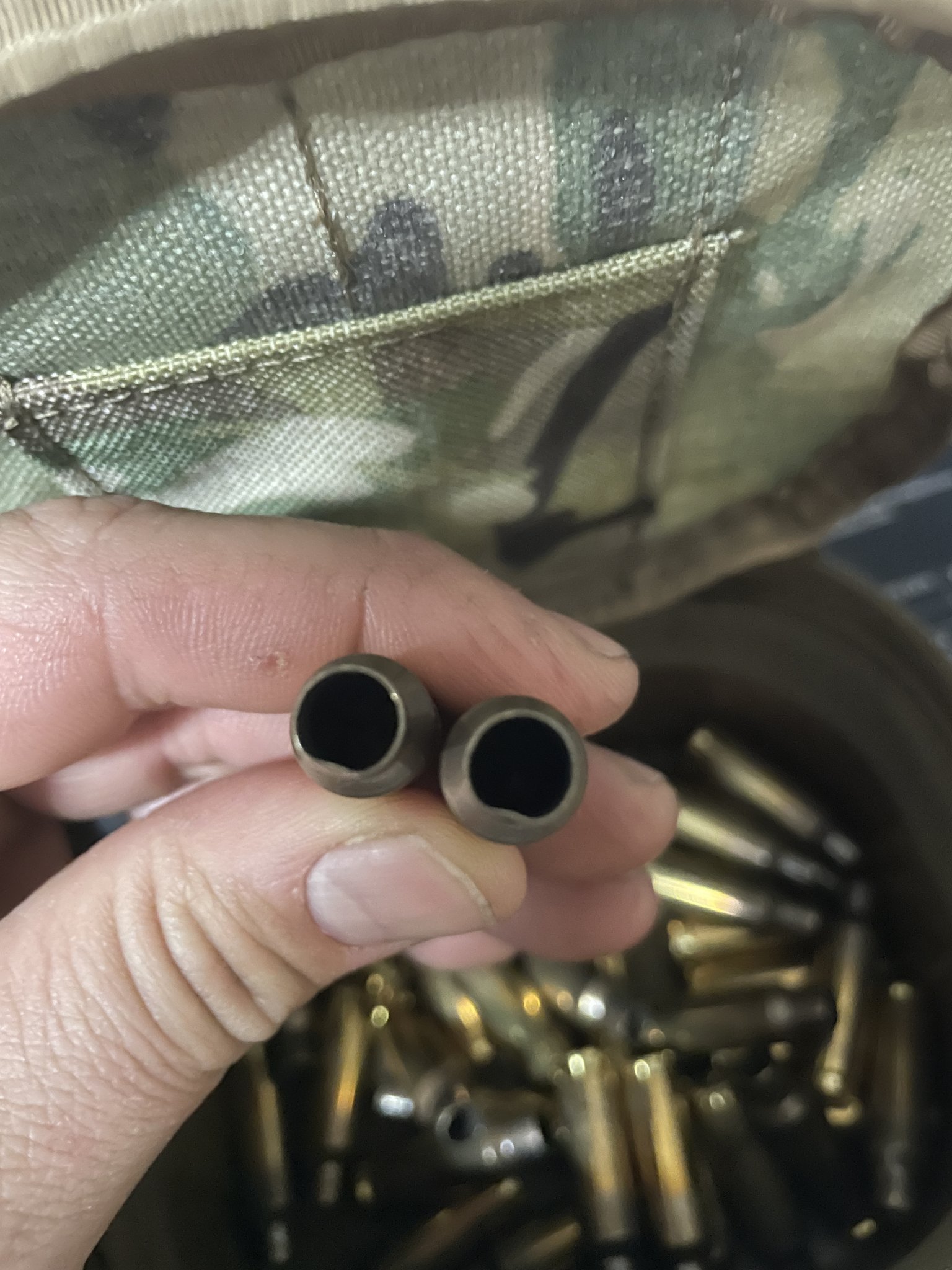

New to reloading my Grendel. Working up a load with Lapua Brass 26.6-27.4gr H4895 with Nosler 120gr BTs (because I have them).
All my brass came out with dented mouths after firing. What is causing this? Any help is appreciated.
I don’t want to try and mandrel it and dent the case more….
Dented mouths happen when the brass ejects and hits the spent brass deflector. Adhesive pile tape (Velcro) solve that for most. You can also clip coils off your ejector spring to tame your ejection force.
It doesn’t really matter though since the re-sizing operation will open the mouths.
It has never been an issue for me in over 12 years of loading for Grendel regularly, but the question comes up at least once a month.
