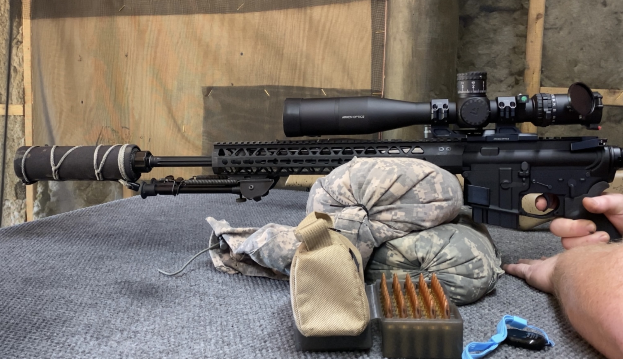

Wondering if I can get 2500 out of a 20 inch ar with a suppresor.
Still breaking in barrel.
I’ve loaded 31.5gr CFE with both 123gr AMAX and Nosler CC’s. I have a 16” barrel but I think you’ll hit 2500+ in a 20”. I found I can get the same velocity with 27.3gr of AR-Comp

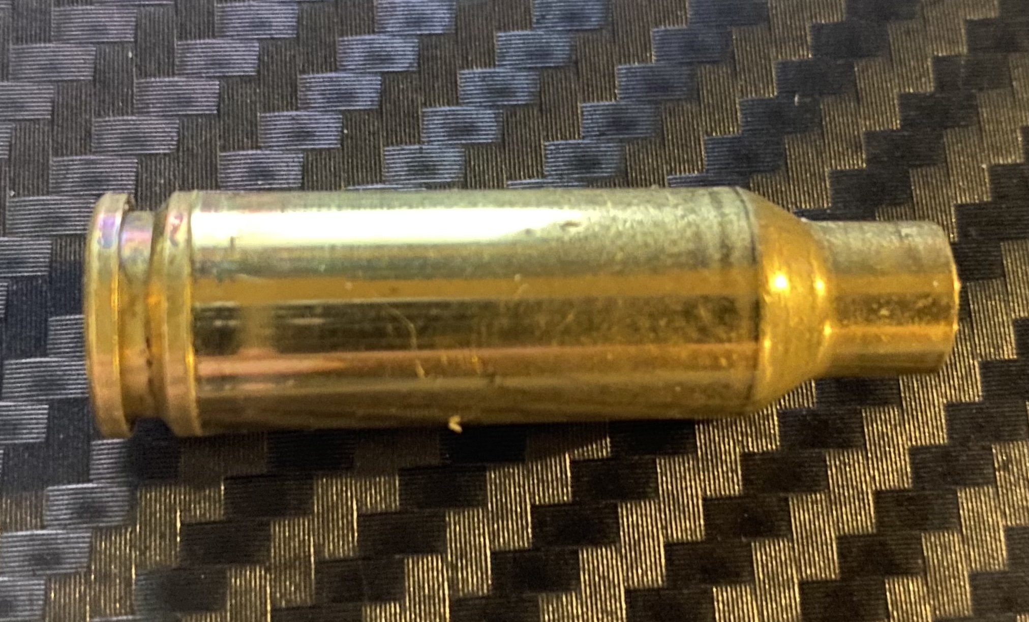

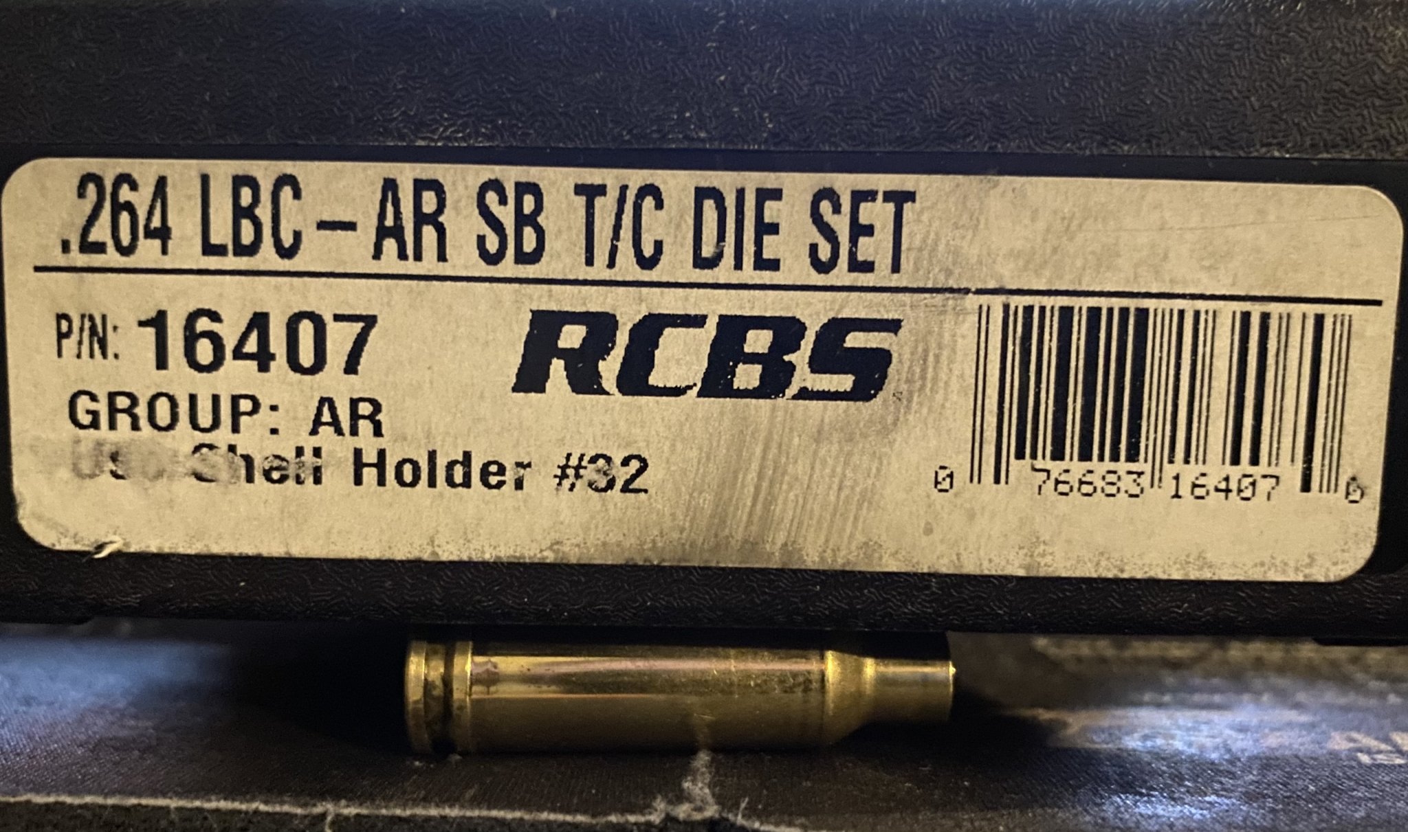

Anybody else have an old set (2012-2013) of RCBS .264 LBC AR SB T/C dies, and has this issue when FL sizing your 6.5 Grendel brass? Guess I’m gonna have to buy a whole new set of dies. It’s sizing WAY too tight, and ruining my brass by leaving a ring on it. Luckily I’m not an idiot, so I only ruined 1 piece.
I looked online, and 1 other guy had the same dies, with the same issue, but his post was from 2013.
Here's pictures of my dies and the piece of brass it ruined...
  • Wow
Reactions: Snuby642
I would expect RCBS will take care of you.
Yeah, I haven't called them yet. Might do that today... The guy in the old link I posted, said he called them, and they sent him a proper spec'd FL sizing die. Apparently the old .264 LBC SB dies were cut SUPER tight (out of spec), and I never noticed, because I'v never used that die...
I have some too that did that. They were on clearance at Midsouth when nothing else was available. I polished mine until they stopped doing that, then some some non-SB 6.5G dies popped up for sale and i bought them.

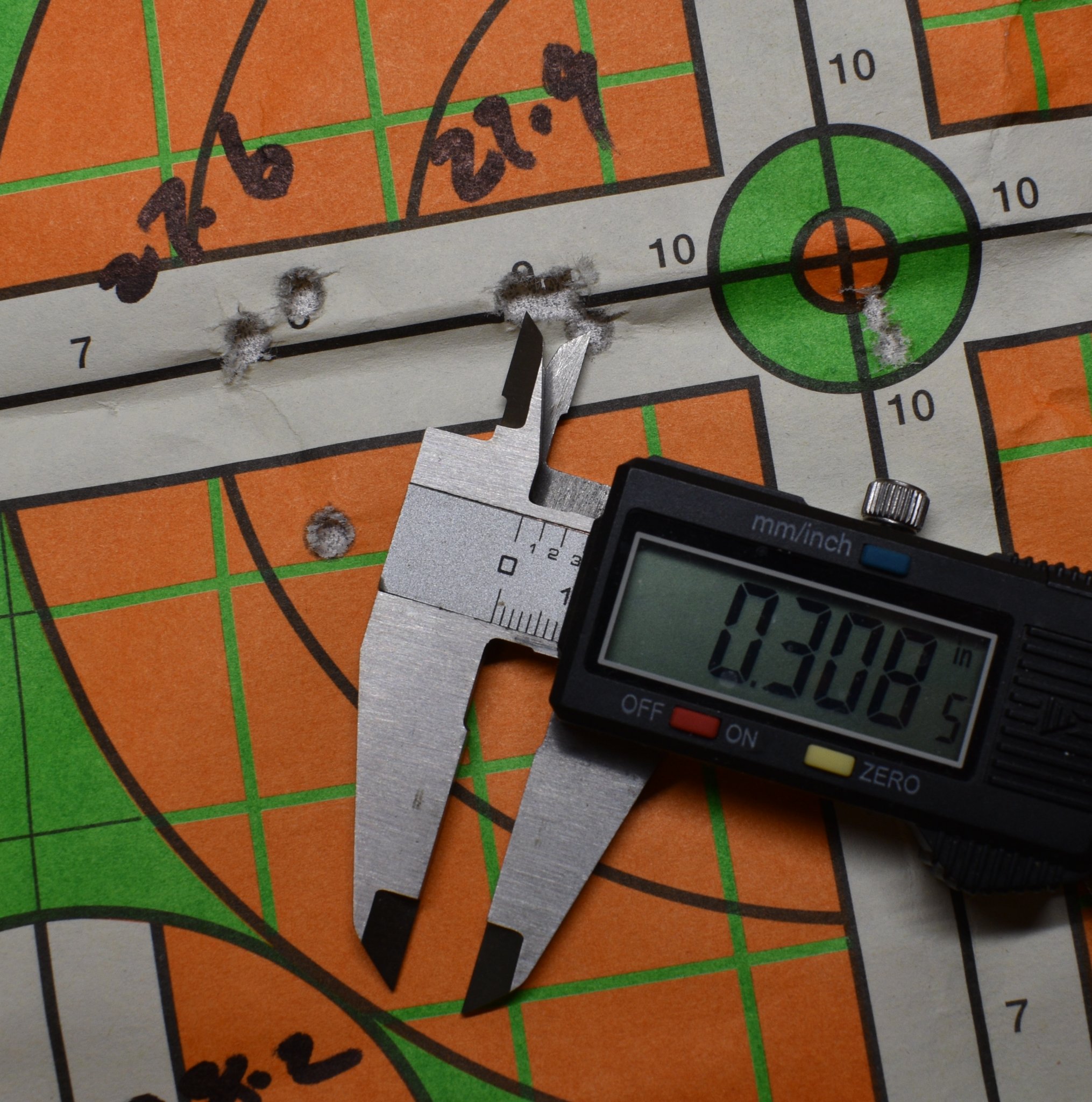

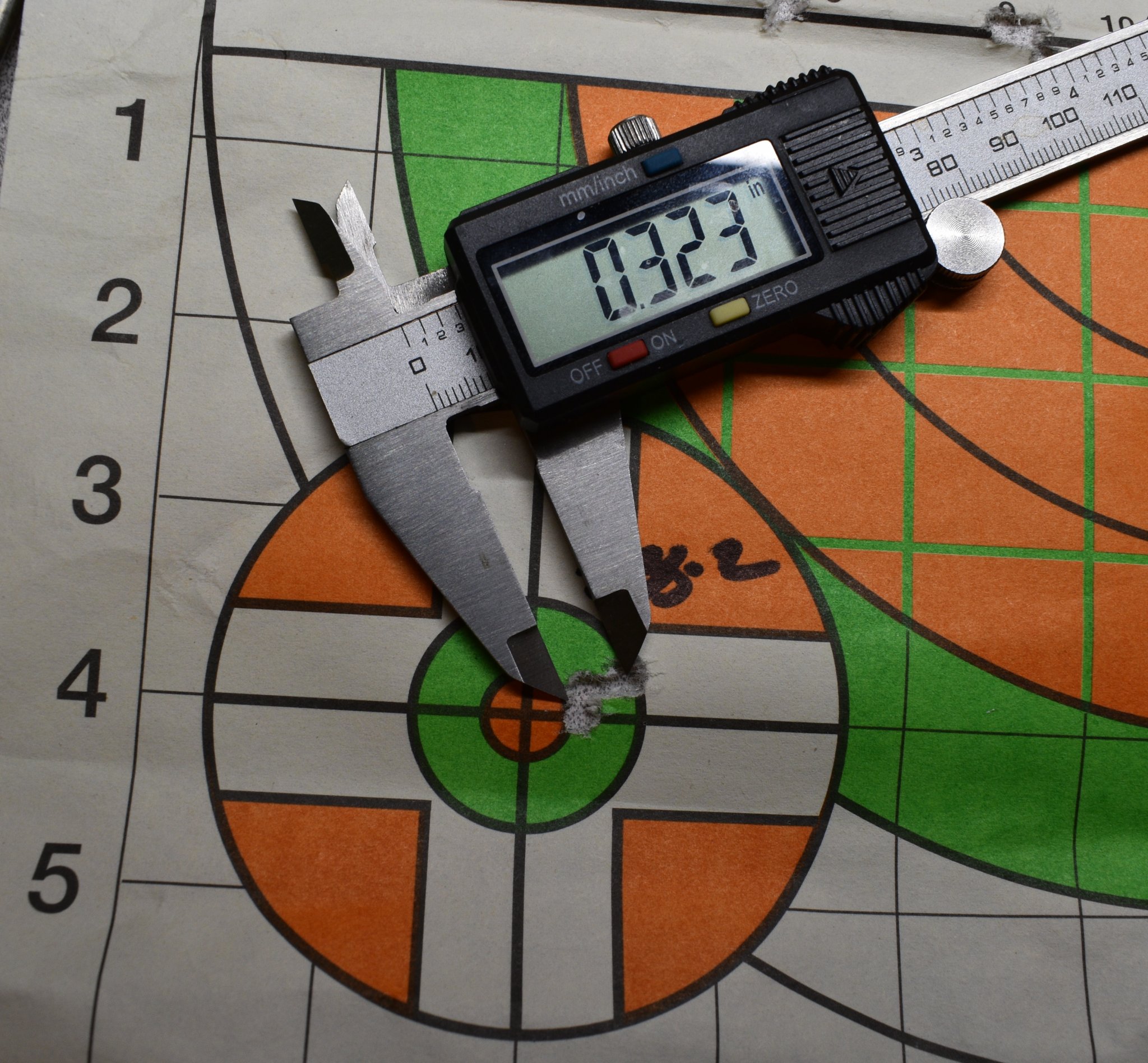

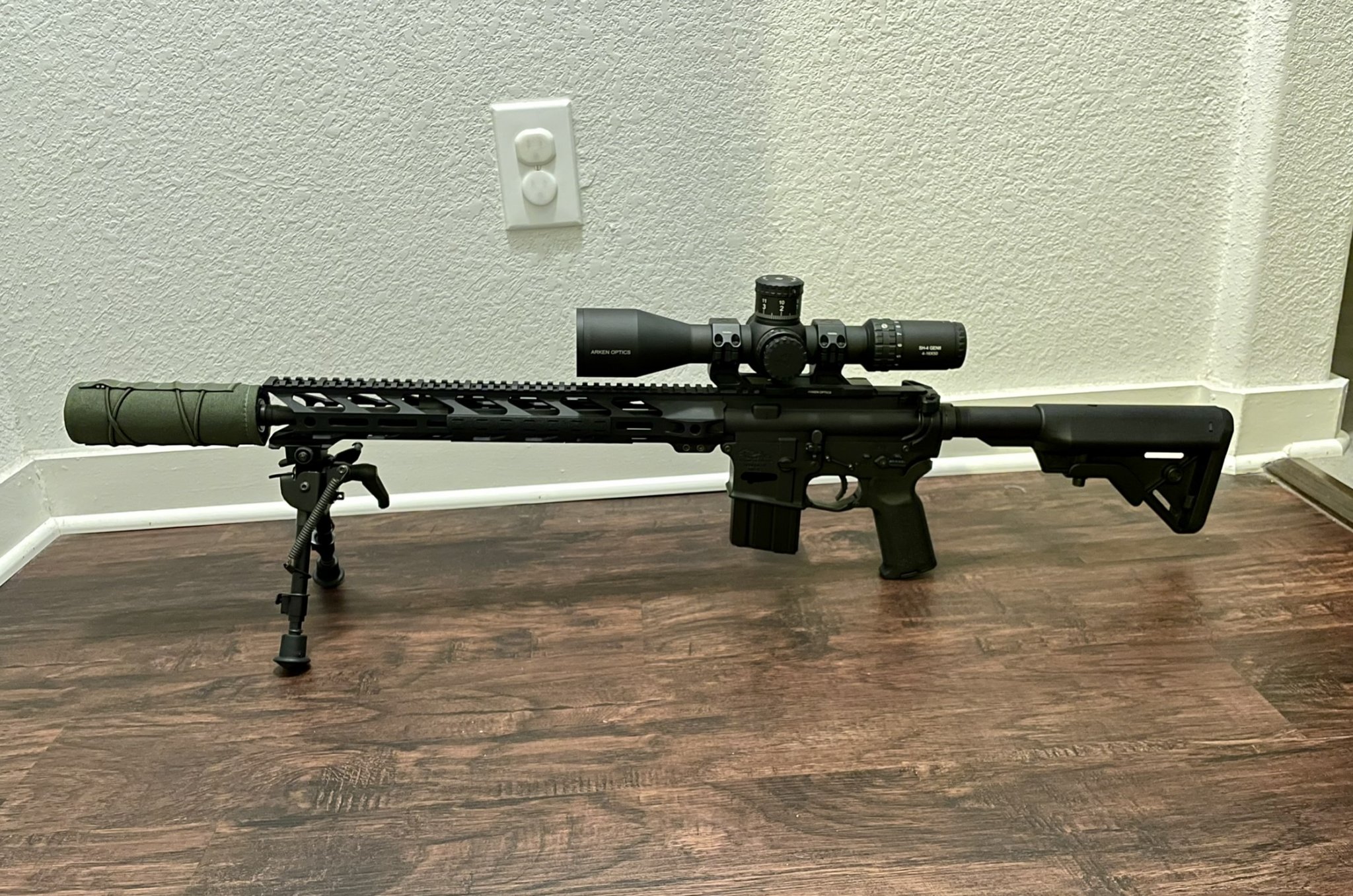

Went to the range today… Did some load testing with the 6.5 Grendel with the new Faxon 20” 416r Heavy Fluted 5R Match barrel. I found a load with 30.0gr of CFE-223 in 1x fired Hornady brass, CCI 450’s, and Nosler 123 CC’s. I was able to seat them 0.020” off the lands and they still fit in the magazine! Most groups were closer to 1/2-3/4” @ 100 (which is typically from me moving around), but it did put down one group that impressed me. 3-shots at 3/8”. I was shooting through my Dead Air Nomad-LT, since it was already sighted in for it. I think I’ll be exploring this load some more. 👍🏼
I was finally able to get out and shoot some groups to proof the load development so far. I think I am going to run with 28.0 grains of IMR 8208xbr with the 123 ST's. Loaded up 50 and will shoot some 5 and 10 round groups. Impressed with the Ruger Ranch thus far.
I was finally able to get out and shoot some groups to proof the load development so far. I think I am going to run with 28.0 grains of IMR 8208xbr with the 123 ST's. Loaded up 50 and will shoot some 5 and 10 round groups. Impressed with the Ruger Ranch thus far.View attachment 7842490View attachment 7842491

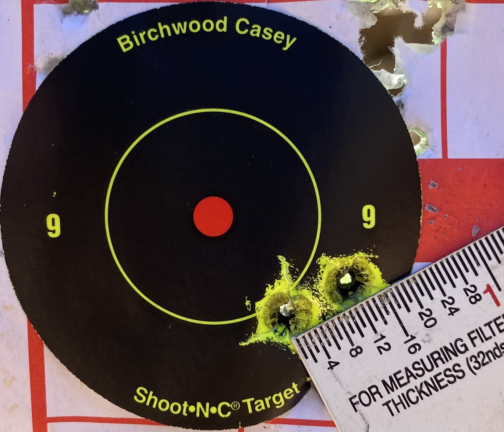

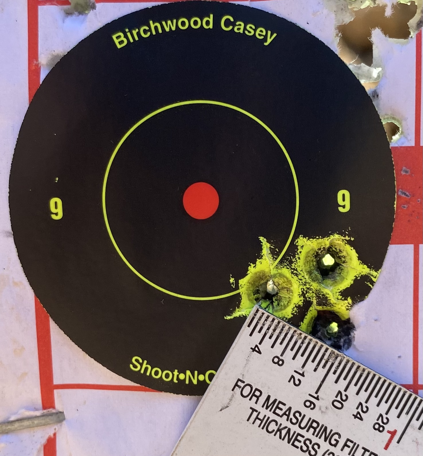

Experimenting with the Maker Rex 85gr-tipped for upcoming hog hunt. I think I’m gonna like these little, speedy copper solids. They suggested max load of 30.5gr of XBR8208 (which is my fav Grendel powder) or 31.5gr of H335. Load work up groups with 8208 kinda sucked but 31.4gr of H335 shot one ragged hole out of my 12.5” Faxon barrel.
Reactions: Snuby642
I shoot 110 makers our of a 12.5" Faxon as well with 28.5grains of 8208 and they have shot .75 with my NV scope off a tripod.
Reactions: Lthrt

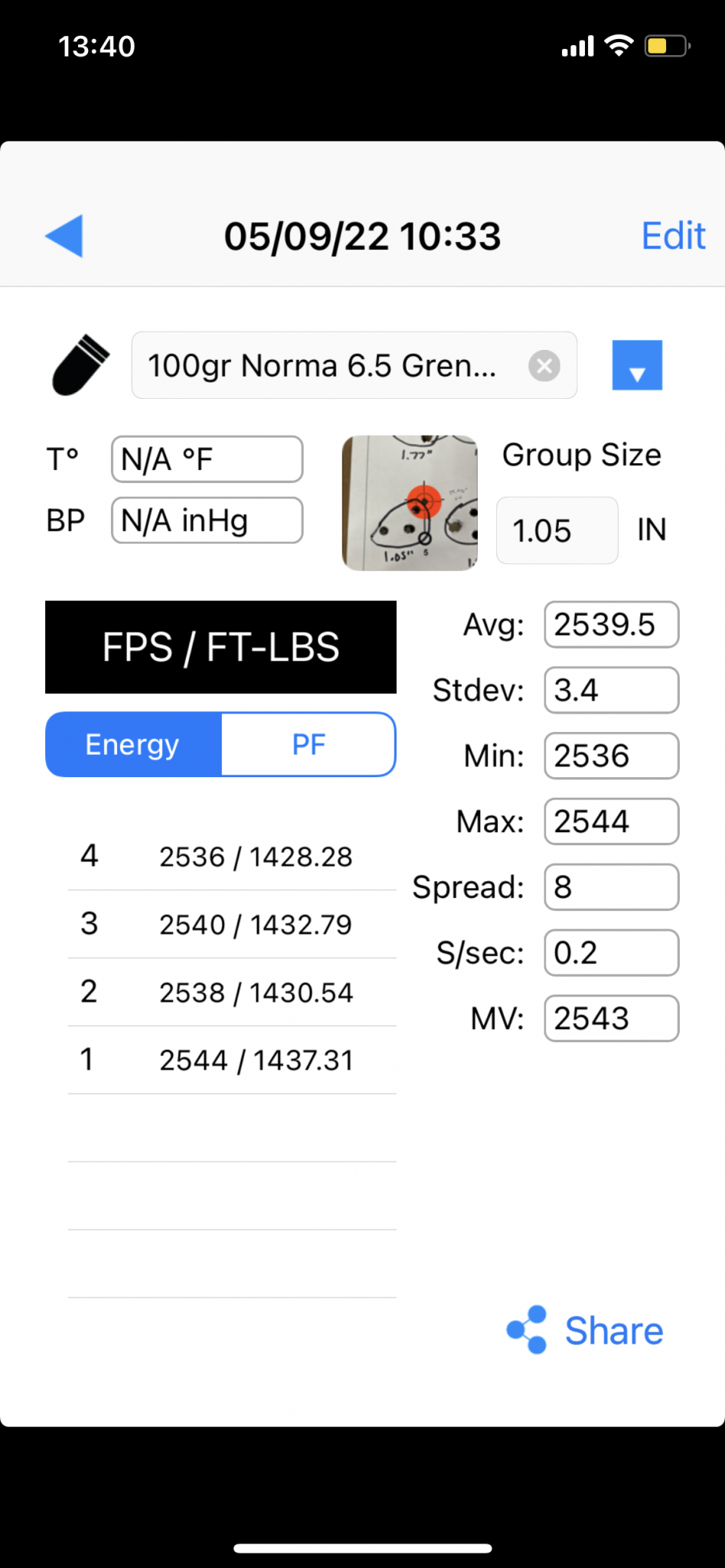

Just finished a load work up today for my 16” Grendel. Overall I’m happy with the velocity, SD, and ES. My barrel has a hair less than 100 rounds down the tube. Hoping the groups will tighten up.
6.5 Grendel
100gn HPBT Norma
Powder:H335 29.0gr
Trim: 1.506
Coal: 2.303
Ogive: 1.815
Loaded coal: 2.237
Loaded ogive: 1.754

I shot 4 round groups starting from 27.4gr to 29.6gr. Although 29.6gr yielded my best group at .96” and a mv 2583 with slight ejector marks on the casings. I decided to go with my 29.0gr load. Due to having no pressure signs a mv of 2539 and sd 3.4 / es 8 and a 1.05” group @ 100 yards.

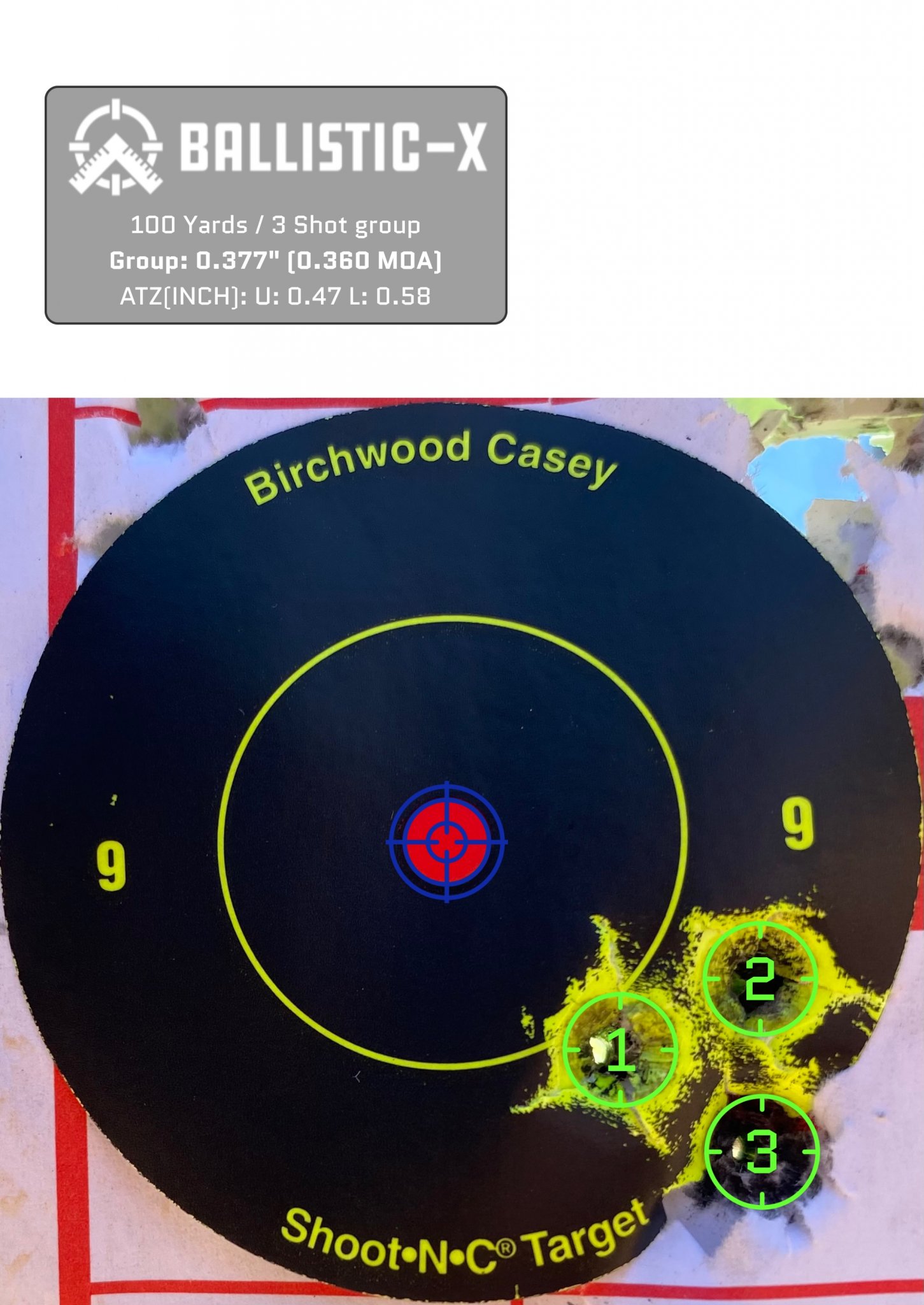

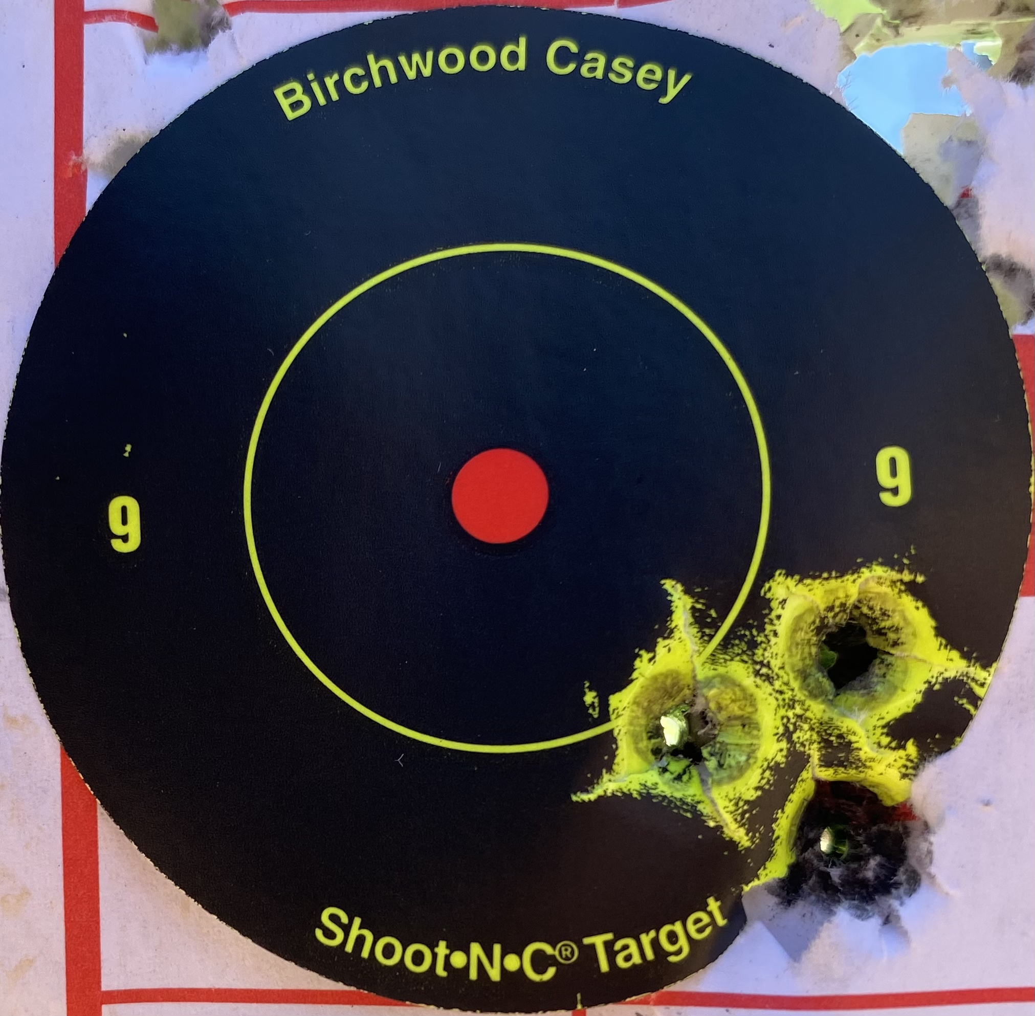

Just a quick update to this…
I recently got the Ballistic-X app for my phone so I can measure my groups more scientifically at the range (I hate bringing targets back home to measure with calipers), than an old plastic 6” ruler with fractions on it…
Here’s what that “3/8” group” ended up actually being… Which impressed me even more with the Faxon Match 5R 20” barrel…
Reactions: DubfromGA
Thank you LRRPF52 for the side by side pics. While my daughter is trying to shoot me into the poor house, it's good to know the 107SMK I have are extremely comparable to the 123s which her rifle likes. Since her rifle (Howa Mini in 6.5Gre) outright loves/adores the Gold Dots @120gr, I'm hoping the roughly similarly sized 107s will do well also. If nothing else it'll give me an excuse to pull them out of a bunch of new Lapua 6.5x55 brass. :)
