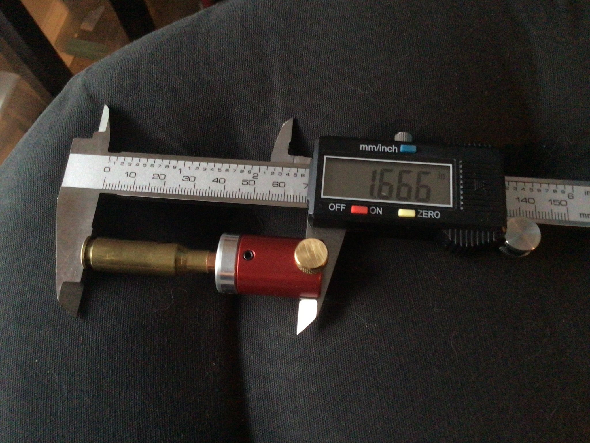

Anyone have a BTO measurement on some factory Hornady 123 eldm ammo? I don’t currently have any on hand and need a starting point for some bullet seating tests. Doesn’t have to be precise, just ballpark. I understand there will be variance in the factory offerings.
Thank you in advance!
Factory 123Eldm BTO.

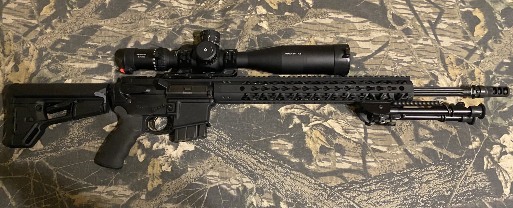

I have a 16" ruger ranch grendel, starline brass, 123eld and 8208.
Im feeling like I should be getting or able to get higher velocities...
28.6gr of 8208 gets me 2395-2415..... I have zero pressure signs but hear 8208 can spike quickly in this range...
That seems pretty close to what I’d expect from a 16” barrel. Nosler lists 27 grains as max load for 8208 with a 123. Your load might be safe in your rifle but I’d have to suspect you’re getting close to pressure even in a bolt gun. If you want more velocity you might have to step down in projectile weight.

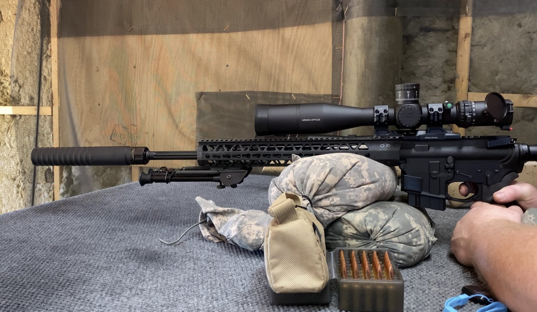

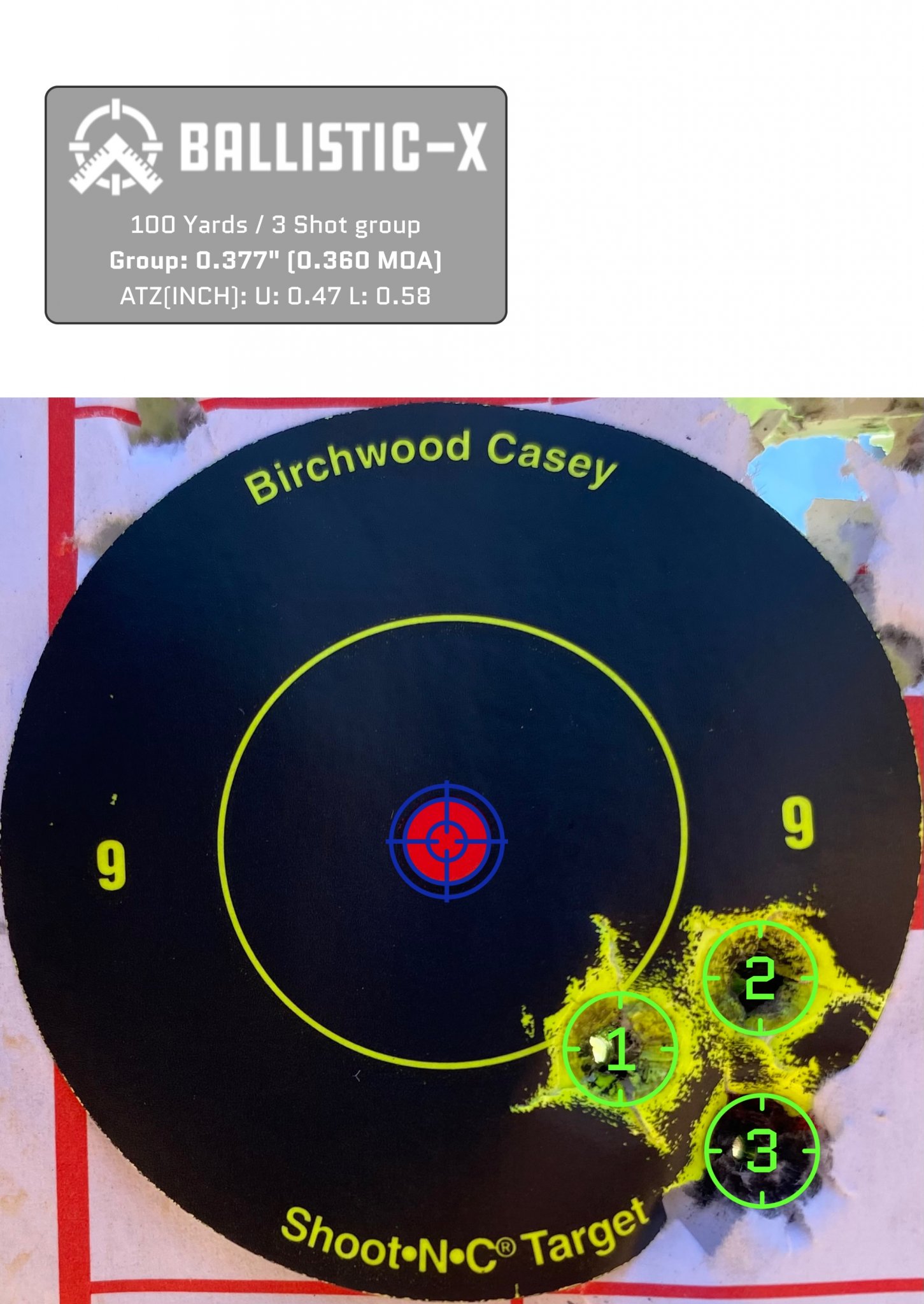

I’m good with the velocity, if that’s normal. It’s been a while since I’ve messed with a grendel. I know it’s not a fast round but as long as I’m in the ballpark of where I should be.
I shot a 5 shot group suppressed and was about .75”, threw the MagnetoSpeed on and shot a 10 shot group and it opened up to about 1.25”
That’s not the accuracy I’m used to, for sure but not bad with this crap trigger, cheap stock and cheap rifle.
ES of 25 and SD of 8 with that 10 shot group
