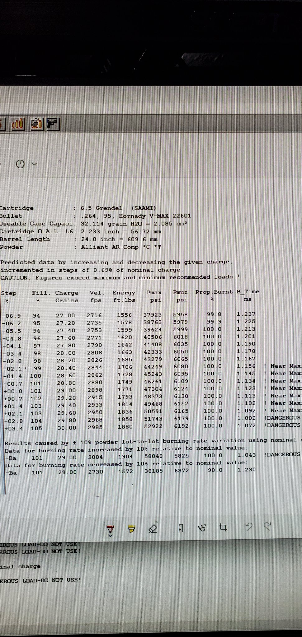

Anyone have starting loads for ARcomp for a 95gr Vmax? I was going to try that and I have some benchmark. Really looking for a good year round coyote recipe so more temp stable would be ideal. I thought my 123sst was it but some of them just punch holes and results in a dog running off
Every barrel is different, For the 95 VMax, I'd try the benchmark with a starting load about 27.0 grains and work up from there.
I think the AR Comp will run out of case capacity before you can get an acceptable velocity.
I have a 6.5 CM load for the 95 VMax that uses AR Comp, and there's quite a bit more case capacity in the CM vs. Grendel

Oh great thank you! Doing my own research I was going to start at 27.0. What primer were you using? I have a 16in barrel. I run a suppressor, thats why I run a shorter barrel. Mixed with my thermal.......nasty.

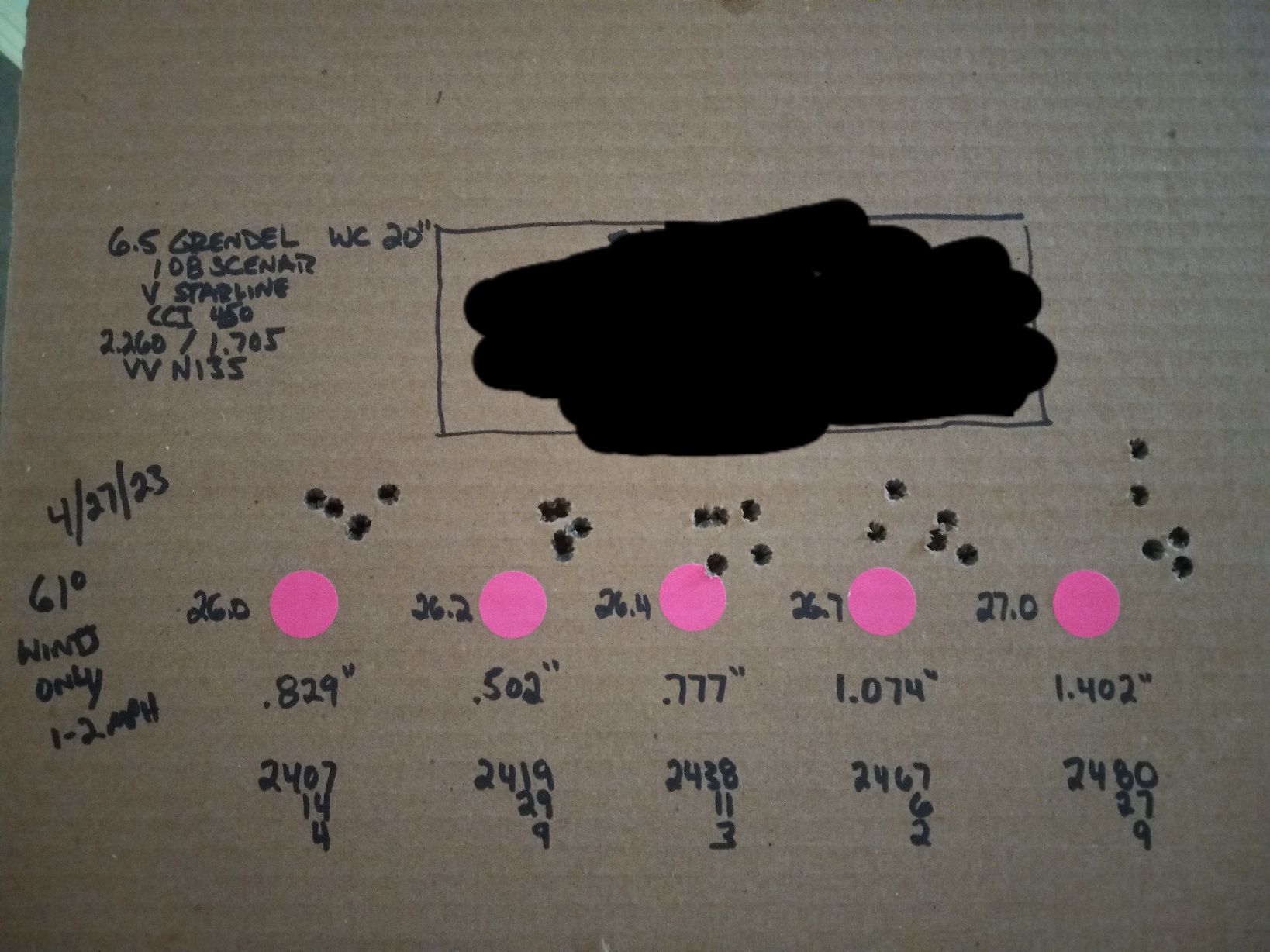

Couldn't find any data on VV N135 and the 108gr Scenar (probably for a reason).
Tried it today using data for the 123gr Scenar. Unfortunately I ran out of case capacity, and accuracy deteriorated before I got to the velocity I was hoping for.
However ES and SD were pretty nice.
20" Wilson Combat barrel

Cool, thanks. 27.0 grew my COL by .006-.007. I'm betting that AA was using different brass than I used.
I think you'd probably have to work at it to get pressure so high with N135 that you will blow primers etc... but by 26.4 I was getting a good crunch.
Unfortunately for me, groups at 27.0 were coming apart badly.
I've got N133, I will probably give that a try. VV has data showing 27.8gr at 2,638.
