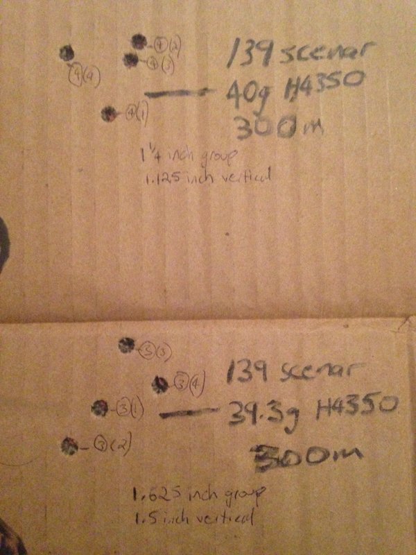

Hey guys thought I'd post this here I started another thread about a recent ladder test I did at 300m with my 6.5x47l. Today I tested the 2 nodes that I identified here is the results. The 139 scenars are seated 10 thou off lands at a coal of 2.840. The 40g load is slightly smaller group with slightly less vertical but I didn't really want to run the rifle this hard. Thoughts ?

if i had to choose between those 2 groups id take the 40g load and play with seating...i dont like jamming so id go .005 off then .020 .030 .040....139g lapuas are not real jump sensitive and why id make the larger jumps.
that said i dont shoot ladder test i personally think that is a test better suited for BR and F-class guys...ive shot a few in the past but never walked away with a load...i will also add im not the best group shooter either so i try to keep things as simple as i can.
i will look for an upper charge weight(like i did here with Padom and Bull) that looks reasonable and drop 1 to 1.5g off and start there...i normally load 7 of each charge weight in .2g increments...i shoot 1 of each charge weight over the magneto speed and watch the velocities and look for pressure signs...i then shoot 3 shots from each charge weight as groups...once ive ran through all the charges i start over but on new dots/targets...as you see in my target above #6 is my charge...i will shoot 3 5 shot groups with that load at 550yd...if it will group 1/2MOA or less im done.
Thanks mate looks like the 40g load running around 58k psi so I will work with that. Curious what other guys are running at how many of up around 63k psi??
