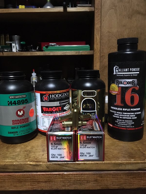

Got some 123gr ELD-Ms in going to load some this weekend over 8208 and see how it does. Been told to try varget as well which i have a ton of though i'm almost positive i'd be pushing 37+ grains to reach that kind of speed in such a short package. I've been debating on just moving up to a 130 and shooting for 2700. More energy across the board.

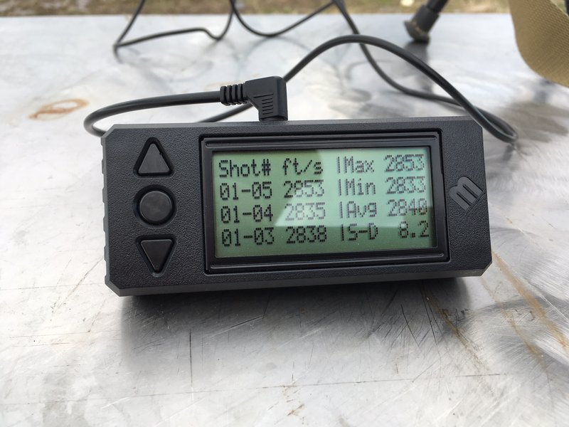

Here's a shot of my LabRadar after shooting 28rds the other day for a seating depth test. So thats 8 foulers than 5 shot groups of 4 different base to ogive measurements. 5.8 SD.
PVA 26" Rock Creek Button Prefit
140 ELD-M
37.2g Varget
2xLapua
CCI 450
2831
SD 5.8
140 ELD-M
37.2g Varget
2xLapua
CCI 450
2831
SD 5.8
Barrel length and COAL?
140 ELD-M
37.2g Varget
2xLapua
CCI 450
2831
SD 5.8
Pretty impressive fella
As I stated those 28 shots were a seating depth test. So varry8ng from touching lands to .02 off...
I understood that. Barrel length and a COAL range like 2.780-2.800 would get guys in the right area though. Just trying to clarify for someone looking to find a load similar to yours
Barrel length is already posted. 26"
COAL is 2.736" to 2.716"

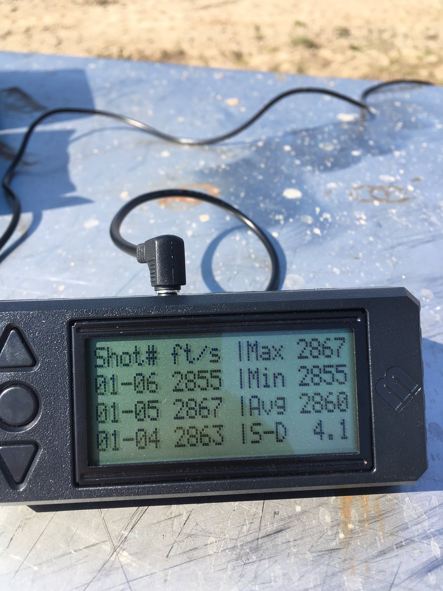

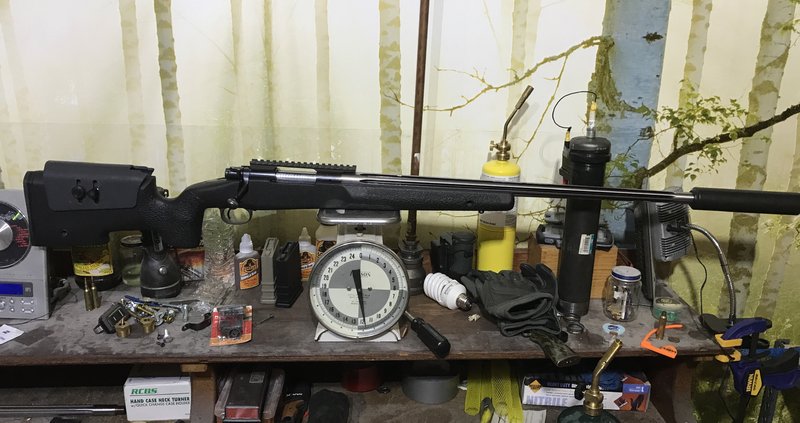

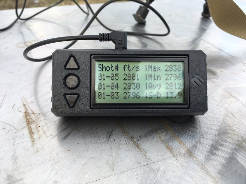

So I got around to load development for 2 projectiles... Nosler 140 RDF, which I only did the first stage to find a velocity node, and then switched to the Berger Hybrid 130 AR OTM.
24" MPA build, Surefire 300SPS. Magnetospeed V3, and I used Labradar side by side with the V3 for the 140 RDF.
For the RDF 140, 37.0 to 37.5 grains of Varget gave me 2801, 2795, 2808, and 2803fps so I would have explored 37.3 grains.

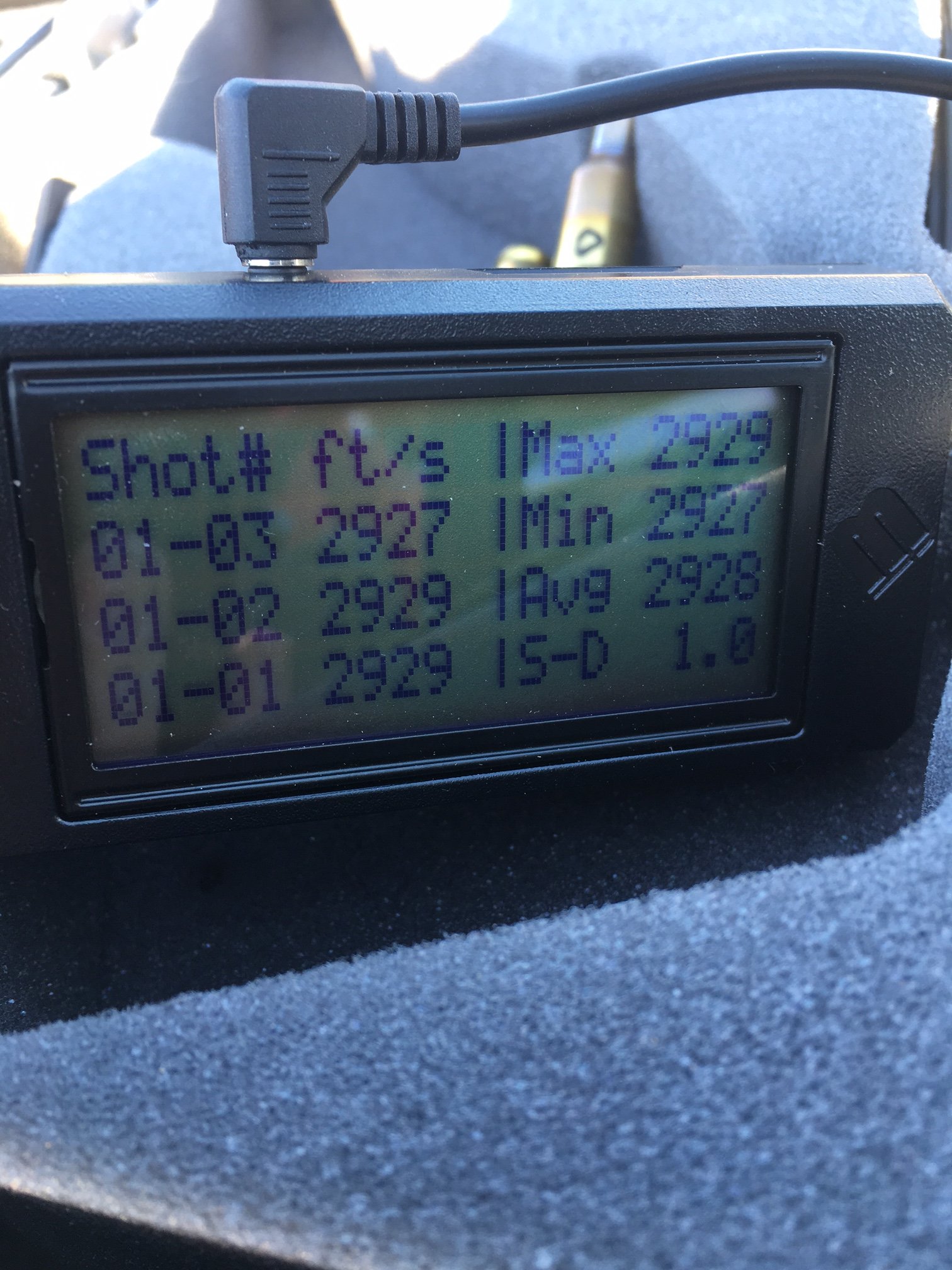

For the Berger Hybrid 130: 37.8 gr Varget, CCI 450, .030" off the lands. 3 shot ES: 3, SD: 1.4
This gave me 2925fps and .312" for the group I shot, and I've never shot for groups, so I was happy. I'll try to post some pics
I tried 10, 20, 30, and 40 thousandths off, with .030" off the best, followed by .020"(.435" group SD: 9), then .040" off (.562" group SD: 3.1). .010" off was a .8" 5 shot group with an SD of 1
Now I have 50 rounds loaded to try at distance, hopefully I'll get results out to 1,000 yards. So far, I'm very excited about my first try at load development.

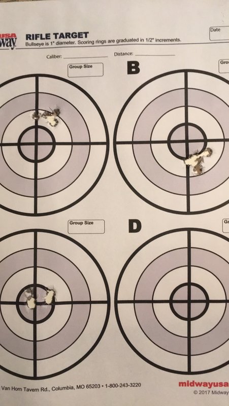

Here’s two five shot groups shot during load development for my new Criterion Light Varmint barrel.
John
41.6gr IMR 7828ssc
140gr Berger HVLD
CCI 450
Base to Ogive 2.067”
42gr IMR 7828ssc
140gr Berger HVLD
CCI 450

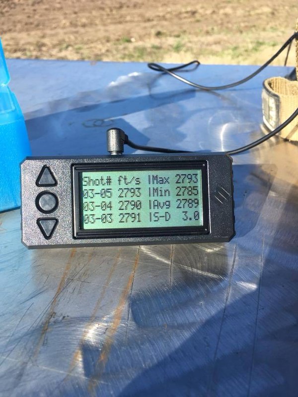

I finally found a node for the 130gr hybrid with varget and it the best two shot group i've ever printed, then it got to my head and whiffed the third shot.
Chorono results are solid though. 37.6gr of Varget out of 3 shots gave me an SD of 1 and then 3 more shots of 37.8gr gave me an over all SD between the two of 4.1 out of 6 shots. Not my best day accuracy wise, 15mph wind was killing me and i'm having a hard time adjust to the Huber.
