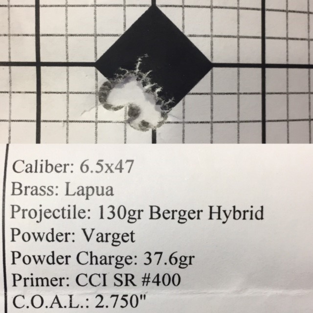

6.5 x 47 Lapua
Bartlein 1:8 26 inch Medium Palma
130gr Berger AR Hybrid
Lapua New Case
37.6 gr Varget
CCI SR #400 Primer
2887fps (Magneto)
5 shots @100yds

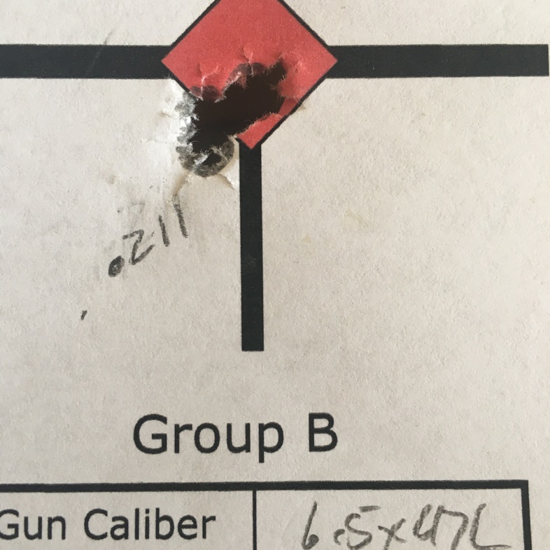

After quite a few different charges and seating depths. I shot these:
Ended up with 2769 FPS average and a 5 SD
100 yard measured .211"
The second is a 300 yard group. I didnt correct for wind. It was 6-12 variable from 4:00 .

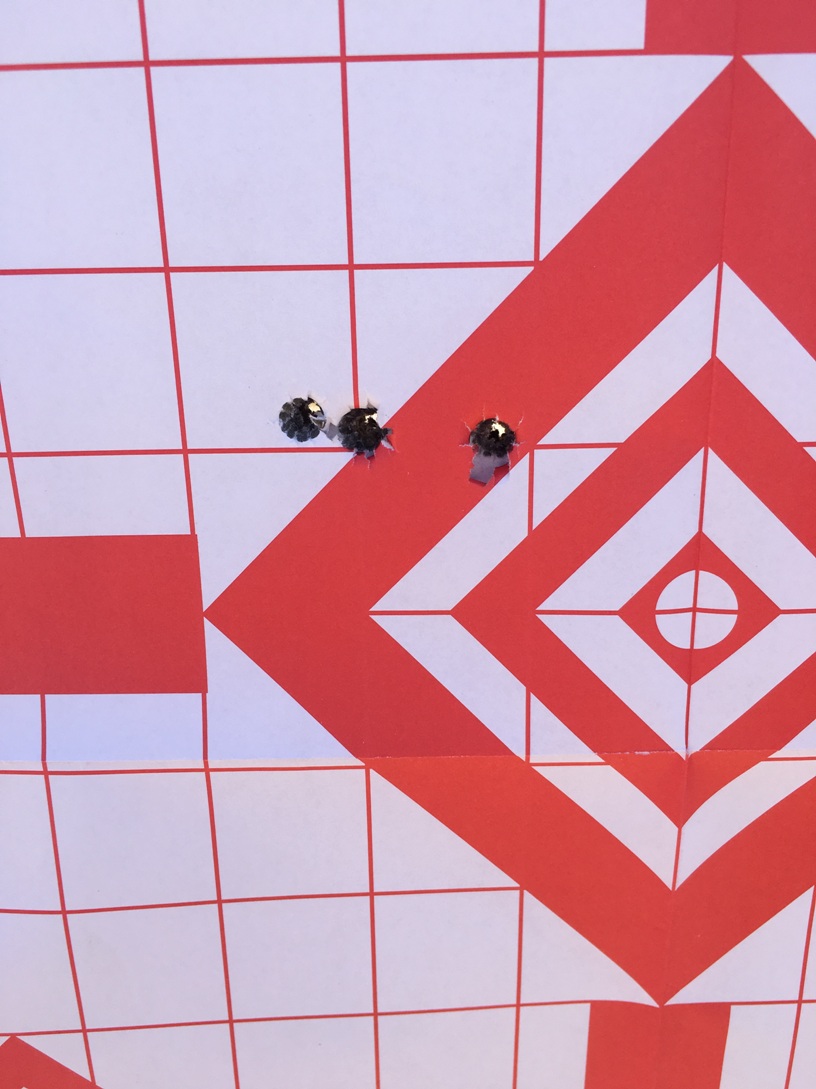

Worked this up at 500 via my modified ladder test and then did seating depth test at 100. This was the final result. 5 shots at 100.
39.8gr H4350
147gr ELD-M
CCI 450
BTO 2.070”
2710 fps
24” 8 twist Criterion Light Varmint
John

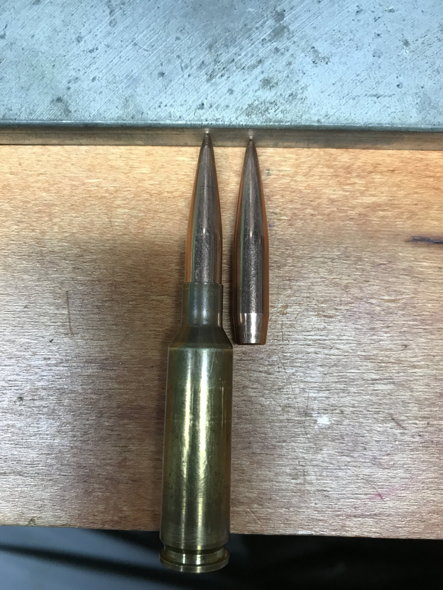

A little compressed but not too bad. OALs hold at a little over 2.8”. The 2.070 is base to ogive.
John
gotcha thanks...i can get 40.1g of 4350 in a case with a 4" drop tube and im just touching the powder with a 130g berger hybrid...at 2.065 base to ogive thats .020 off in my rifle...i havent shot any 4350 with the 130s yet because i could not get any velocity out of it with 140s in my last barrel...may have to give it a try in this new barrel.

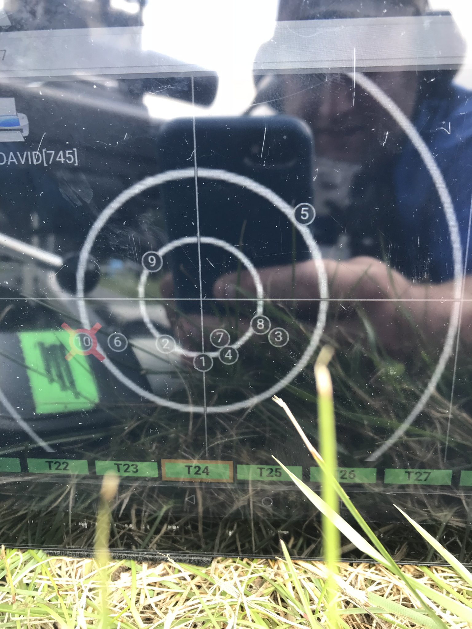

10 shot string in 90 seconds or so.
300yards

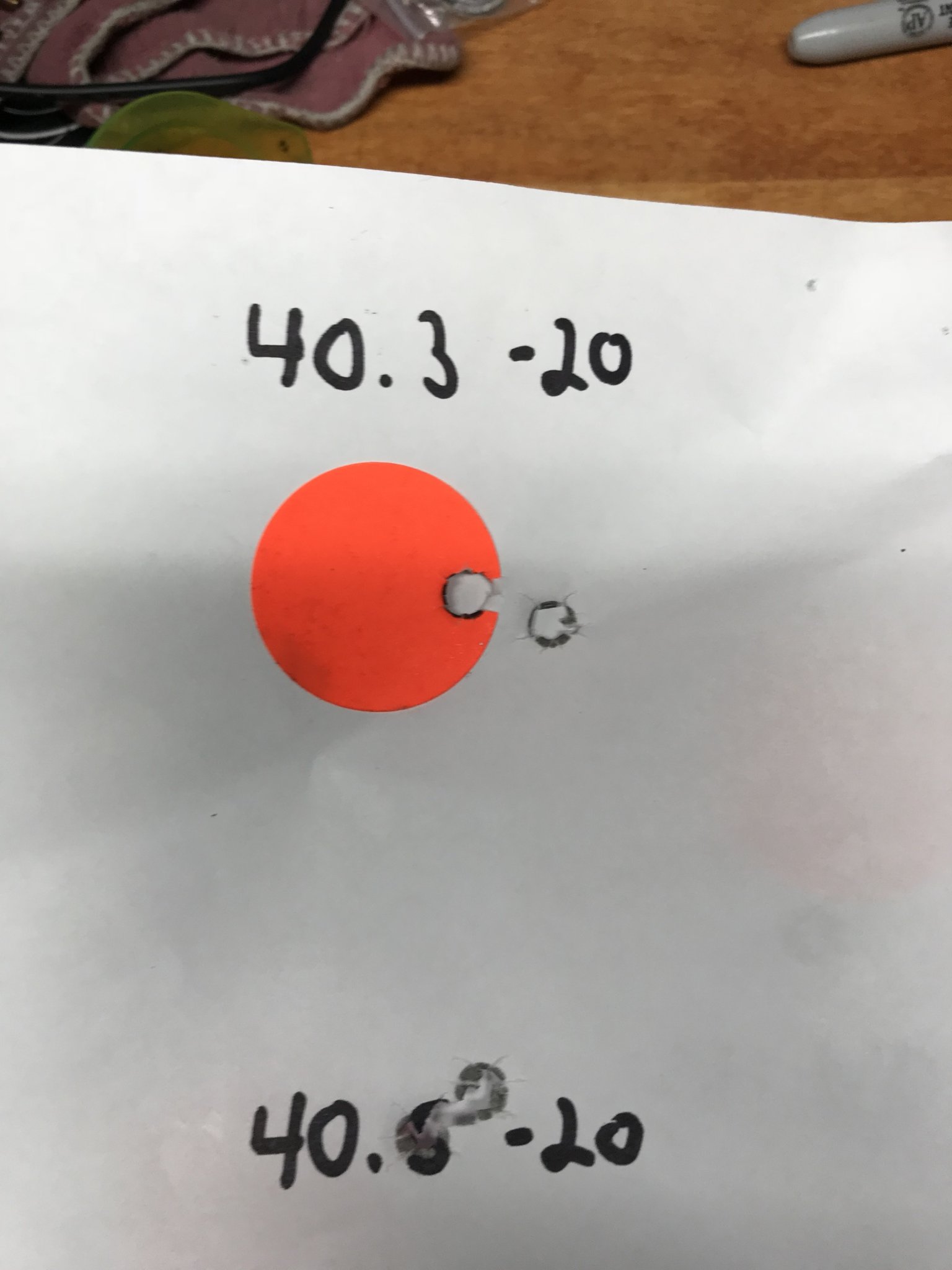

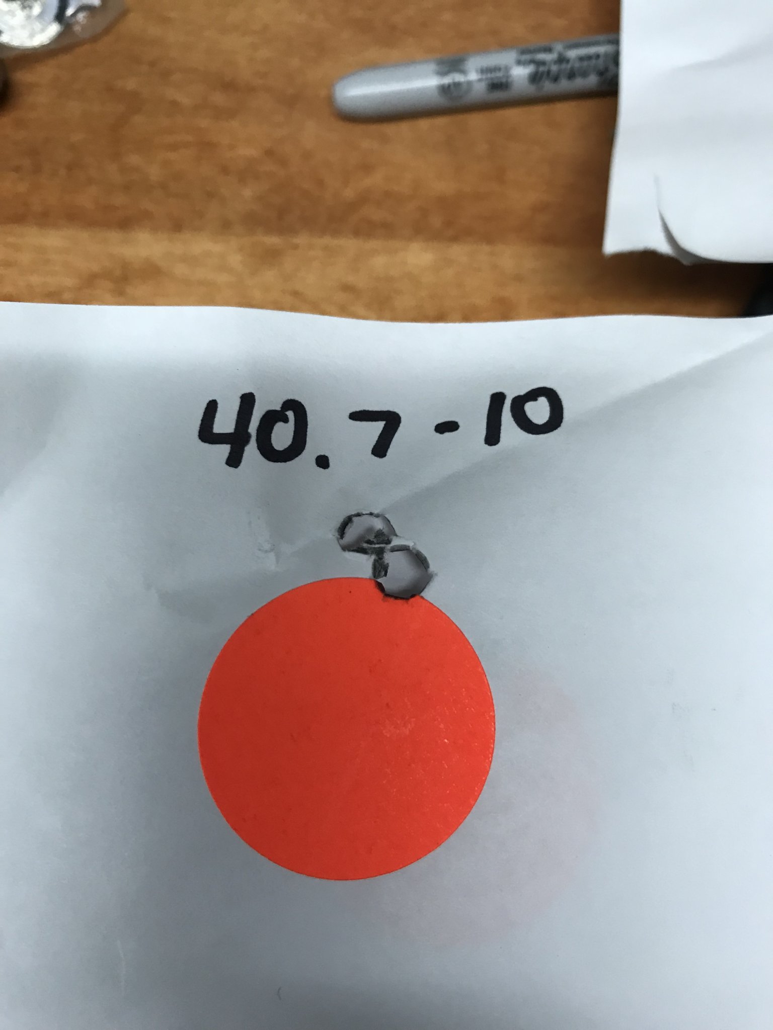

Just working up some new loads with the Sierra 150 MK. So far looking good. All the loads are using Lapua brass, H4350 and cci 450 primers. All testing was done at 200 yds. The orange dots are inch and an eighth big. I only did 10 and 20 thou off the lands. 40.3 to 40.7 looks like it wants to shoot. I’ll play around with it some more. Loads show no pressure signs. Primers are round no heavy bolt lift and no marks on brass. I went all the way up to 41.1 and still had no pressure, but groups were opening up. Didn’t have the chrono set up. Hopefully next time. I have very long freebore in this reamer. So that I’m sure helps with the pressure.
