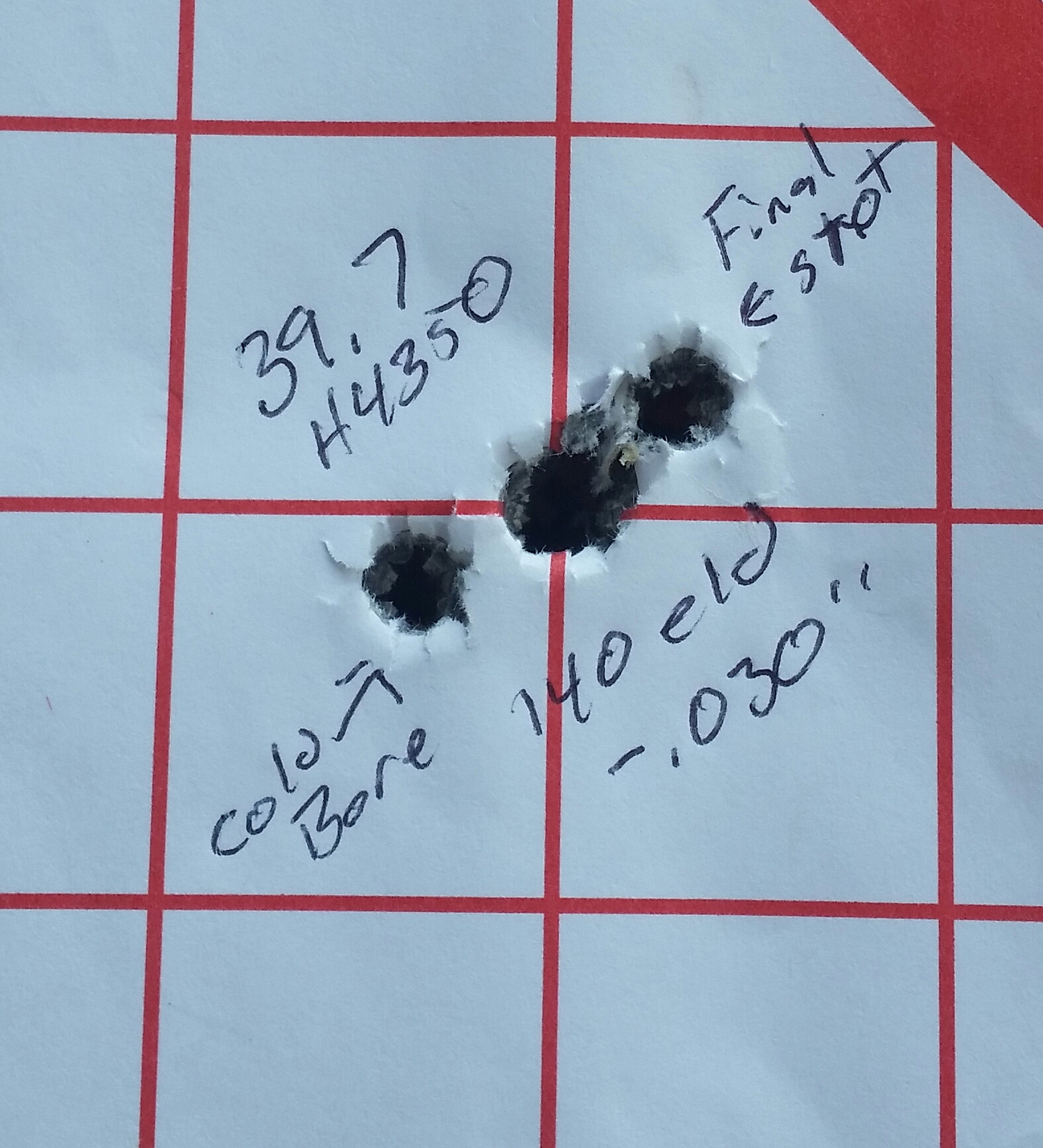

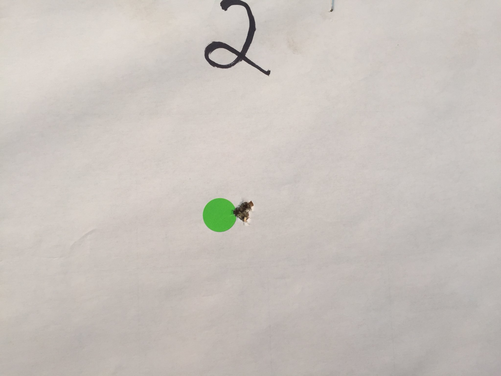

6.5x47 Lapua
39.7 grains of H4350
140 ELD at -.030" off the lands
2750 SD-3, ES-6 for 5 shots.
Loaded 5 more for confirmation of group and watched shots 2-4 go through the same hole... 5th shot laughed at me all the way to the target.

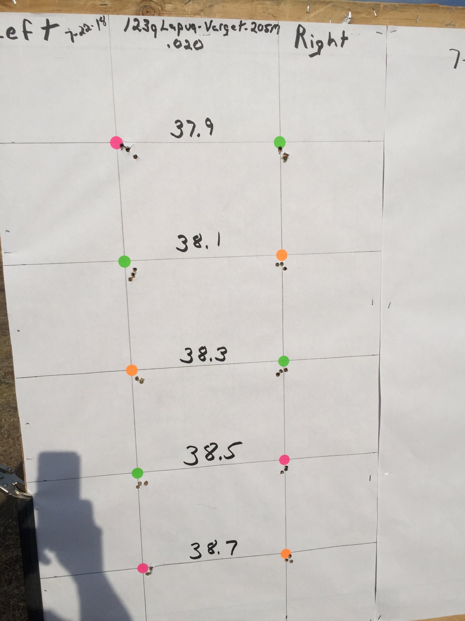

130g berger hybrids...ALL of these shot way better with varget and now my latest and go to load in the 47 from this point on...
123g lupua .010 off
38.7g varget
fed 205M...the fed205s have produced better numbers and accuracy than the CCI450s for me
3020FPS out of a 26" heavy palma hawkhill .167 freebore

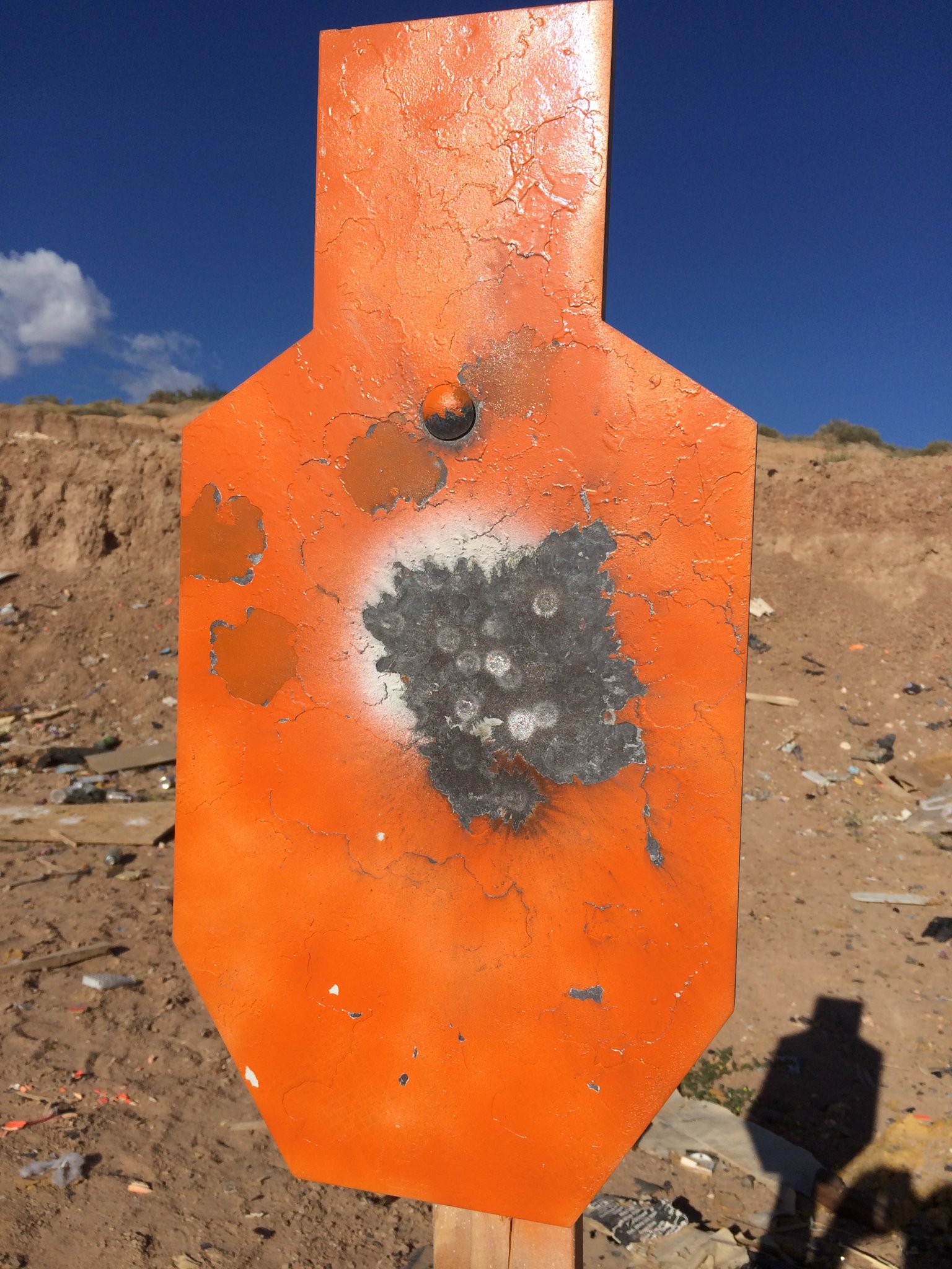

Yesterday I got bored confirming zero and shot two flys. Today was stacking headshots on a full size IPSC at 886 yards.

10 rounds at 600yds on A-C zone IPSC 12x24

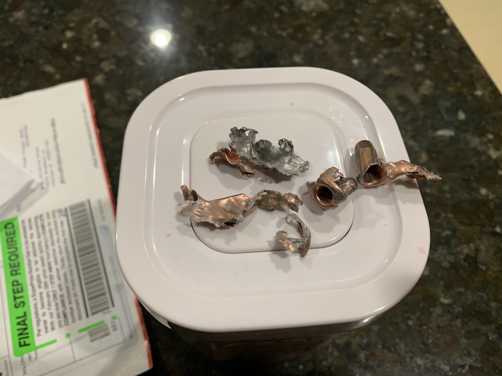

Took it out to 1k but wind got the better of me - shot to 1500 with 300wm before wind got going. Hit 1 mile with 300 Norma AI switch barrel AX (not my gun)
Attached shows recovered debris at 1m, .284 with Lab Radar and me pointing to my one hitcat 1m. The other 5 are from the rifles owner. My gunsmith who prefers to remain nameless.
