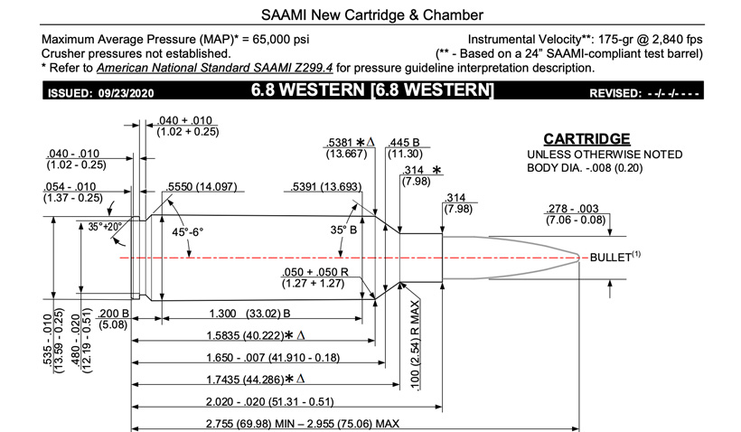

If we think along the lines of "what is the heaviest-for-caliber bullet I can get to 2600-2800 FPS" Then I think the new 6.8 Western technically occupies that zone in AR10. The SAAMI drawing says it will do a 175 at 2840. This cartridge probably will not stand a chance against the 6.5 CM for many reasons though, and 6.5 CM with a 130 is a really great choice when considering this efficiency and balance argument.
I don’t know how well the 6.8 Western would do in a large frame setup. The SAAMI specs say COAL can run from 2.755 to 2.955, and its max pressure is 65,000 instead of .308’s 62,000.
It seems like you could run it in a large frame AR, but you wouldn’t be getting the full benefit of the cartridge. I don’t reload or have any experience with cartridge development / acceptance, but it seems like quite a lot of work to still miss out on what the cartridge should be capable of.
