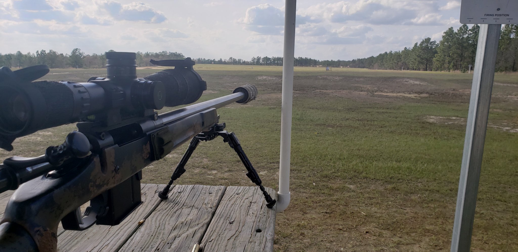

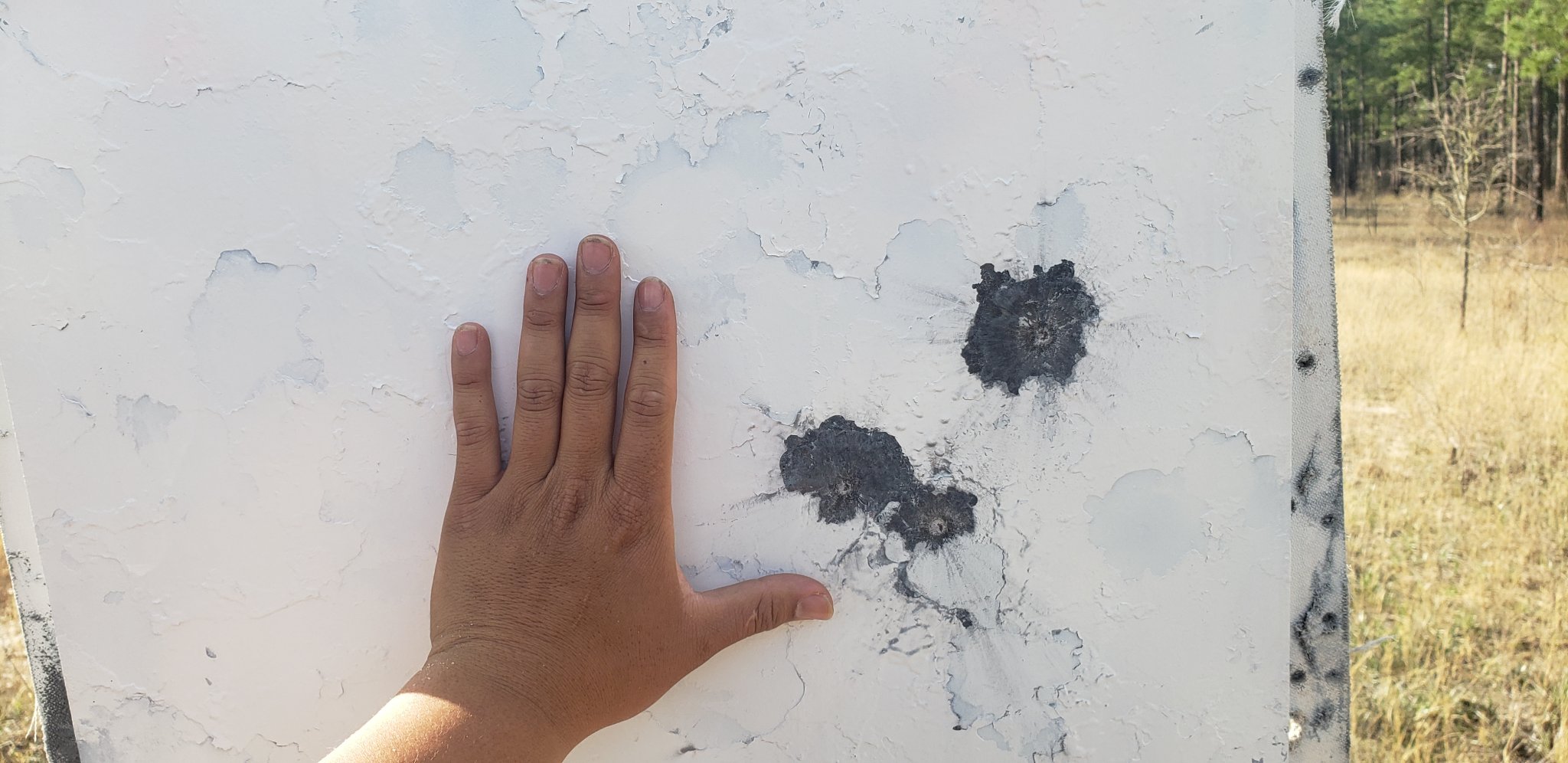

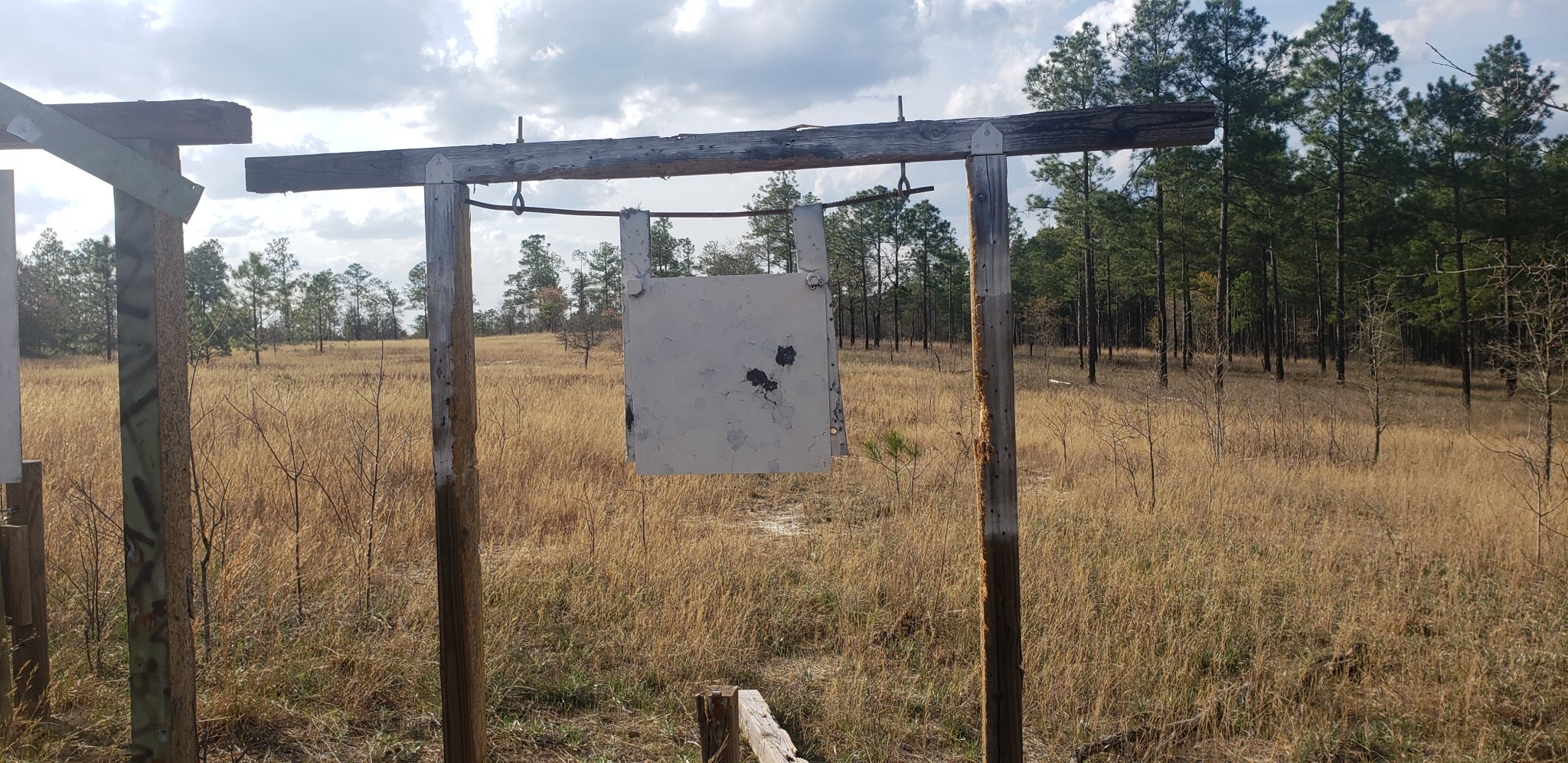

1003 yards, not too shabby. 3 shots, I wanted to shoot 5 but range was closing. I'll try 10 rounds on this plate someday.

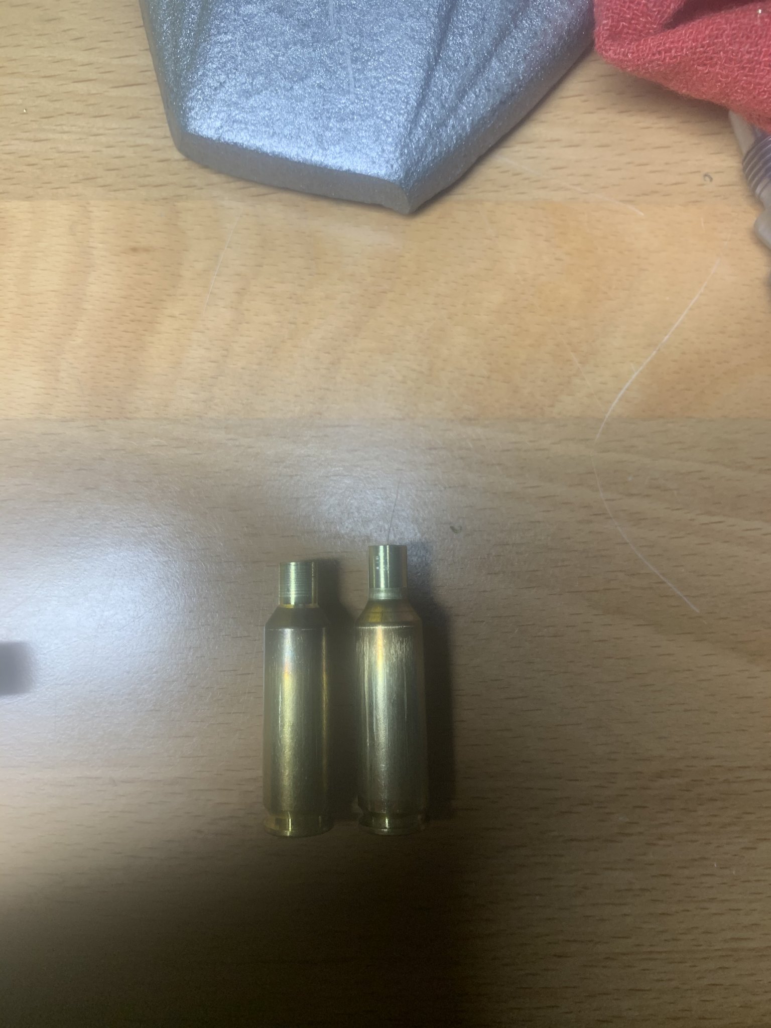

I'm at 1700 rounds and noticed my groups opened up. I listened to the modern day sniper with scott satterlee and was at .02 off the lands before this test. I shot 5 round groups left to right and than bottom left to right. Point of aim was the corners of the box and the bullet meet my lands at 1.980. Below is what I seated the bullets to,
1.975
1.970
1.960
1.950
1.930
1.900
1.880
1.860
