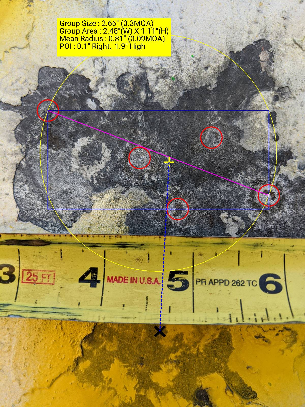

844yd
105 bergers
In the cheap brass

I have 800 rounds through my barrel, still half moa. I'm running it slow at 2900 with 34.3 GN of varget. All alpha brass but I did notice that my bolt was sticky with once fired. I'll try resizing down an extra .002.
I cleaned the chamber at 600 rounds when I heard Dthomas having issues. So far I'm liking the less recoil over the 6.5, gonna keep adding to the barrel life.
Awesome. And either only half of my issue was the dirty chamber. Could have been 100% brass though. Will be experimenting a bit more here shortly. But for the moment I’m working on another more proven cartridge so I have something to shoot matches with until I have this worked out properly.
