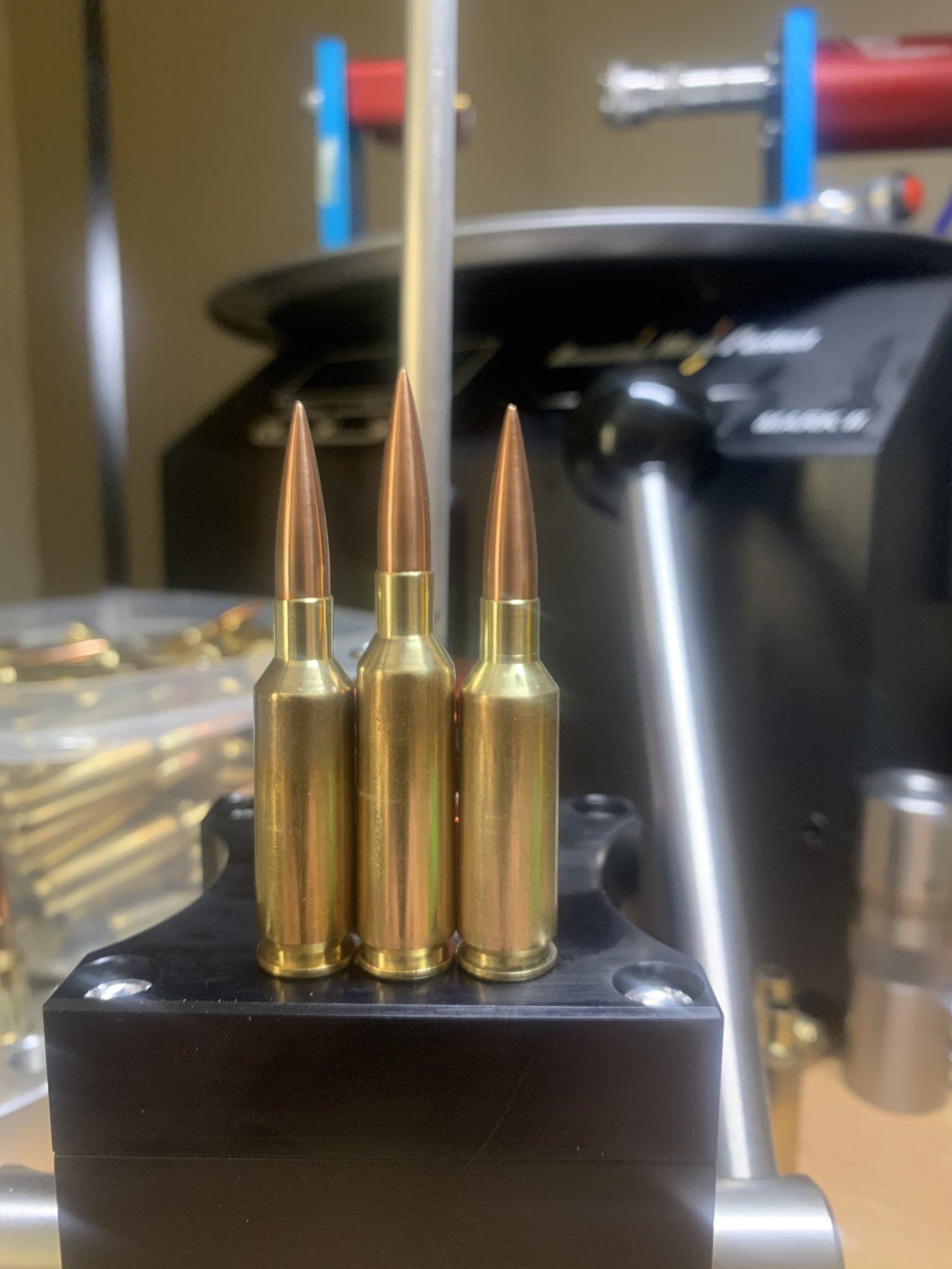

Just because bored.
Left-Hornady 6gt
Middle-6x47 lapua
Right-Lapua 6gt
Reactions: tob5 and 47guy

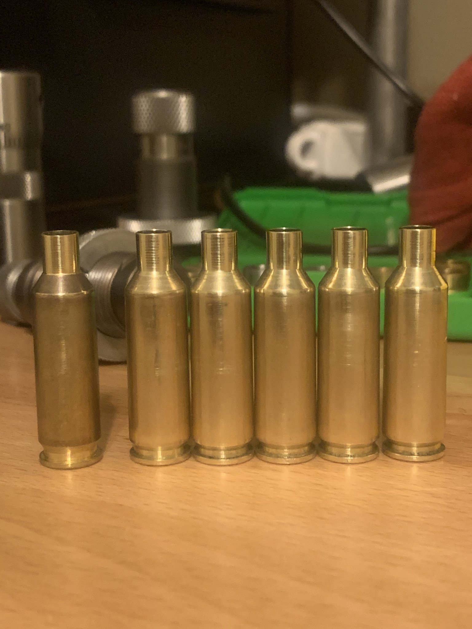

what step and equipment did you take to form the lapua case?
6.5x47 through Gt die without bushing
Then with a .271 and a .268
Run though neck turning mandrel
Turn neck on lathe
Trim in giraud
Run in die with .265
Mandrel up with .242 mandrel
None of it was hard. I timed it. 3-5min per piece without optimizing any step yet.

5 sacrificial/test lapua 6gt
Hornady on left for comparison. I’m not looking to go above 2950. So, *hopefully* it works fine.

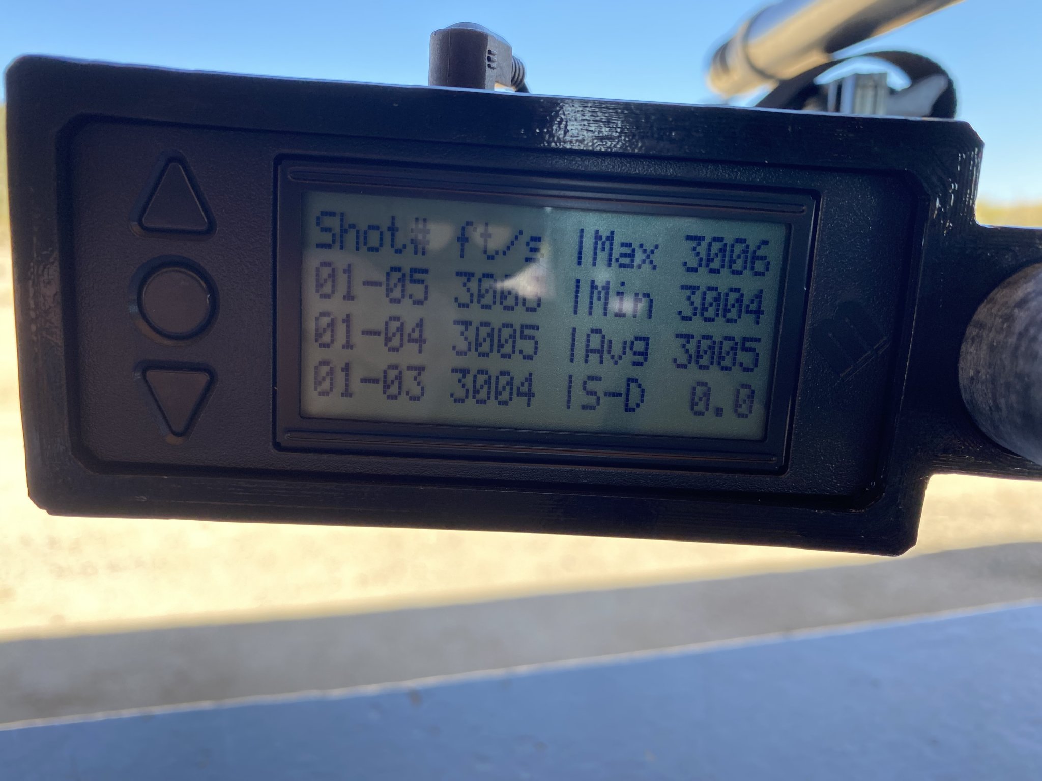

I'm getting the same velocity, similar nodes, except out of a 26" bbl. Bbl only has ~250rnds through it.
37.75gr H4350, velocity avg 3040fps 108 ELD-M

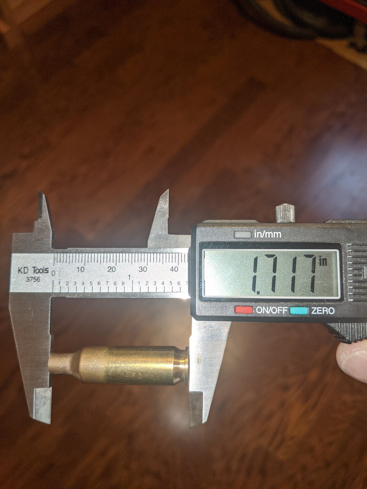

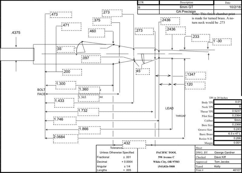

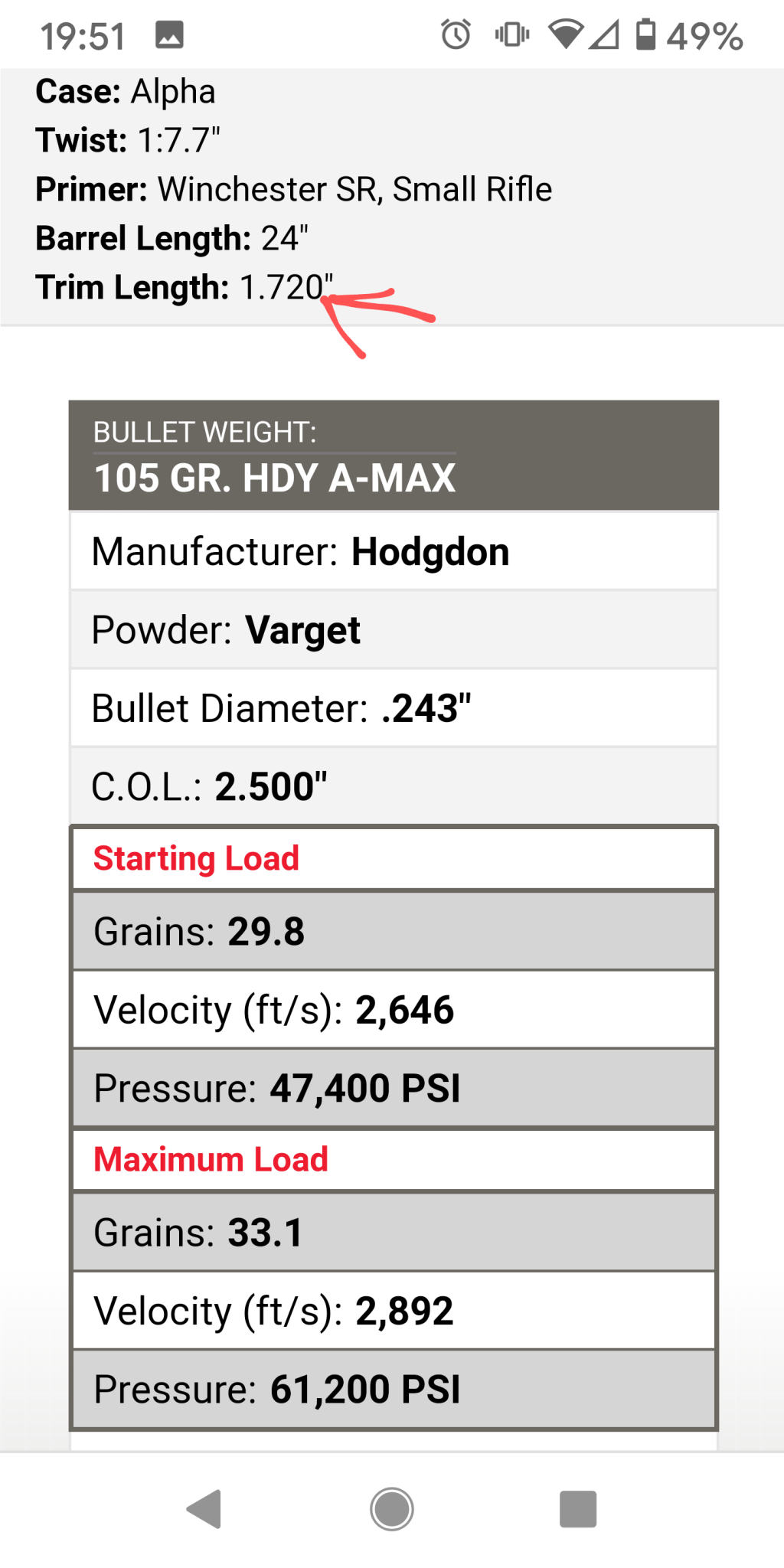

Gents - can someone please let me know the recommended trim length for 6GT, or length of new Hornady or Alpha brass? I'm having to make my first cases from 6.5x47 and I've never seen a 6GT in the wild down here. I might have missed it somewhere. If so, apologies.
Here’s the print. I’ll try to remember to measure my hornady/alpha brass today. The lapua I’m experimenting with I have just been running it to same length as I do hornady (I go about .001-.002 under what factory hornady comes so they are all uniform length).
Reactions: Mr Flannel
Virgin Hornady
I believe the spec is 1.720
Thanks gents. Greatly appreciated. I’d looked at the reamer print but didn’t know what a safe margin might be.

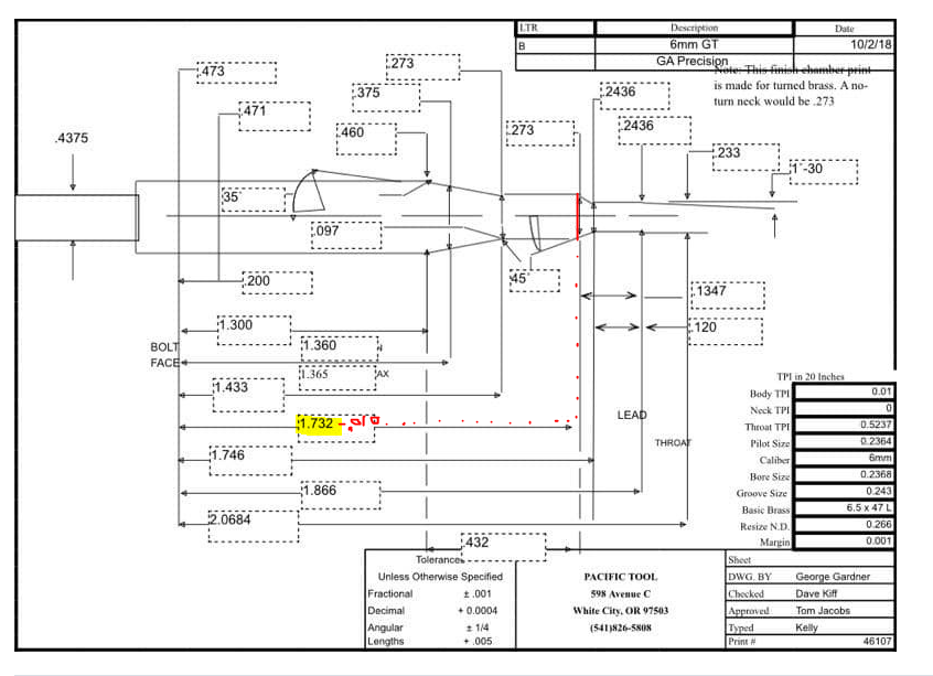

For saami specs generally the max case length will be .010 from the end of the neck before it transitions down.
So 1.732 minus .010 gives us 1.722 max. Then the spec will say something along the lines of -.020 meaning that up to .020 below that number is still in spec. So the trim length spec would be 1.722-.020 meaning anywhere from 1.702-1.722 is in the range.
Reactions: sleeplz
Thanks - appreciate it. I’d thought to subtract about 0.015“ to 0.020” from the 1.732” figure so good to see I wasn’t completely off base.

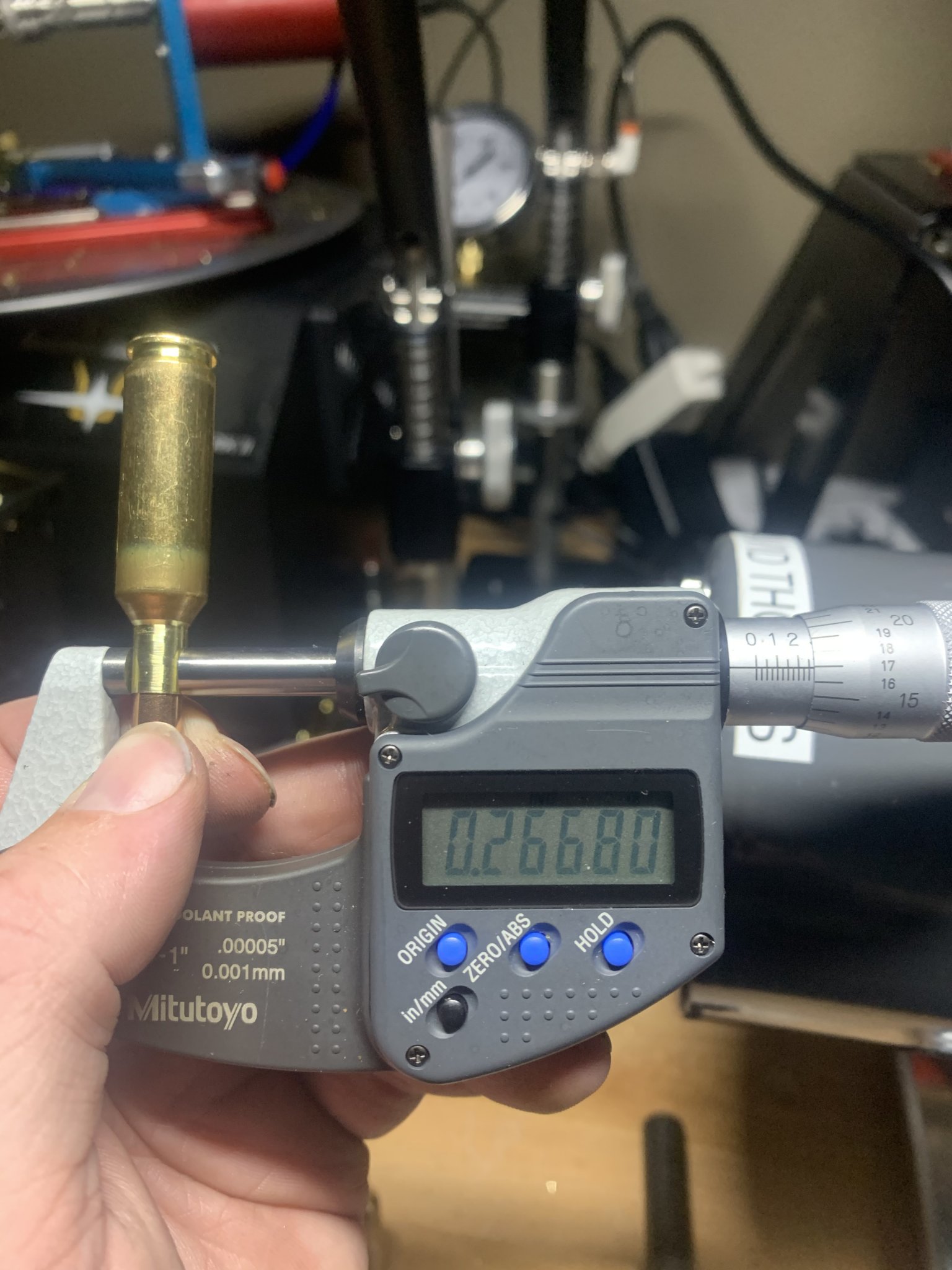

Update on making lapua 6gt. Now that I have pretty much everything I need, I just spent a few hours perfecting the process. I think I have it down. It sounds like a lot, but with the right stuff, it’s not bad.
Run virgin 6.5x47 into SAC 6gt die without bushing. Twist 1-2 times in process in attempt to maintain some sort of concentricity.
21st turning expander mandrel (.240)
Inside ream with IDOD (just enough for the 21st turning mandrel to pass properly). Finding IDOD doesn’t do well with brass that isn’t concentric. Neck thickness was all over the place
Outside turn with 21st lathe (the strength of a mandrel and floating Chuck is when brass isn’t concentric)
Neck comes out at .012 and hugs a .241 pin gauge perfectly without any feeling of a donut.
From here is just trim/chamfer/deburr and load. I’ll probably add the trim/cham/deb after the IDOD reaming.
.012 neck wall works out to a .267 loaded neck diameter which is just about perfect at .006 neck clearance. .006 is what I shoot for on most everything.
