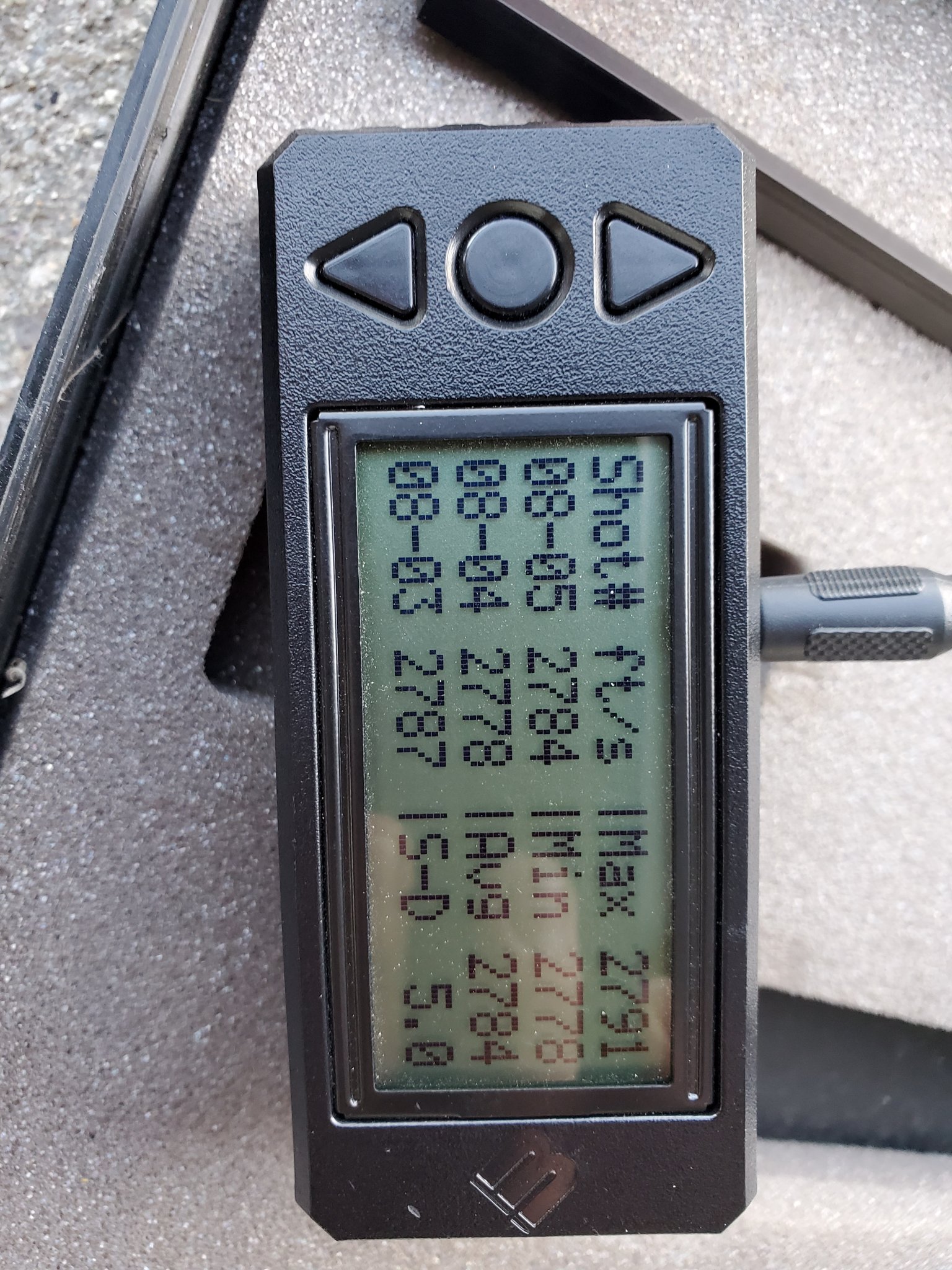

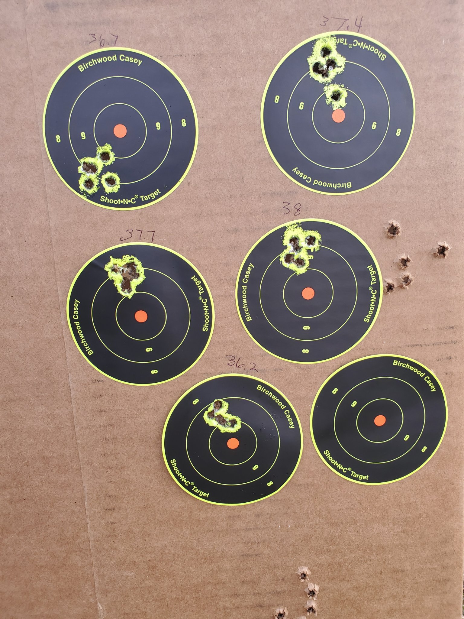

Ran my 6GT today here are the stats.......this looks to be what I will run being that I won't run the hot node. Really digging this cartage.
6GT Stuteville Precision 26 inch barrel Impact Action Gen III Fat Bastard 5 port break
34.6-34.8 Varget was the sweet spot single hole 5 round groups on a lower node, loaded on twin Charge Masters
109 Berger Hybrid 50 thou off
Alpha Brass .267 neck tension, 2nd firing
BR4 Primer
2940 FPS 34.6 Varget SD 4.1 ES 9
2950 FPS 34.8 Varget SD 3.2 ES 7

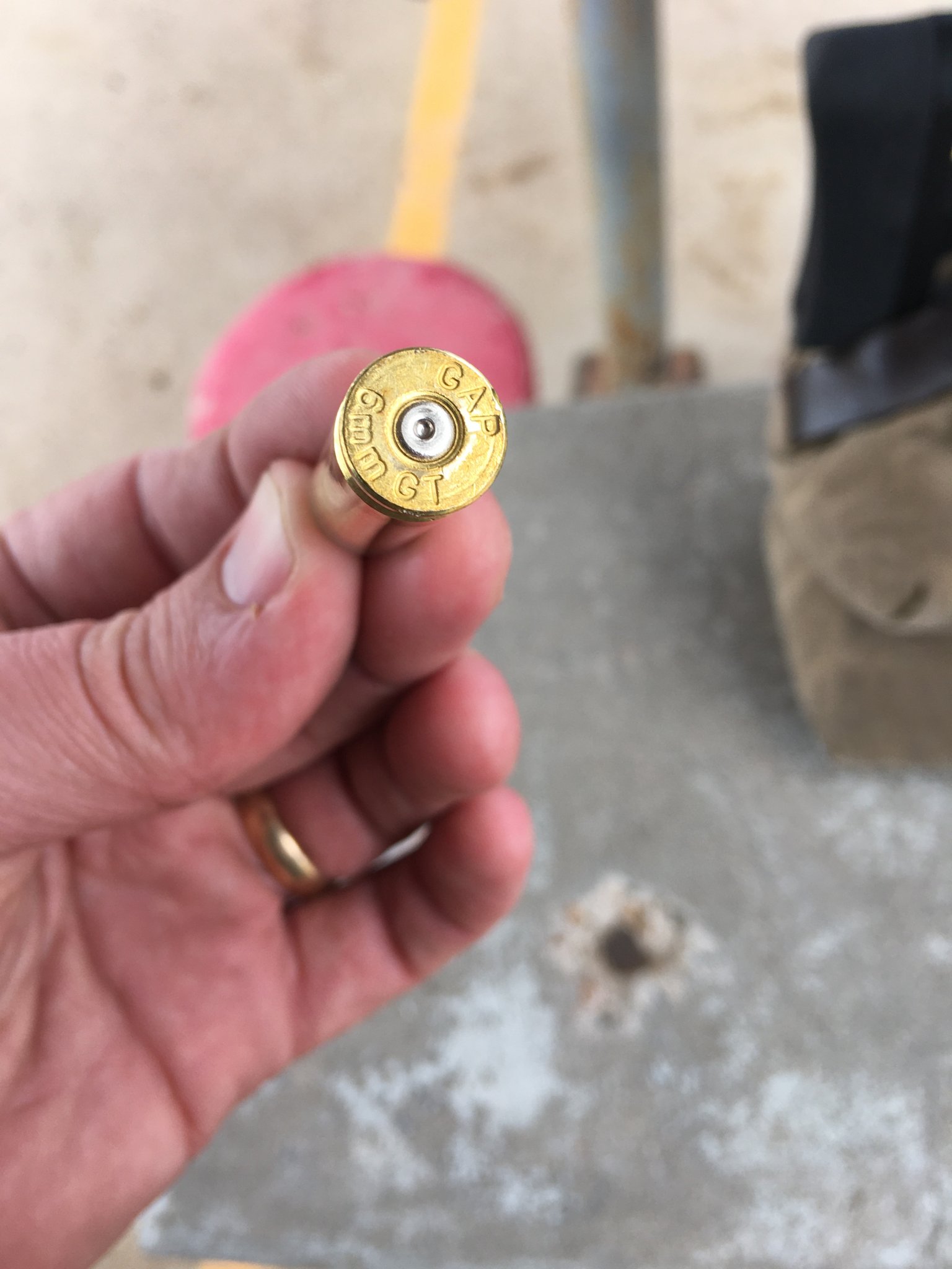

For the lurkers or readers.... regarding the "problems" folks are having regarding pressure with Alpha GT...it's likely a FL sizing die base dimension issue.
Measure at the ".200" line, if you put a case on your bench, .200 up from the case head, measure the diameter of a virgin, fired "clicky/sticky" case, fired no "clicky/sticky" case, and FL sized case where your bumping the shoulder .003-.004.
A pair of calipers will have hard time picking up the measurements if your FL sizing die is on the edge, best to use a dial micrometer that can measure to the .0001.
You should ideally see .0015-.0020 reduction in base diameter of a fired case after sizing. If you don't, you're gonna get "clickers" or see premature signs of pressure.
Just like lot variations in bullets, primers, barrels, reamers etc, dies are no different. You need to qualify your tooling, and your use of it.
I still prefer Lapua, but the Alpha 6 GT I've used is excellent quality brass.
If you've got a big FL sizing die, and a min spec chamber, you look uninformed blaming your lack of knowledge or experience on "brass problems".
I set my die up to where fired brass would free fall the bolt with no firing pin assembly or ejector and it ended up needing .004 of bump. That’s about double that I ever sized a fired case.
I anneal with an AMP every firing so I hope my brass doesn’t split from working that much. I usually only bump shoulders about .0015.
Reactions: V-Ref
You're setting it up perfectly. The reason your measurements show .003-.004 is because there's never a perfect match between the shoulder angle in your chamber and your FL sizer and the datum on your comparator.

Soft case head in some batches is the general consensus among several who have looked at it. Without hardness tests no way to verify.
Dies are sizing properly. Hornady factory brass and formed lapua works fine.

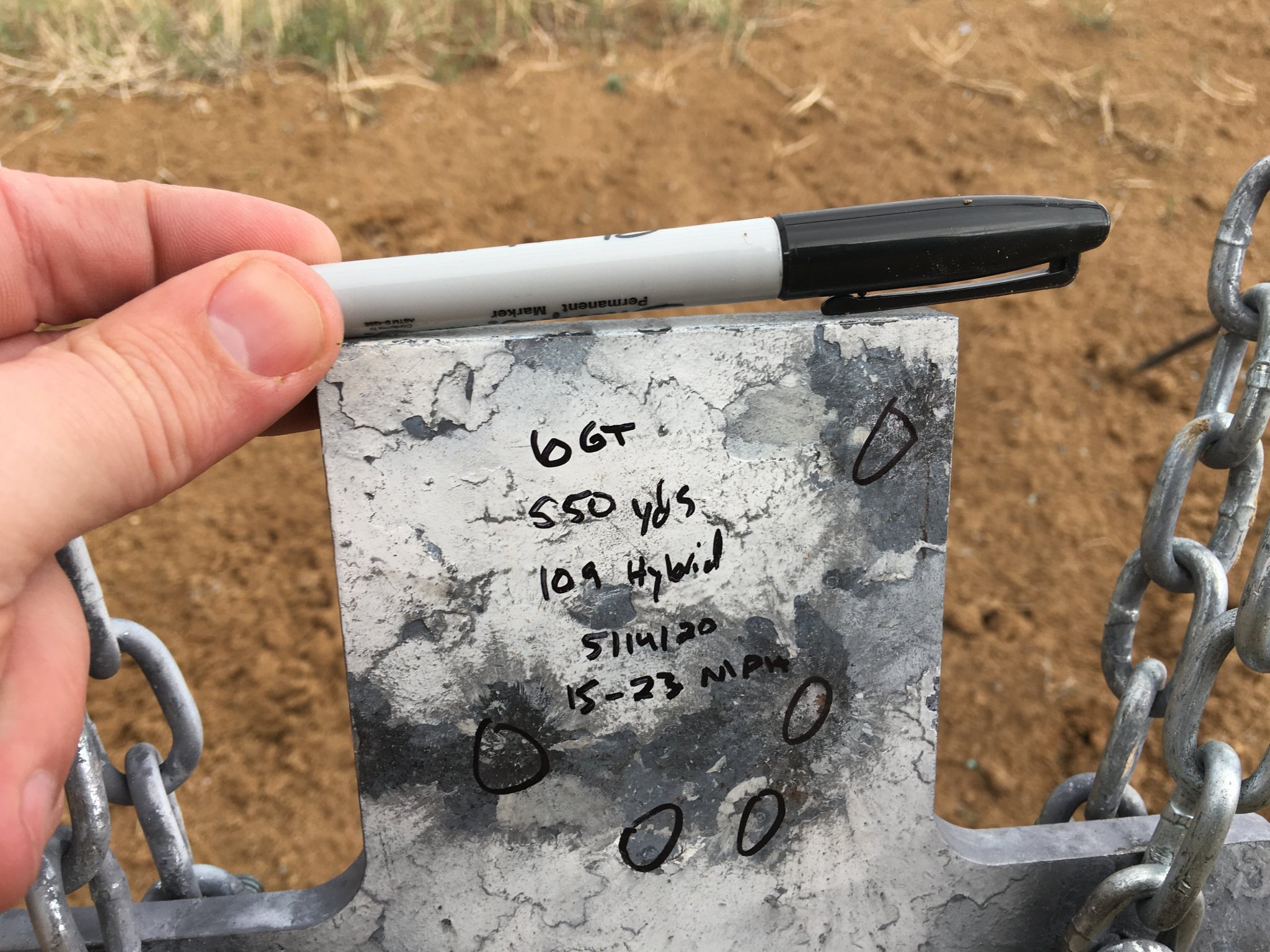

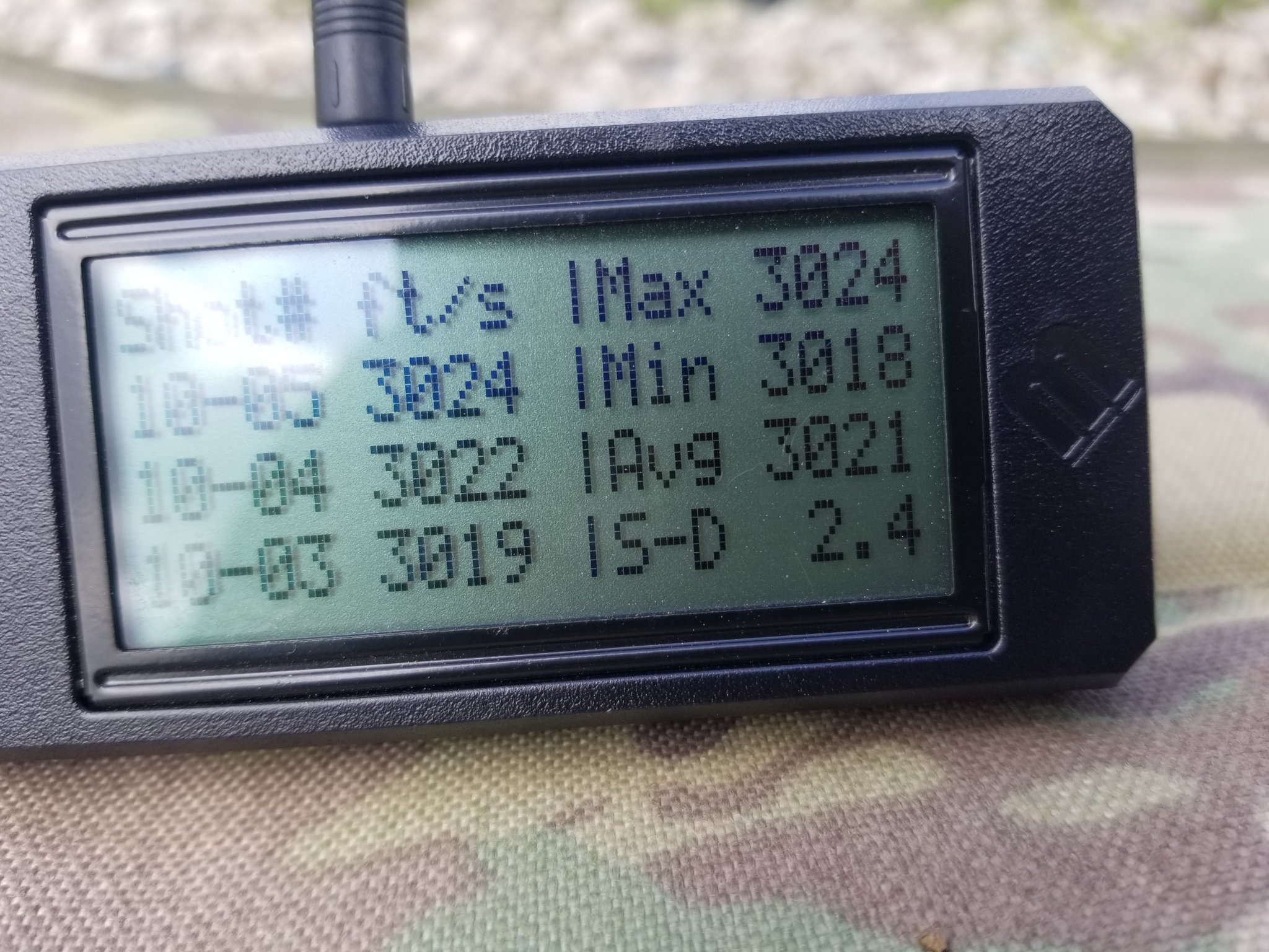

Finally got my 6GT out! Barrel is a Krieger pre-fit chambered by Keystone Accuracy for my Bighorn Origin.
Despite 20+ mph winds and having to single feed(forgot mag) it shot in the .2’s and .3’s with my generic break- in loads at 100 yards.
Load is: 35.5 grains H4350 with a Hybrid 109 in Hornady brass, CCI 450. COAL of 2.59”. Can’t wait to keep shooting it and see where my accuracy/velocity nodes end up.

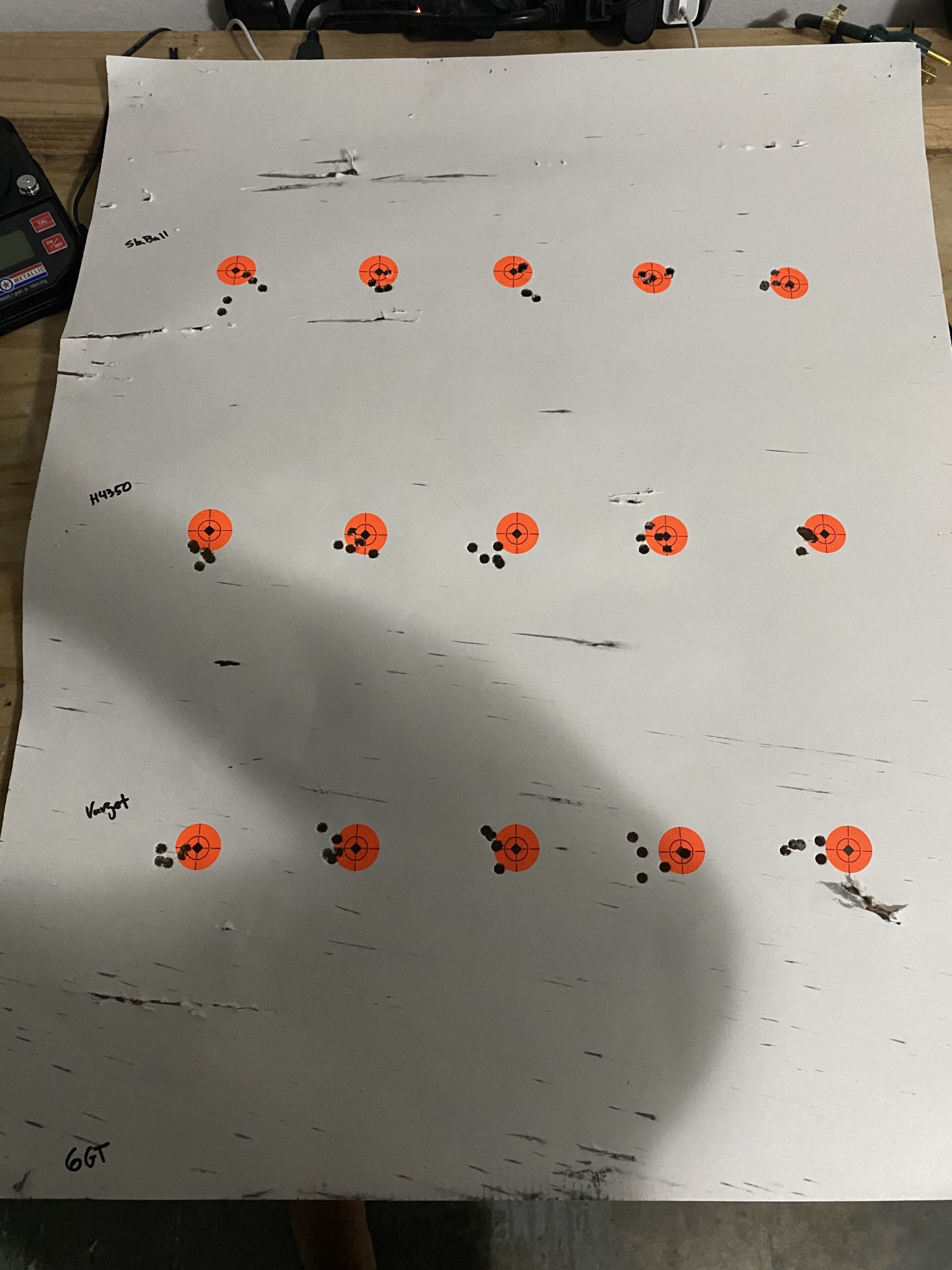

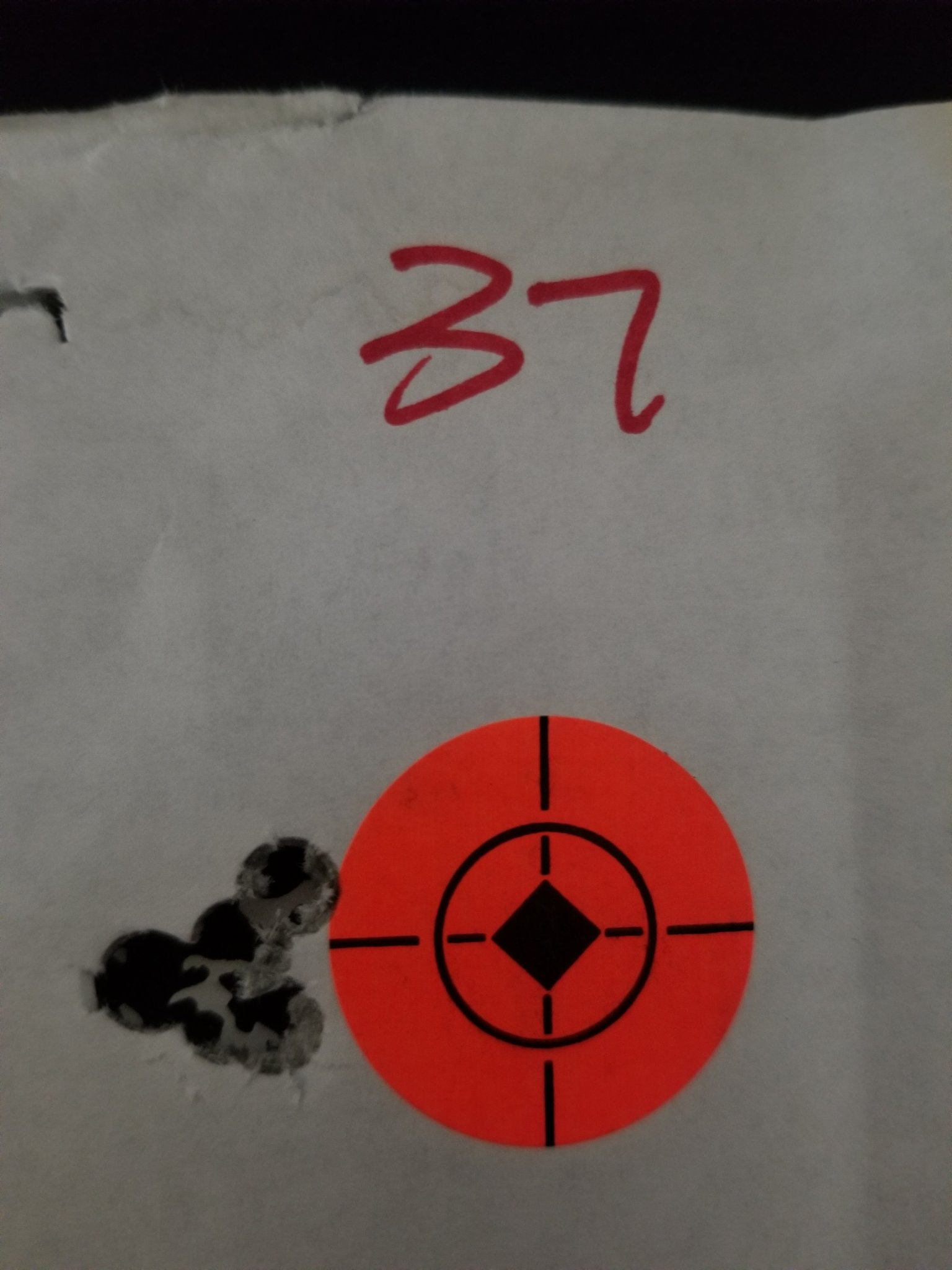

thank you. Berger 105s Staball, H4350 and Varget tested.Best SDs are in the 2925 to 2975 FPS range. This is brand new Hornady brass with CCI450
